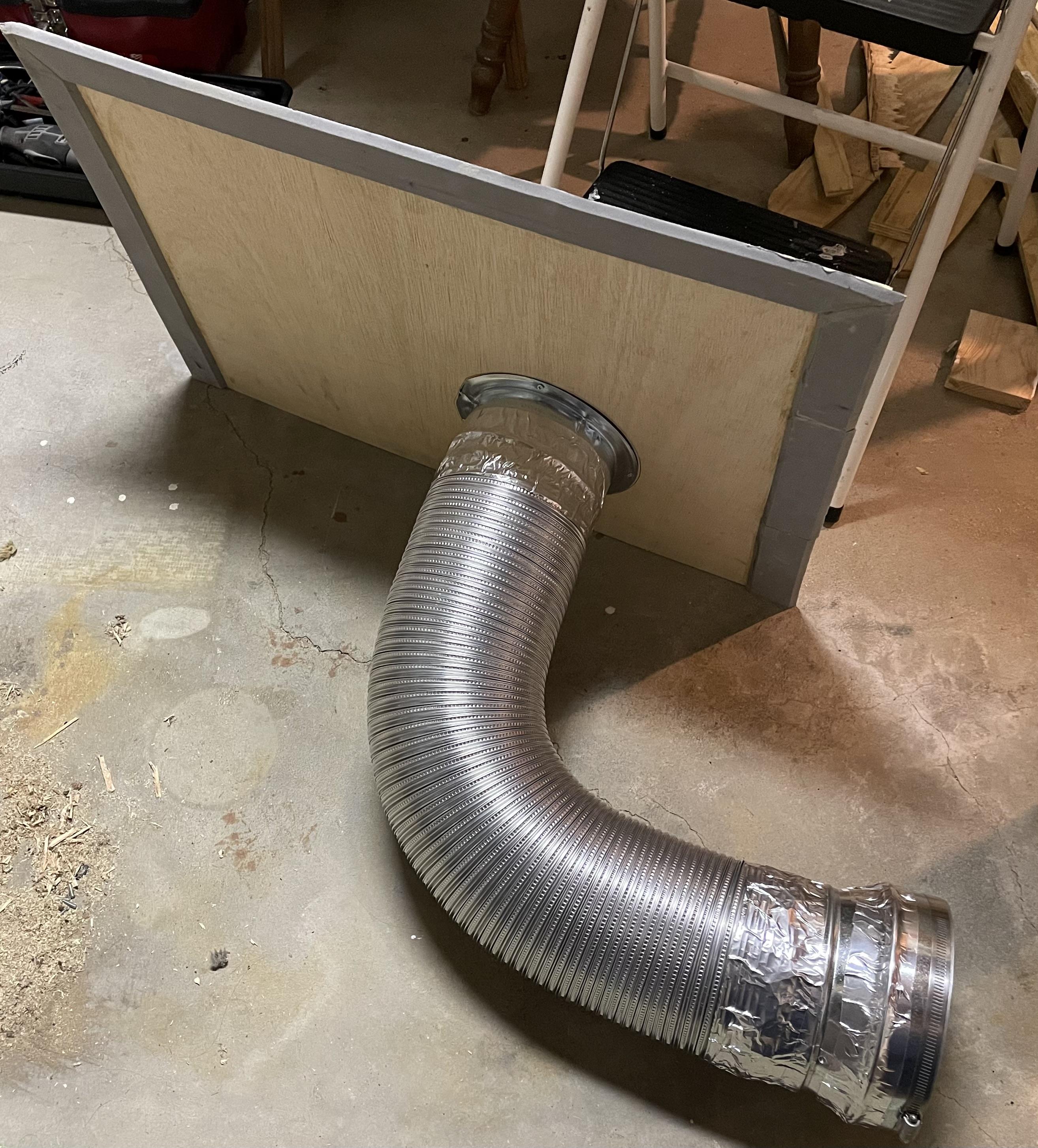

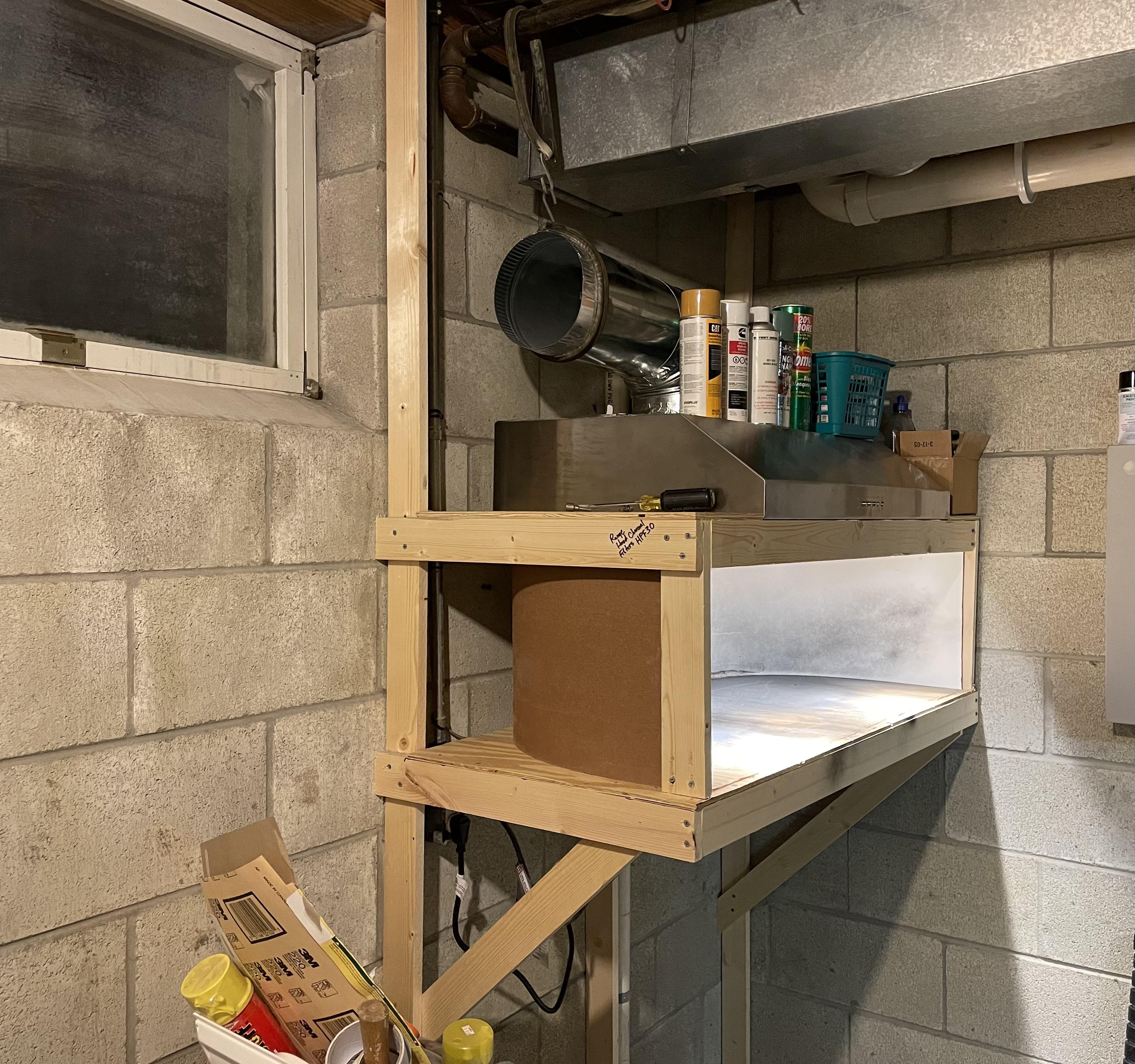

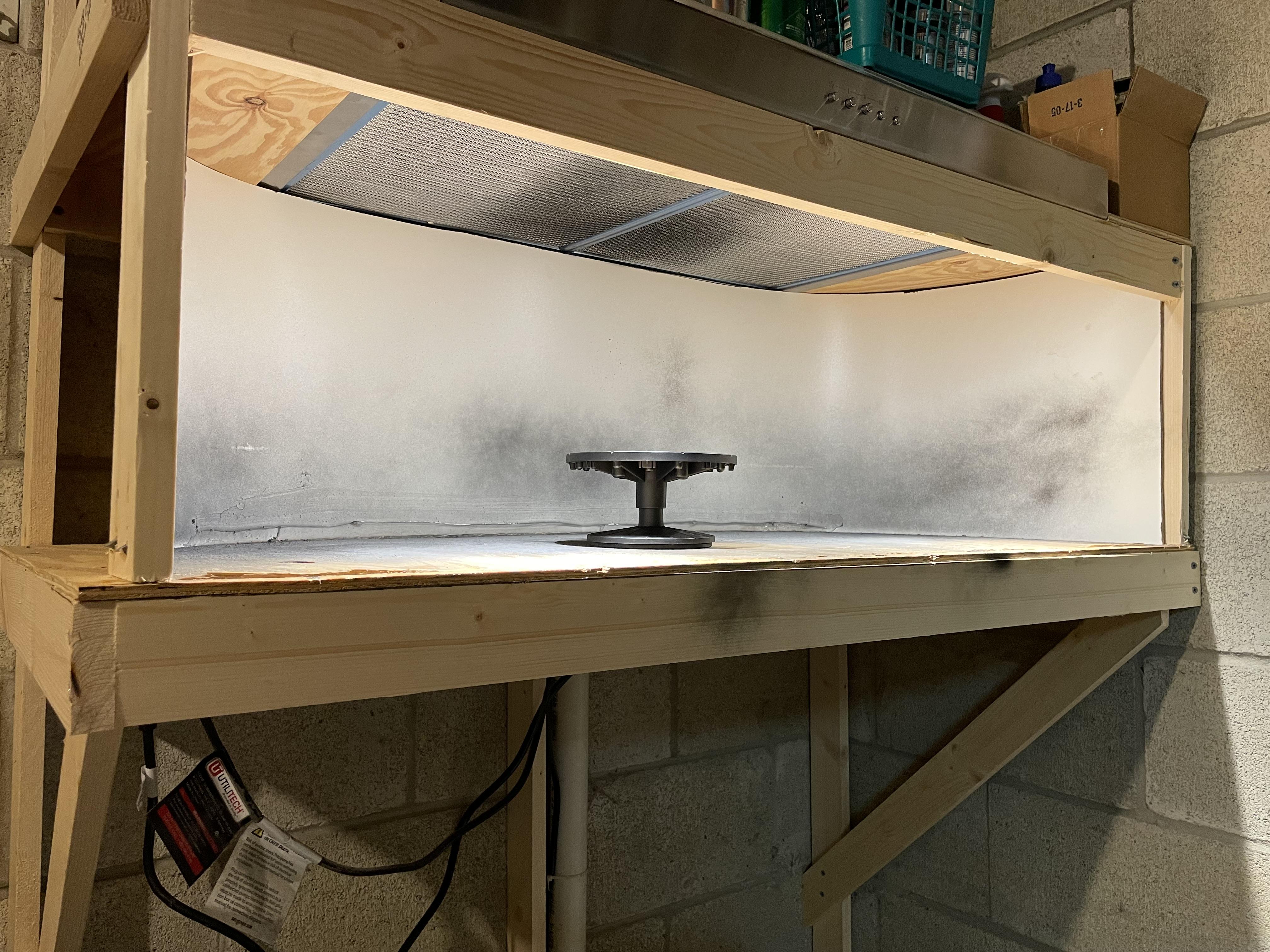

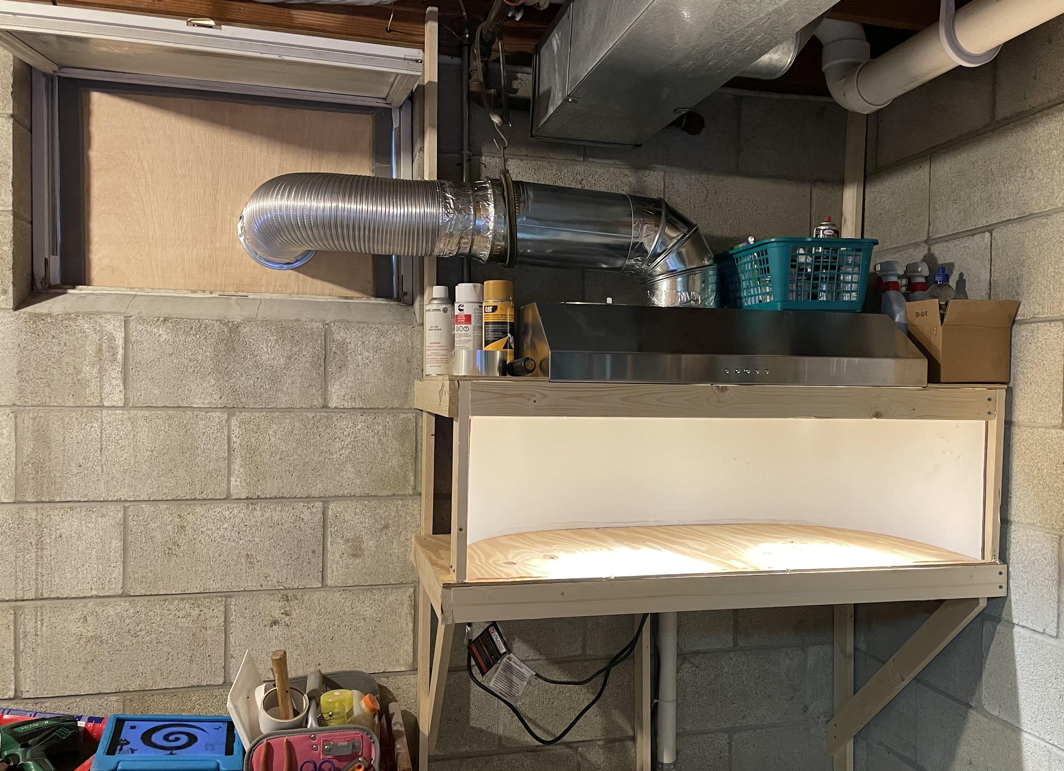

vincen47 Posted February 12, 2024 Posted February 12, 2024 (edited) Yep, just like 63SS350 said above, I use a thin plywood sheet that pops into the window frame. I put the bottom side in first, and it friction fits in place. There’s flexible foam on the outside edges that create a seal. I don’t worry about taking the screen out (paint particles don’t seem to be an issue gumming up the screen). The other end friction fits onto the spray booth vent pipe. I set it up when I need to use the booth. Only takes a moment to pop into place. I built the booth using a scratch n dent sale kitchen stove exhaust hood unit. There are special replaceable filters (not cheap, but worth it) I get from Lowe’s. Yes, it’s a big booth, but I do truck and ship models, so I need them to fit. Edited February 12, 2024 by vincen47 2
atomicholiday Posted February 12, 2024 Author Posted February 12, 2024 50 minutes ago, vincen47 said: Yep, just like 63SS350 said above, I use a thin plywood sheet that pops into the window frame. I put the bottom side in first, and it friction fits in place. There’s flexible foam on the outside edges that create a seal. I don’t worry about taking the screen out (paint particles don’t seem to be an issue gumming up the screen). The other end friction fits onto the spray booth vent pipe. I set it up when I need to use the booth. Only takes a moment to pop into place. I built using a scratch n dent sale kitchen stove exhaust unit. There are special replaceable filters (not cheap, but worth it) I get from Lowe’s. Yes, it’s a big booth, but I do truck and ship models, so I need them to fit. This looks way simpler than I had envisioned. Thanks for posting pictures. Now I have a pretty clear idea of what I want to do. Nice booth you have there! That looks pretty cool. Lots of space. I just ordered a 22” double fan booth from Amazon. It’ll be big enough for most of my needs I think. 1
vincen47 Posted February 12, 2024 Posted February 12, 2024 (edited) The hood’s built-in lights are a plus, and there’s three settings for the fan speed. On high, it exhausts everything out while I’m spraying, then I turn it to low for a bit while the parts are drying. No fumes in the rest of the basement or house. Before this, even if I sprayed for two seconds, I’d hear a voice yell down from above (not heaven, but from the one upstairs that must be obeyed) telling me to stop stinking up the house! Edited February 12, 2024 by vincen47 5
