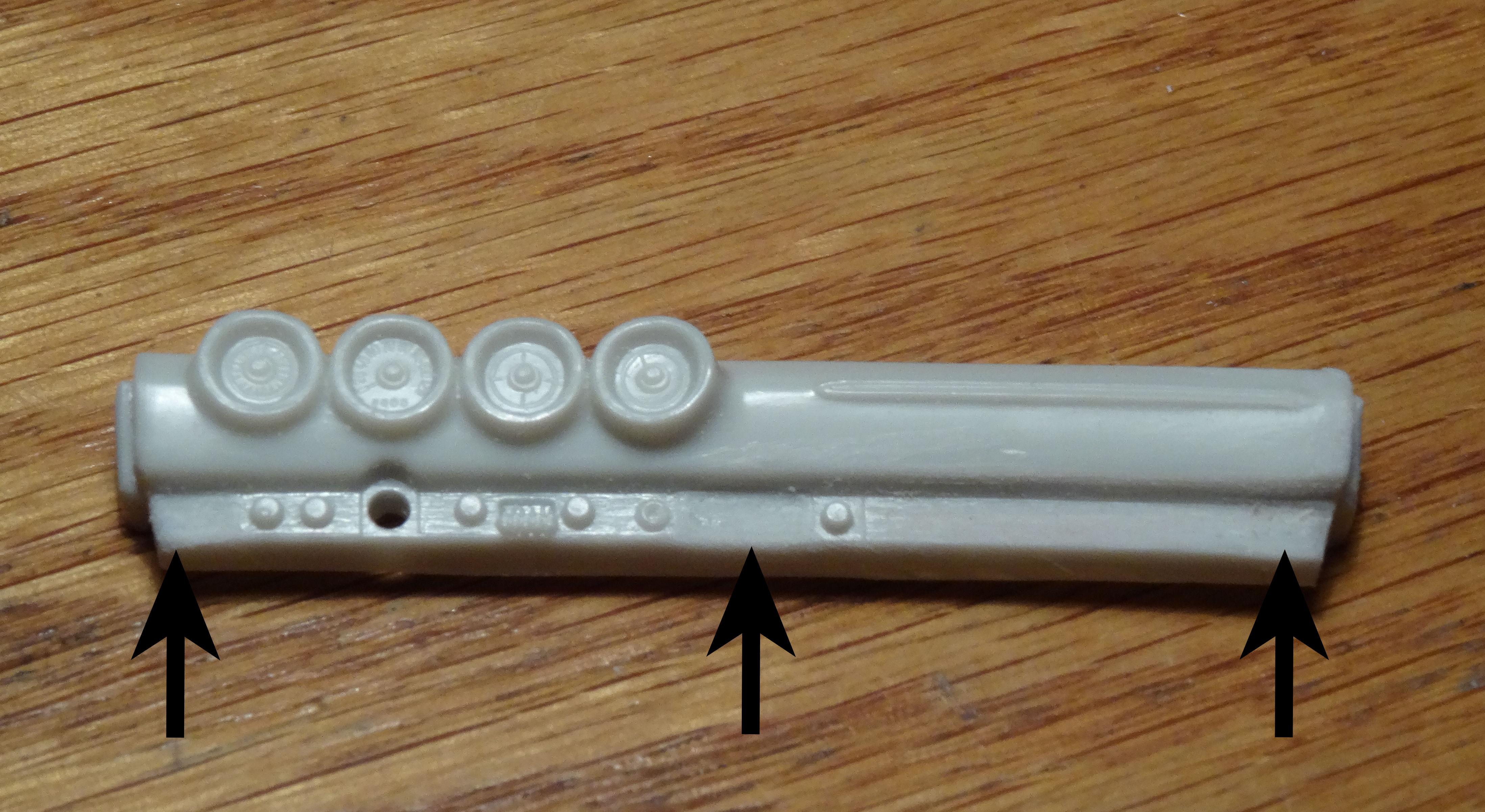

Moving around to the tail end of business. The 68 and 69 Fairlane/Torino are the same in the rear aside for some trim changes. On the left is AMT's 68 Torino and on the right is the 69 Cobra.DSC00074s.jpg.910c2ce612d44de07b14e3bb53bc945d.jpg
The tail panel is concave not flat, but the Cobra is flat and AMT moved the lower section over to the rear bumper.
Have to fix both these issues. First by breaking down the rear bumper and then by creating a new tail panel from some .060 flat stock.

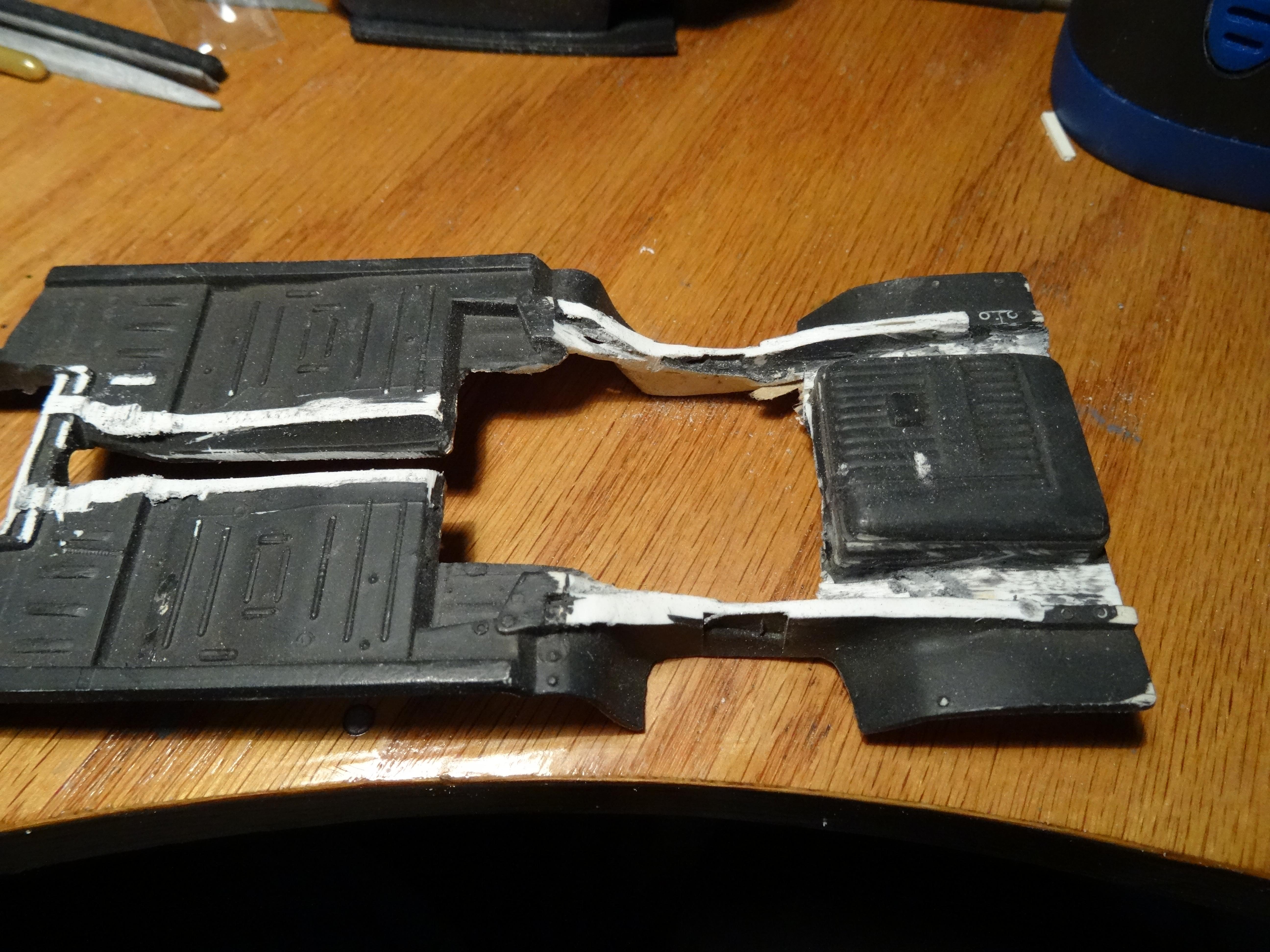

I know you all think I'm crazy for not just using the chassis from the AMT 1966 Fairlane or Revell 1970 Torino but what's the fun in that. The point of this rescue is to use just the parts from my junk box. So now it's time to rescue the chassis I started cutting up some 40 or so years ago.

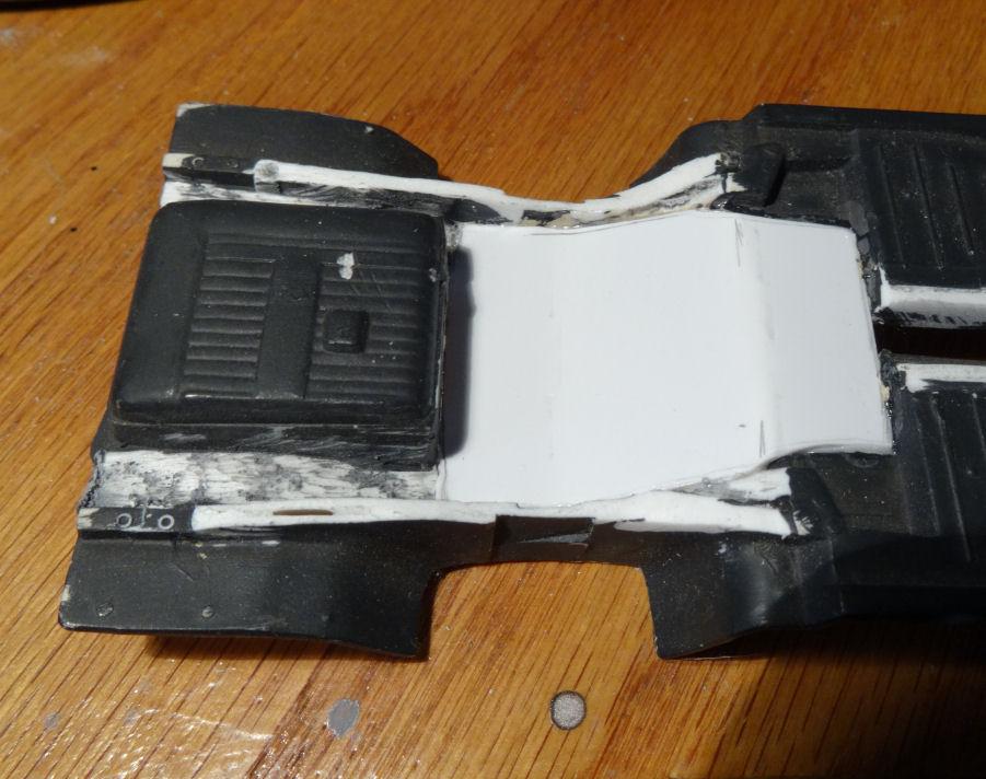

Not sure what I used to fill he area once occupied by the mufflers but it looks like cardboard covered with Bondo. Well, that has to go.
And replace it with some sheet styrene.
The old "Promo" slots for metal axles need to be filled.
A little more cleaning and...we are getting closer.
One reason for jumping on to the chassis at this point is the very rear of the chassis has two tabs which originally slotted into the body. Needed to see how the chassis now fits with the rear body mods.
Tabs have to go and a ridge for the chassis to rest on was secured inside the rear of the body.
This chassis is not without it's flaws from the AMT factory. The gas tank is the wrong shape, it should be wider from side to side and it had what appears to be a partial retaining strap molded in. Also, for some reason they have the front of the springs mounted inside the frame rails. They belong outside the rails. And that's just for starters. I'm not going to go nuts on trying to make this correct, just happy at this point to finally make this chassis usable after all these years.

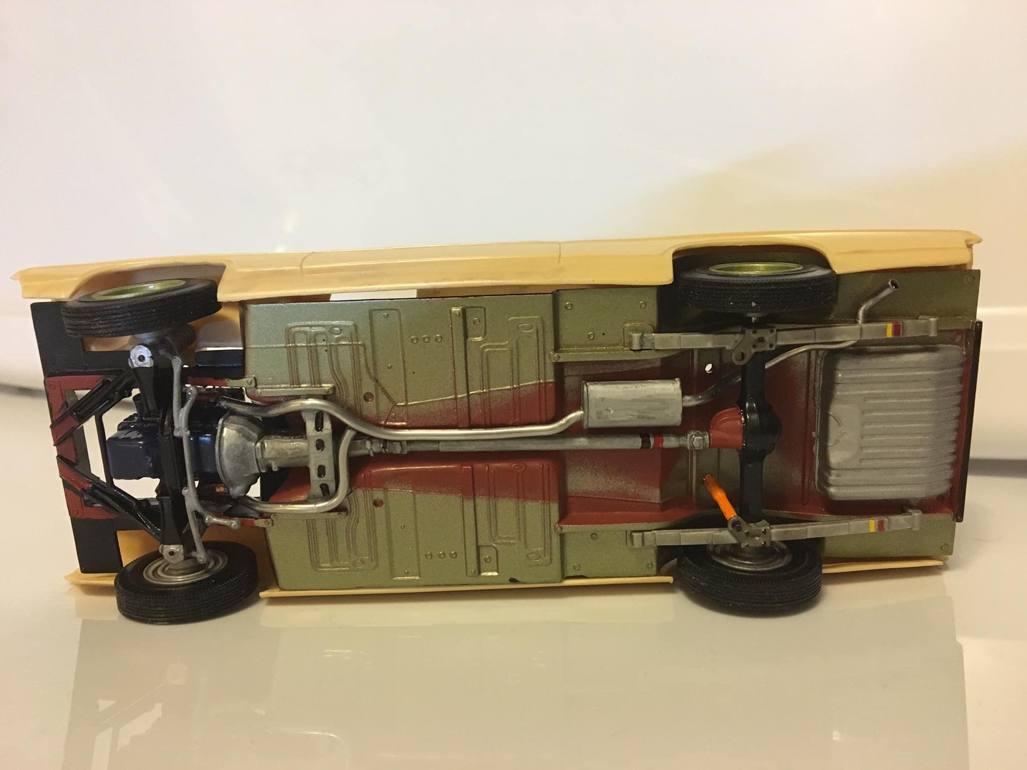

So I waited over two weeks for some "U" channel plastruct to arrive so I could start fabbing the chassis front suspension. When the bits finally arrived I didn't like the way the parts worked and scrapped that idea. Instead I went to the parts junkyard and pieced together some parts and came up with this.DSC00241.JPG.053610629890a57b53bea6831a32779c.JPGDSC00242.JPG.dbebaf36a7579c44acadcb2023cbc6fe.JPG
Other then the yellow sway bar which is from the AMT 68 Shelby Kit I have no idea what the parts came from. I need to extend the exhaust, add tie rod end links and I still need a center link for the front end. Unless I want to go crazy and add power steering.

As far as the Galaxie, don't think the parts are from that, have one sitting right here as my next project. Other then the sway bar and the black section of the cross member the rest is from scratch as far as the front end goes.

The chassis has a great factory undercoat texture. How did you achieve that?
Mike, I would call that dumb luck. Had a can of Rust-Oleum Rusty Metal Primer sitting in the garage. Just used that. It goes on a bit thick which is why I used it to help hide some of the surgery below the mufflers.
