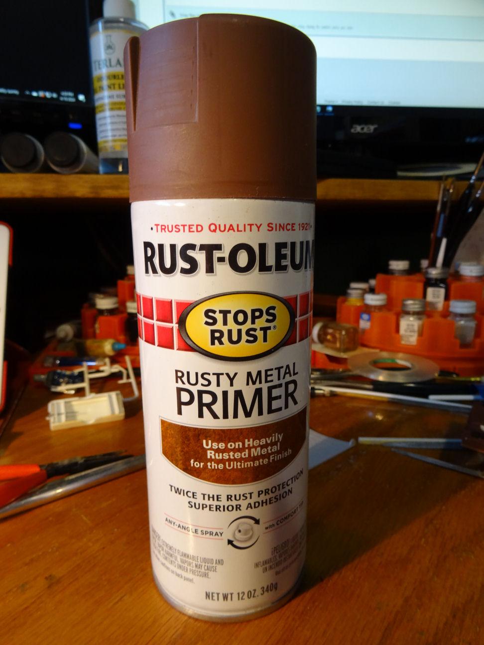

1 hour ago, LennyB said:
Mike, I would call that dumb luck. Had a can of Rust-Oleum Rusty Metal Primer sitting in the garage. Just used that. It goes on a bit thick which is why I used it to help hide some of the surgery below the mufflers.
Ah thanks! Well I would say it was a happy accident then.
