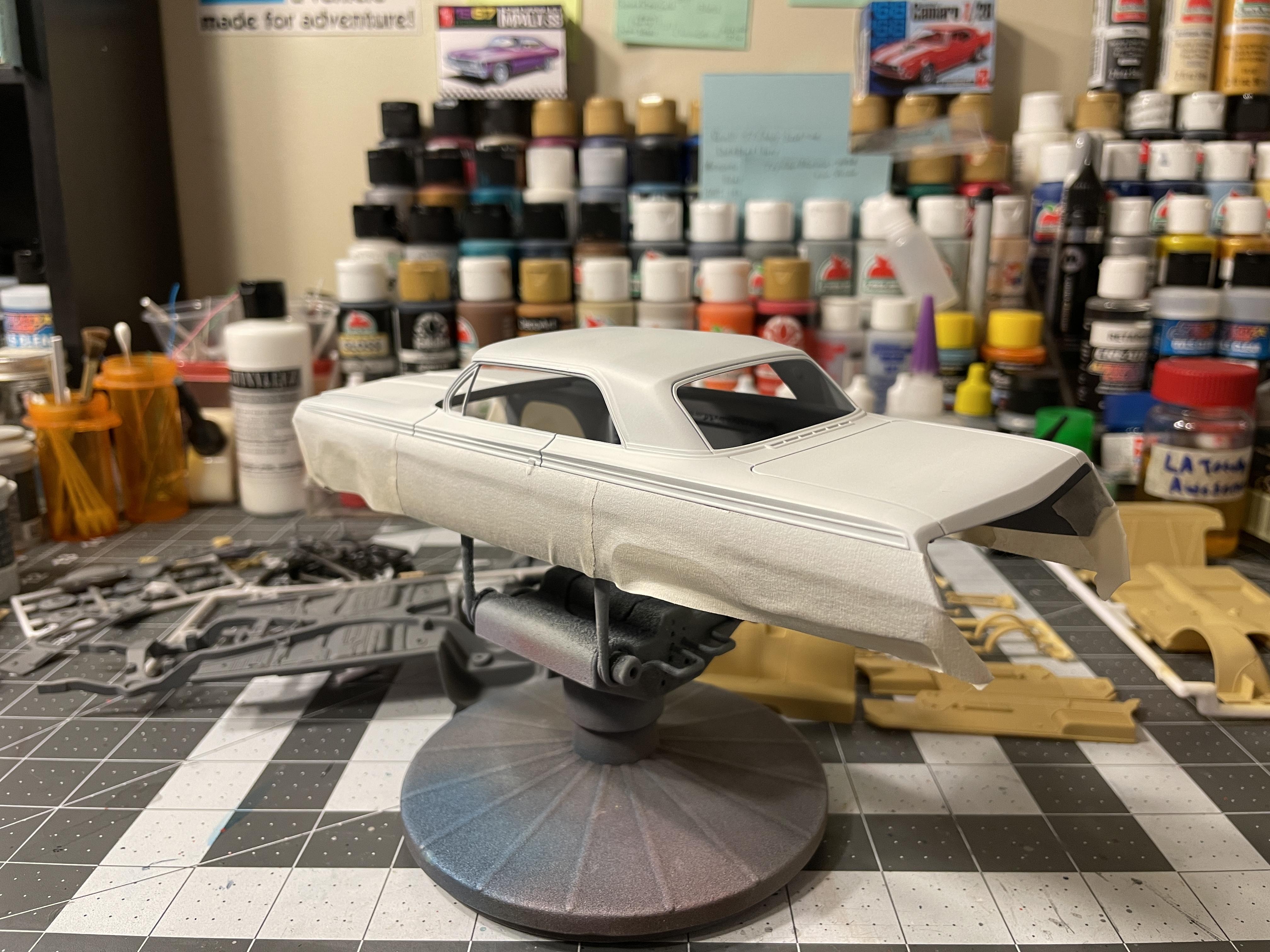

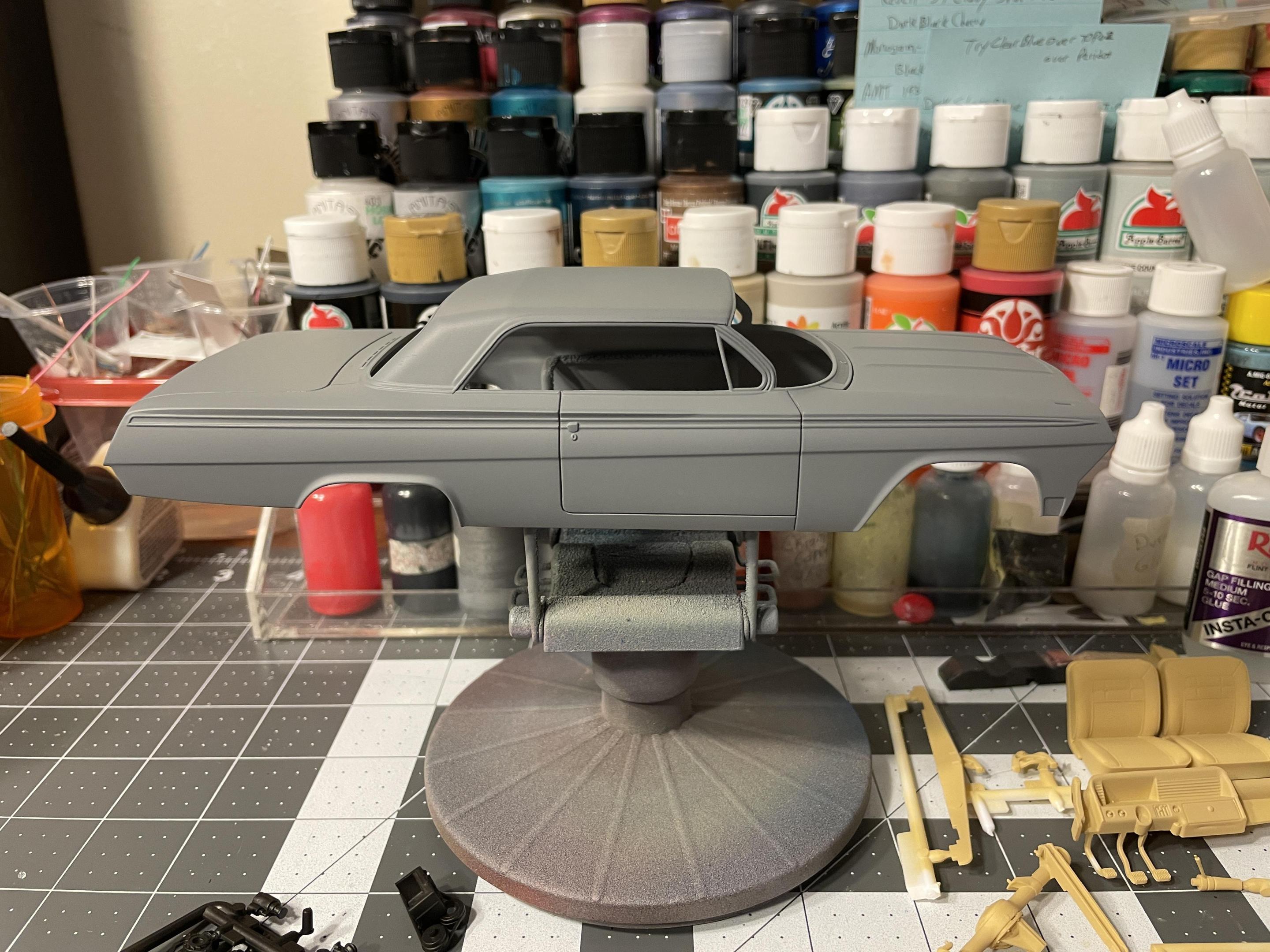

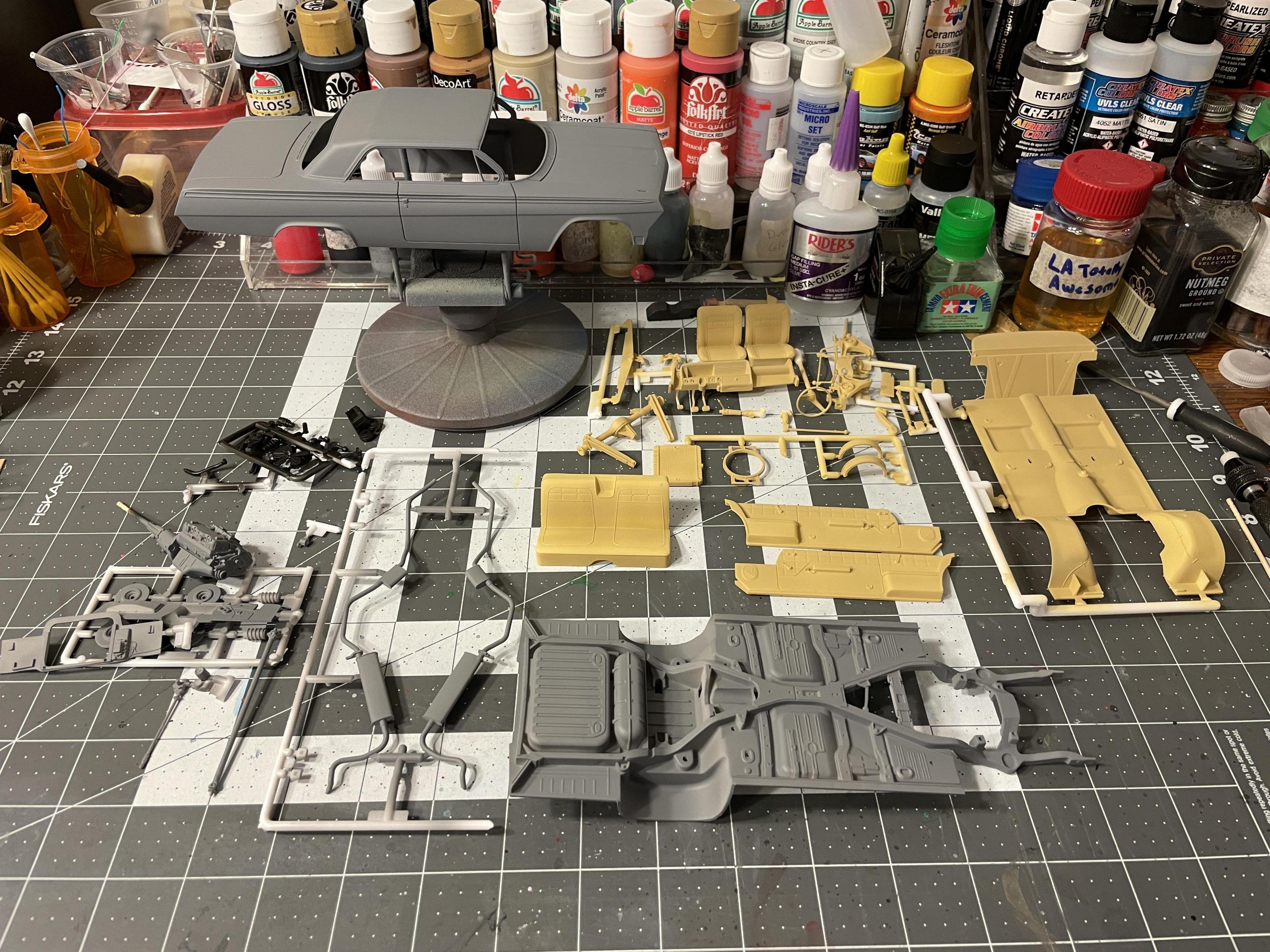

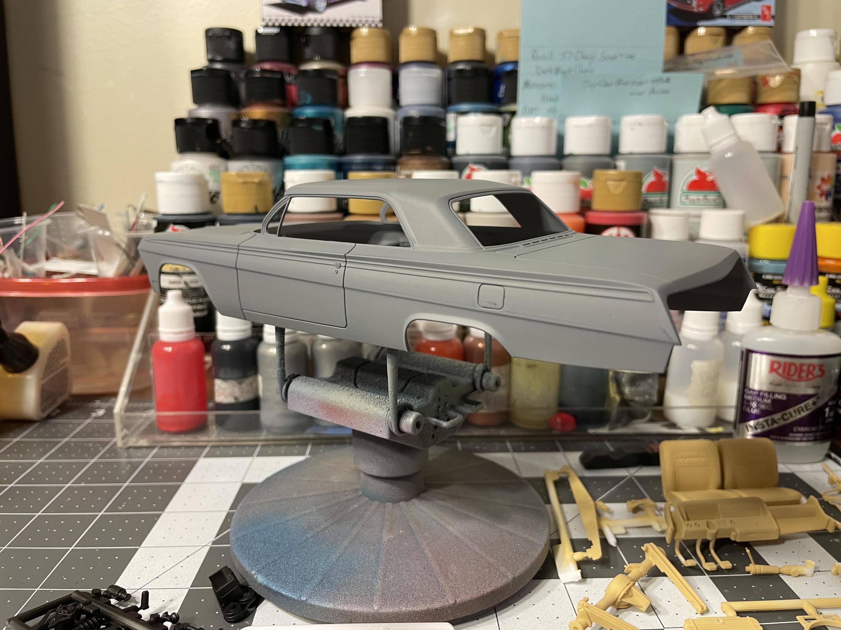

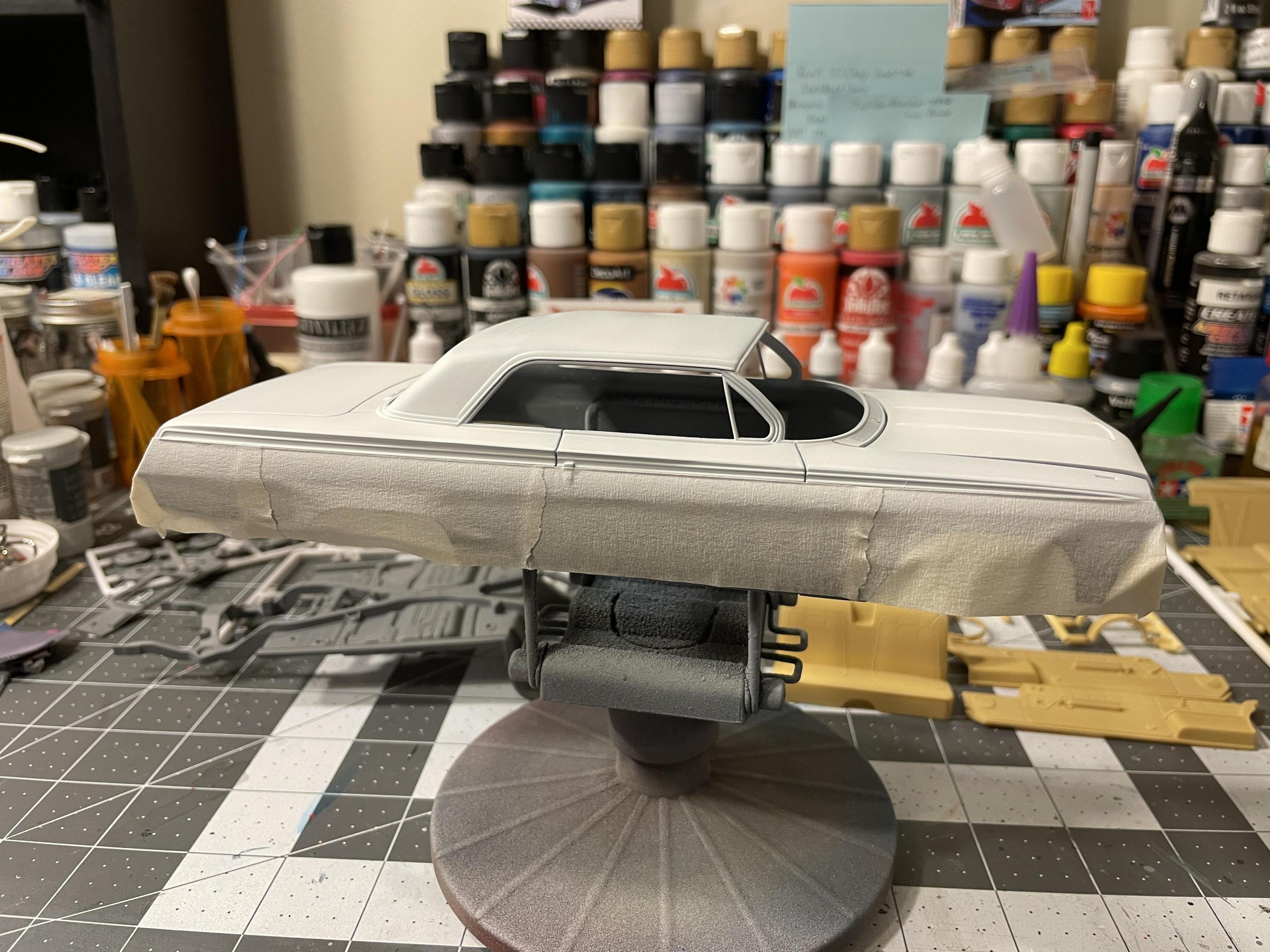

Dragonhawk1066 Posted March 21, 2024 Author Posted March 21, 2024 (edited) OK, so I'll try not to show any more videos, just pics from here on out. After the parts dried overnight, I started with the sub-assemblies like the seats/seatbacks, and the engine parts that will be the same color. After that, I removed some parts from the sprue trees to prime individually along with those left on the sprues. I then sprayed on some Stynylrez Primer. I used Black, Neutral, Gray, and White. I sprayed the body with gray to spot any imperfections or areas that might need more sanding. I then dry-sanded the body and hood with 1000 grit to smooth it out. After that, I taped off the lower portion and sprayed white primer over the upper portion. Edited March 25, 2024 by Dragonhawk1066 2

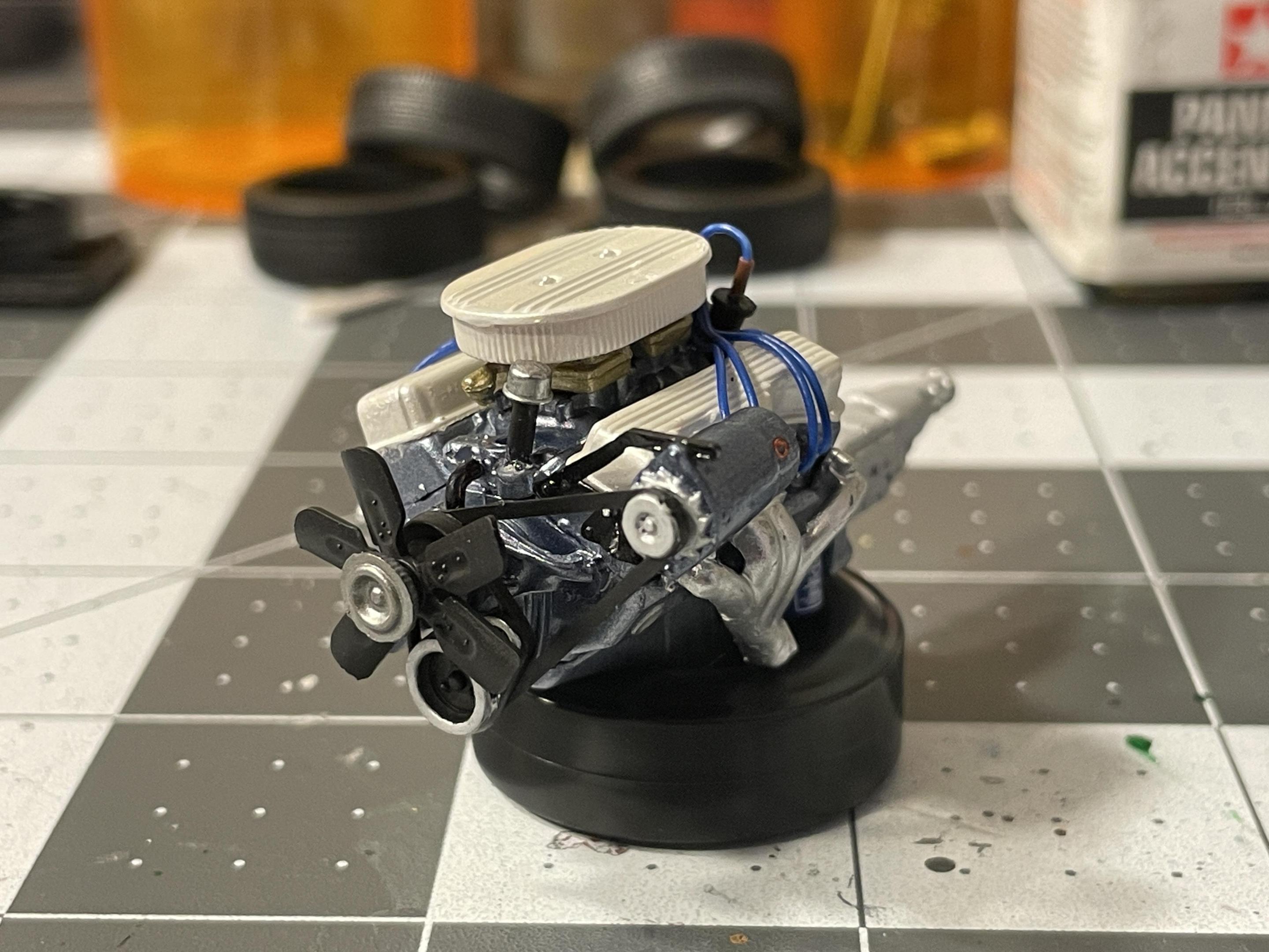

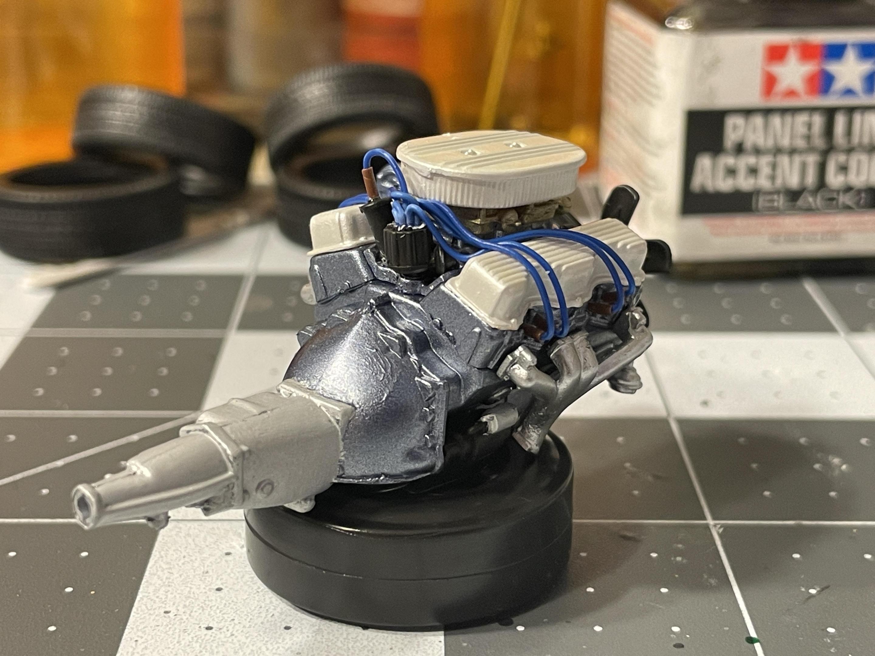

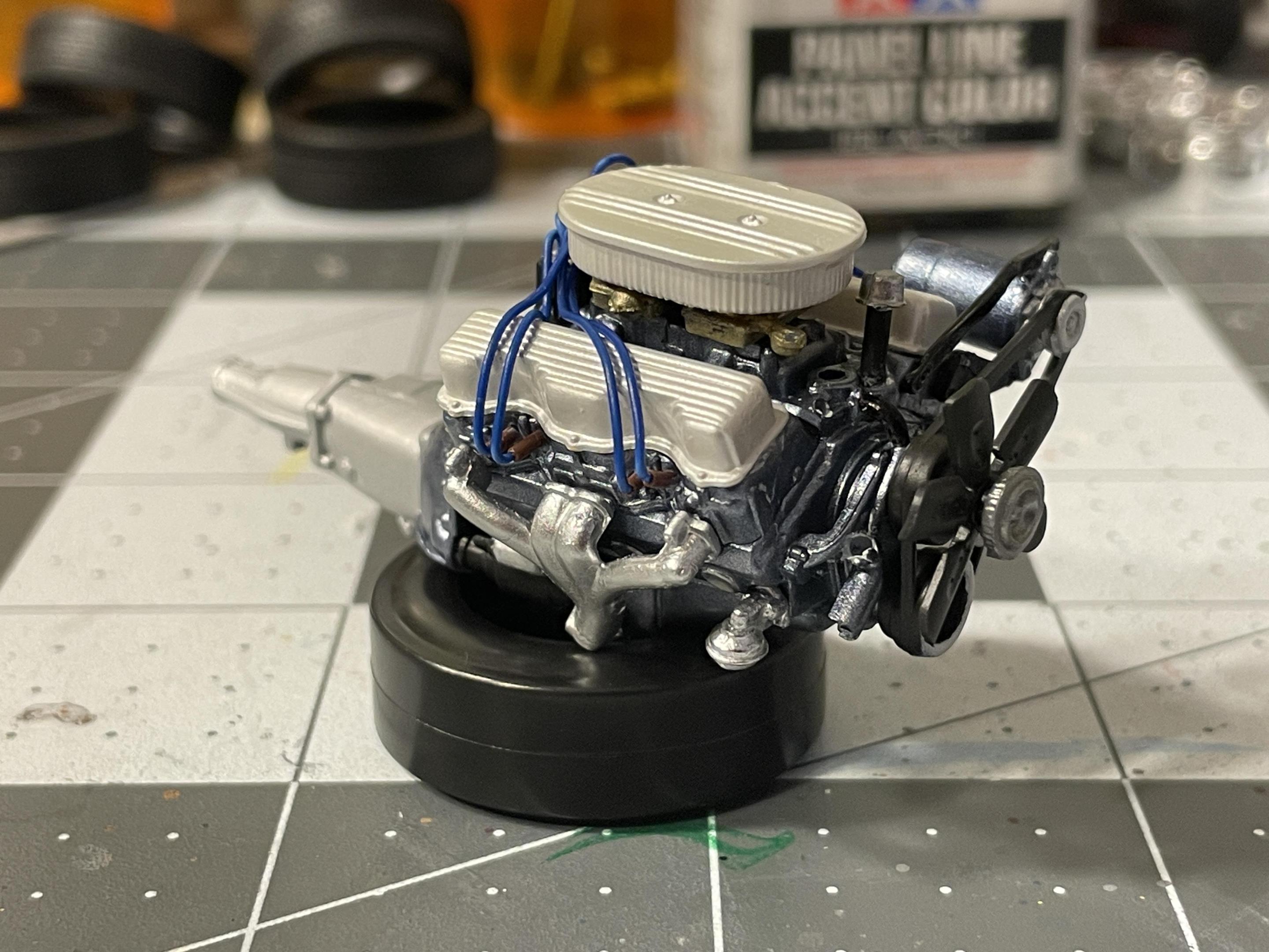

Dragonhawk1066 Posted March 25, 2024 Author Posted March 25, 2024 I worked on the engine today and got that finished. I added spark plug wires, and drilled holes for heater hoses. 1

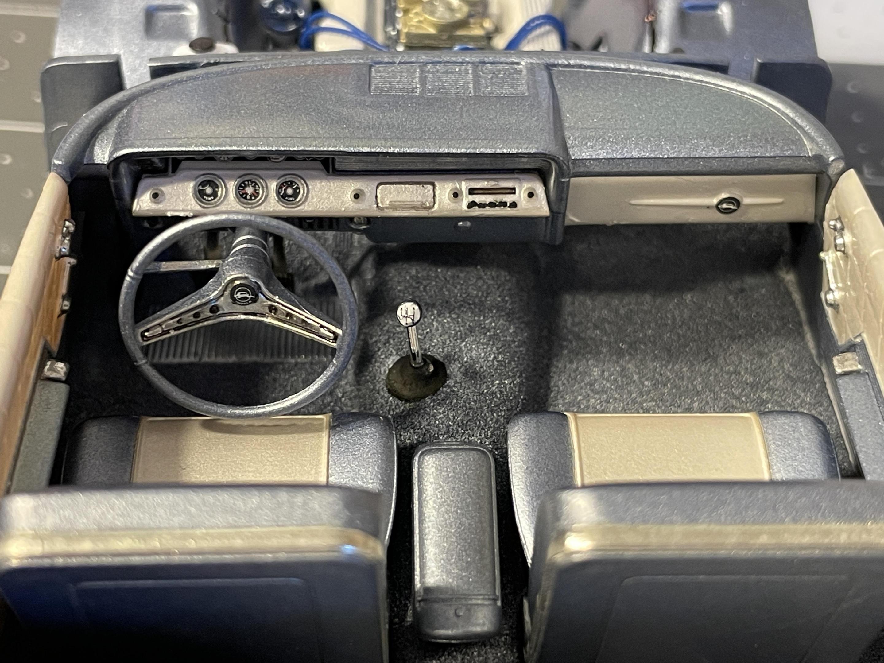

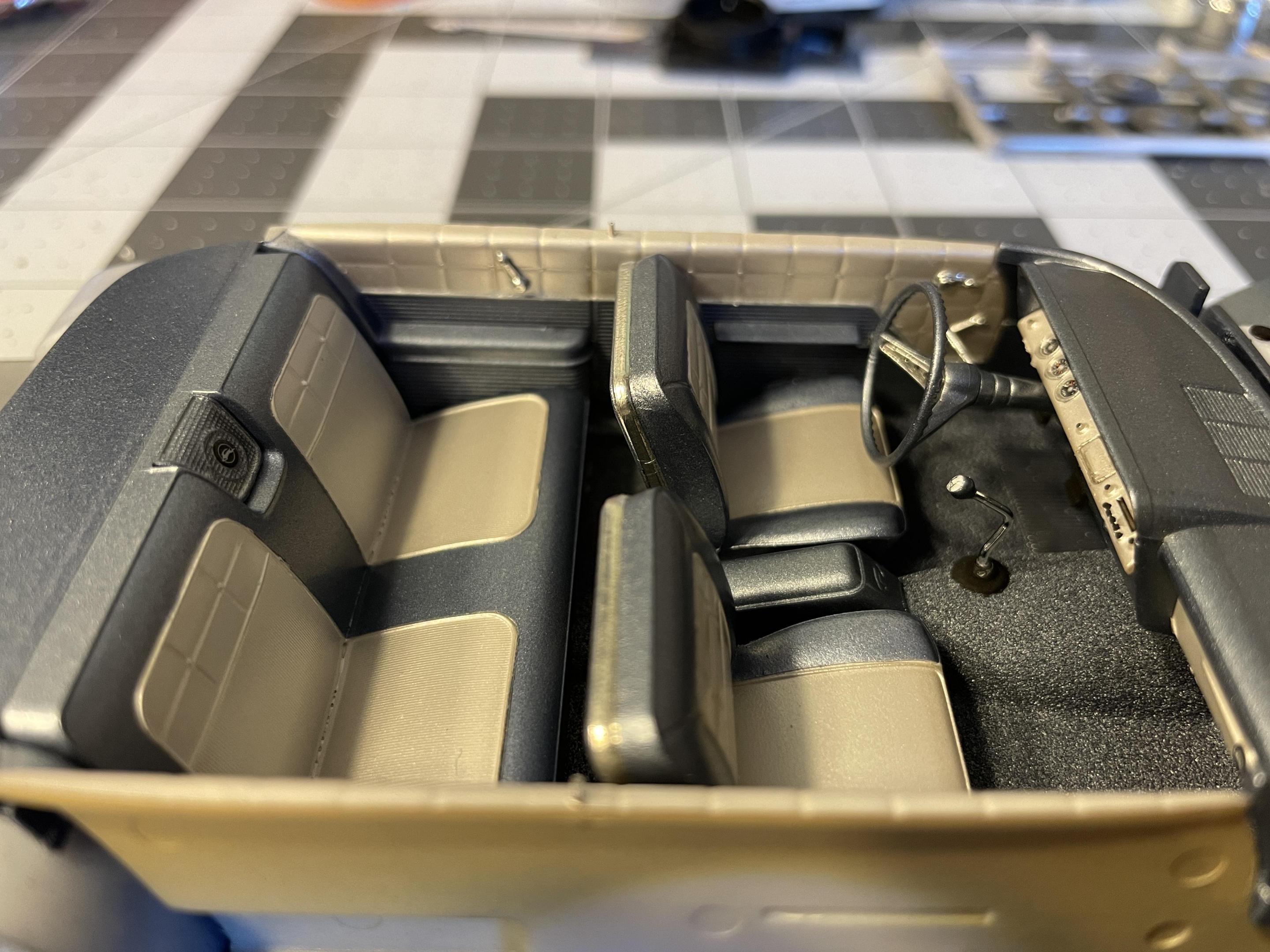

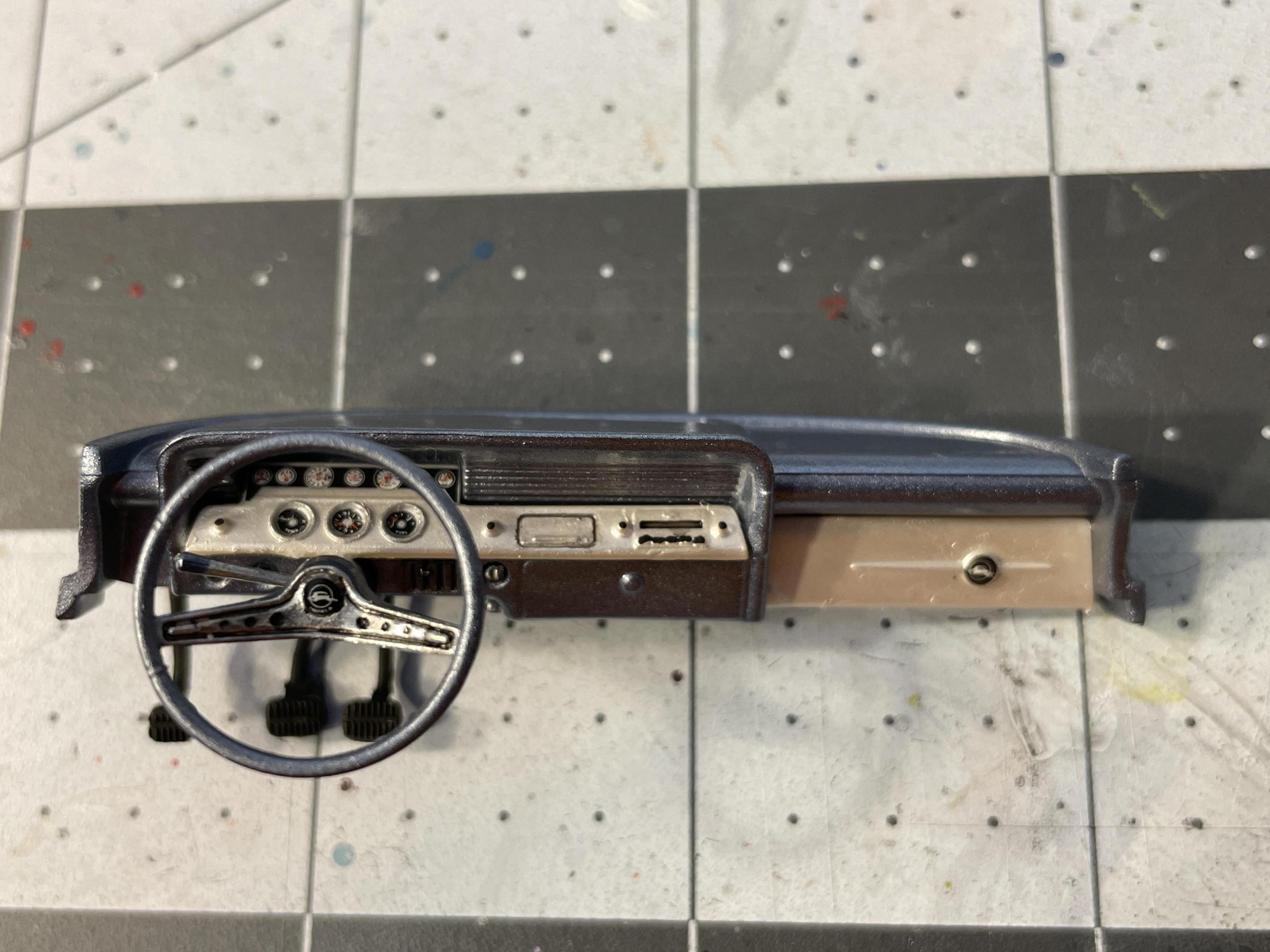

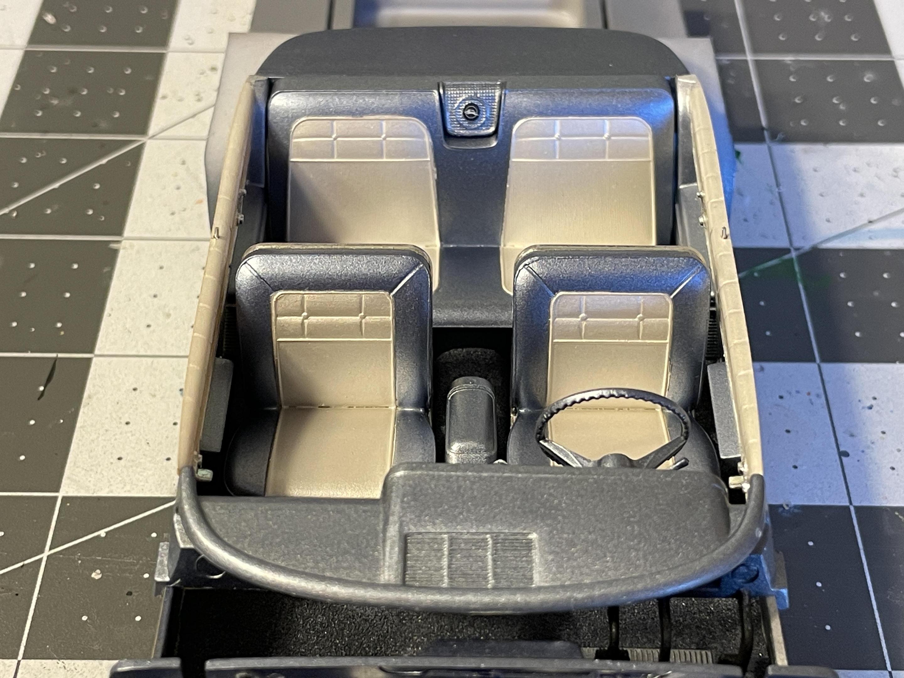

Dragonhawk1066 Posted March 29, 2024 Author Posted March 29, 2024 I finished up the interior yesterday. I used embossing powder for the carpet and brush painted Molotow Chrome on the door handles and window cranks. I used Bare Metal Foil for the seat trim. 3
