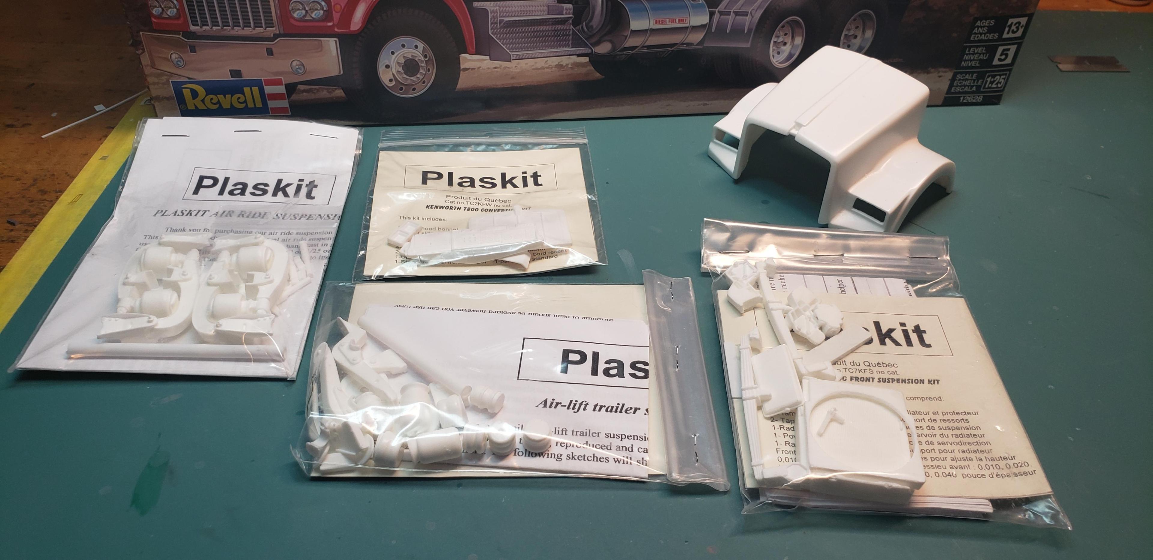

I'm building an Anteater T800, using all the updates I could source from plaskit, st supply and others. I'm planning a regular trailer, but adding a lift axle.
Here's the pile so far, there will be more surprises along the way.

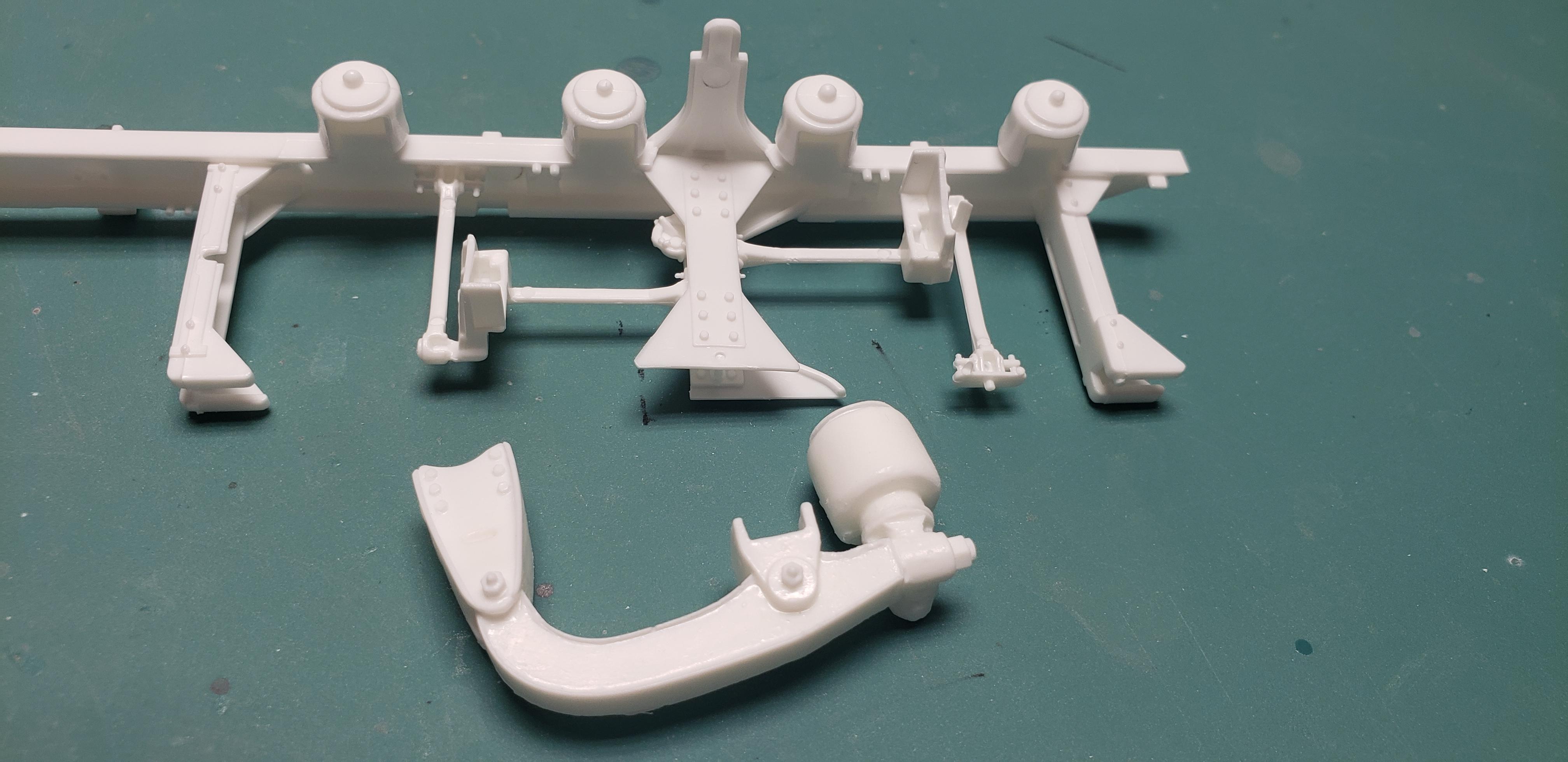

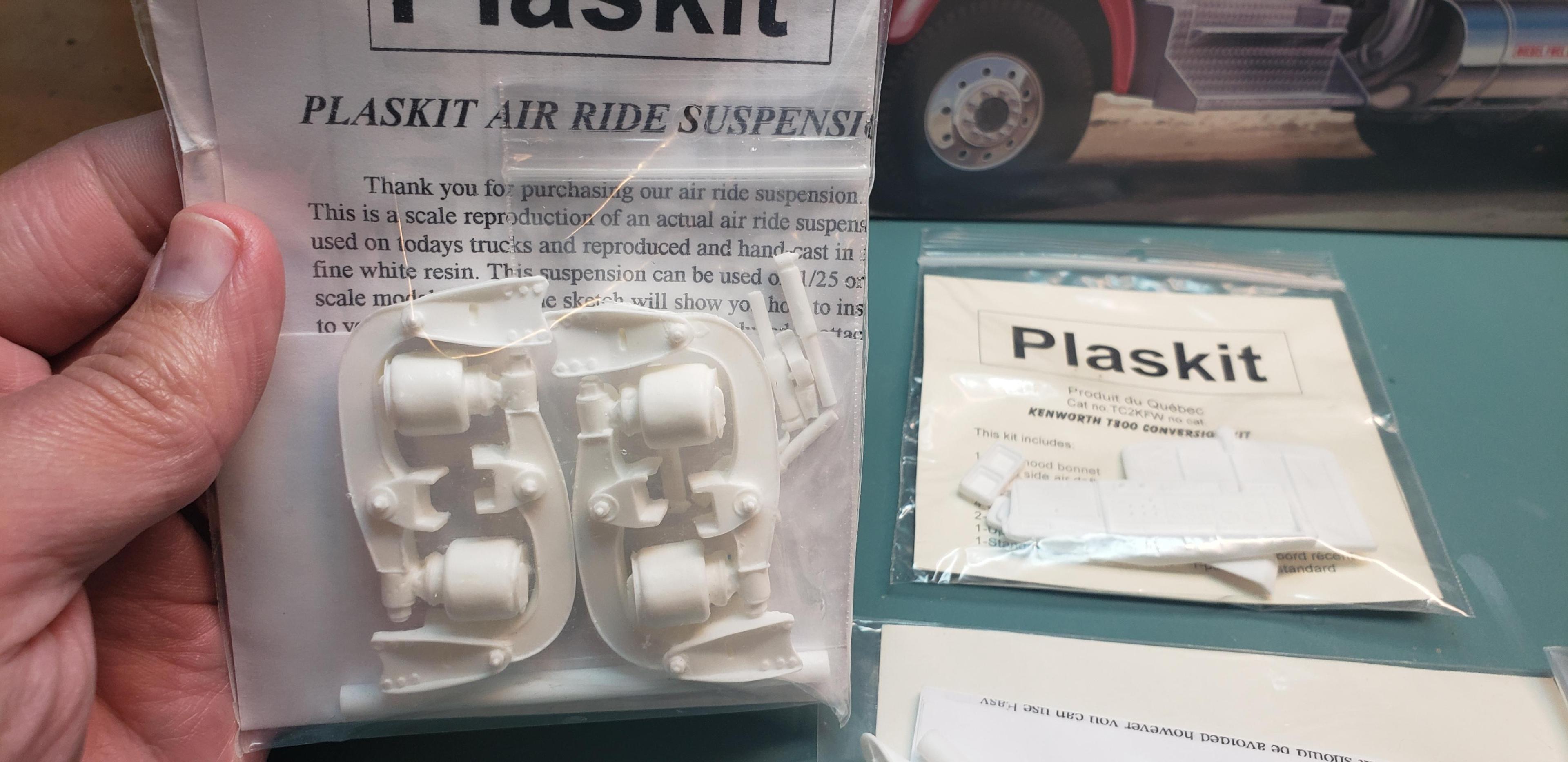

Small update for the wknd, I assembled the kit frame and installed the T800 conversion frame brackets. I planned to replace the kit 8 bag rear susp w an air ride, but the parts looked very large next to the frame.

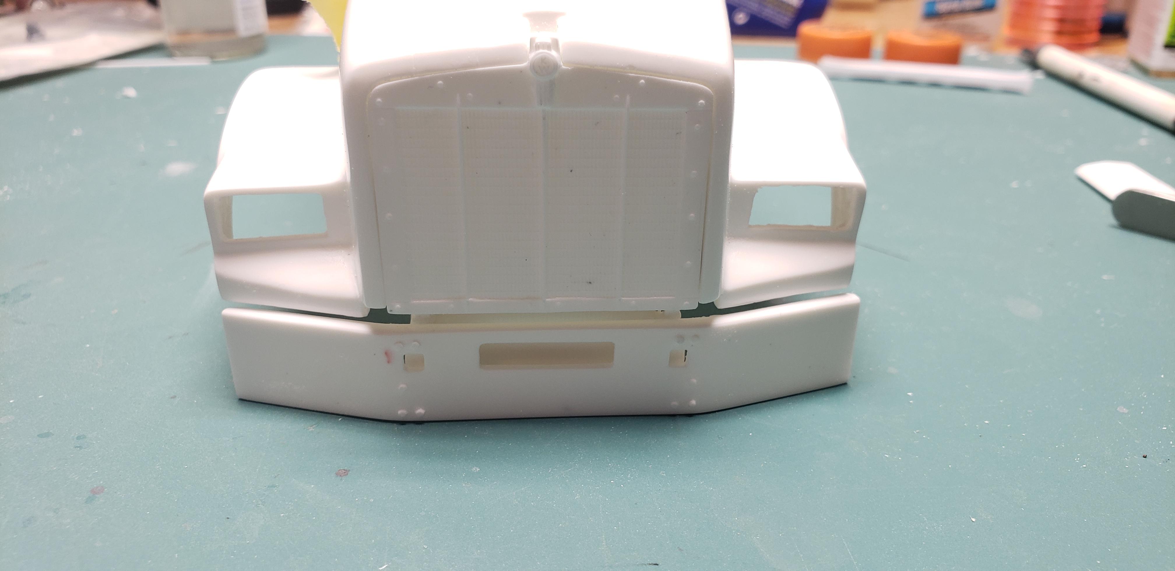

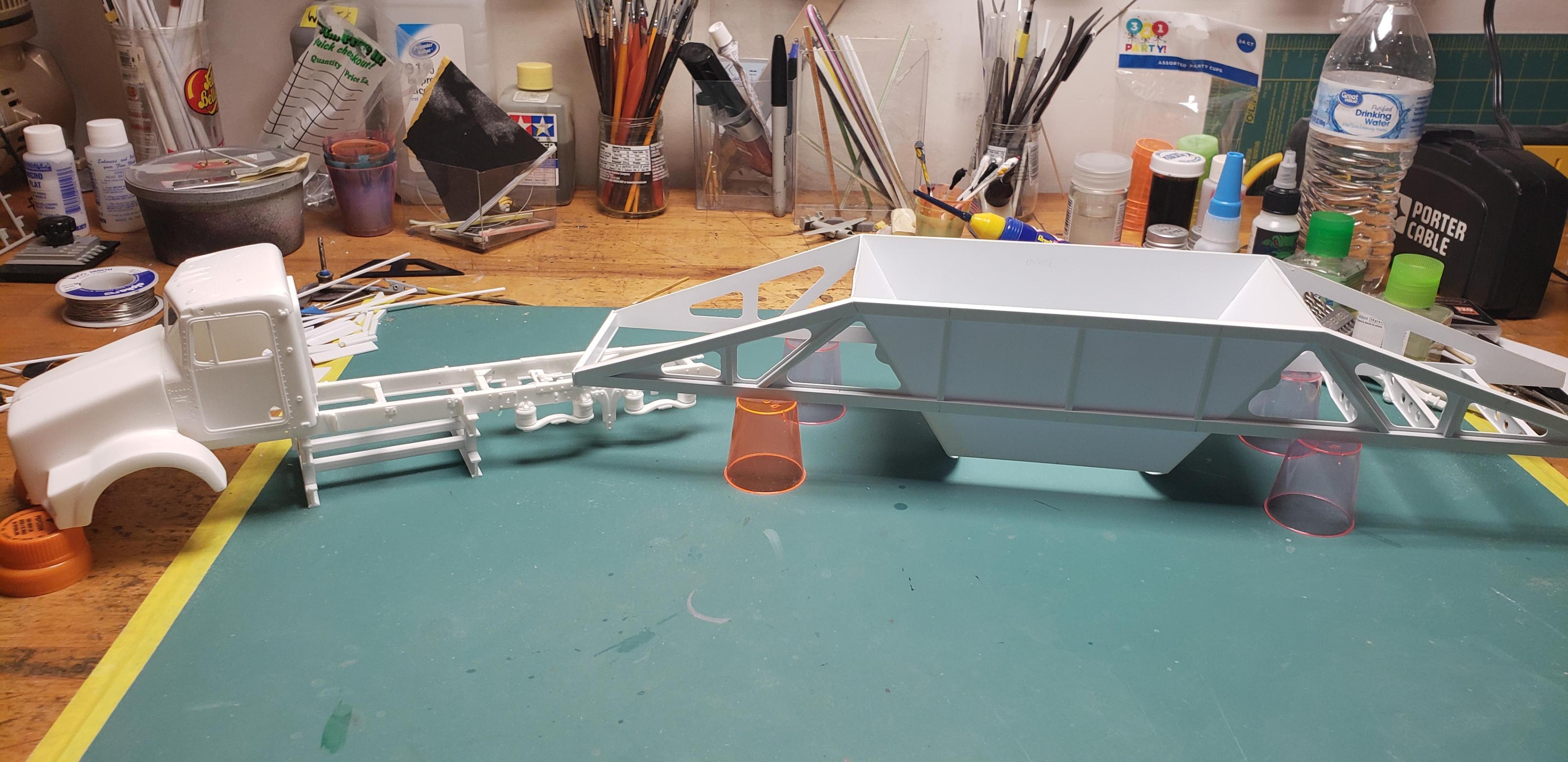

I started  clearing space inside the resin hood to fit around the kit cowl. Theres more work to go, but its taking shape. I just set everything on the kit frame to check fit.

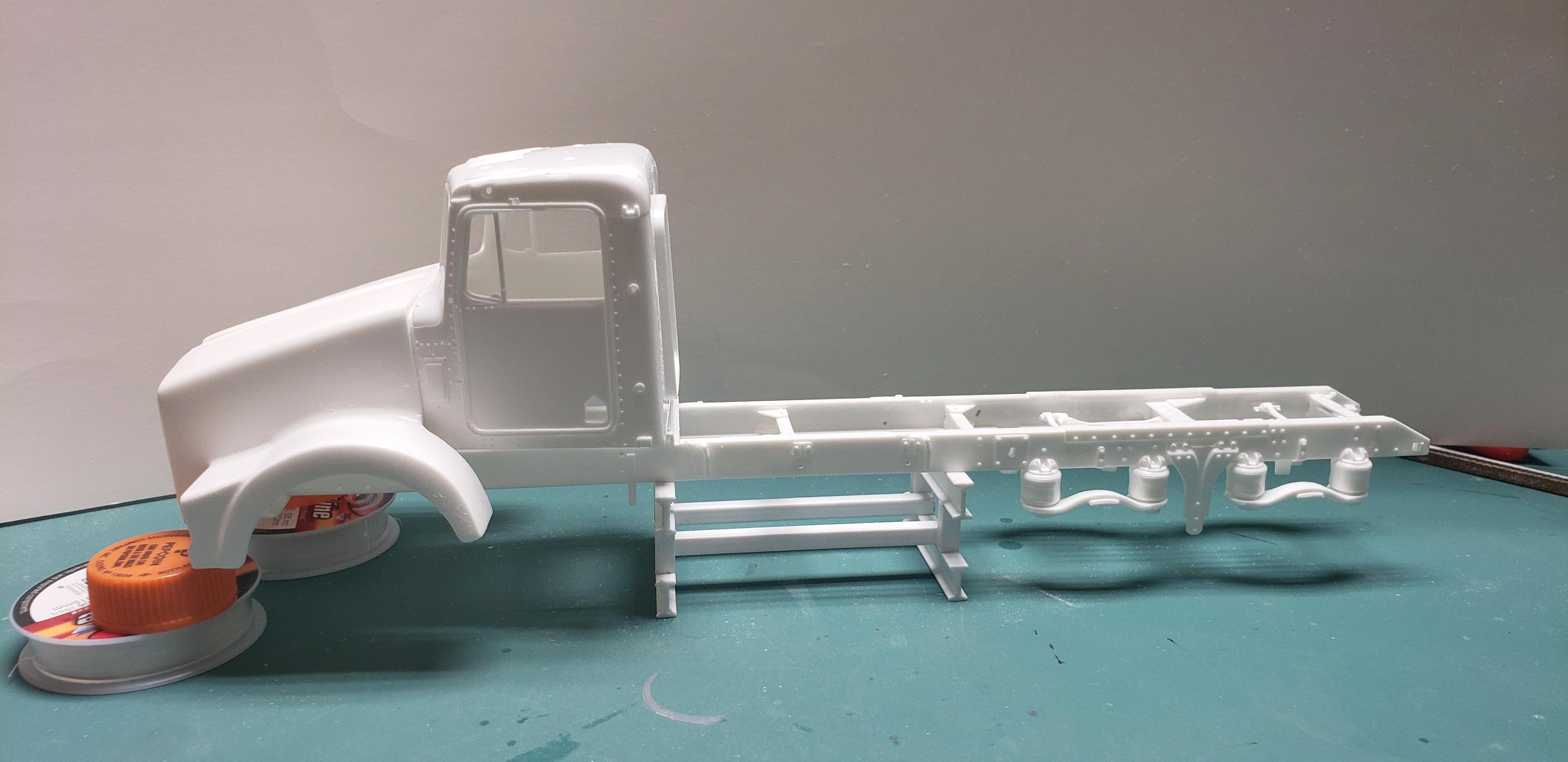

The entire project mock up...20240504_173419.thumb.jpg.2db3726a555dbc7e7127051f25bb2a1c.jpg

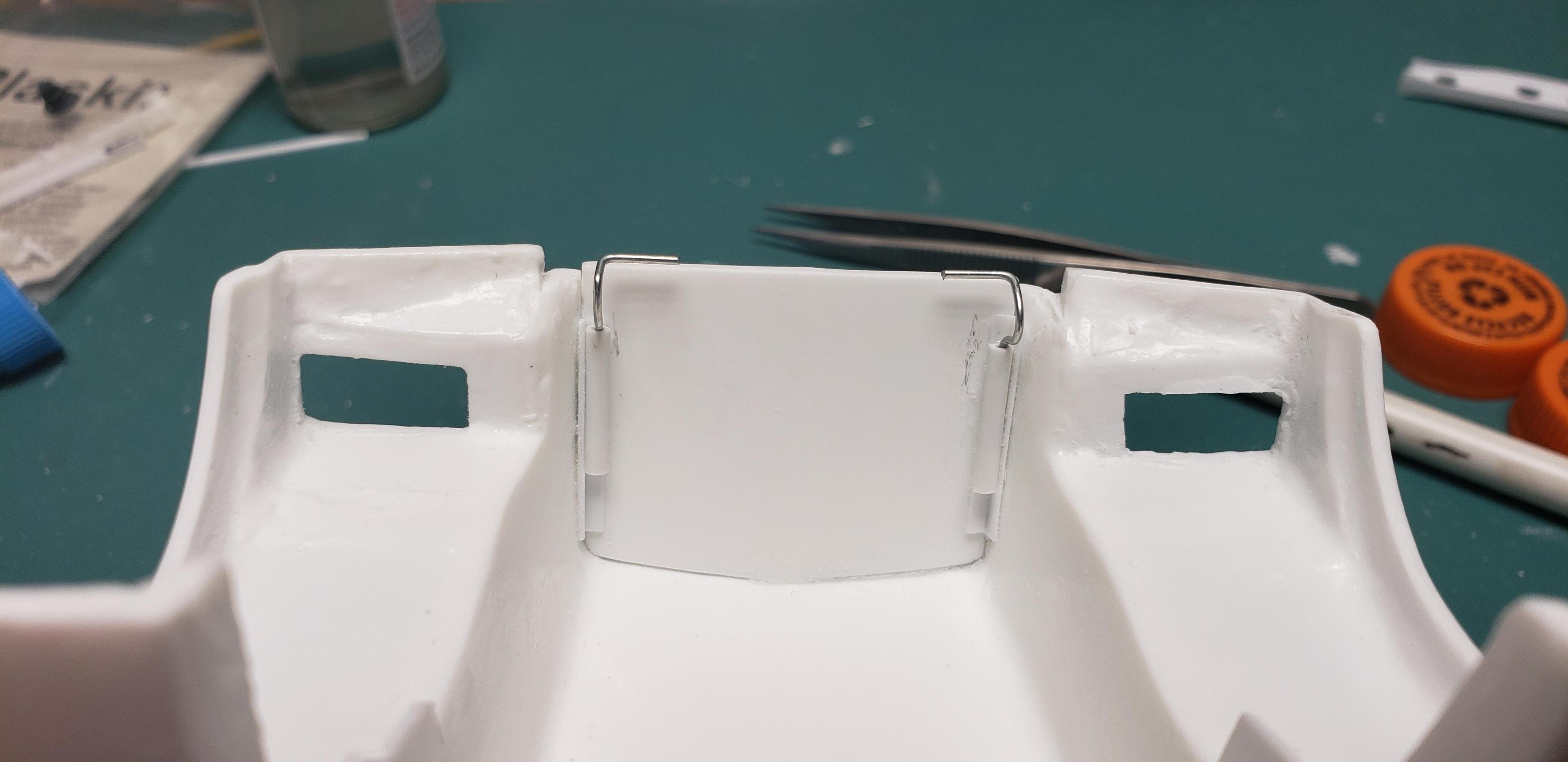

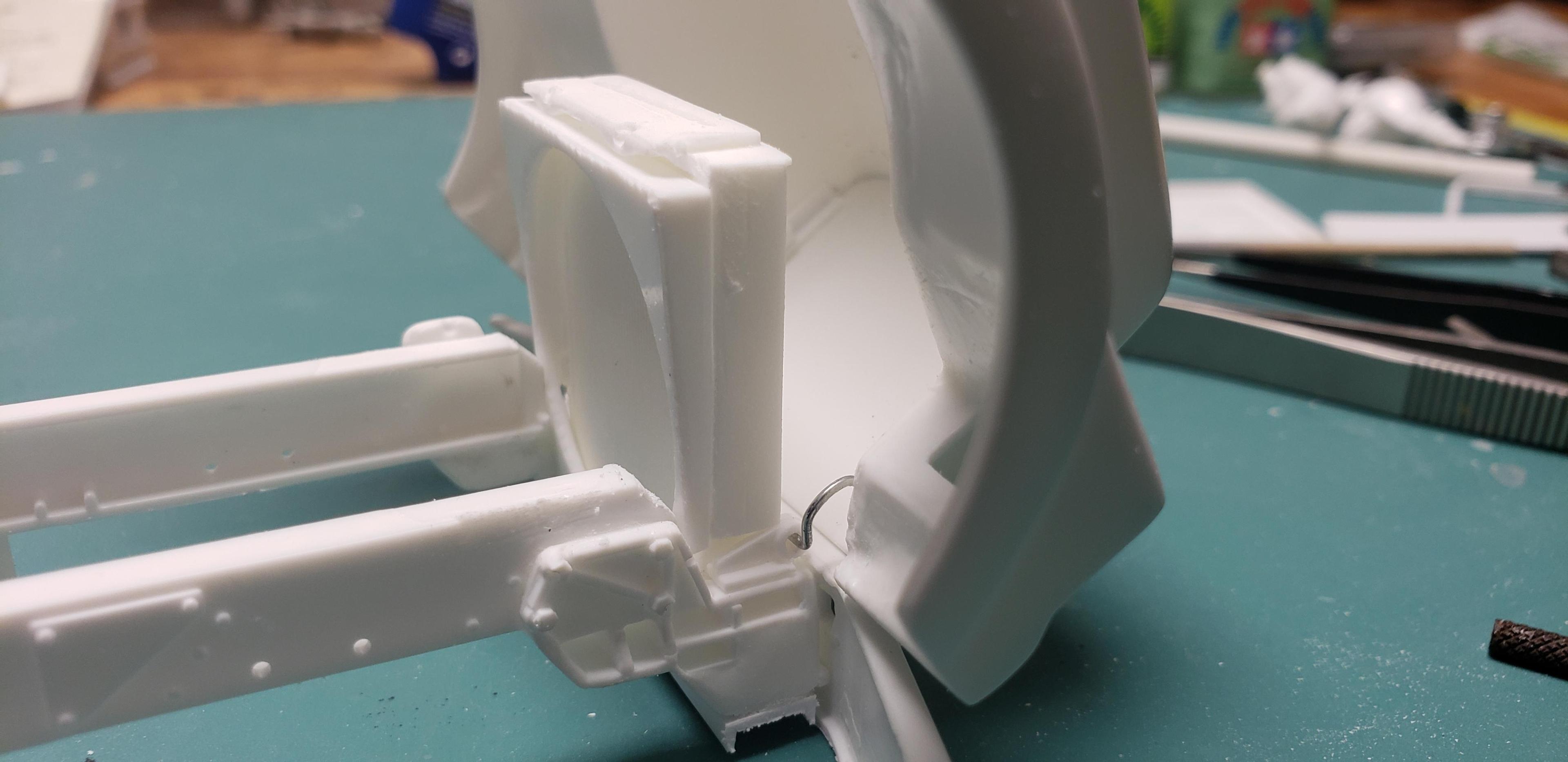

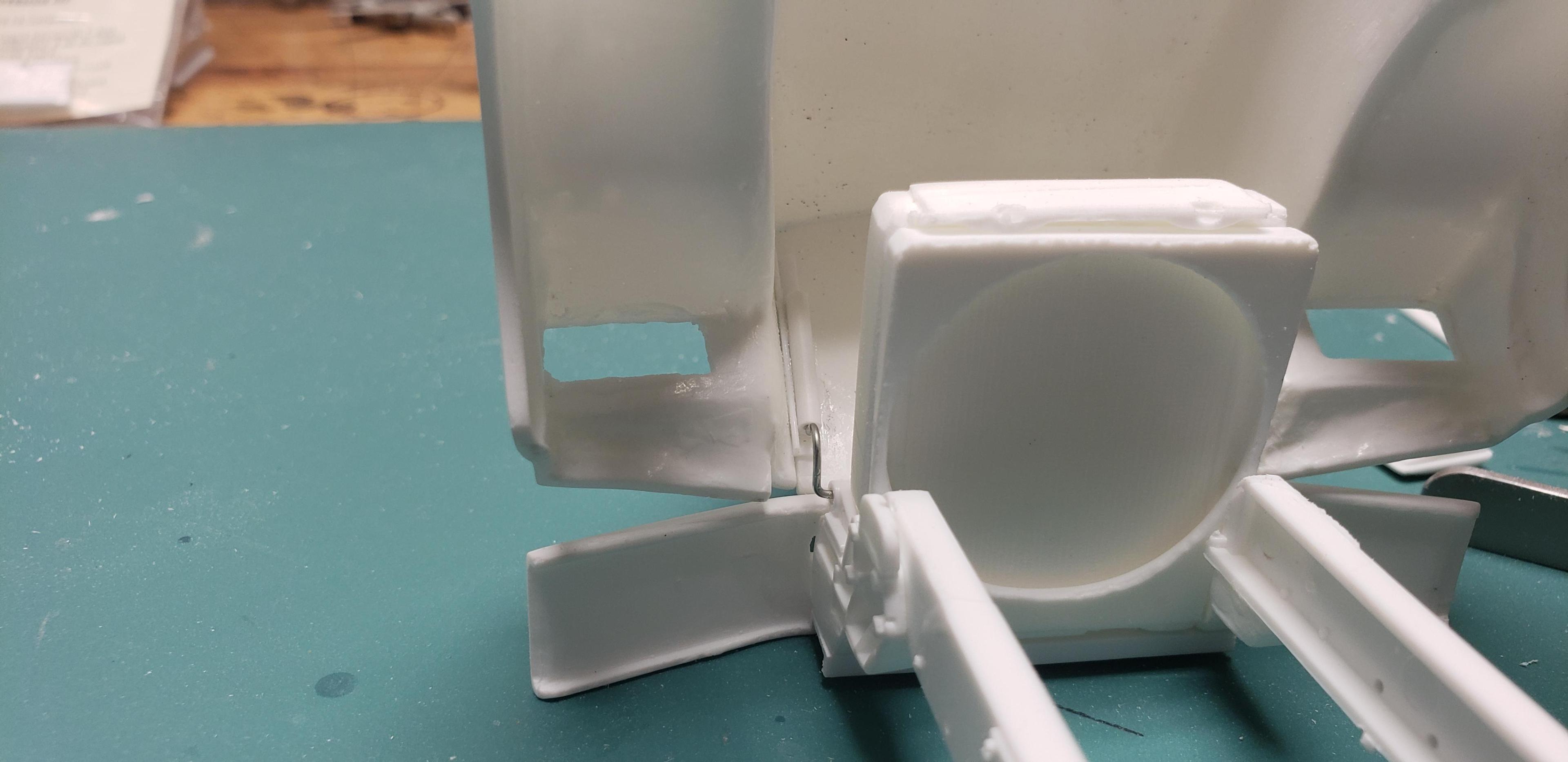

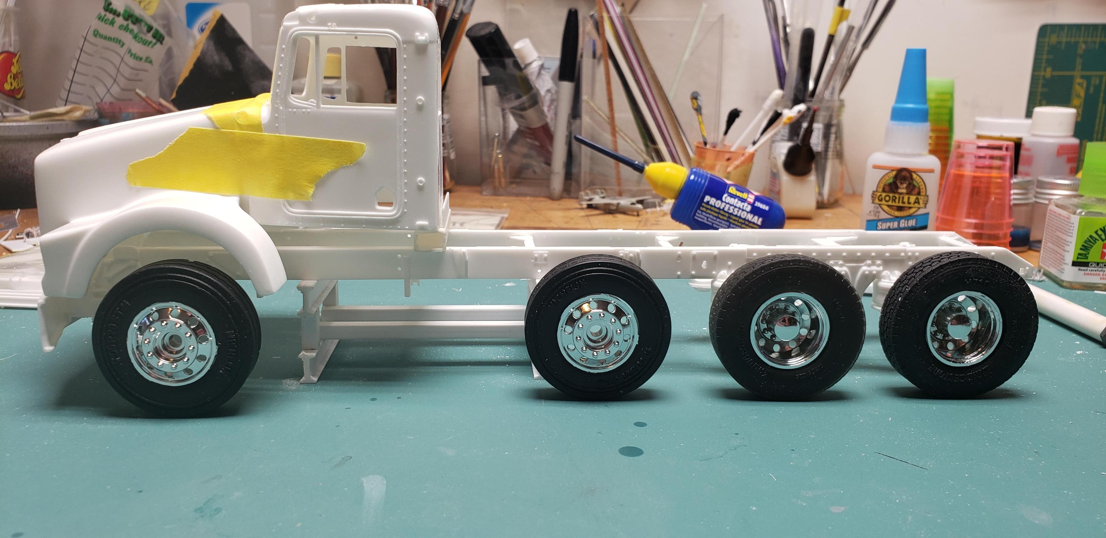

Decided to tackle the hood hinges tonite.I  never tried the tried n true paperclip method before, but understand why its so popular now. I previously glued the grill into the hood opening, braced w scrap angle for more glue surface.

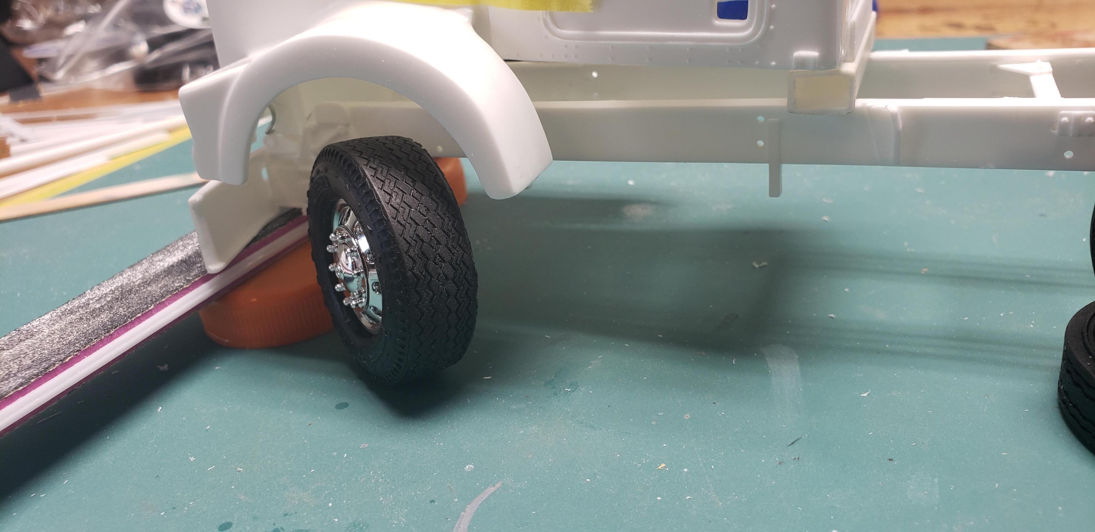

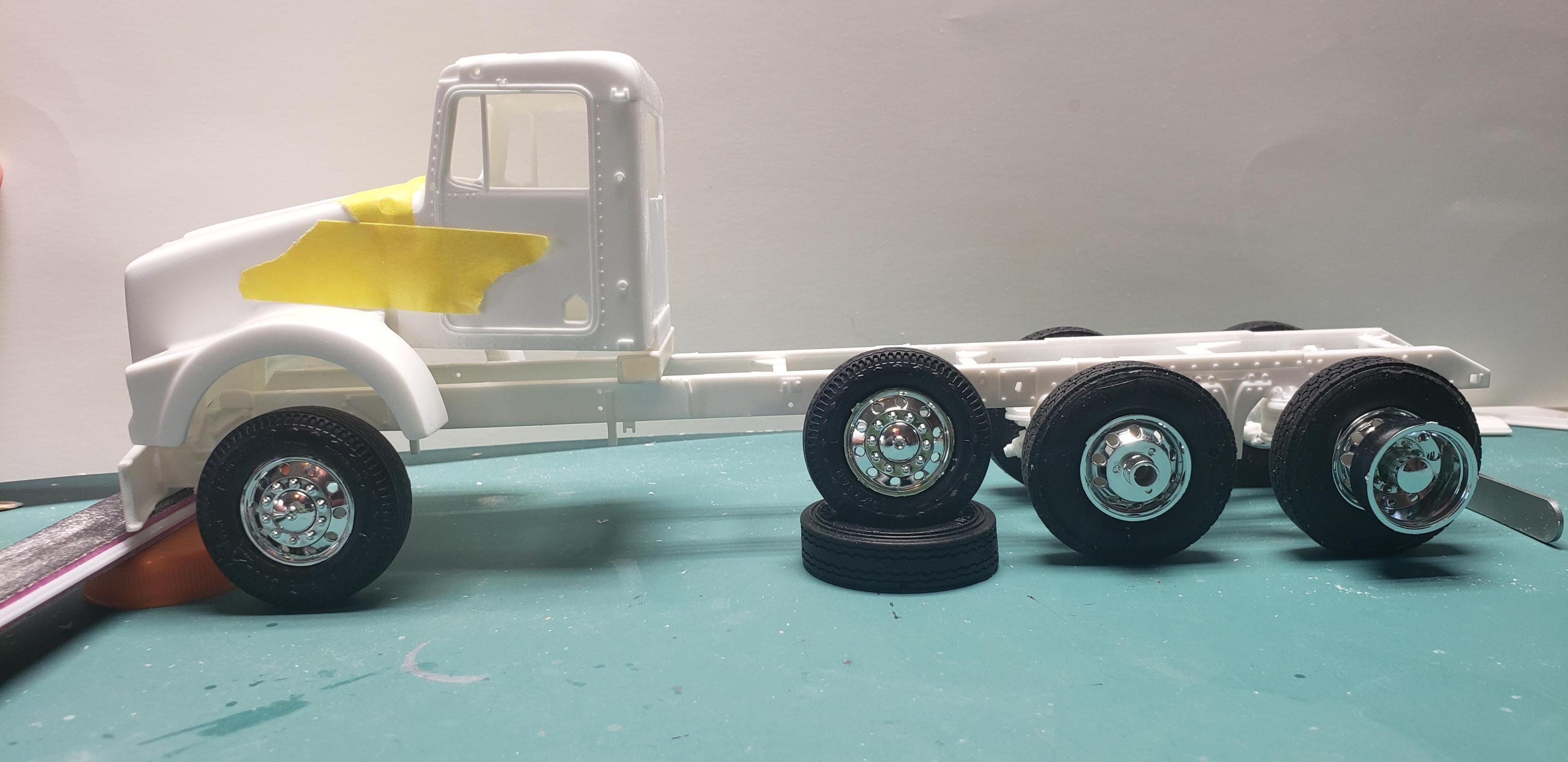

I couldn't pass up a mock up. I'm using rubber from st supply, and mobius wheels. The lift axle tire looks a little large imo, but it may grow on me. The chrome will get toned down, its a little intense for a haul rig

@Gary Chastain it was a method suggested by plaskit, and worked really well. I learned real fast to trim the ends going into the pivots short, or they'll be challenging to remove lol
I tossed some different tires on the front, reminds me of the amt wide  floats. The lift axle tire is a standard amt tire, and being smaller diameter really looks better for the look I'm after.20240509_172254.thumb.jpg.3c21f08a2a5d23cf5c32d8ed53bd6bb0.jpg
I made up some axle bushings suggested by Gary Chastain to hold the moebius wheels on..perfectly smooth.

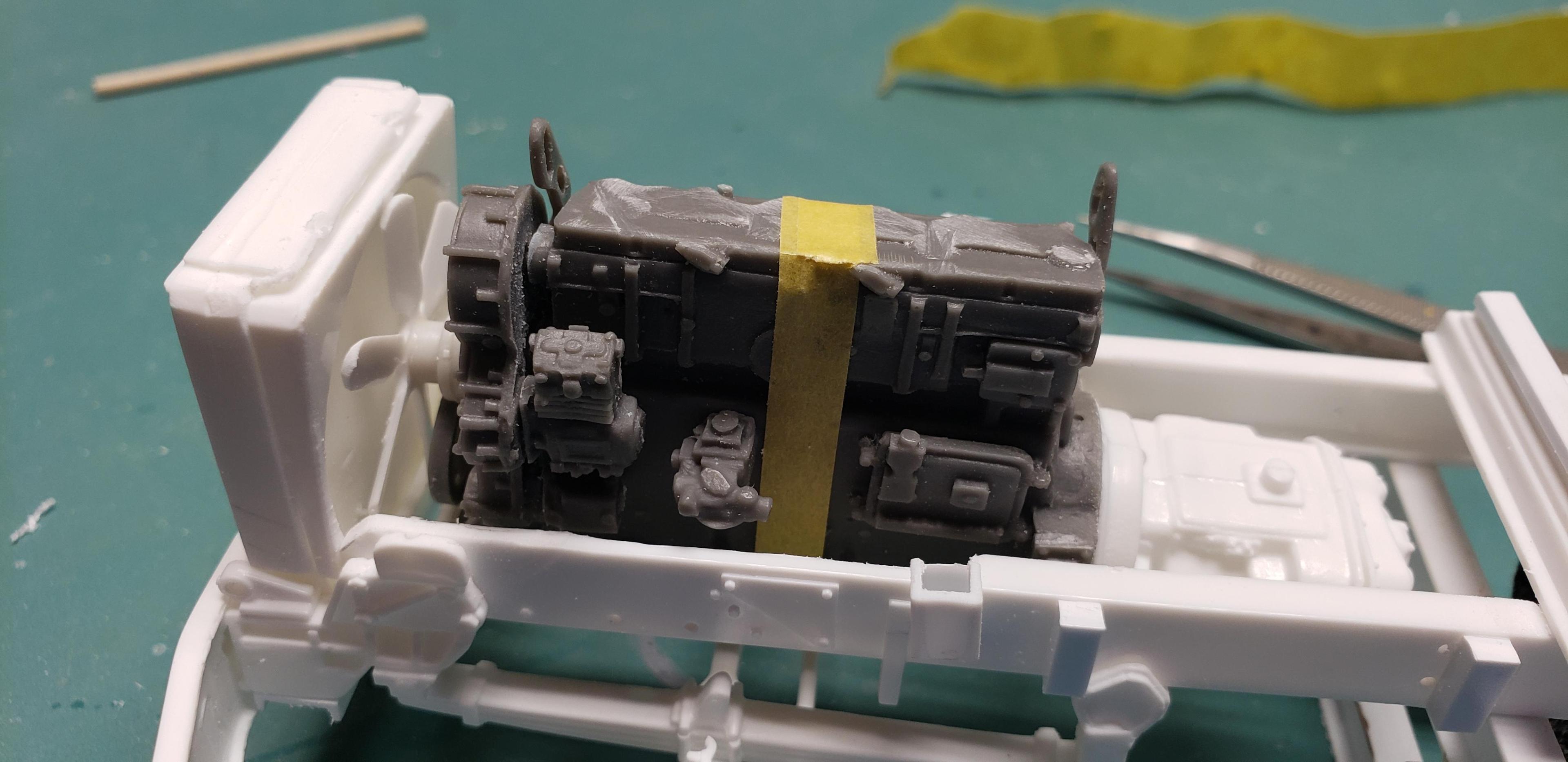

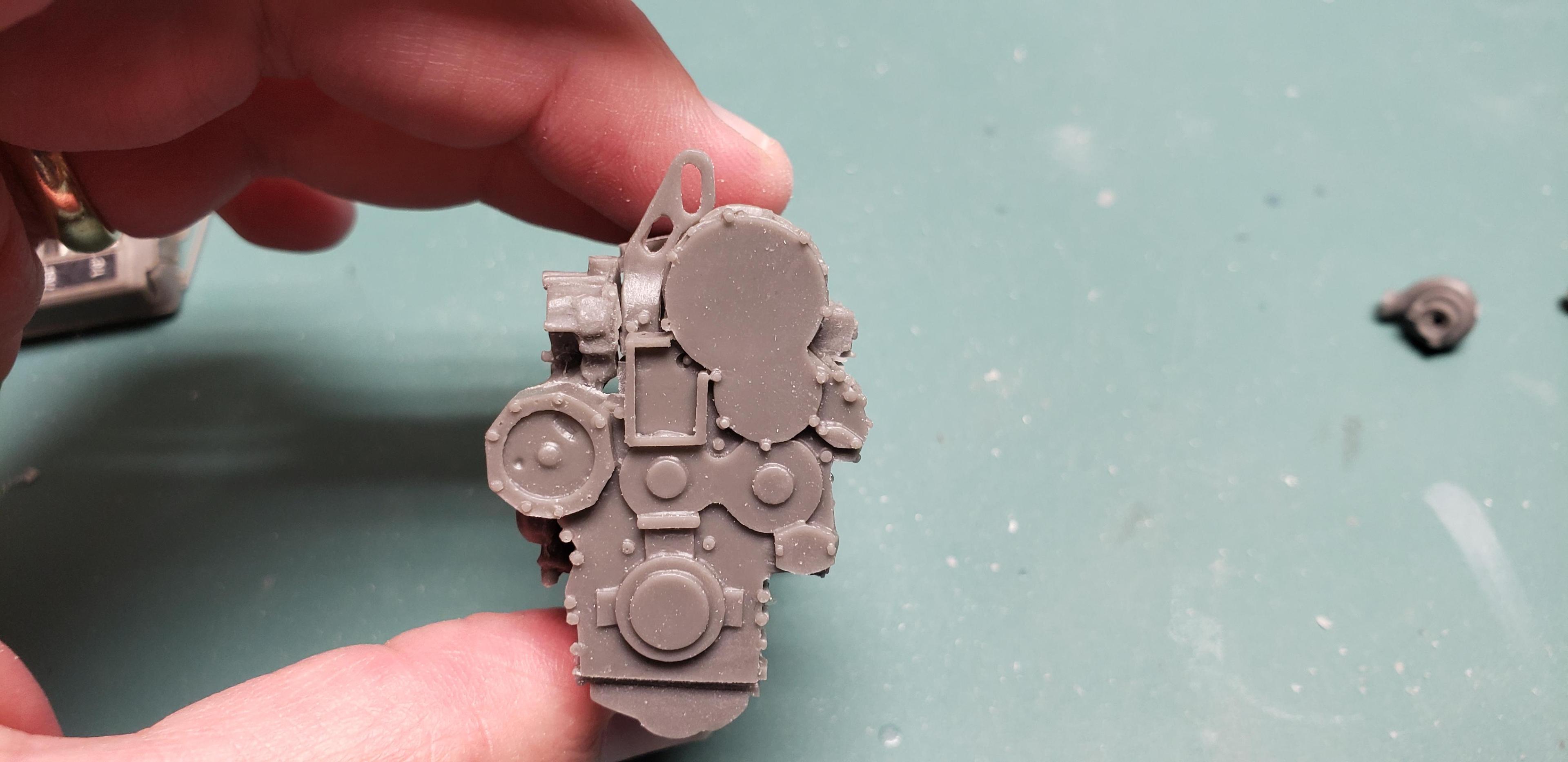

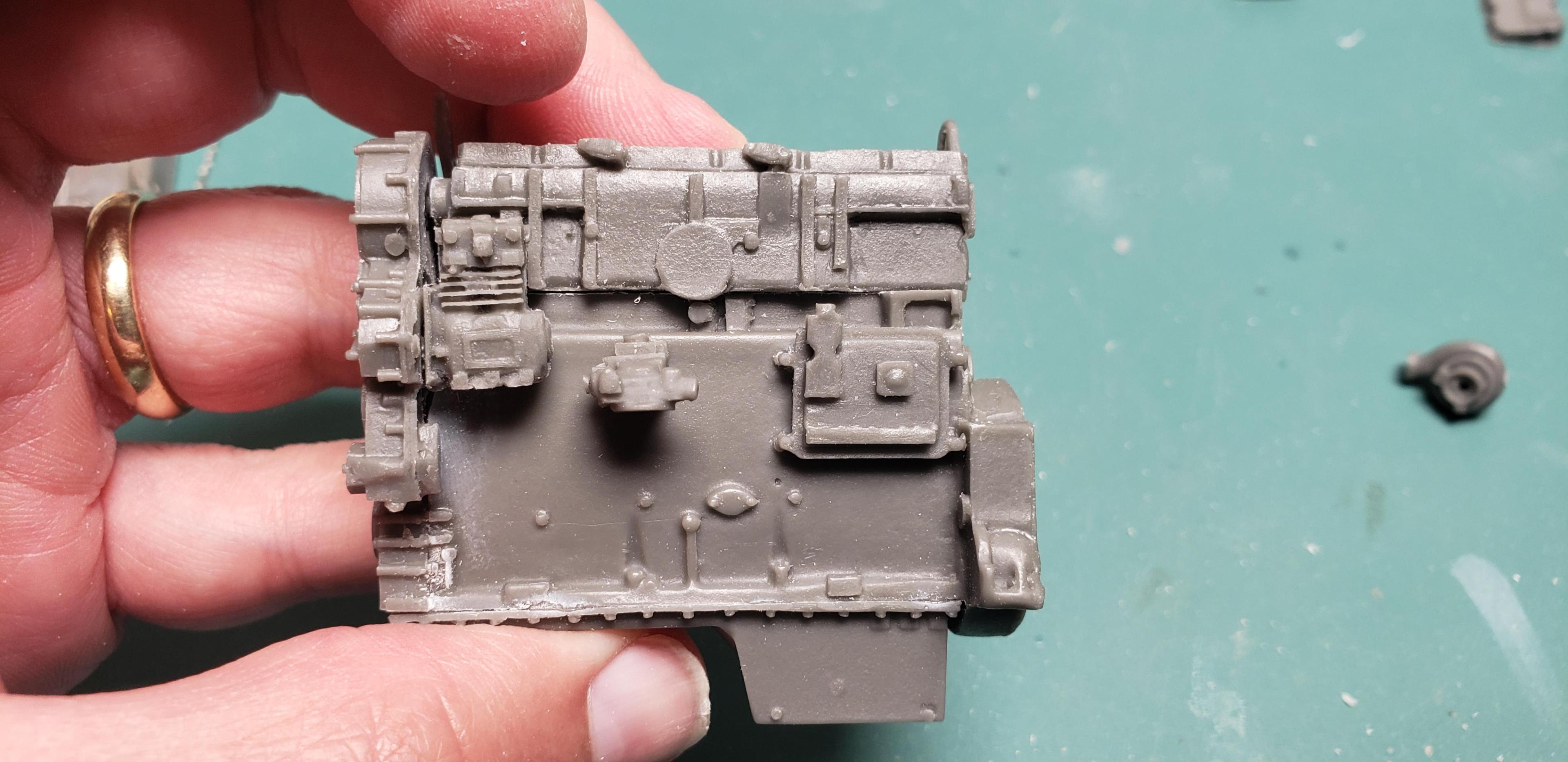

I puttered w the T800, starting on a possible engine for the build. I had ordered a C15 along with other goodies from st supply I'll leak photos of along the way..and its the 1st yellow engine I've ever built. The engine wasn't sent w instructions...and include a bunch of small parts. Luckily there's been a couple built on the forums, a quick search turned up photos.
Here's what I have assembled so far...its not much, but I spent quite a while looking at photos working out how everything should go
I'm leaving the valve covers off to paint separately, but hopefully I'm on the right track. I did notice a possible issue w the filter mount on the left side being very close to the frame...but recall plenty of knuckle busters working on Uncle Sam's trucks.

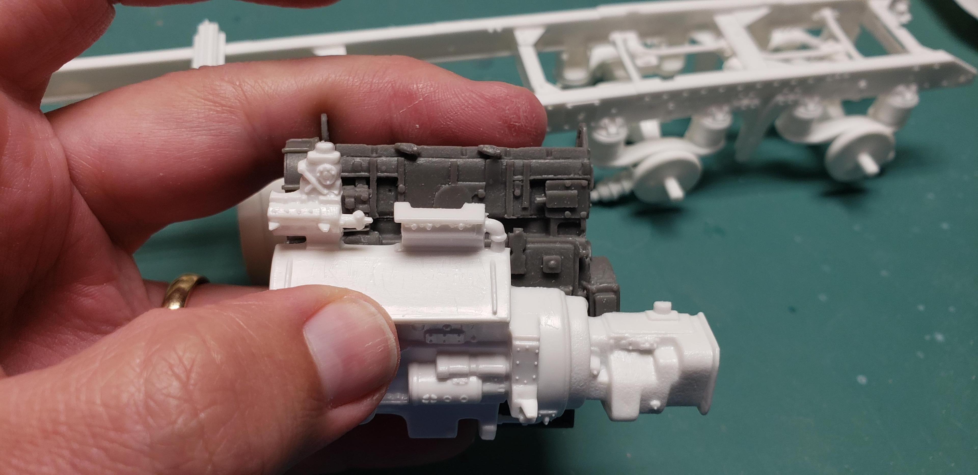

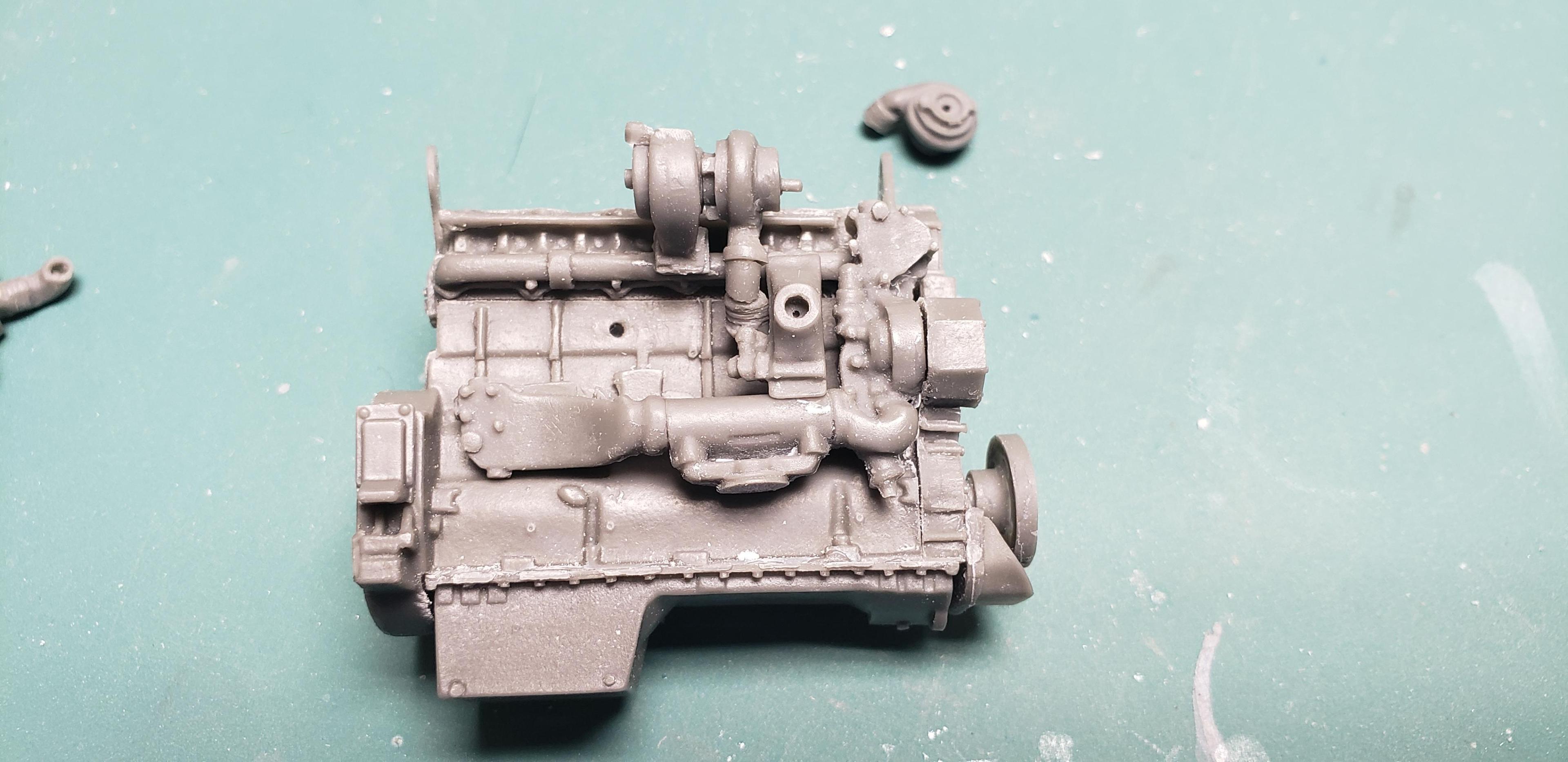

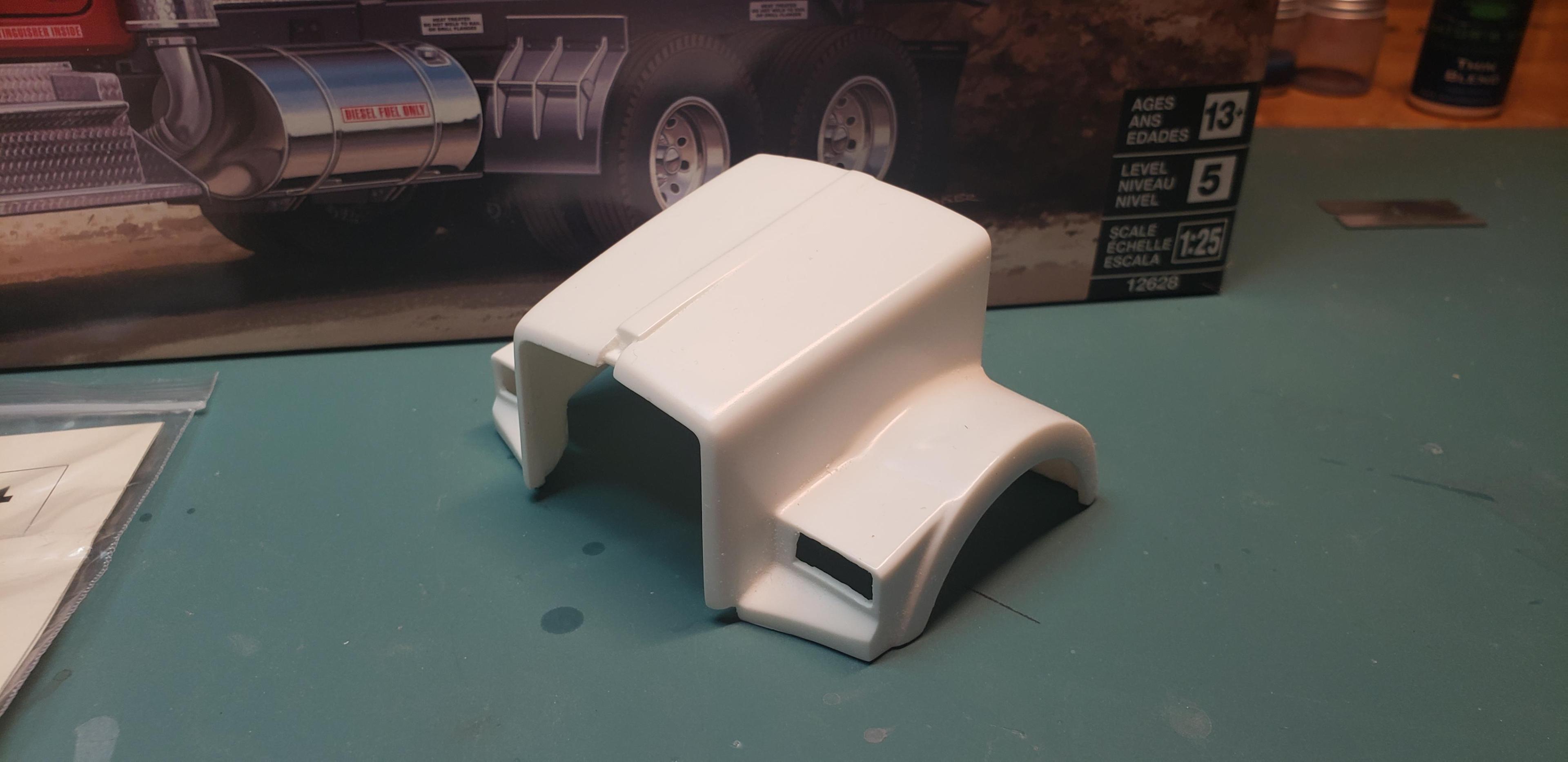

I ran into a snag, wasnt totally unexpected.  The Cat wants more real estate under the hood to firewall than I currently have.  Looks like I'll need to break out the wheel of death and fling some molten plastic..aka doghouse. Just because I wondered,  I assembled the kit engine. The turbo hits the firewall also..heres the overall size difference between them
Decided to keep building the C15..maybe these photos will help answer someone's else's questions like I faced . Overall a very detailed engine, I just drilled a few holes deeper to fit tighter

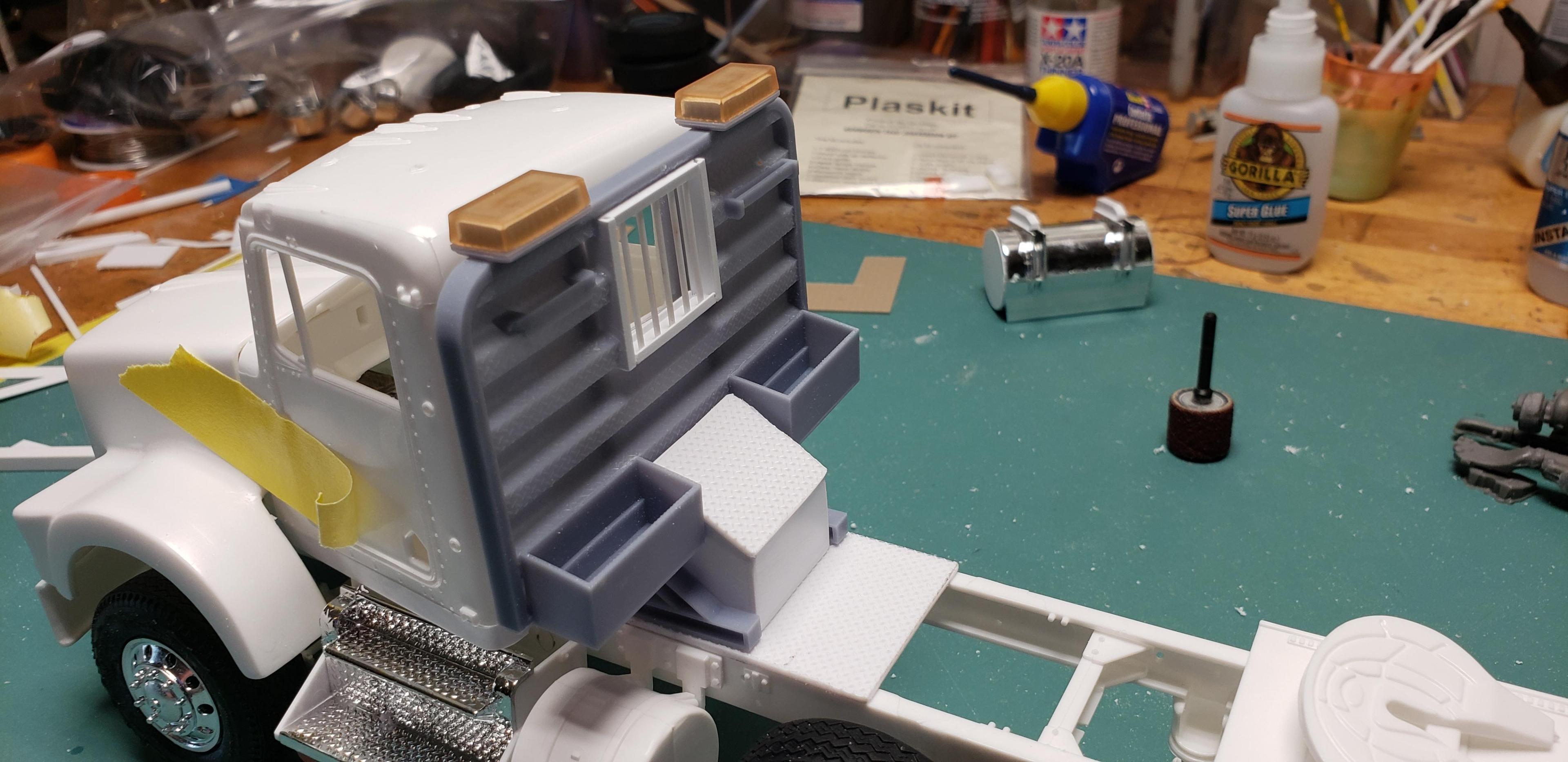

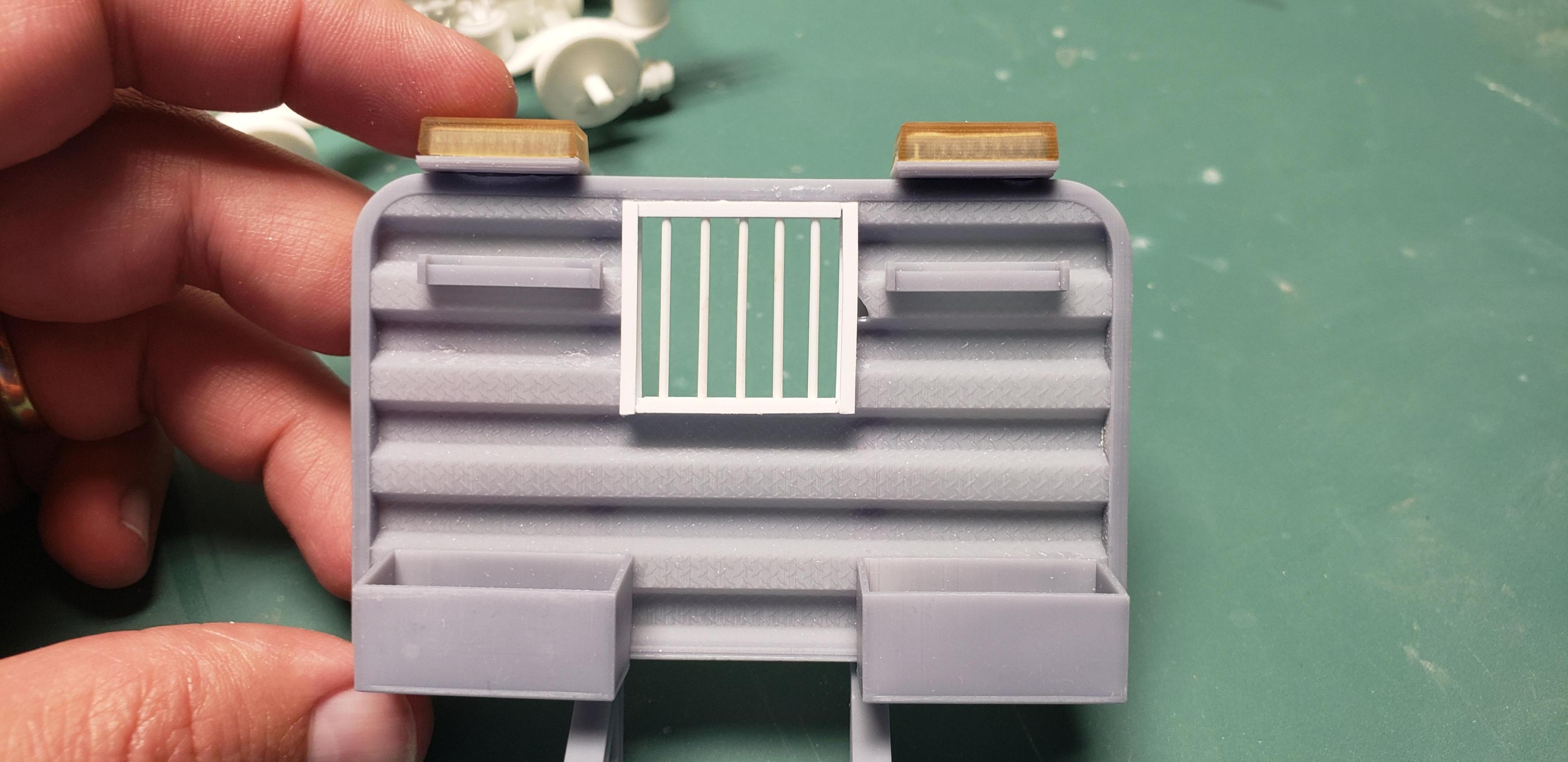

I did tinker w making a jailhouse window in the headache rack..dicey sanding the very brittle parts20240514_172110.thumb.jpg.163eecb6663cdab2b3ac4da680762400.jpg

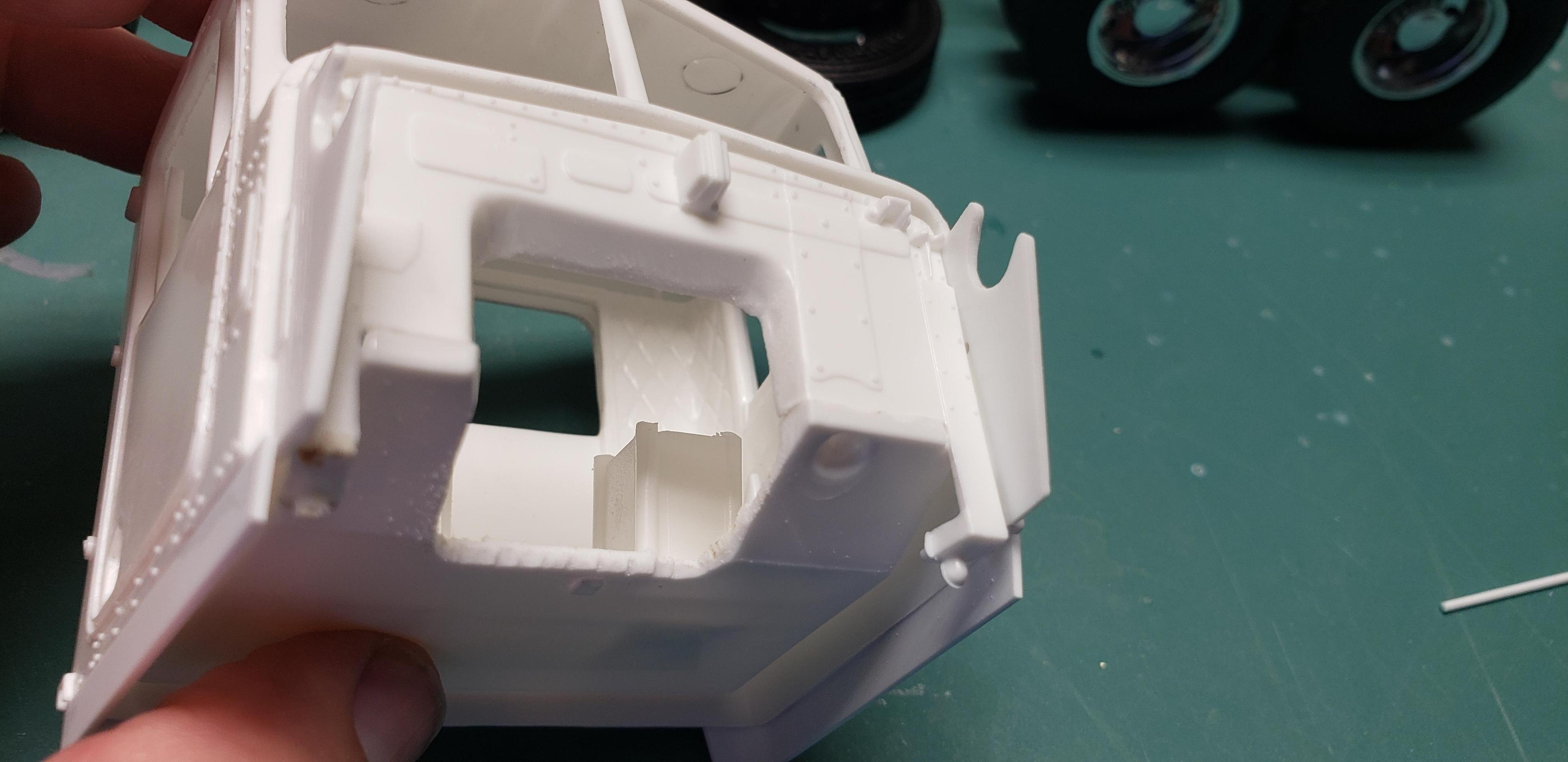

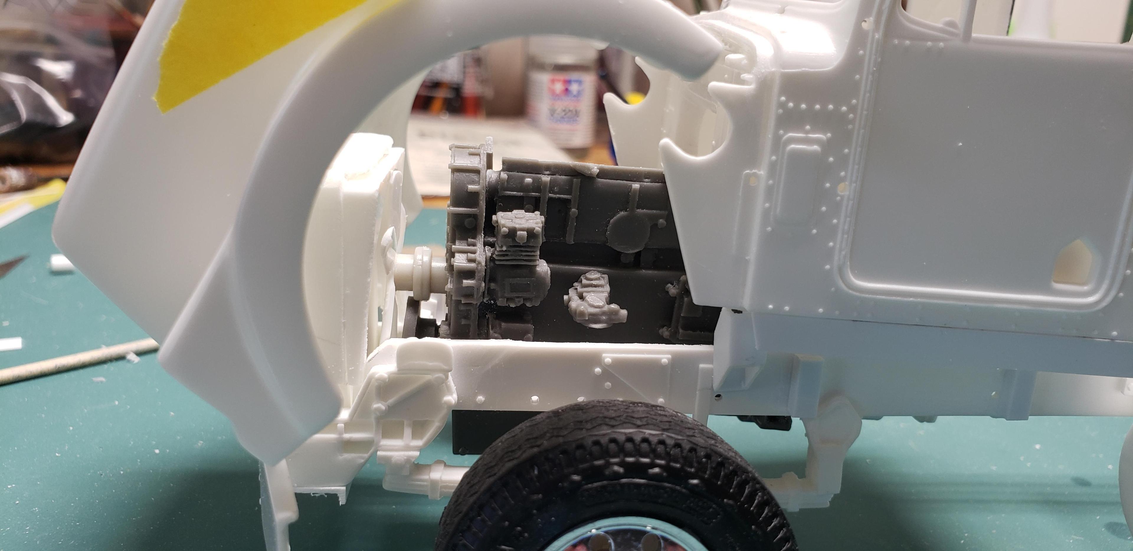

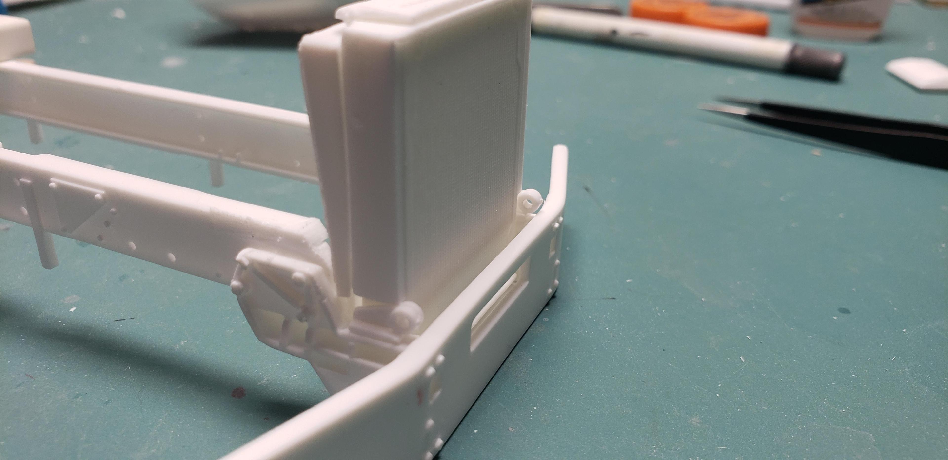

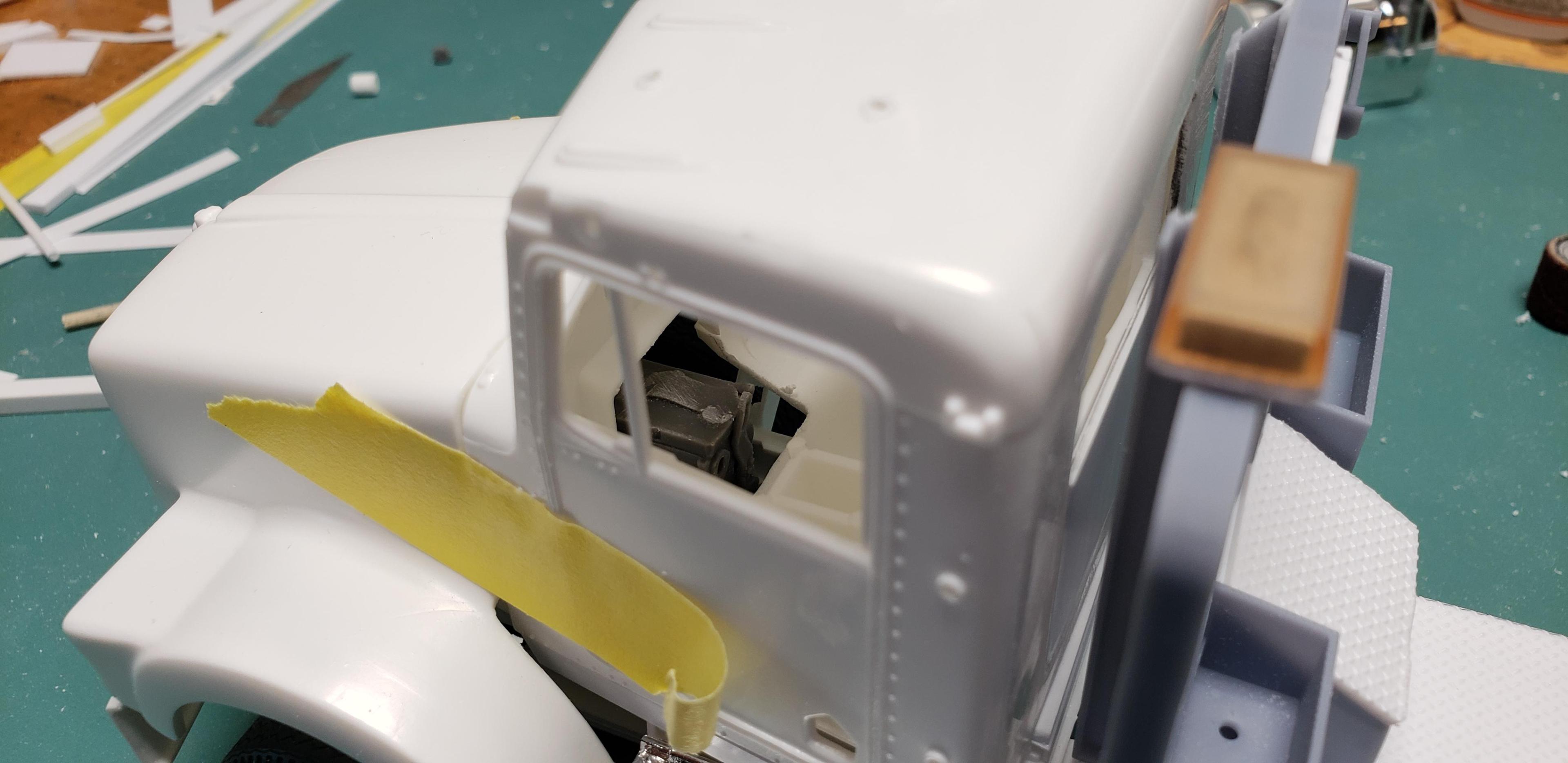

I decided since the weather today was soggy and Cats typically don't like rain, I'd better find a way to keep it dry. First up was cutting the cab firewall and floor. 20240518_134844.thumb.jpg.9557e2905bf7a6858a914ec2fd1dd9cb.jpg
The frame top flange needed to be sanded away, to clear the filters, after flipping the oil pan around..the engine seemed to fit !! 20240518_113032.thumb.jpg.25bfec39c96eef7a6a99c3df48a7568d.jpg
Ignore that 70s era metal fan, I'll have to find a plastic one, or fab one. Guess I'll need to scratch an air cooler, or charger whatever they're called that piggyback on radiator.
Peeking inside to check the work ahead
Last for today was building a tool box under the rack, the deck plate is Don Mills diamond plate. 20240518_133913.thumb.jpg.eba33c3a9454b14594d36858975b5813.jpg

  On 5/18/2024 at 9:30 PM, Gary Chastain said:
Liking the progress, rear rack looks really good and appropriate
Expand
Thanks Gary ! A fellow modeler sent photos of a truck at his workplace, I kinda copied that. I'll need to make some chain hooks once the paint flies to fill those hangers
