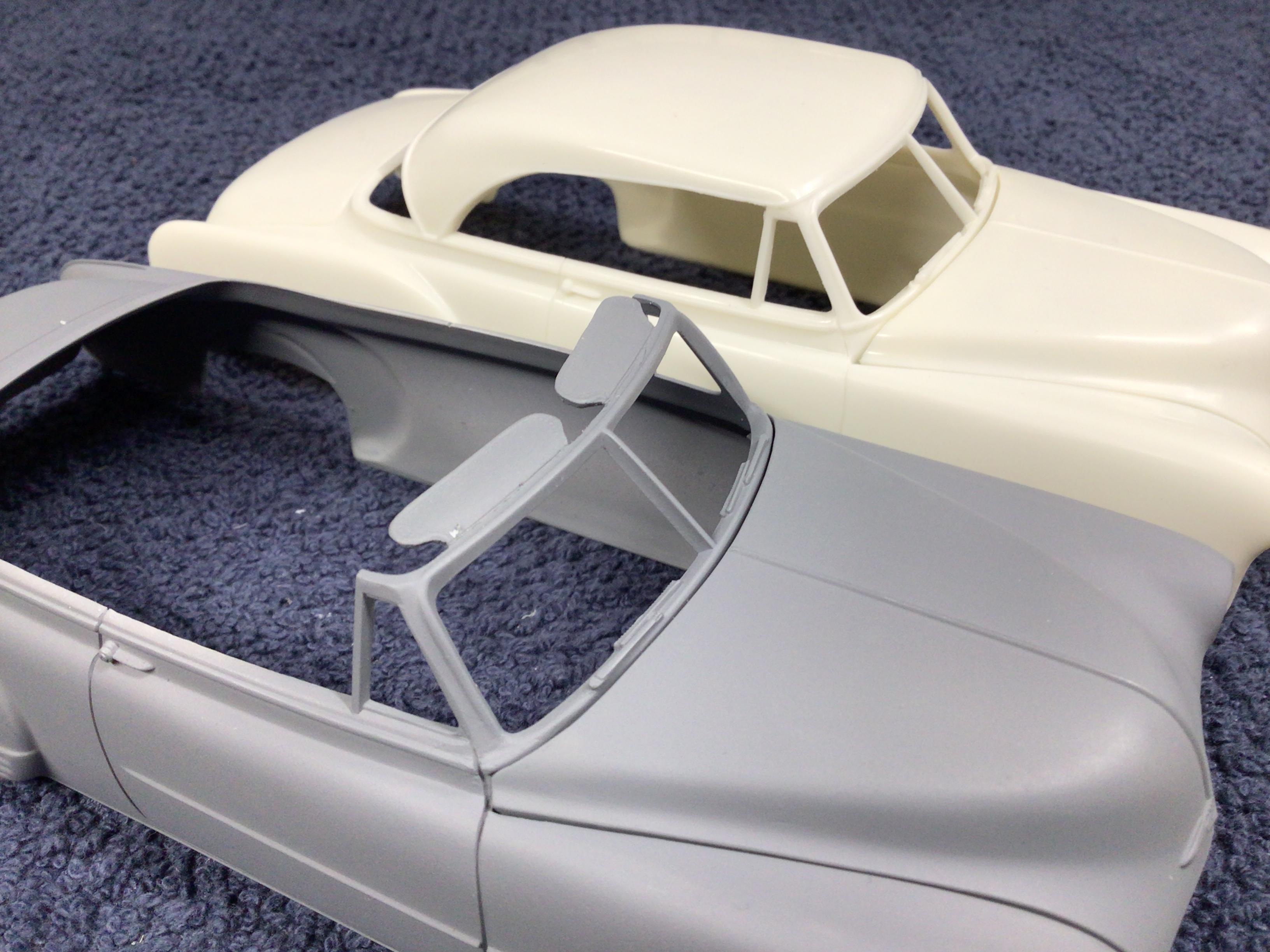

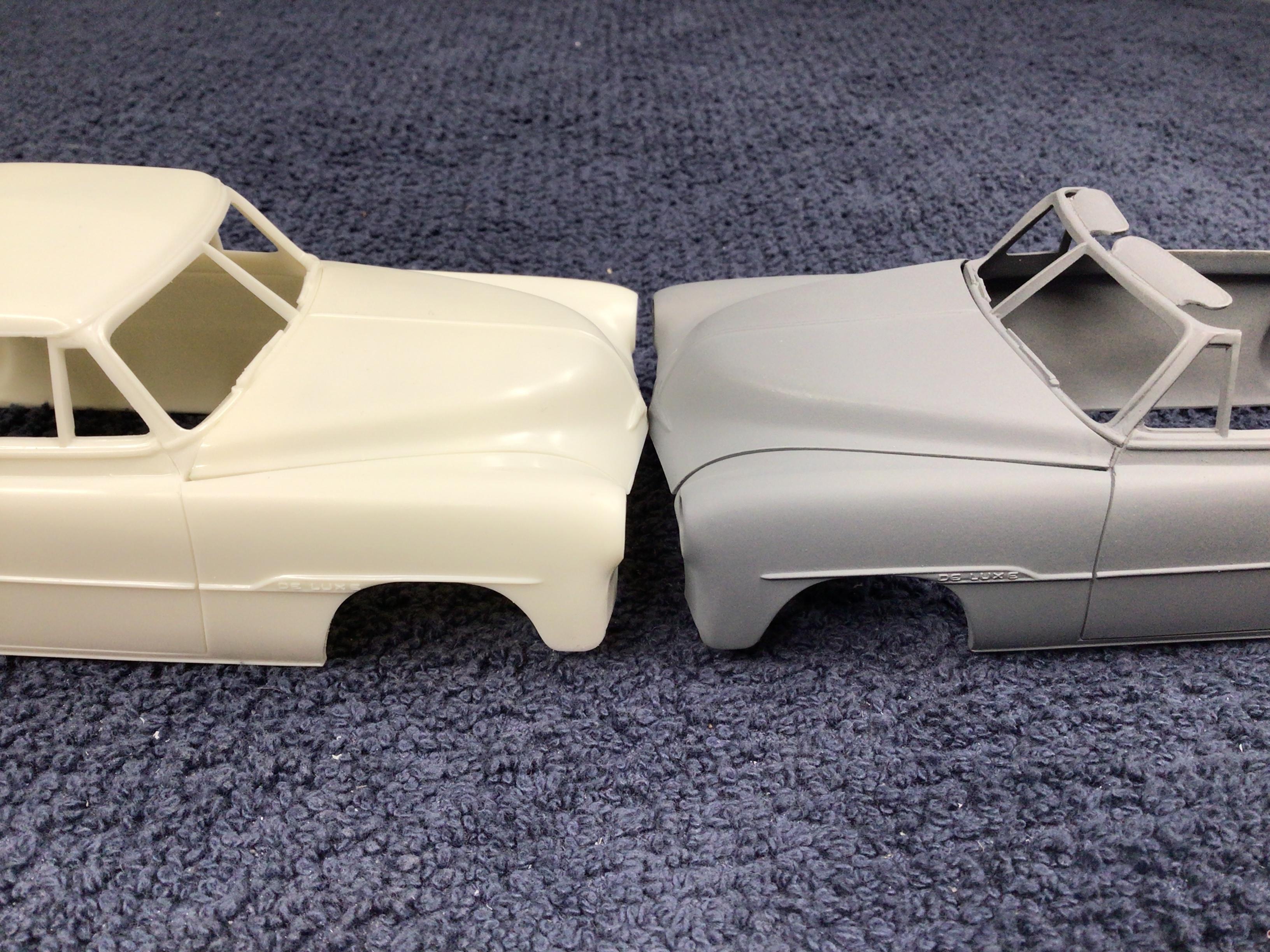

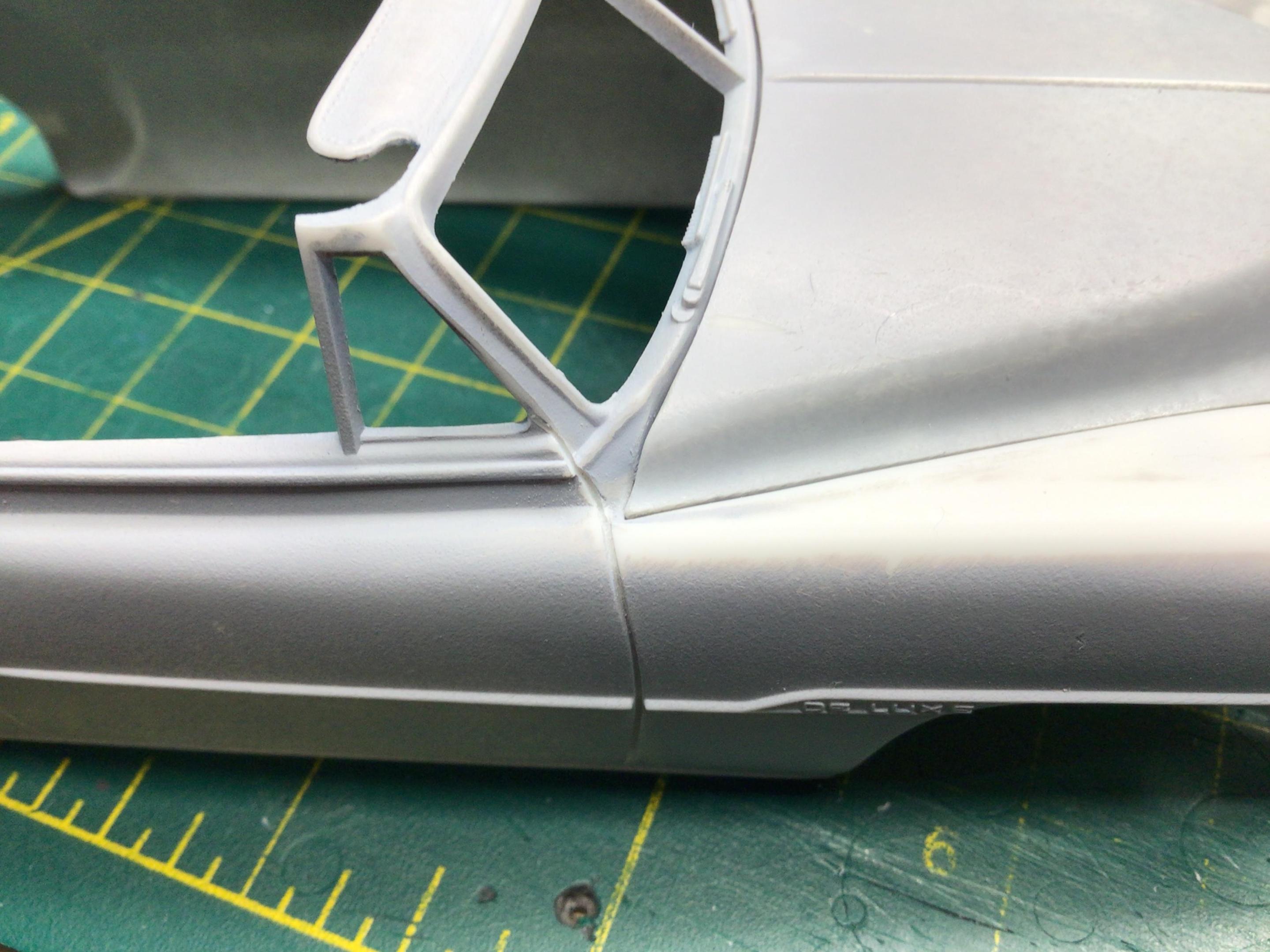

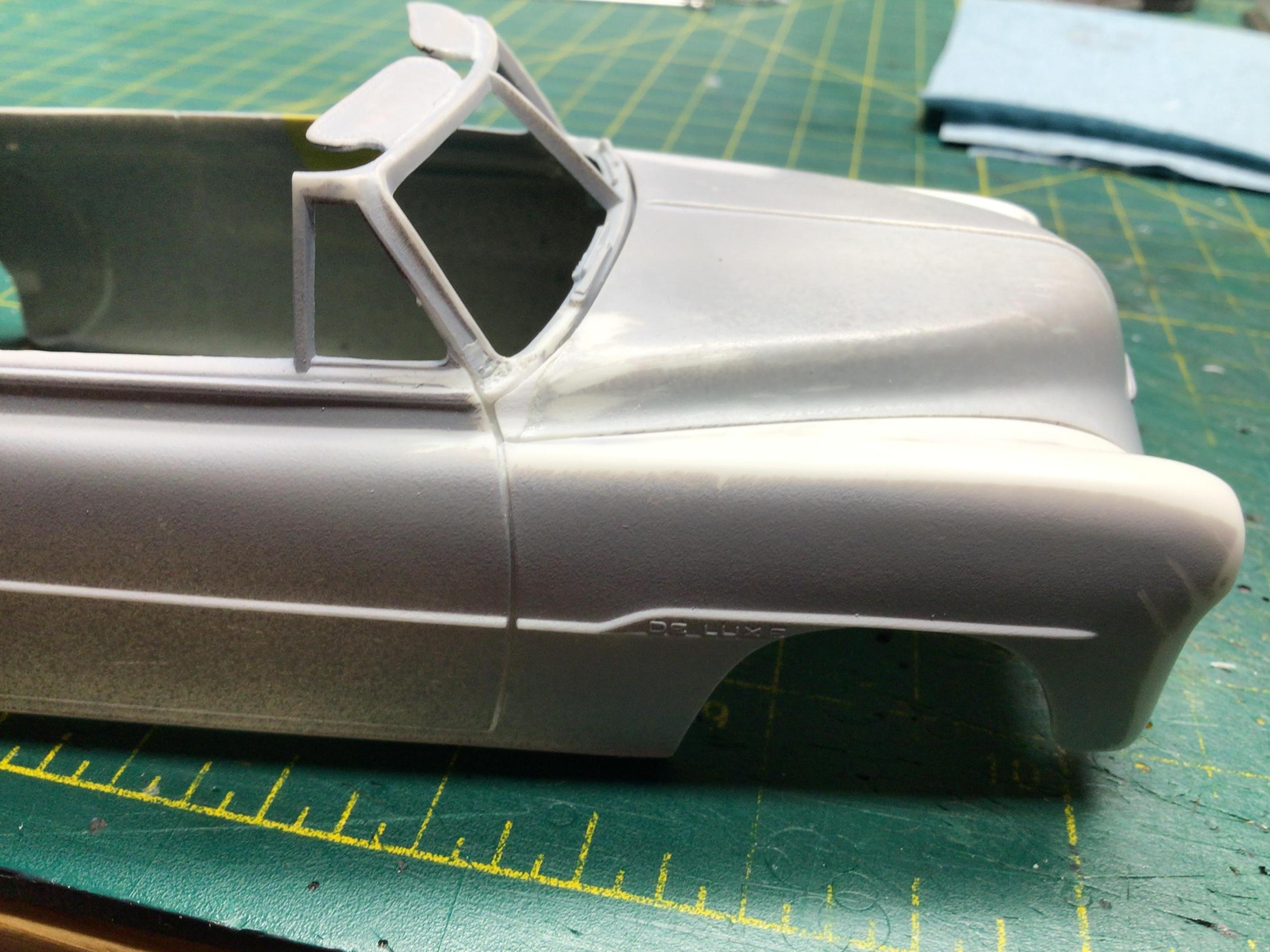

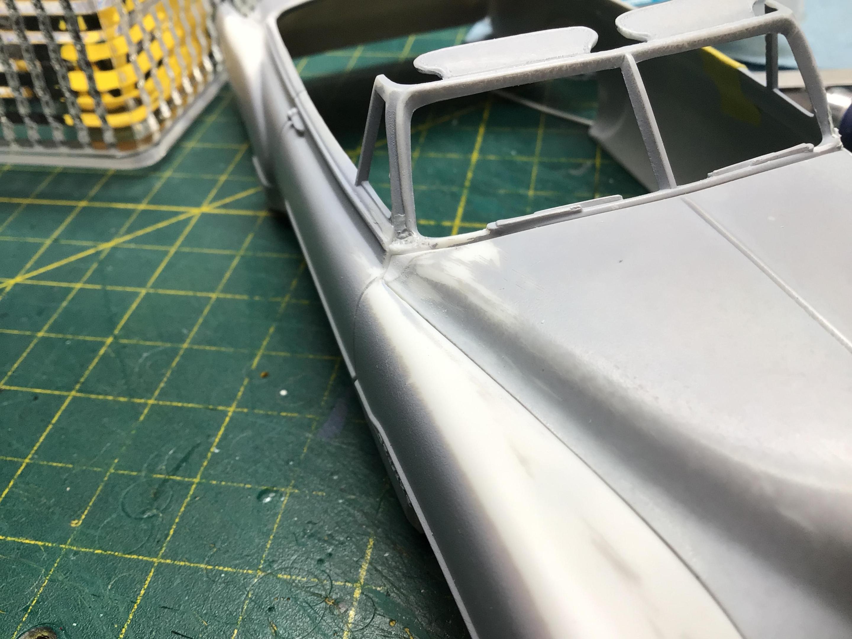

The hood to cowl area on these AMT Chevys is really bad! The lower windshield trim and cowl are not correct, but the worst part visually is outer corners of the hood.? I finally found a decent picture of the area.

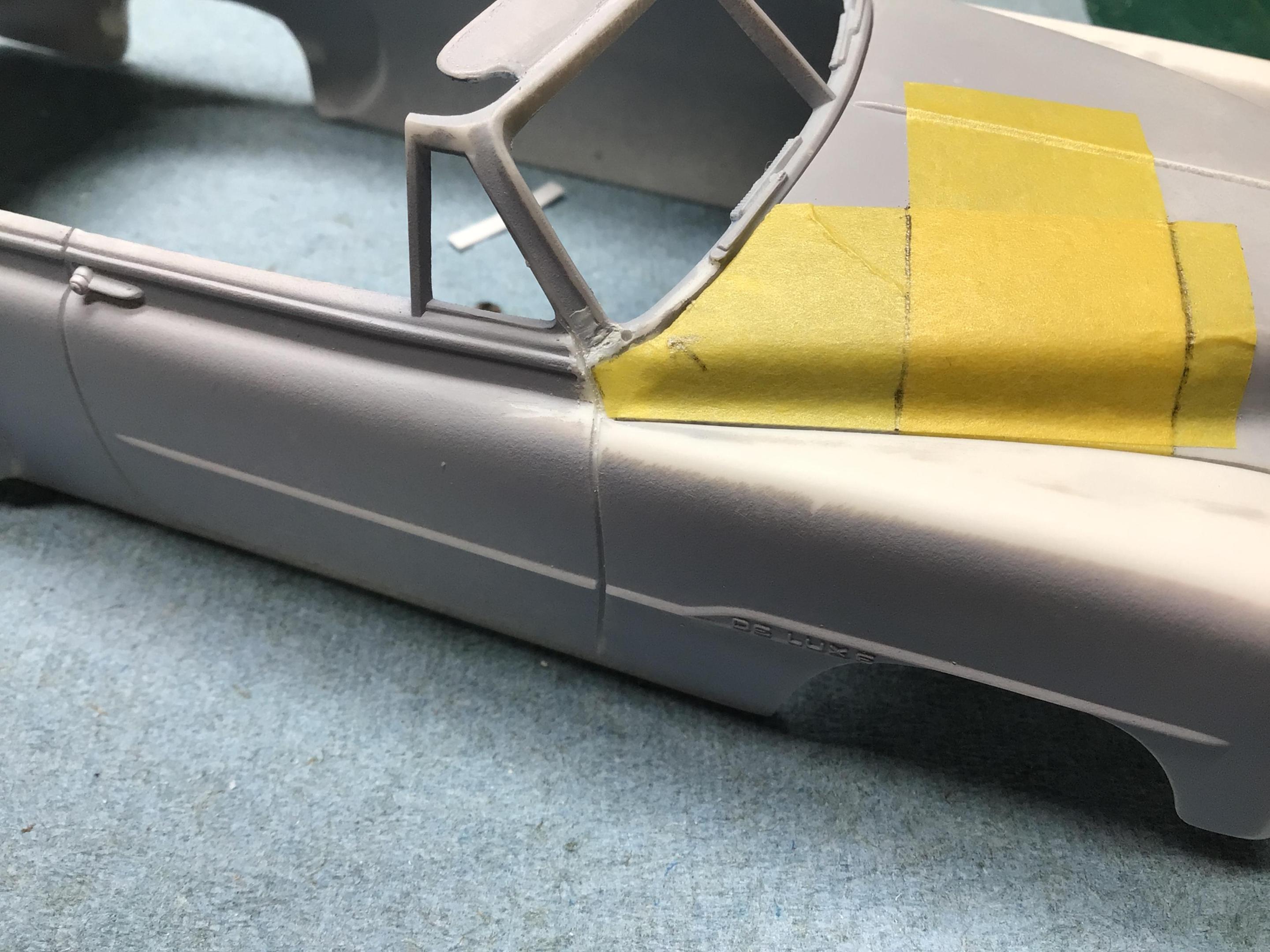

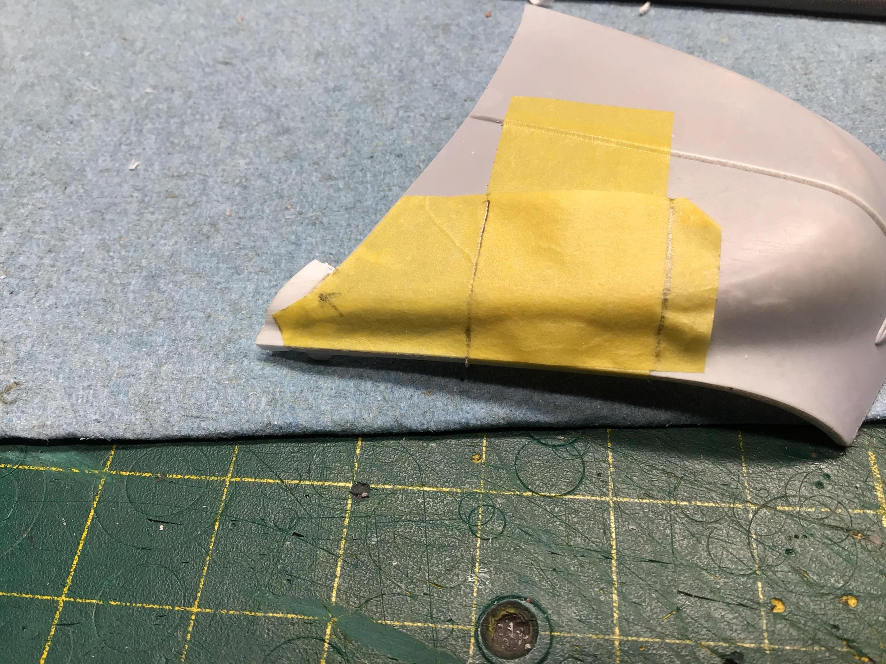

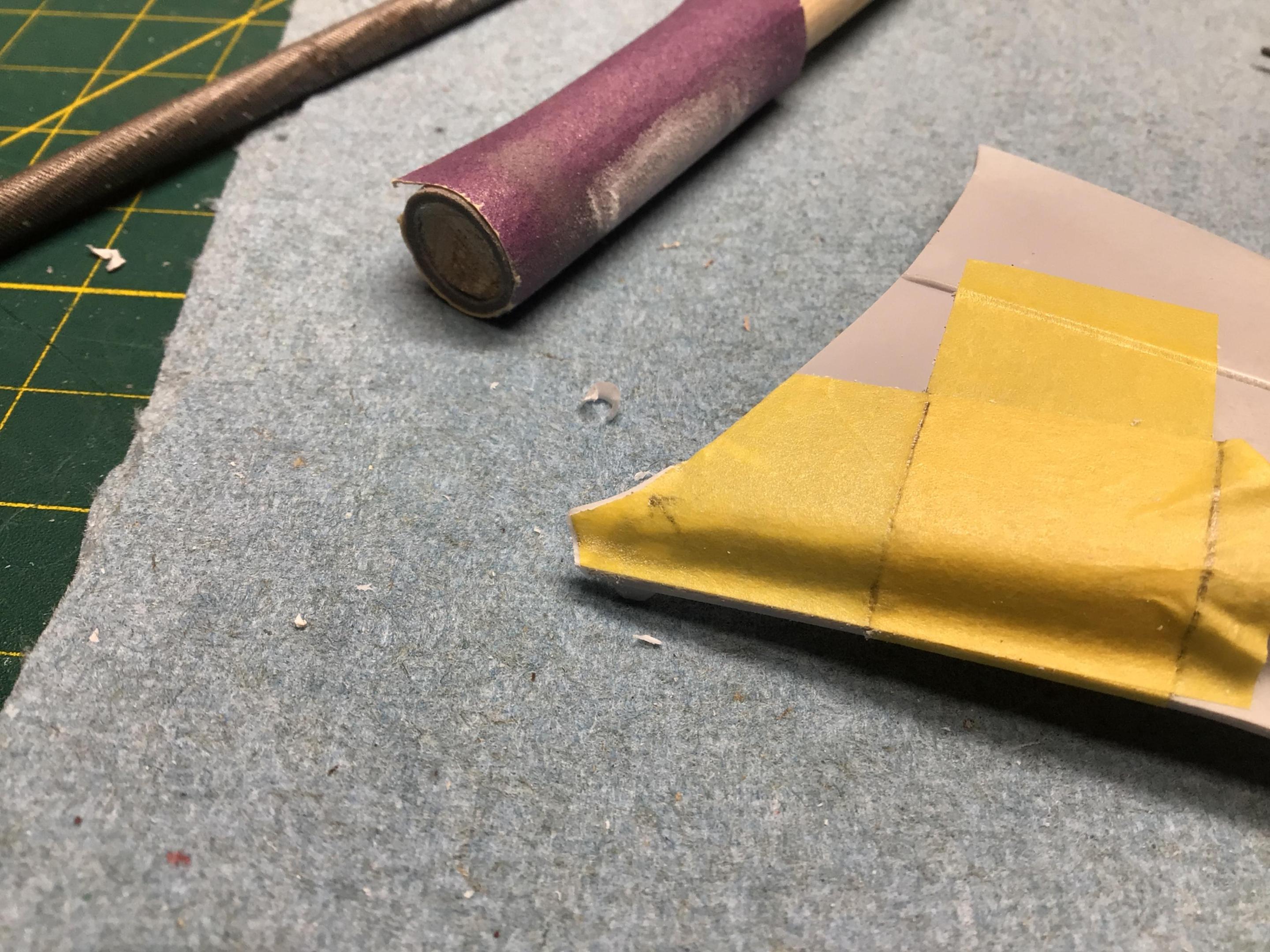

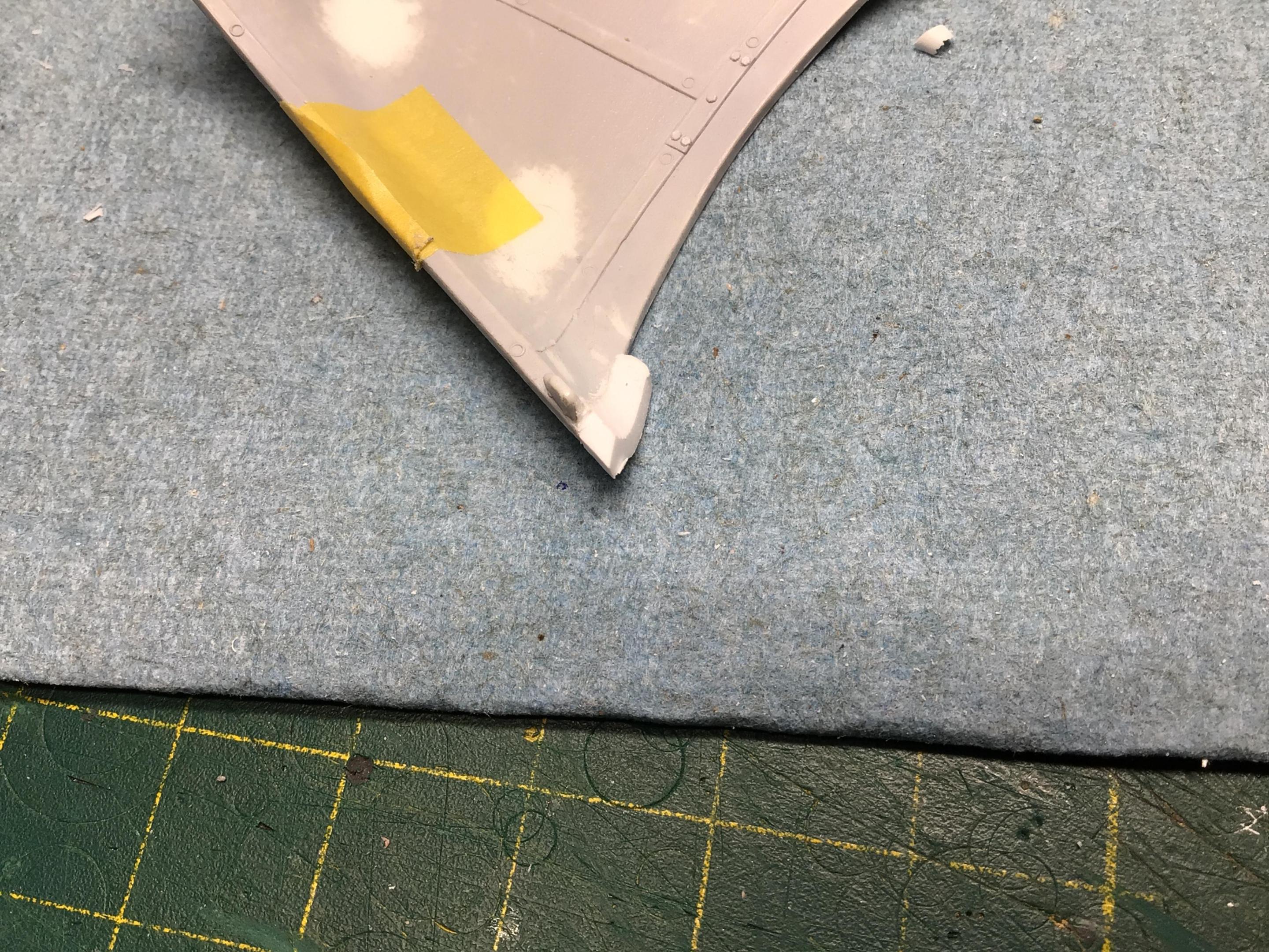

I first made a pattern from tape of the contour that I want then glued a chunk of evergreen on with Tamiya cement.

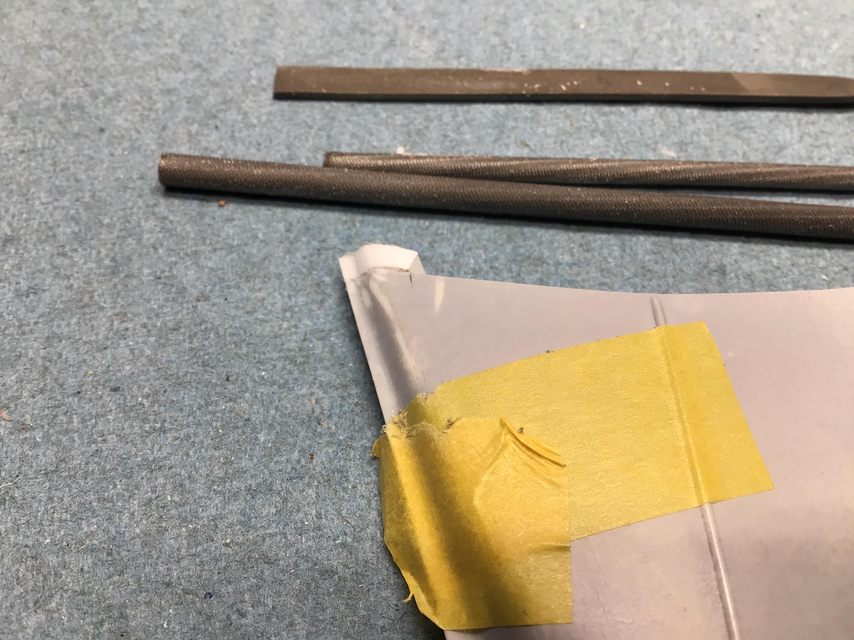

Then I filed the inside and outside down close to level with the hood surface.

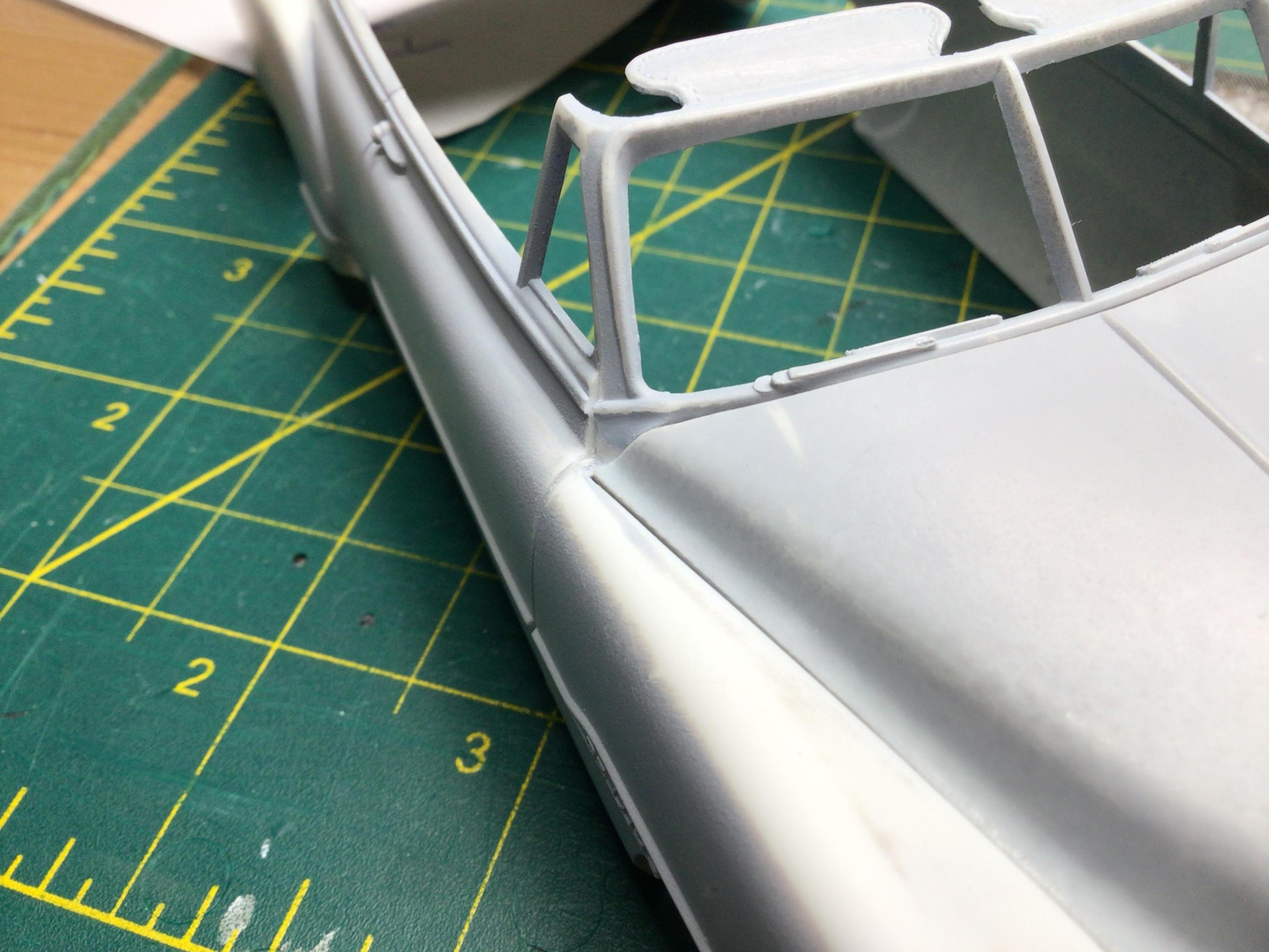

Then replace the pattern tape and file away everything that doesn’t look like a’51 Chevy hood.?

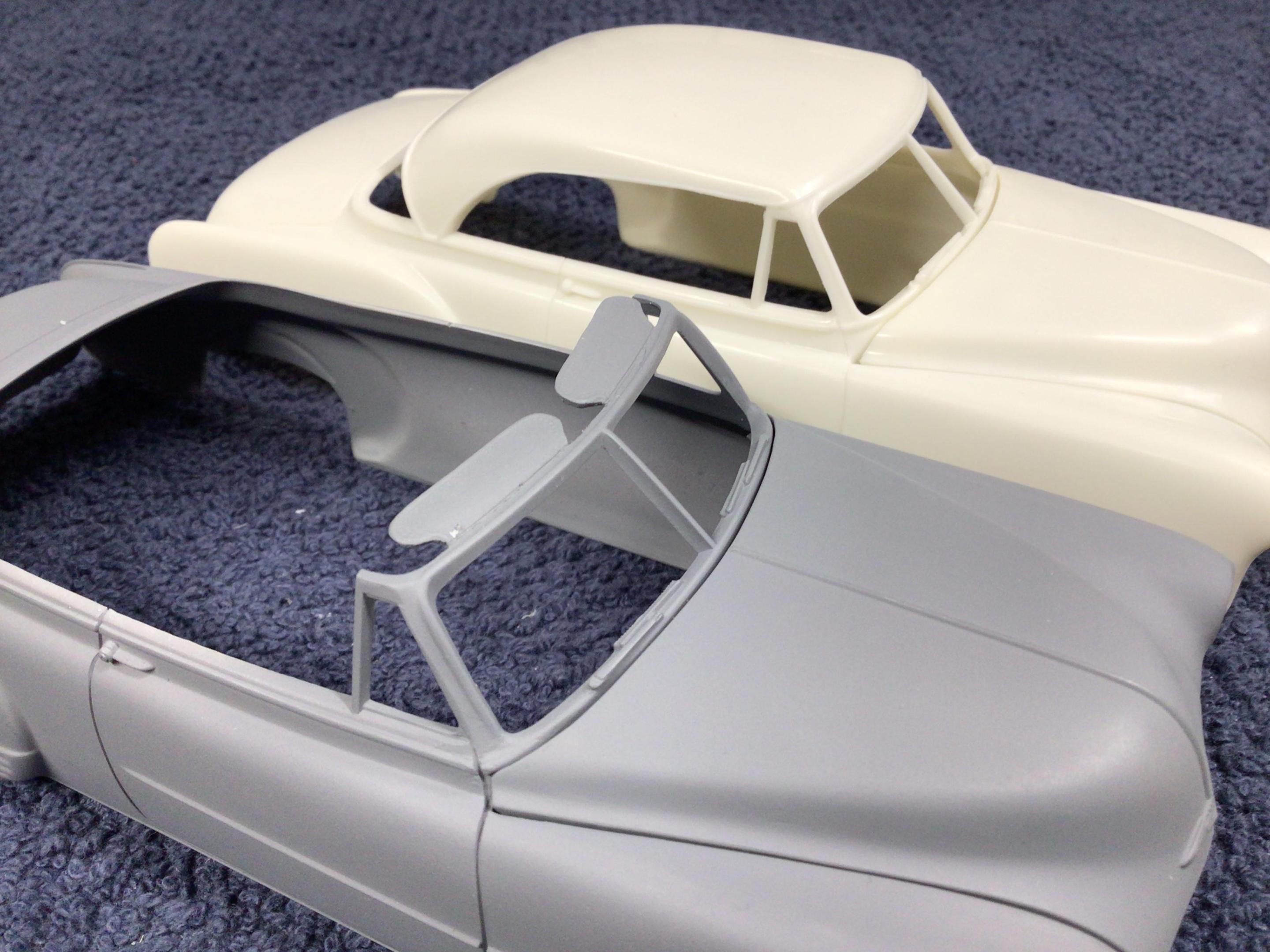

A little shaping of the back edge and a bit of scraping of the cowl corners gets a pretty good fit. I added a short chunk of .040” half round just forward of the door trim to try and blend it in a bit, since I don’t want to tackle fixing the cowl.?
