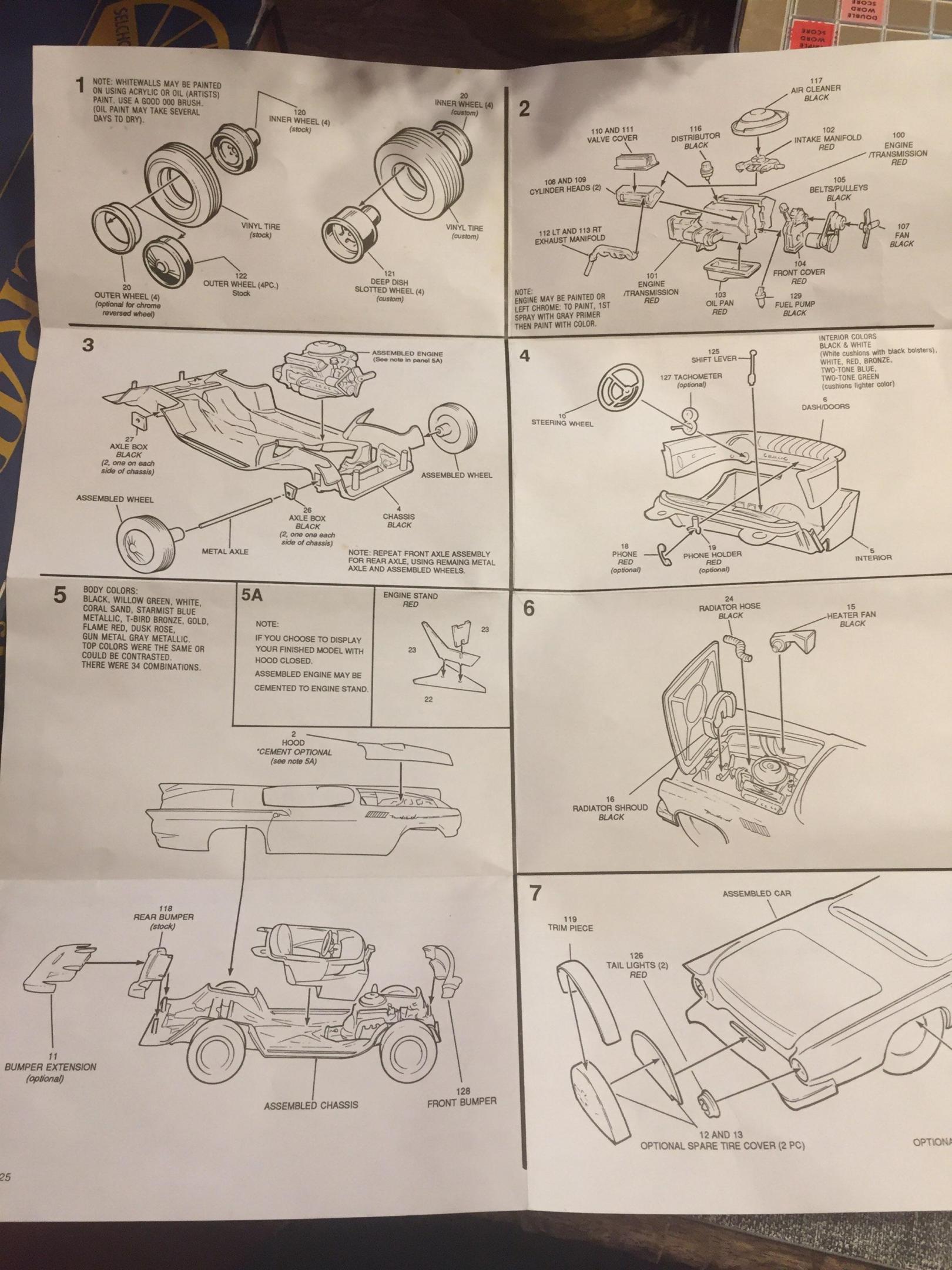

Instruction sheet is road-map style and not very helpful. Just rudimentary illustrations and the usual goofs; you know the routine.  Luckily, it ain't complicated.  I can probably figure it out ?

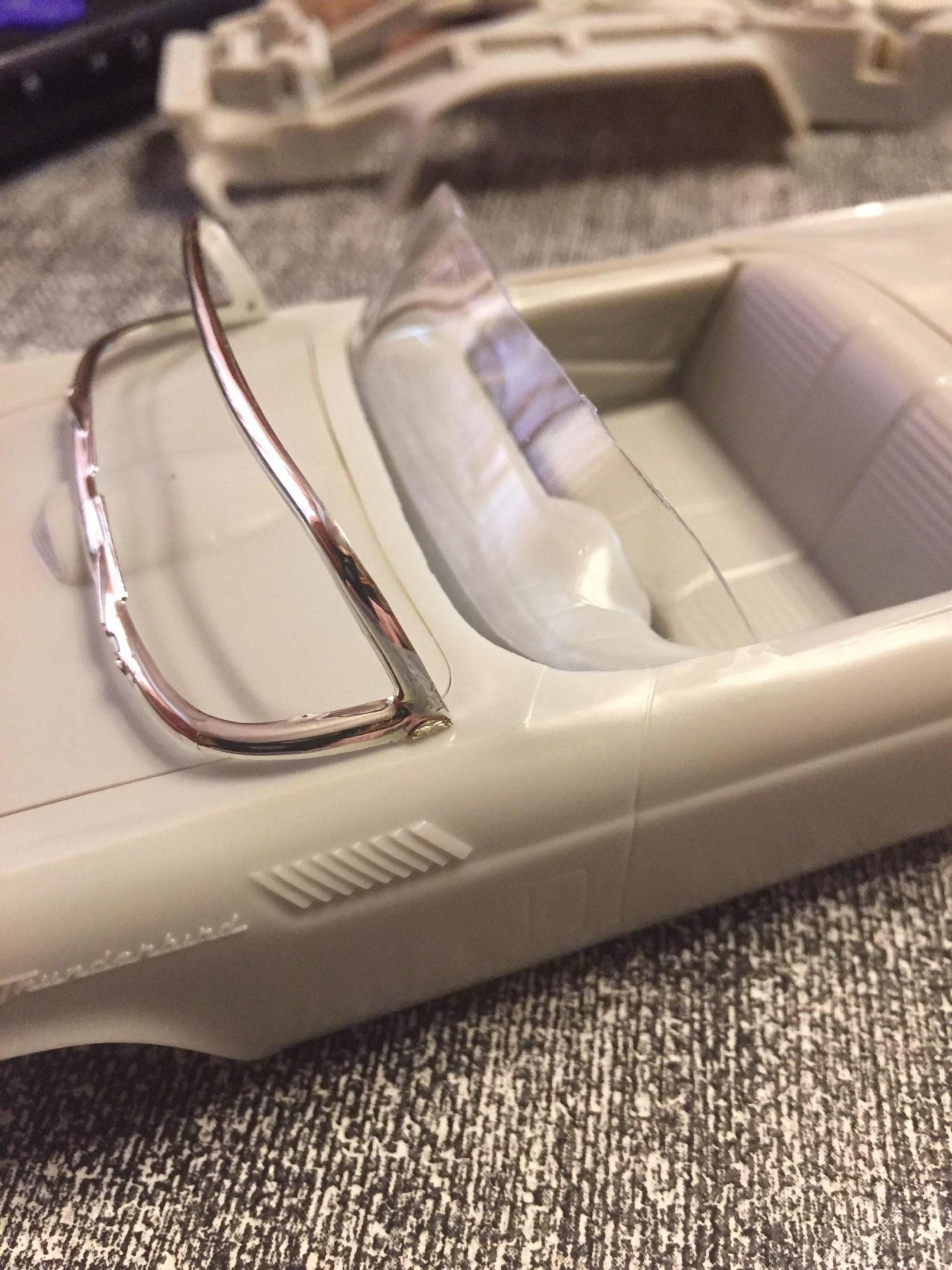

For the windshield, it looks like the glass fits into a slot and then you add the plated frame to it.  thats how I plan to play it anyway. Maybe it will become clearer when I get there. ?
IMG_6159.thumb.jpg.77e62864530b36a1fc058a859a8ad723.jpgIMG_6160.jpg.c38678da91230767863c4079f35d7532.jpg
It looks like a nice easy build and, of course, there is opportunity for improvements.  I will be building it pretty much OOB and I will start with the 312.  Thanks for looking. If you have experience with this kit, your sharing will be appreciated and your comments and praise are always welcome.

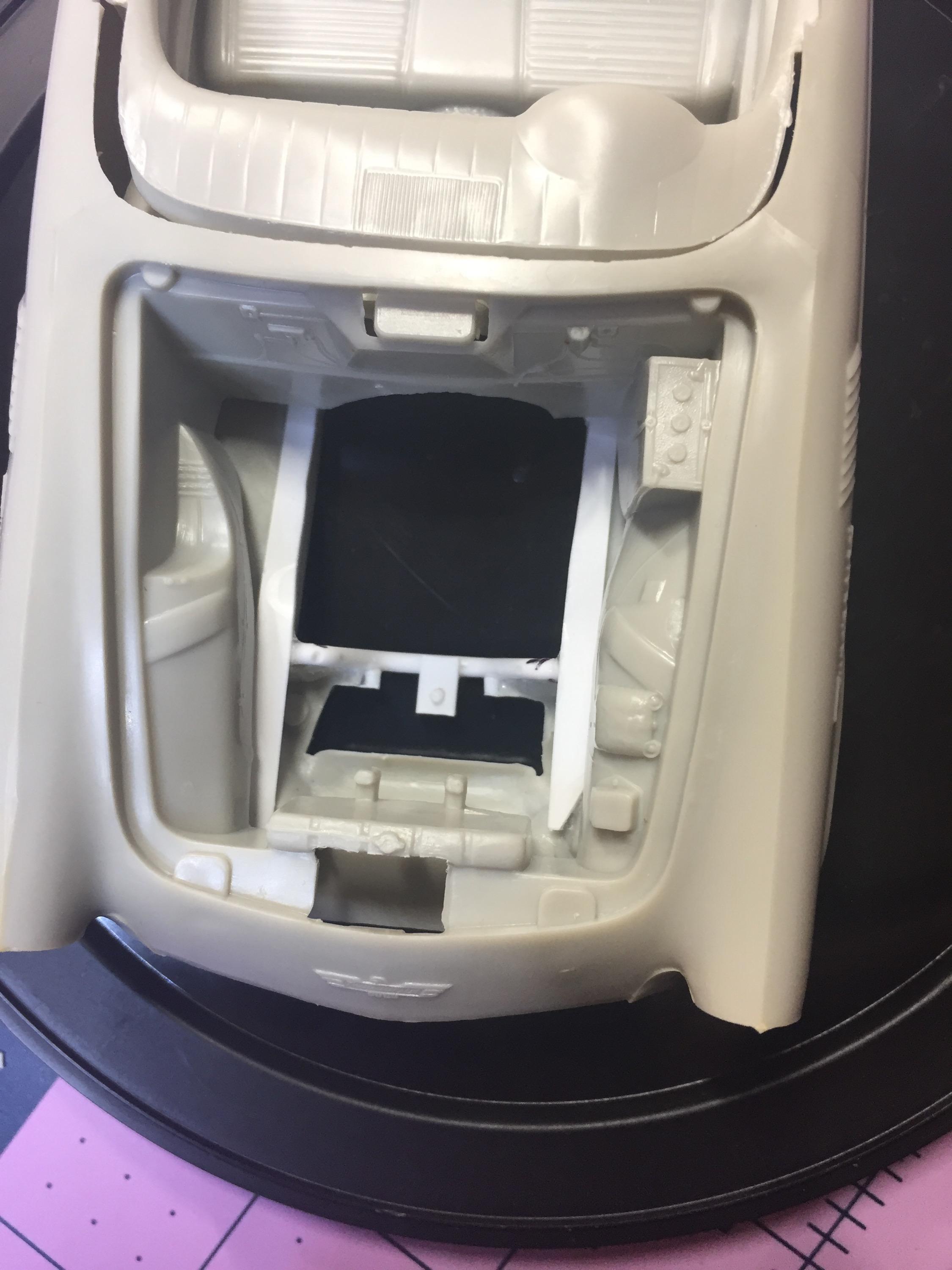

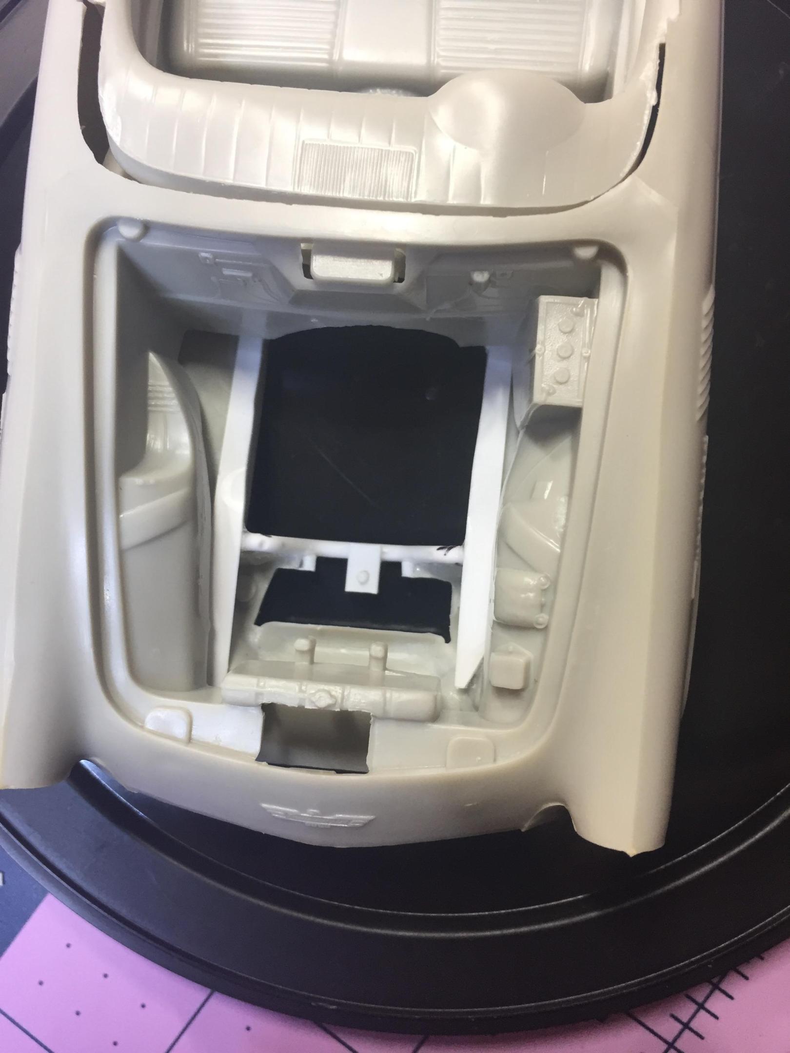

All right, then.....I got in to it today and put the engine together enough for paint. Then I used it to explore how it goes into the frame.  The front portion of the frame is poorly molded and it appears I need to make improvements here.
IMG_6172.thumb.jpg.7139f191cd7febdd5ad3f3c4e7a11006.jpg8

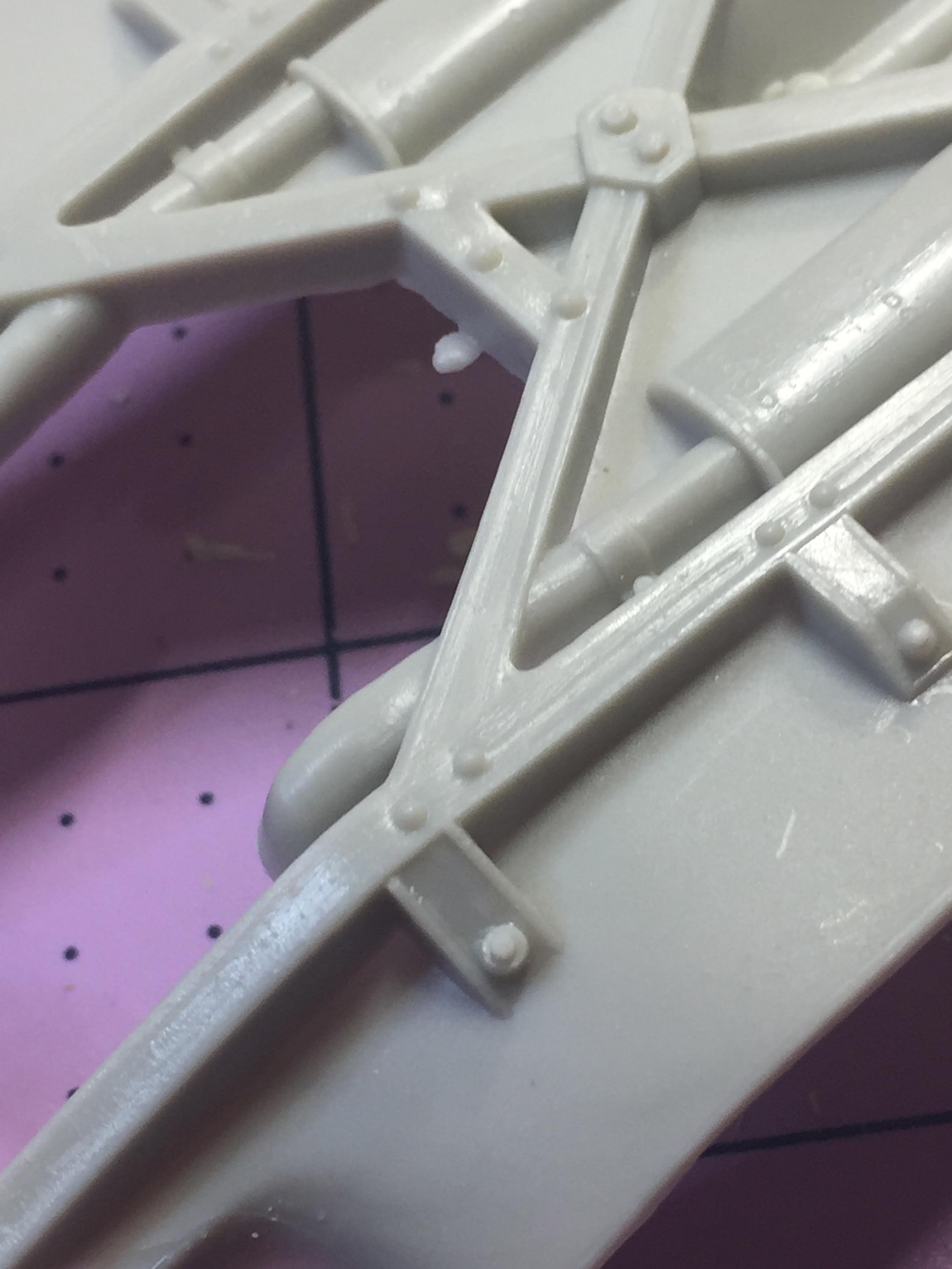

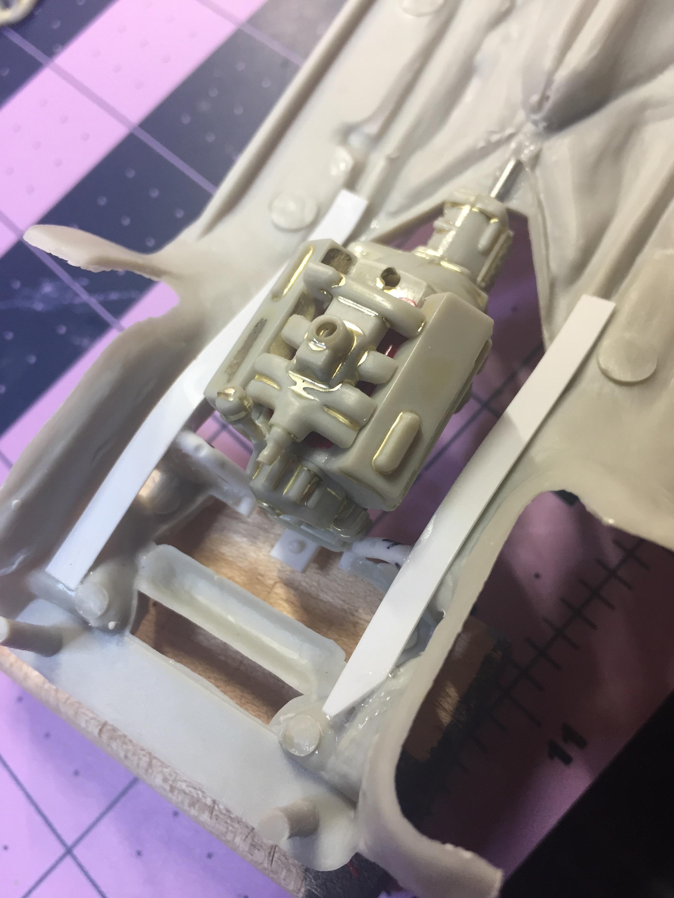

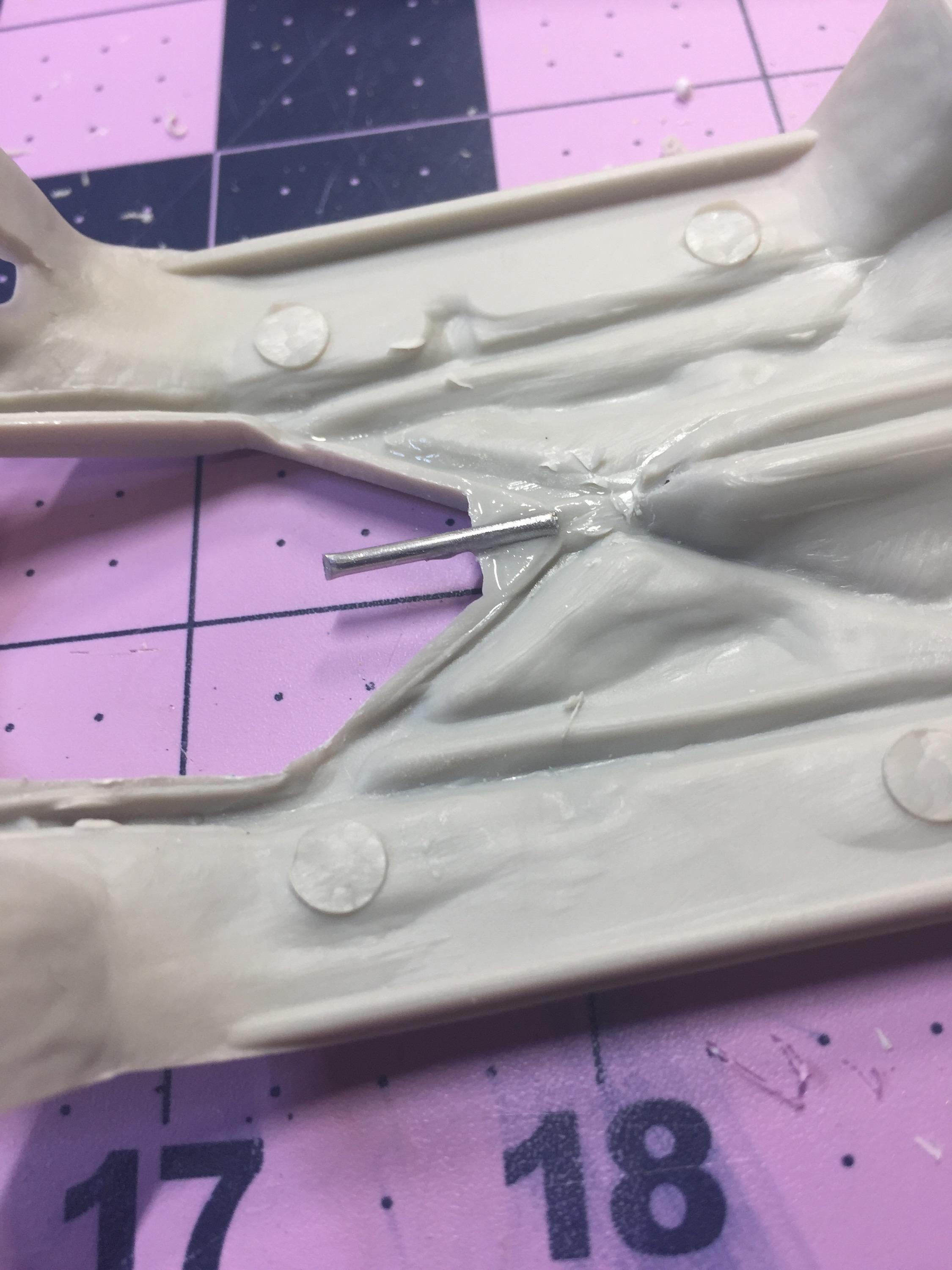

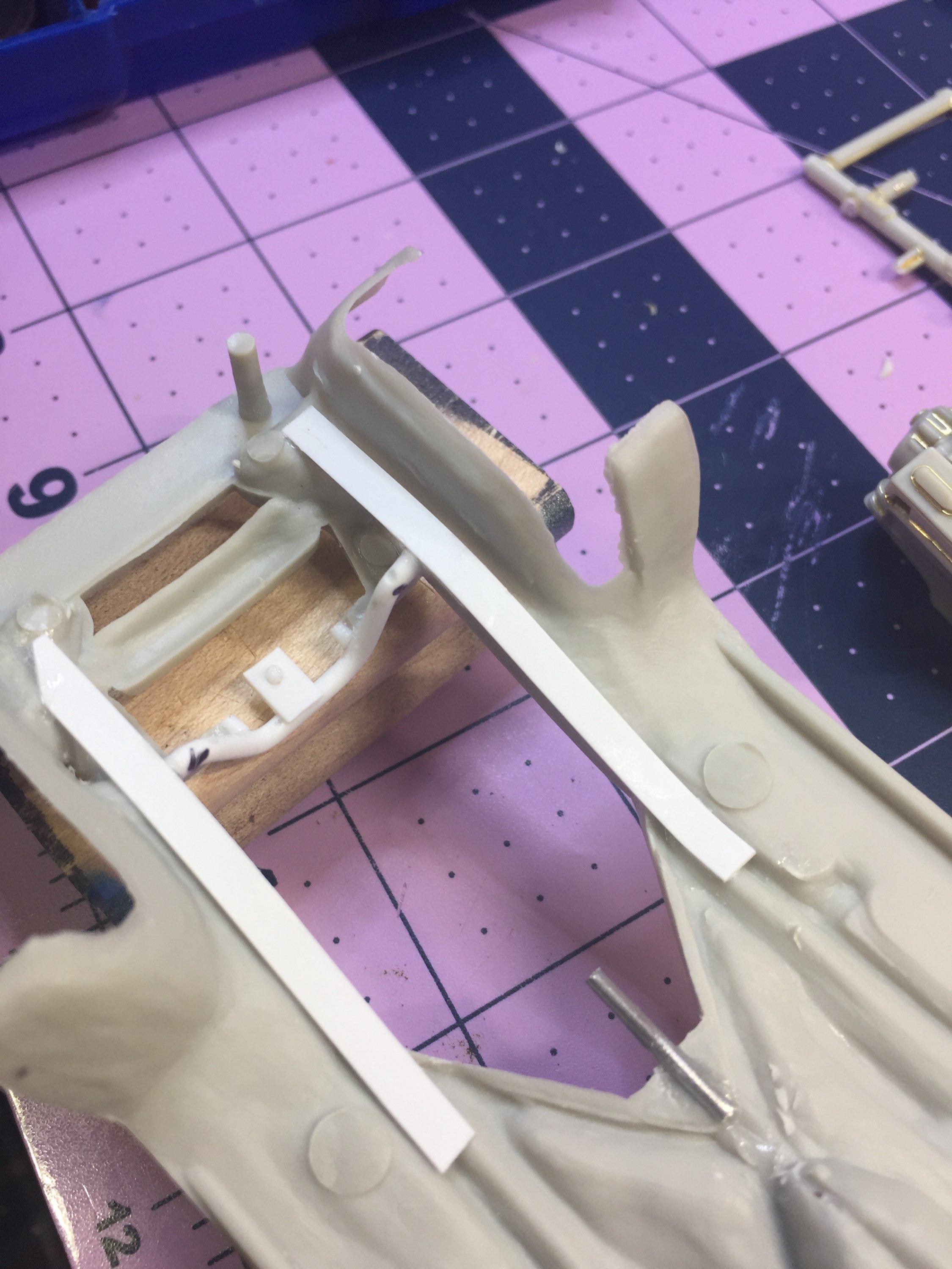

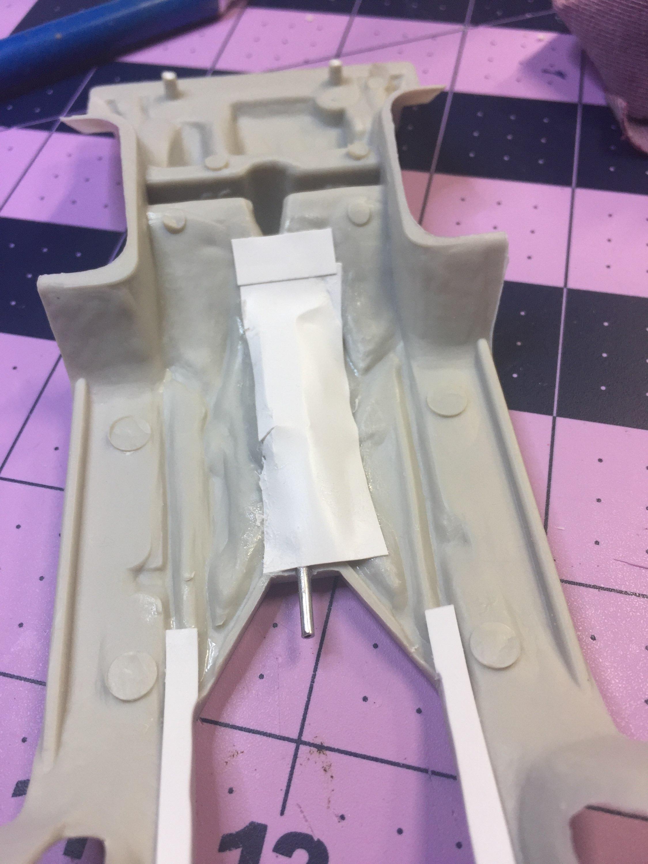

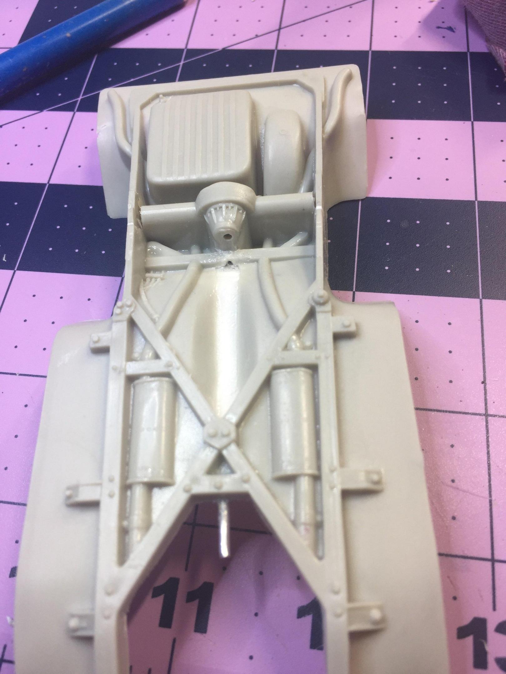

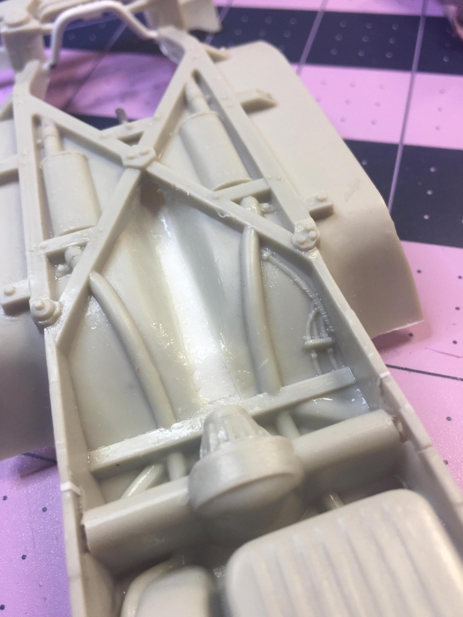

that little ....nipple....didn't seem like it would do the job so I removed it and replaced it with something more positive. I also found the engine would not sit correctly in the frame due to the exhaust pipes on the frame. I removed them. Worry about that later. The front engine mount needed some attention too. I had to consult a photo of a frame in order to replace the less-than-useful mount cross member.
R-71(1).jpg.faffe487a35e7ec77aeff9b9a20adf09.jpgIMG_6175.thumb.jpg.be3a9c5026404804f90eaf81b1e3777c.jpgIMG_6177.thumb.jpg.dd18e026c892e442a82fb580005d1cc5.jpgIMG_6174.thumb.jpg.6e6f409c88114bfd78dd9a1370d7bb3d.jpgIMG_6176.thumb.jpg.793fb5860e5a2c5bc1eb35be37dea90f.jpg

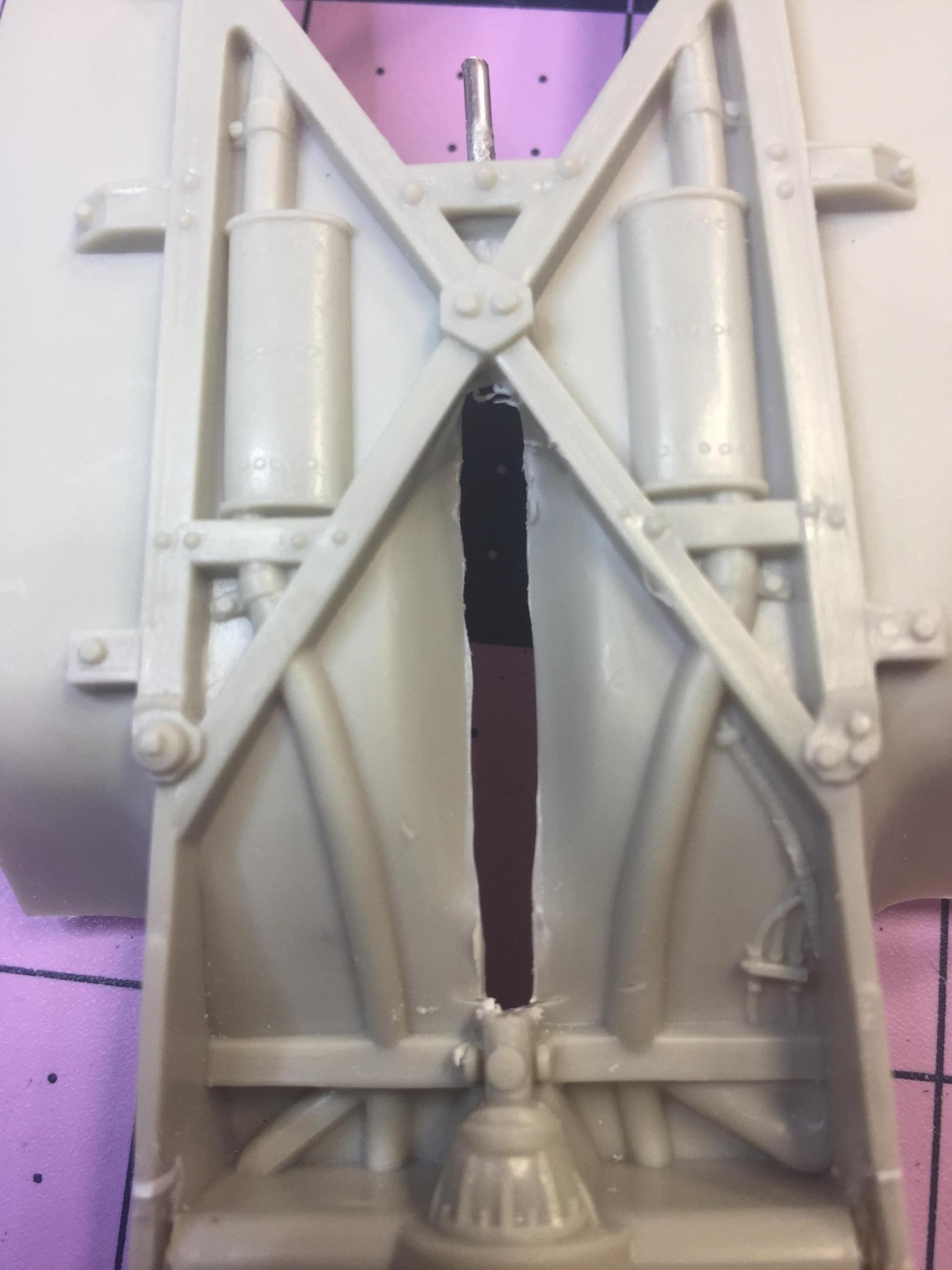

I closed up the frame and replaced the engine mount cross member with one a tad better. .080 styrene rod bent cold. took a few tries. Faked in the lower A frame tie-ins. Good enough!  I'm tempted to cut out the molded drive shaft and put in a real one but I didn't want to get too deep on this one. Just some minor upgrades.  Yeah.

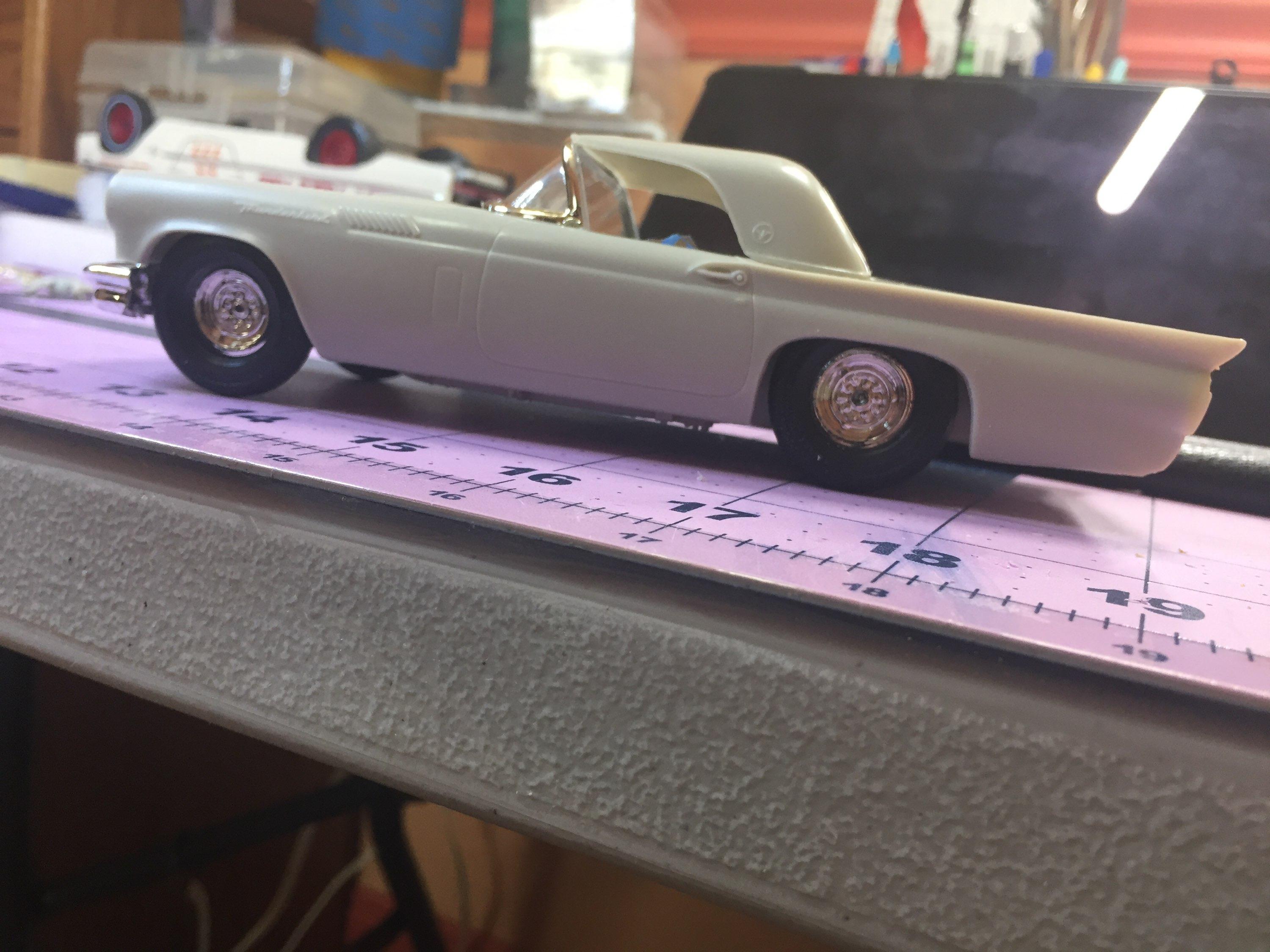

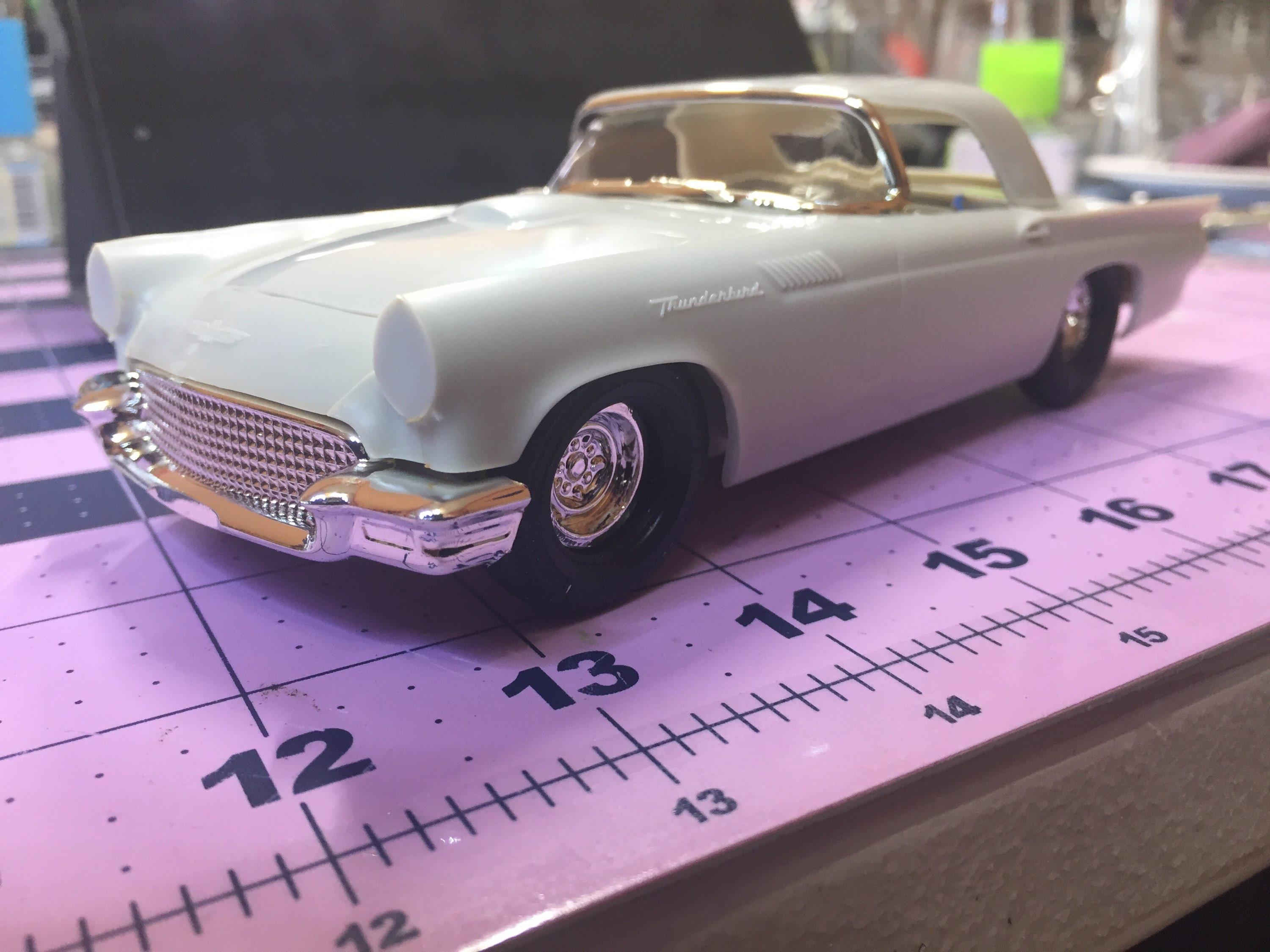

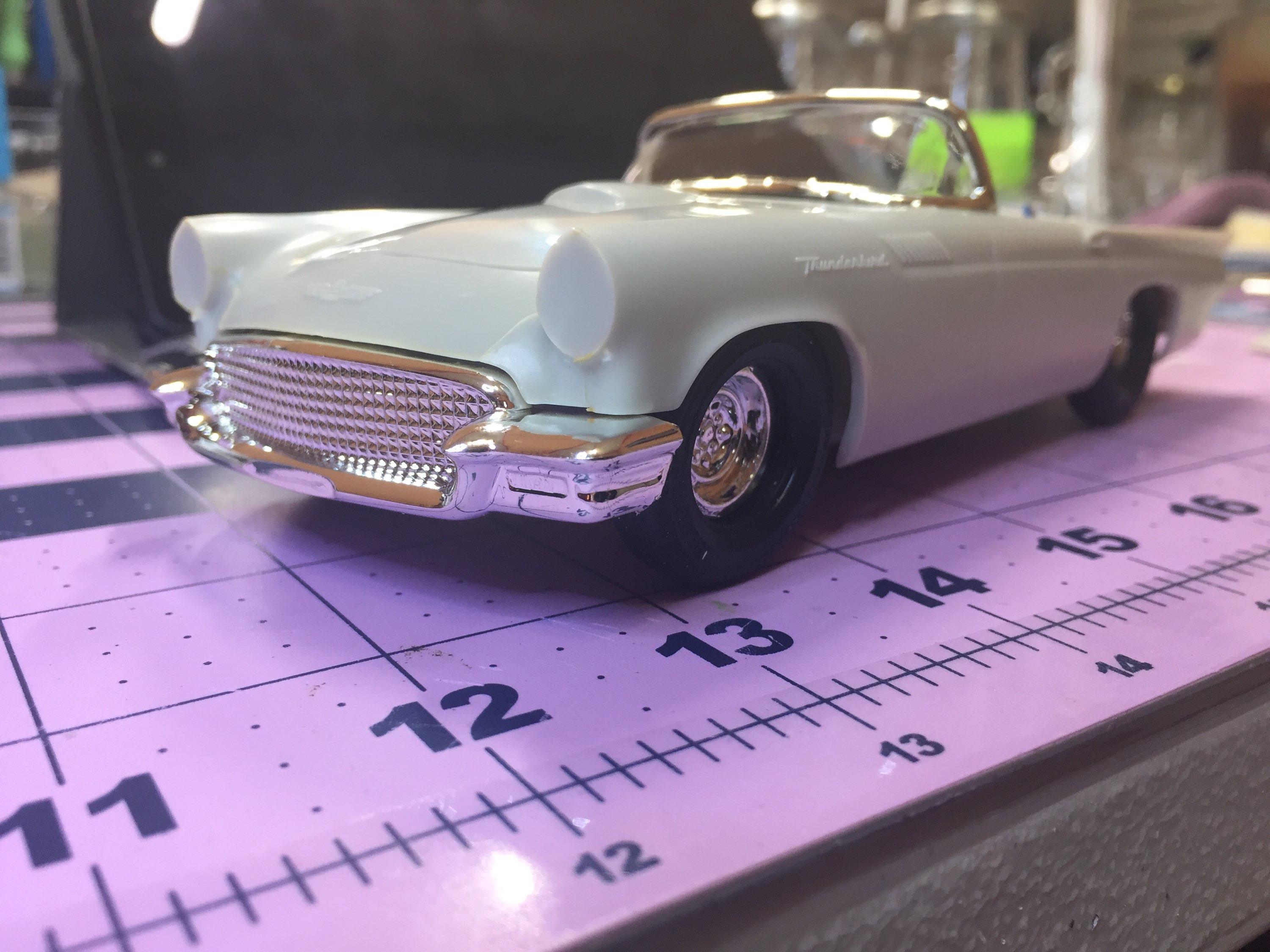

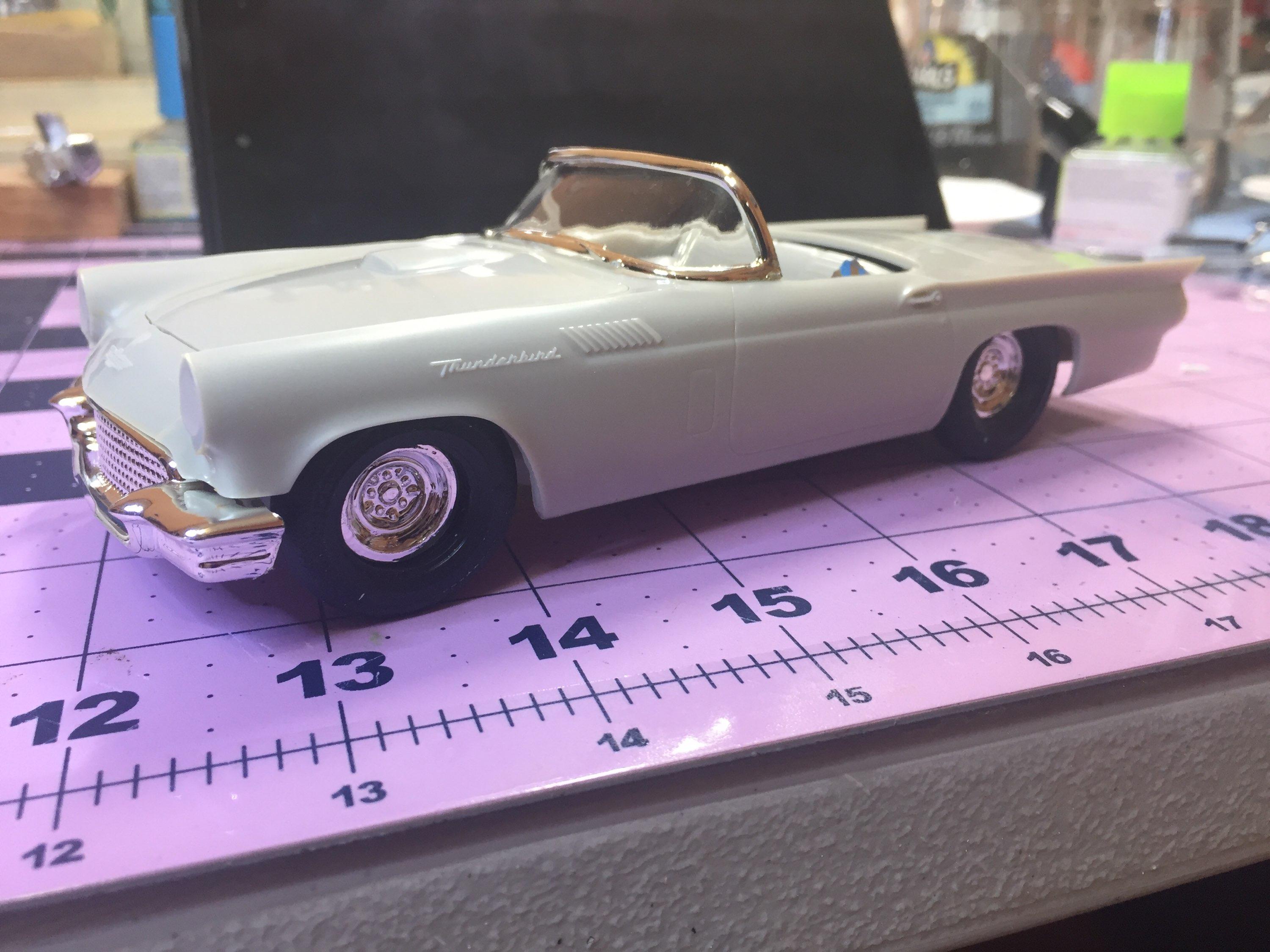

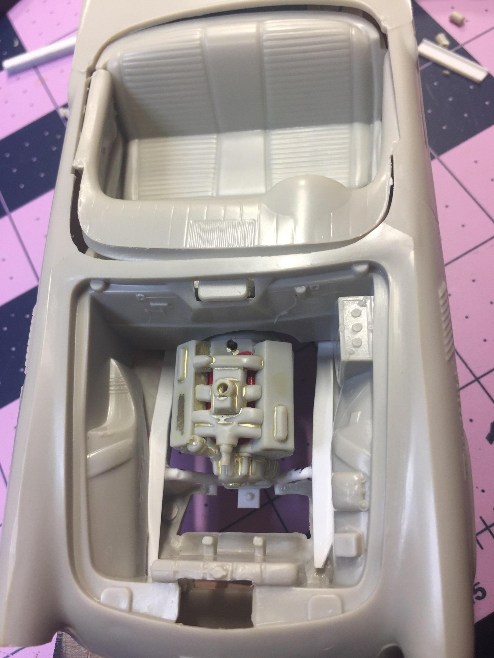

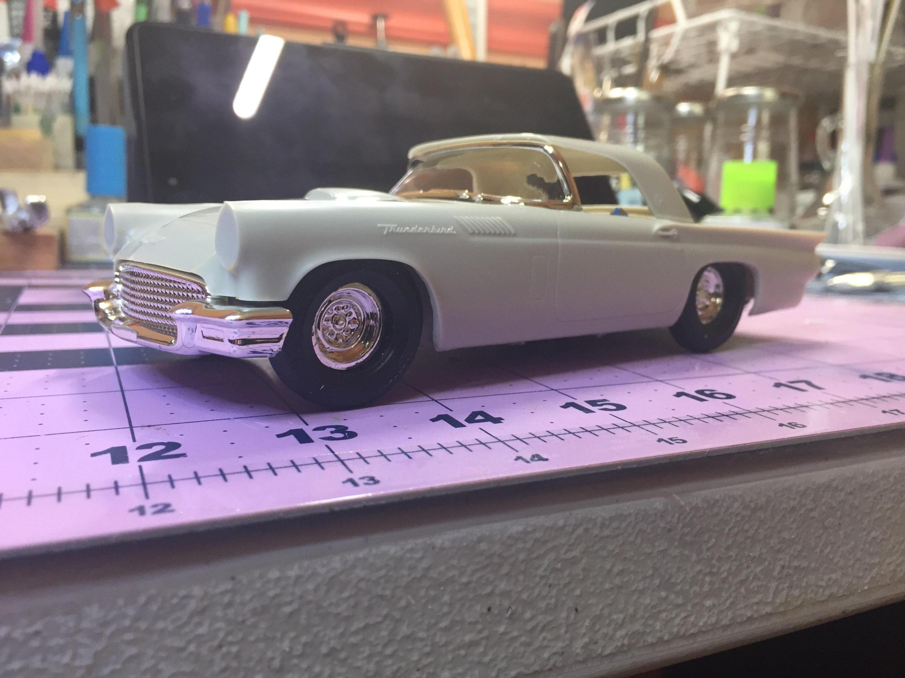

How about a mock-up?
IMG_6182.thumb.jpg.a3b22b34a454ae3a0fe05d845f5277a6.jpgIMG_6181.thumb.jpg.b36bab7c7ac8889f163f4b8c760ce12e.jpg
the ride height has been lowered but not because it was AMT's idea. Earlier in this thread I asserted the ride height was adjustable.  Nope. Not true. But it is easily done by drilling a few holes. I think it makes the tires look too big. White walls would help. Gotta look in my stash.
IMG_6180.thumb.jpg.ccdfc4baf08af00155e1f9b695c140d6.jpgIMG_6179.thumb.jpg.f77c3286a3ec74d307018a99b79ba788.jpgIMG_6178.thumb.jpg.3515088a03e757fee37693695dce0711.jpg
