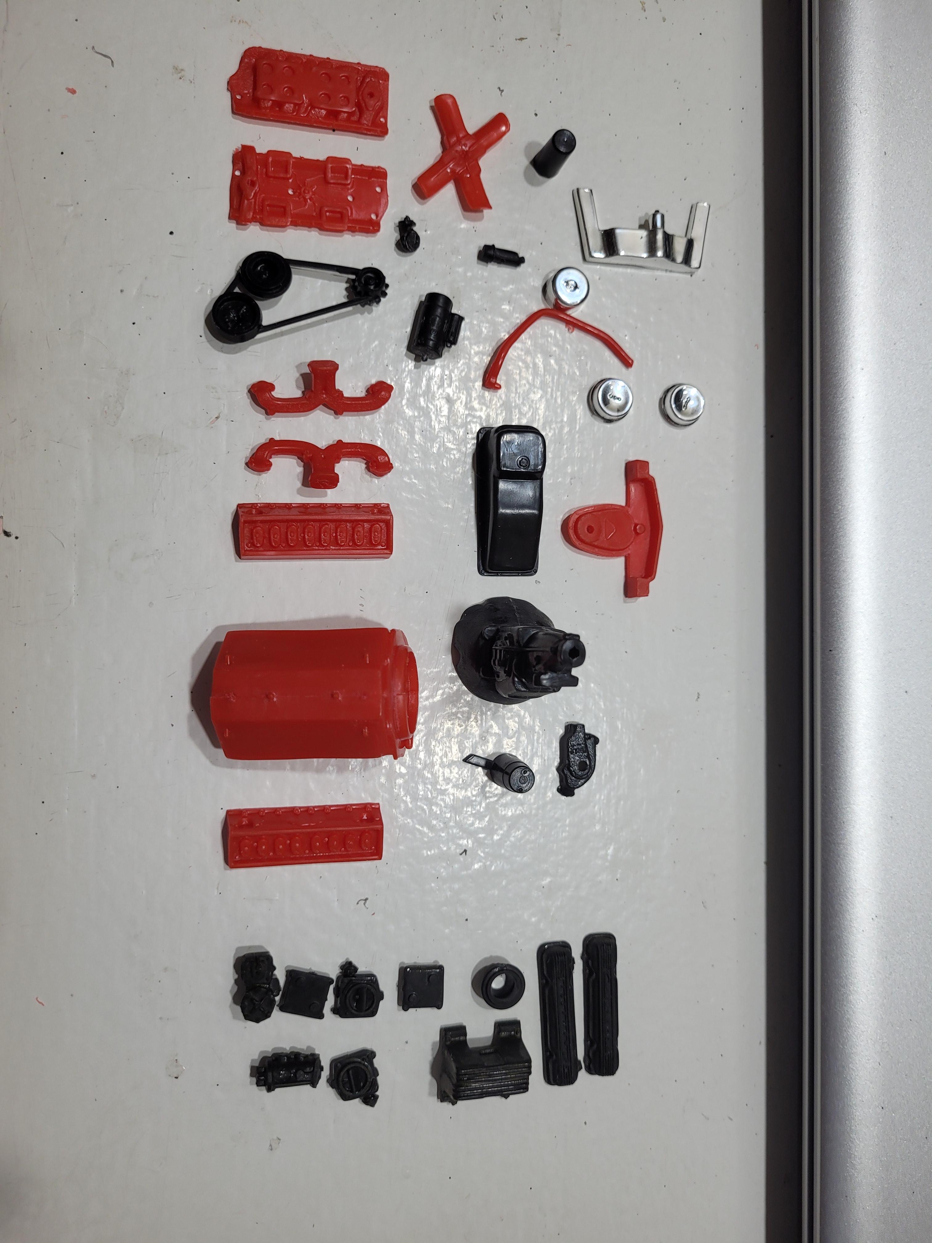

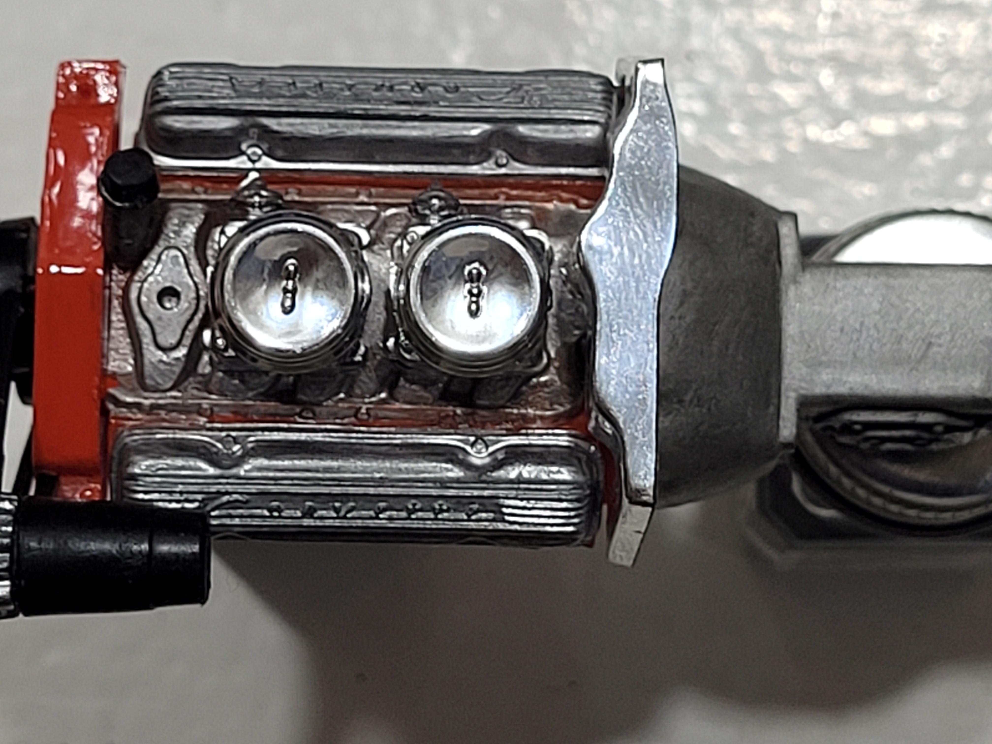

kenlwest Posted July 9, 2024 Author Posted July 9, 2024 Here are all of the engine parts. The black parts on the bottom have had the chrome stripped. The only chrome left are the air cleaner covers, and the ignition shield. 1

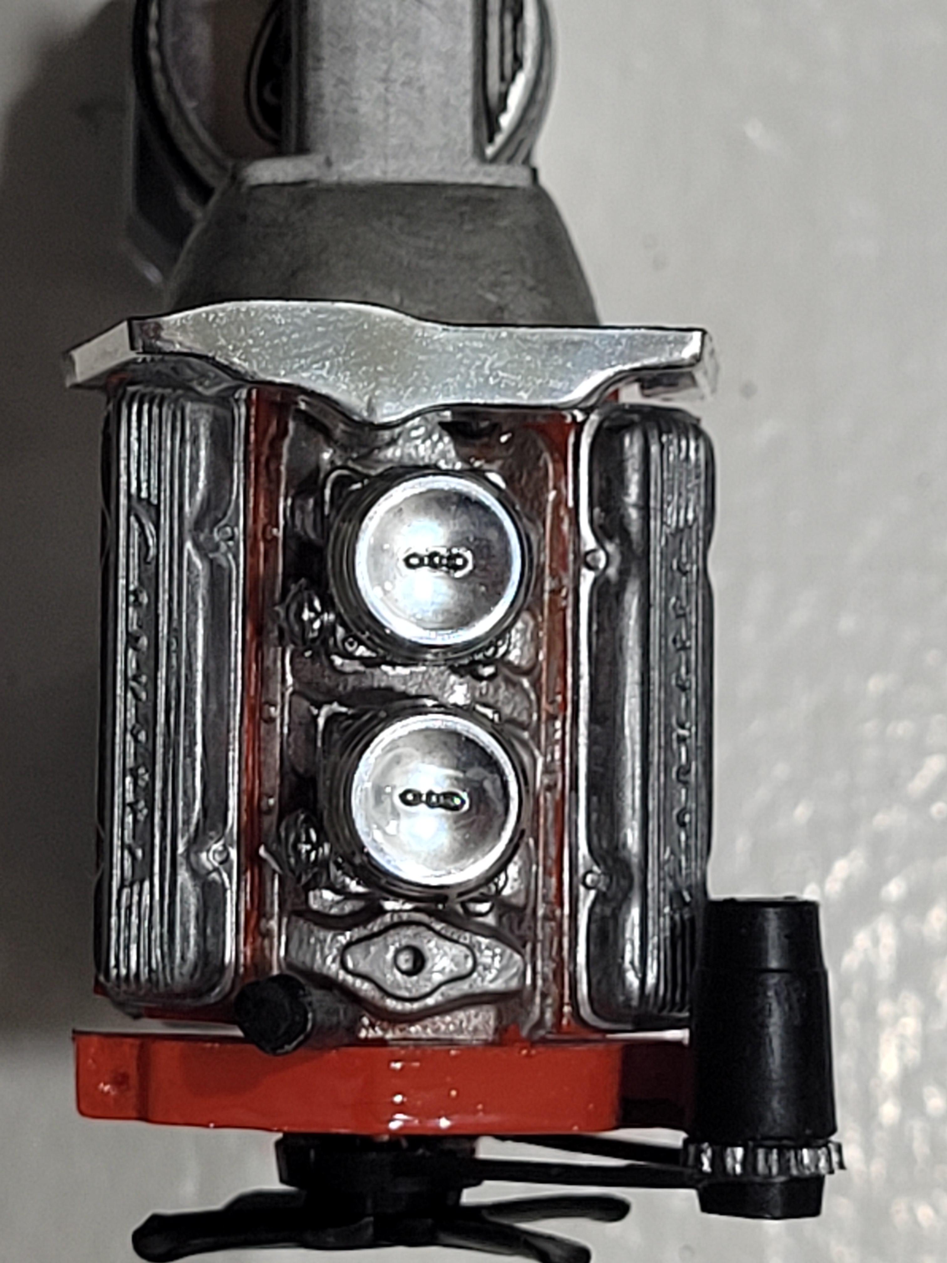

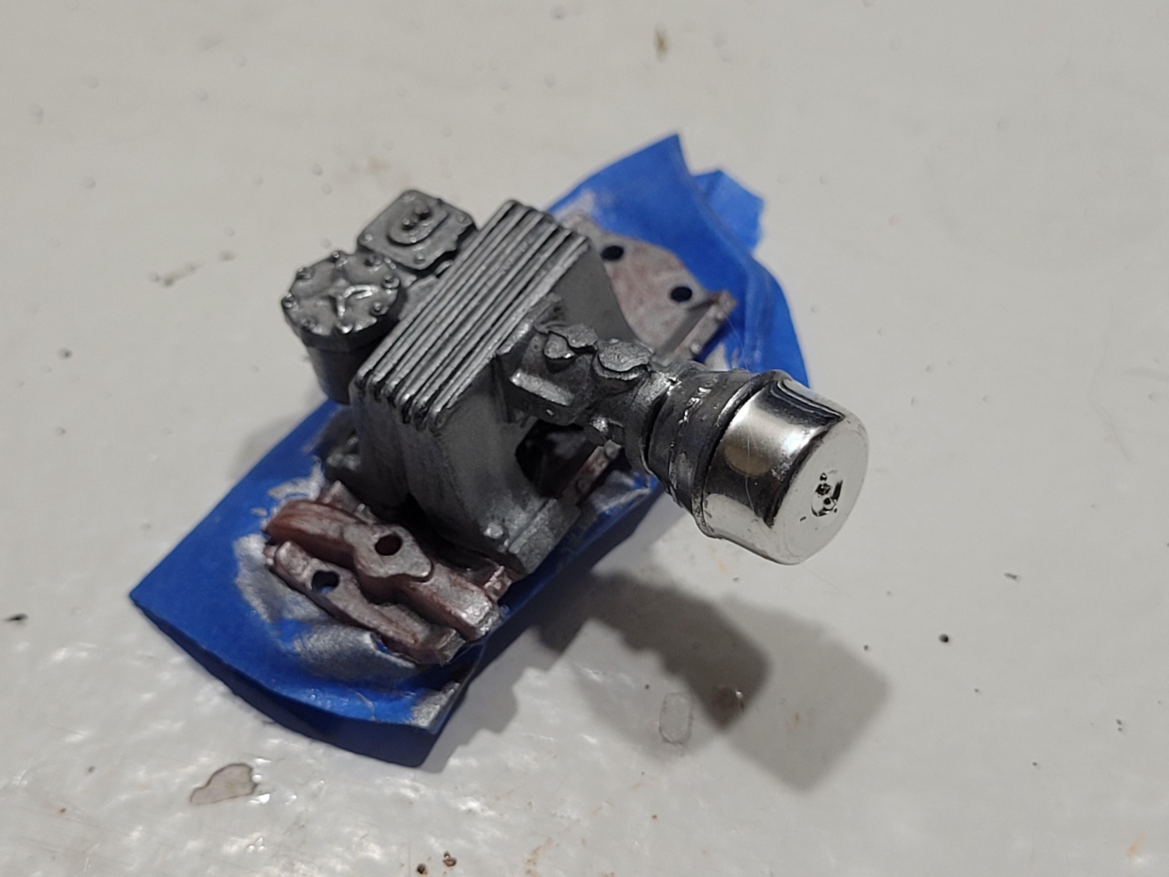

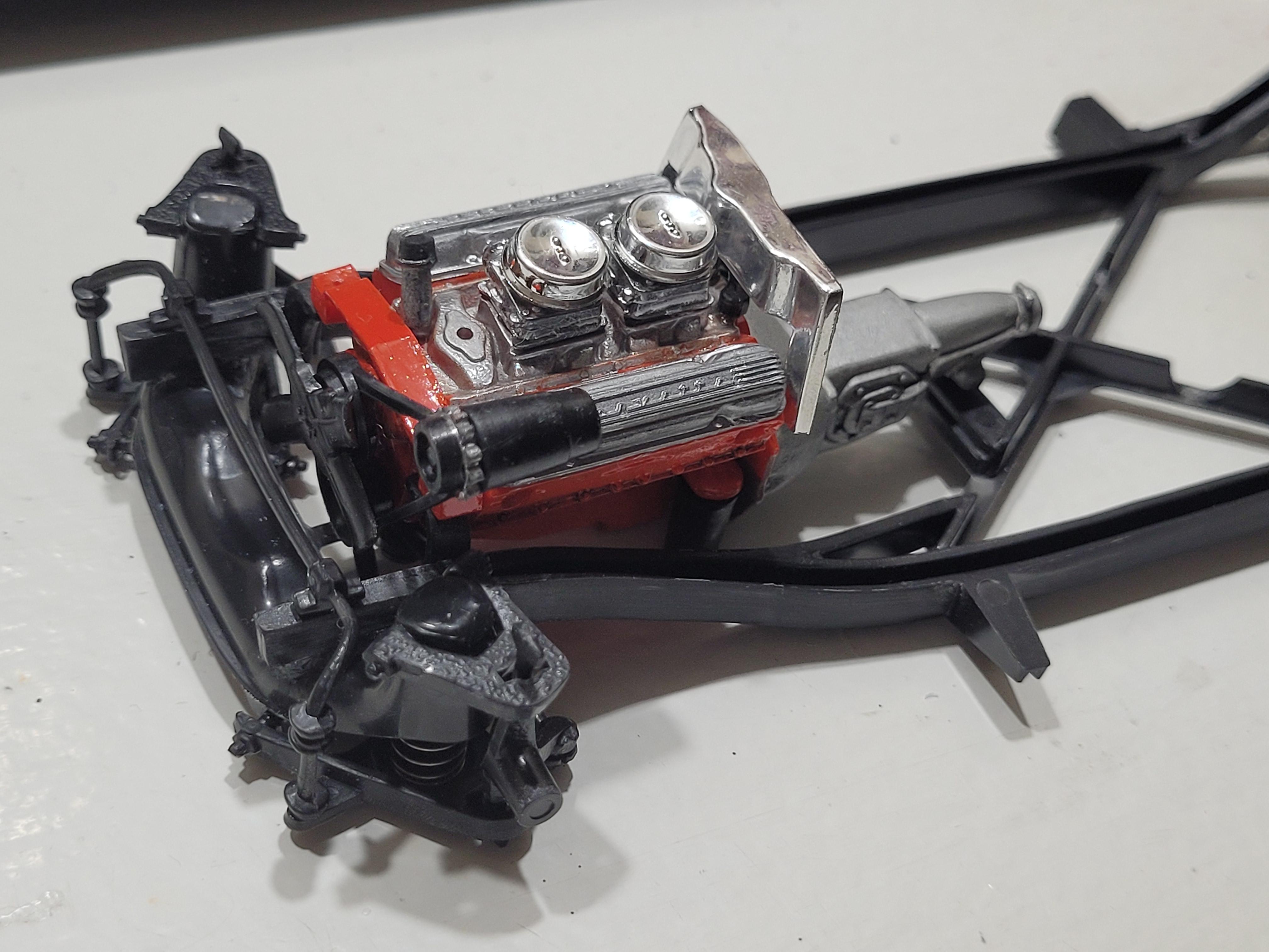

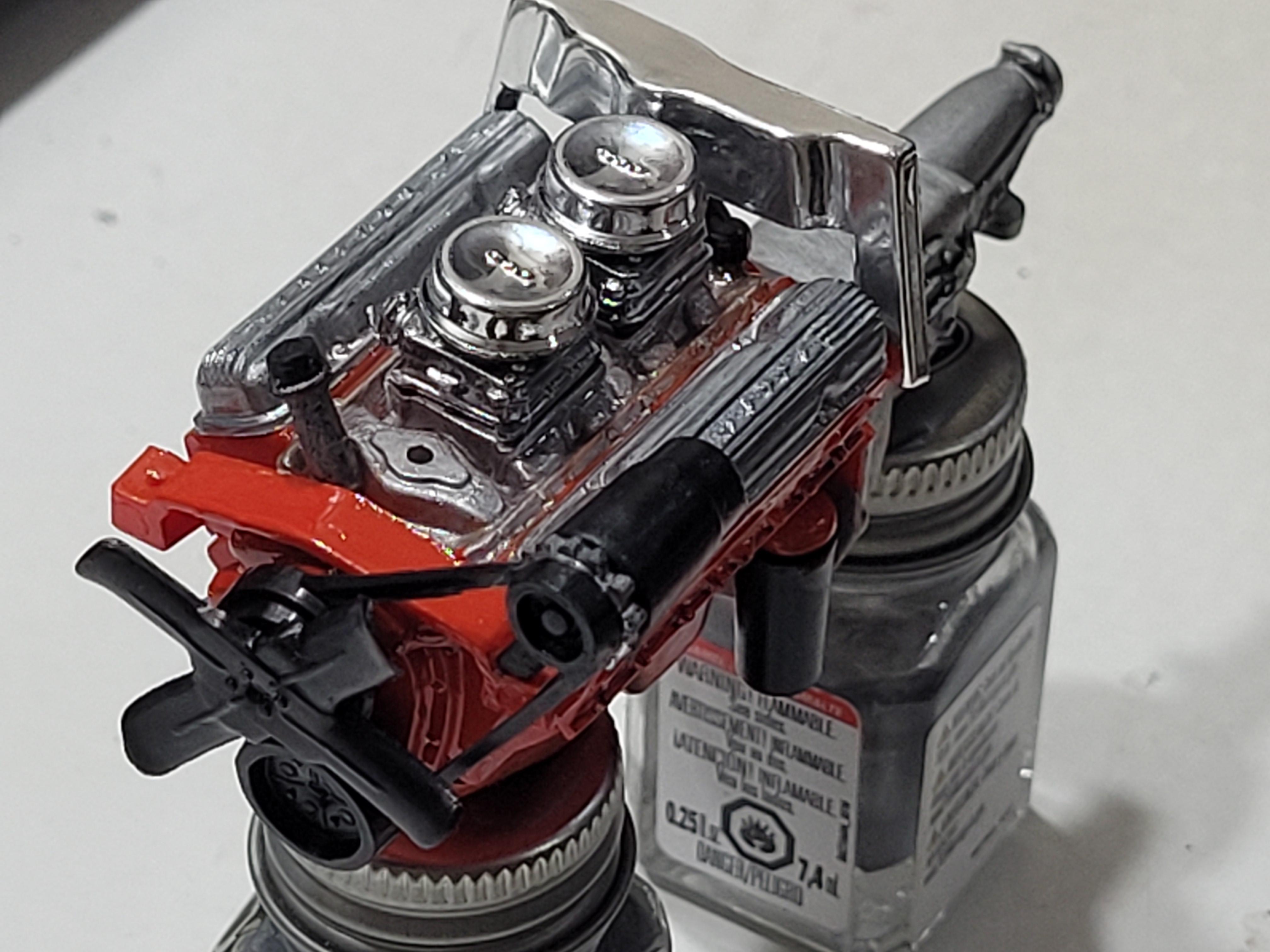

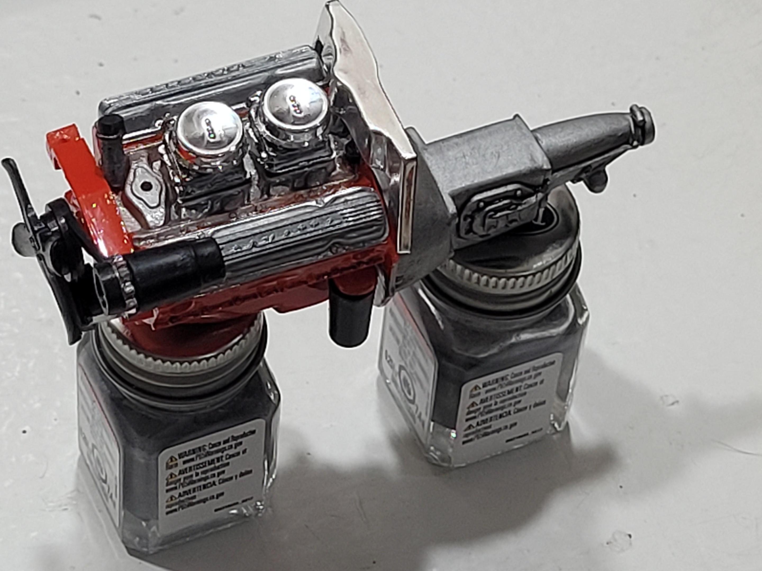

kenlwest Posted July 9, 2024 Author Posted July 9, 2024 I was able to move the RH head rearward to create the offset to more depict the real engine. To do this, I had to trim out some of the ignition shield. Later I will have to shorten the RH exhaust pipe. Other than that, I am happy with the engine. I also built the fuel injection version of the intake, although I won't be using it. 4

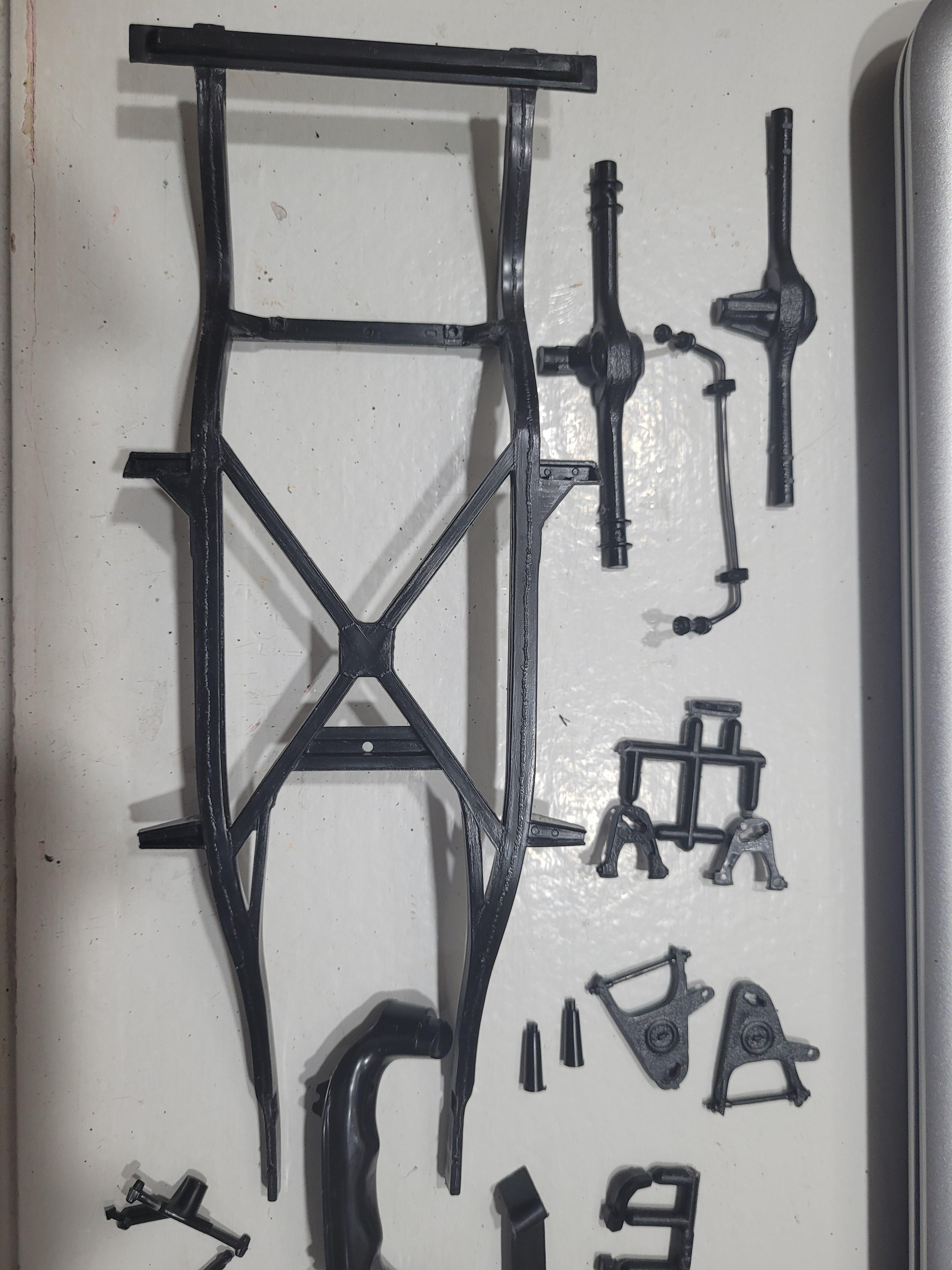

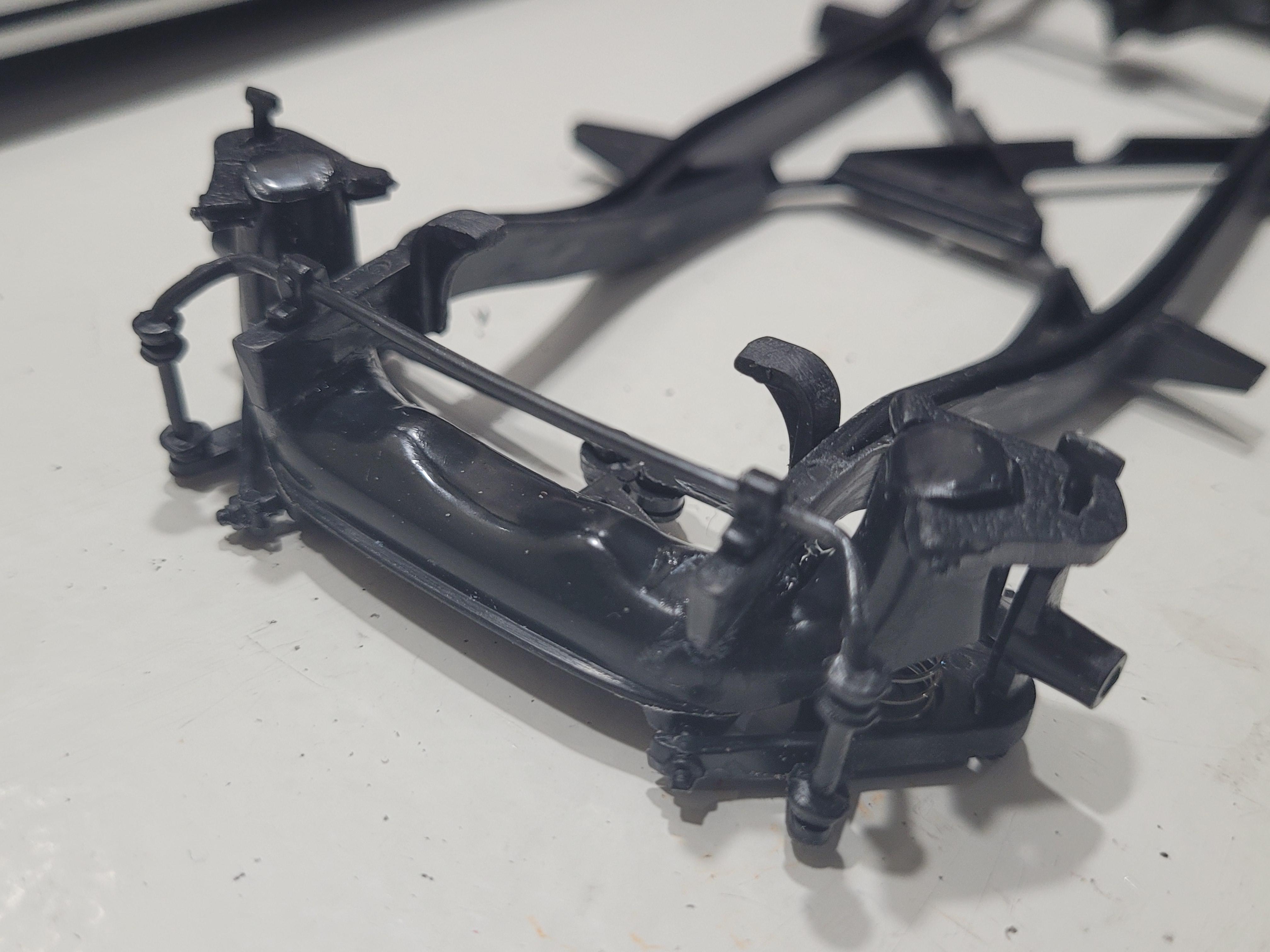

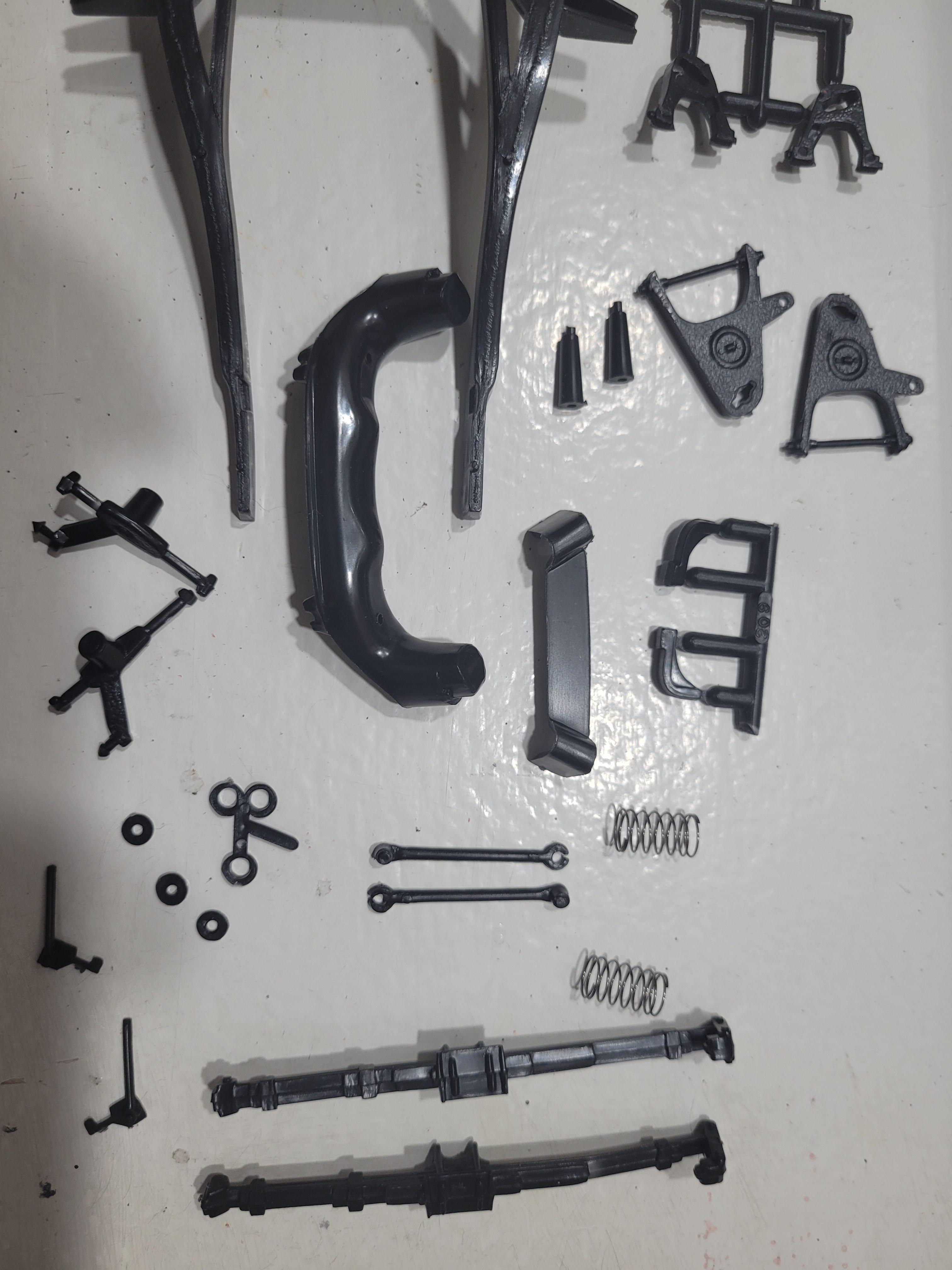

kenlwest Posted July 10, 2024 Author Posted July 10, 2024 The frame and chassis components are actually pretty good. Here are the parts before cleanup. 1

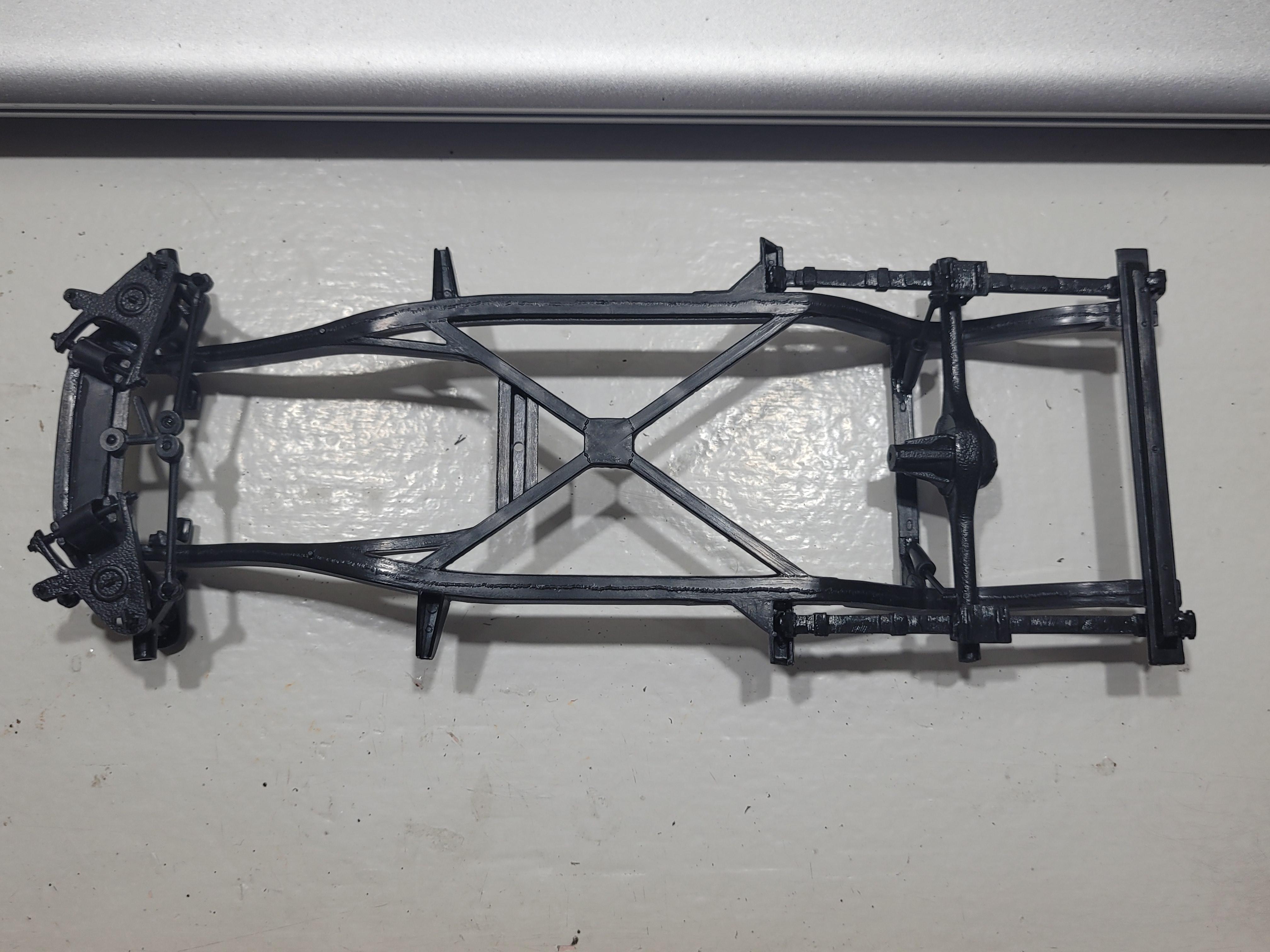

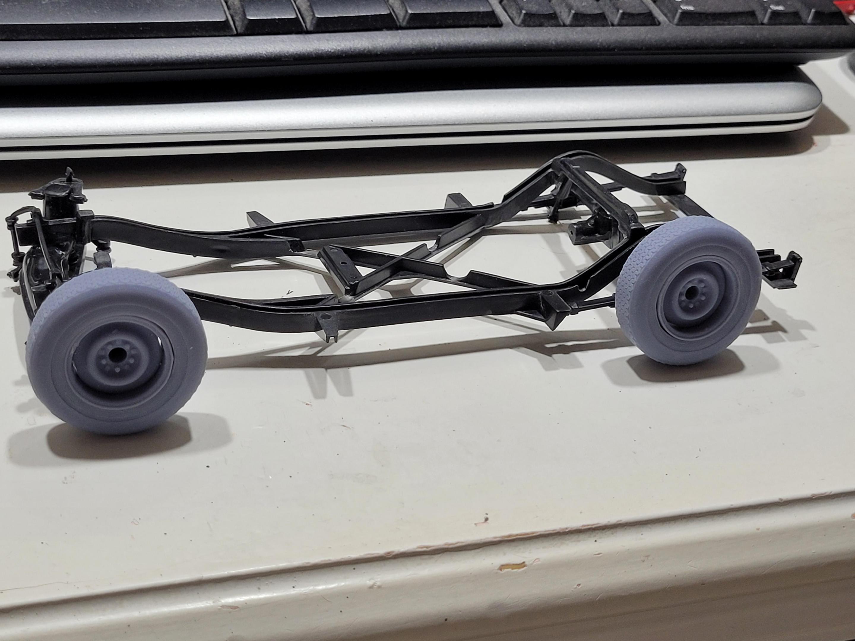

kenlwest Posted July 10, 2024 Author Posted July 10, 2024 The frame and chassis assembly prior to painting. I had to twist and torque the frame quite a bit to straighten it to an acceptable state. Overall it goes together well. I will have to see if I can keep the front articulated suspension in place after final assembly, depending on the stance. If the front wheels do not sit vertical and parallel, I will permanently fuse everything together. 1

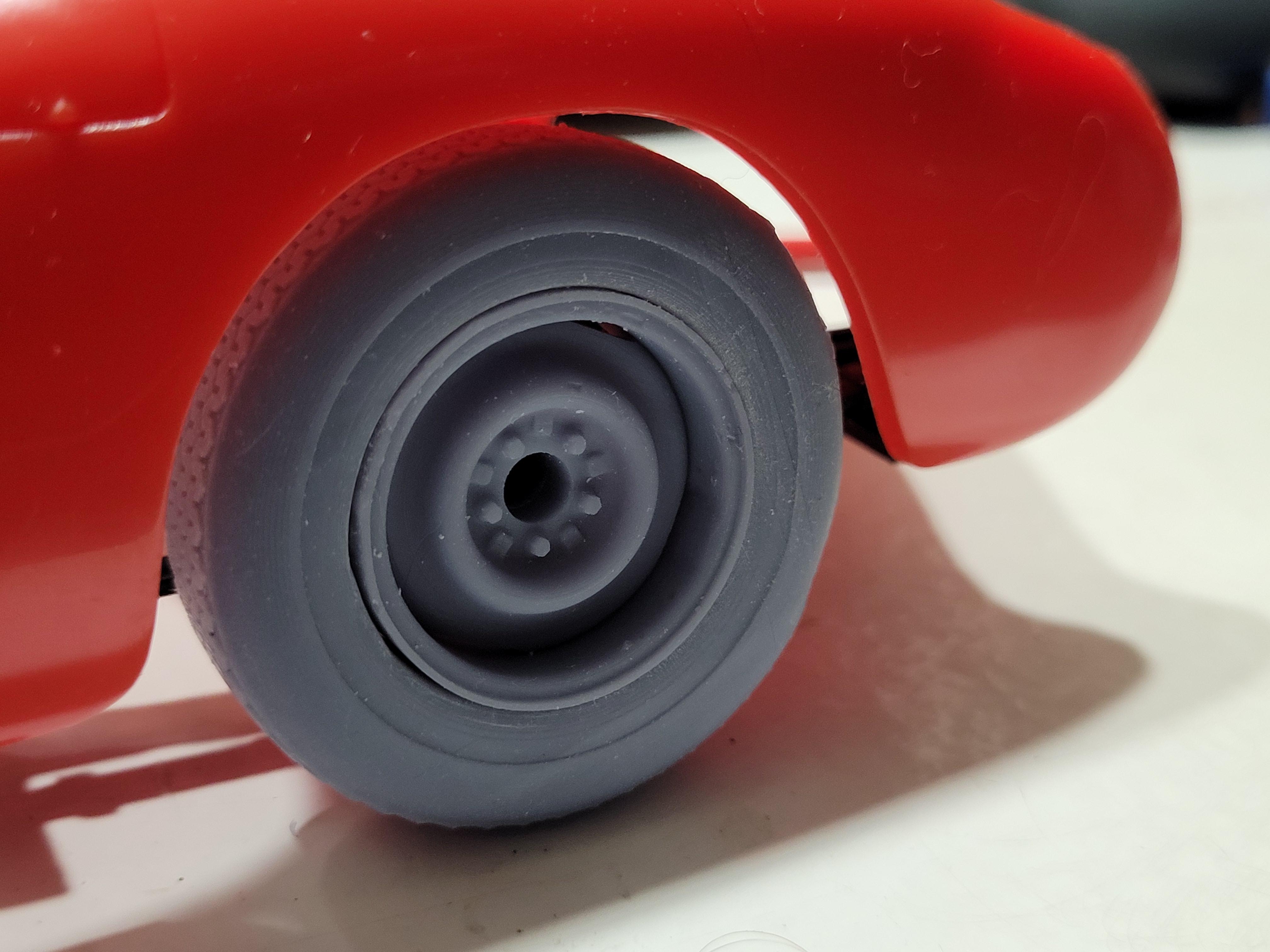

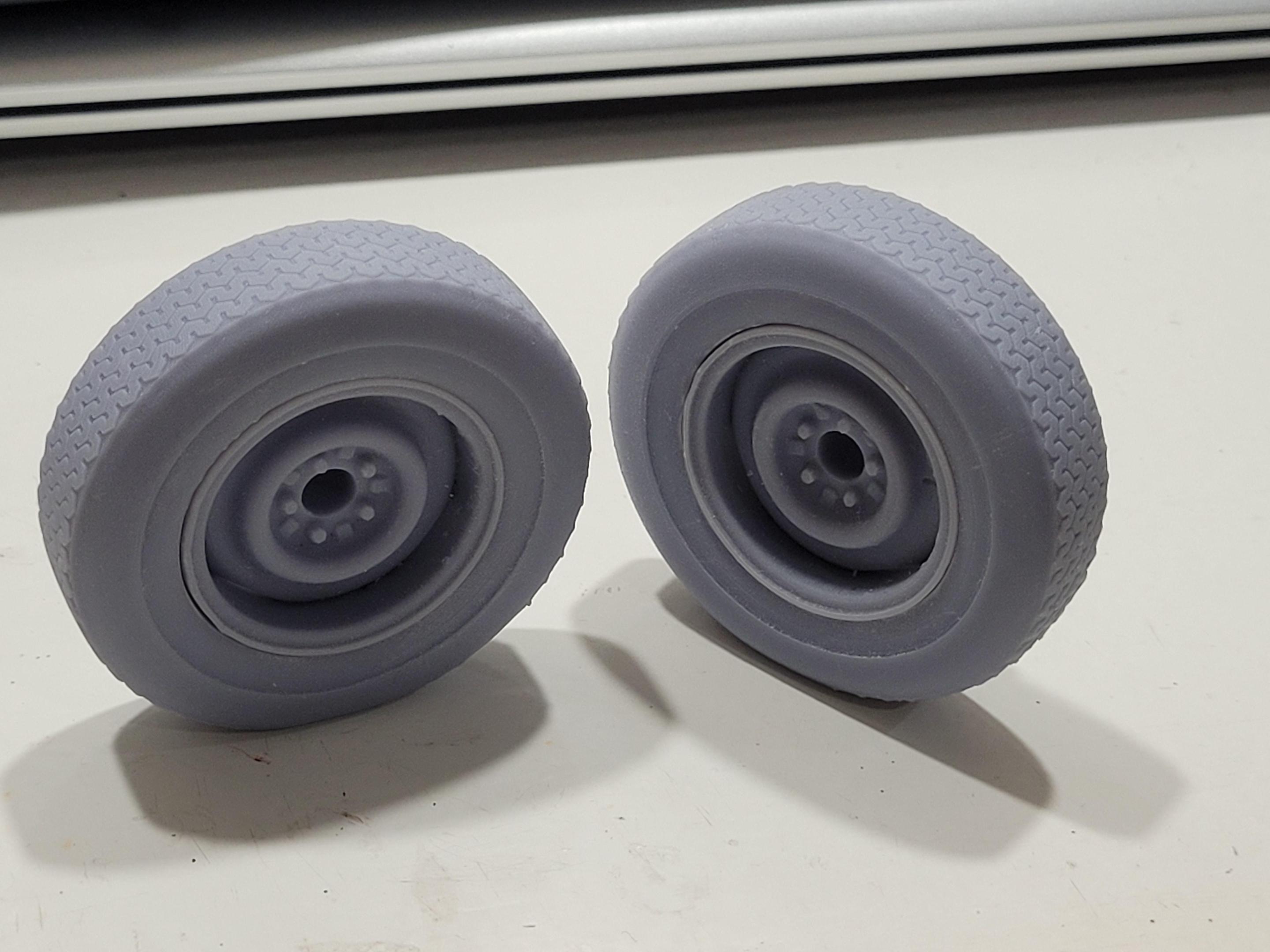

kenlwest Posted July 11, 2024 Author Posted July 11, 2024 I printed the wheels and tires. BUT, somehow they were printed at 1/12 scale. 1/12 is my usual scale, and setting up the printing gcode at 11:30 pm was probably not a good idea. I am happy with the design, but I just need to scale down to 1/16 and reprint them. 1
kenlwest Posted July 11, 2024 Author Posted July 11, 2024 Tires and wheels are printed. I staged the left hand wheels on the chassis, then placed the body on top just to verify correct wheelbase. The detents on the tires are where the whitewalls will be painted. 2

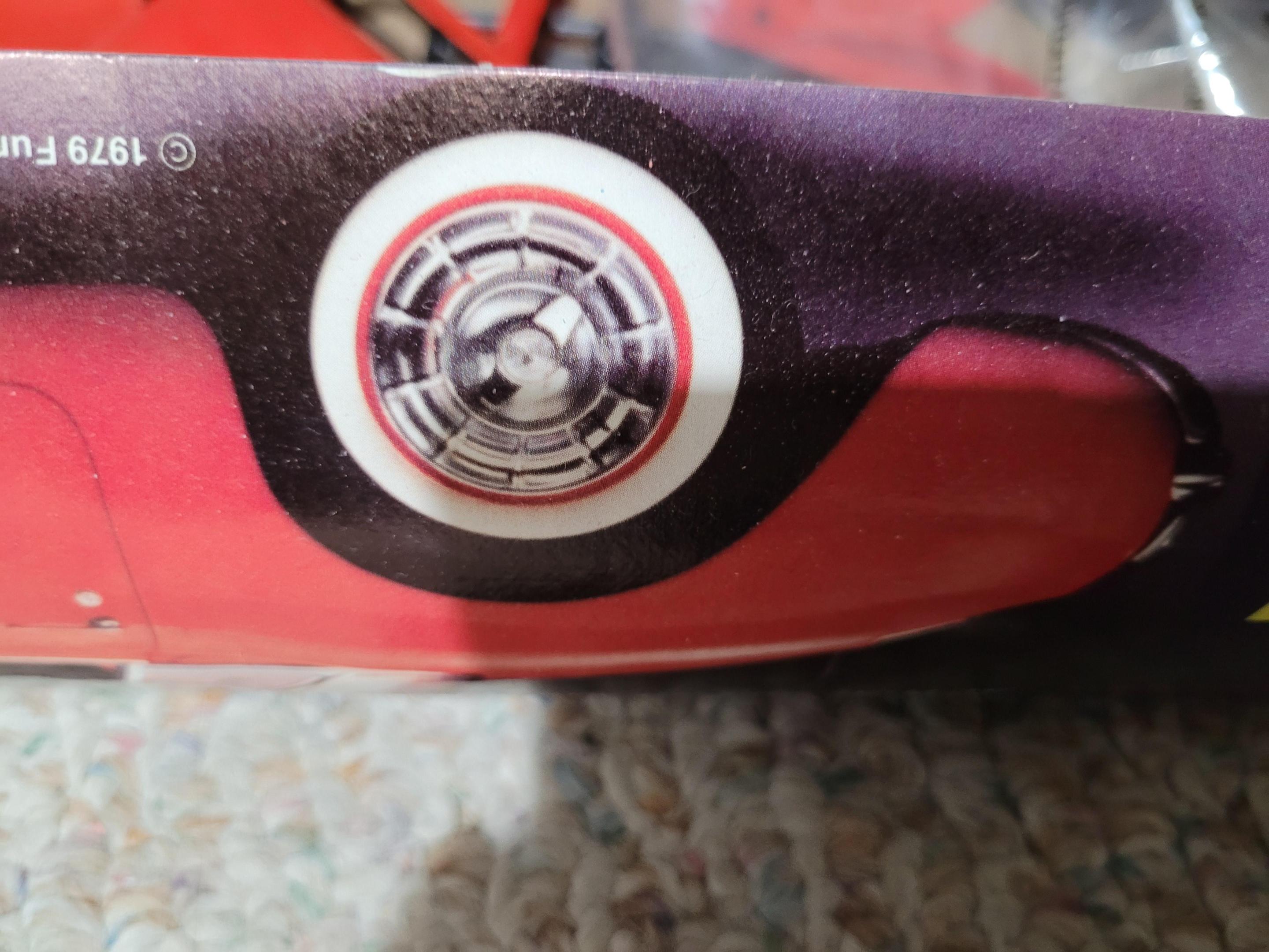

kenlwest Posted July 11, 2024 Author Posted July 11, 2024 The tire ww's were modeled after the box art tires on the real car. The wheels were modeled exactly as the kit wheels, except I narrowed them to the correct width. This is so that the kit's hubcaps would fit perfectly. 1

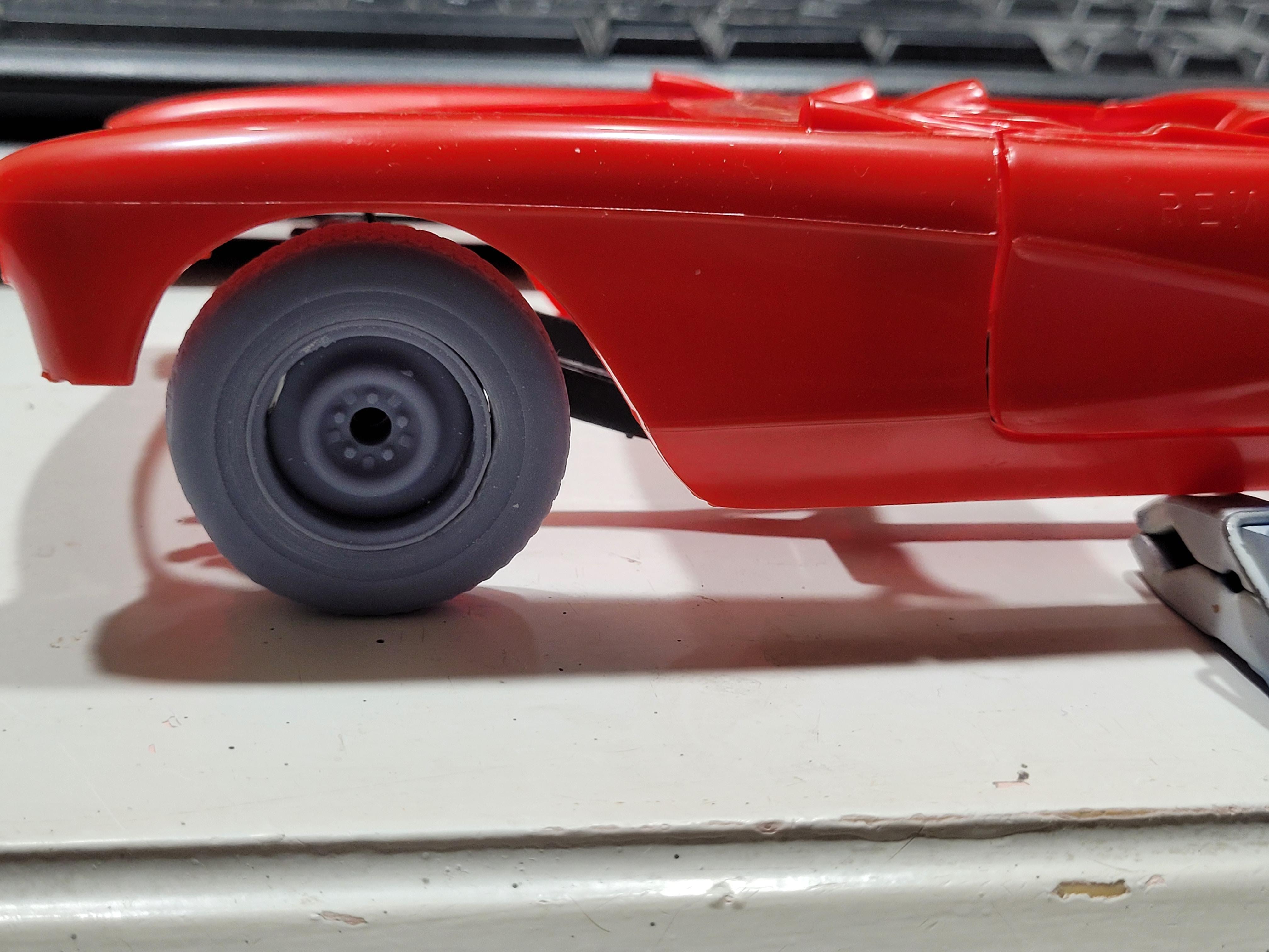

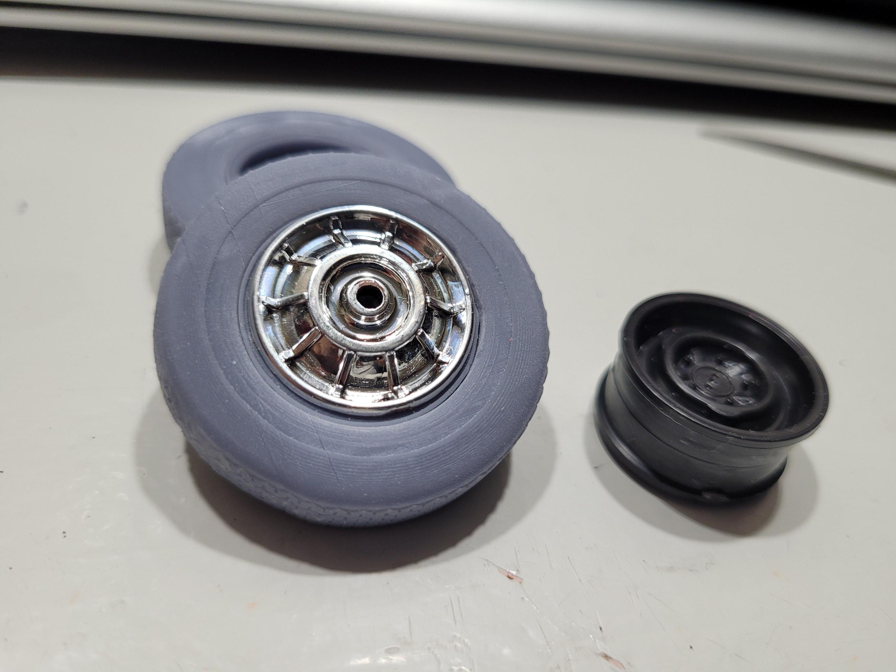

dino246gt Posted July 12, 2024 Posted July 12, 2024 Great tires and wheels, in both scales, 1/12th and 1/16th! Ya gotta get those wheel covers set deeper into the rims though, agree?
kenlwest Posted July 12, 2024 Author Posted July 12, 2024 (edited) 1 hour ago, dino246gt said: Great tires and wheels, in both scales, 1/12th and 1/16th! Ya gotta get those wheel covers set deeper into the rims though, agree? Yes, maybe a millimeter or so. Just need to decide whether to grind the rims or reprint modified wheels. Leaning toward reprinting. I appreciate the feedback - nudges me to do what needs to be done. It seems that many amt and mpc 1/16 subject suffer from this. Edited July 12, 2024 by kenlwest Added comment 1

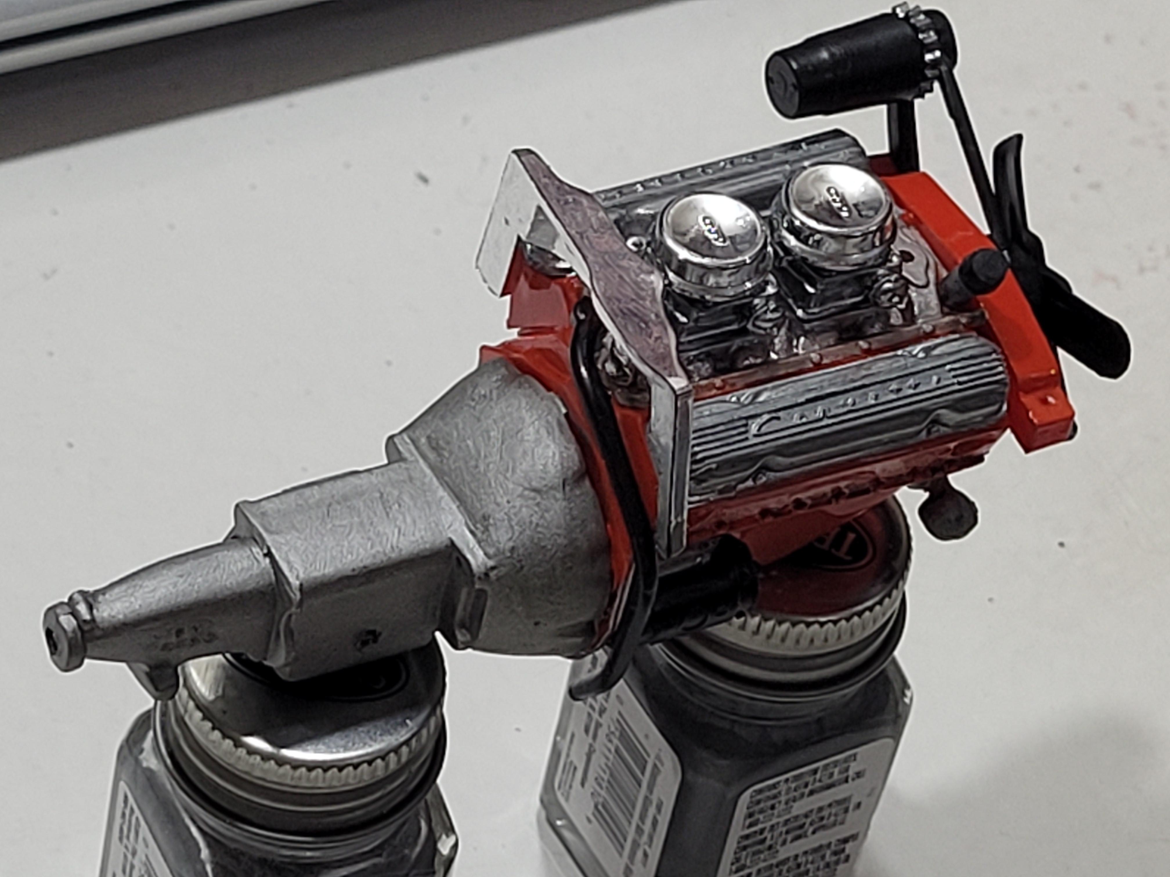

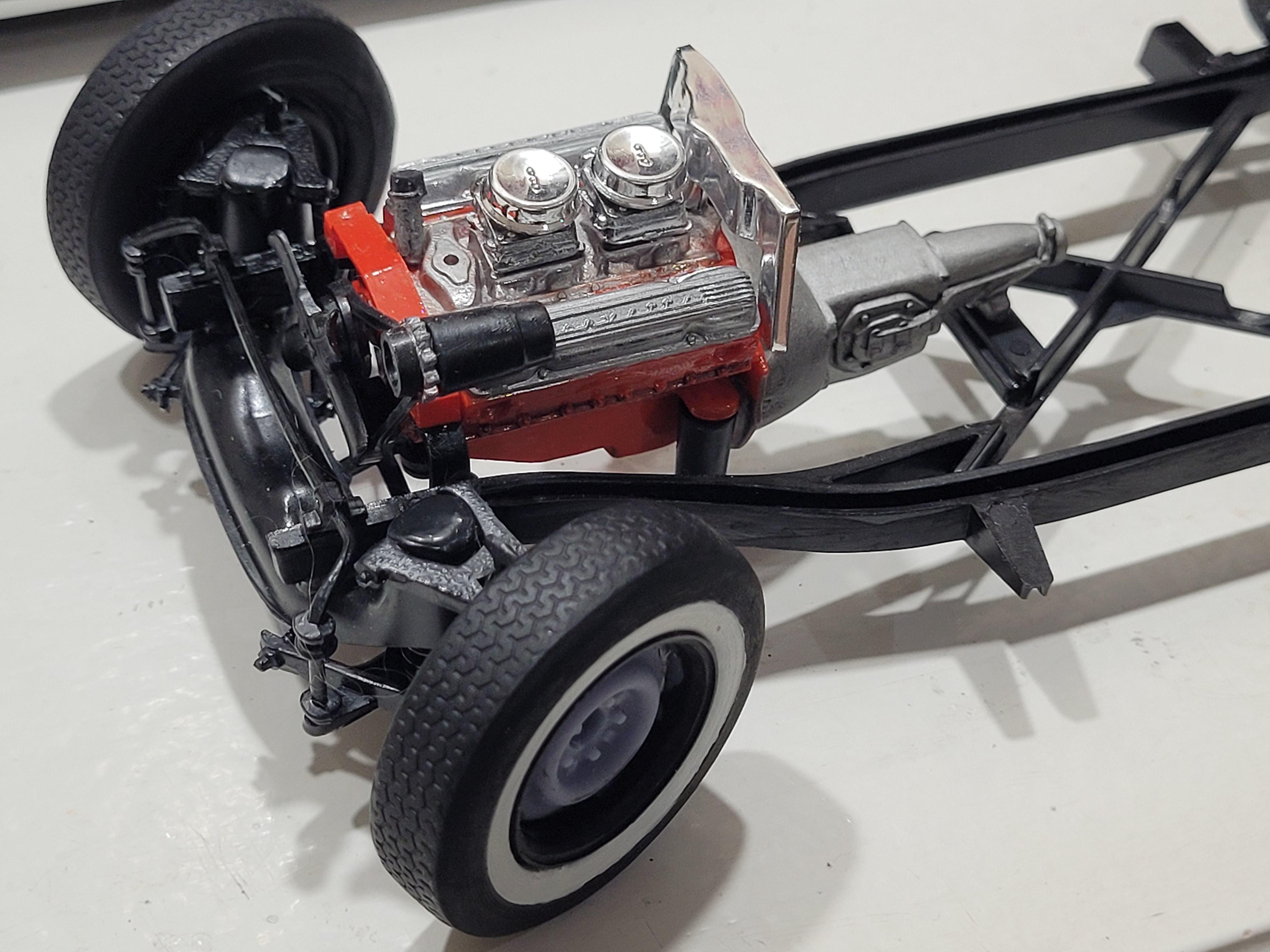

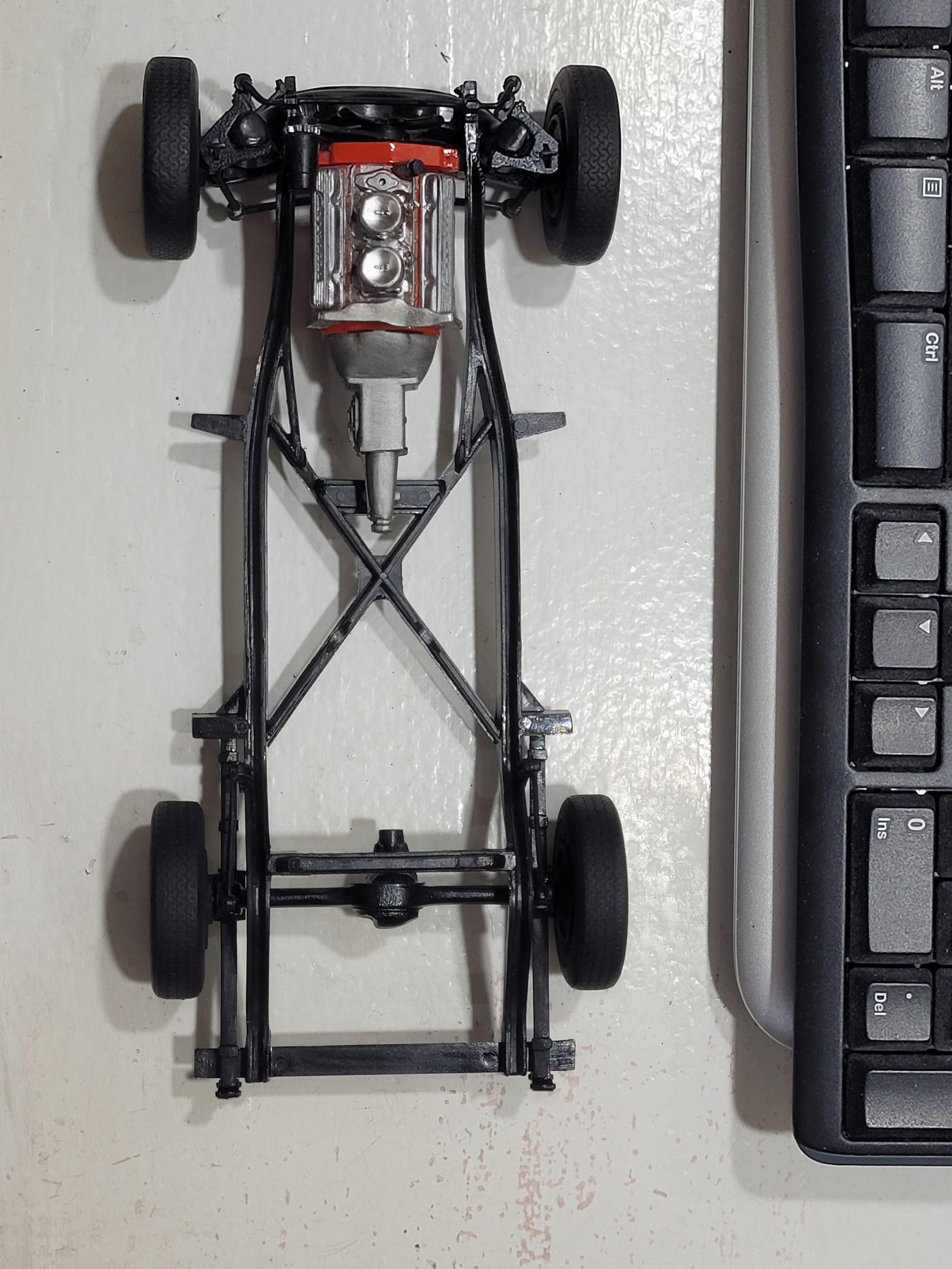

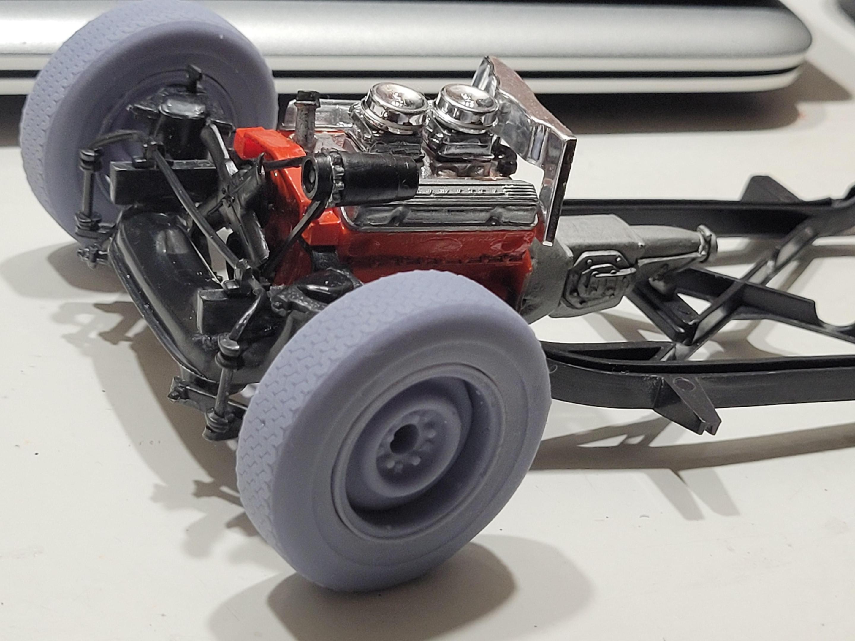

kenlwest Posted July 12, 2024 Author Posted July 12, 2024 The engine sitting in its place. Also looks like the weight and flats on the bottom of the tires are enough to keep the loose parts on the front suspension stable and straight. 2
dino246gt Posted July 12, 2024 Posted July 12, 2024 26 minutes ago, kenlwest said: Yes, maybe a millimeter or so. Just need to decide whether to grind the rims or reprint modified wheels. Leaning toward reprinting. I appreciate the feedback - nudges me to do what needs to be done. It seems that many amt and mpc 1/16 subject suffer from this. Almost all kits, 1/25th included suffer from this! Cheers!

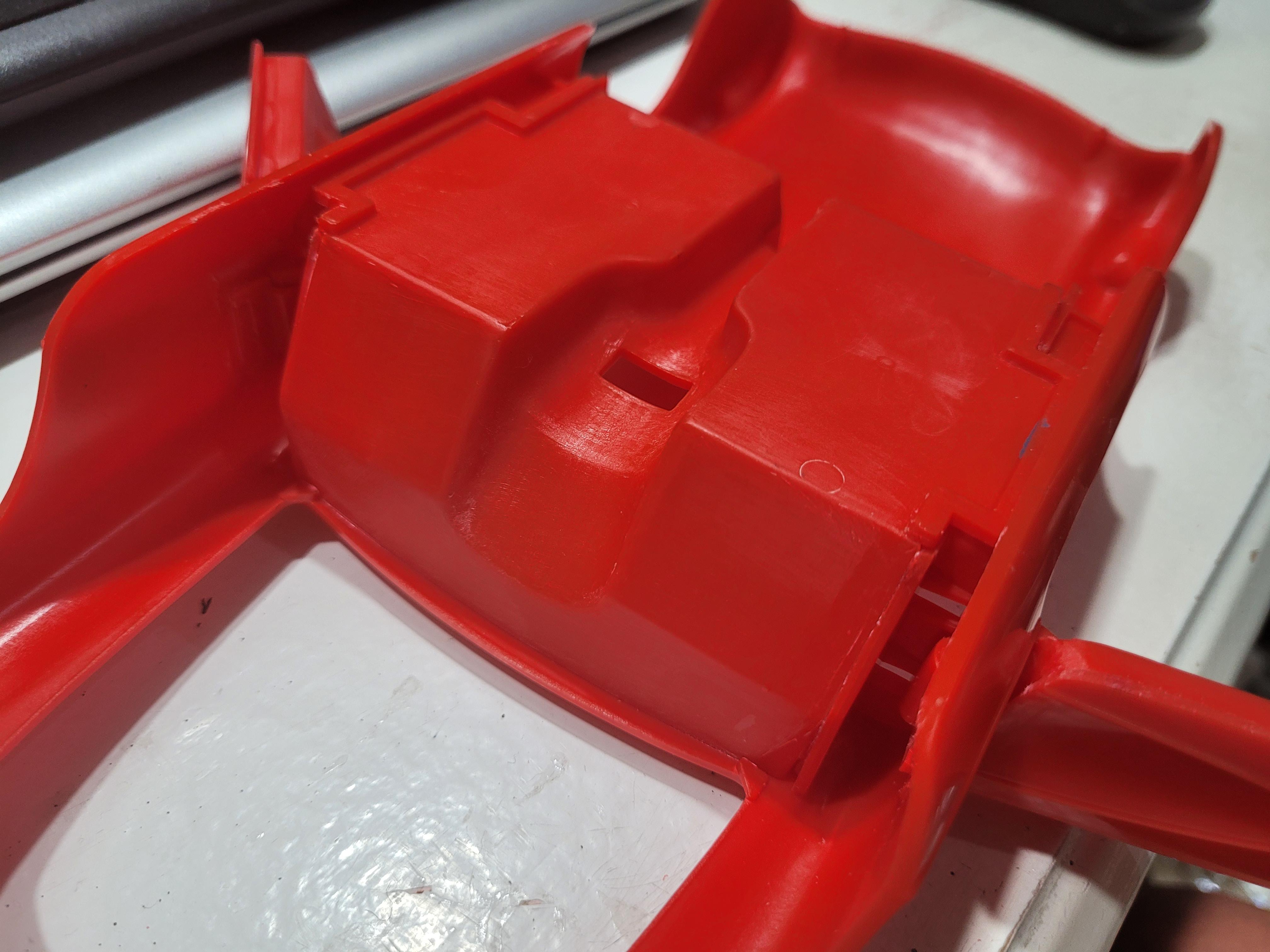

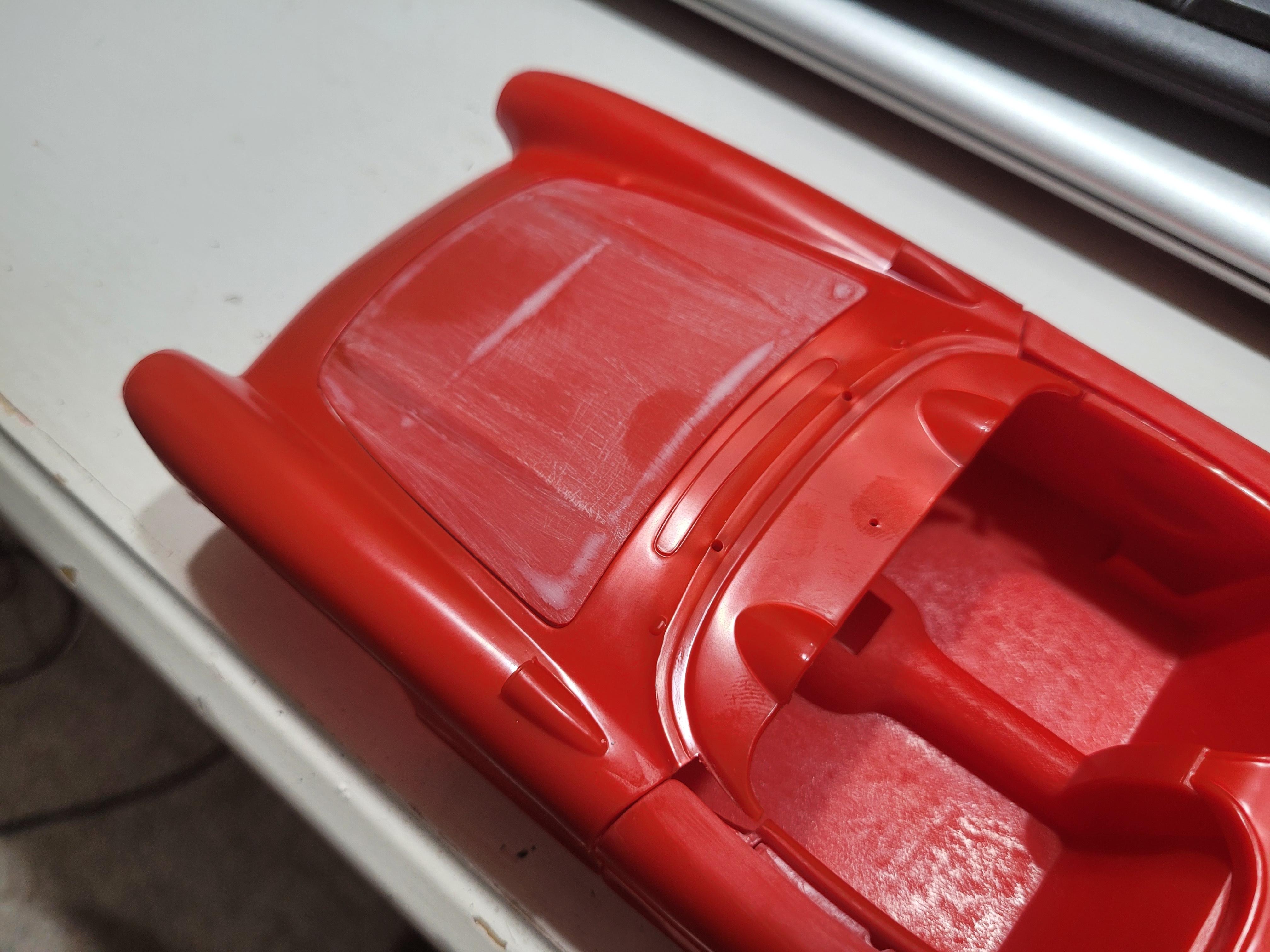

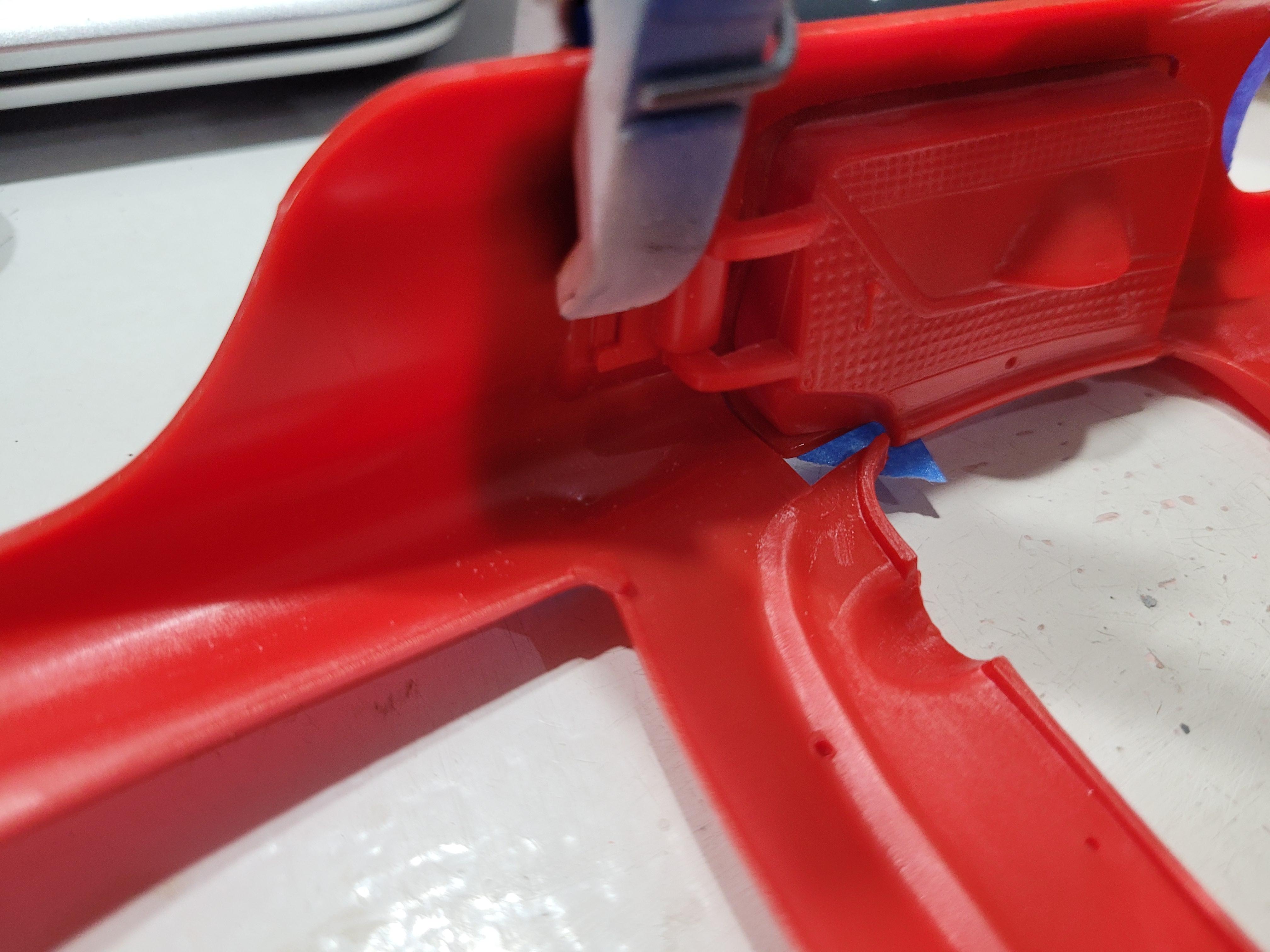

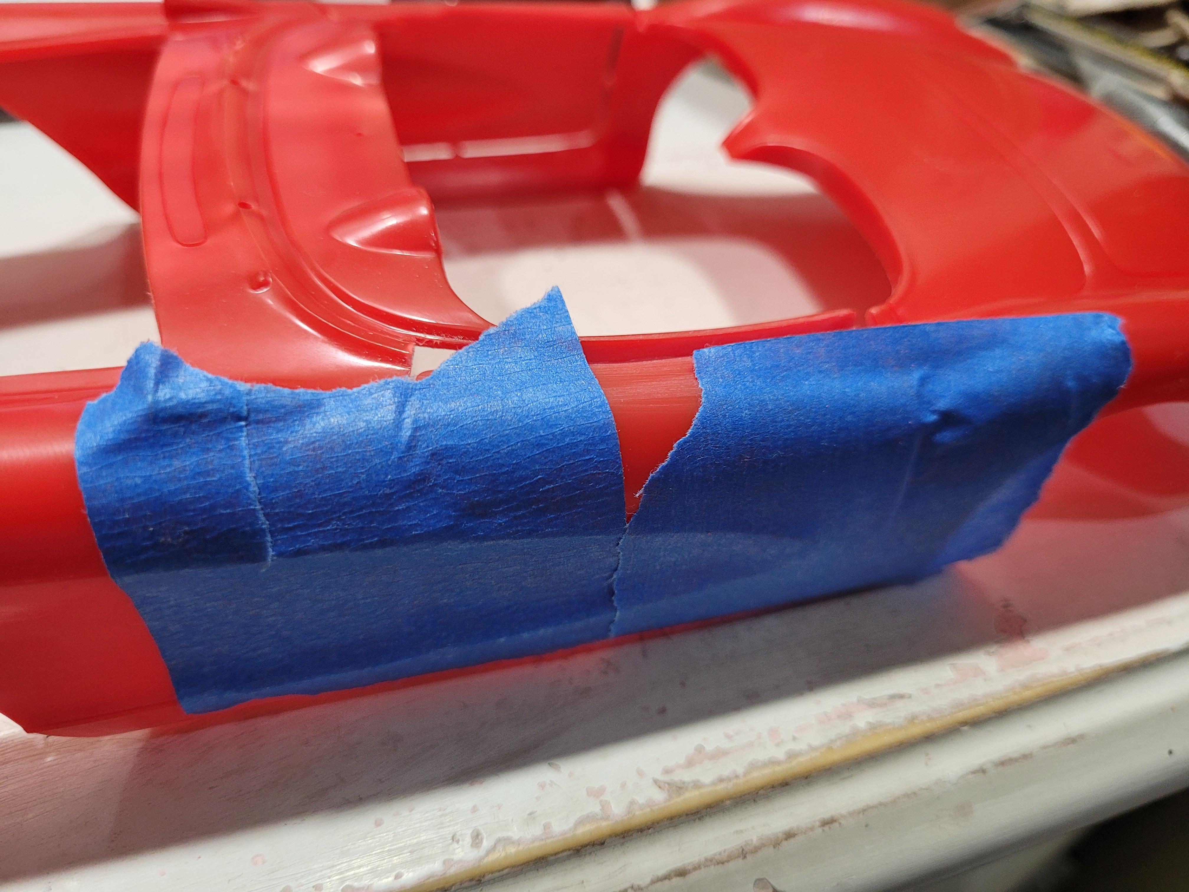

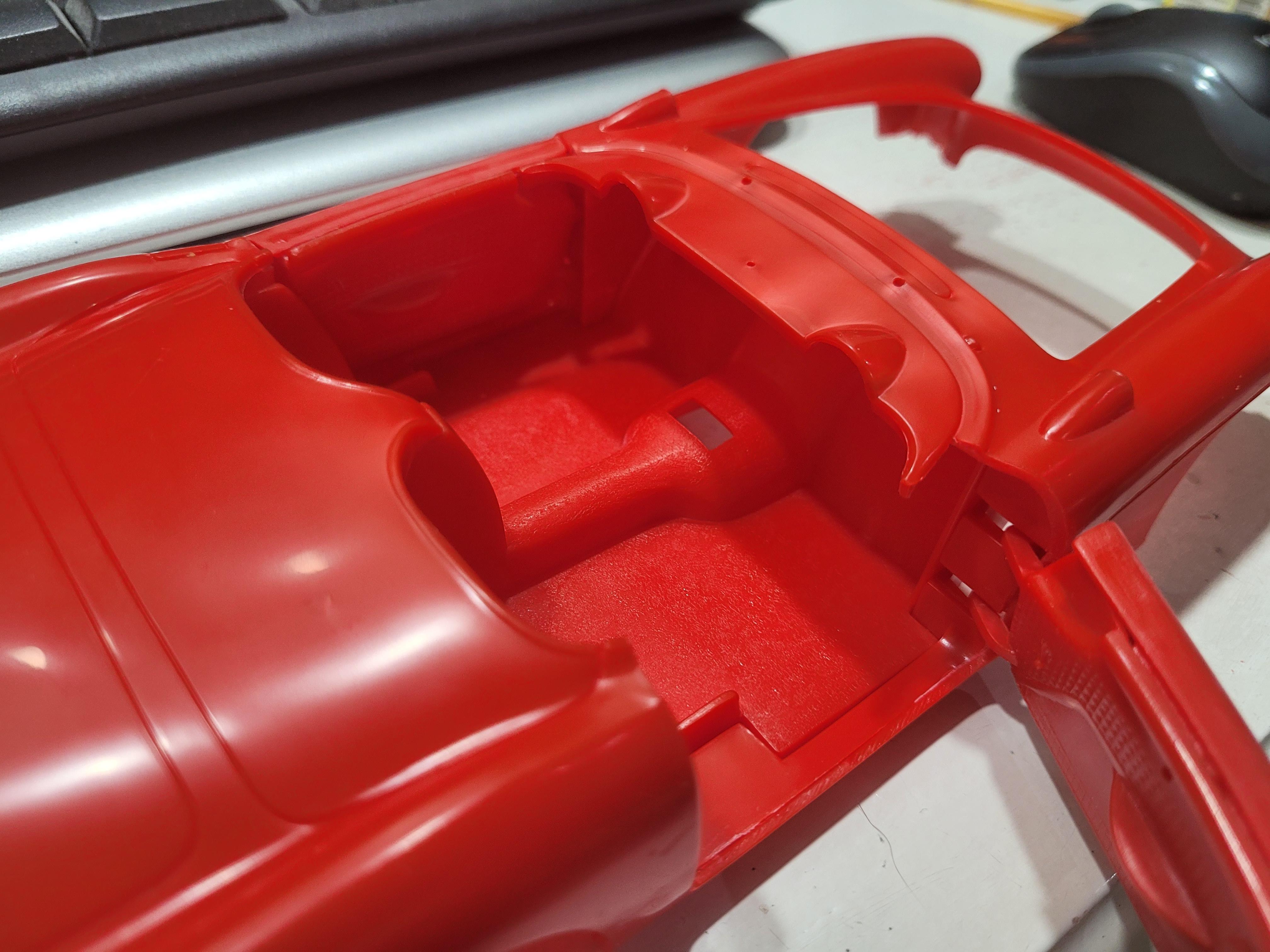

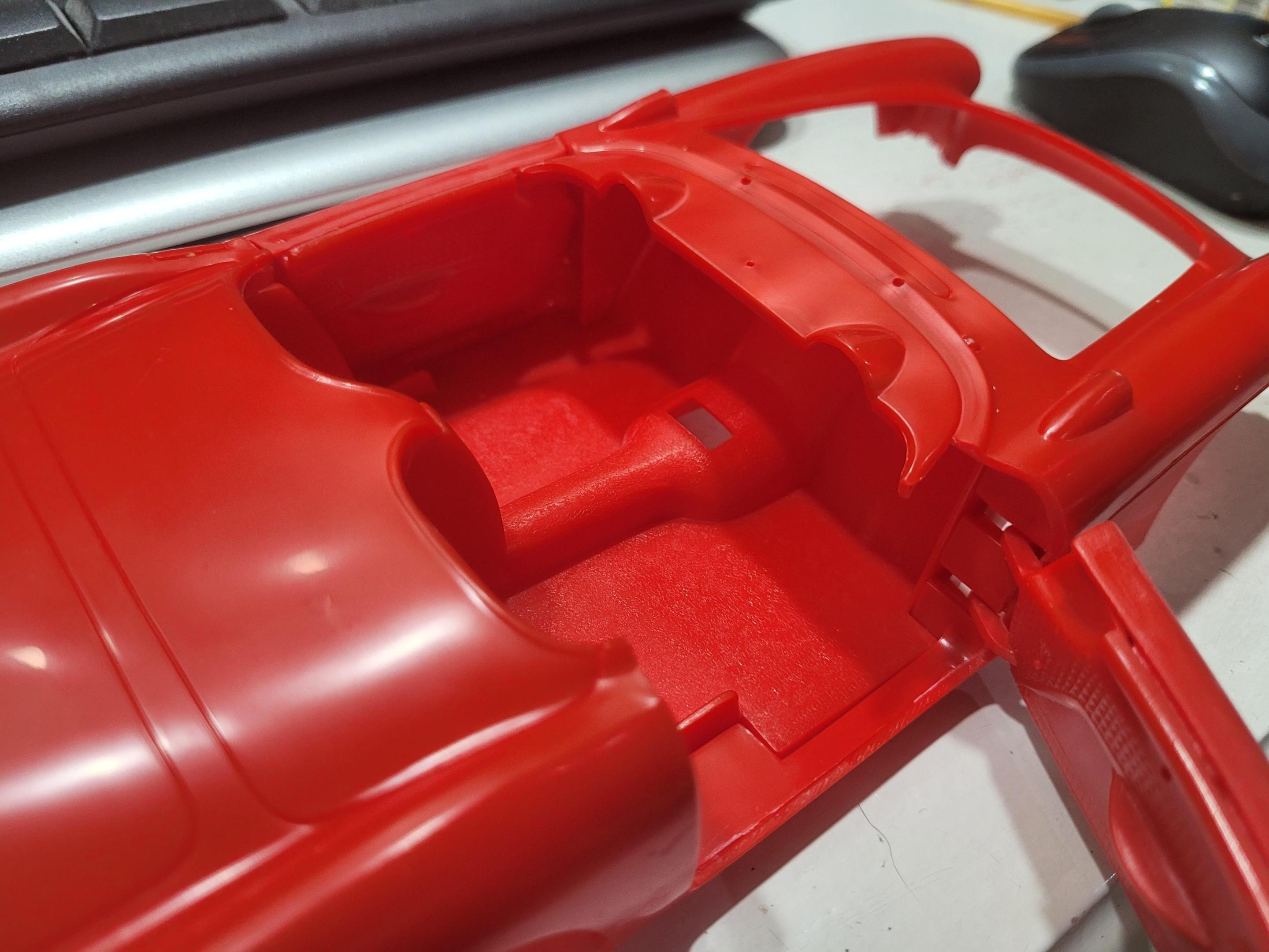

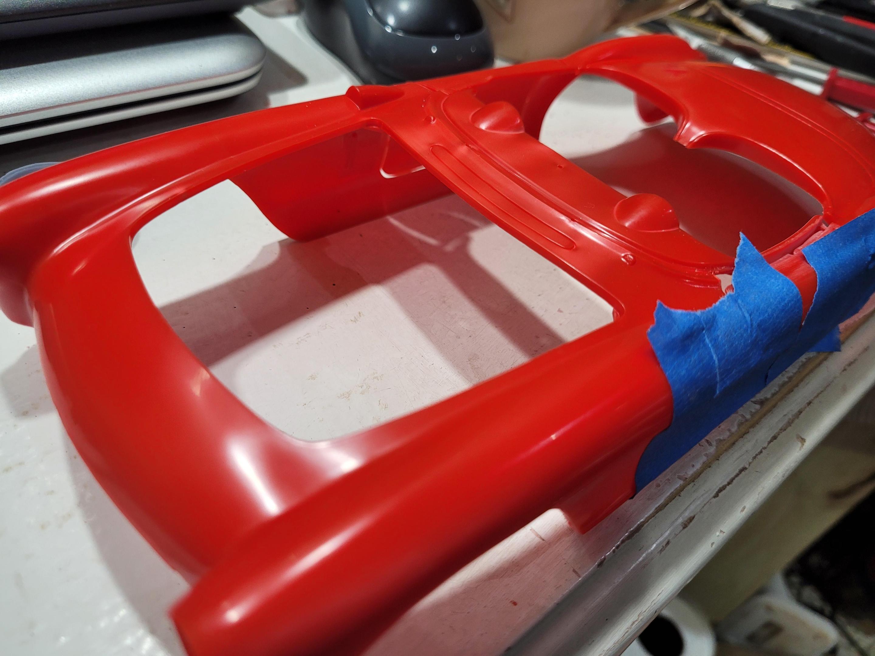

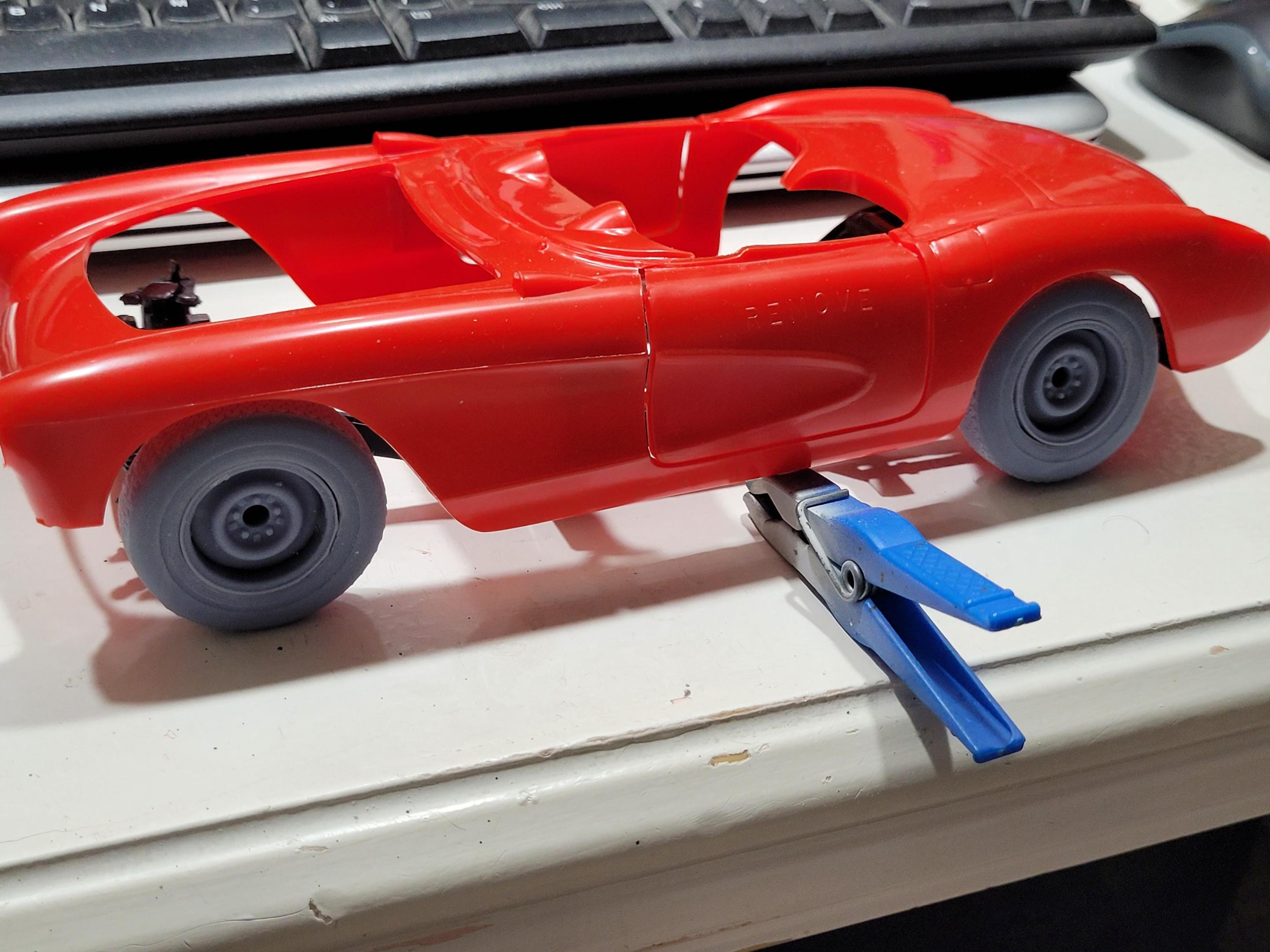

kenlwest Posted July 20, 2024 Author Posted July 20, 2024 I am back from moving my son and his girlfriend to Chicago. Glad to be back. The body was really a warped mess. The cowl was crushed at some point, and it splayed the rockers outboard. This made it impossible to fit the hood and door jambs properly. Fortunately, the interior tub matches the correct shape of the cowl, so I used it to pull the body into the correct shape.
kenlwest Posted July 20, 2024 Author Posted July 20, 2024 The hood now fits the opening. The pictures really didn't show it, but I would say the cowl dipped about 1/8 inch in the middle, and the sides were splayed out about the same on each side. The body was either pulled out of the mold too soon, or the kit was exposed to attic heat or something similar. The sealed box and parts showed no sign of crush. 1

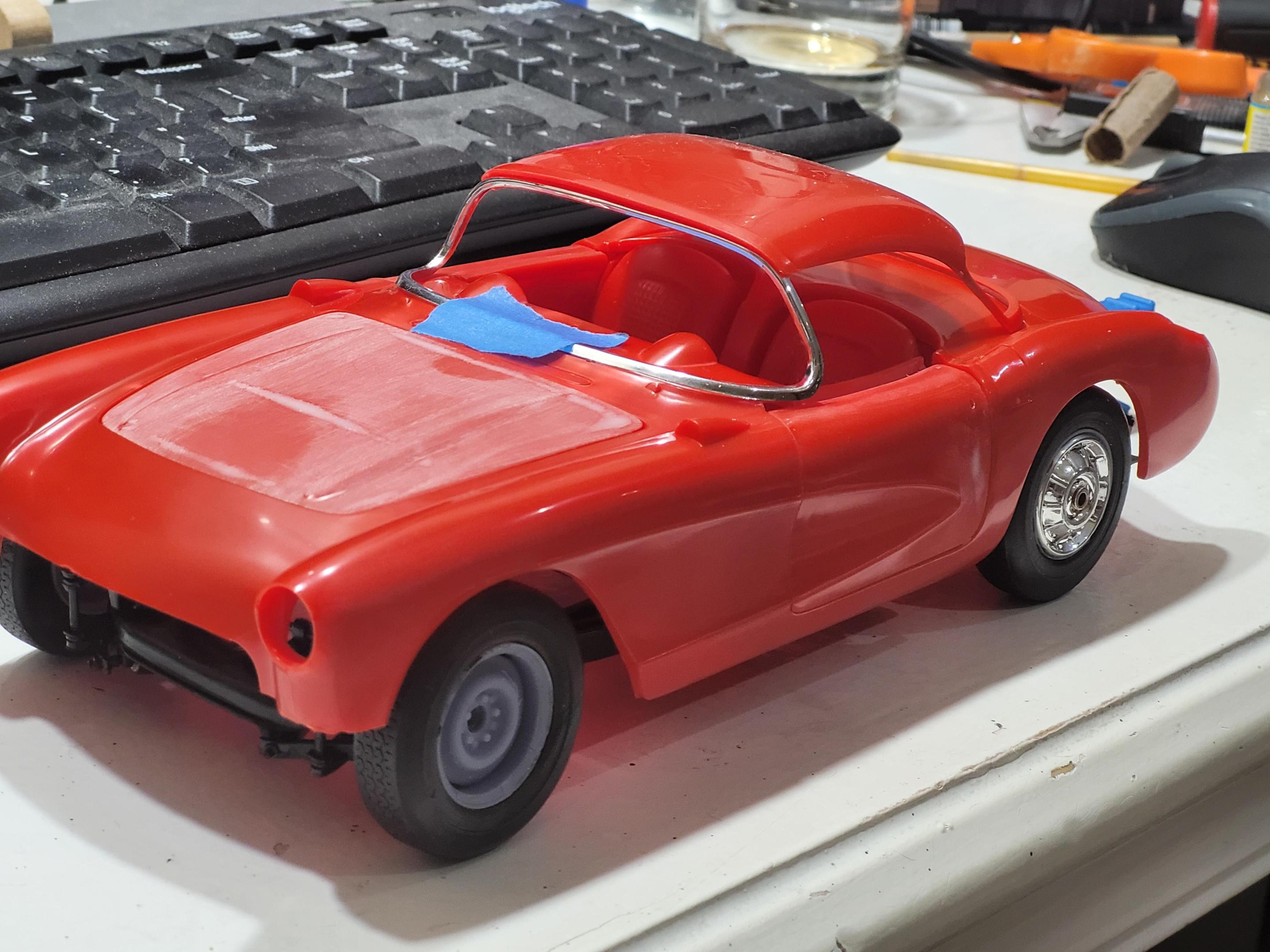

kenlwest Posted July 20, 2024 Author Posted July 20, 2024 A little staging fun... I wanted to try out both tops. I did manage to sink the hubcaps into the wheels.
DJMar Posted July 20, 2024 Posted July 20, 2024 Lots of work on this one, and she's looking good. I really like the wheels and tires you printed up, versus the kit pieces. Also, I totally forgot this kit came with both the hard & soft tops.

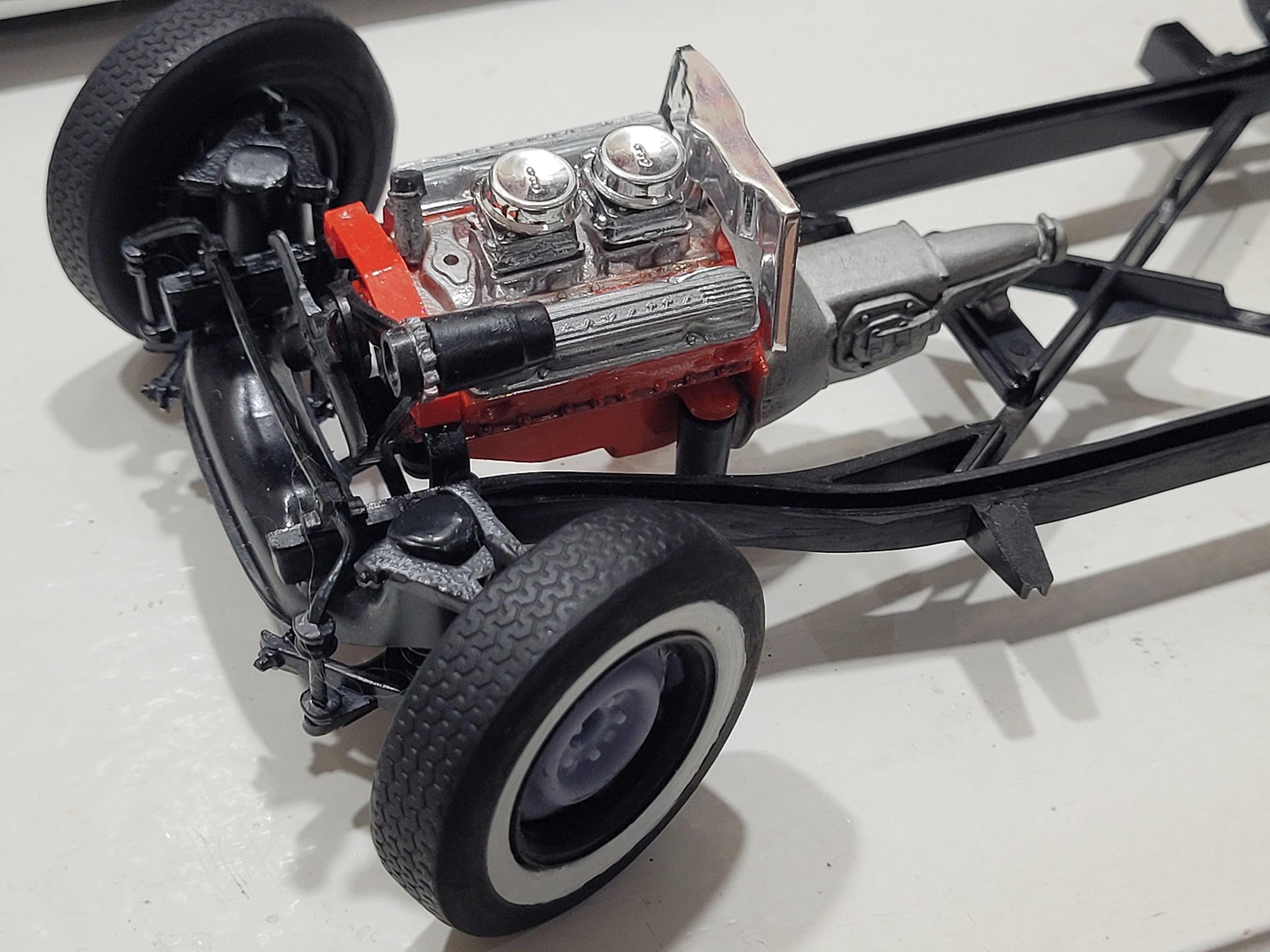

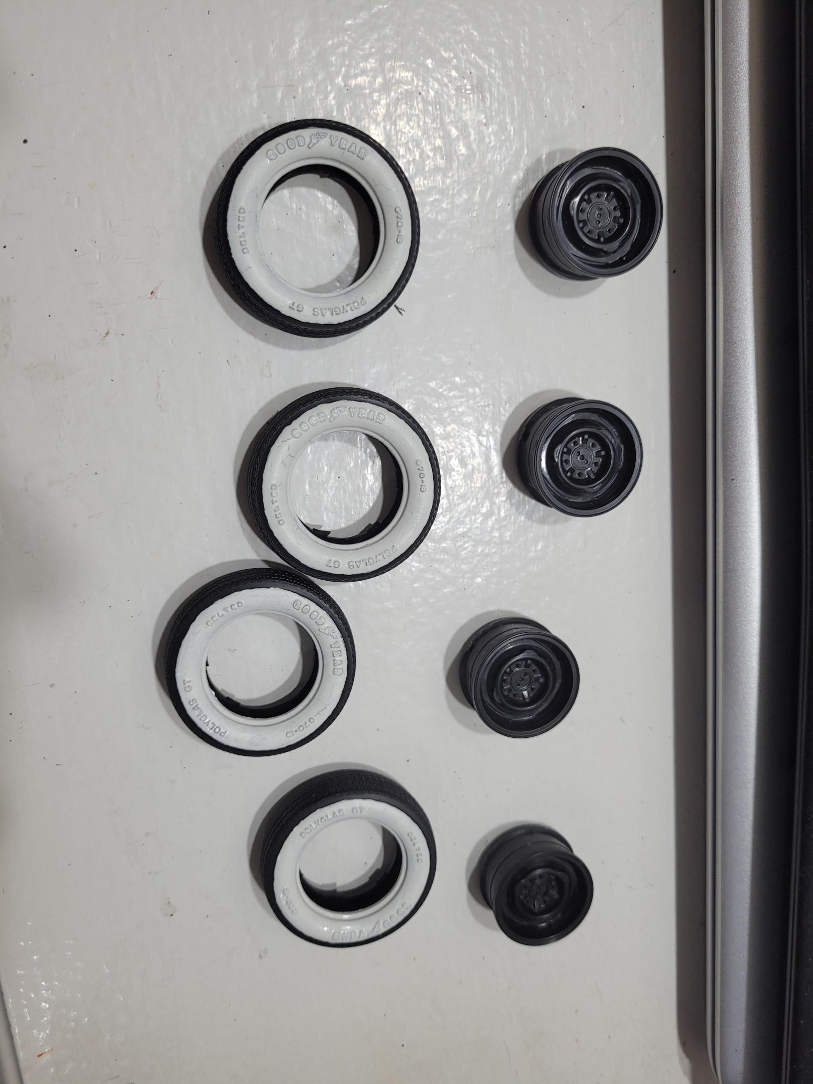

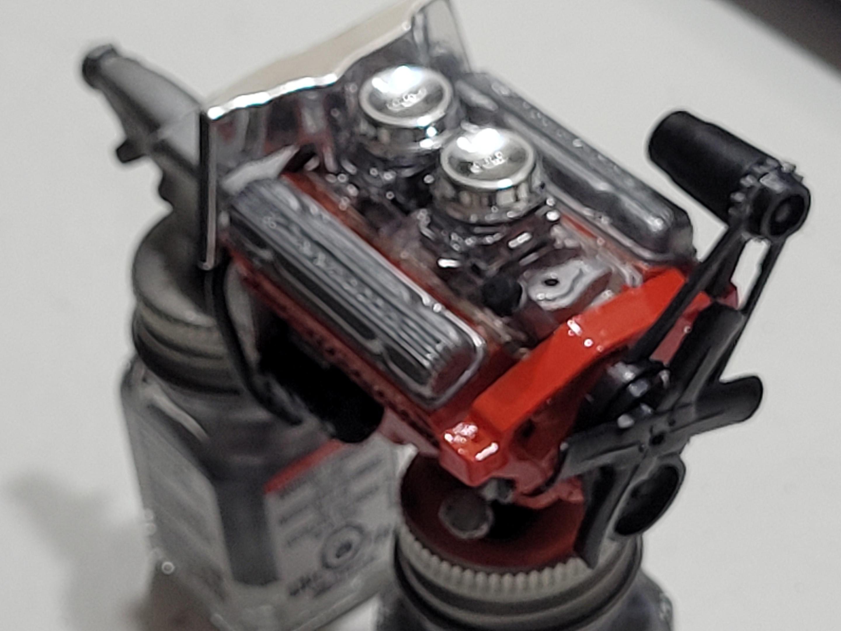

kenlwest Posted July 22, 2024 Author Posted July 22, 2024 The engine is mounted. The tires were flat washed, then the whitewalls were painted. 1
