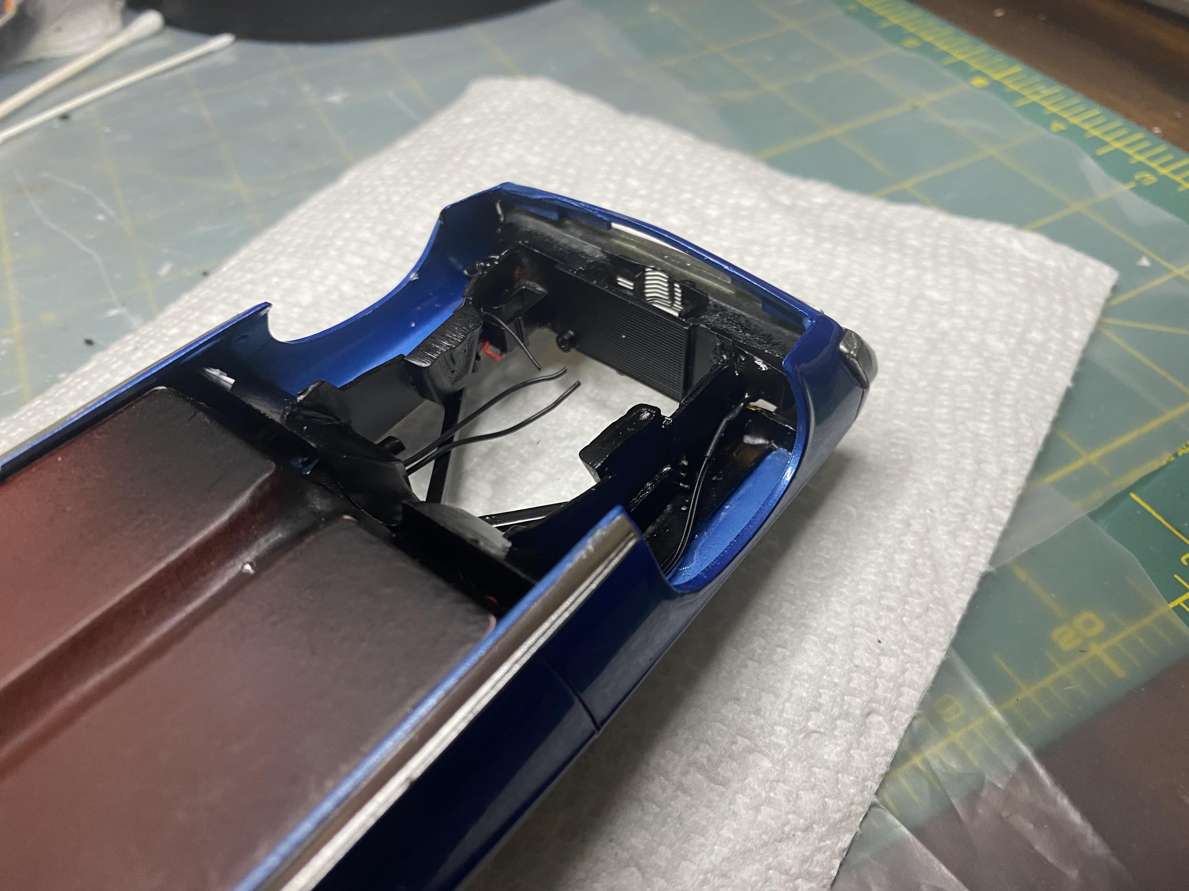

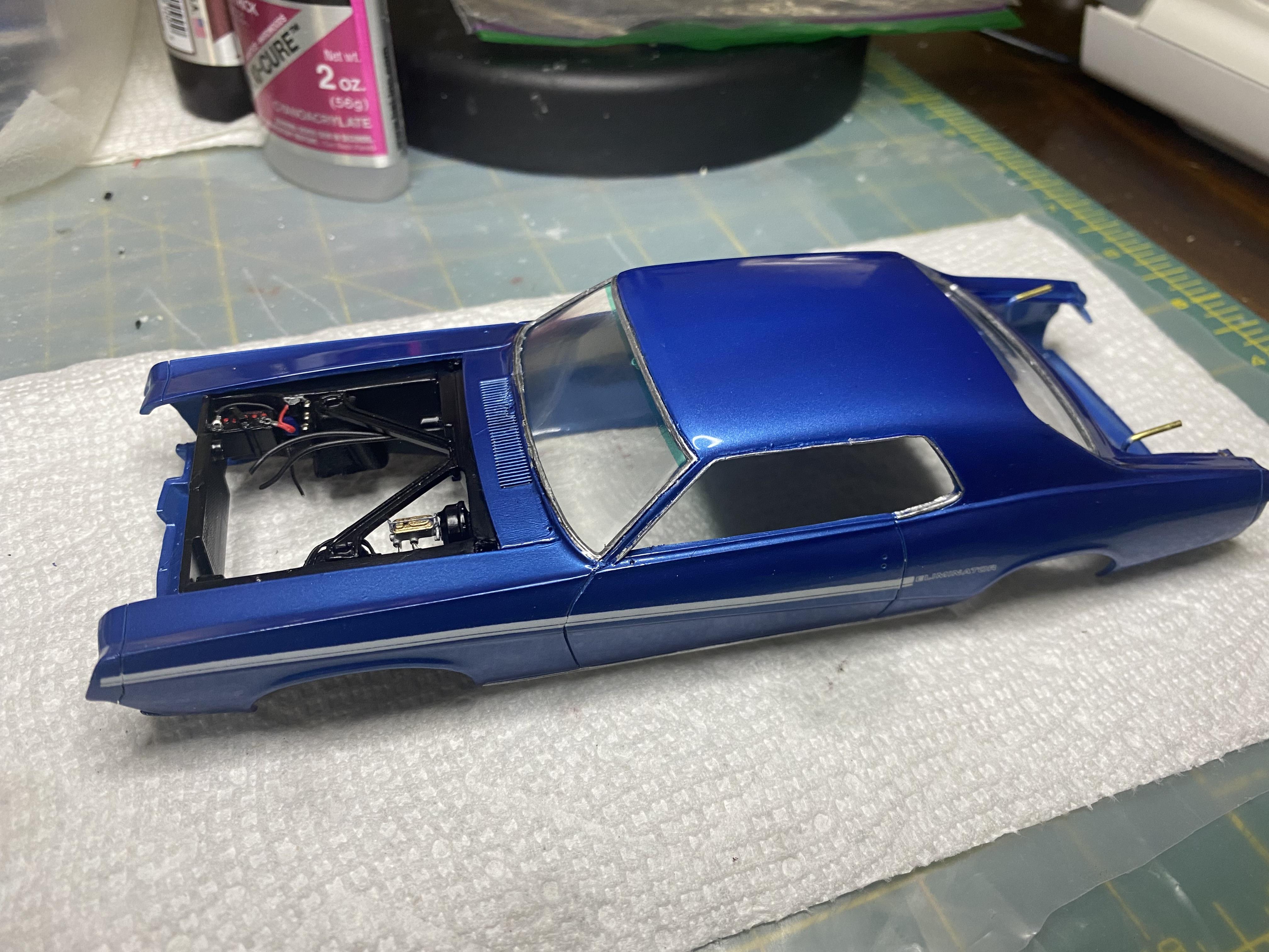

Windows, inside rear view and engine compartment installed.IMG_5417.thumb.jpeg.86e0789b4a4f6889641a181acb60471e.jpeg

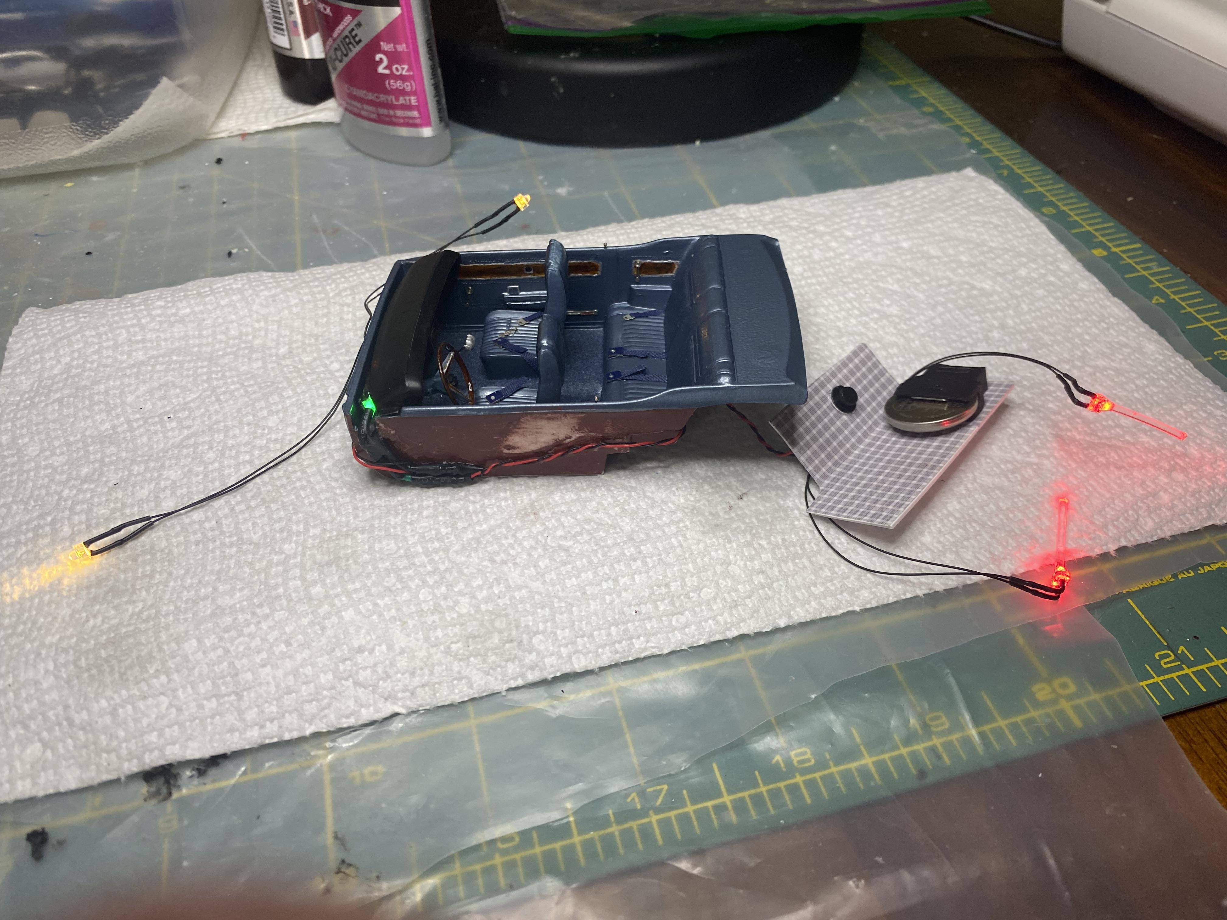

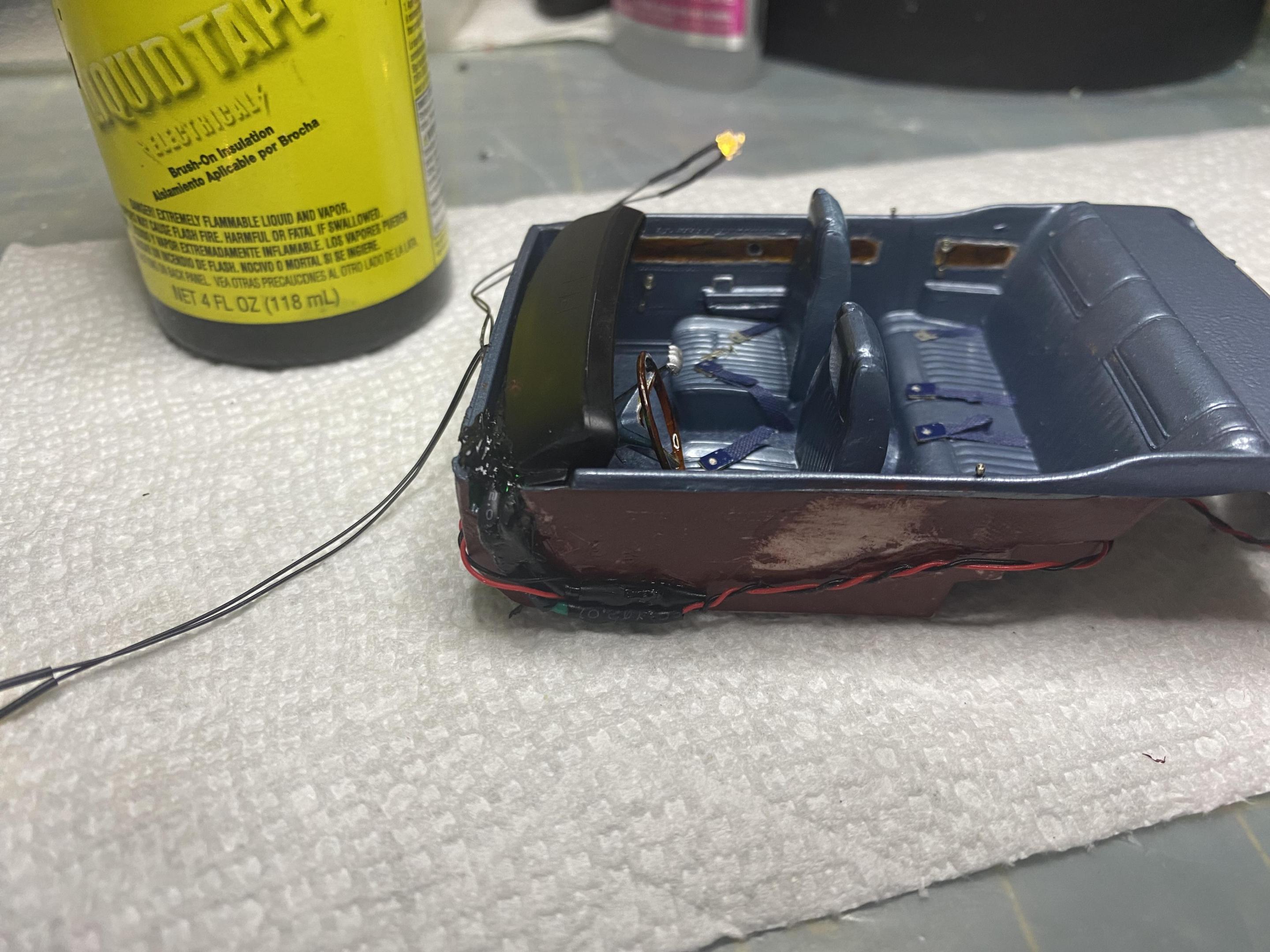

attached Wiring harness to interior tub and sealed dash.
IMG_5418.thumb.jpeg.83a8e7ea9790e702b347d78407834863.jpegIMG_5419.thumb.jpeg.f4819229ff806845d715faf038ec9e0b.jpeg

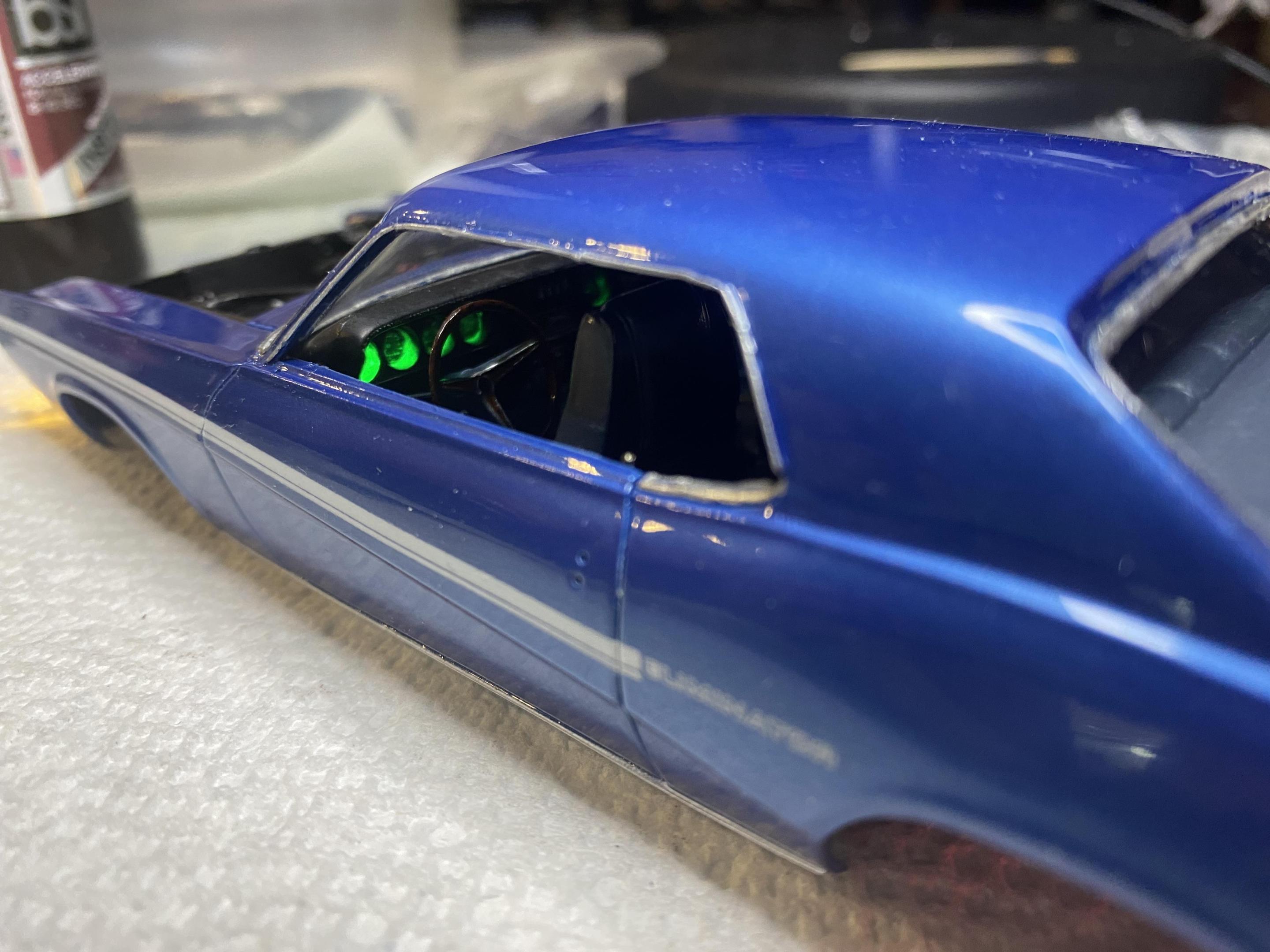

installed interior and tested gauge lights.
IMG_5420.thumb.jpeg.afb584820e6dd478da1a3ed7fa23e485.jpegIMG_5421.thumb.jpeg.748294f2cb5814e40d0f3988386df38b.jpeg

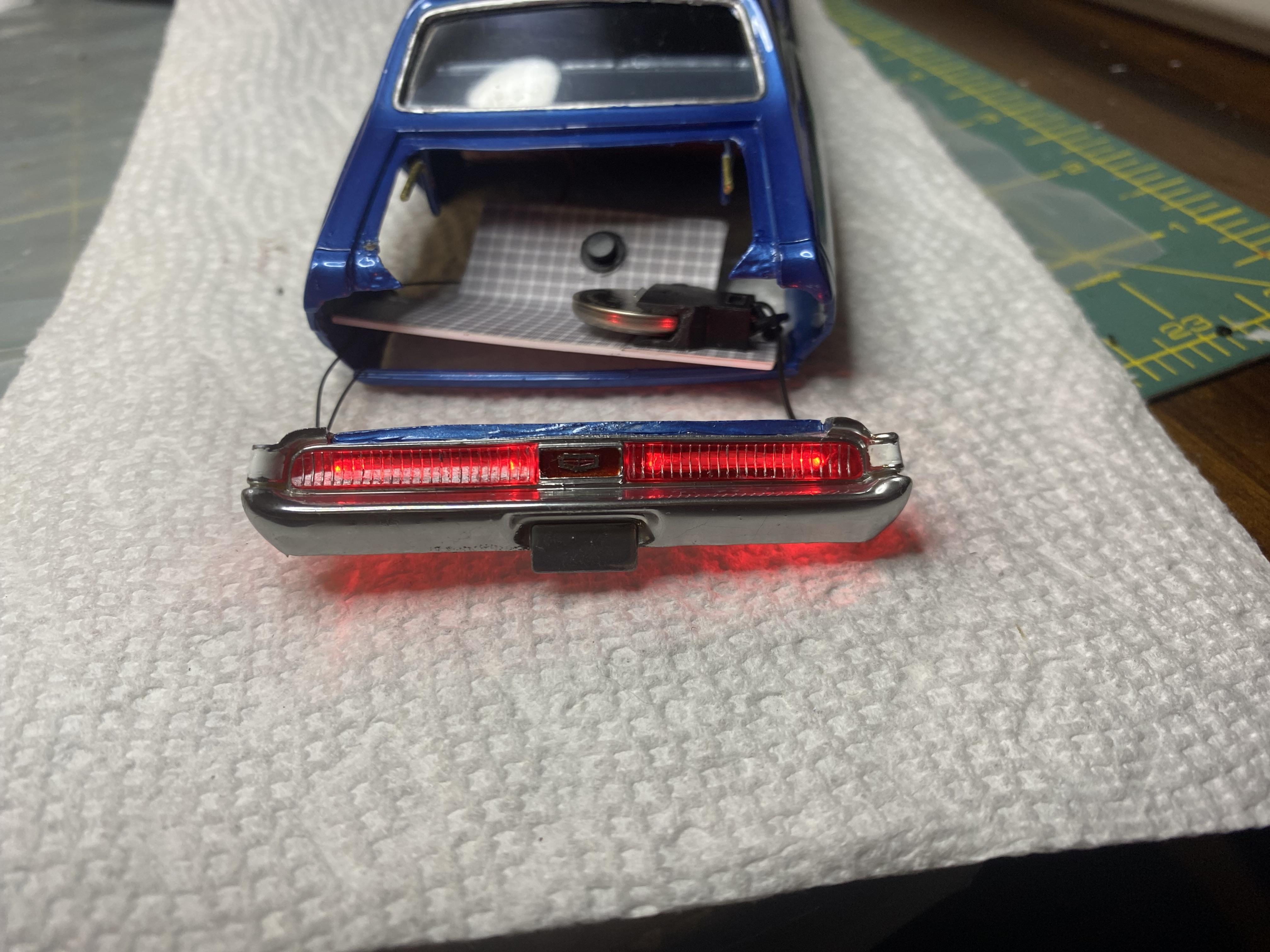

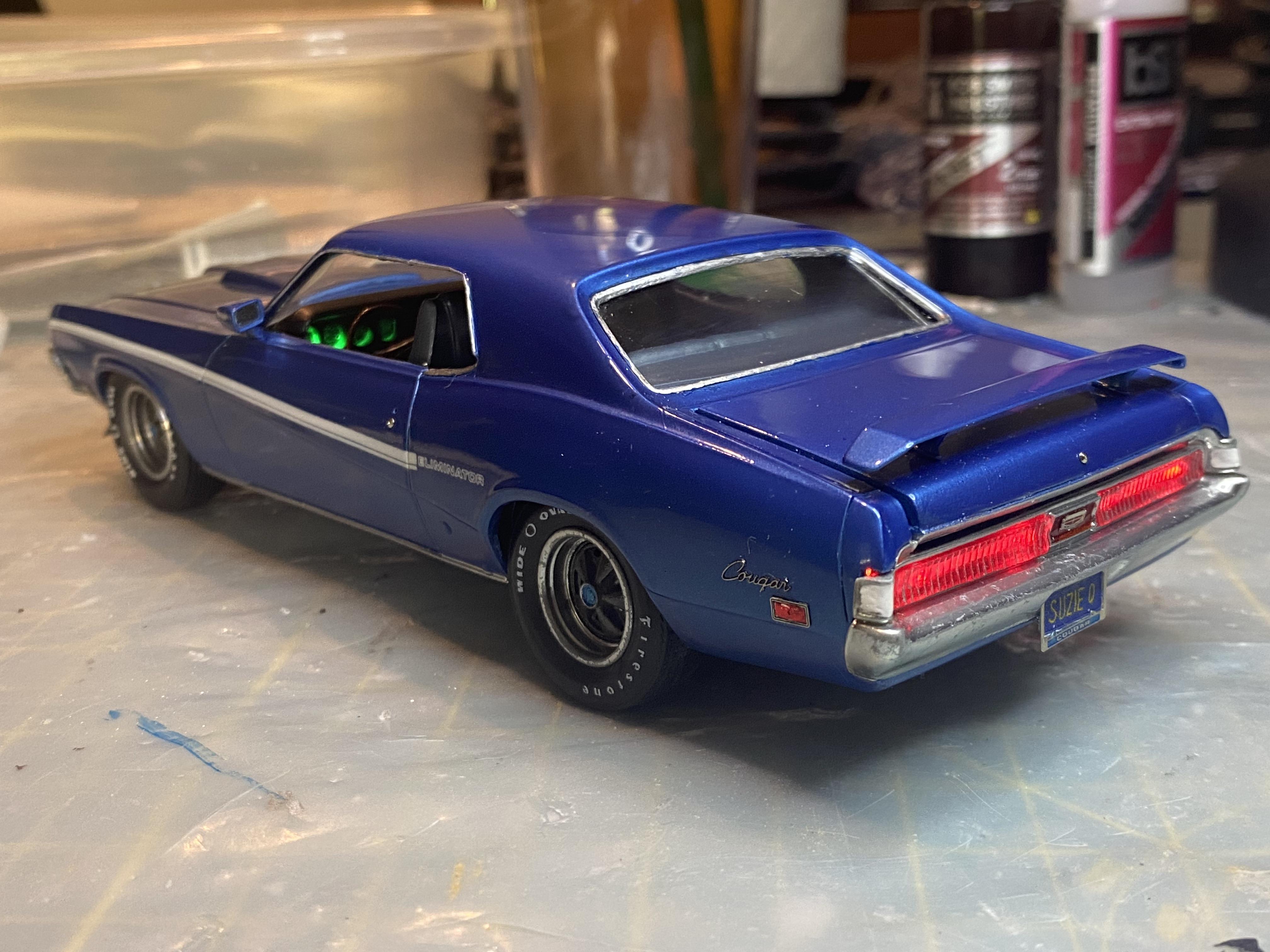

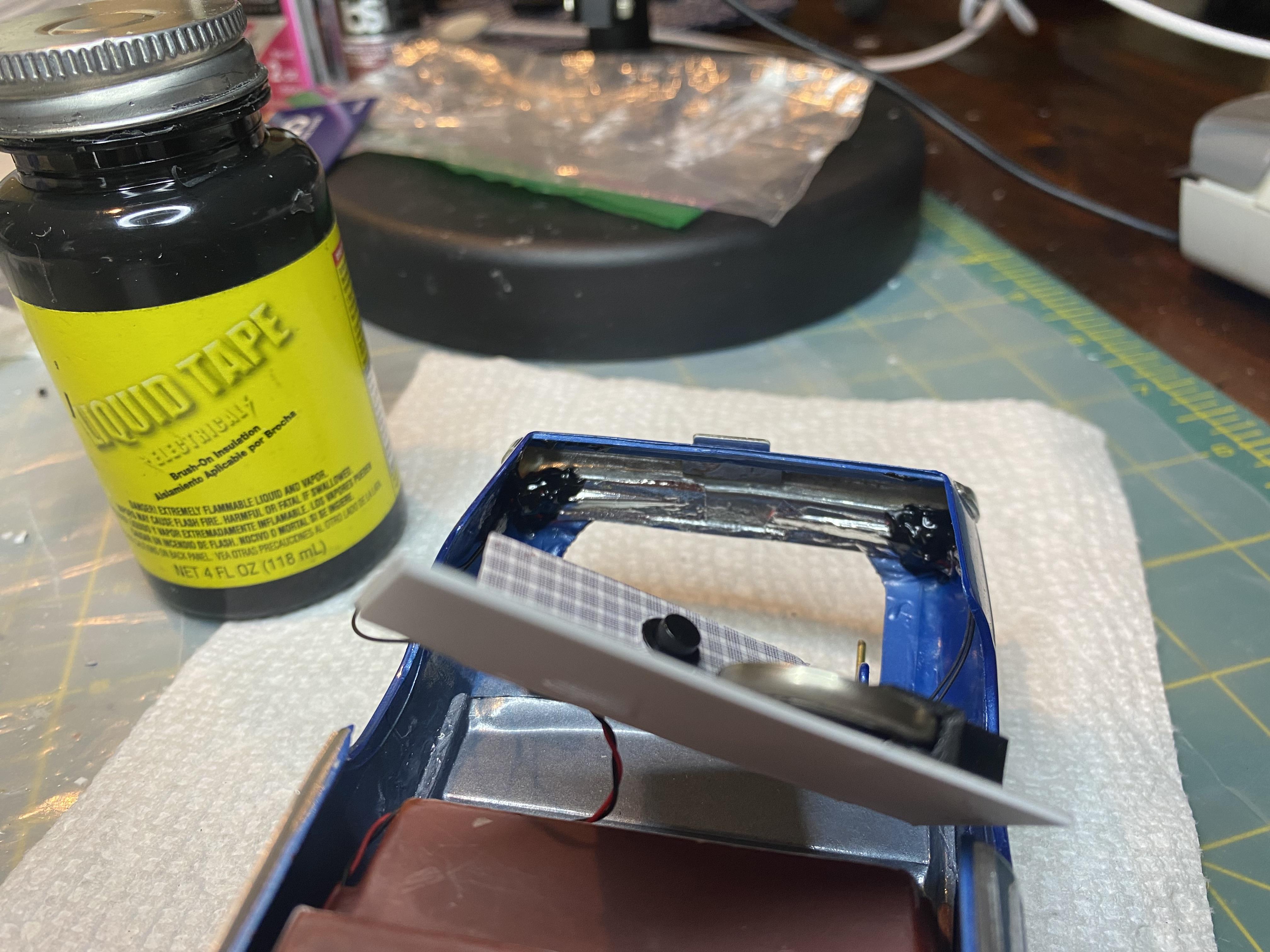

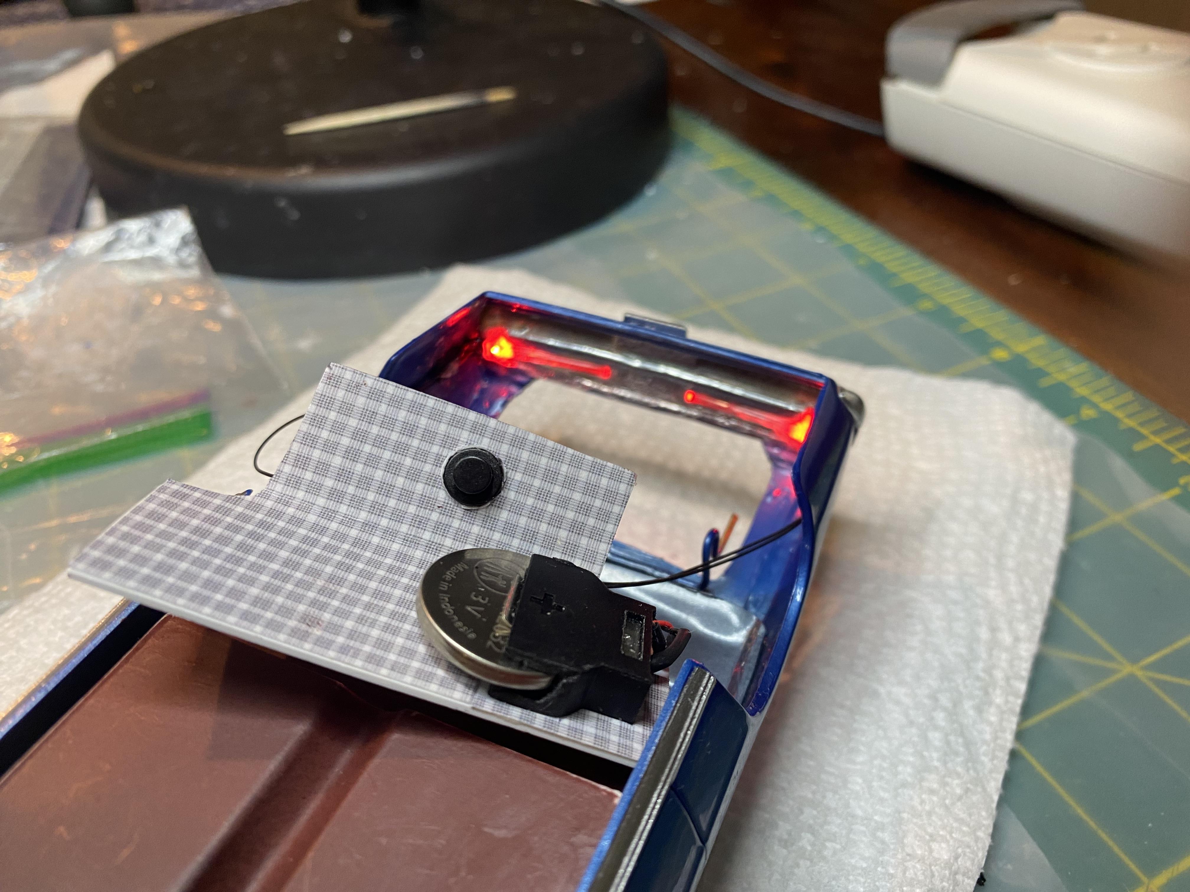

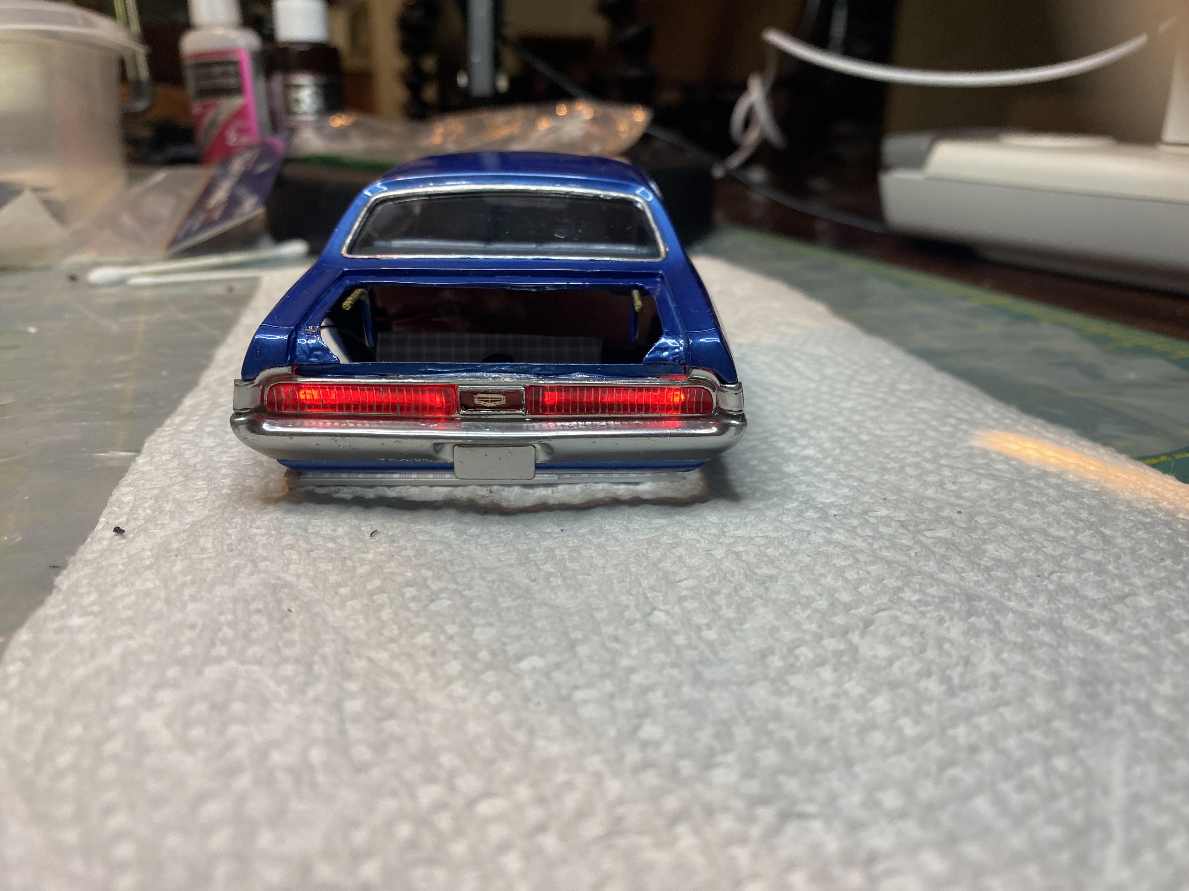

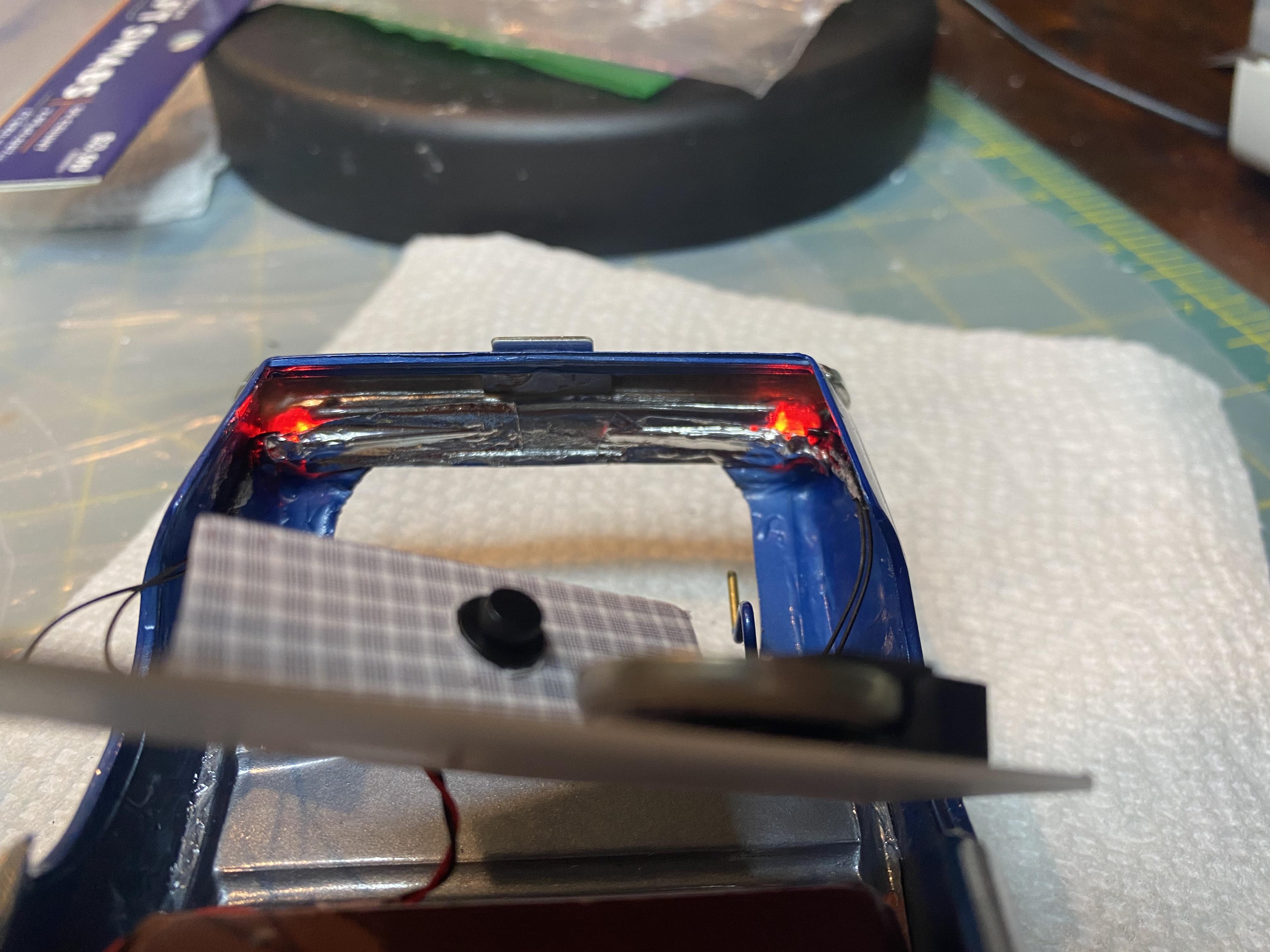

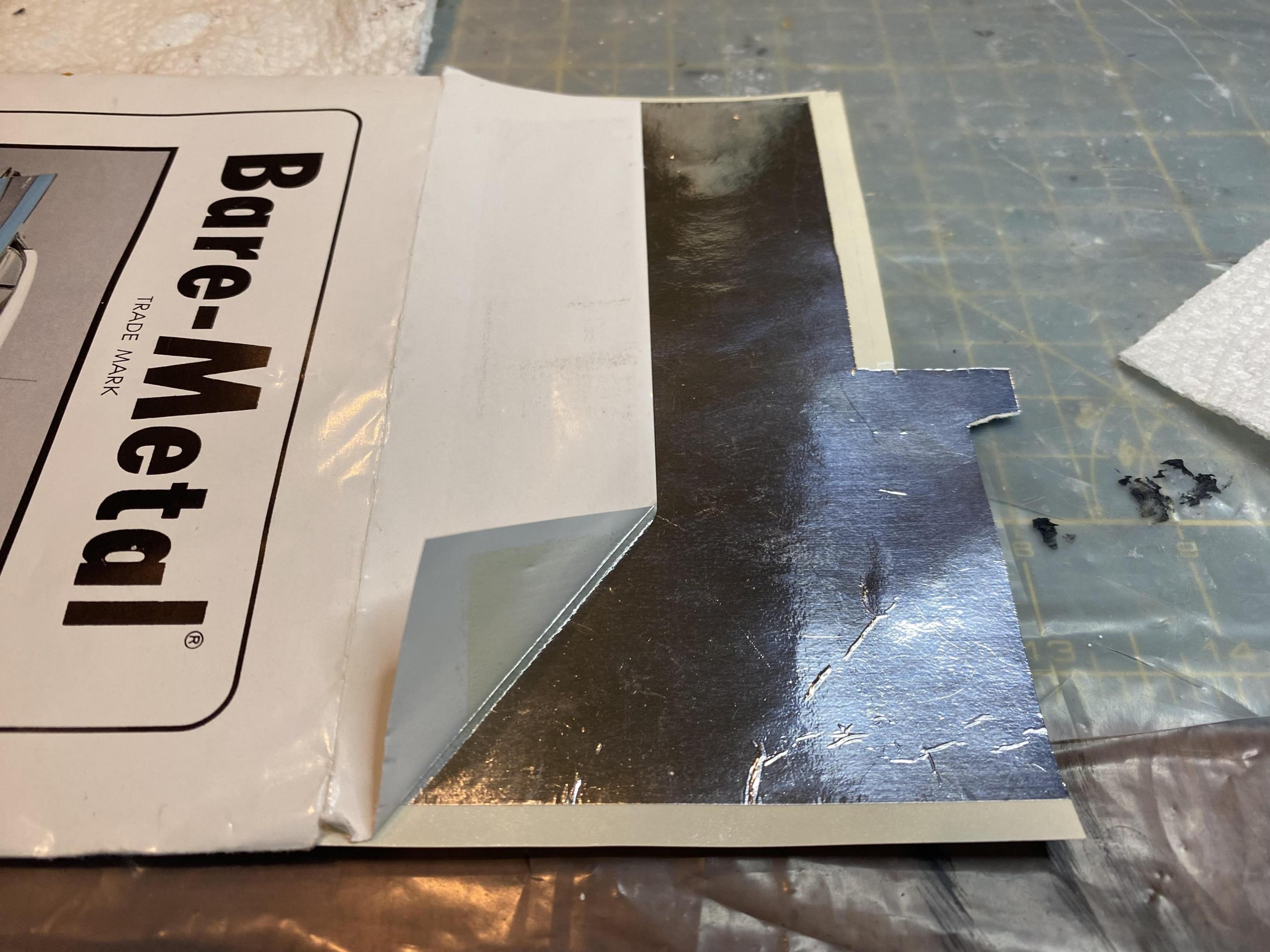

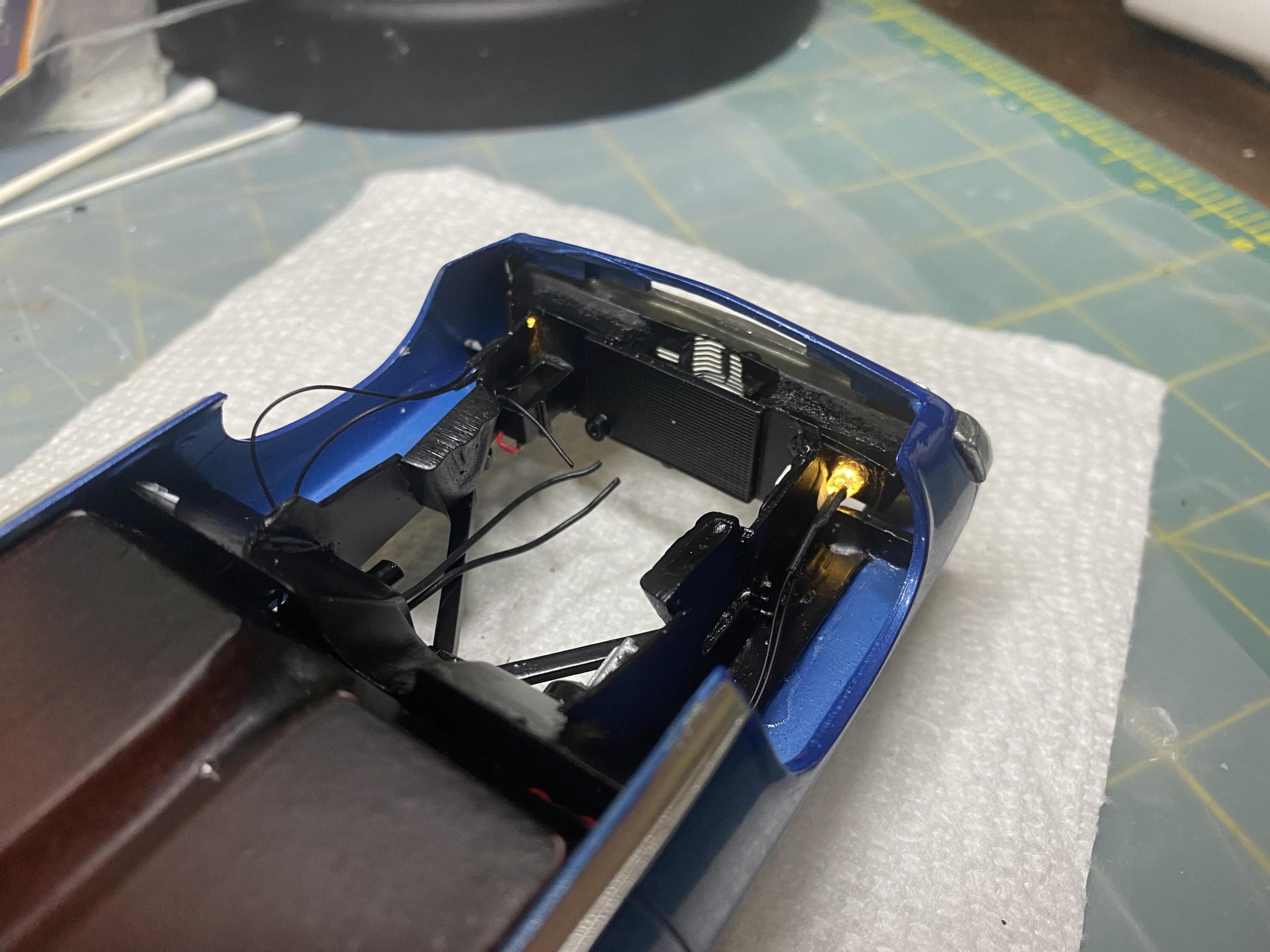

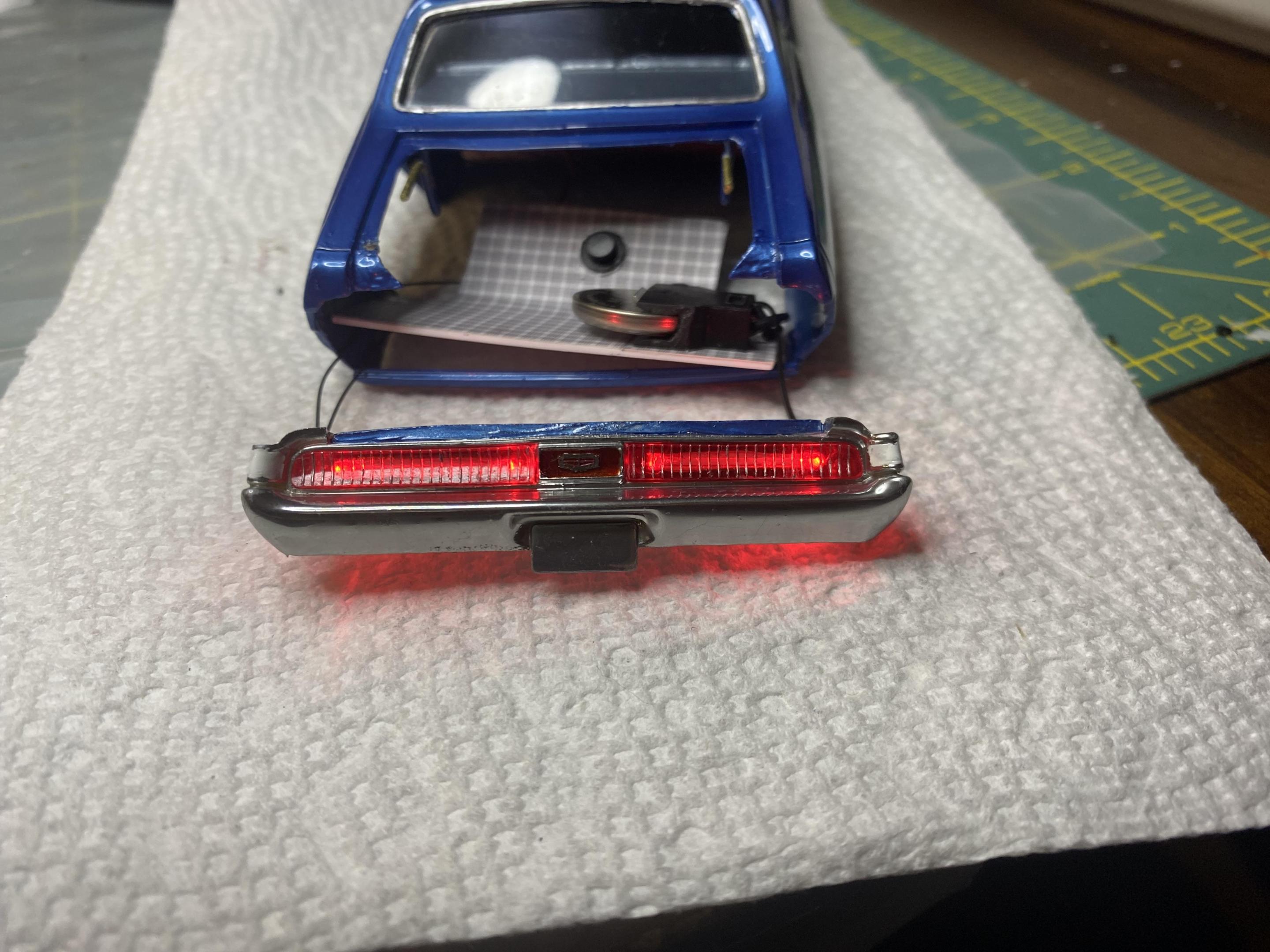

installed taillight side glow fiber optics to rear, installed, added bare metal foil as light blocker and liquid taped the ends.
IMG_5422.thumb.jpeg.3f7e906951a785005cf61eb446e00bc8.jpegIMG_5423.thumb.jpeg.1ae3f7b03fa217baca4b9def38e9904d.jpegIMG_5425.thumb.jpeg.e2aa9b4ea609c14a56c0df388d86e20d.jpegIMG_5426.thumb.jpeg.8c4427efffbe64ffc61baa283b10f522.jpegIMG_5427.thumb.jpeg.8f0d7d5f167ada6ee00821dbd68dc249.jpegIMG_5428.thumb.jpeg.3b0a3b28bb31733ef1d8c71476b87c4f.jpeg

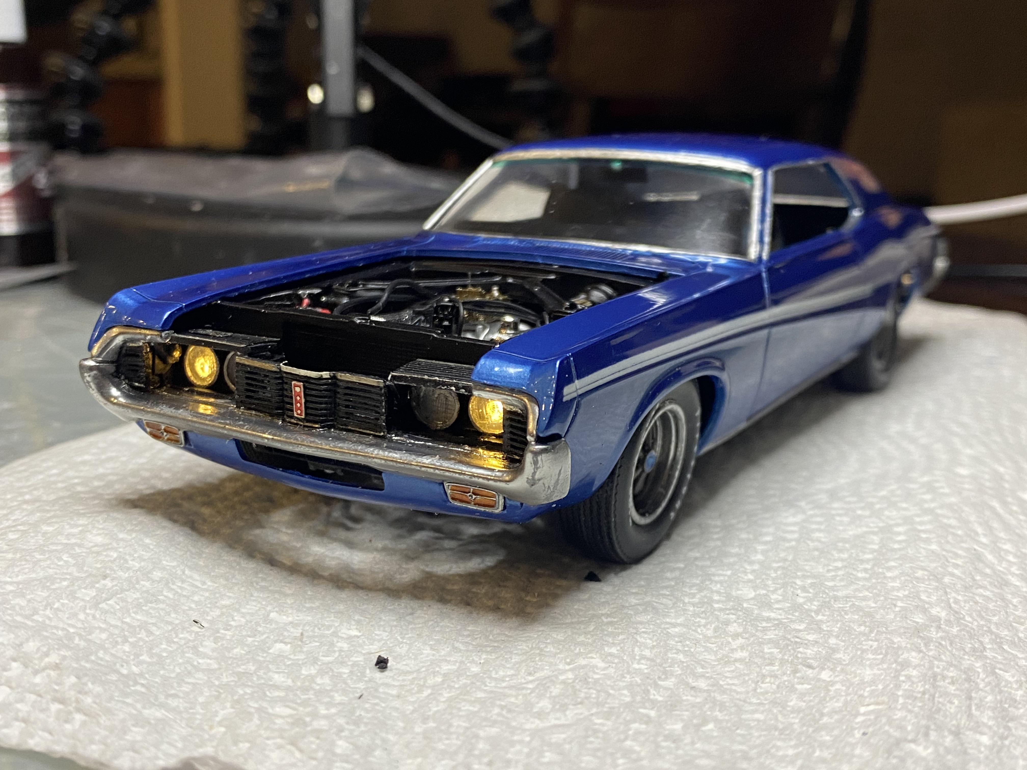

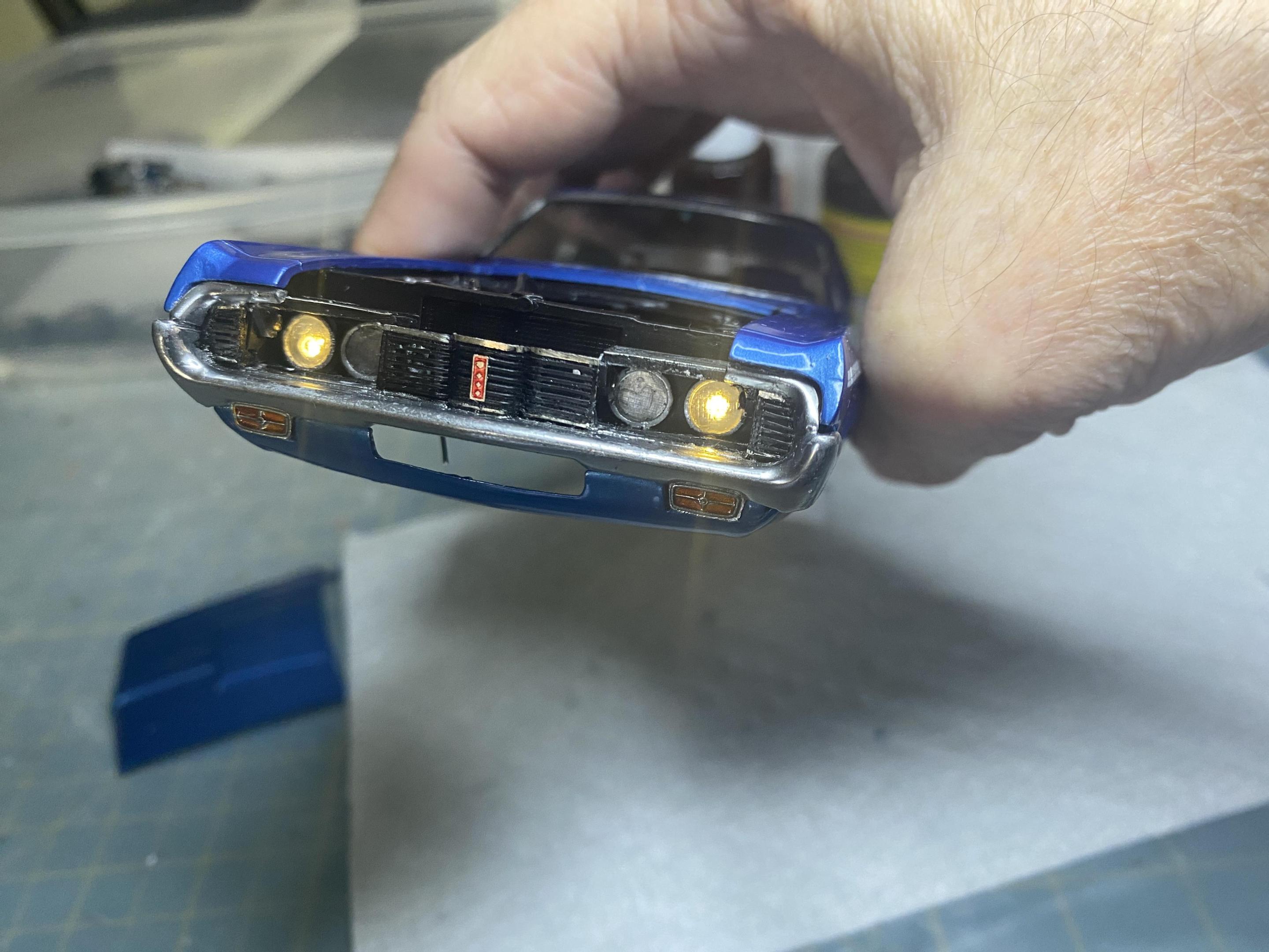

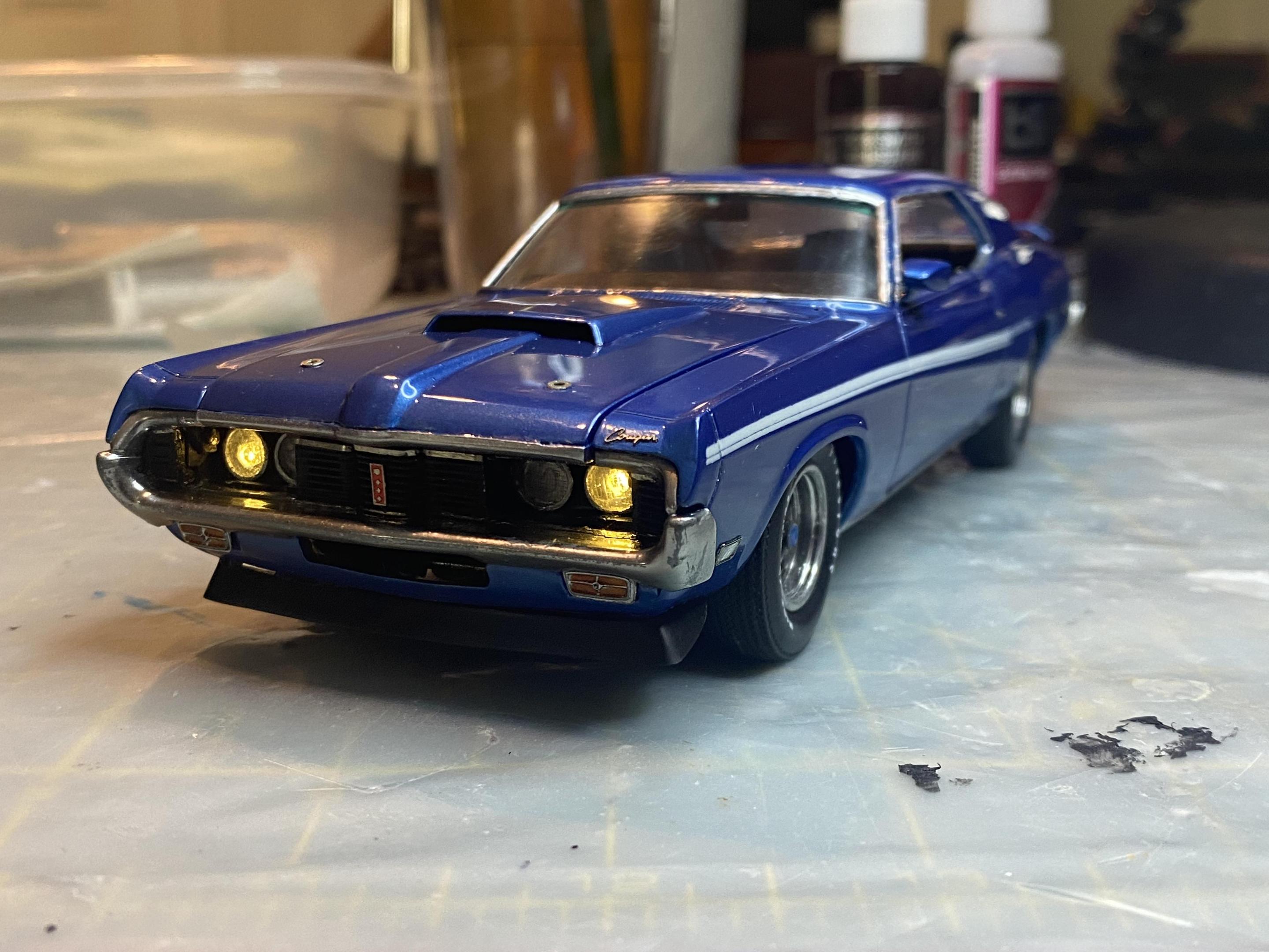

Added LEDs to front and sealed with liquid tape. Added headlight lenses.
IMG_5429.thumb.jpeg.91436fdf0ea15a61c5e4a7018bb3c544.jpegIMG_5430.thumb.jpeg.7ceaece033ff744fbf578f2f30d1f54a.jpegIMG_5431.thumb.jpeg.eb5f66418edb3a0526fbe32952bc2119.jpegIMG_5434.thumb.jpeg.ebcd5217480b0aa137a0239c8f01e626.jpeg

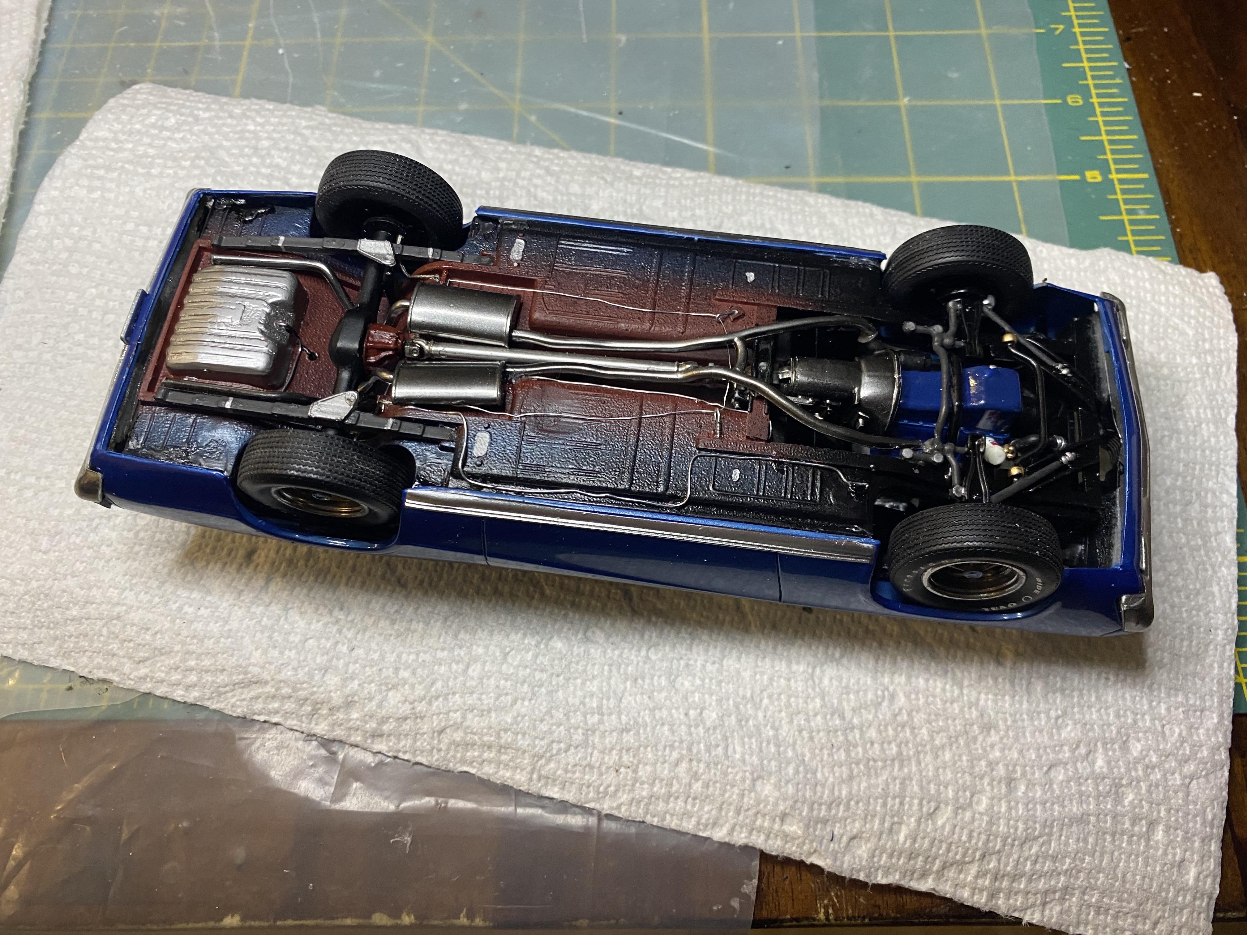

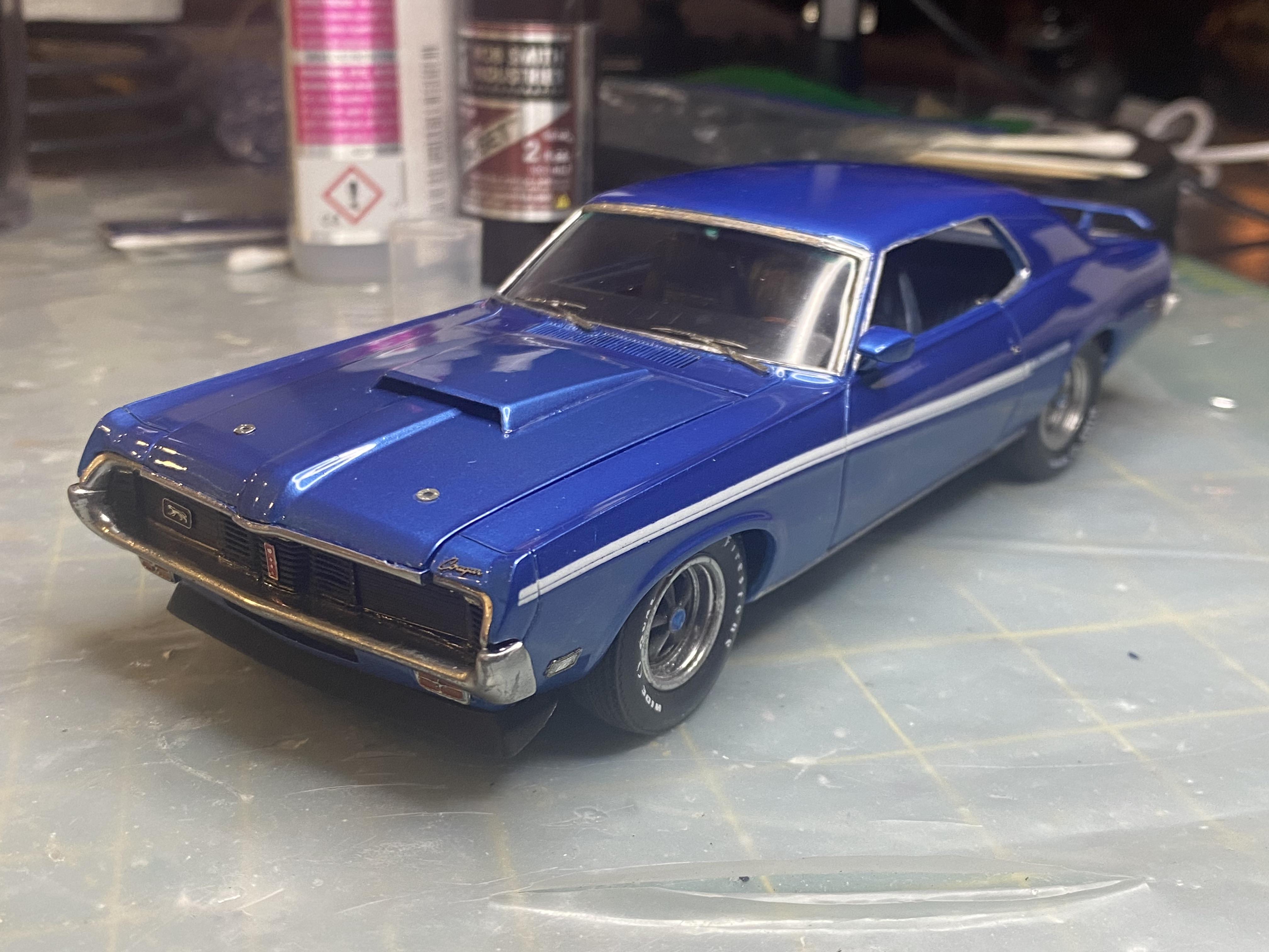

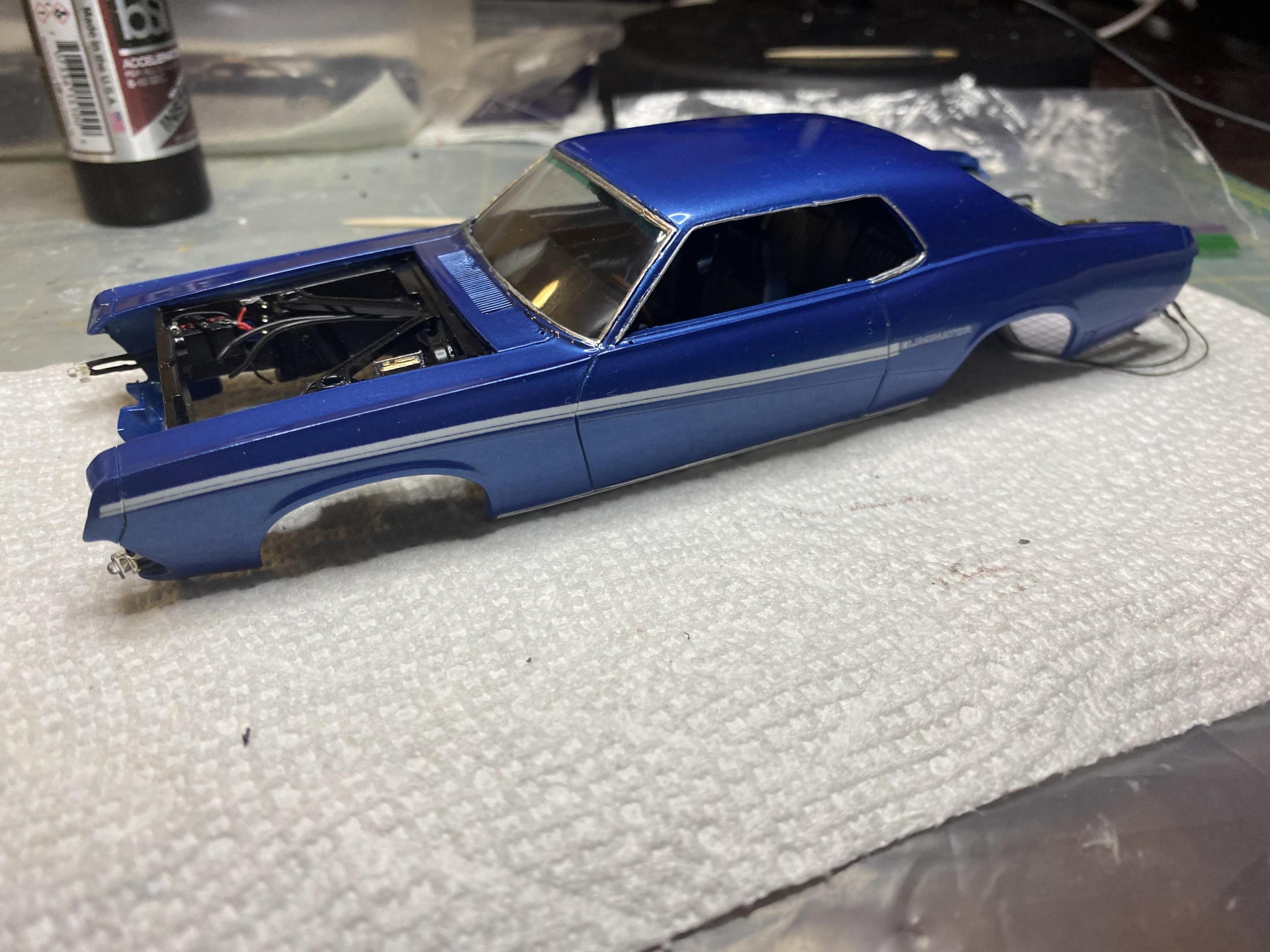

Mated the chassis and body this evening. A lot of detailing and fixing to go bipartisan starting to see the light at the end of the tunnel.
IMG_5435.thumb.jpeg.88d9d1a5cde4944f6556944fed078e4f.jpegIMG_5436.thumb.jpeg.284bb4bb742543127b72016be61792f3.jpegIMG_5437.thumb.jpeg.0e1e0b7e2f7030fba11ff19a6436dc8d.jpegIMG_5438.thumb.jpeg.f8df519c29687799563fe810211816aa.jpegIMG_5439.thumb.jpeg.b92bfe374aac568dda255bfd309c365c.jpegIMG_5440.thumb.jpeg.4defd736fe0f200dfe08dc8a8023f1b8.jpegIMG_5441.thumb.jpeg.3ccbb84ee964699cf188ef3c675dc4c9.jpegIMG_3846.thumb.jpeg.fae3fafde721466e3d7def8db998d43b.jpegIMG_3845.thumb.jpeg.9eff82e4d9c27a368aaa13986c6c97bc.jpegIMG_3844.thumb.jpeg.2c5db0cae27a8439c209d980353bdec9.jpeg

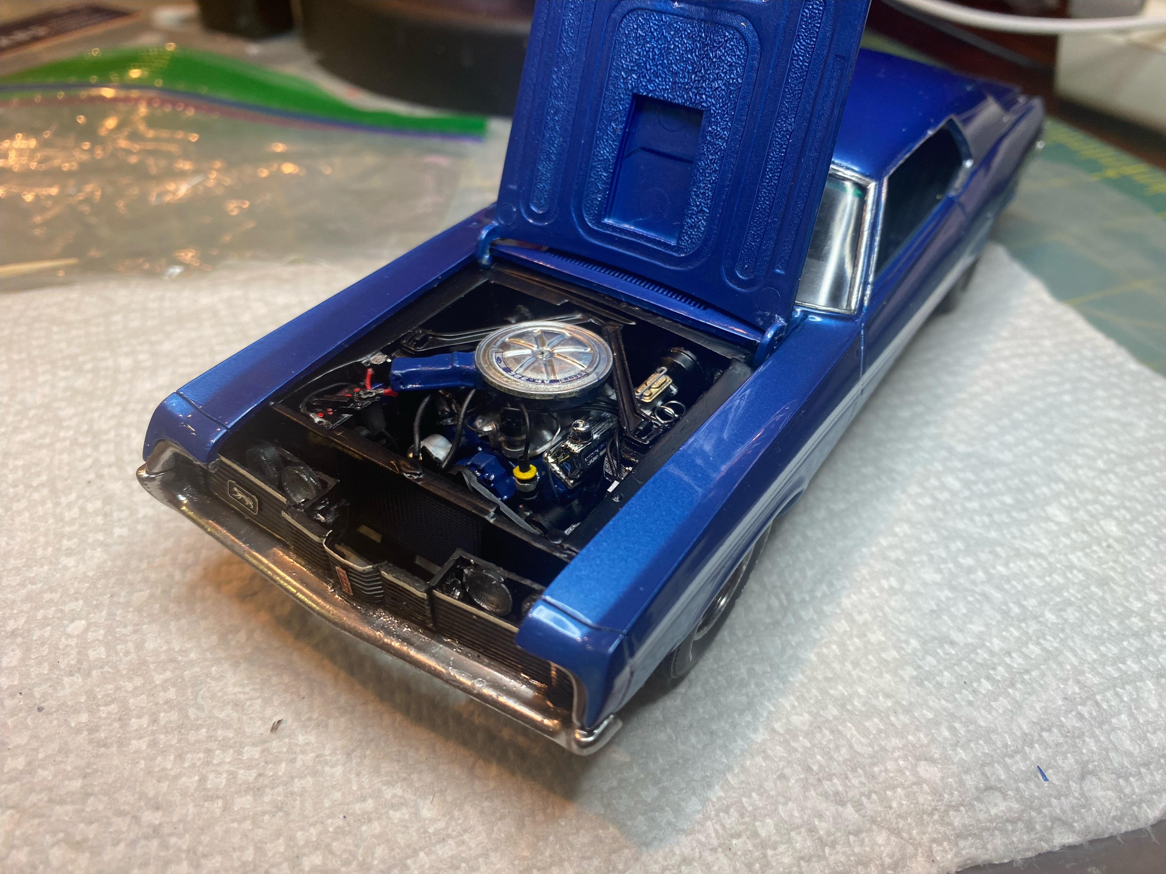

Thank you, I am pretty happy with how the engine compartment is coming out, considering the kit basically didn’t have one and it had to be scratch built.

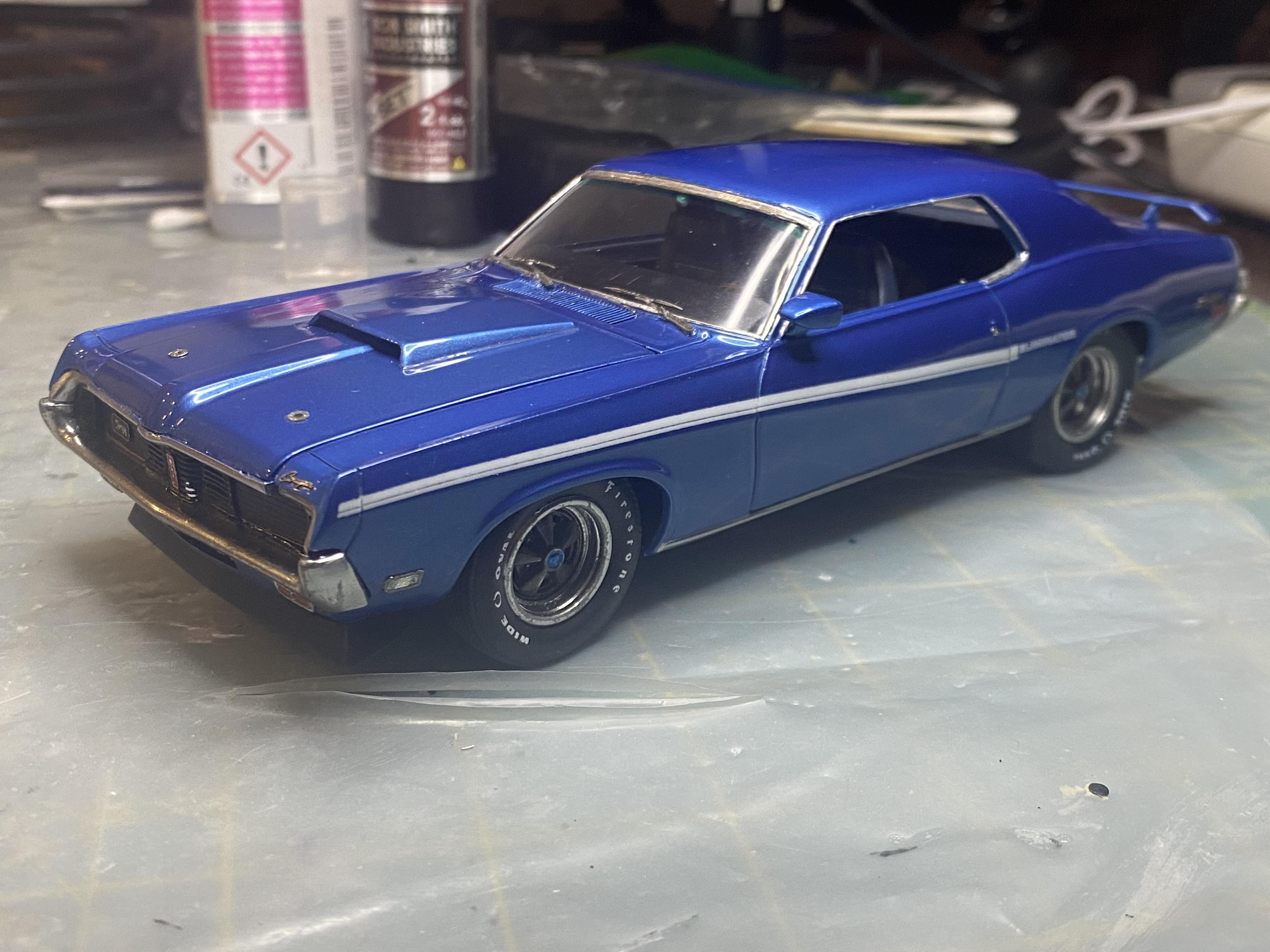

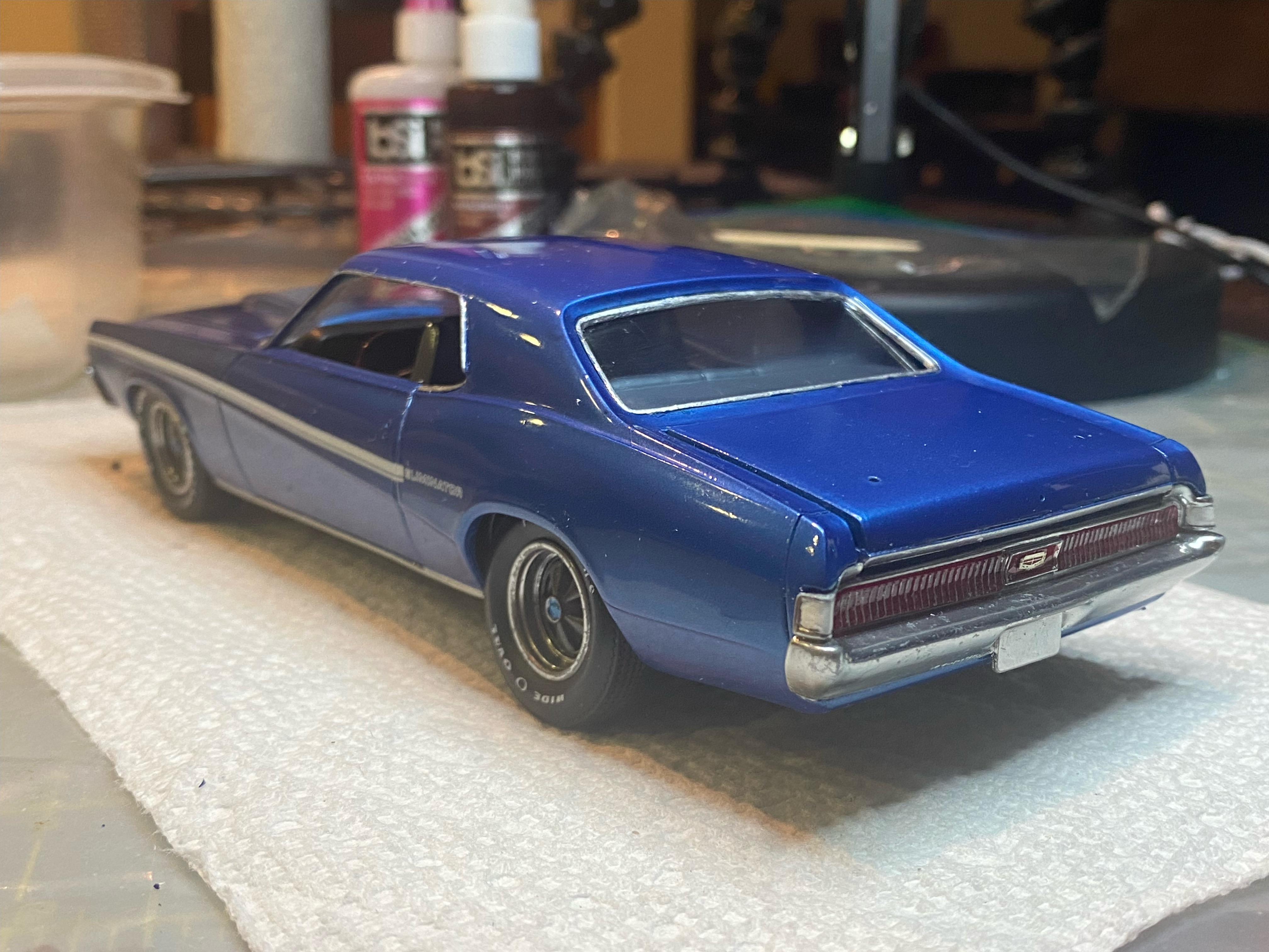

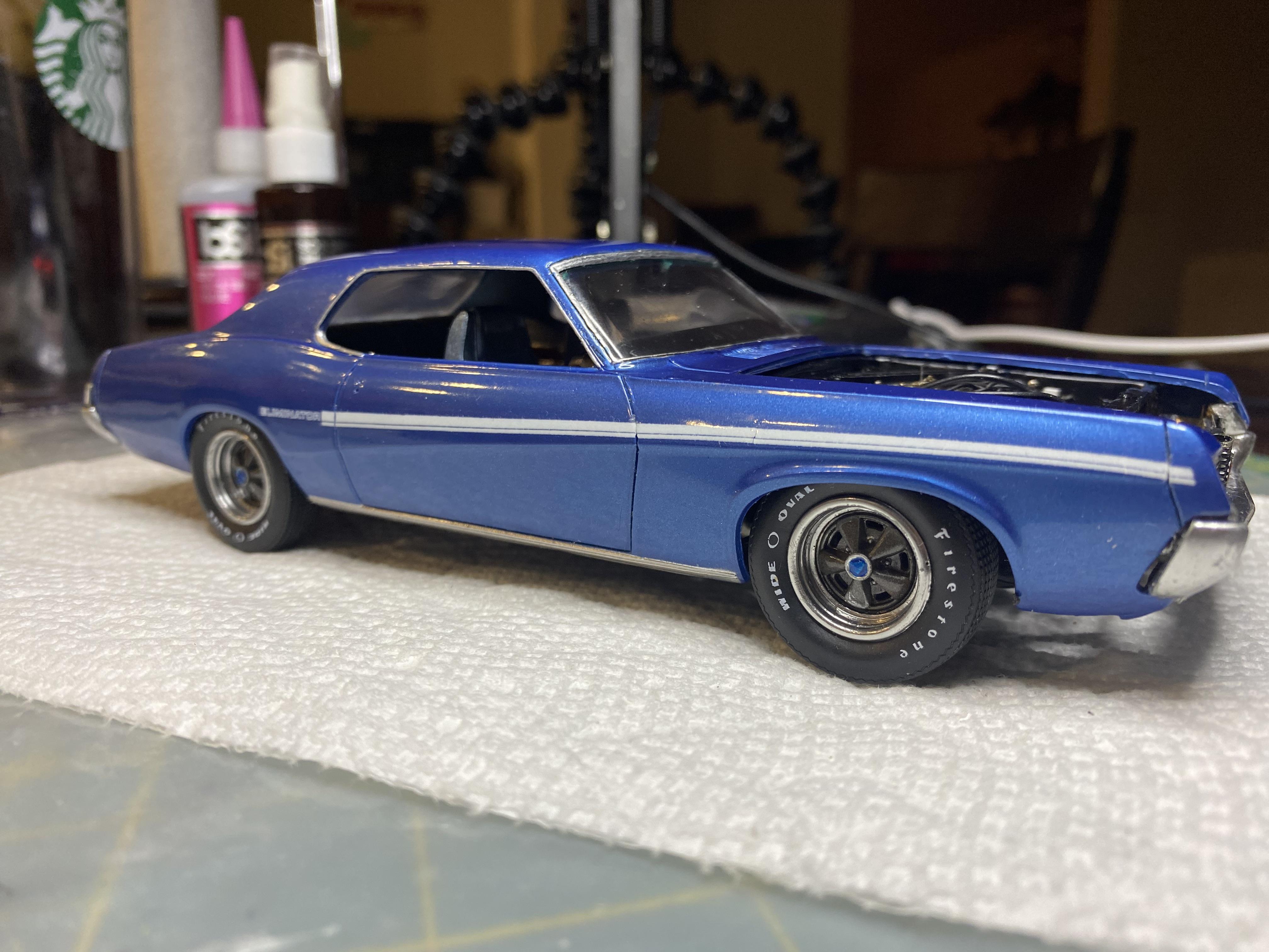

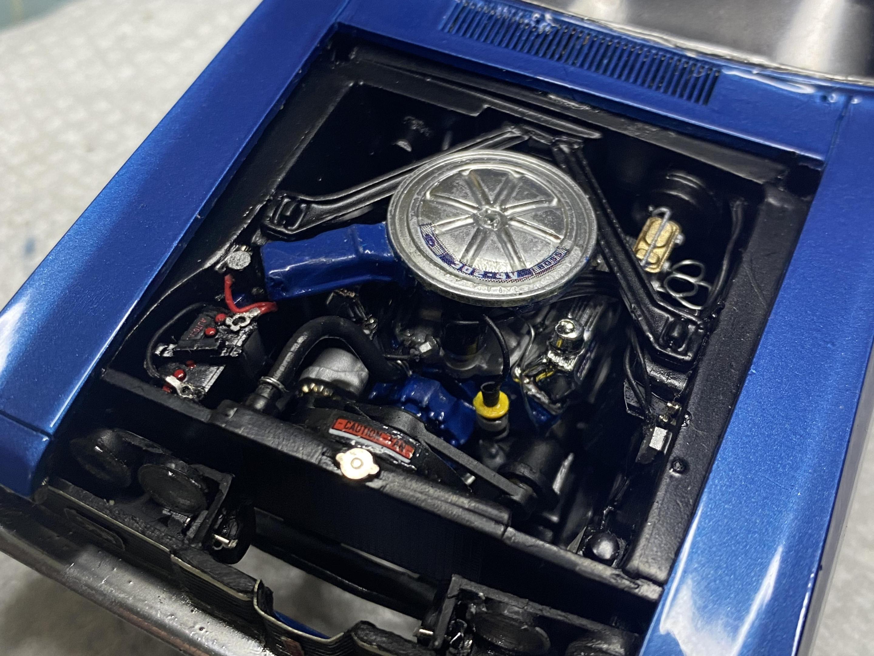

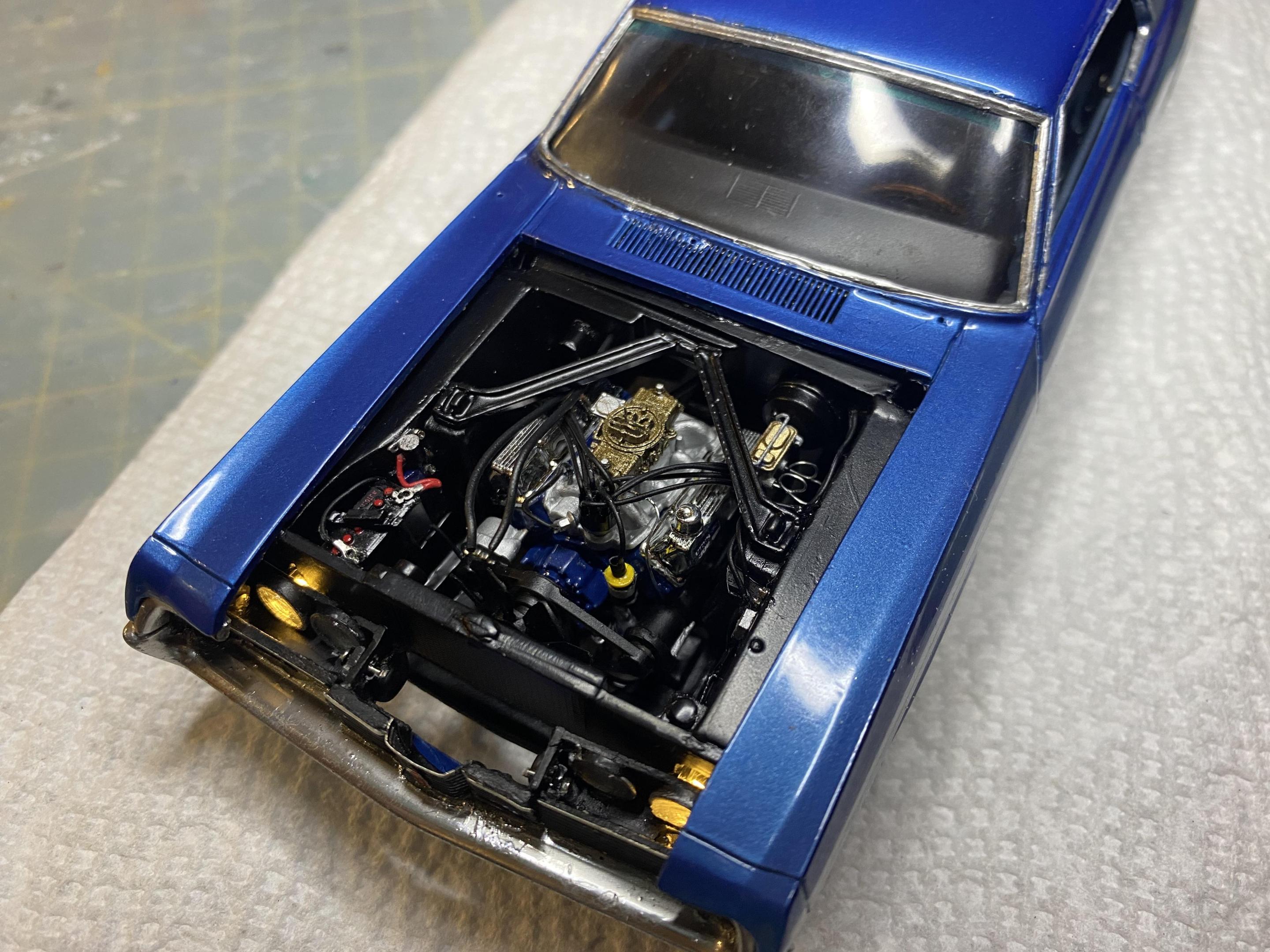

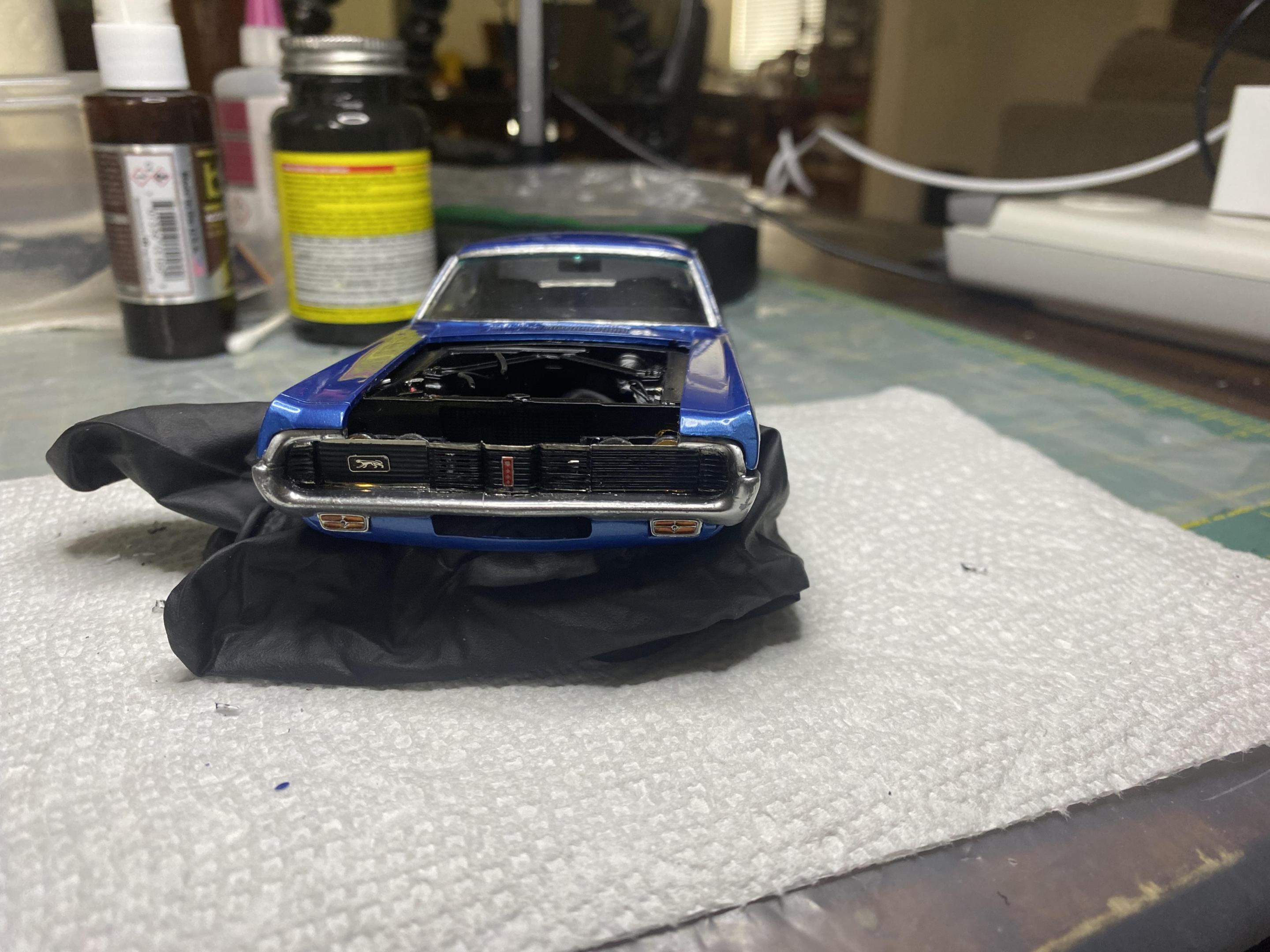

Got a lot more detailing done today, just a bit more to go.

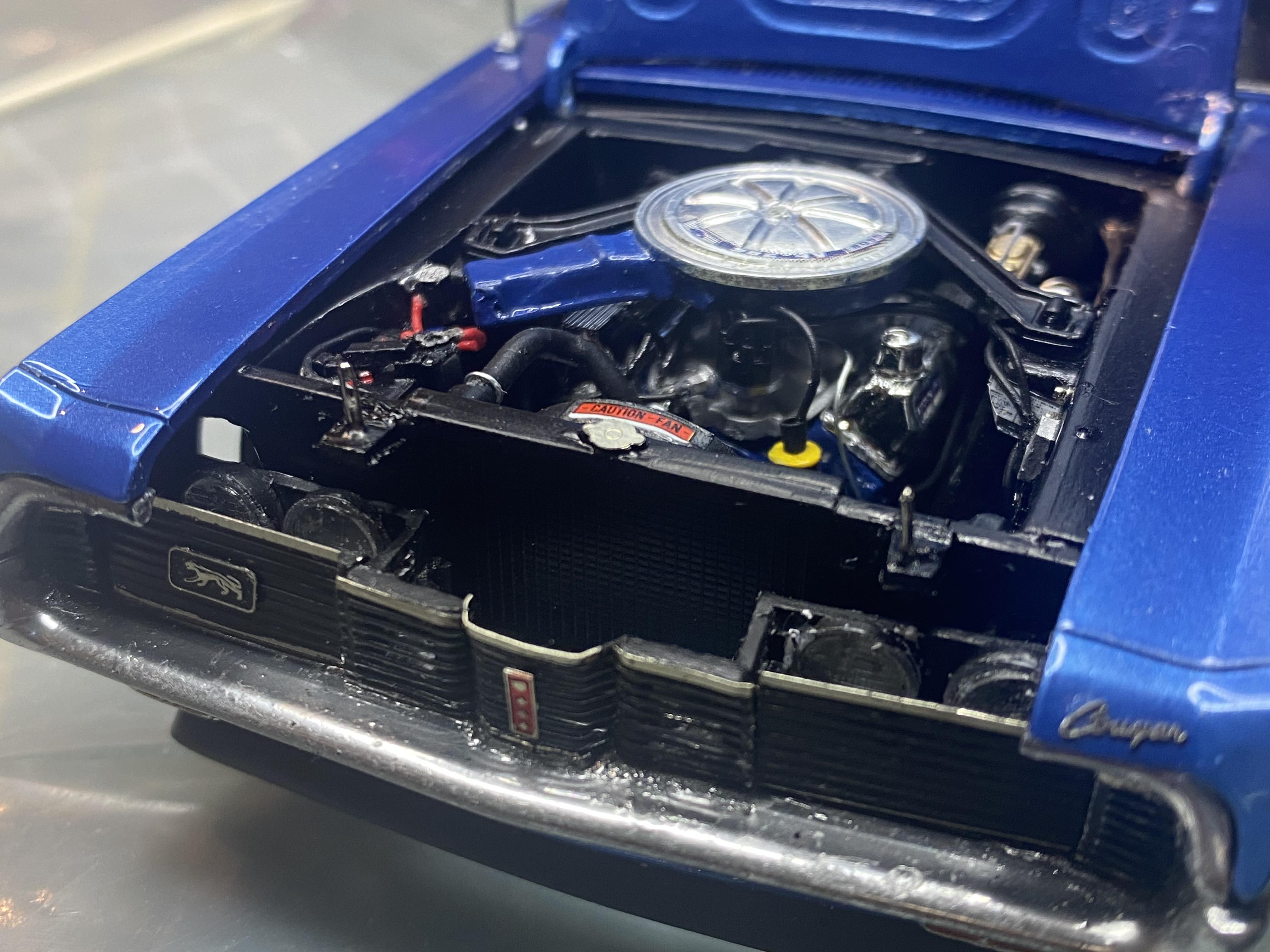

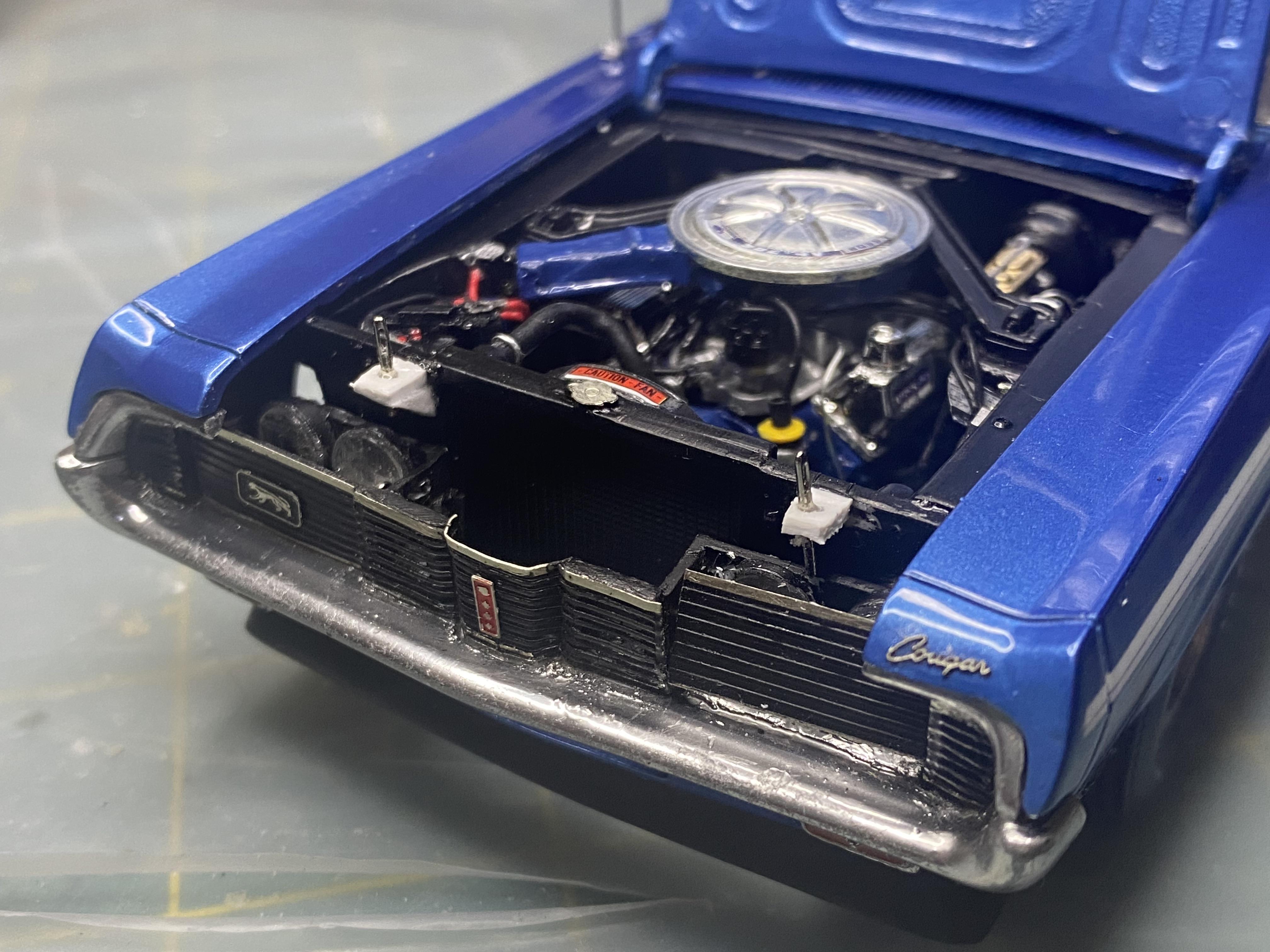

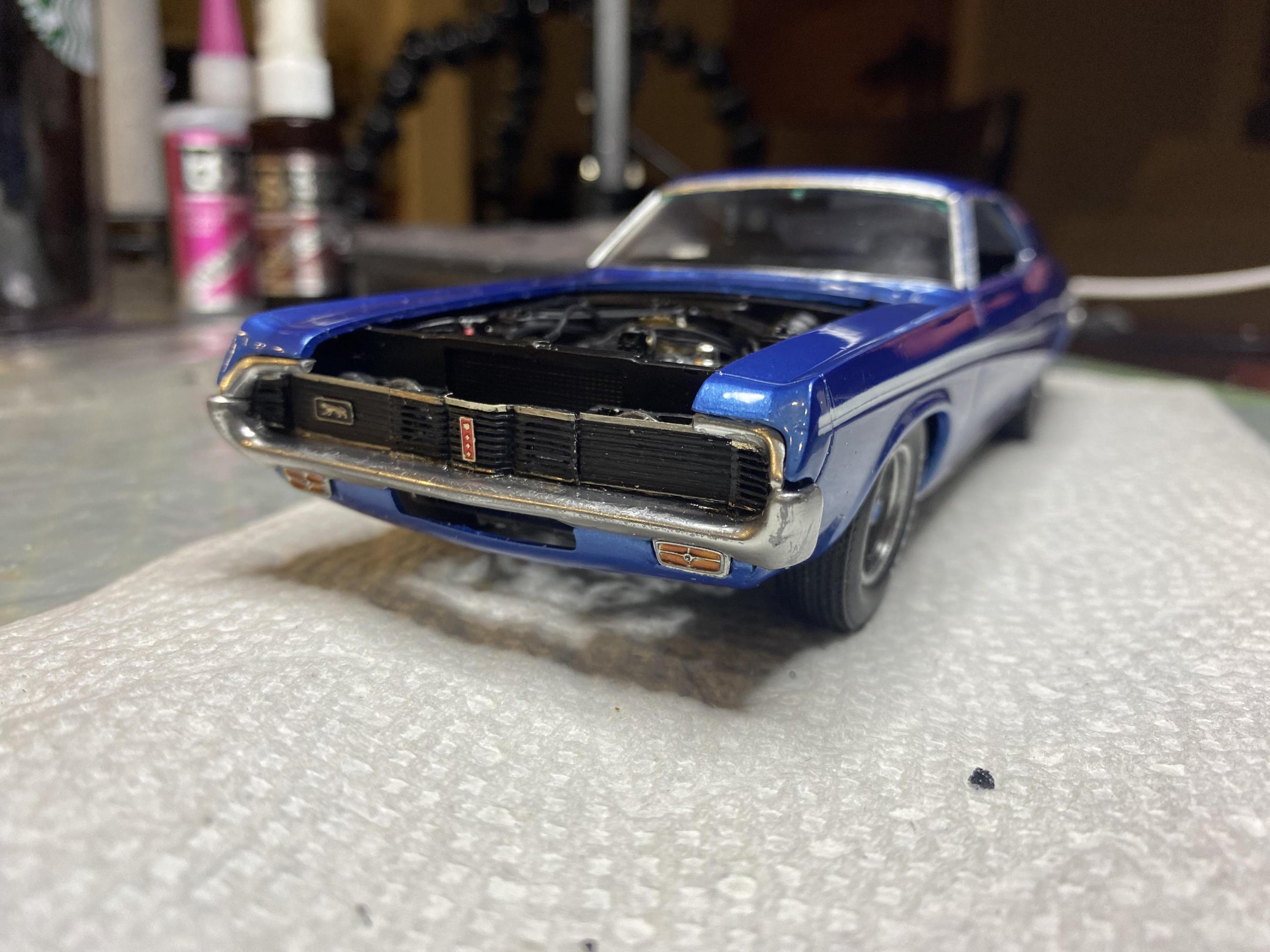

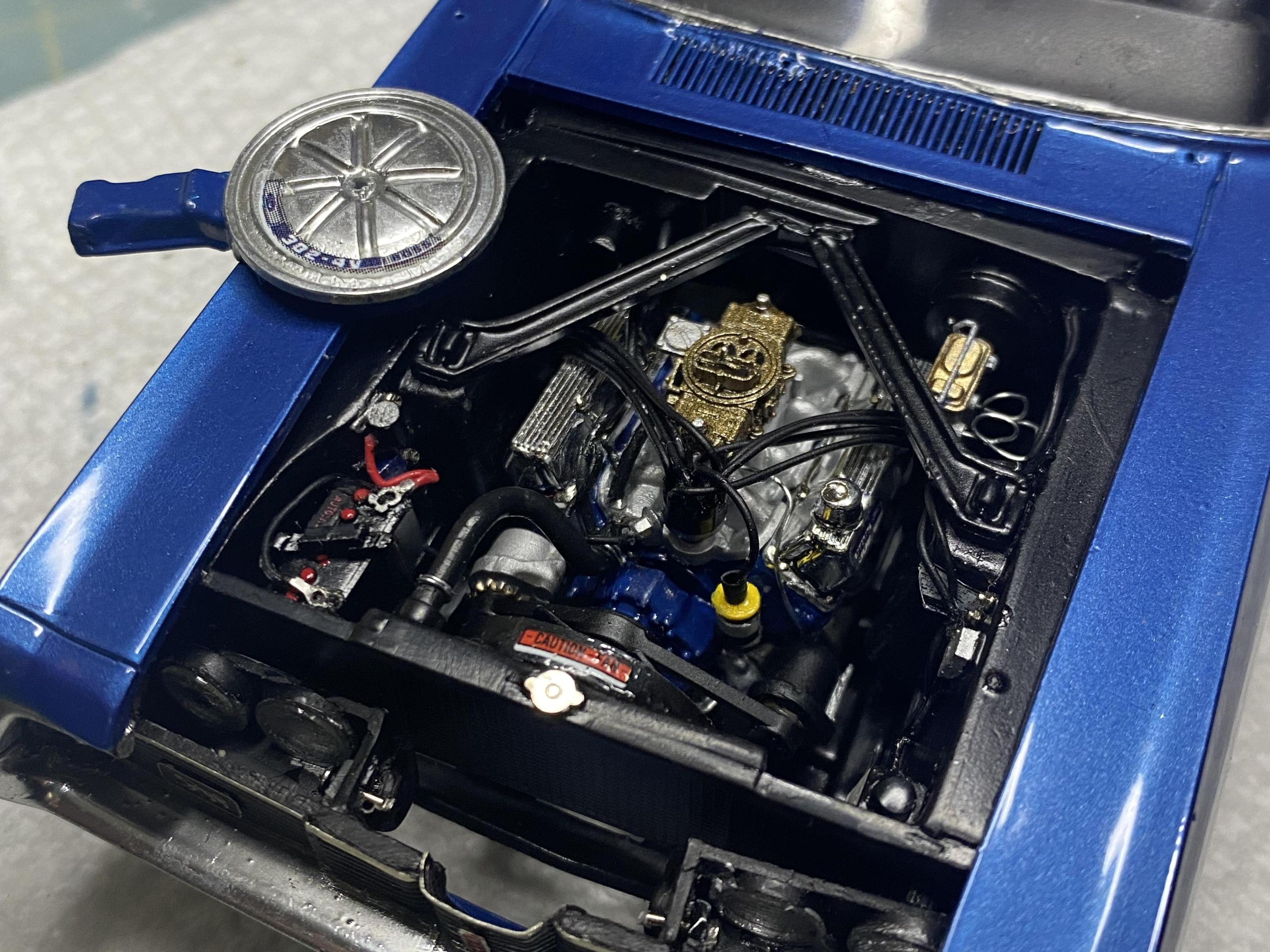

Pretty much finished up the engine compartment detailing with removable air cleaner.
IMG_5443.thumb.jpeg.88a59e8612f39ace3647438d12e9cb01.jpegIMG_5444.thumb.jpeg.438eb1b52a834788ce96380faddcb7b6.jpeg

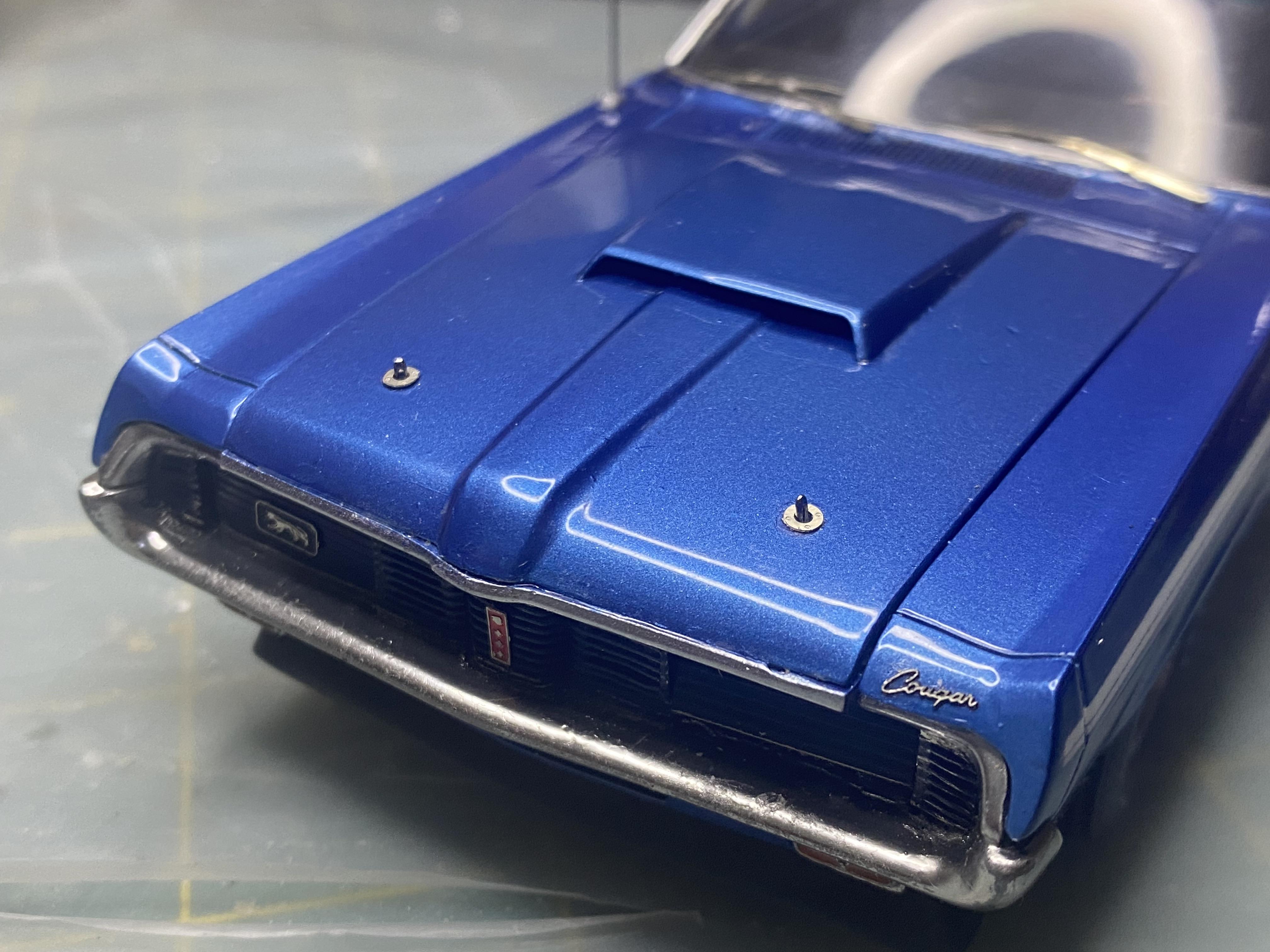

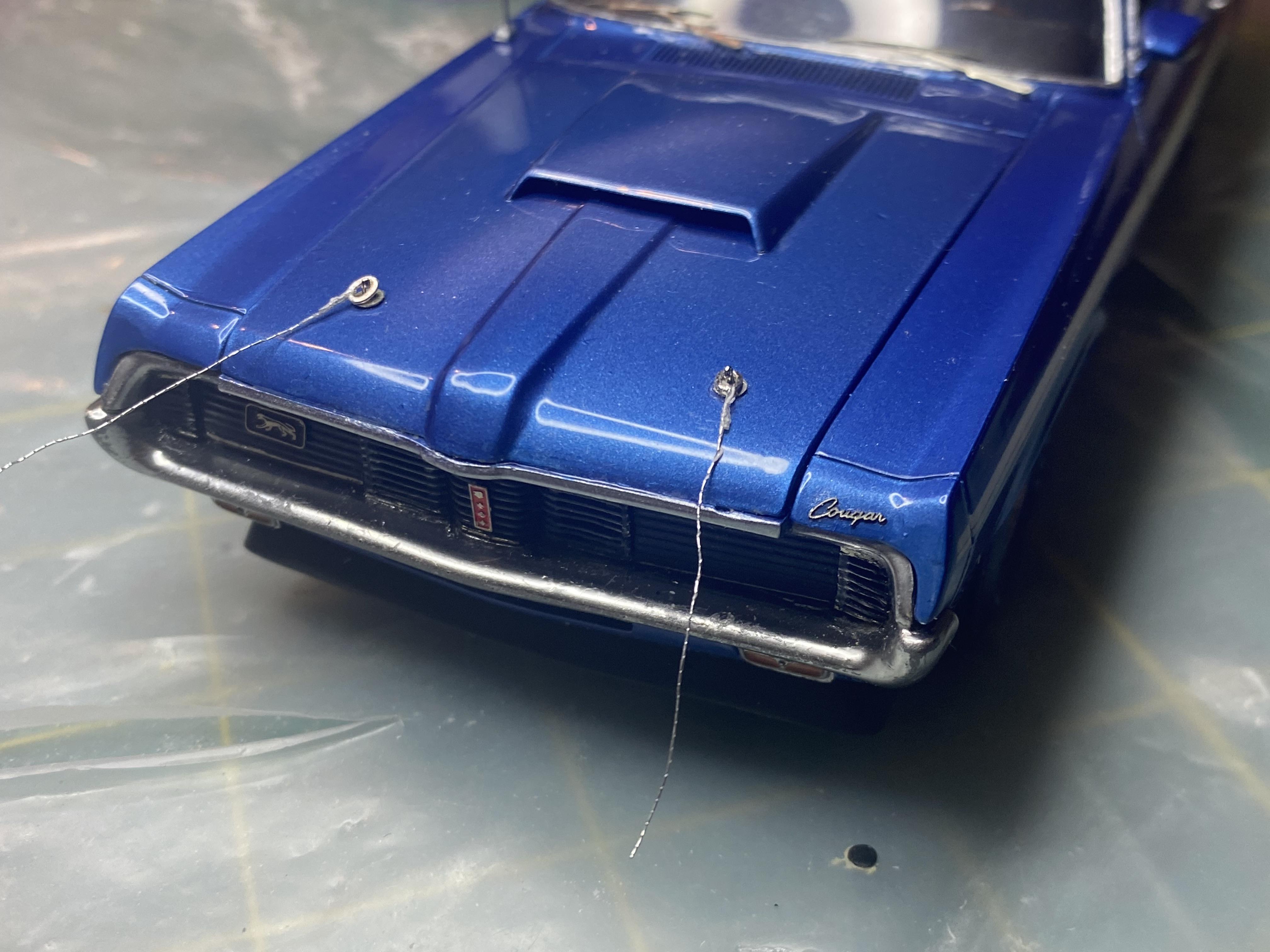

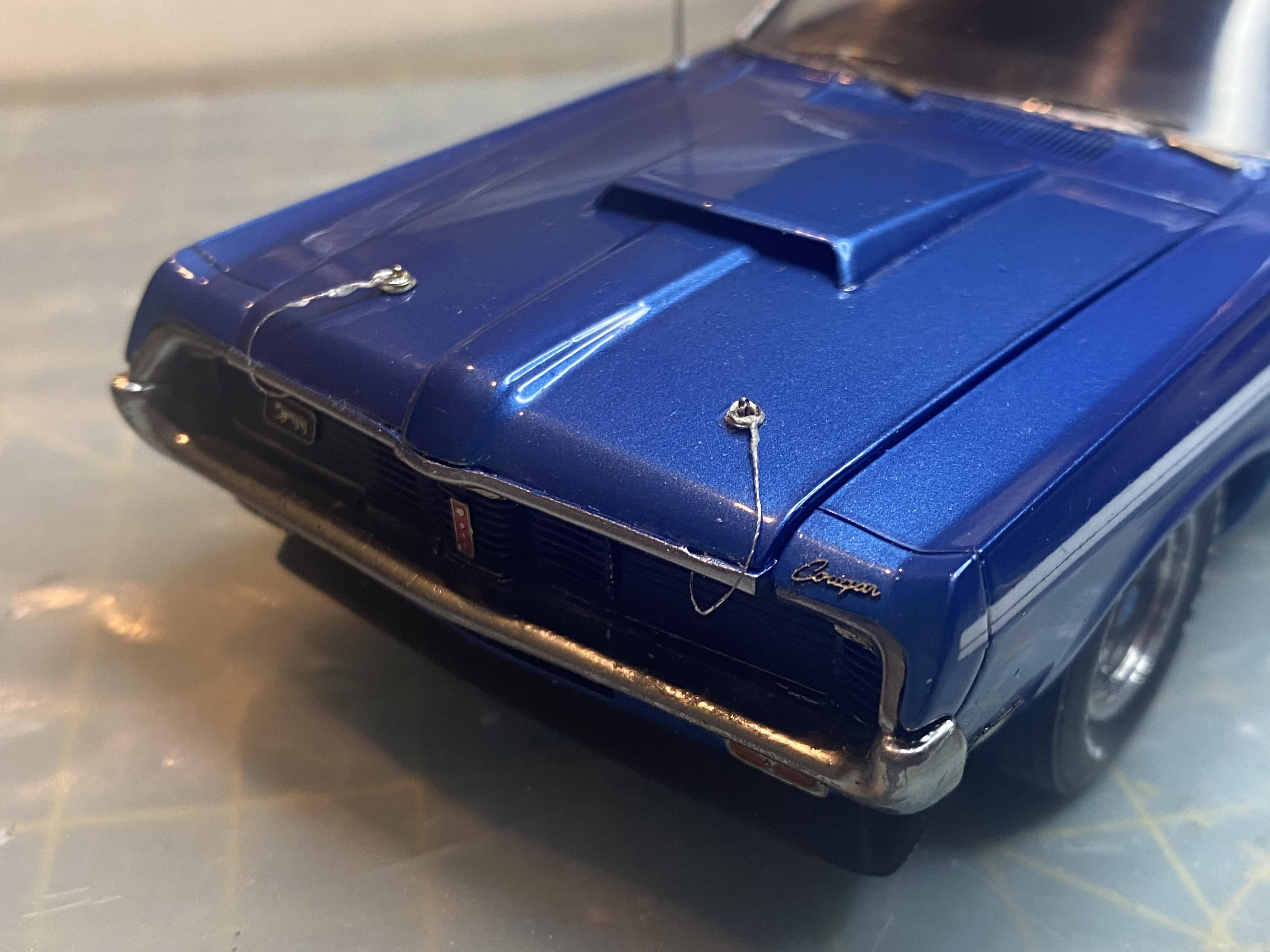

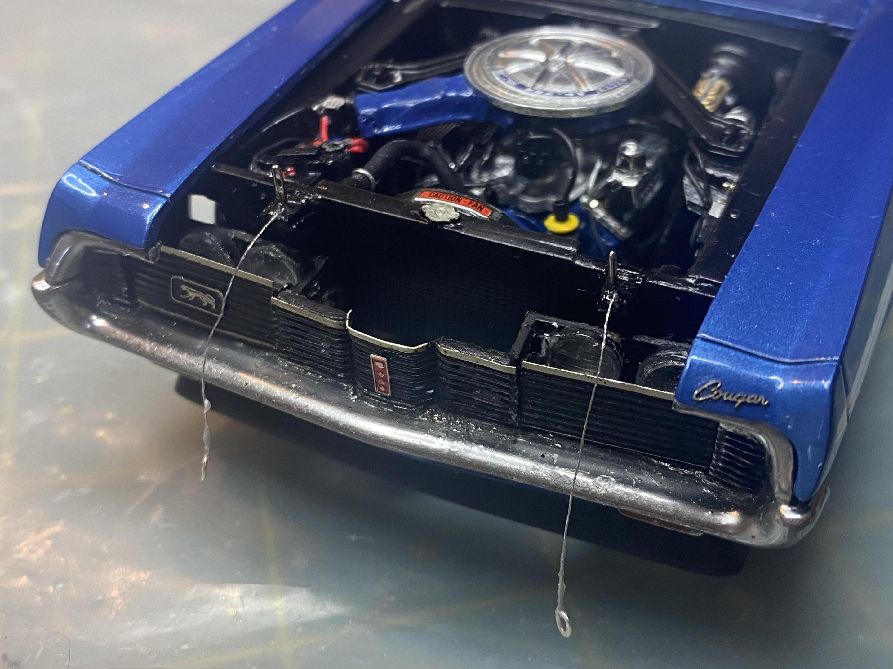

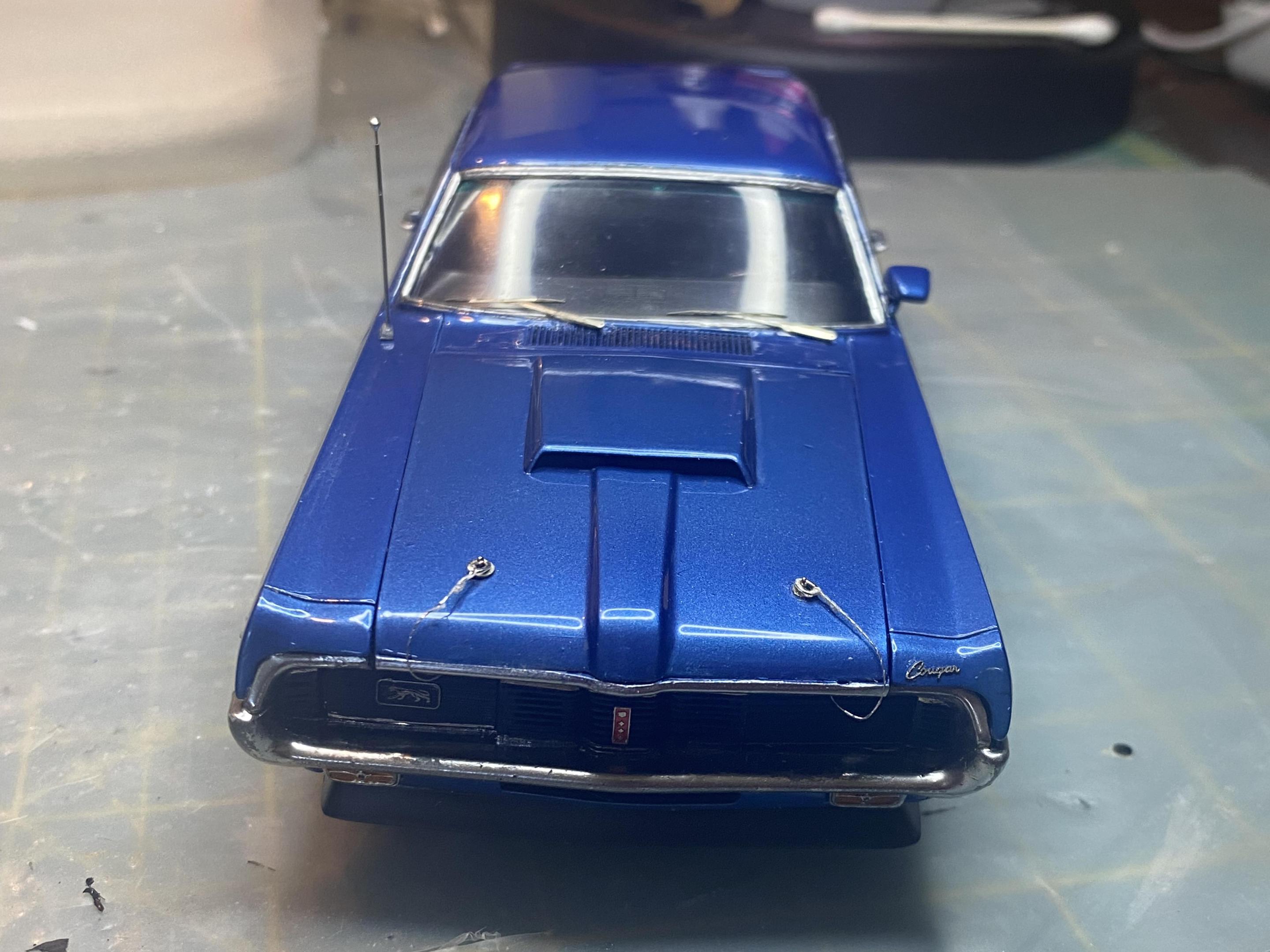

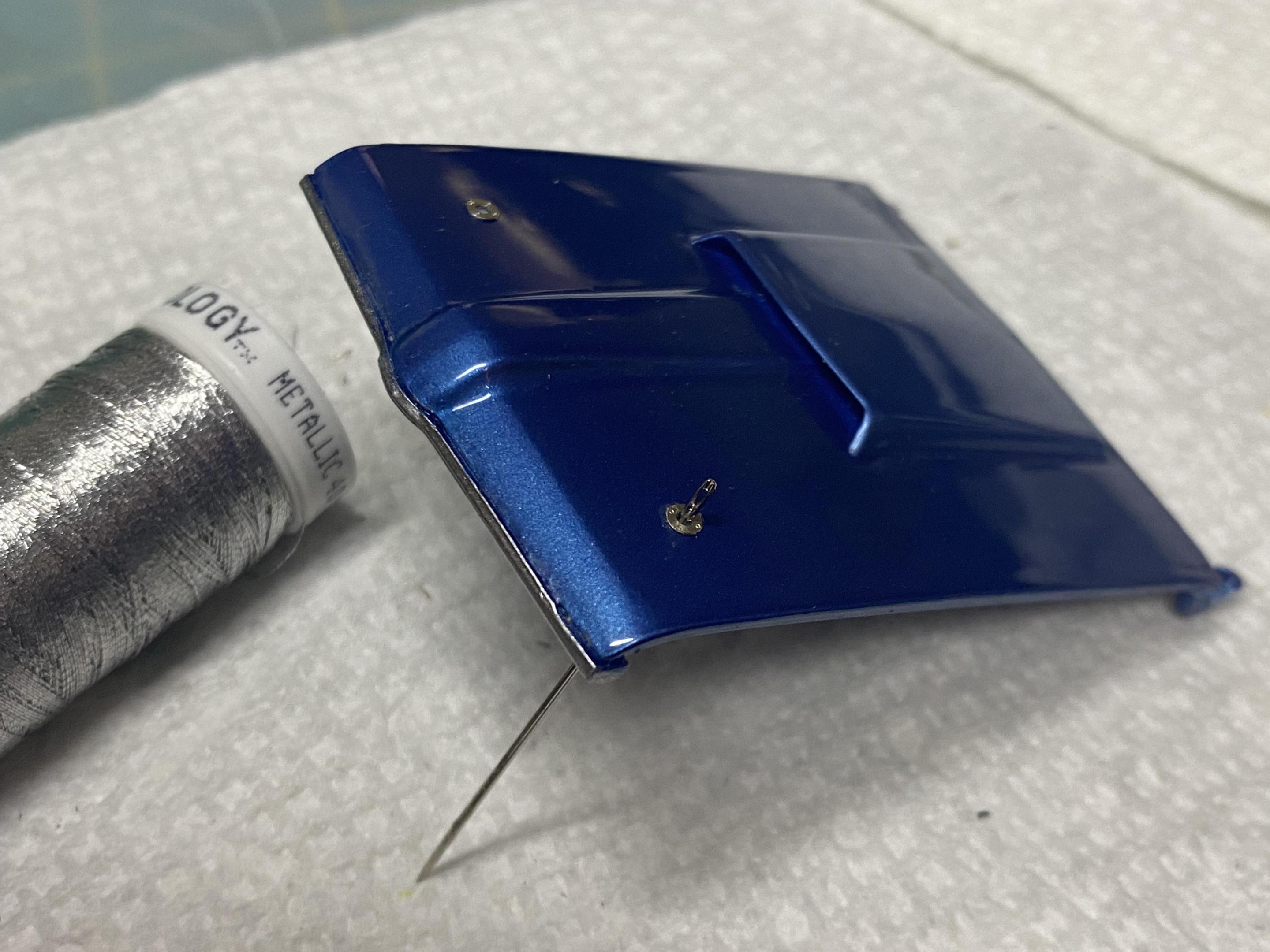

added the hood pin plates that came with the photo-etch kit. Picked up some bright silver thread and small needles from Hobby Lobby to make the pins and cables. Need to figure out the holding pins and rings.

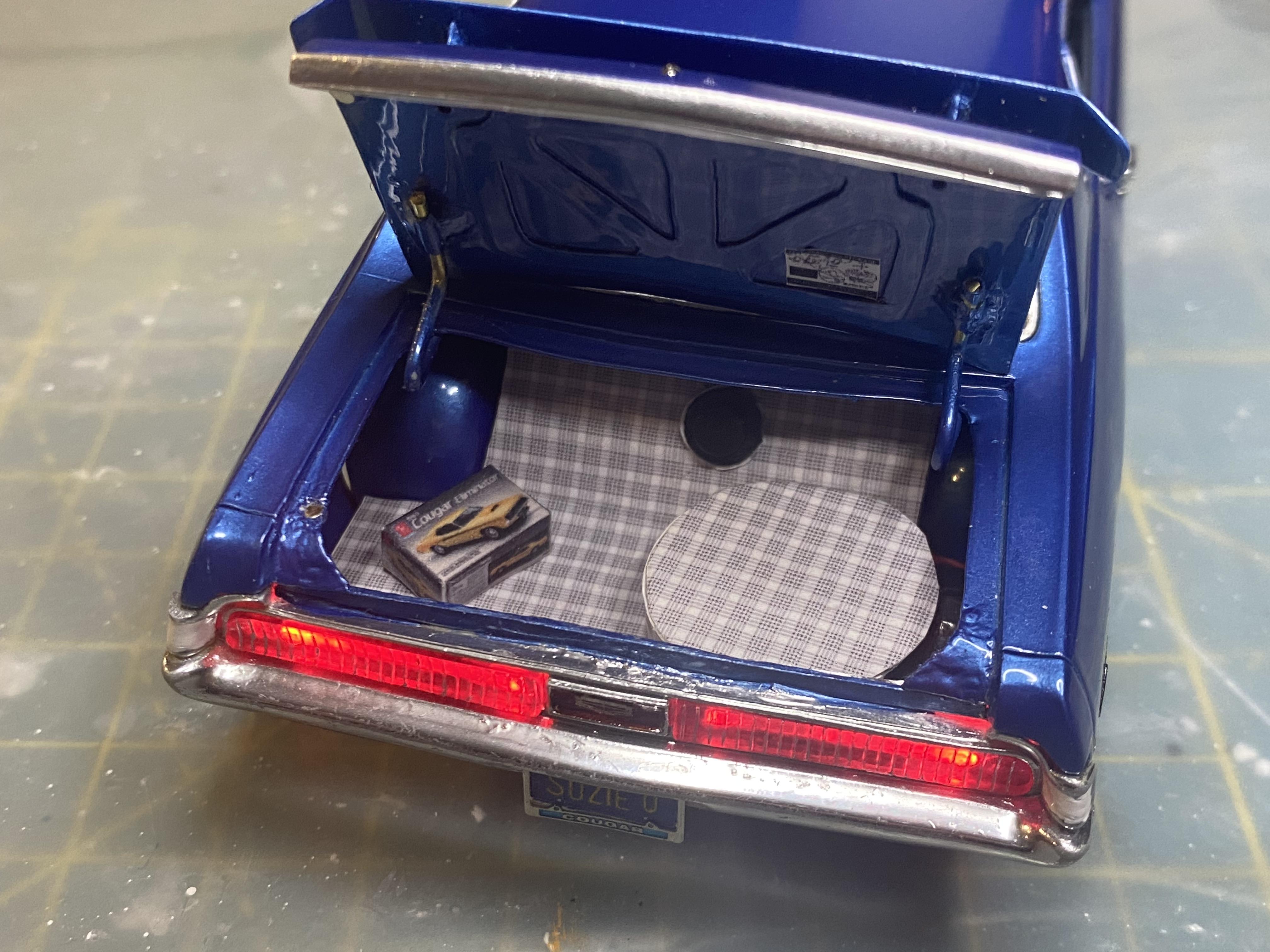

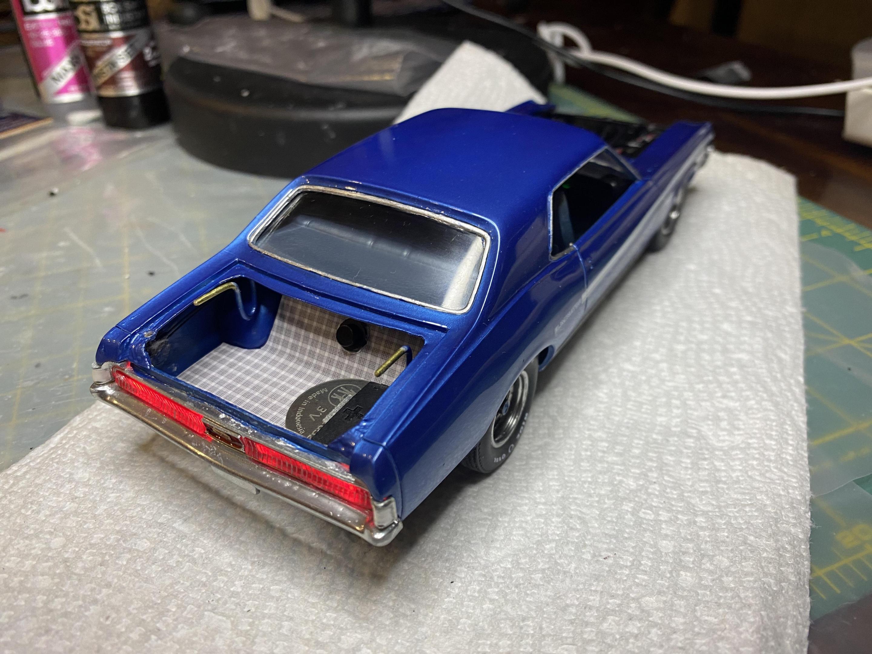

added the trunk jacking instruction decal

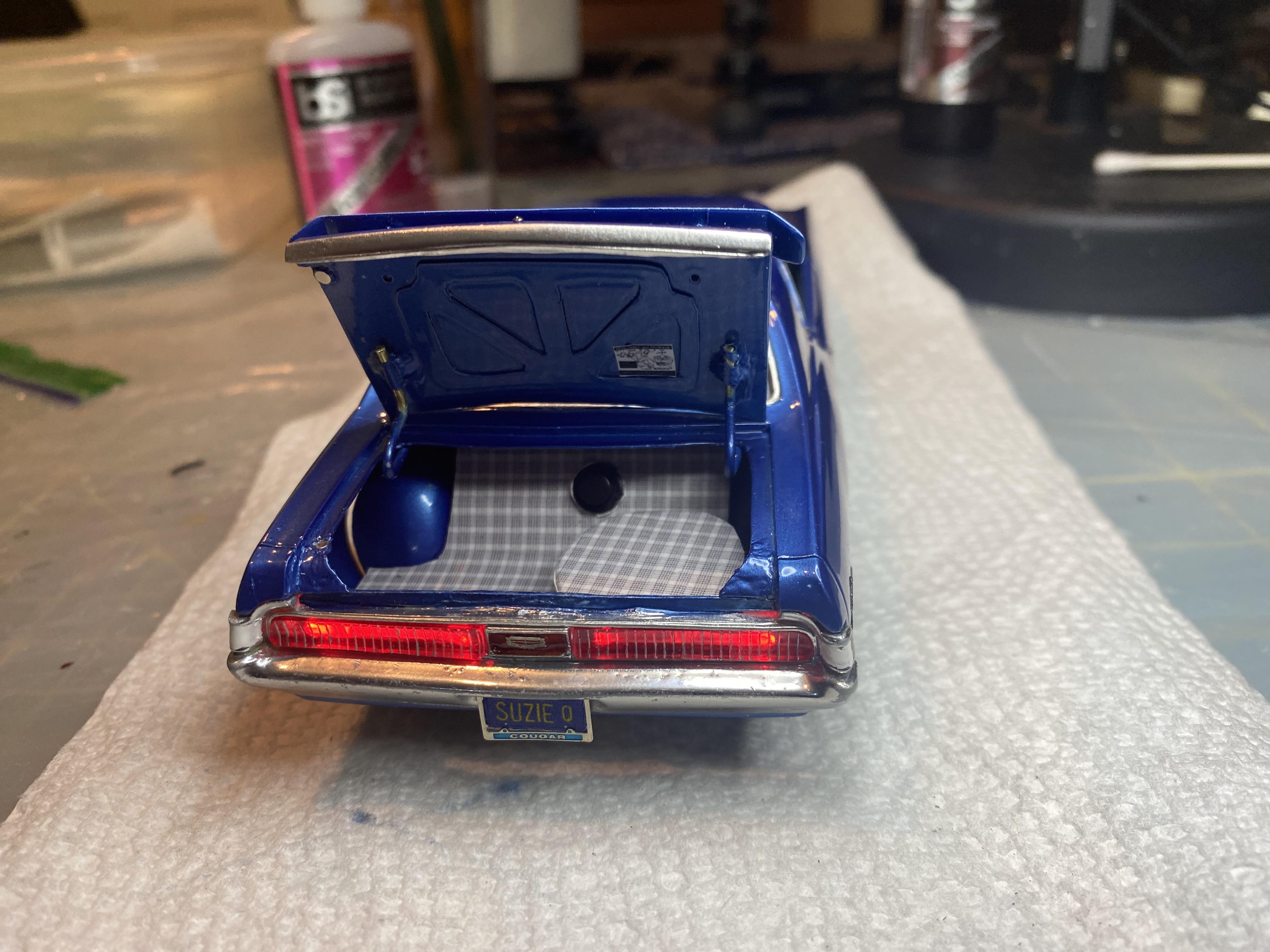

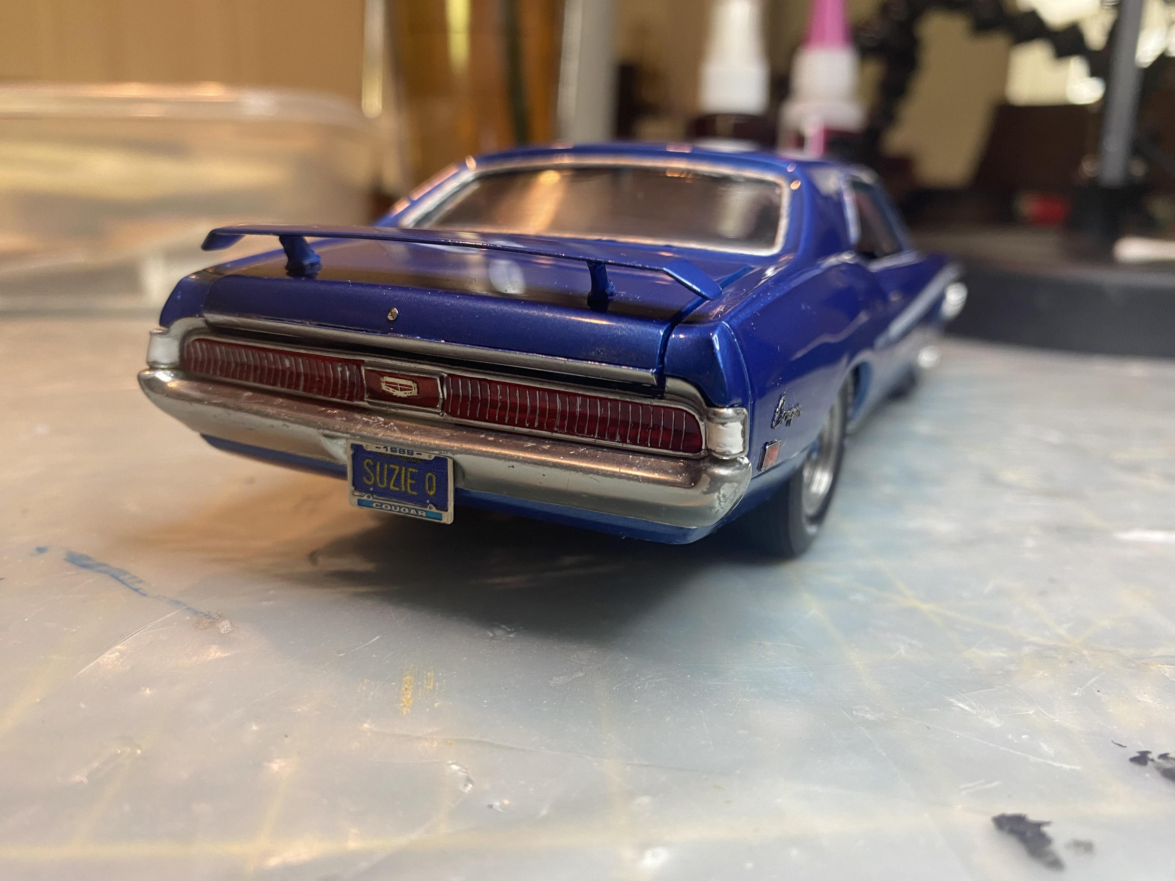

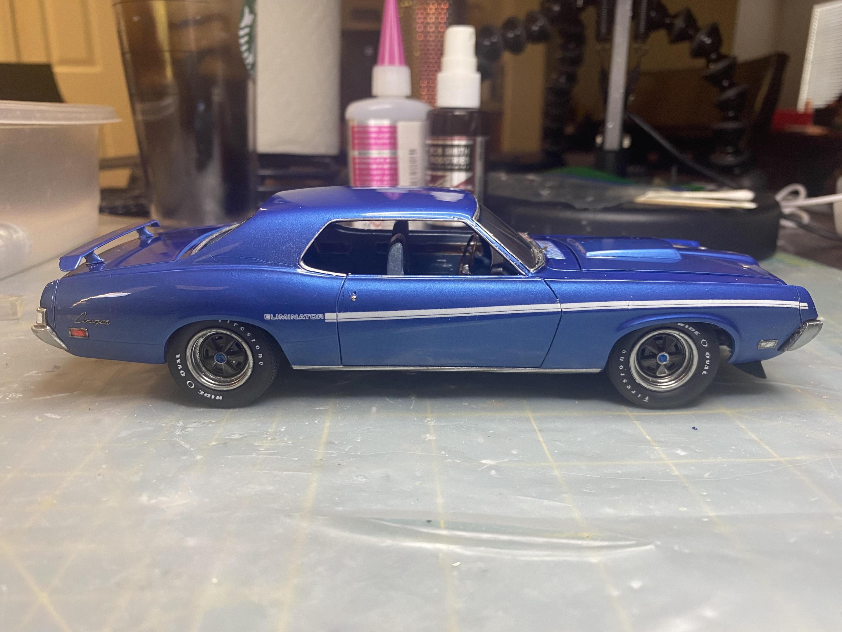

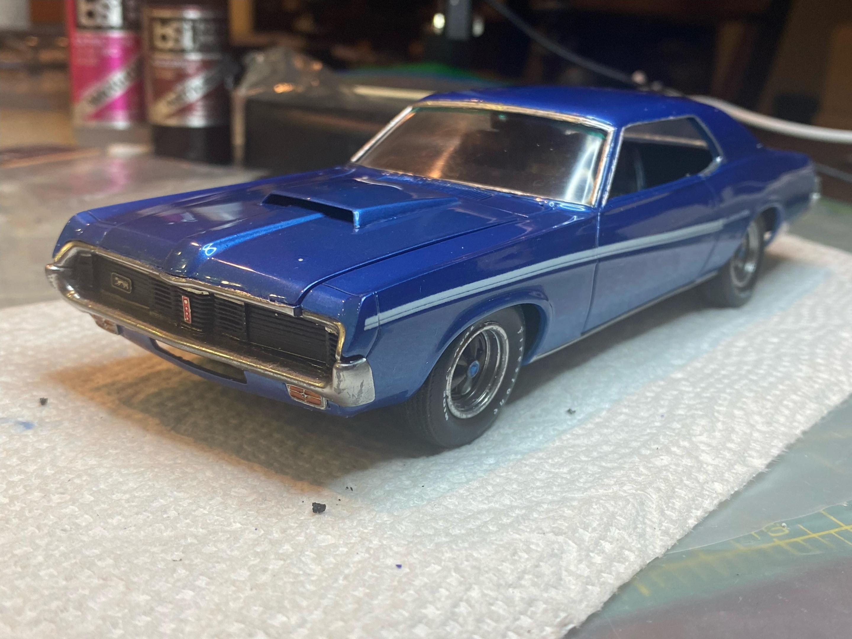

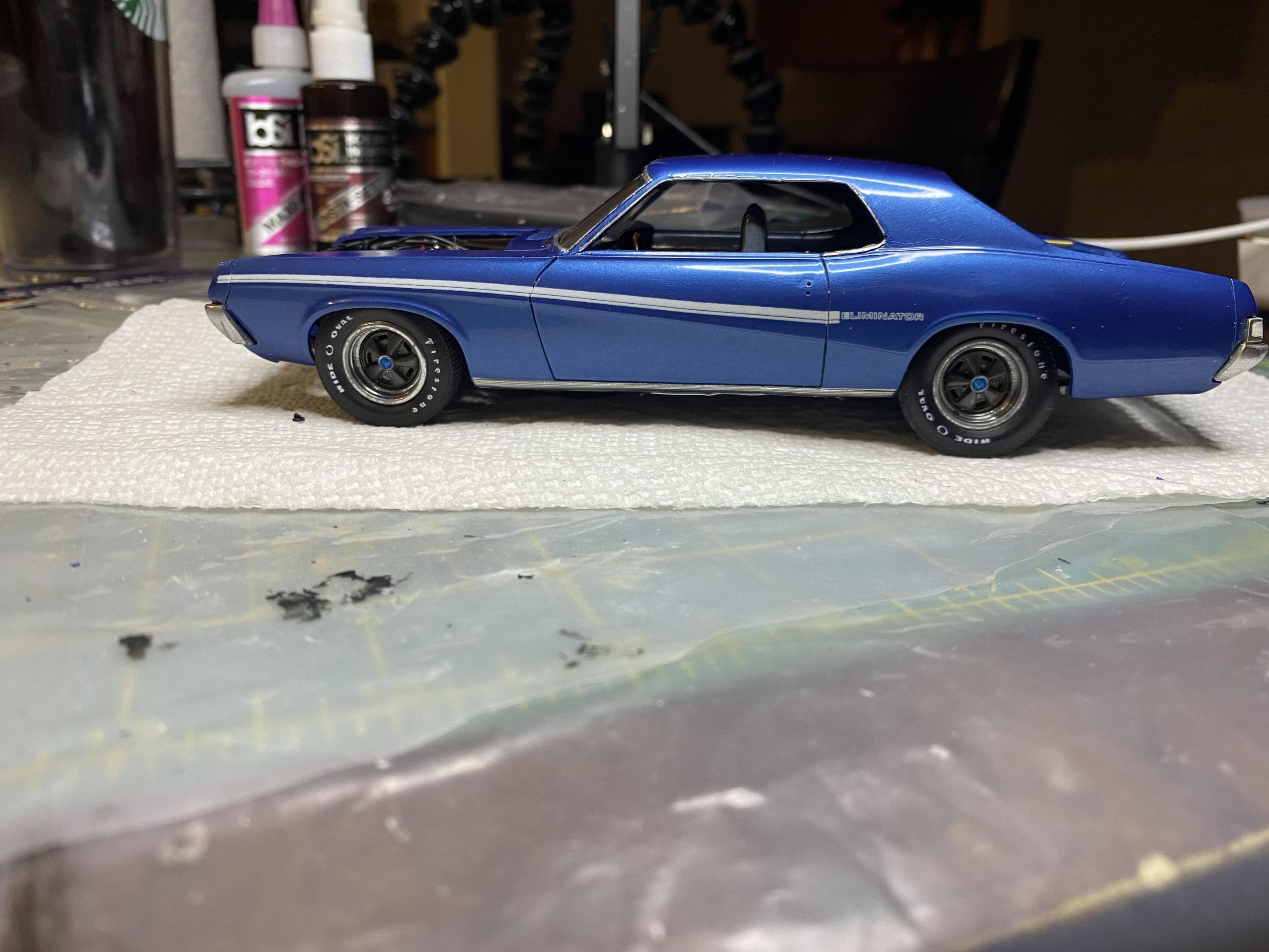

added a lot of photo-detail parts and the rear spoiler. Water spots on side from having to polish out the roof, got a drop of glue I had to sand out and polish, ?

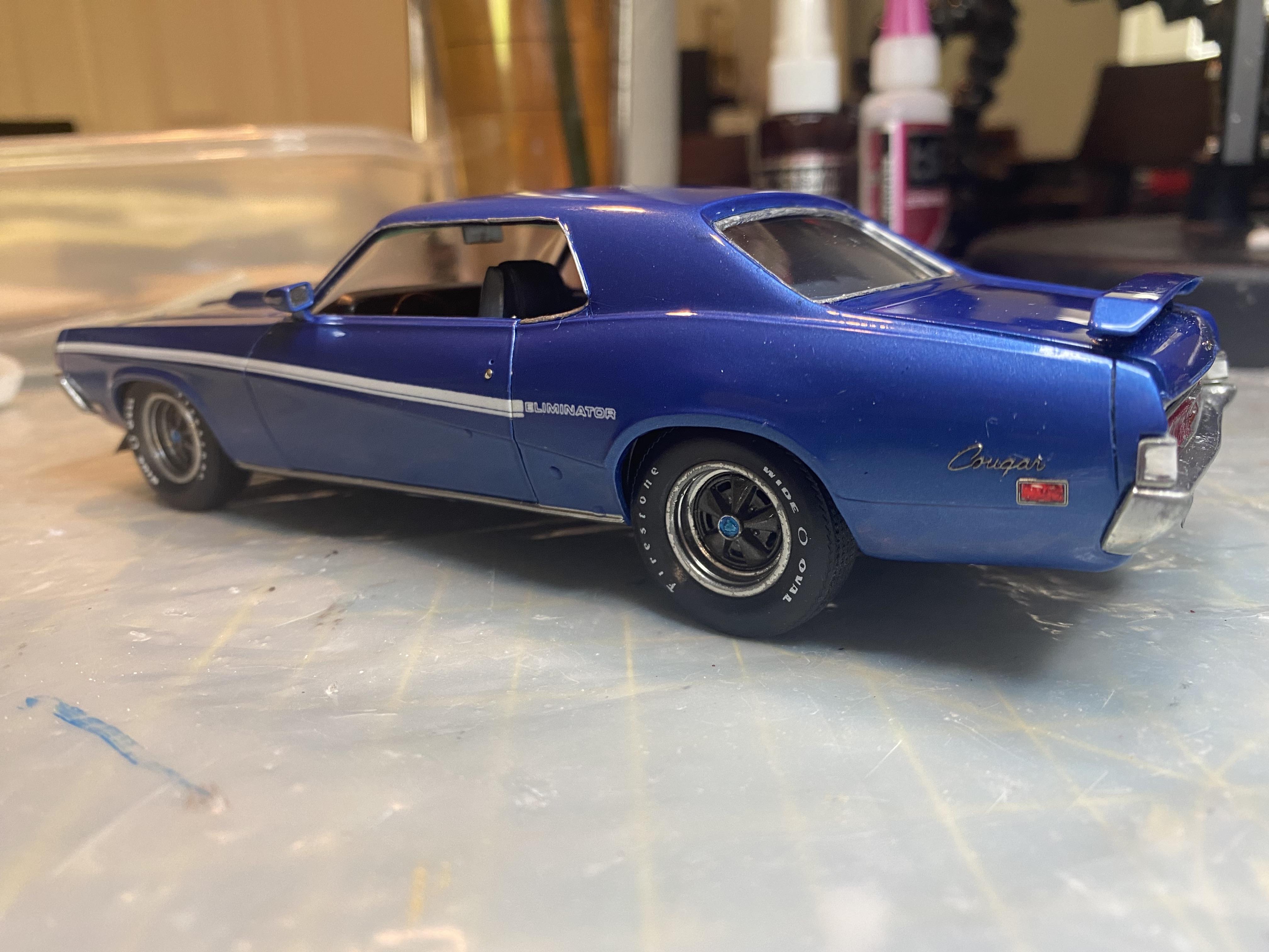

Decided to name this one SuzieQ just like the truck build for her. This time because she is 1 1/2 years older than me, and this is a Cougar. She didn’t find it too funny. We’ve been married for 40 years so she will get over it. ?
IMG_5449.thumb.jpeg.8415a6d1b3ced780715d578ff42d246b.jpegIMG_5451.thumb.jpeg.cd807516d0943672f5c8f0718c00a105.jpegIMG_5452.thumb.jpeg.03649a514caecece216b1d066b2f4ffc.jpeg

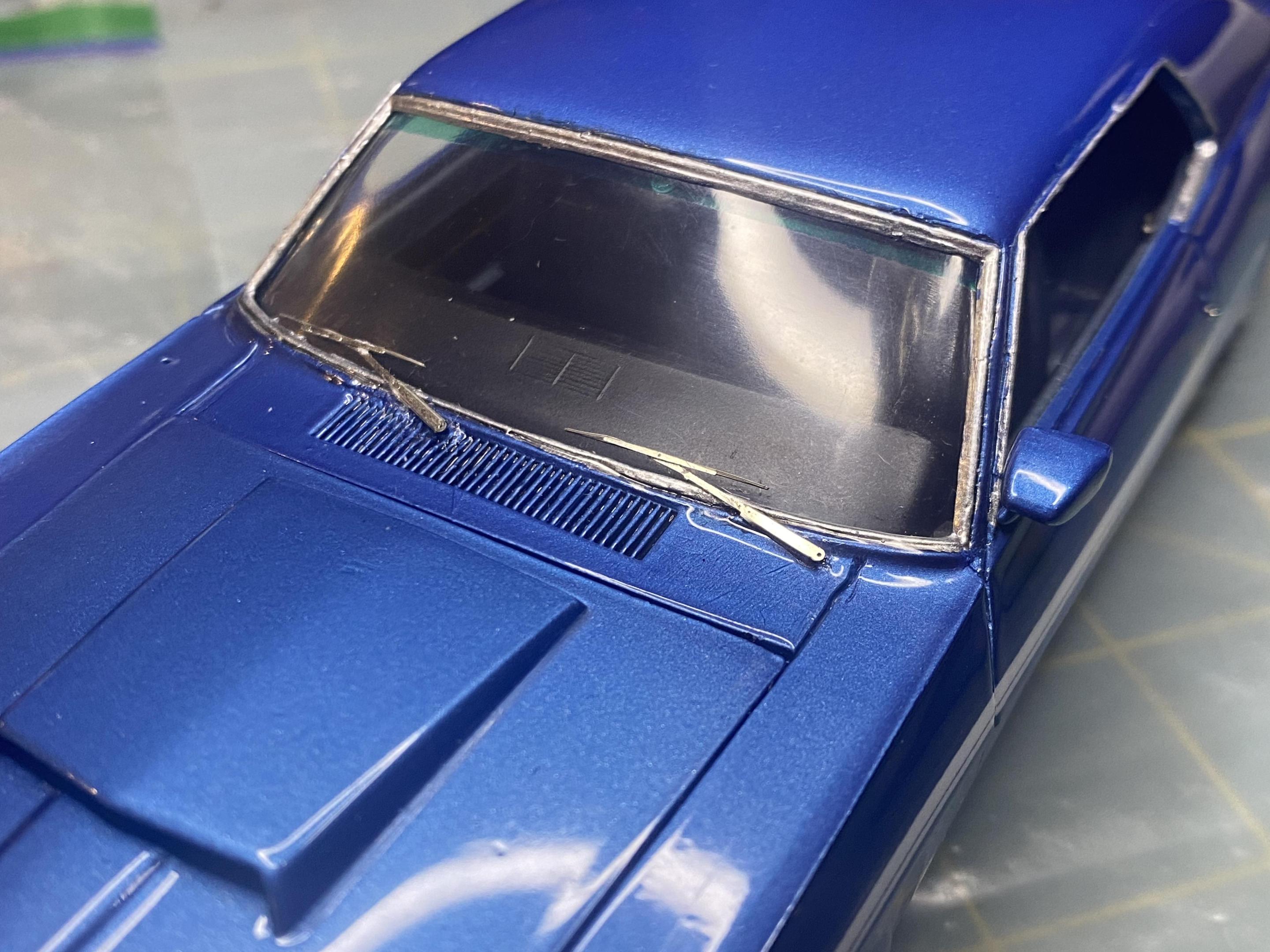

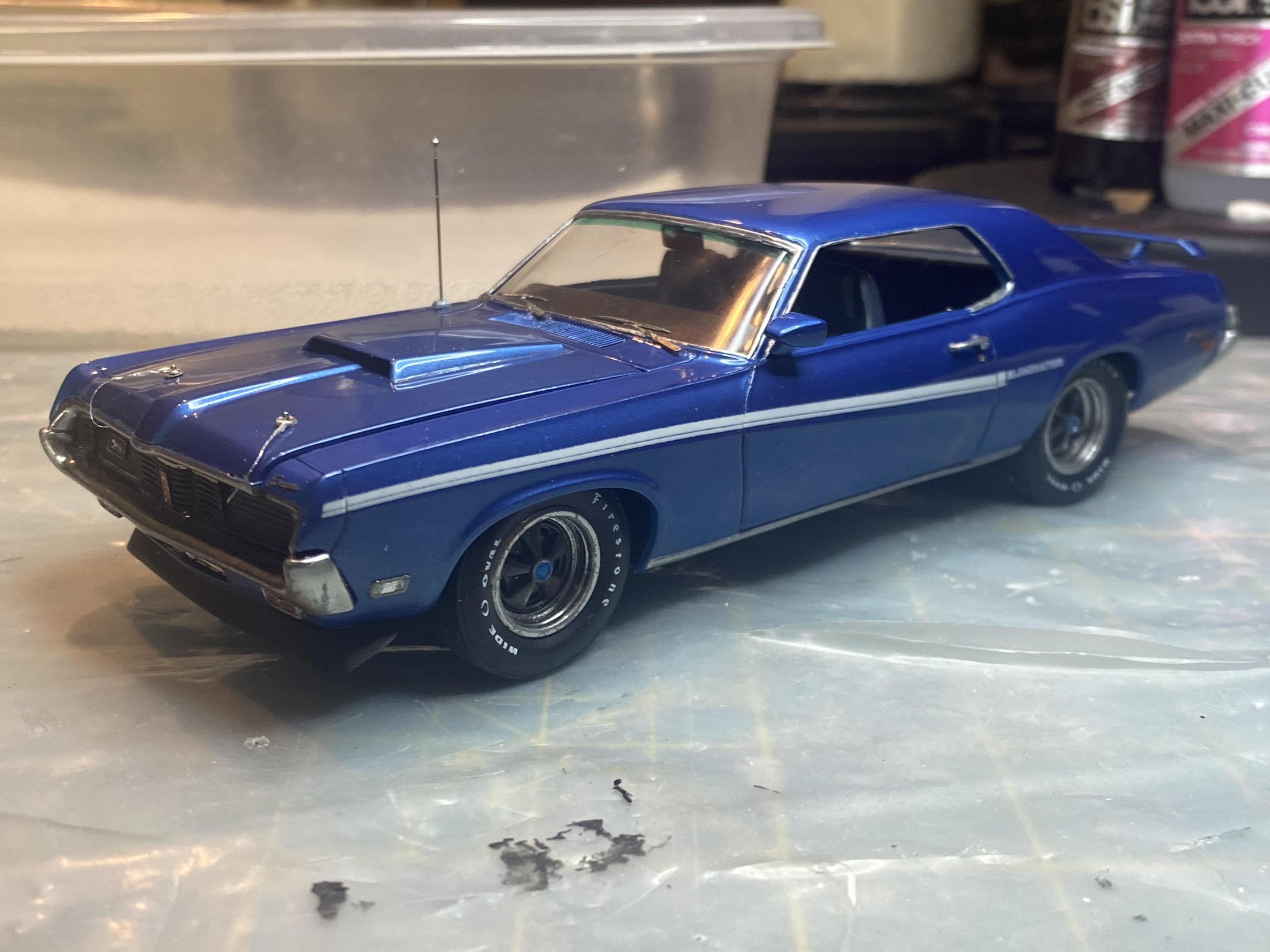

added photo-etch wipers.
IMG_5454.thumb.jpeg.a2218ebb028c2573f6654747d7c86c2a.jpegIMG_5455.thumb.jpeg.69279c2b0712e2bcb13250b5ff91d3c8.jpegIMG_5456.thumb.jpeg.cf59193b1932ff33640957ccfd09eab4.jpegIMG_5457.thumb.jpeg.24ebd982fa9832c32dcf0b53b20d5553.jpegIMG_5460.thumb.jpeg.580cce87c57c12c6986c20721de2607a.jpeg

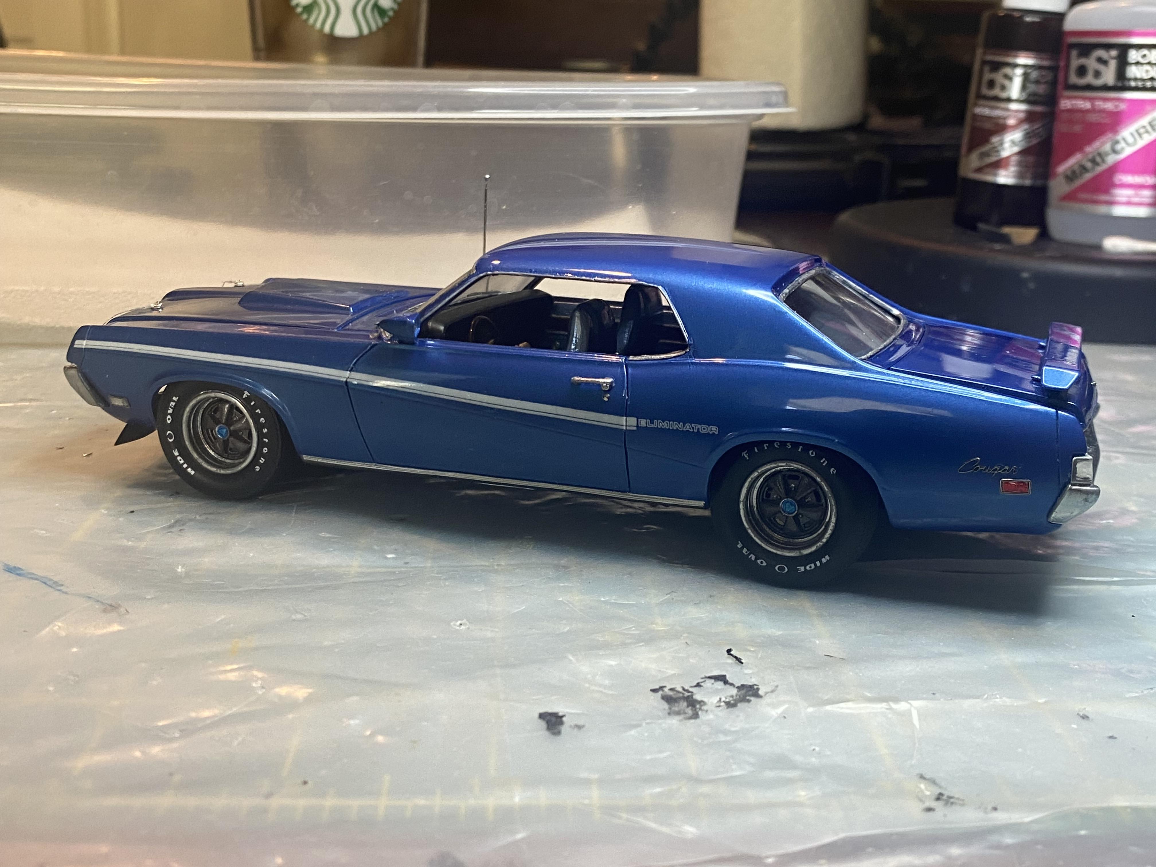

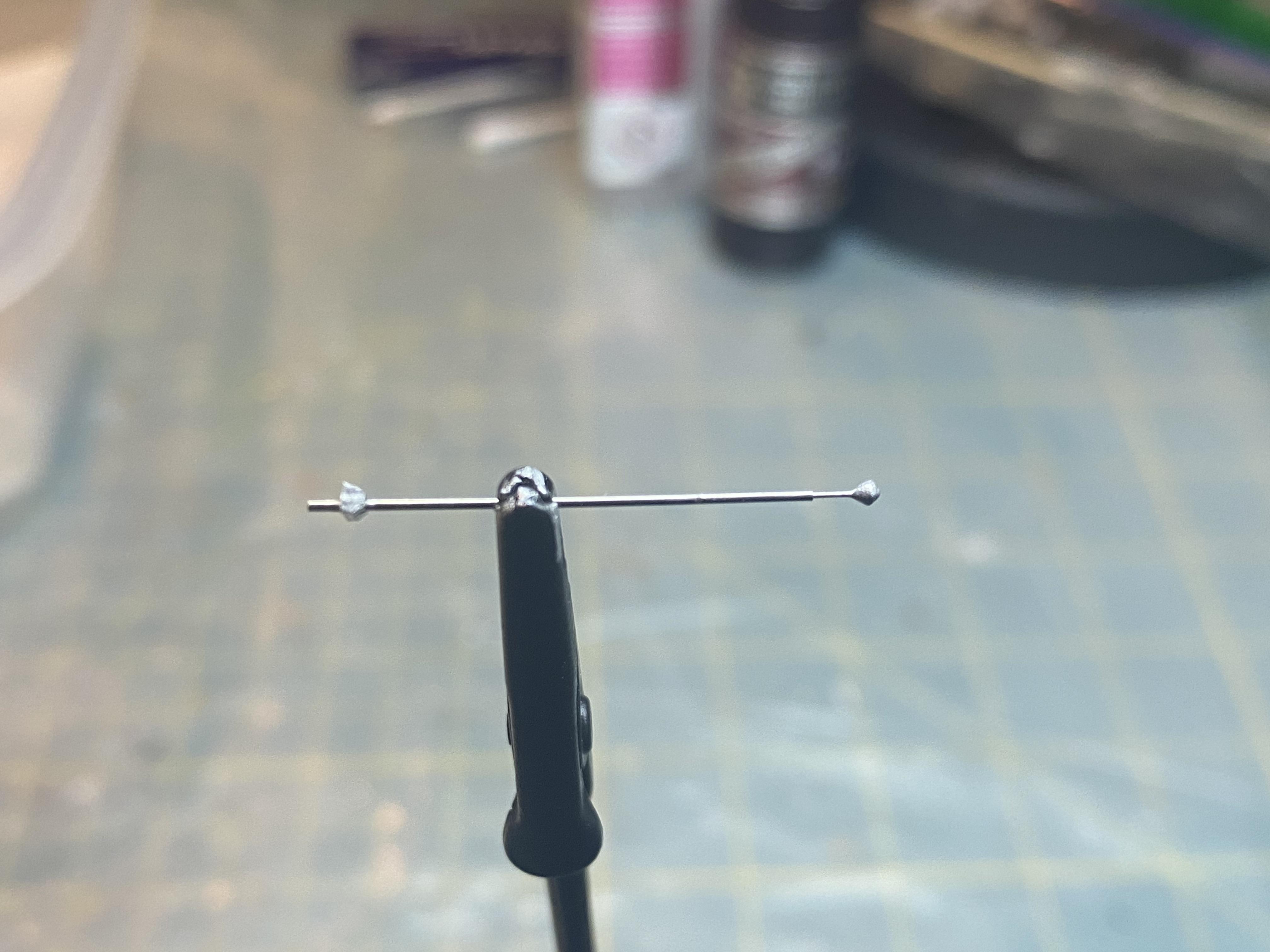

in case anyone is curious, I make my antennas from a bug pin and some catheter tubing, that way it can function up and down like the real ones.
still a little more to do, but Almost There!

Nice wrap-up on the engine bay Donald. The PE looks great too.
A cool idea for the antenna, where does one find such things? I know that medical supply vendors are often careful as to what they provide to whom. I may still be on the list with Southland Medical but I'm not sure if they carry the cath tubing. I know that Dodge doesn't.

Both the bug pins and catheter tubing I got on Amazon
Look for 0.5mm stainless steel capillary tube & insect pin #00

3 hours ago, David G. said:
Nice work on the hood pin details!
It's the little things that can make some of the biggest differences.
David G.
Thank you!
