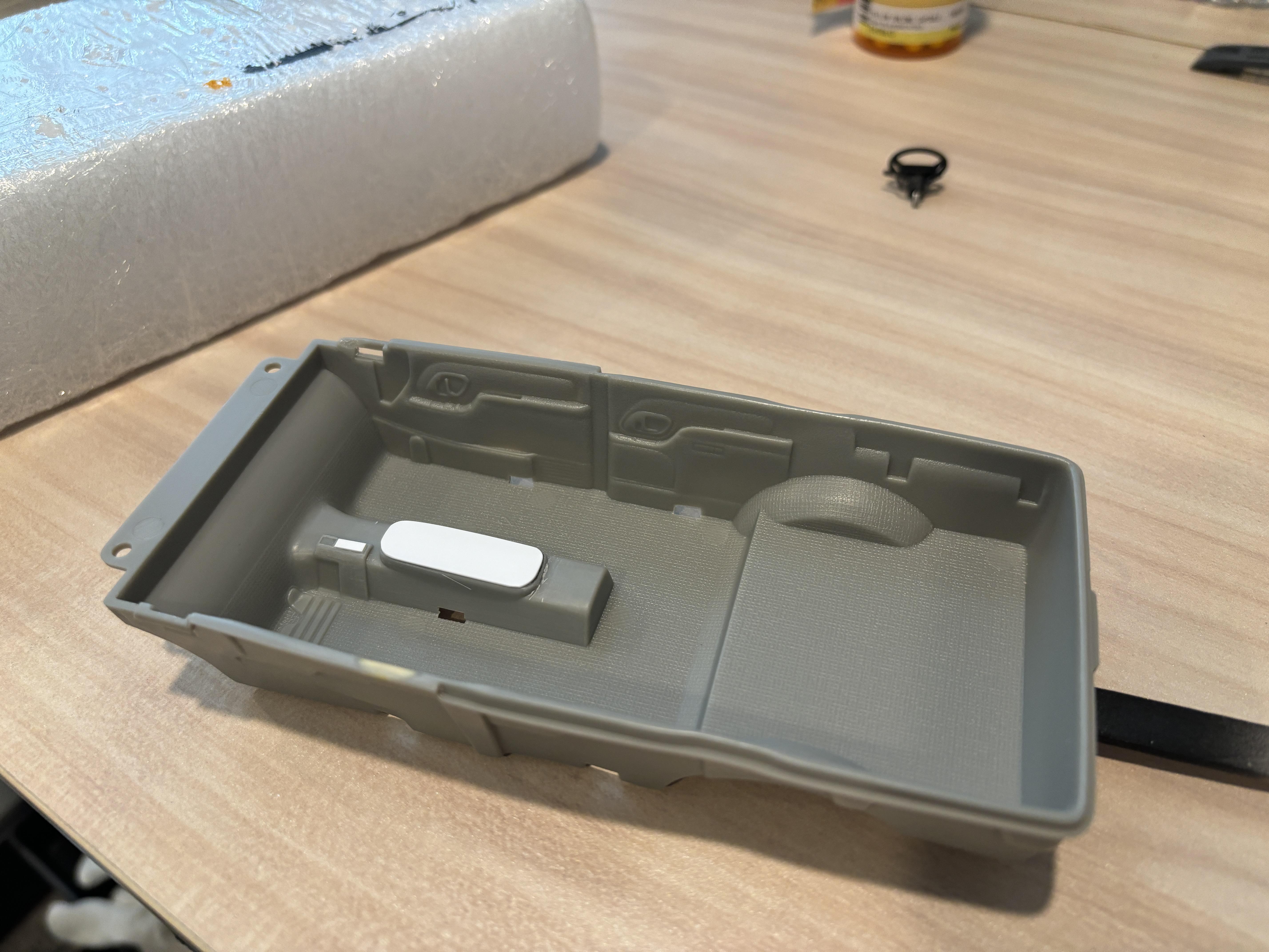

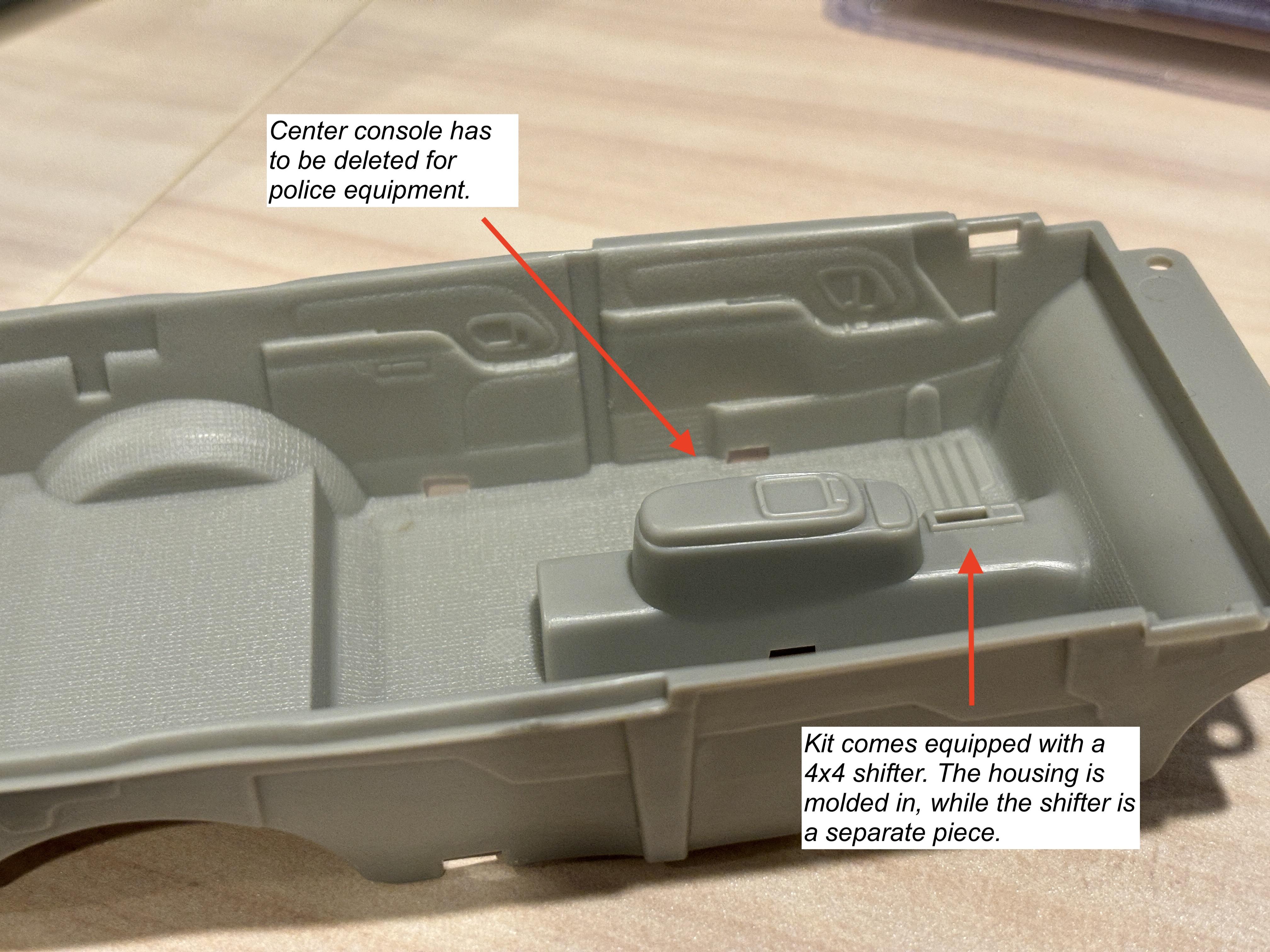

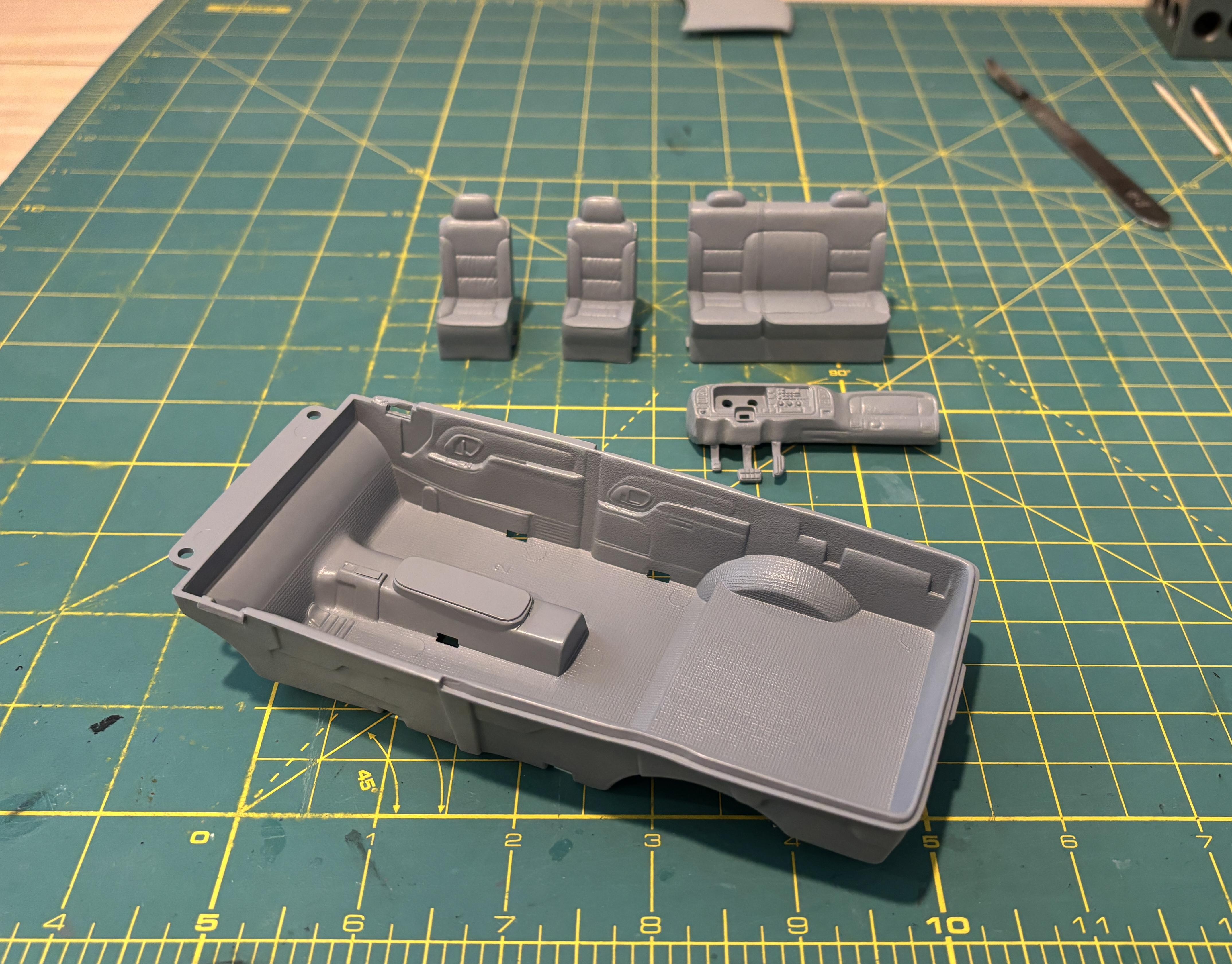

On my law enforcement builds, I always try to recreate the actual interior equipment used as best as possible. More so if I know what the interior layout was. I have some memories of how these Tahoes were equipped. But the molded in details of the interior tub, combined with my lack of accurate scale police equipment and patience to completely re-do the interior, means that I'm going to aim for an in-between solution. This is what the tub looks like:
I carefully cut out the majority of the center console, sanded the are down, and covered it with a piece of Evergreen styrene. I also placed a piece of styrene over the 4x4 shifter housing. Again, not the cleanest look, but it'll have tp do:

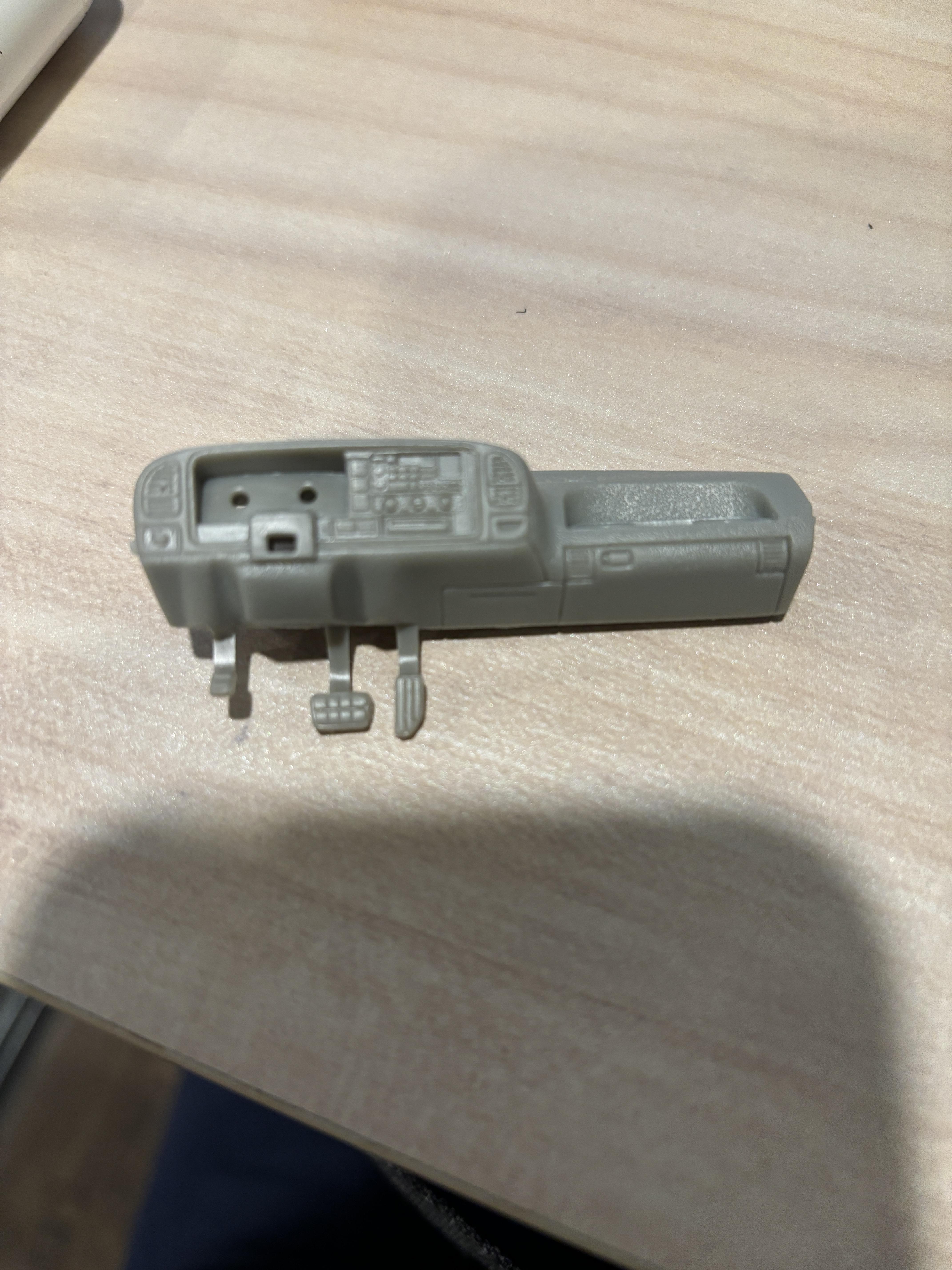

Since the Tahoe is a 1996, it comes with a dash that does not have a housing for a passenger-side airbag. For the 1997 model year, GM added passenger side airbags, necessitating a re-design of the dash. This coincided with the introduction of the Tahoe PPV. This is the Tahoe dash, sans passenger airbag:
I took a 1997 dash with the passenger side airbag housing from a promo 1997 C-3500 to use on this kit. Again, I want to emphasize that the Tahoe and C-3500 molds are not from the same family, so I had to cut/sand down the sides of the truck dash to fit in the Tahoe tub. I also cut the pedals from the original Tahoe dash and glued them onto the C-3500 dash. Here's the C-3500 dash after these modifications:

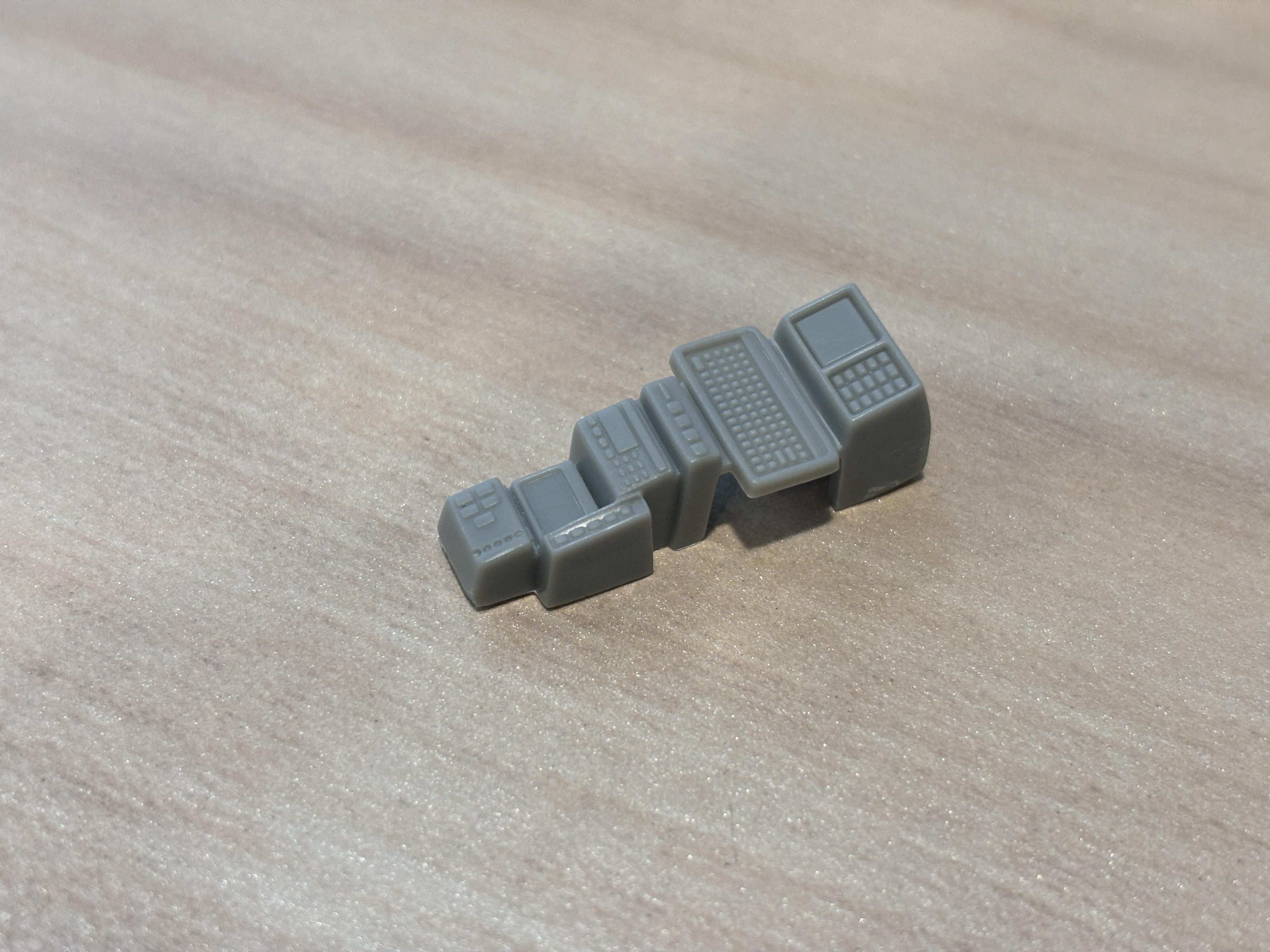

I'll be using the center console from the Lindberg Crown Victoria kit. It's not really accurate to what LASD had, but I chose it because it has an MDT (computer) fairly similar to what LASD ran at the time:

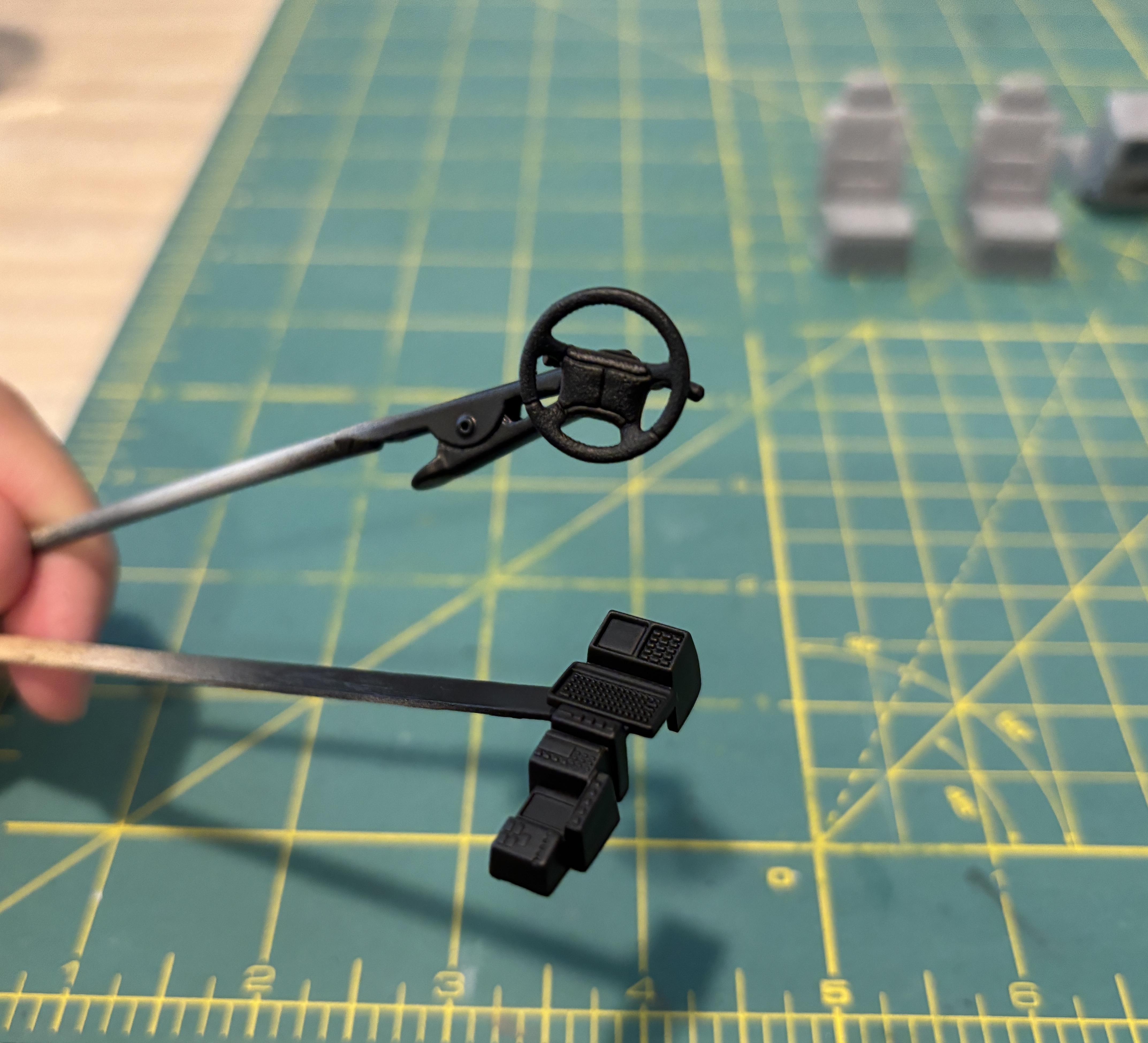

I used the steering wheel and column from the Tahoe and modified it to fit the C-3500 dash as it has much crisper detail than the C-3500 counterpart. Here it is after being painted alongside the police console:
