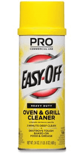

yh70 Posted October 6, 2024 Posted October 6, 2024 Like Mark said you'll have to sand/scrape it off, But as a re-builder of Big Rigs i picked up thru the years glues tougher with globs of Testors as i was removing the paint with Easy Off Oven Cleaner brand name i notice that all the parts were coming un-glued being a good thing. so the oven cleaner could help you soften the glue but you will still have to do some scraping. if you try this soak the parts 12 hr.
