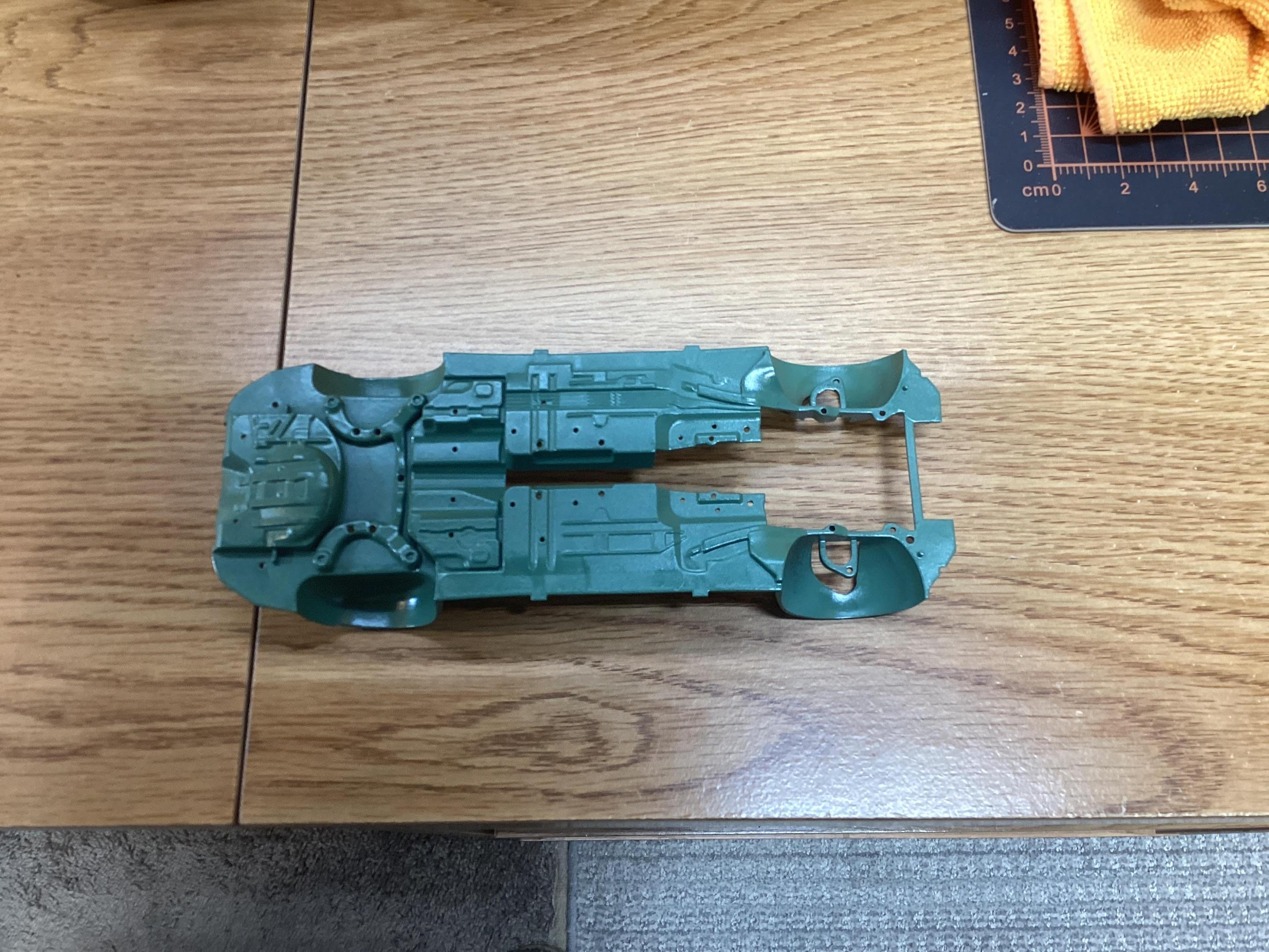

shoopdog Posted November 8, 2024 Posted November 8, 2024 I’m in the process of building the AMT 21 Charger RT kit and wondering about the actual chassis color. The directions call for an olive color. If anyone has any first hand experience please let me know before I settle for a black.

SSNJim Posted November 9, 2024 Posted November 9, 2024 (edited) On 11/8/2024 at 9:13 AM, shoopdog said: I just had a peek at Tamiya’s AS line, looks like AS29 Grey Green might be the closest with AS14 Olive Green a close second. I think you're right. I picked up a can of AS-29 today and it does look pretty close. I haven't sprayed it yet, though. Thanks! Edited November 9, 2024 by SSNJim
shoopdog Posted November 9, 2024 Author Posted November 9, 2024 Unfortunately I had to go with what I had on hand which is Rustoleum Moss Green which is pretty dark but I’m good with it. I won’t be displaying the Charger on its roof. I wish I could have gotten the AS29 but there are no close hobby shops and trying to use what is available 1

SSNJim Posted November 11, 2024 Posted November 11, 2024 I got my 2021 Charger chassis painted in Tamiya AS-29 Gray Green. It may not be a perfect match, but I think it's fairly close and looks right to me - at least for the rear part of the picture above. 1
