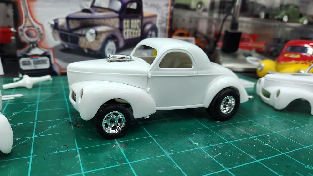

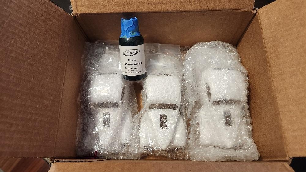

Zippi Posted December 9, 2024 Posted December 9, 2024 (edited) I was pulling one of my 41 Willy's Gasser's down off the shelf just to check something and yup....I dropped it. The display case shattered and the poor old Willy's ended up in a lot of pieces. I decided I was going to strip the paint and do a make-over but disaster struck. Long story short the body was no longer usable. I good friend of mine (Terry) said he had a spare body. When I opened the box I found that Terry had not only sent me one body but three and a bottle of Scale Finishes paint. What a surprise. So...I currently have a thread going on with the 41 Willy's Pickup and I'm going to go ahead and start the re-build of this '41 Gasser. Just love this body style. Edited December 9, 2024 by Zippi 5

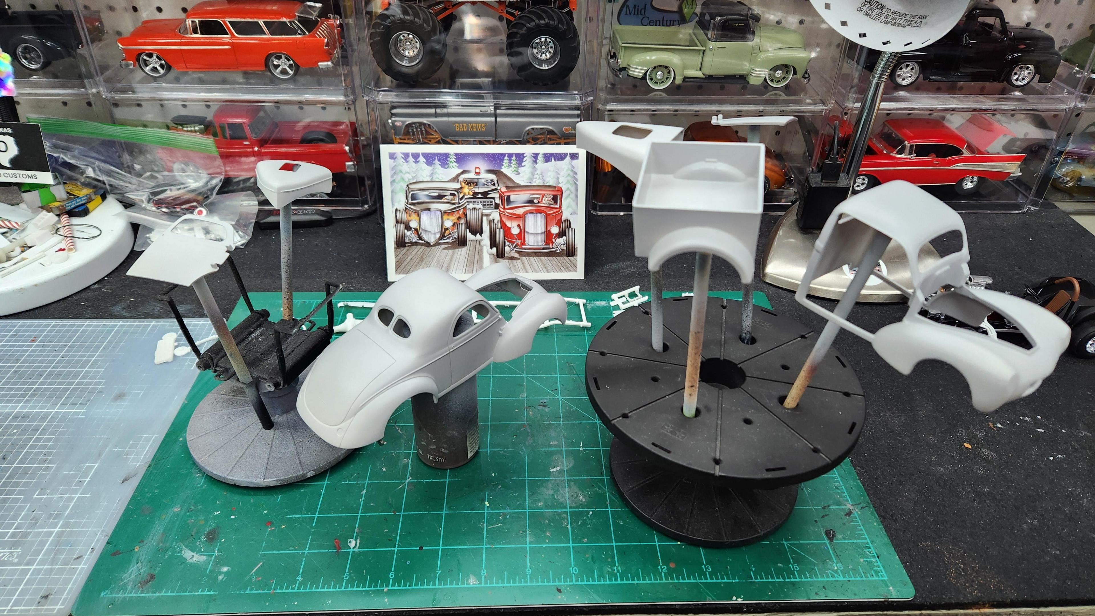

Zippi Posted December 10, 2024 Author Posted December 10, 2024 The weather in the garage was right this morning so I got some primer on a couple 41 Willy's bodies. 2

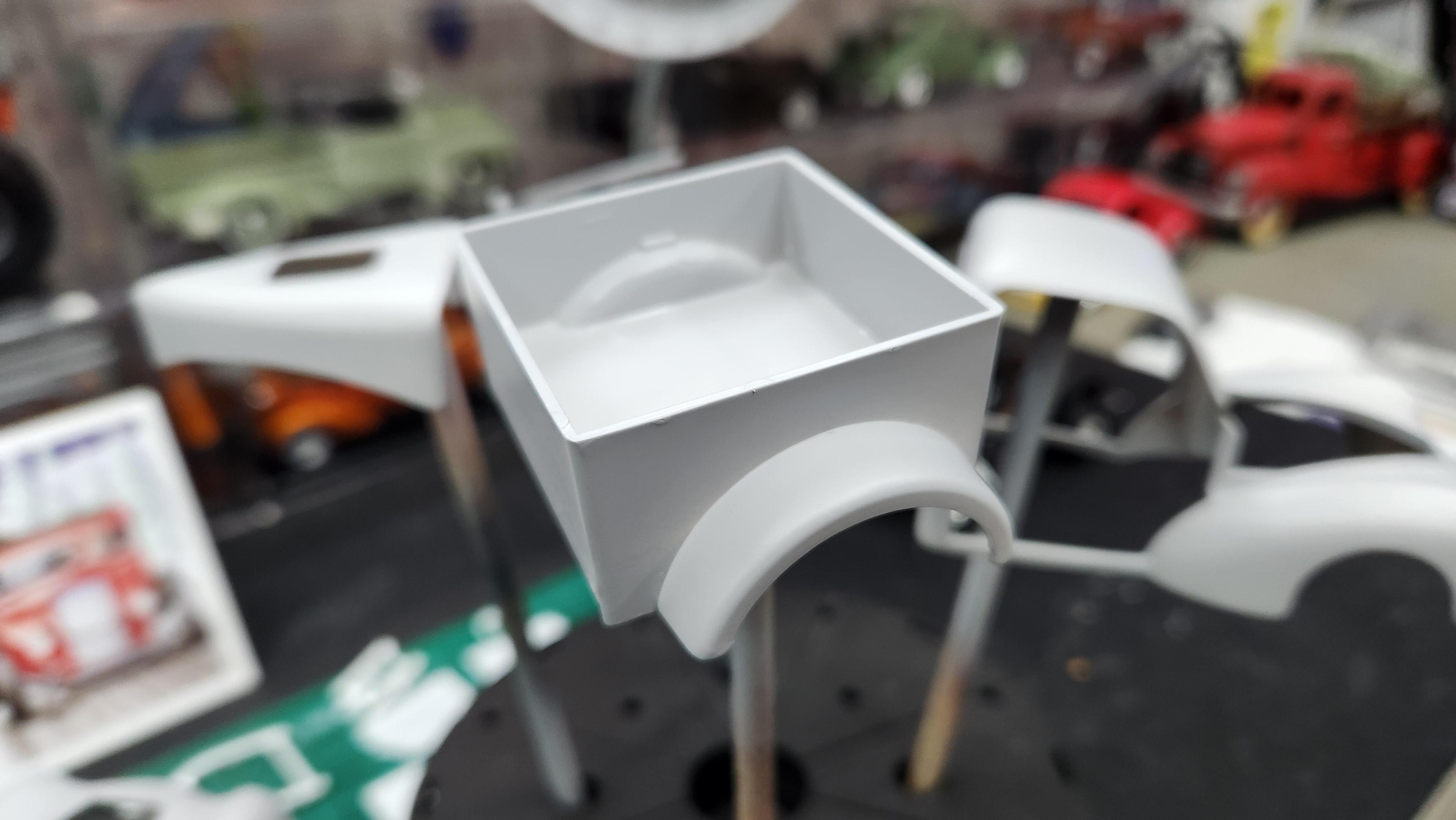

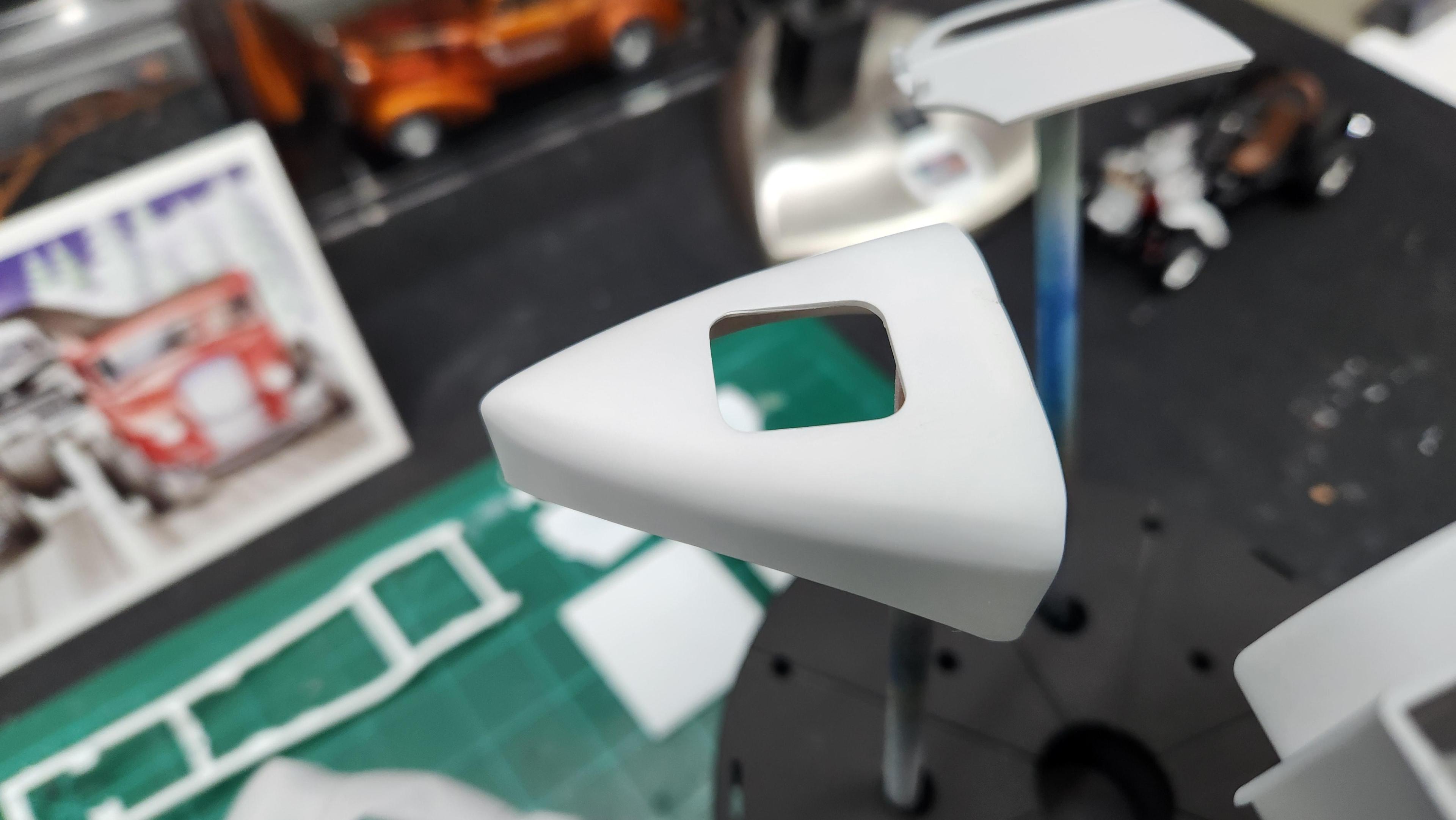

Zippi Posted December 12, 2024 Author Posted December 12, 2024 (edited) Opps...posted the wrong 41 Willy's pics. Correct ones coming shortly. Update: Ok fellows, here are the pic I was supposed to post. That's the problem I have when I'm working on to many builds at one time. Once this cures out for about 3+ days I'll hit it with the 2K clear. Edited December 12, 2024 by Zippi 2 1

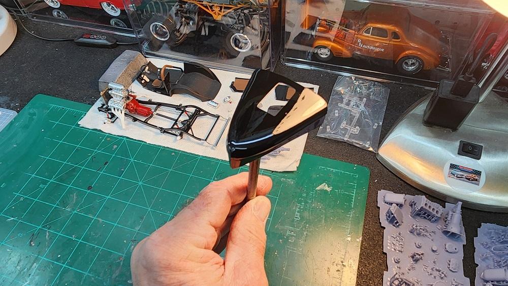

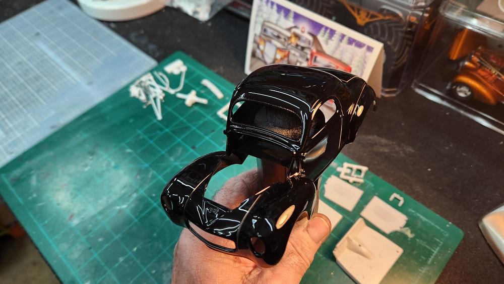

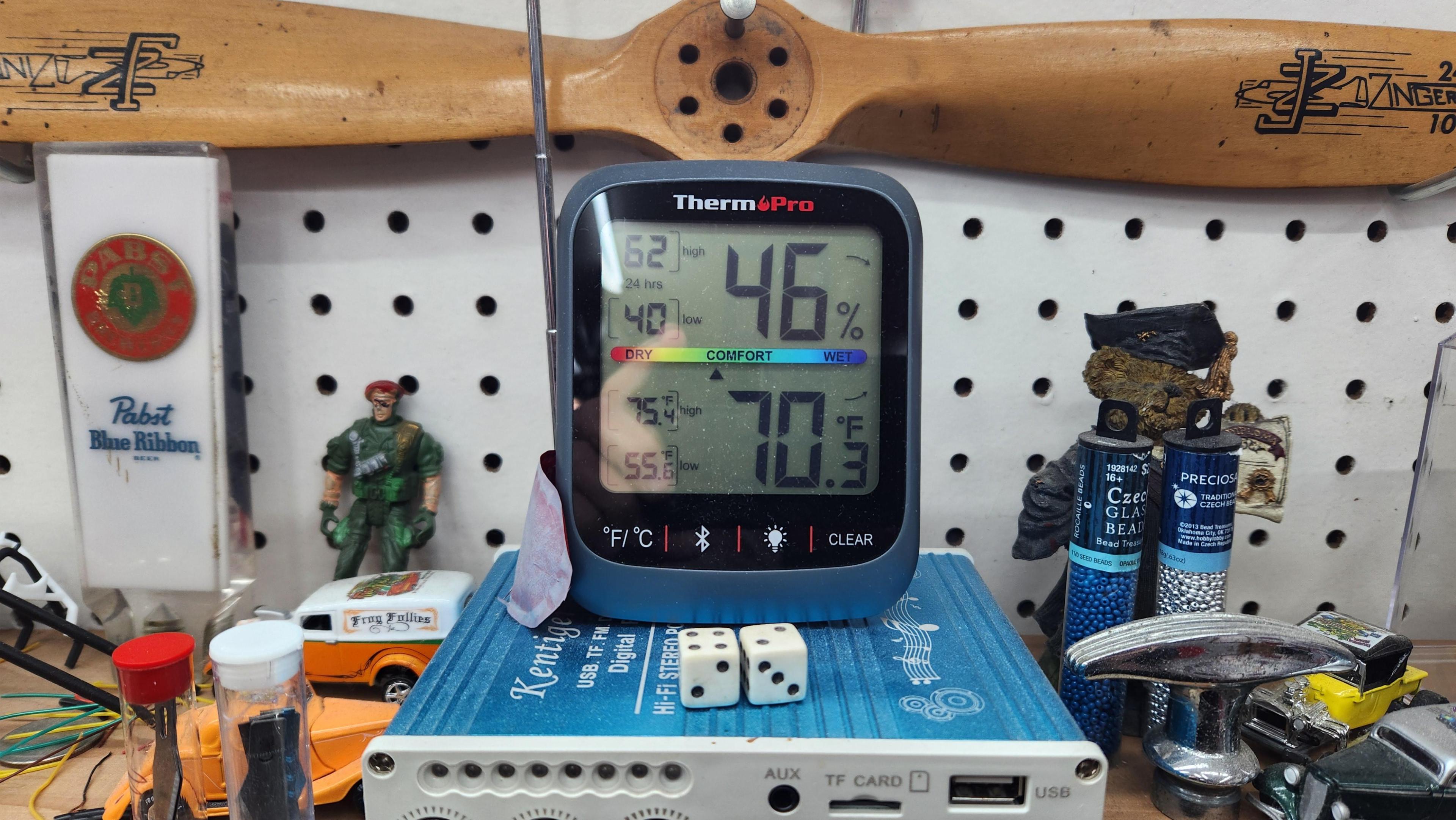

Zippi Posted January 12 Author Posted January 12 Man, it has been a while but I finally got a fairly decent day to get out in the garage and throw some 2K Clear on the 41 Willy's. The garage was up to 58° with 42% humidity so not to bad but I'm not pleased with how the Clear laid down. I'm going to let it cure out as it should get better as it cures. 2
Zippi Posted January 12 Author Posted January 12 5 hours ago, dragcarz said: That looks gorgeous! Silk and shiny, don’t drop it 😂 Haha...thanks Roger.

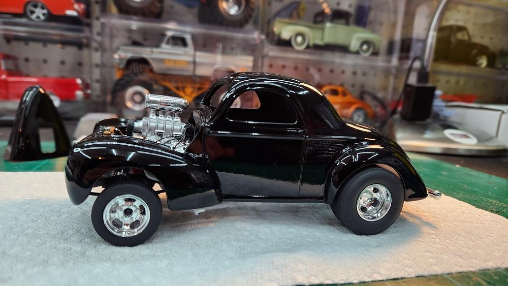

Zippi Posted January 13 Author Posted January 13 The 2K Clear is dry enough today to lightly handle so I did a little mock-up to make sure Everything still fits. Here are the decals that will be going on. 2

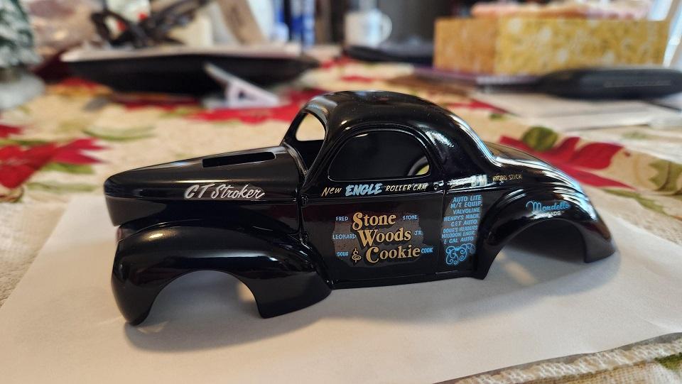

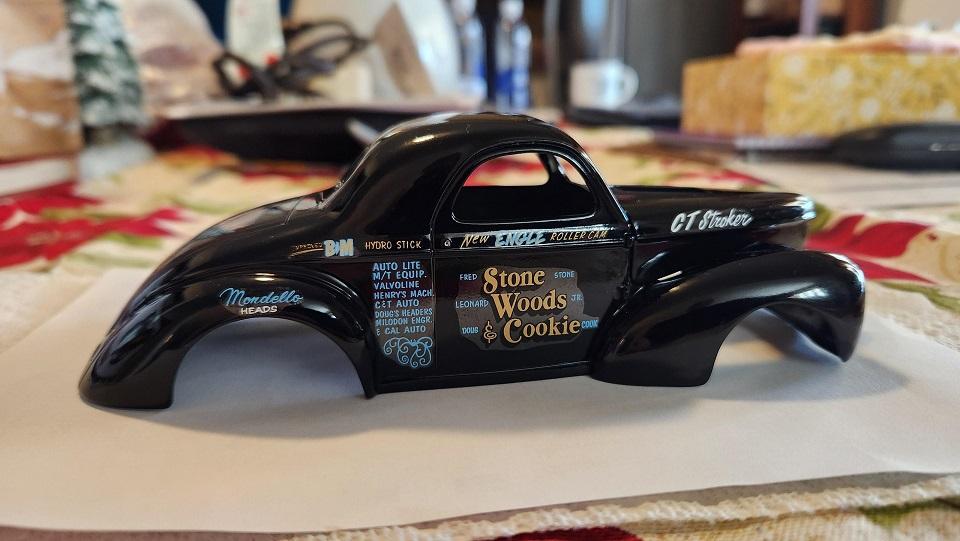

Zippi Posted January 20 Author Posted January 20 (edited) Got the decals on. I could not get the Swindler A decals that went on the rear fenders to lay down without a wrinkle due to the radius of the fender in two directions so I went with something else. I'd rather it look good vs it looking right. I'm not looking to memic the the original, just looking for something kewl looking Edited January 21 by Zippi 5
Zippi Posted January 21 Author Posted January 21 (edited) 16 hours ago, TransAmMike said: And yep, it is cool looking👍 Thanks Mike. Taking another look at the pics I'm not liking how I can see the clear area around the decals. I'm going to pick up some of the Tamiya decal set and see if it will help. Edited January 21 by Zippi

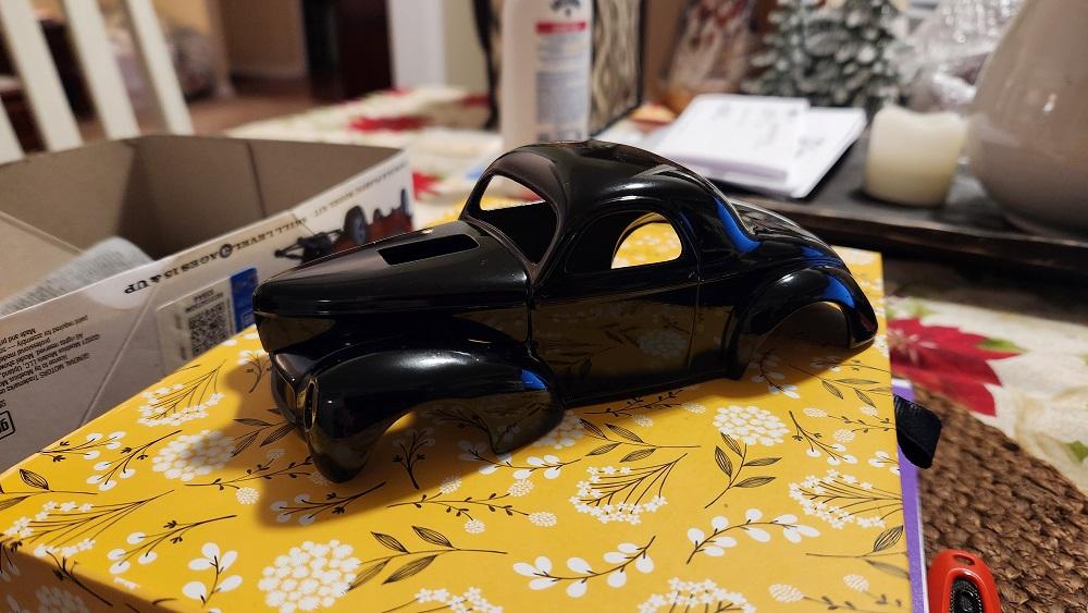

Zippi Posted January 22 Author Posted January 22 Problem has been solved. I was setting here in front of my computer this morning looking at the body and just didn't like what I saw so I pulled out a toothpick and picked off the decals. Not sure what I have to replace them so we'll see.
BK9300 Posted January 22 Posted January 22 Do you think a coat of clear over your decals might have made the decal background be less visible or disappear? Have any decals left over you could experiment with on a spare piece of painted plastic?
James2 Posted January 22 Posted January 22 (edited) It’s odd that the decals silvered like that on gloss paint. Usually that happens with flat or matte finish. Clear coat under decals helps, but over won’t. IMHO Were the decals after market? Edited January 22 by James2
Zippi Posted January 22 Author Posted January 22 3 hours ago, BK9300 said: Do you think a coat of clear over your decals might have made the decal background be less visible or disappear? Have any decals left over you could experiment with on a spare piece of painted plastic? I don't think if I shot a coat of 2K clear over the decals it would have helped. I think the issue was on the under side. Once the weather warms up I'm going to be doing some testing with 2K clear over decals which I've never done.
Zippi Posted January 22 Author Posted January 22 2 hours ago, James2 said: It’s odd that the decals silvered like that on gloss paint. Usually that happens with flat or matte finish. Clear coat under decals helps, but over won’t. IMHO Were the decals after market? I hear ya James. The were Slixx decals.
