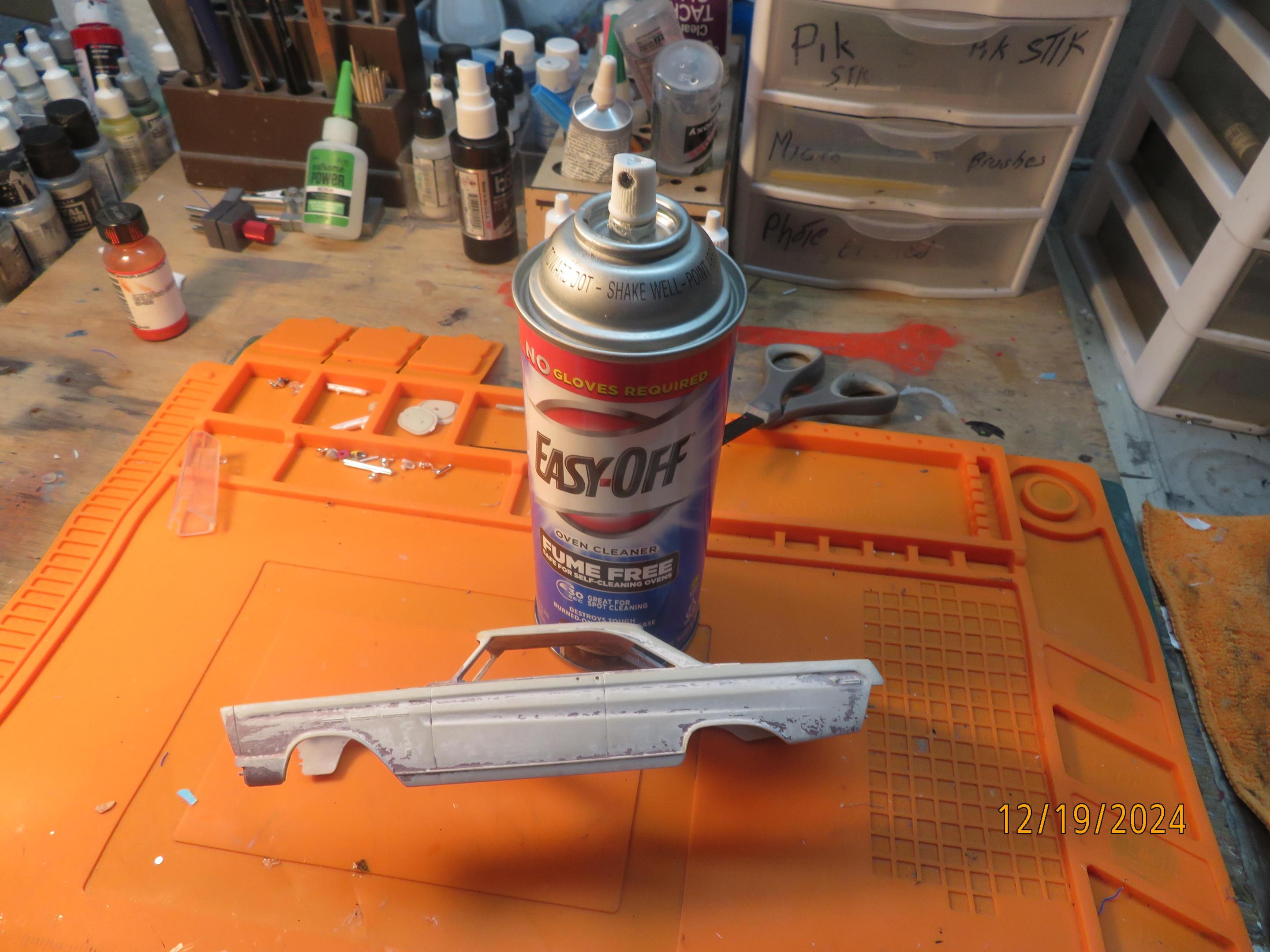

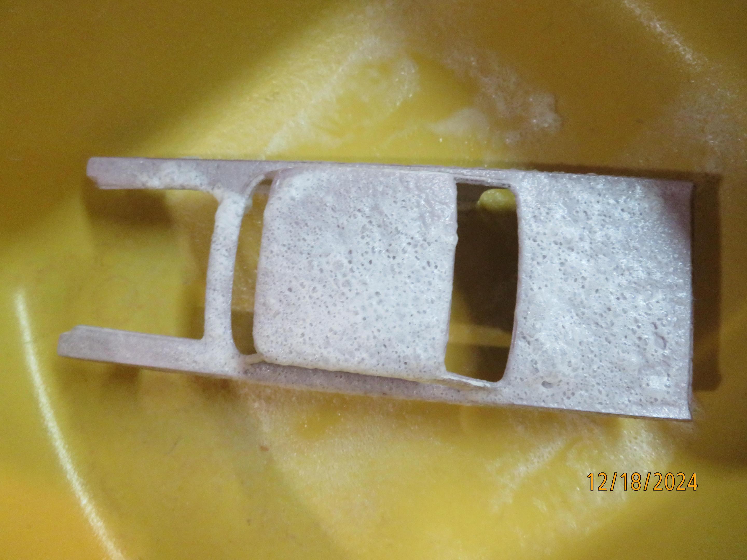

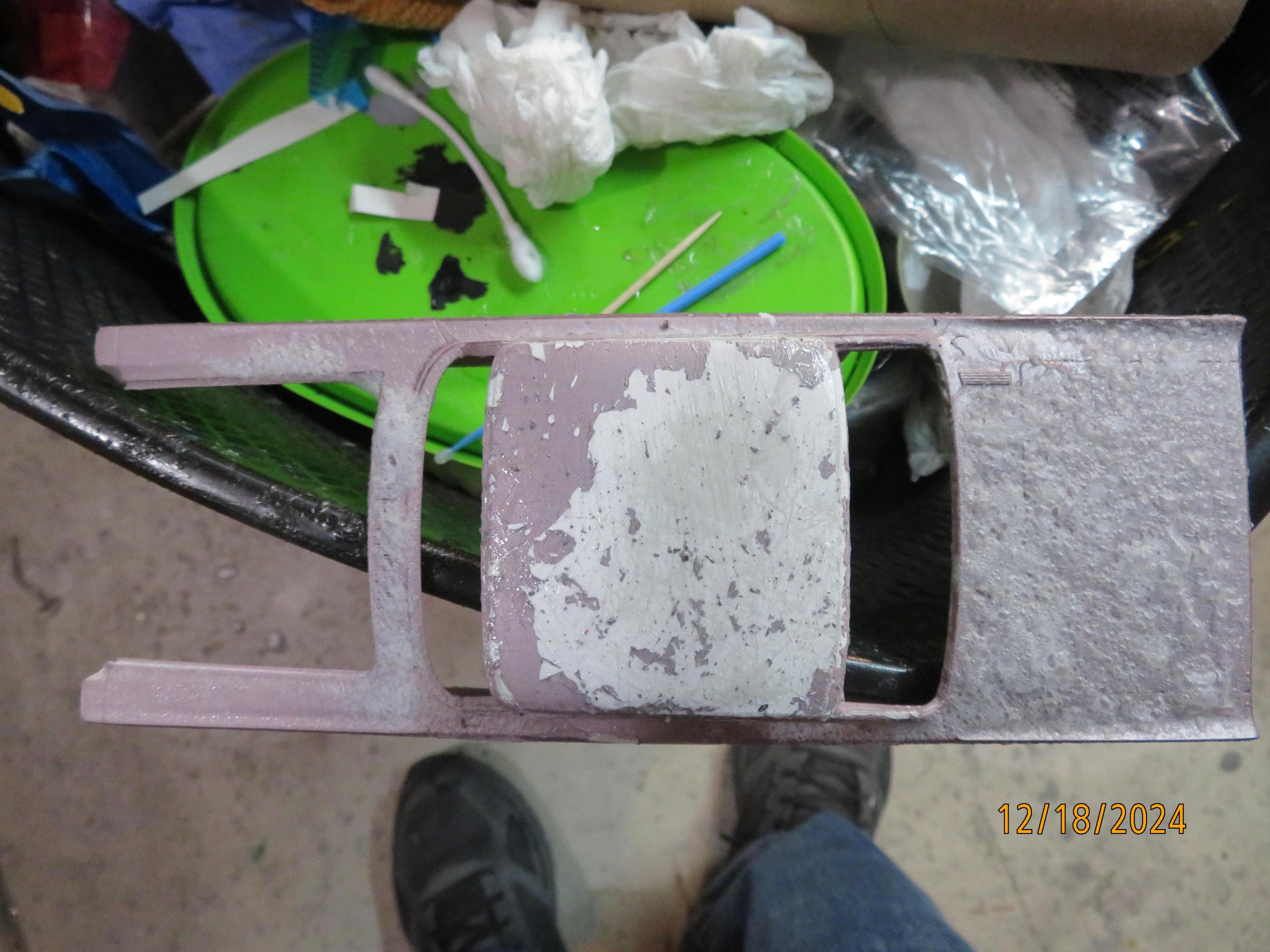

Of course, I read it you are right No LYE I stripped this one in about 2 hours yesterday. Testors Supreme Clear Laquar over Splash Paint. scratched the body trying to BMF the car. Another Easy Off bath today and some light sanding it will be as good as new.
