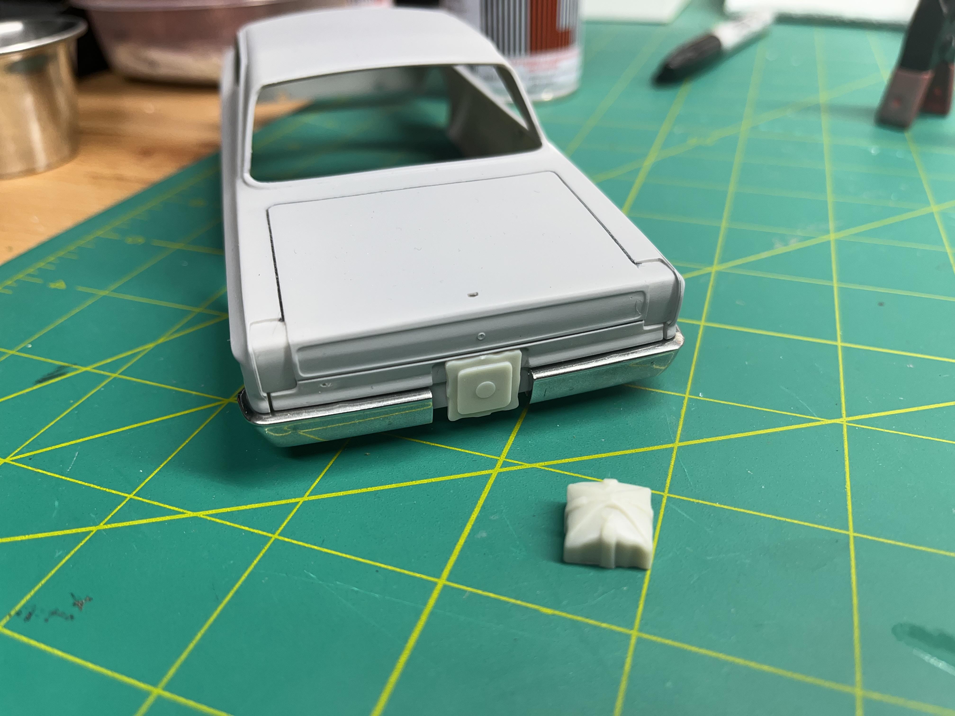

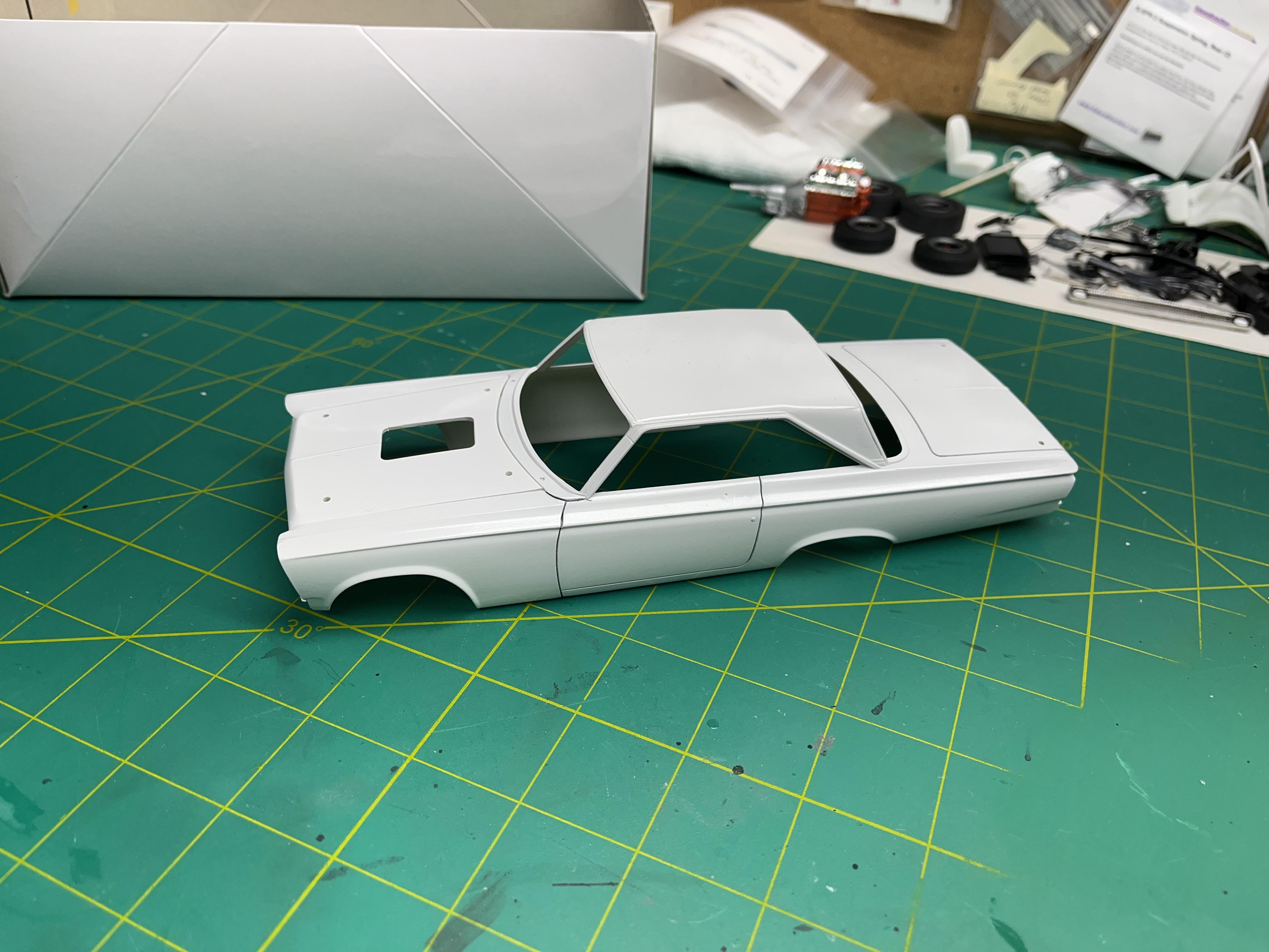

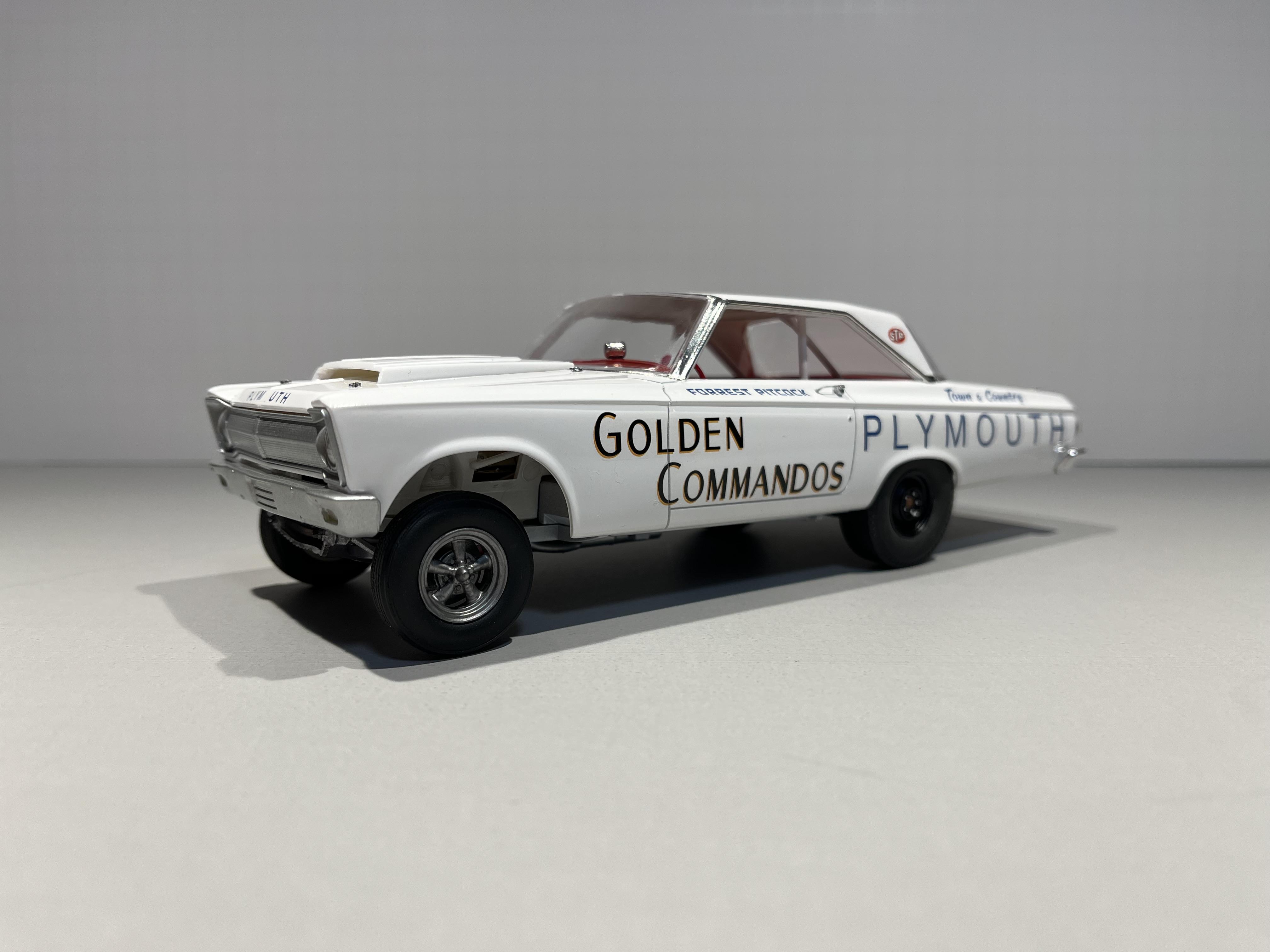

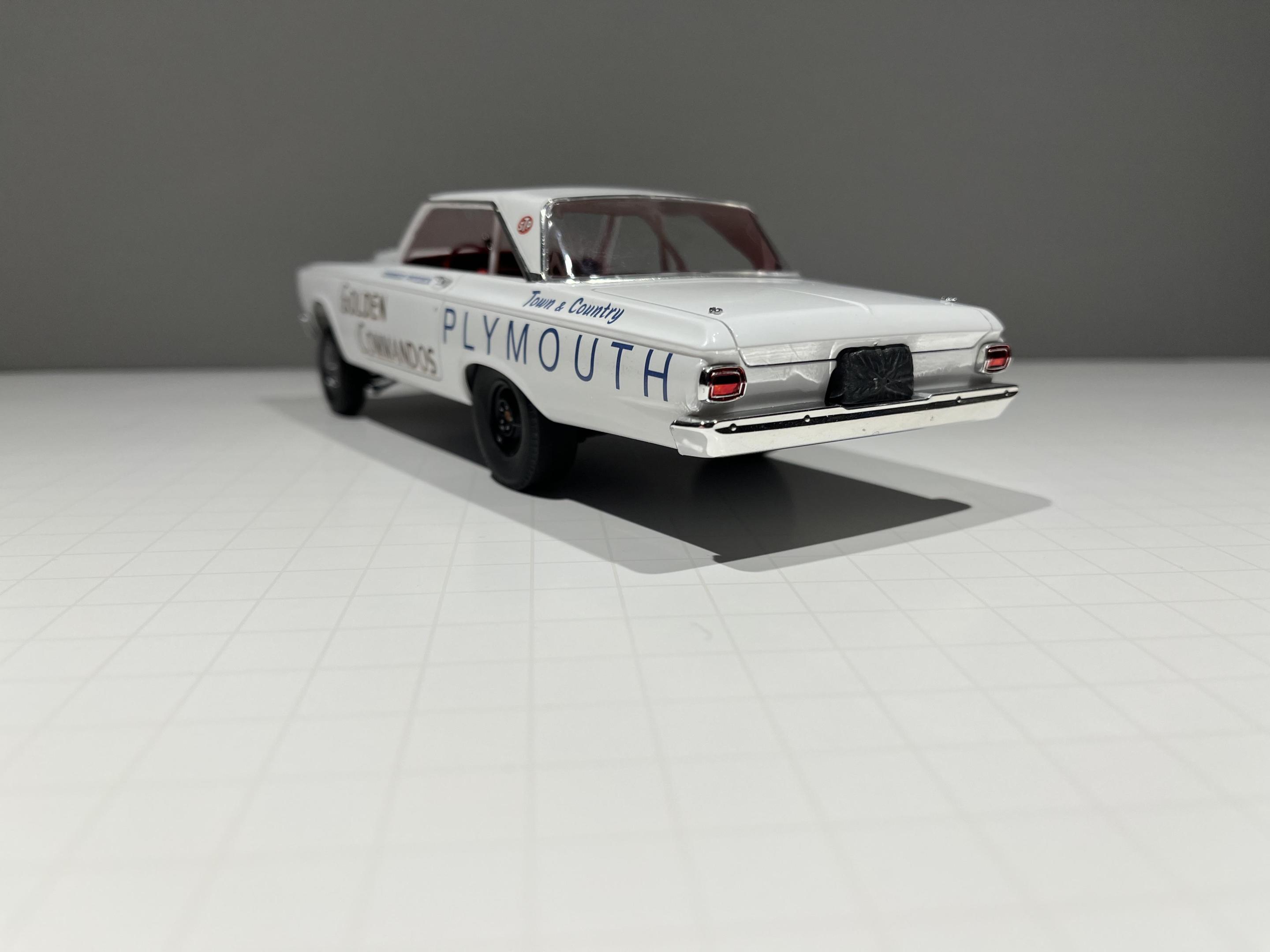

I finished up the 65 Plymouth white car, and the only thing I screwed up on, was forgetting to install the side windows. At least you can see the interior better, so no big deal. Moving on to the Landy Dodge now. One problem I encountered while mocking things up, was the parachute does not fit right on the Dodge as it does on the Plymouth. Since Landys Dodge has a split bumper and a different chute altogether, no big deal here. A couple pics of the Plymouth.

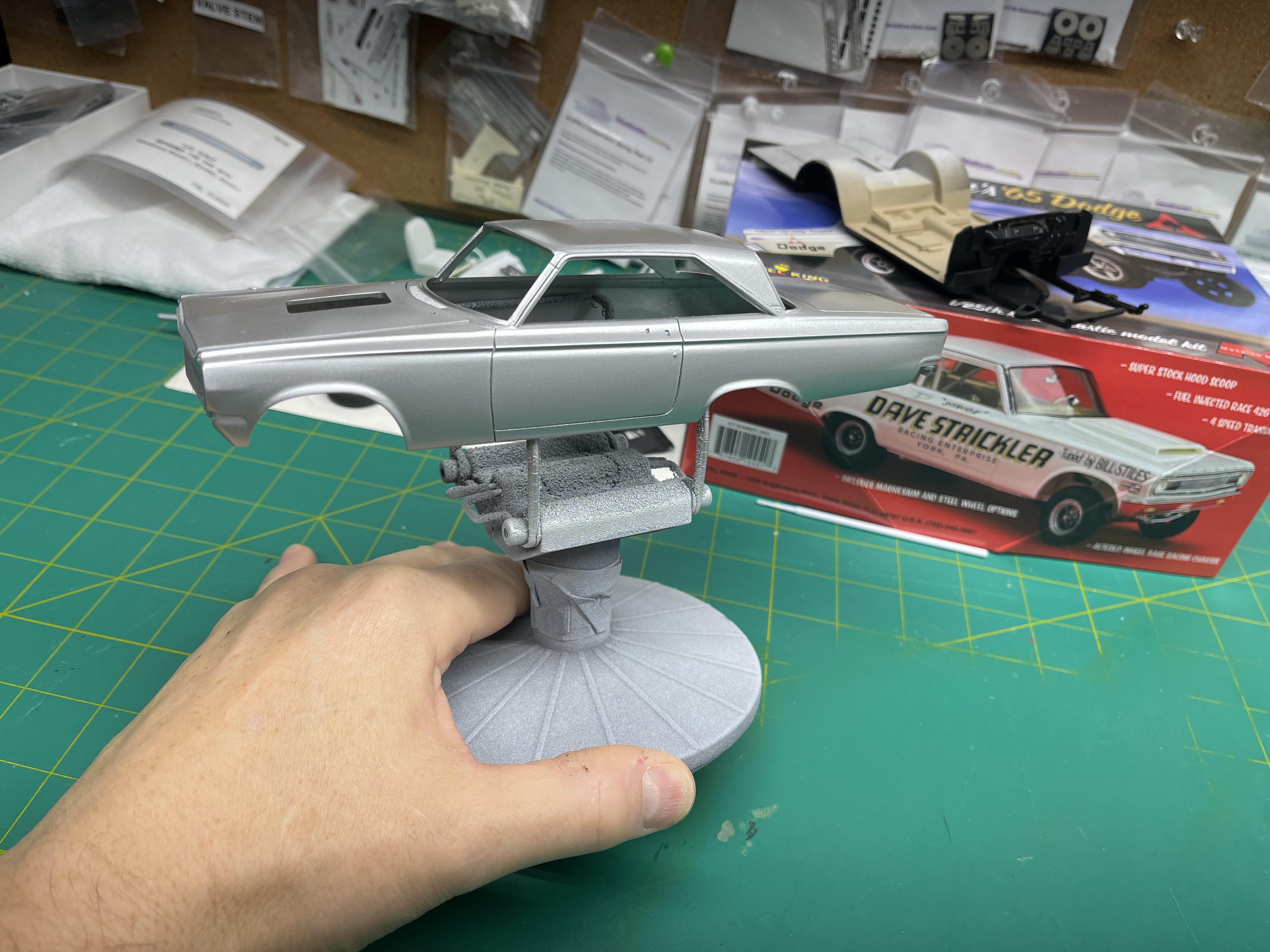

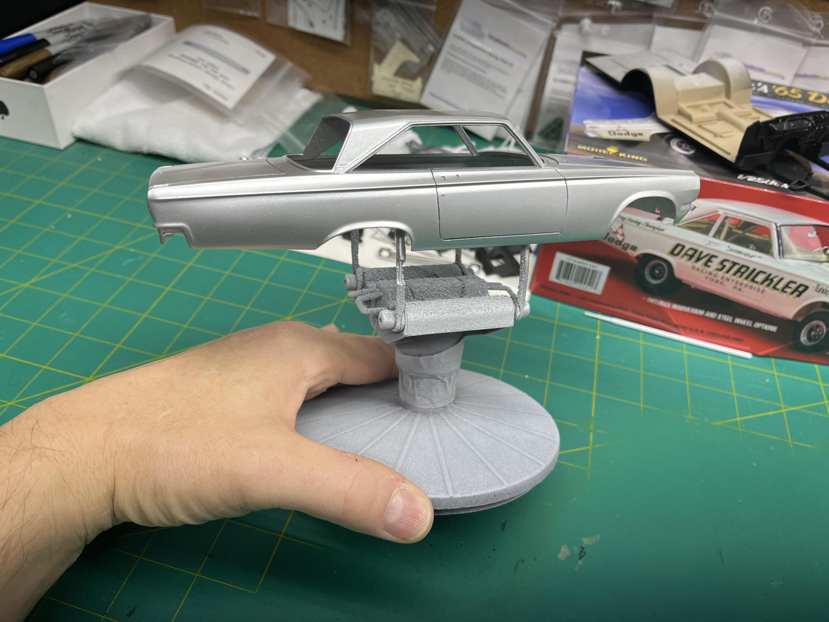

I’m really looking forward to building the Landy Dodge. I got a good jump on it now, and plan on painting it Tamiya Gloss Aluminum as it looks pretty good to my eye over gray primer.

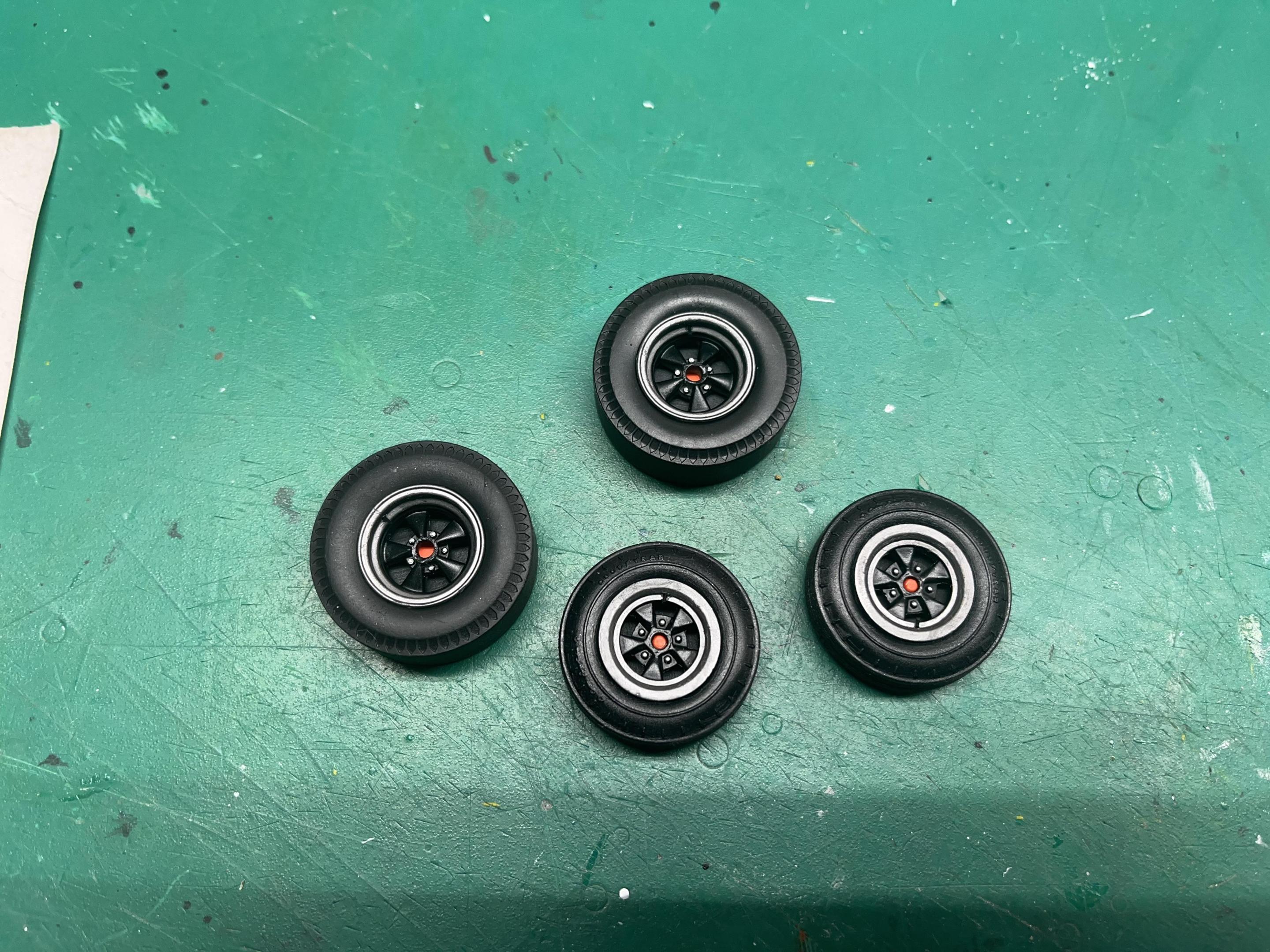

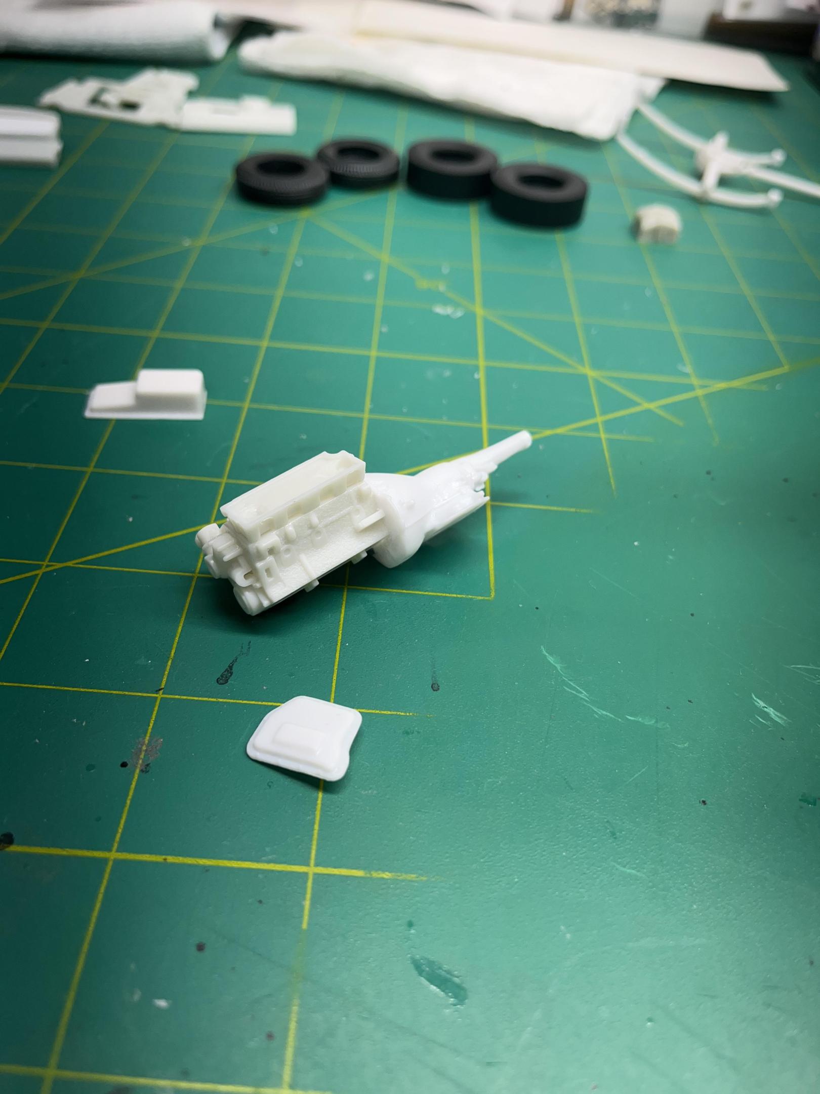

I have the body in primer now, with the panel lines deepened. And a few other things completed. The engine had the manual trans removed, and an automatic from the 68 Hemi Dart added. Also got a set of resin rims as close as I could find that look like the real rims.
Edited by Brutalform
  • Like 5

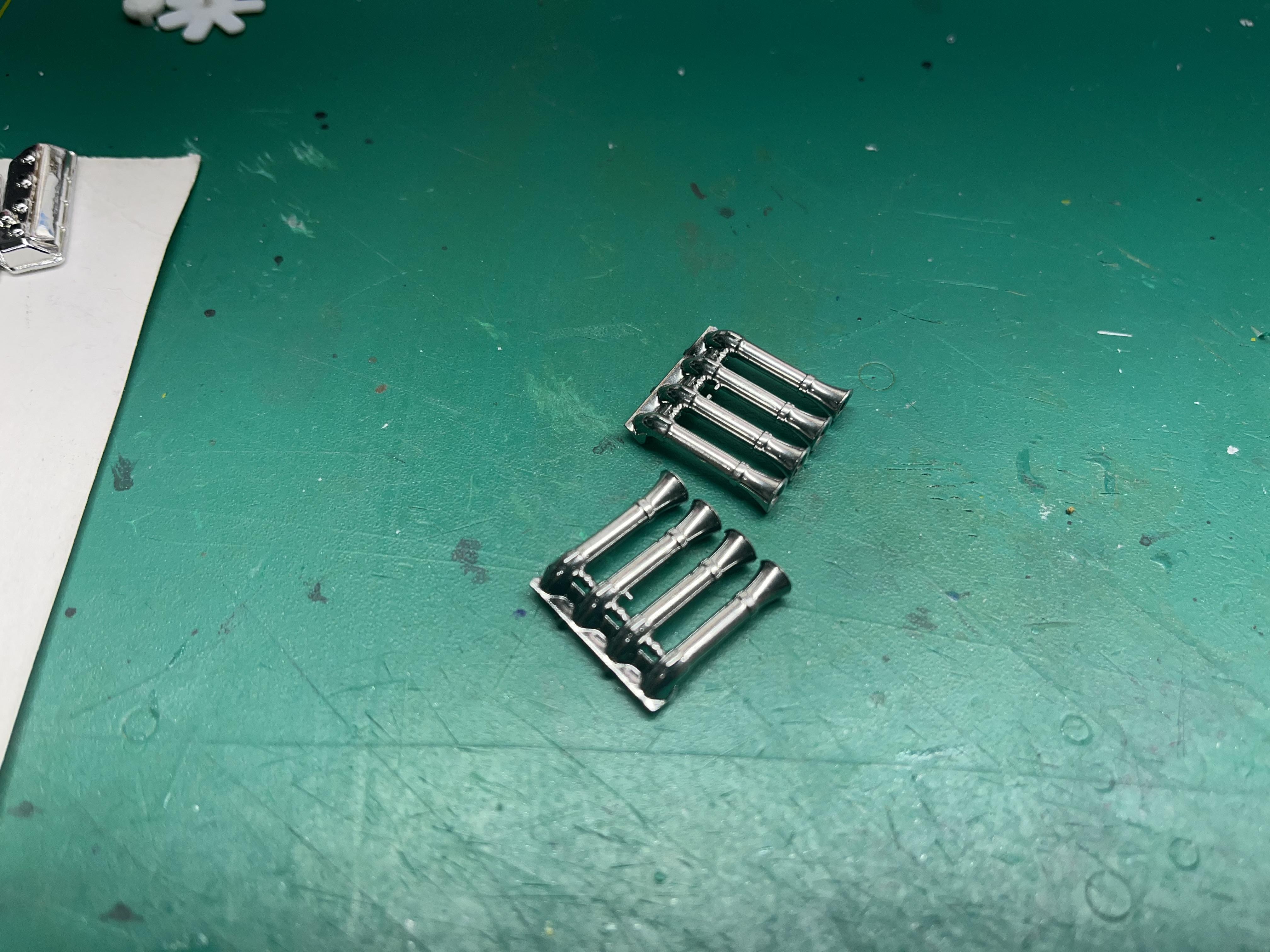

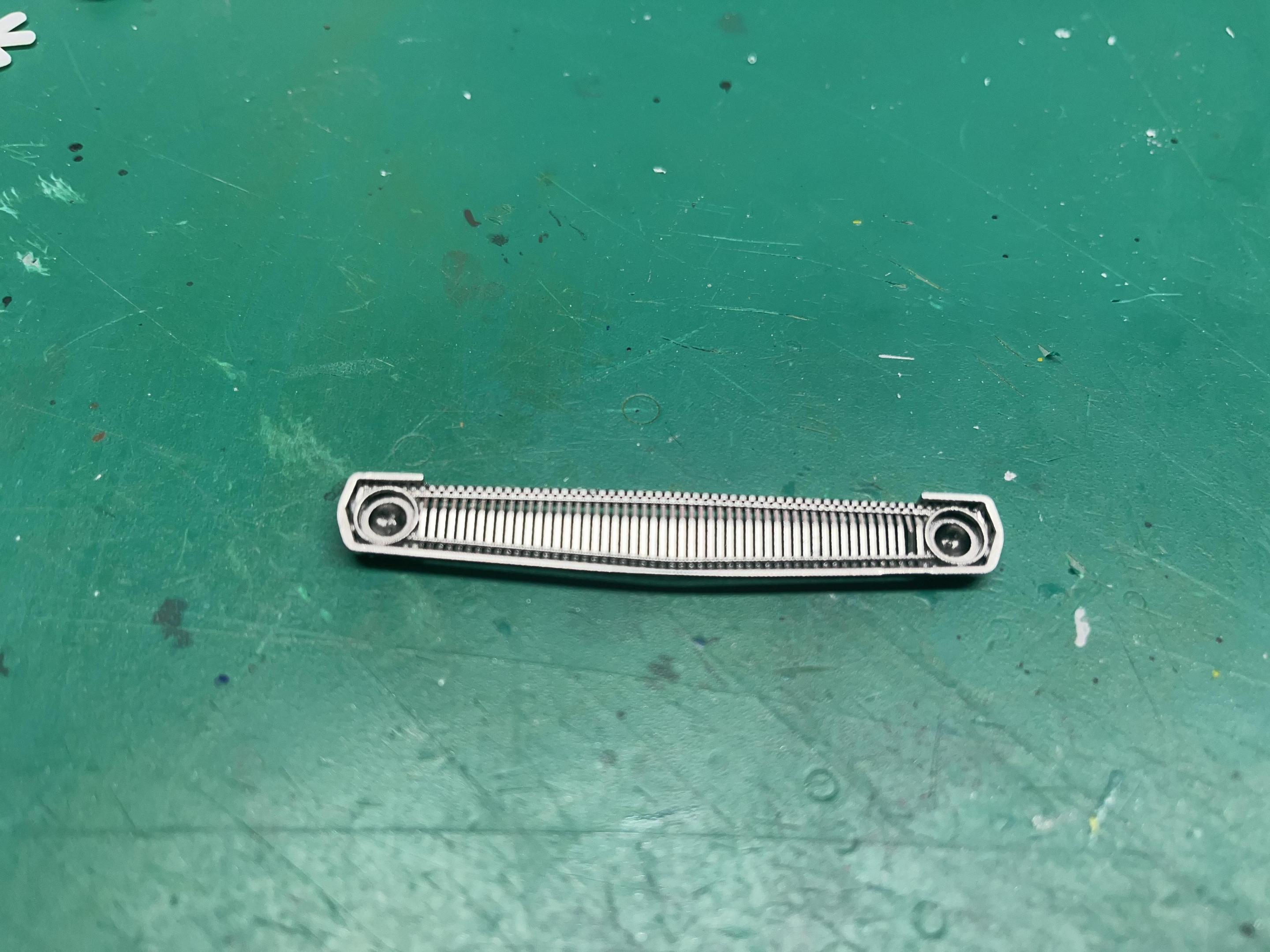

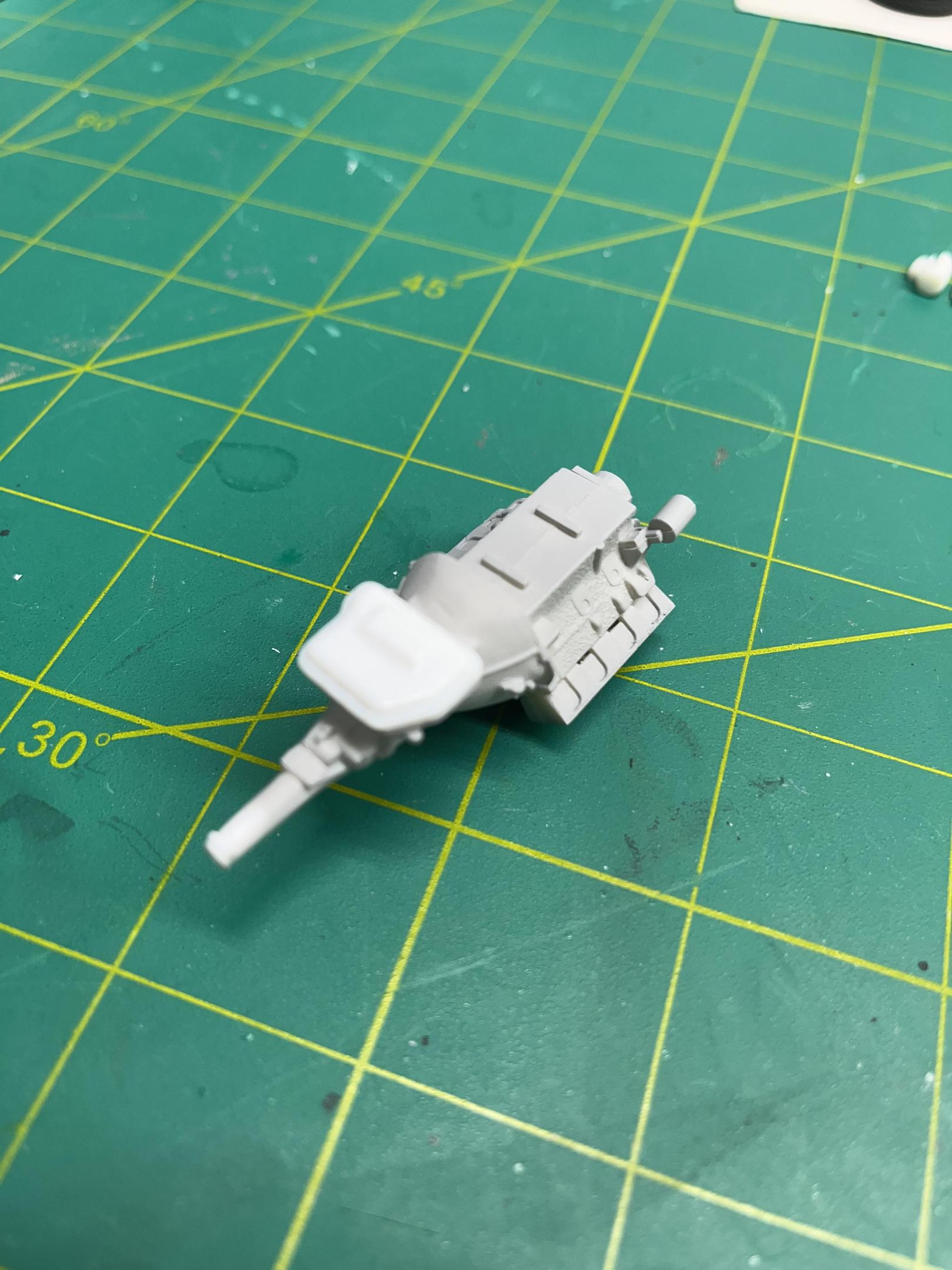

Removed the chrome from the rear bumpers, and injection stacks, and sprayed them with Alclad chrome. Also plan on adding a more realistic grill.
  • Like 5
Yea, I tested it on some old styrene, with the gray Tamiya primer under it, and it looks pretty close to the real cars color. It’s the only silver I tried.

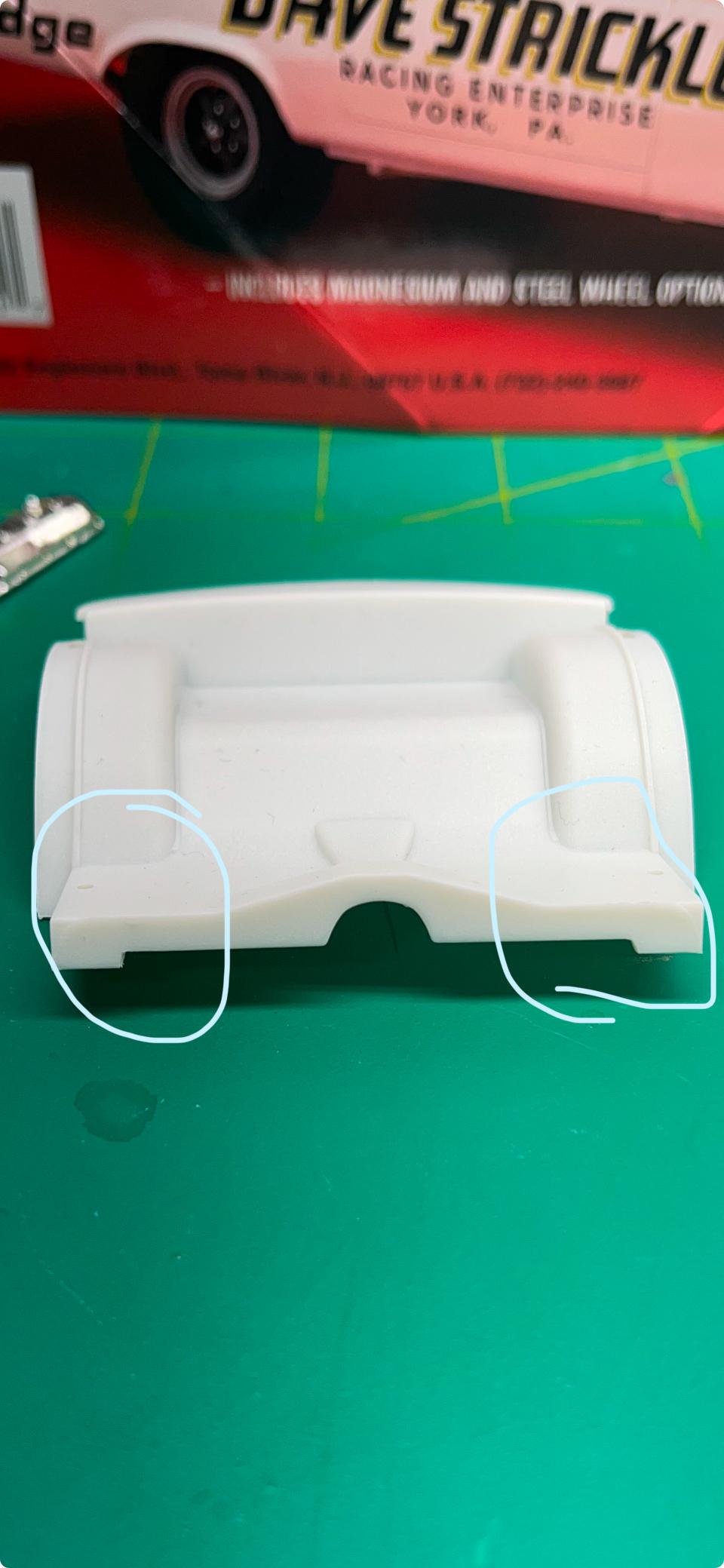

I only built the white car so far, and I have the Melrose Missile all finished except for the blue color on the body and foil, and decals. The only thing I can say is, check the glass, as it goes in from the outside. I encountered a bit of a problem with the foil on the rear window, as I was slipping the completed chassis into the body. Just a quick touch up fixed it. The model will fit into the body pretty tight, so make sure the rear bumper is installed prior to slipping it in. The rear bumper helps support the rear tail light section. I did this without the rear bumper in place, and had to re glue the edges as it tried to come apart.  Hope this helps Bill.
Also, enlarge these areas circled a little with a sanding stick, or it will not fit flush with the floor. And that will throw the door panels off. Other than that it’s straight forward.

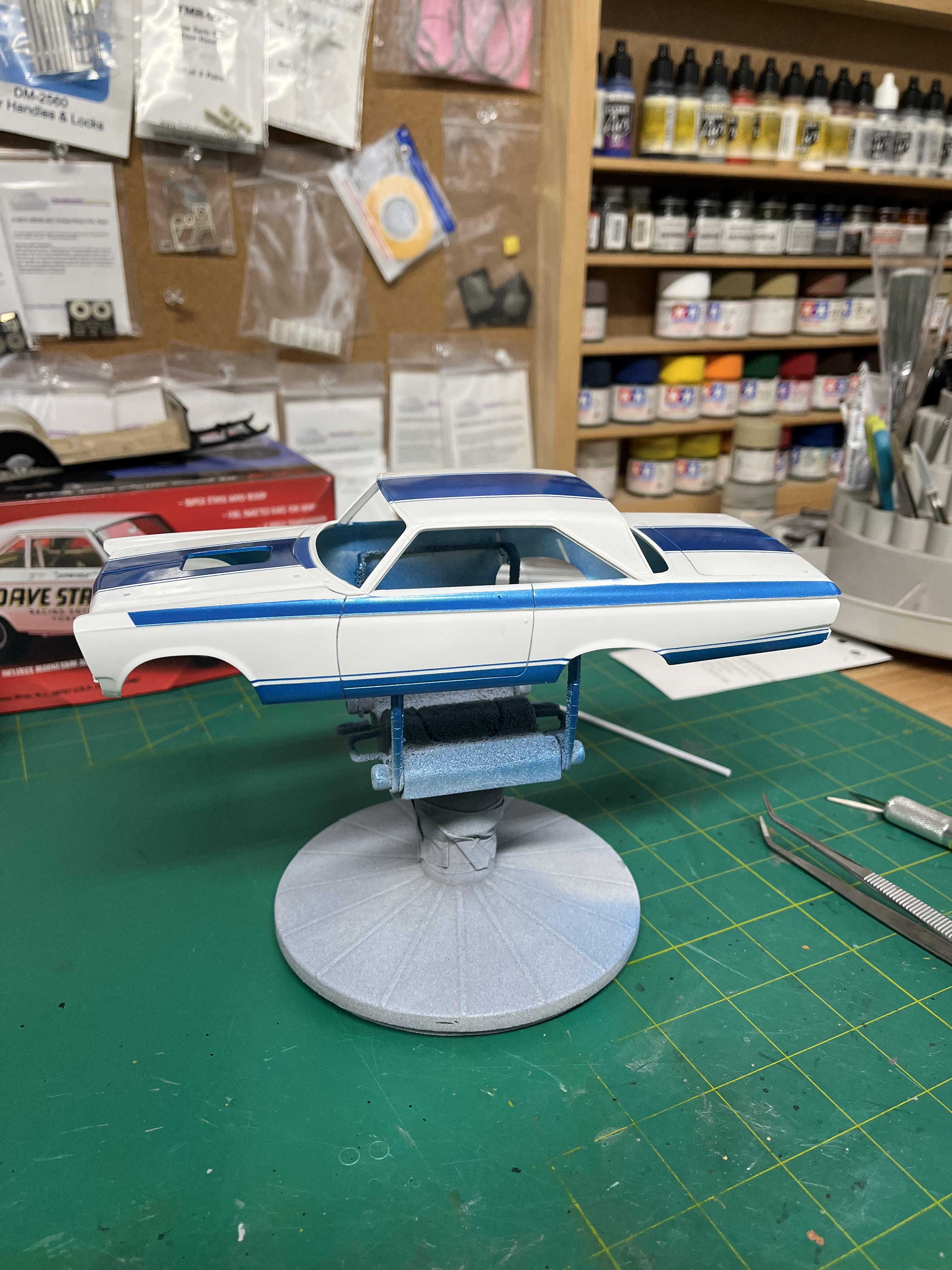

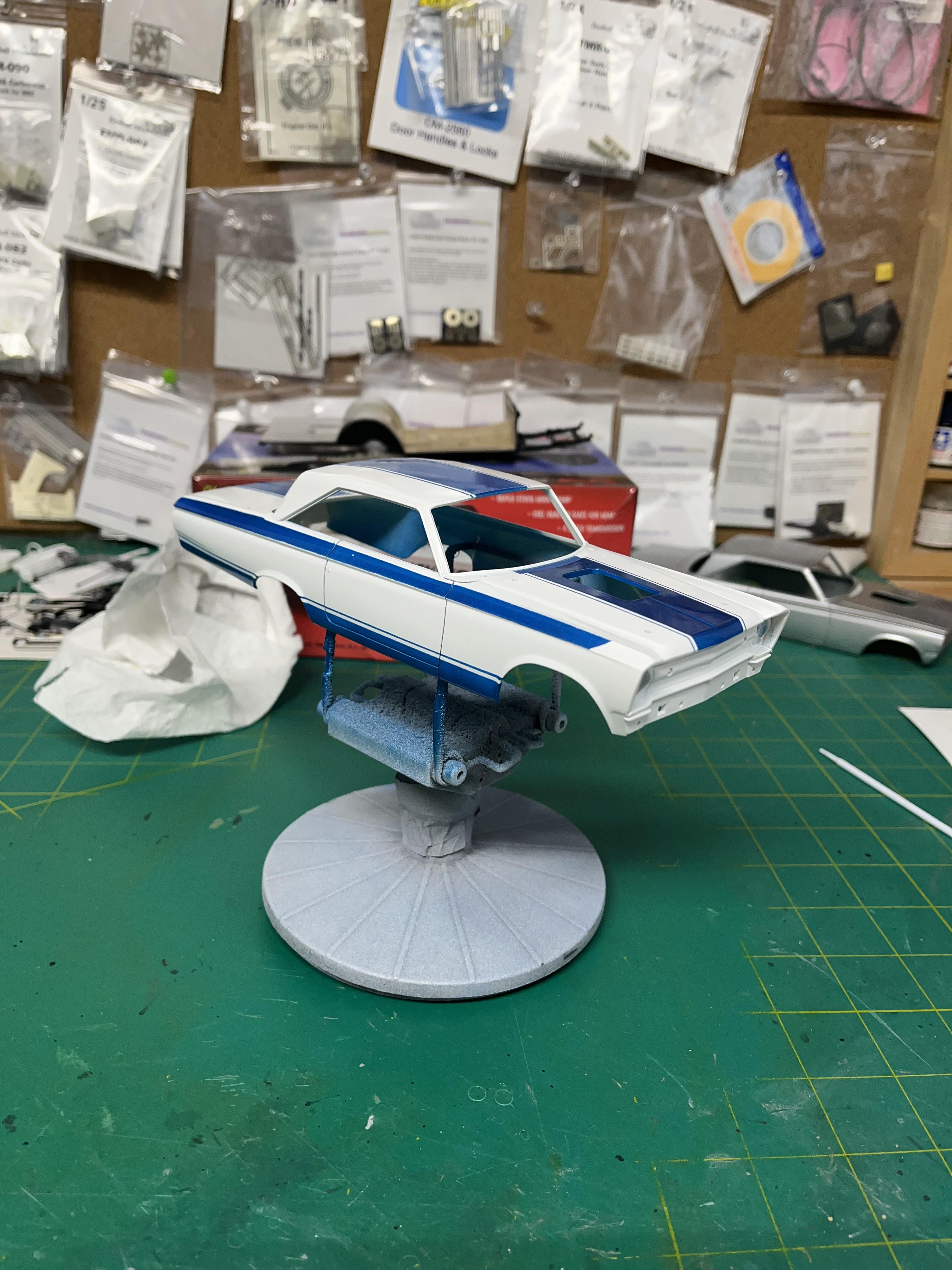

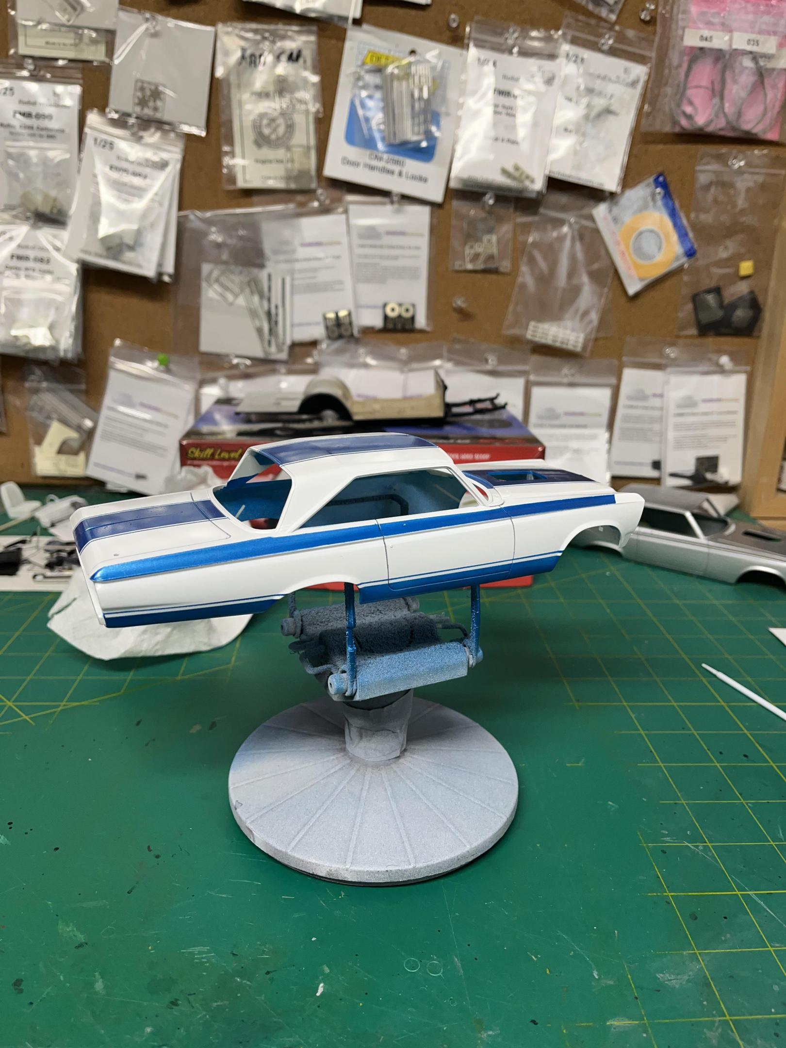

I also masked up and painted the blue and pinstripes on the Melrose Missile car. After foiling and decals, this one can be assembled. The interior and chassis are pretty much finished now.
  • Like 6

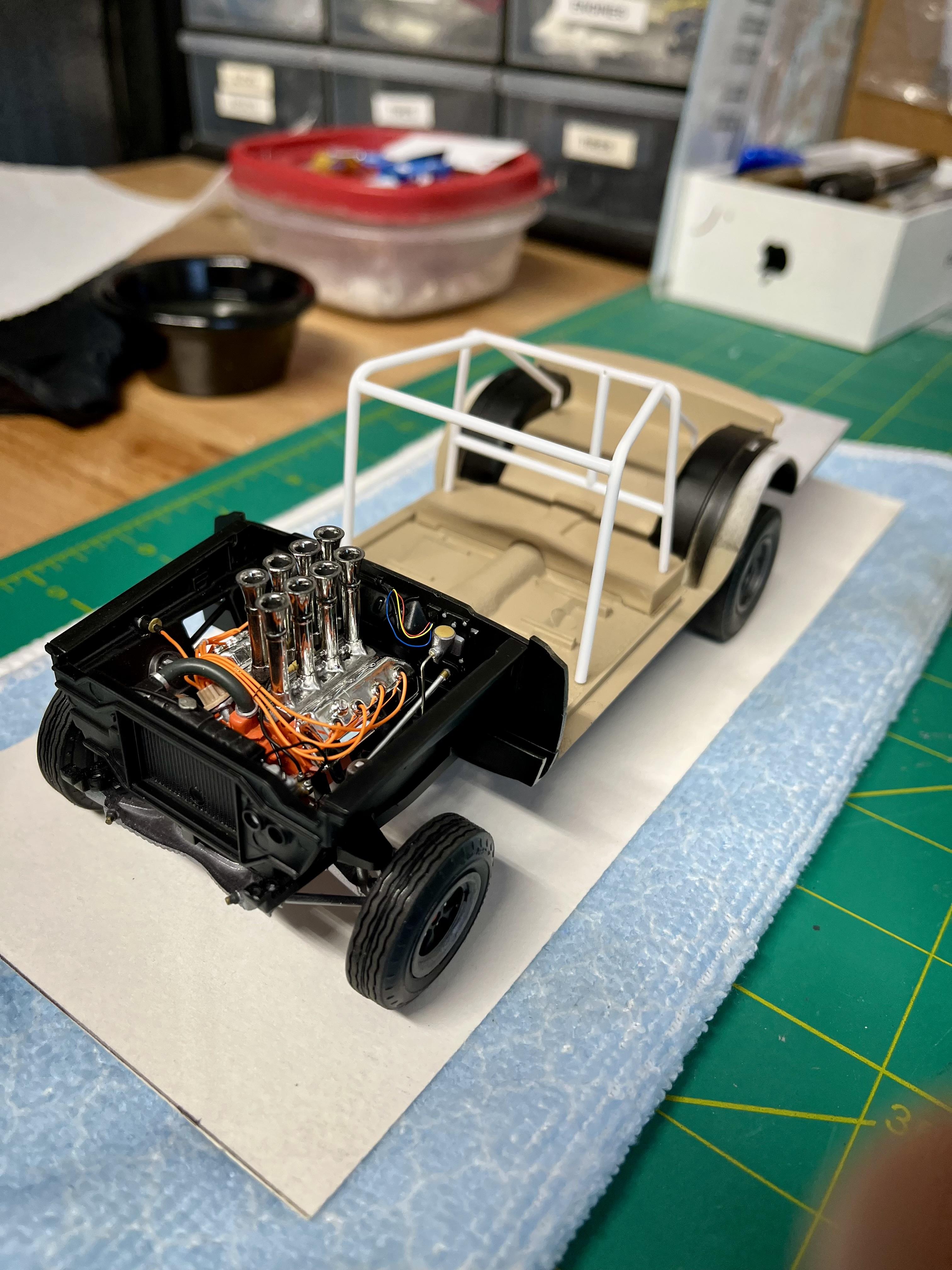

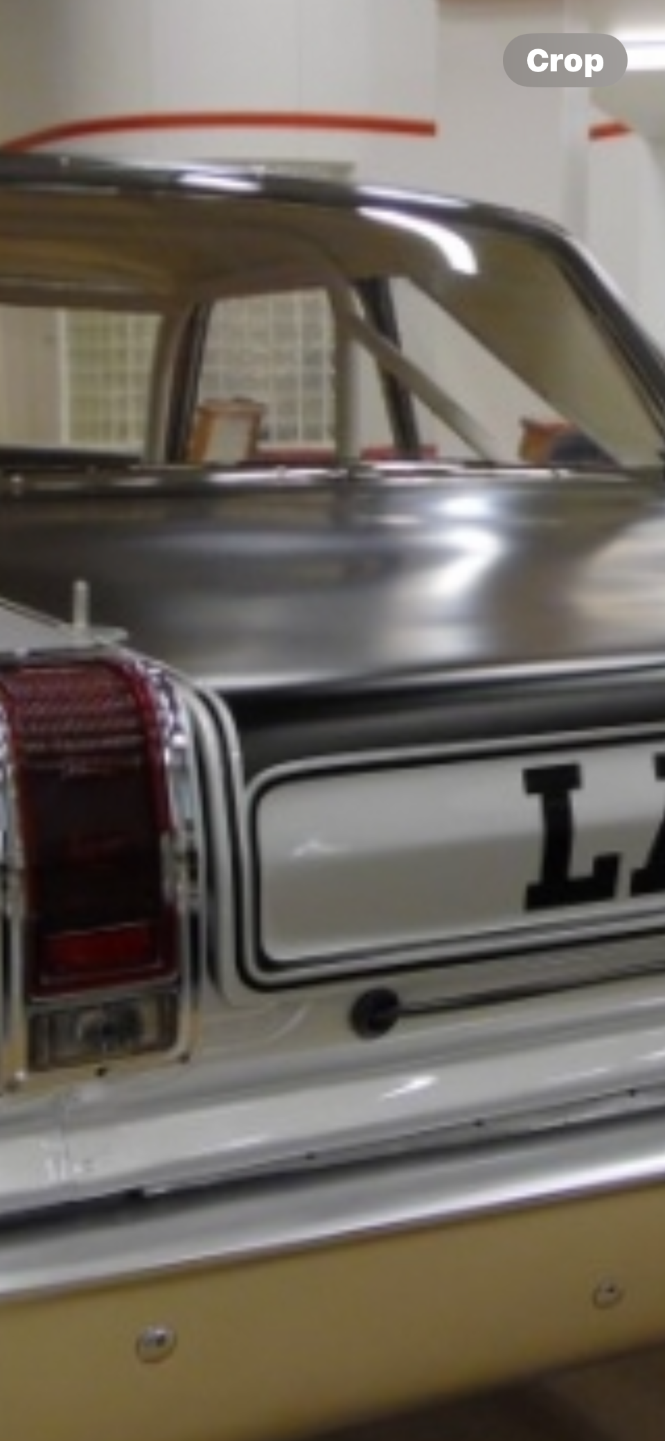

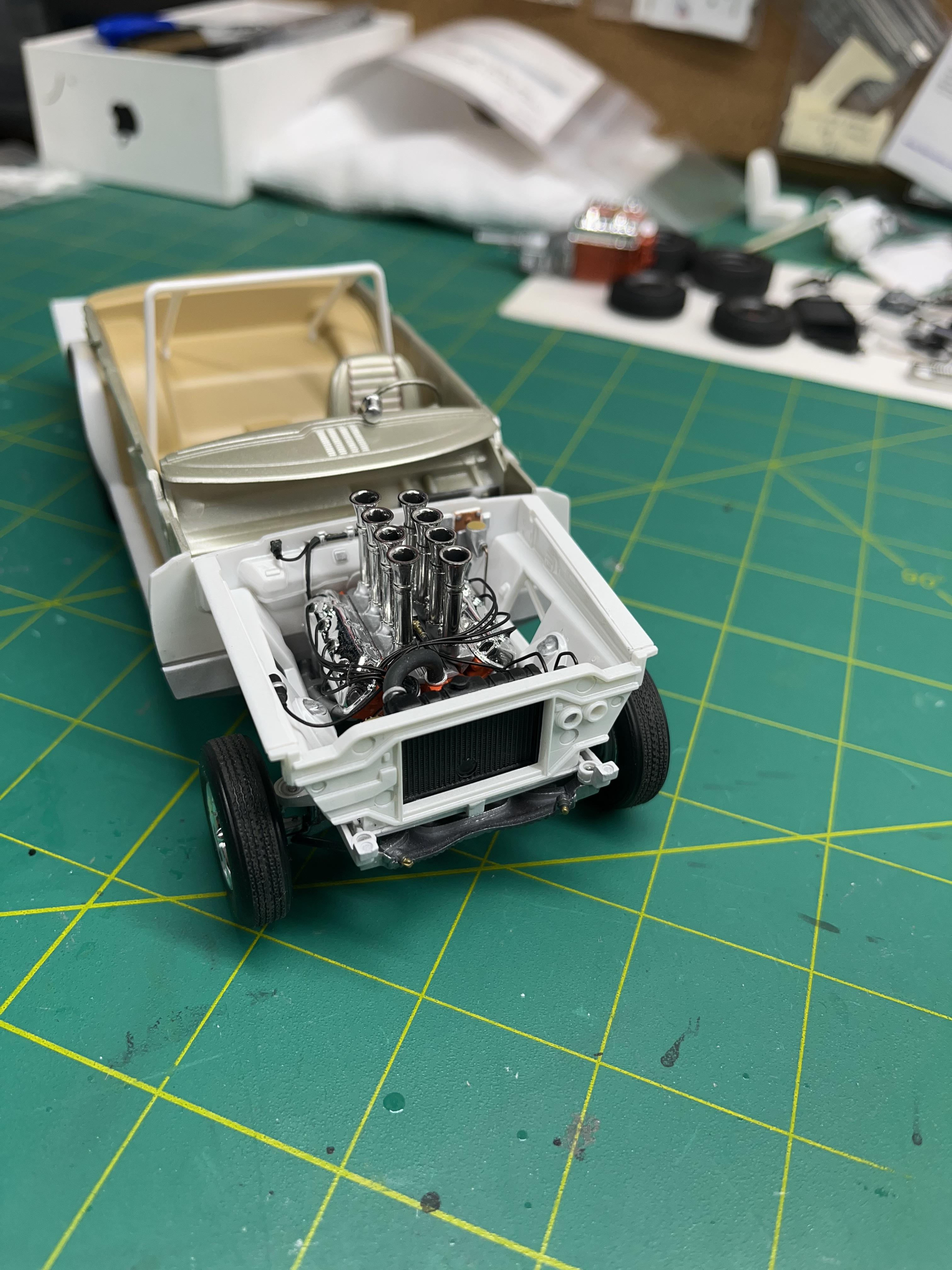

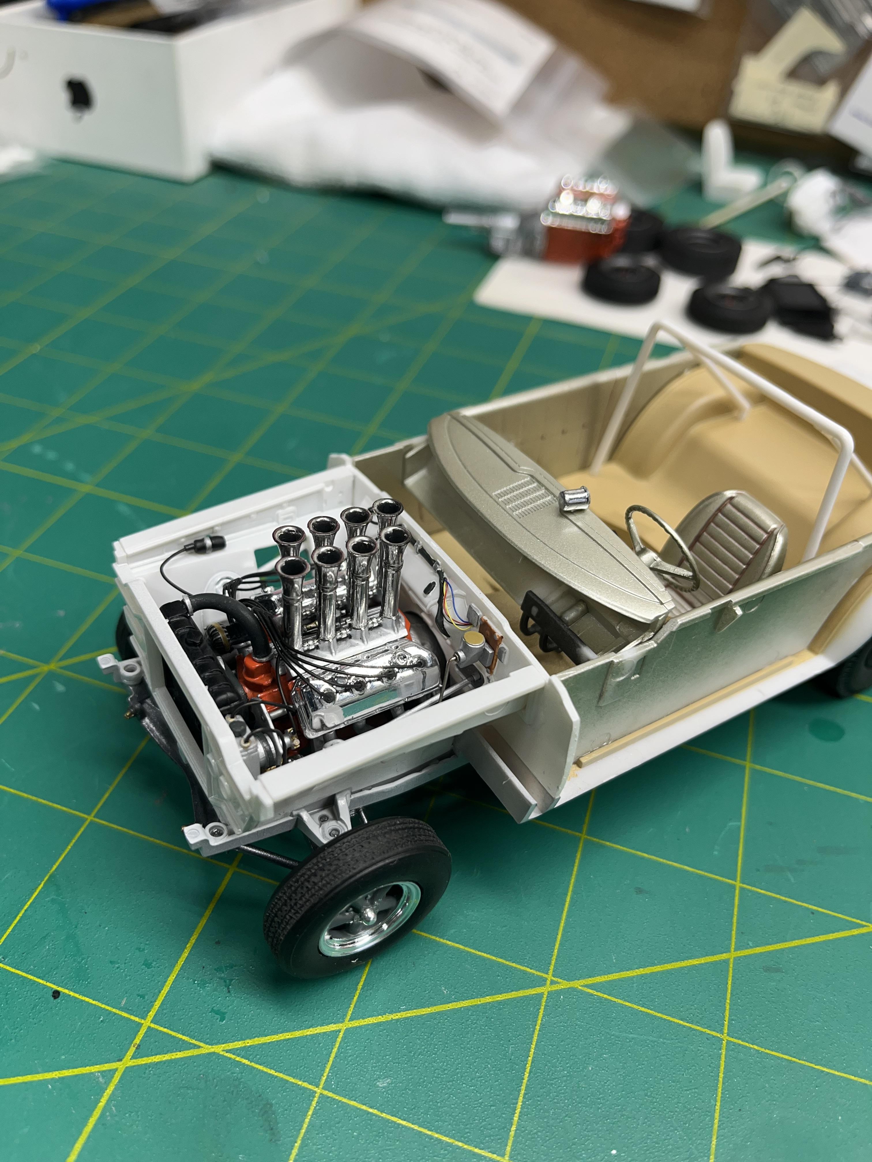

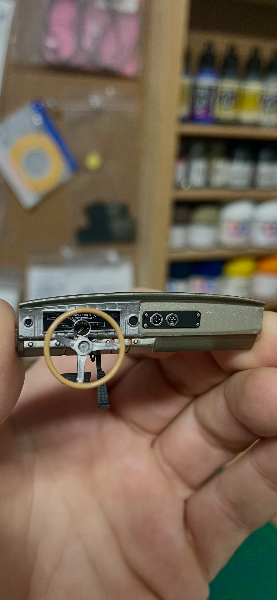

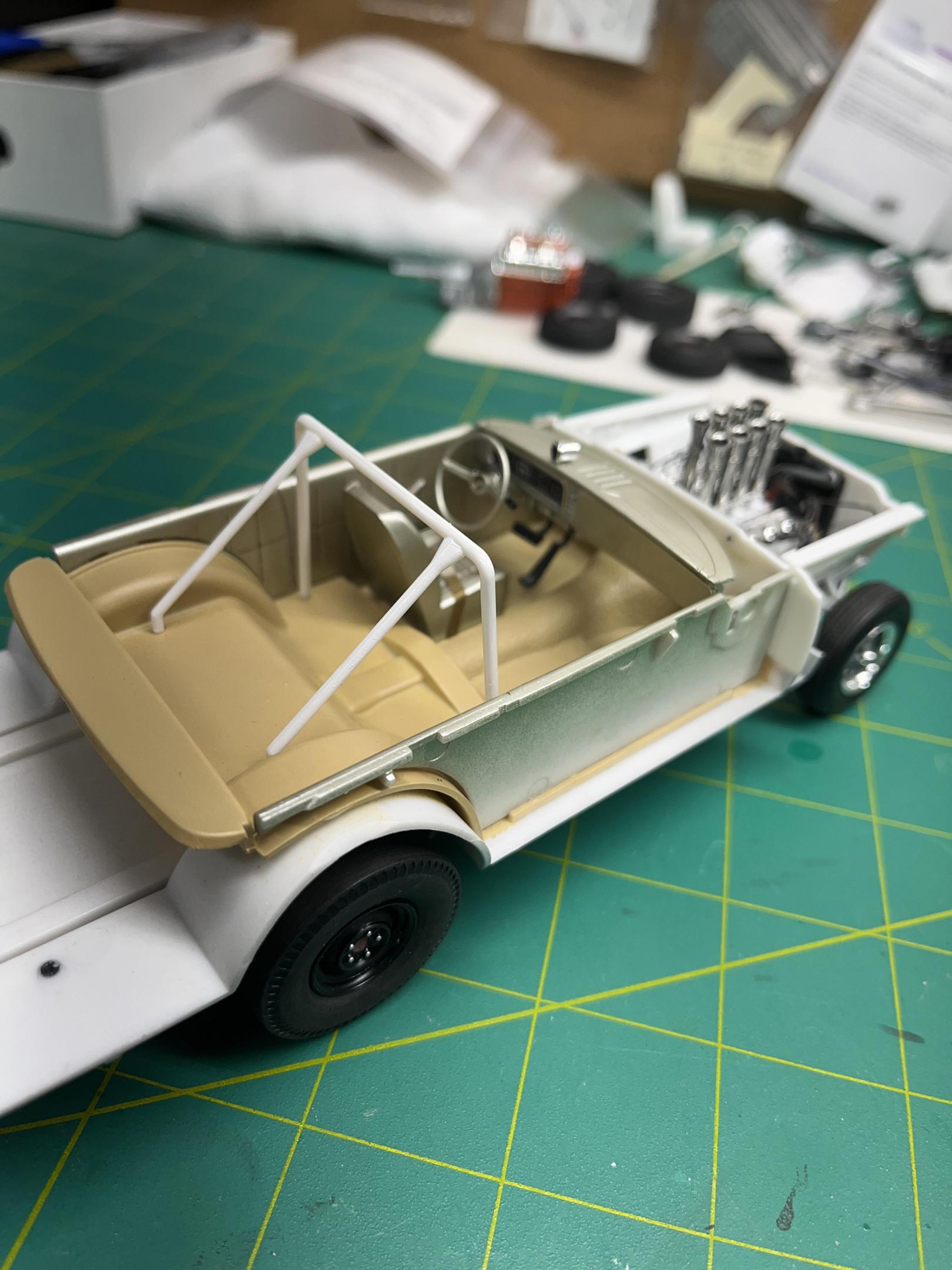

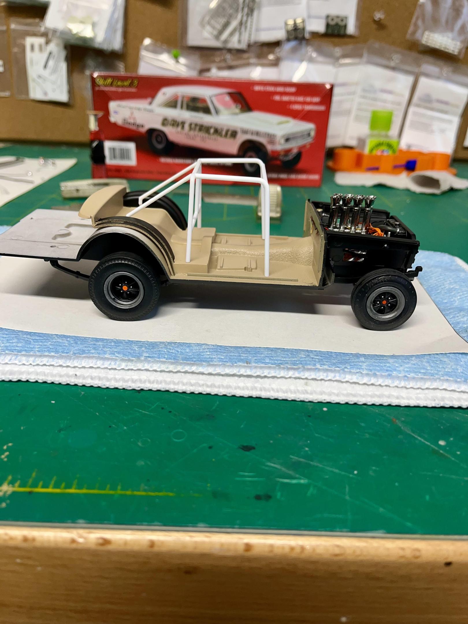

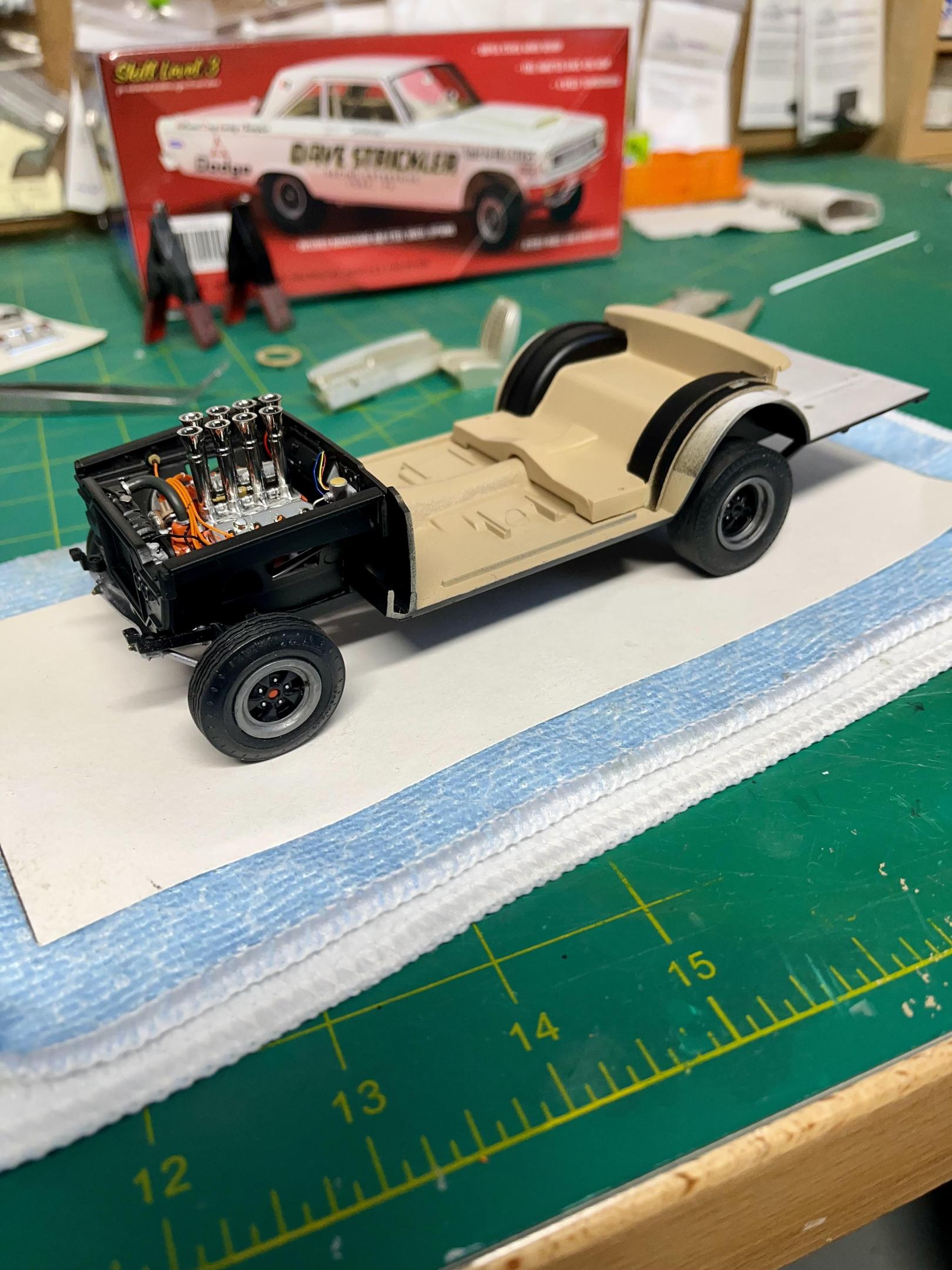

Worked on the Landy AWB, and I assembled the chassis and engine, and suspension. Trying to get the interior looking like it does on the real car. I probably should have built the entire cage from scratch, instead of building off of the kit roll bar.
  • Like 1
