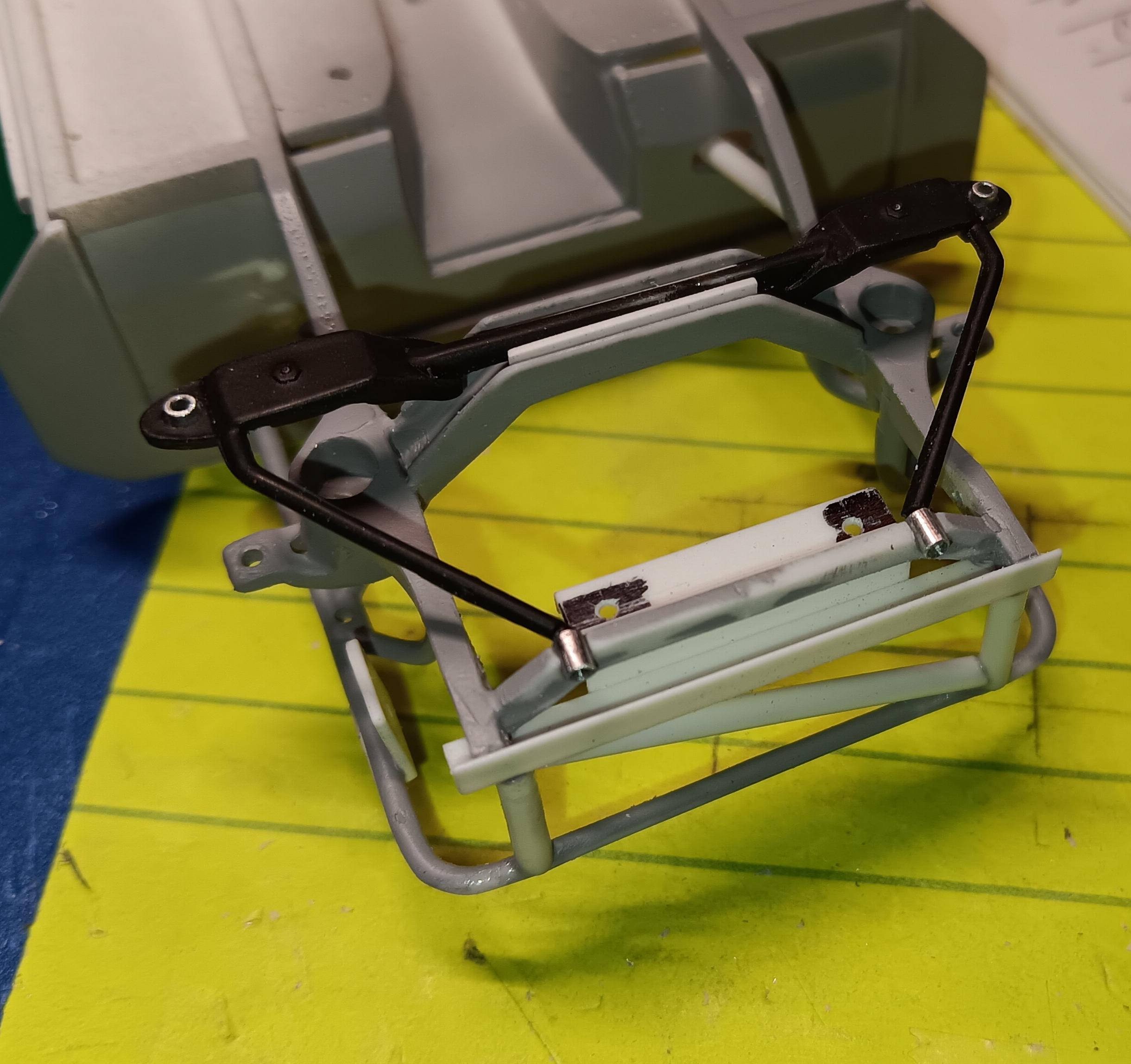

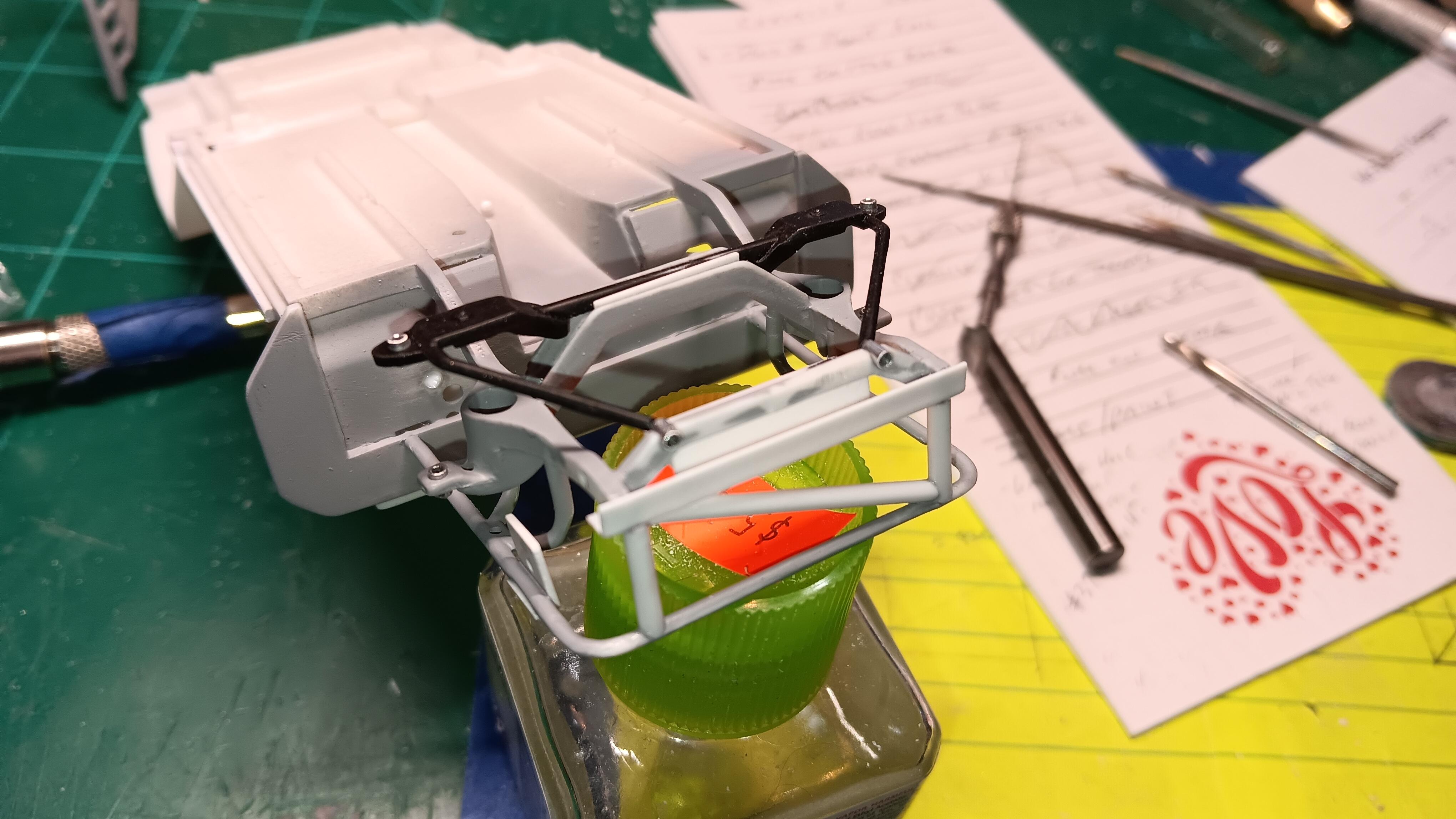

bobss396 Posted January 25 Posted January 25 Like I need another project, oh well. This is the latest re-pop of the old MPC Southern Stocker-ish kit with the slope nose Laguna body. I feel bad for any kid tackling this gem. Instructions are poor, some items like the rear cage kicker bars are missing. The dash was so bad, I made my own. The basic cage went together okay. I made features to locate the body to the chassis, angle plastic along the rockers, a bar across the rear to support the chassis. Extended the rear of chassis by 3/8" to close the gap, made a tab to locate the bumper, there was nothing there. The dash came out pretty good. I'm using Model Car Garage gauge set MCG 2098. Lots of parts were taken from a WC donor kit. The big block that came with the Laguna is awful. I'm doing a fit check with the SBC from the donor if the headers work out. I'm using some bigger PPP period correct tires and wheels. I have to play mix and match with the wheel backs. I dropped the rear by 1/8", it sat a mile high. 6

dwc43 Posted January 25 Posted January 25 (edited) By 75 those NASCAR type cars were running 358 small blocks. Really the big block was pretty much gone by 72. And most were running slotted wheels by 75 too. And that rear is supposed to sit high until you get the car up to speed and the aero would make it squat back down to normal. Can't believe they left the kicker bars out of the kit. That front cage around the engine is not correct either, but they put that in all the kits. Edited January 25 by dwc43 2

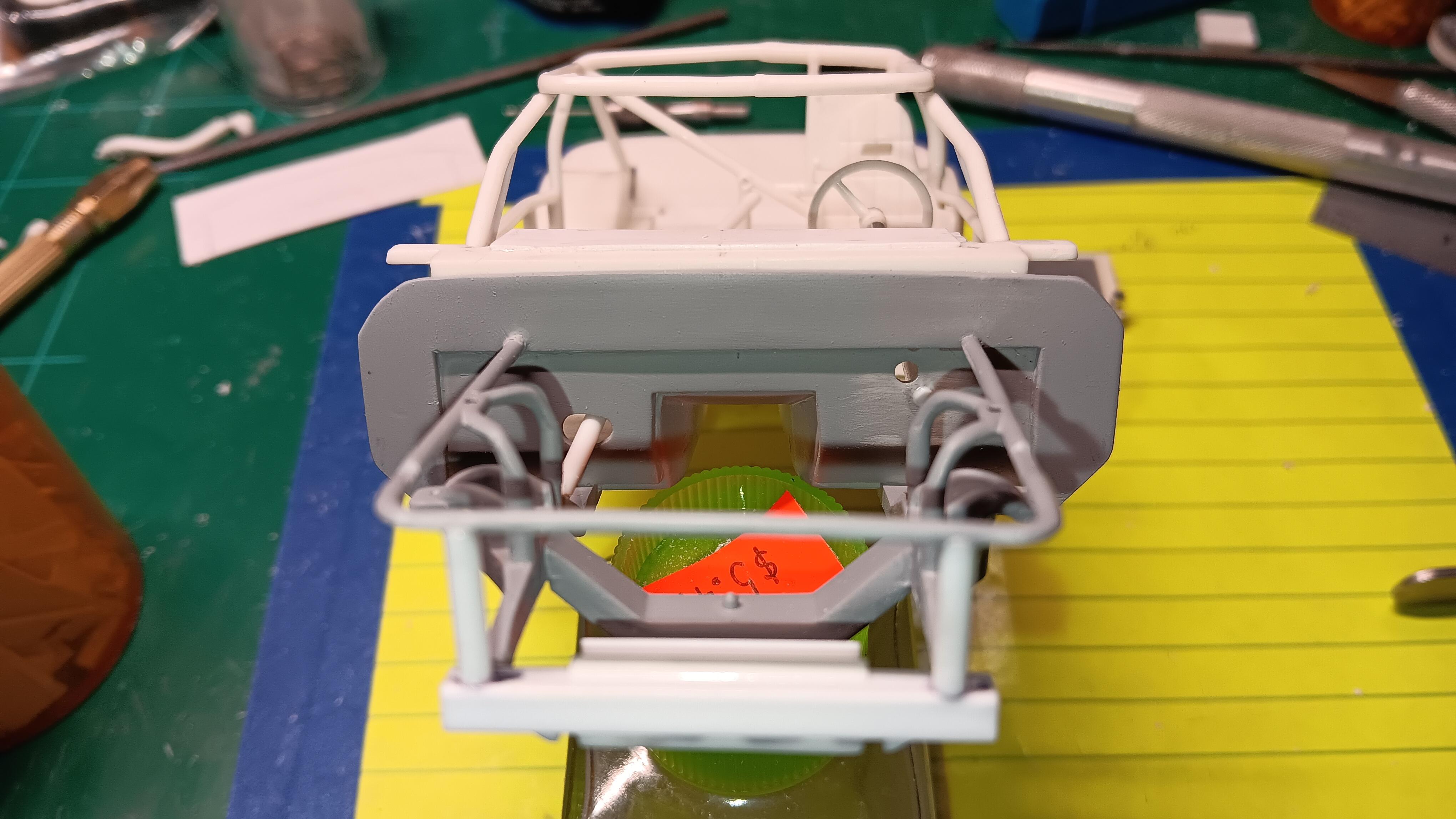

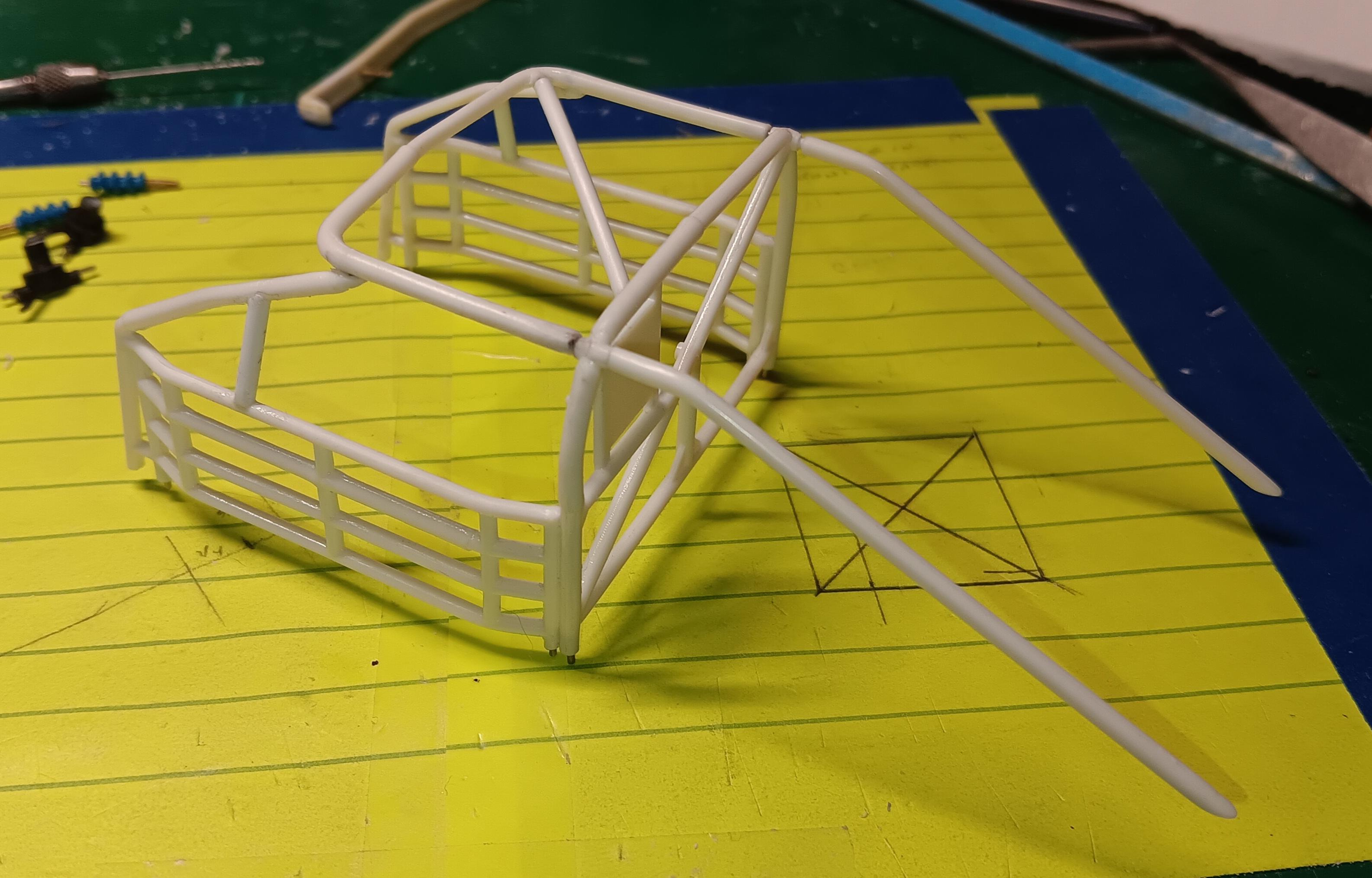

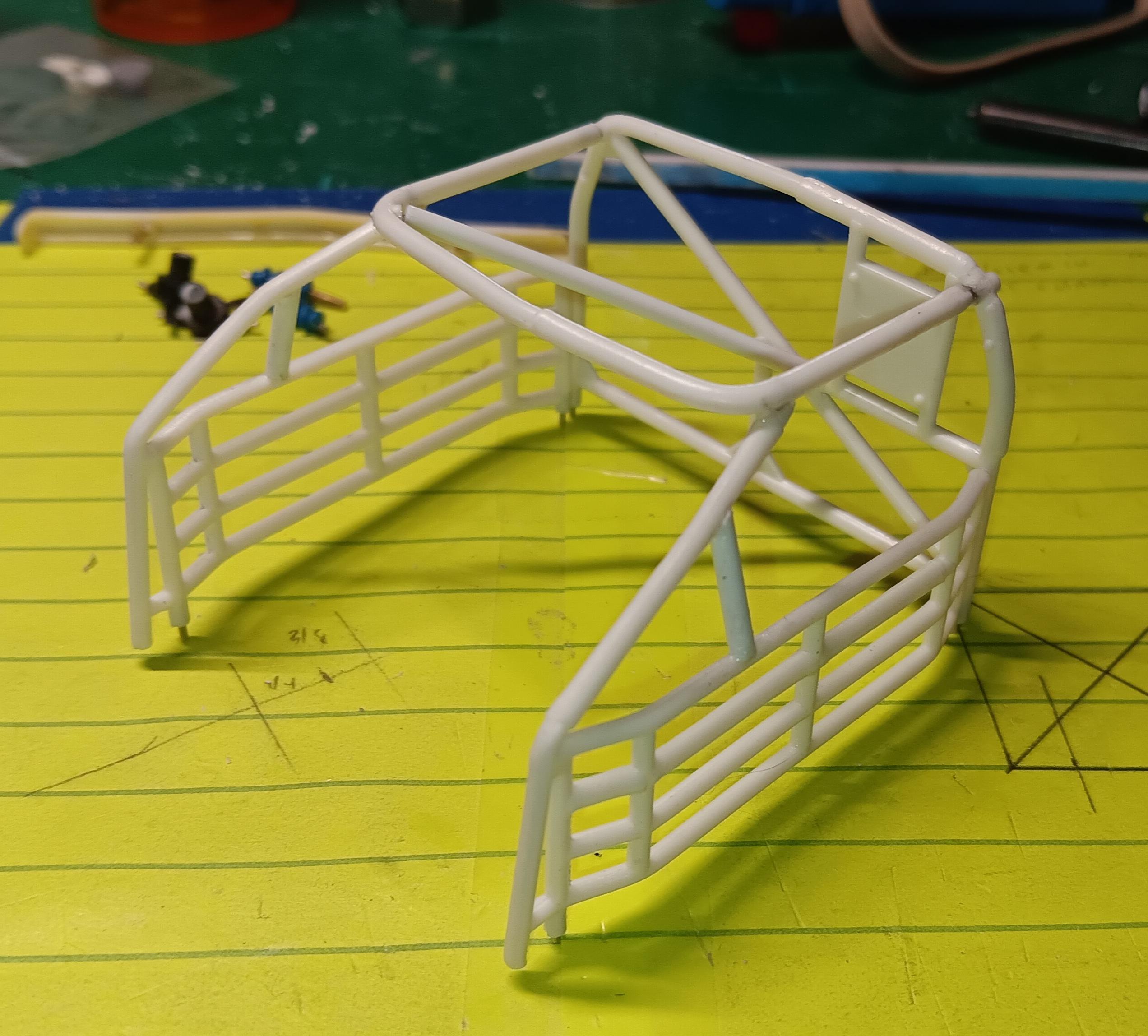

bobss396 Posted January 27 Author Posted January 27 This is it for today. The cage is close to done. The rear kickers came from an AMT donor and went right in. I added 2 vertical bars by the side glass to give the cage more strength. The front cage piece was an abomination, so out that went. I added 2 bars up front and have to make up a diagonal bar. The seat, also from the donor kit, was modified slightly. Steering column is aluminum tubing. I used an old NASCAR radiator to make a new one. I'm waiting on a 3D printed big block. The kit one was awful, especially the headers. The new one looks to have similar headers. I also have a big order coming from Ron Coon Resins. 2

bobss396 Posted January 28 Author Posted January 28 Cage is done. Added a Ron Coon overflow tank and fuel fill. Pinned the spindles, added 00-90 threaded rod for front weight jackets. Using a PPP window net. MSD boxes will be inside on the dash. 3

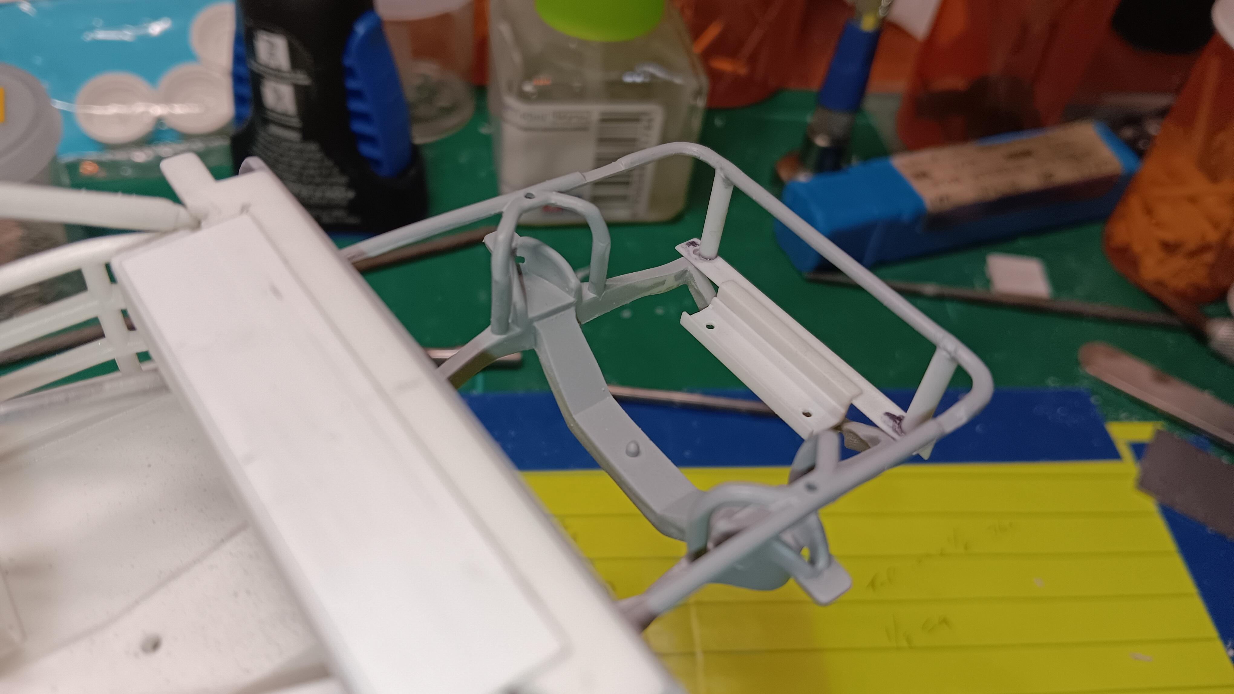

bobss396 Posted January 30 Author Posted January 30 I decided to make up some bushings to help locate the front strut rods and lower spindle mounts. I still have to do the upper spindle locations. 1
