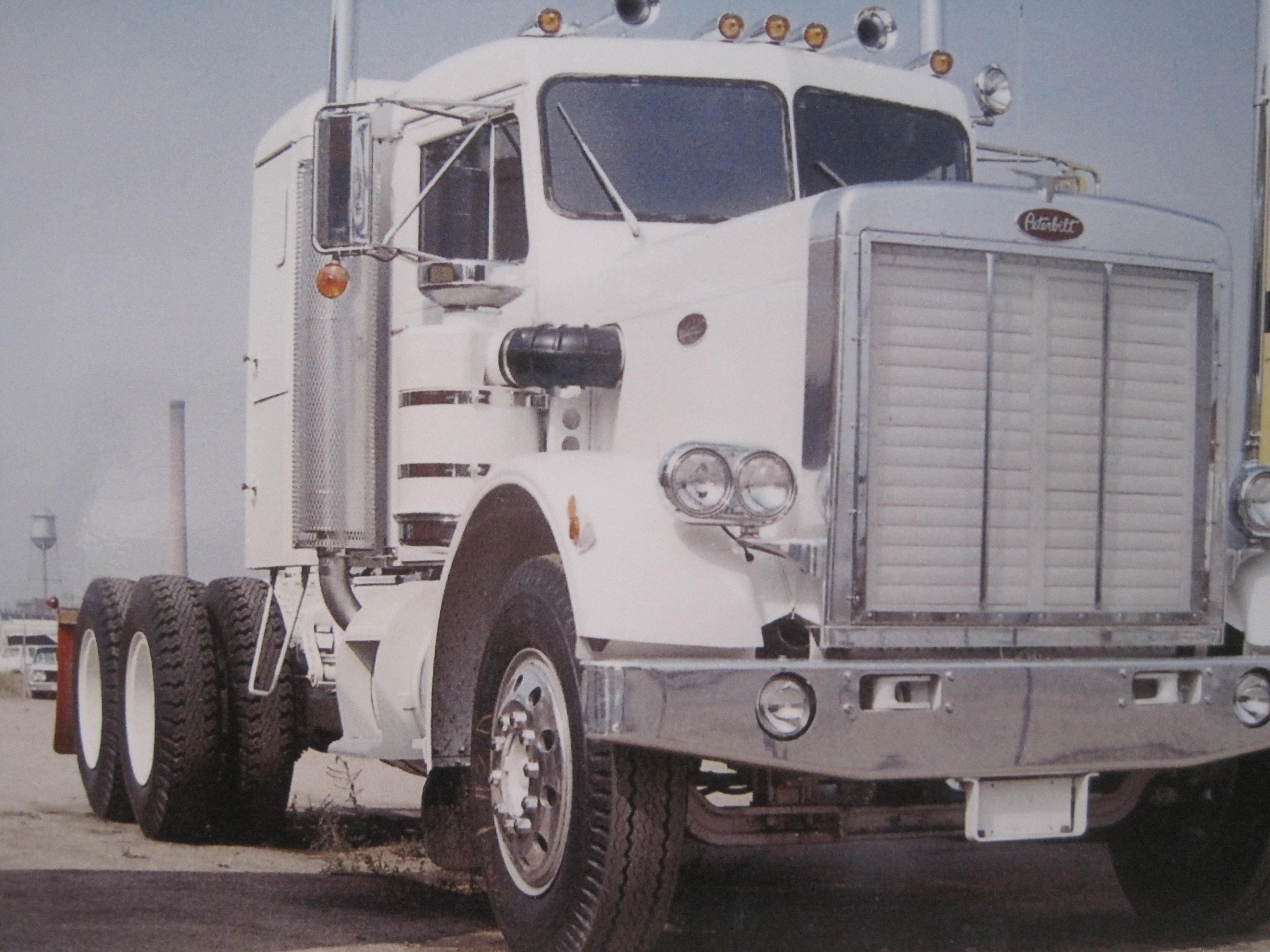

Really like your detailed analysis of the California Hauler issues and approaches to correcting the problems, wish I had that patience.  I like to study period older photos to get a better understanding of the subject. Here is a period photo of a California Hauler, note how front wheels sit under fender. Most all have turn signals in the standard top of fender location, however this one does not. Another thing I notice is many builders black wash the grill for some reason, most grills really need a white wash.
Edited by leafsprings
  • Like 3
  • Thanks 1
@leafsprings Thanks for the positive feedback, and this photo helps greatly.   Double thanks on this!  👍
Although, I don't think I have the necessary talent to make everything look exact, but I was able to pick up a couple of ideas for the truck.  For one, I will definitely try to put the front wheels under the fender.
As you pointed out, that front grille is definitely interesting to look at, almost as if there are operable blinds (white) to control the airflow.  But I am not sure if things were that high tech back then...  Or perhaps that white panels are the radiator front?
And both of the windshield wipers seem to operate in same direction too.

Talking about grille, it could be trivial to most of the folks here, but this is the technique I have been using to cut out the center portion of the grille:

2 hours ago, cifenet said:
white panels
The White panels you are talking about are called Shutters they control the airflow to the Radiator. On some trucks I’ve drove when these Shutters would close it sounded like a Jet engine sucking in air because it made the fan work harder you definitely knew when those shutters closed. When they opened again it was like the truck was breathing a sign of relief.  This mostly happened on old Mack’s that I drove and a 1969 Brockway 360.  What was cool is back in the day drivers would paint something on the shutters like a letter or something. A friend of my dads had “Hobo” painted on his with a Hobo character painted on them it was pretty neat when they were open you couldn’t see it when closed you could.
Edited by Pete68
  • Like 1
  • Thanks 1
A few UK trucks had them too, they were Kysor Air Shutters. They were most often a dull aluminium, mostly because they weren't visible in the UK, the rad was buried under all sorts of bodywork. We used to cut a section out of the upper radiator hose and fit a section in with a temperature sensor. That fed a signal to the motor on the shutter to adjust the slats. Clever idea.
Amazing how they thought about this some decades ago!  Thanks again for the info and the name of the mechanism, Steve!  Appreciated also.  I looked up Internet and already info is flowing~ :)

Great reference photos Hakan. Another short coming of the AMT Peterbilt kits are the poorly detailed rear axle hubs which lack axle shaft retaining nuts. Your photo shows the older style Rockwell hubs with 12 retaining nuts, the AMT ALF pumper kit has this style Rockwell axle hub. I used this axle hub on my '66 Pete 281 build. On my 70's KW build, I used the newer style Rockwell hubs with 8 retaining nuts. They were resin pieces found on ebay, unfortunately, they are not readily available as far as I know. Not sure what Rockwell hub style was used on a '69-'70 Peterbilt, probably, IMO, leaning toward the newer 8 lug style.
  • Like 1
  • Thanks 1
Håkan!
Never disappointed!  I totally forgot about the split rims and tube vs tubeless tires!  Great info as usual.
I need to rethink about my strategy on wheels, but I think I have crossed the border and it may be too much for me alter back.
I will have to blame you for giving me more options though. :)
Nevertheless, I think the reference photos are awesome here and allow me to contemplate even more on this subject.
On 2/11/2025 at 10:07 AM, Force said:
I see you wonder about wheel/tire size and the kit supplied wheels are the smaller diameter 10.00-20 rims and tube style bias-ply tires but lots of trucks back in the day had larger fiameter 10.00-22 or 11.00-22 rims for tube tires and these rims have the split/lock rings, and they fill out the fenders well.
I see you have rims for tubeless tires on the drive axles but plan to use the tubeless style lock ring wheels on the front axle, tubeless front wheels looks ..
Man, you guys are totally on the subject understanding the shortcomings and such.  If mine is going to go "incorrect", then I will have to go with the story of "all of the custom modifications done by previous truck owner". :)
