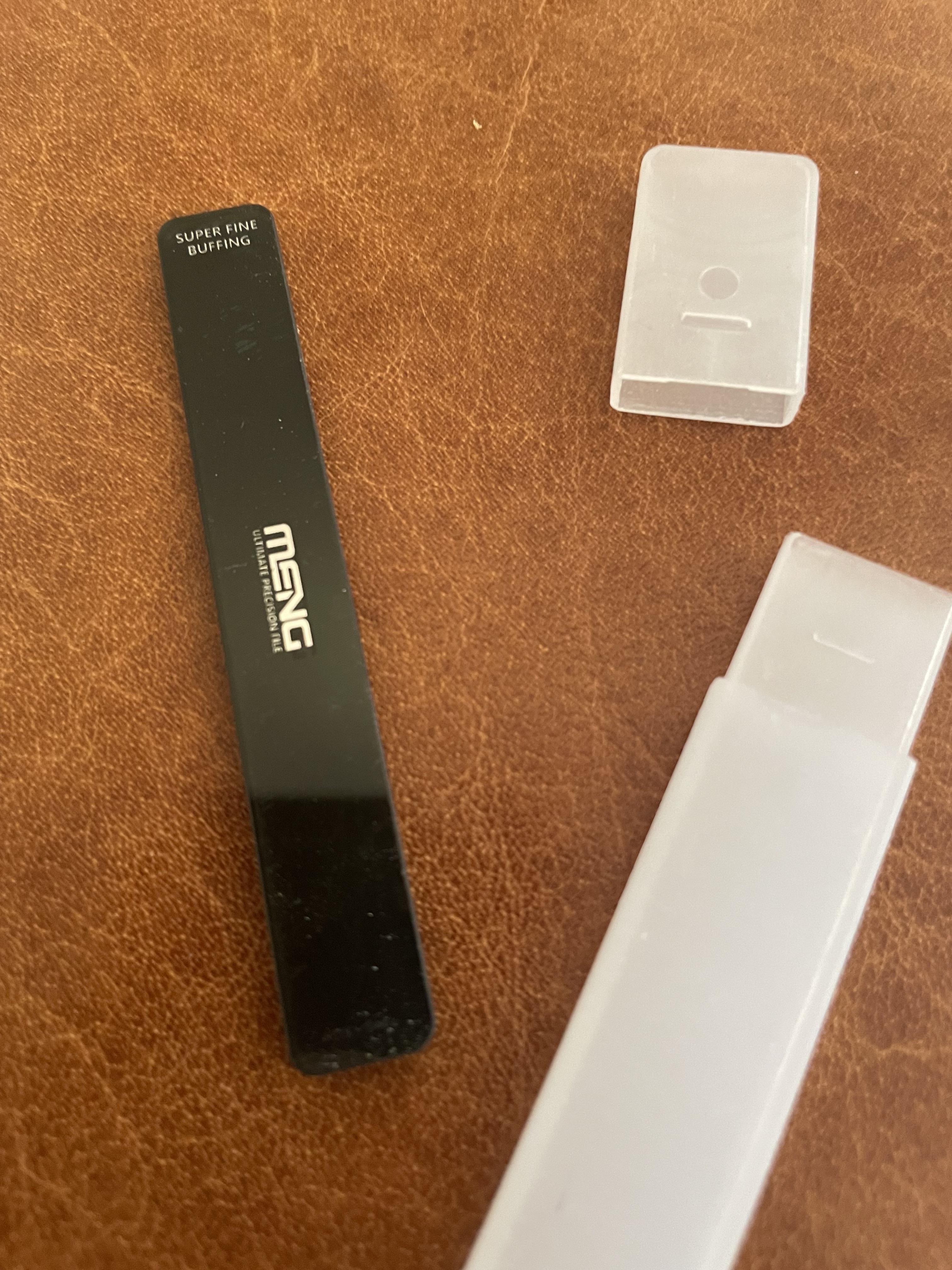

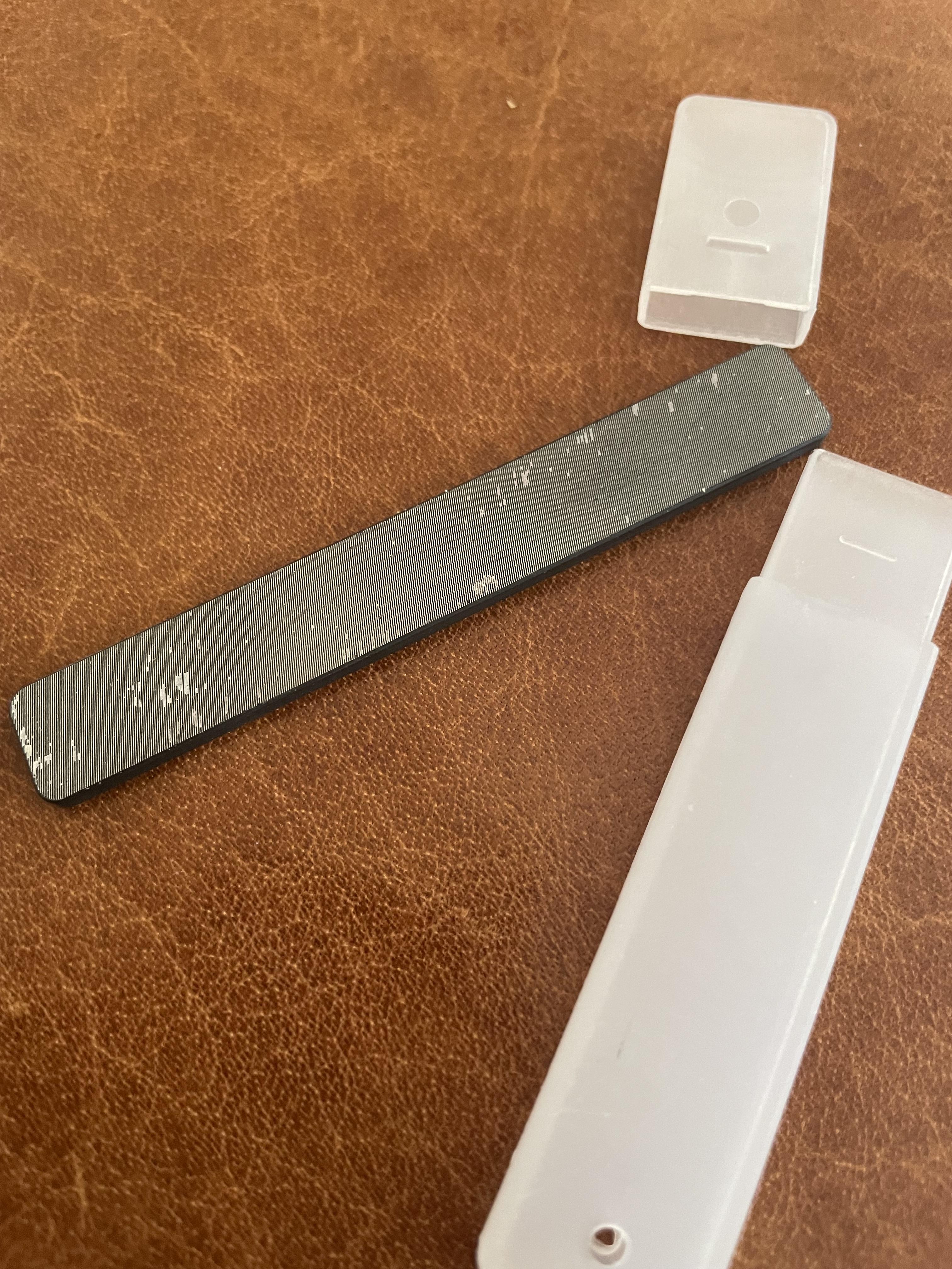

Ulf Posted March 27 Posted March 27 I have removed a small(old) glue spot on a windshield with MENG's diamond file actually. I had no polish or so where I was but it turned out very well actually. The windshield was convex so I could file without the edges of the file touching. A friend has said that he will try to file off the ”reading glasses” in an old Jo-Han windshield, maybe it will be another new level (his builder are very nice). 1
