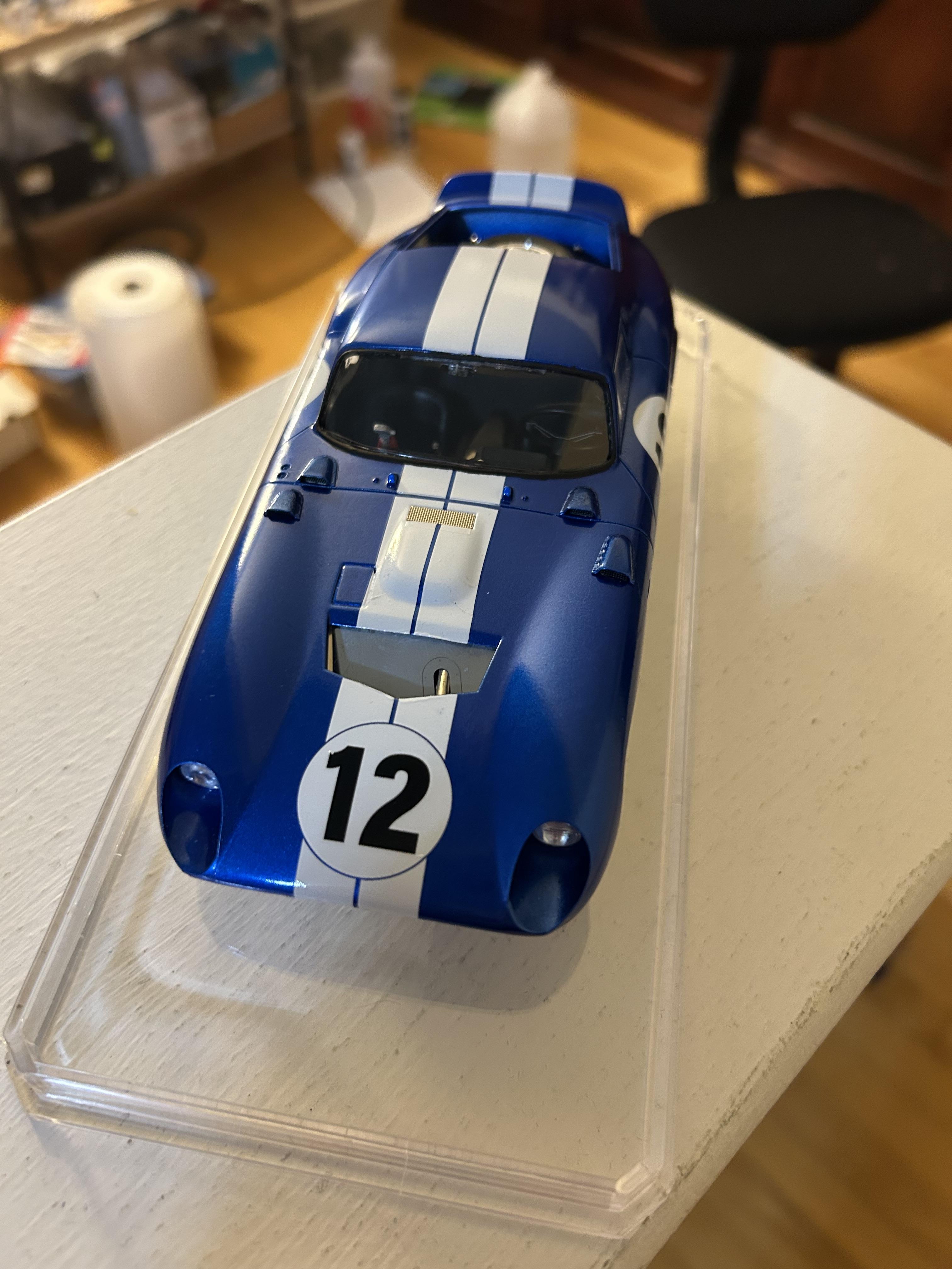

10 hours ago, styromaniac said:
Nice color ! Is that Tamiya...Mica Blue...or something else ?
Tamiya metallic blue (TS19) from can over grey primer.  Actually lays down nicely from the can
