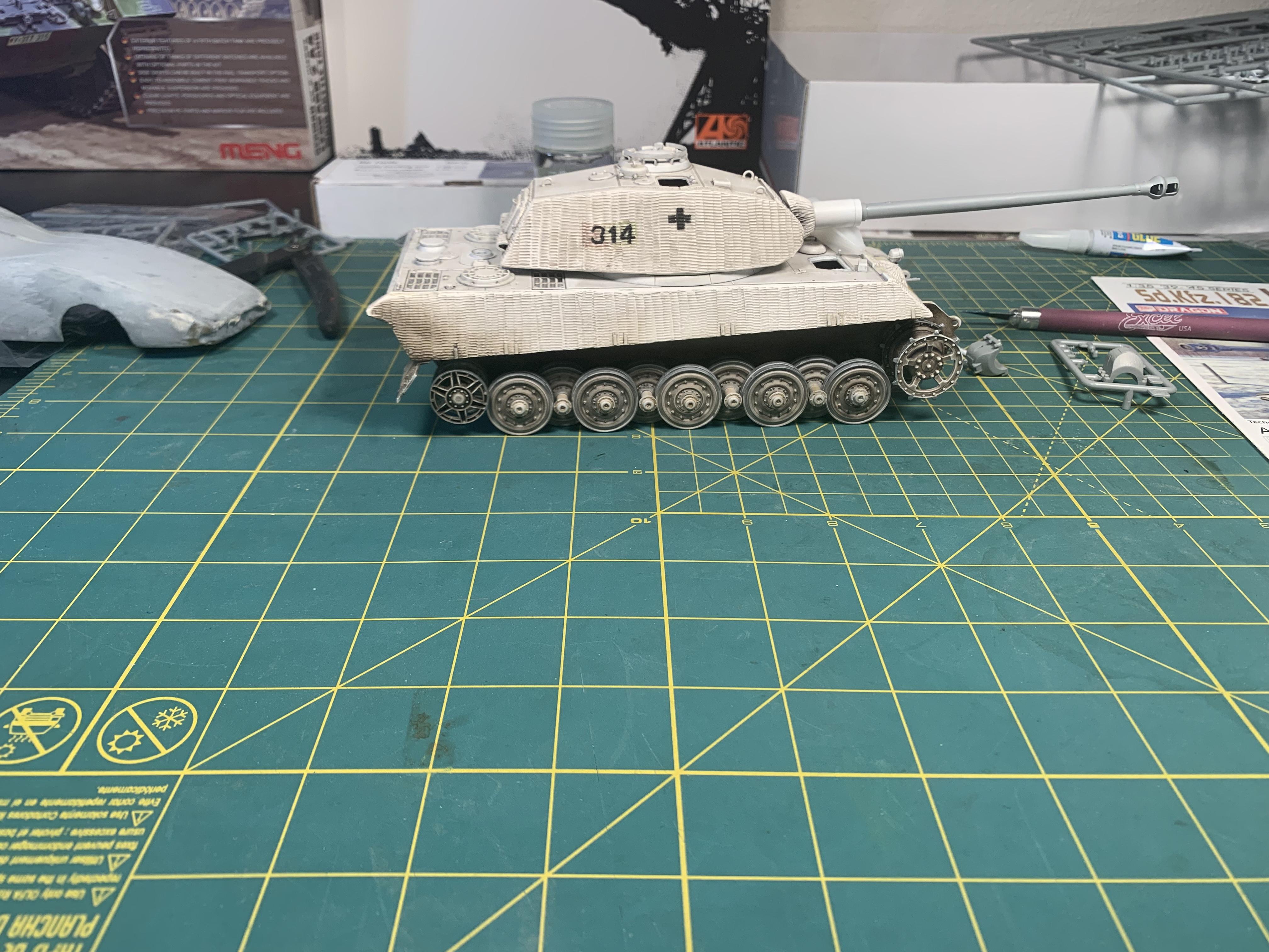

LDO Posted April 10 Posted April 10 I like Superfine White Milliput. It can be like Bondo or used for texture. I made the Zimmerit texture on the Tiger II tank by rolling it into thin sheets on a porcelain tile with a Teflon rod for a rolling pin. I used talcum powder to prevent from sticking to either. I scratched up the surface of the plastic with the back edge of a number 11 blade. 2
