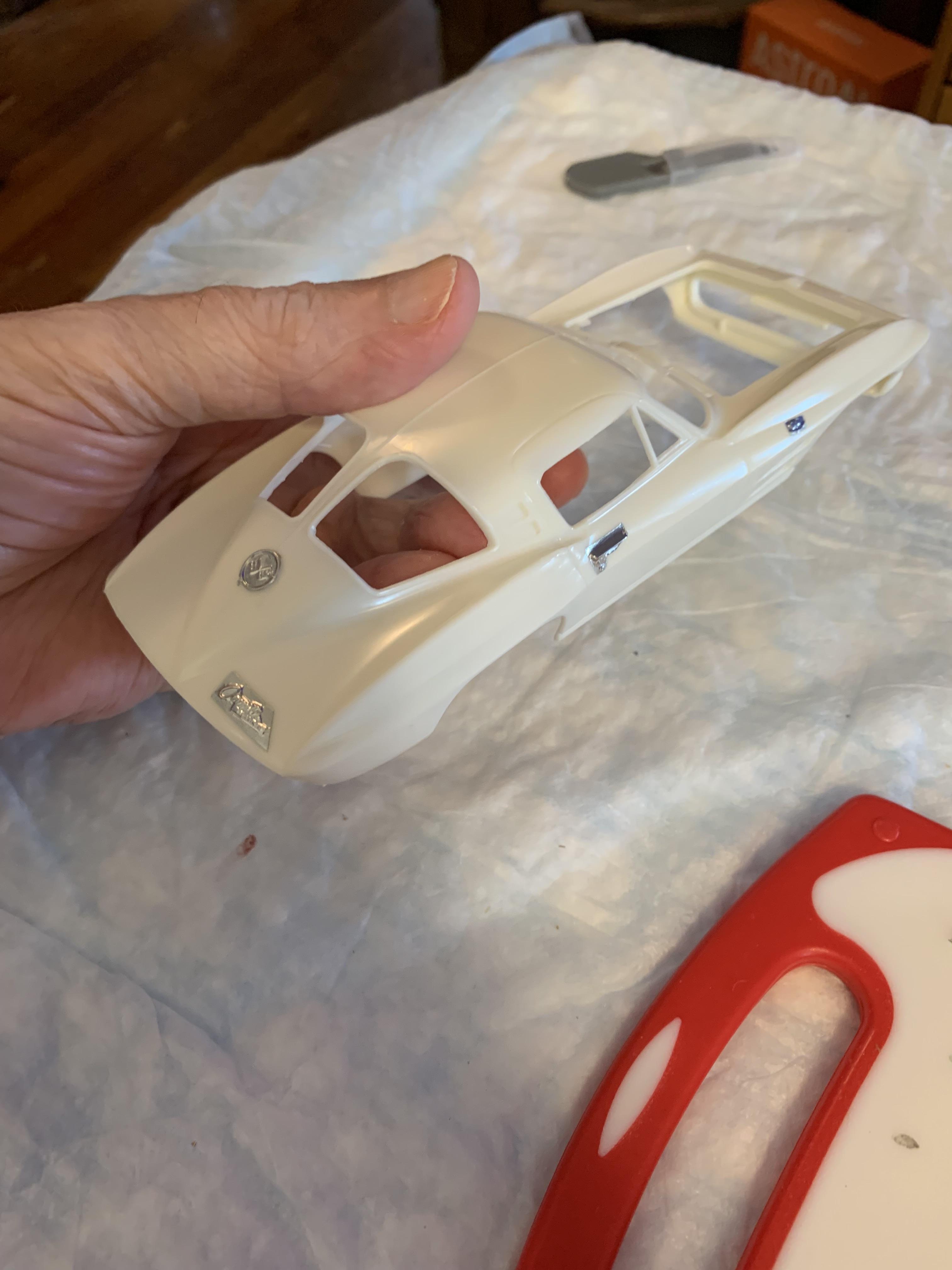

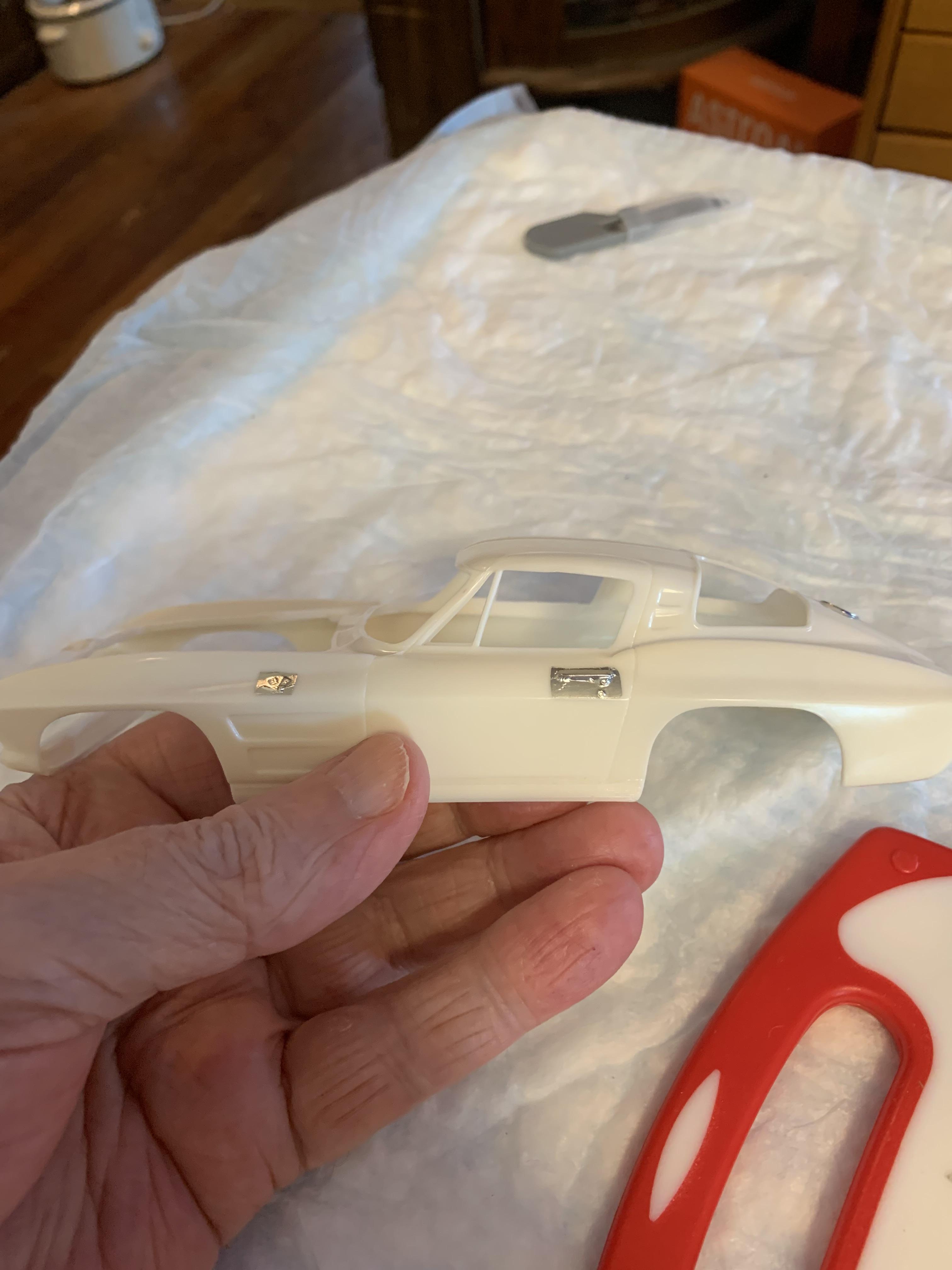

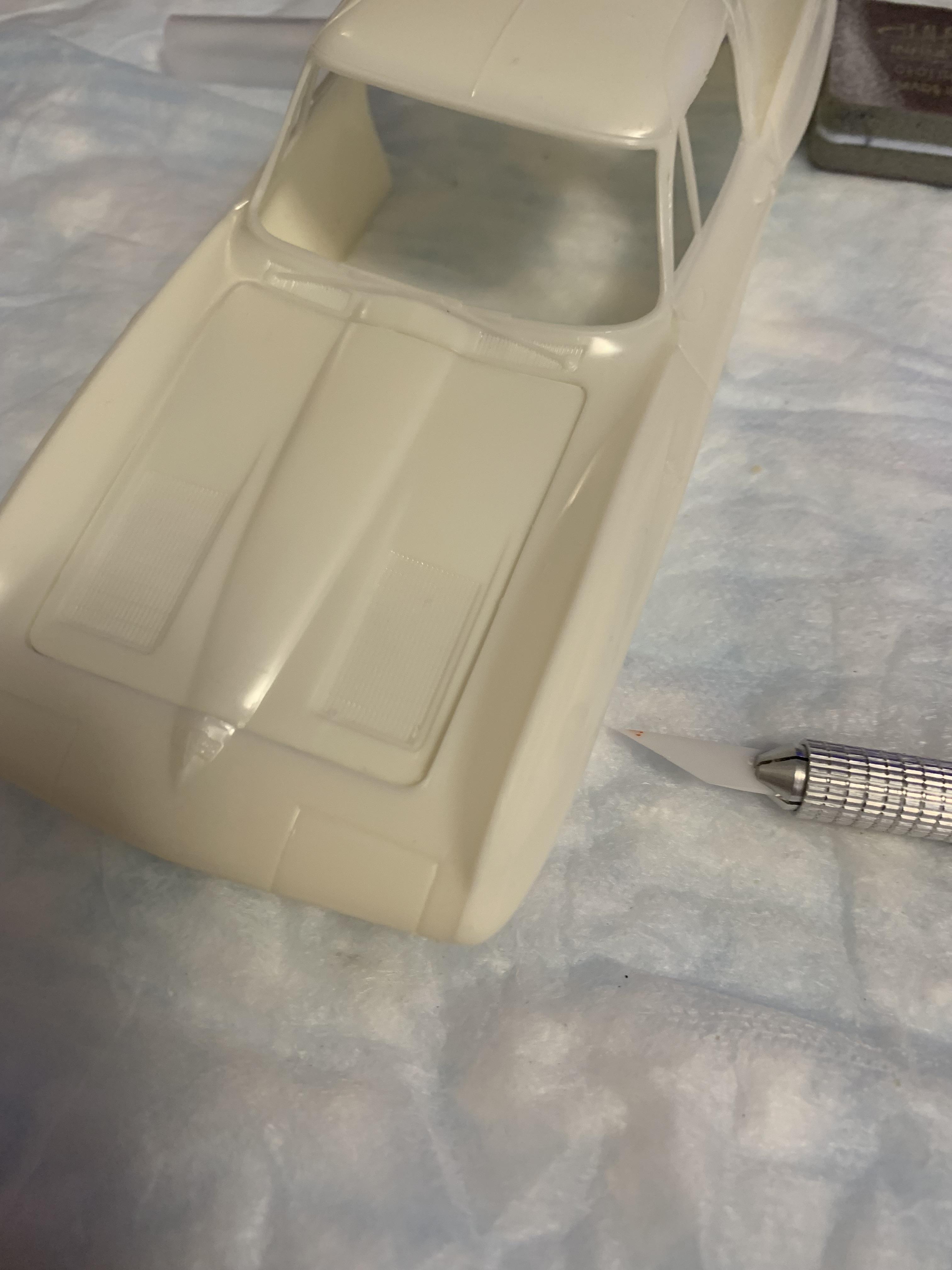

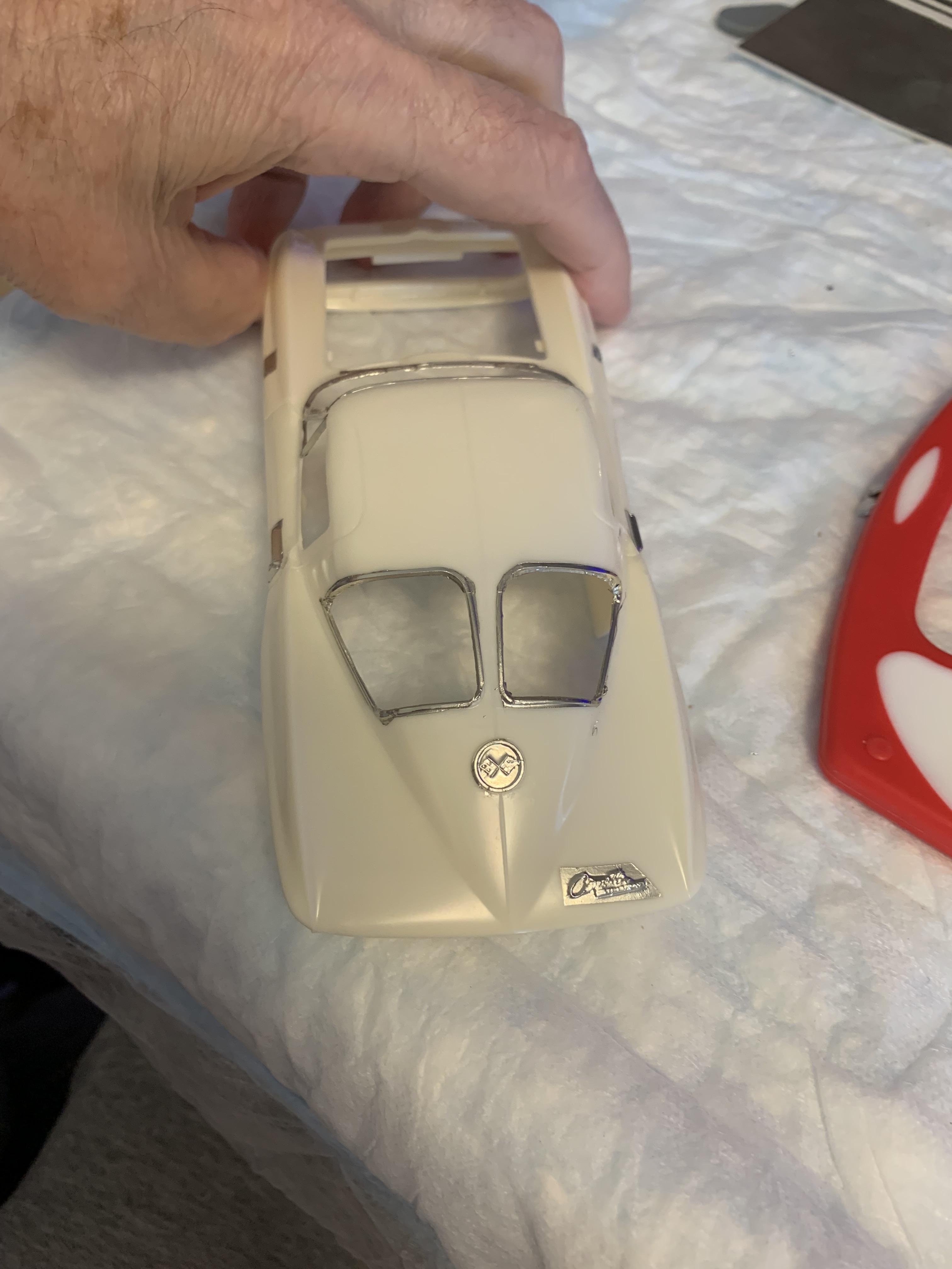

Geez, starting another one when I already have 2 or 3 started on here.  This will be a 327, perhaps 340 hp afb carb version, something like Tony Hernandez’s car.    Cleaned up some seam lines on the venerable amt “parts” kit.  Put some bmf on the emblems, then decided, what the heck, put the bmf on the windshields and chrome trim, too.  After the paint job, they will be rubbed off with alcohol or thinner.  No primer, put some Tamiya gold on tonight, will put some clear on tomorrow.

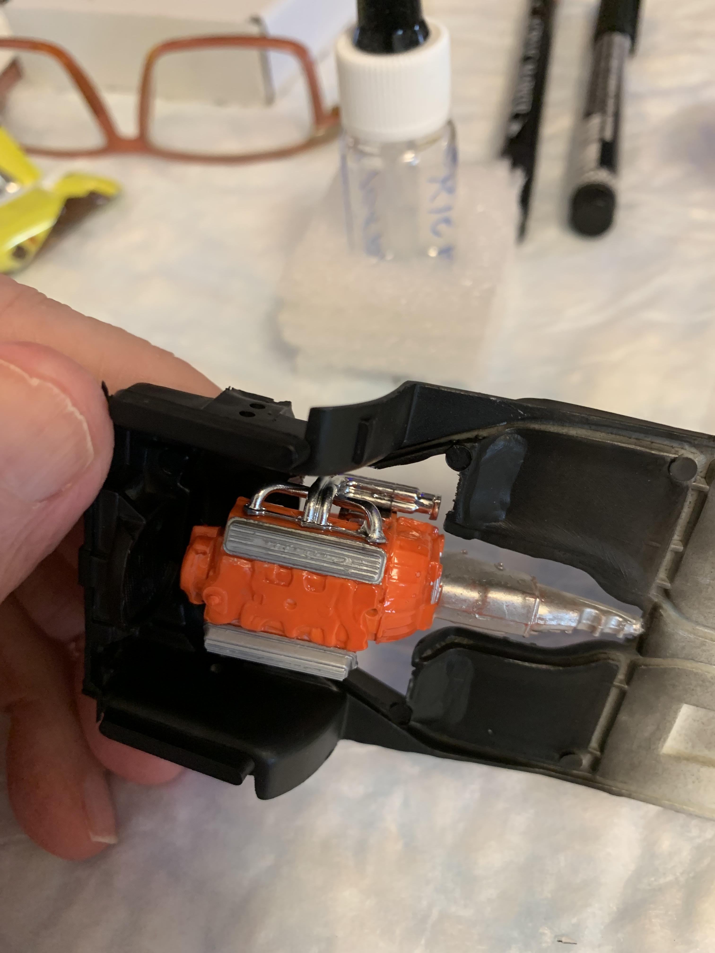

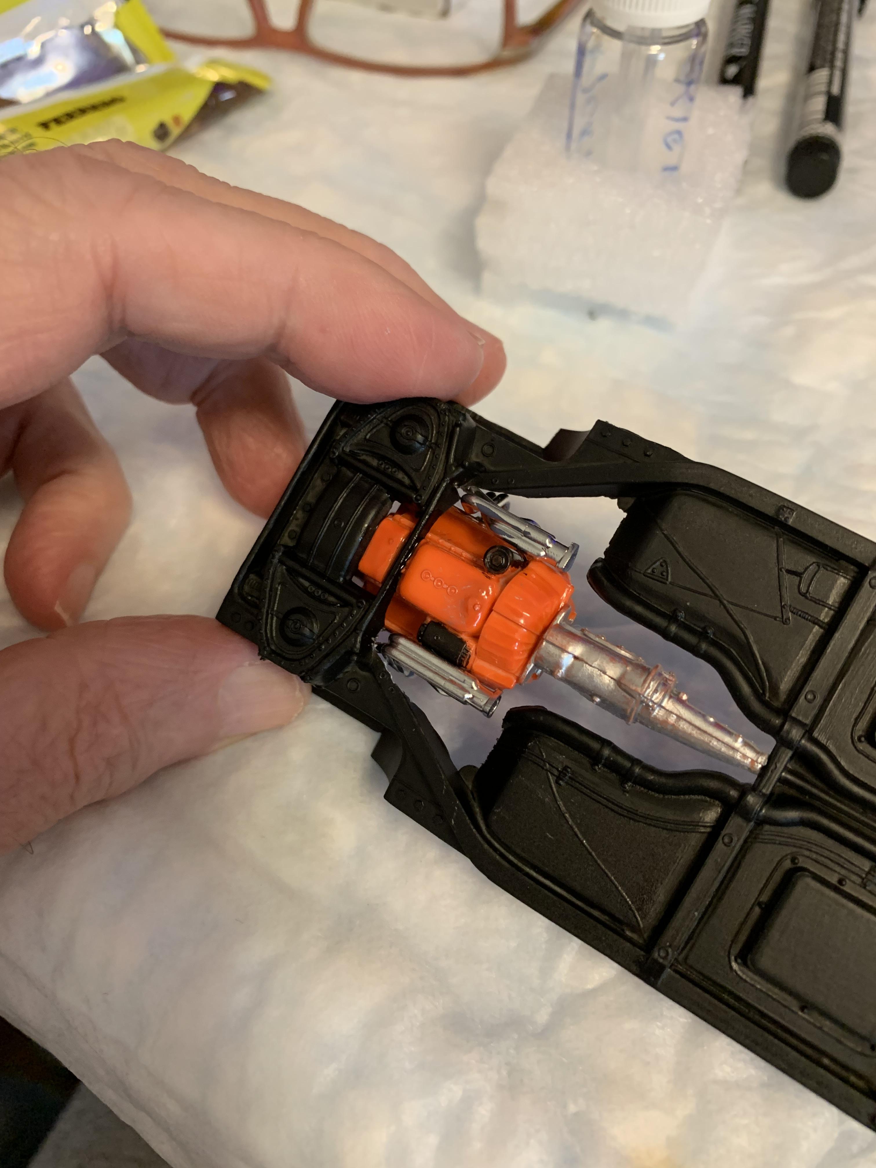

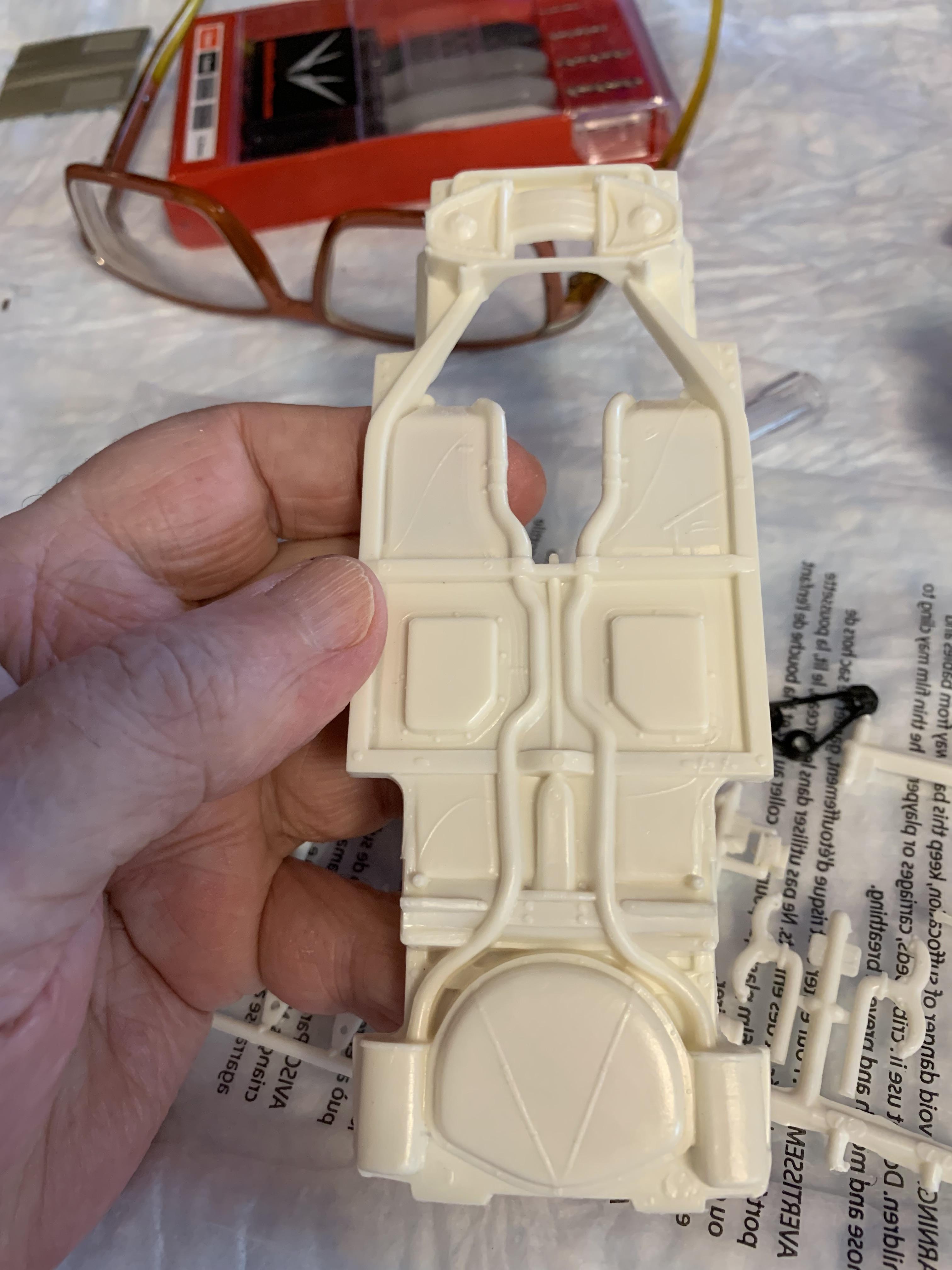

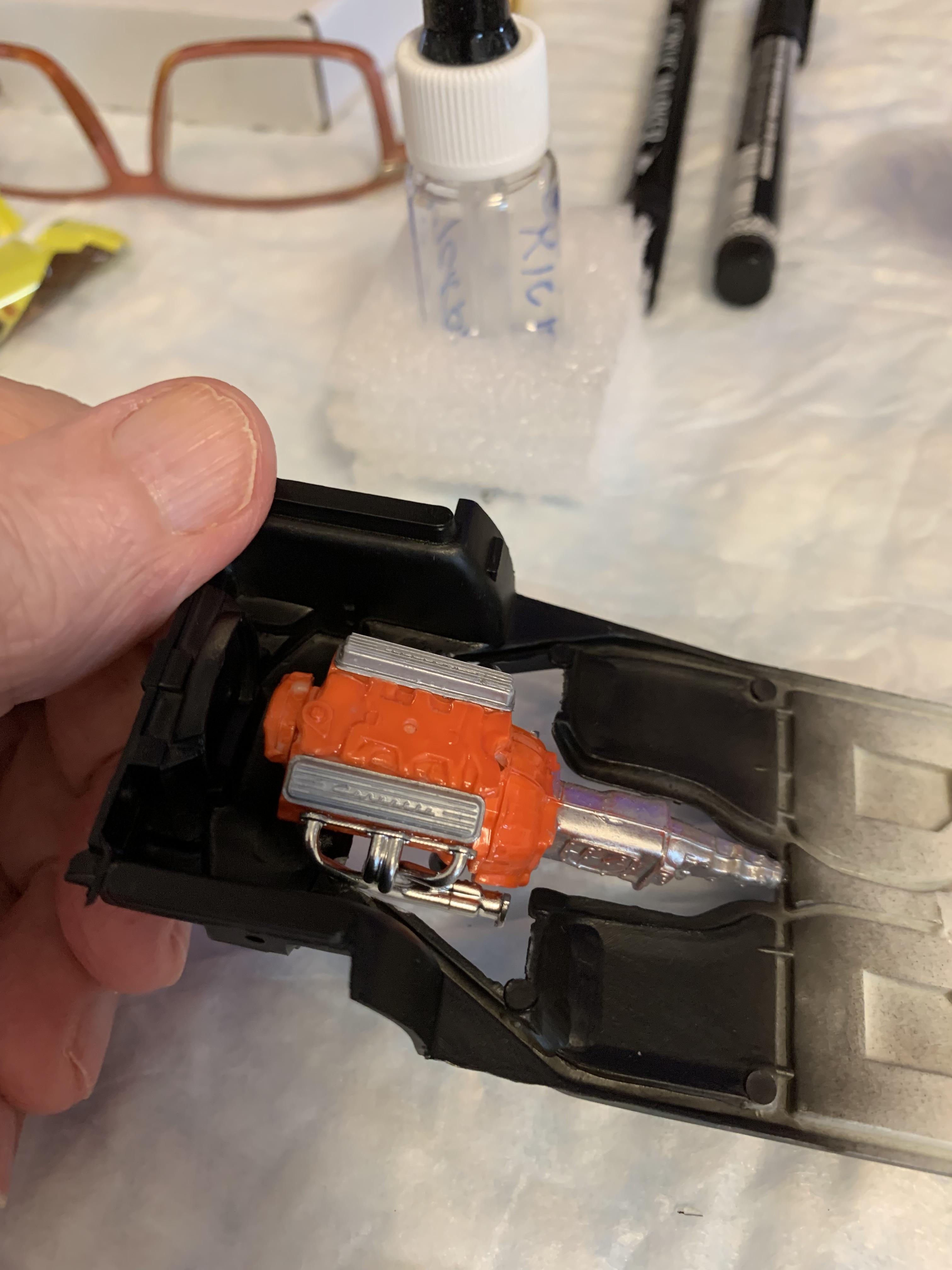

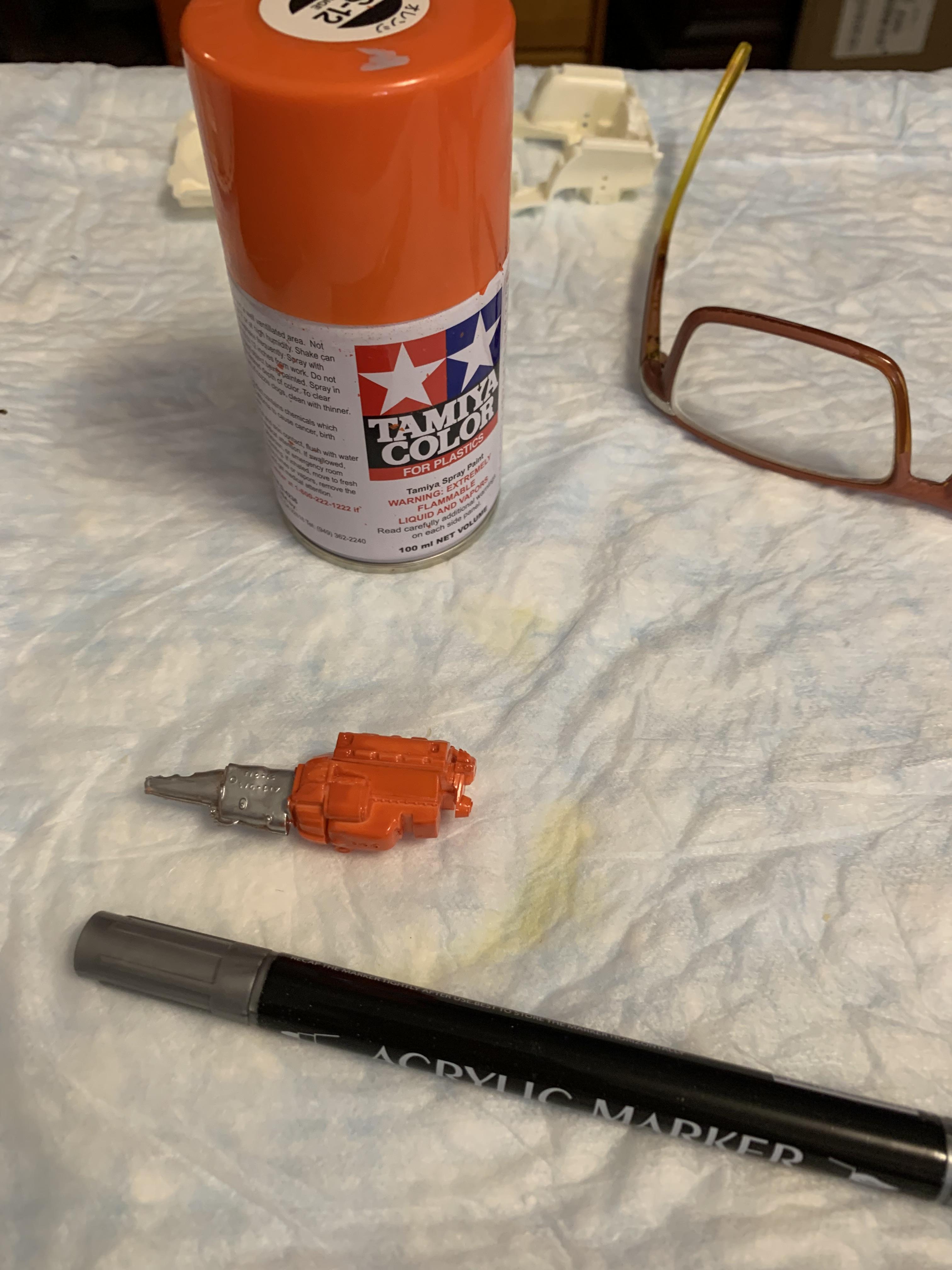

I hope so, Mike.  Not going to put a lot of time and money into this one.  Put a little Mr. Hobby clear on, looked at the chassis, and decided against trying to remove the exhaust system.  Not thrilled with the small block that came in the kit, but it will have to do.  Put some orange Tamiya on, then a silver marker on the trans.

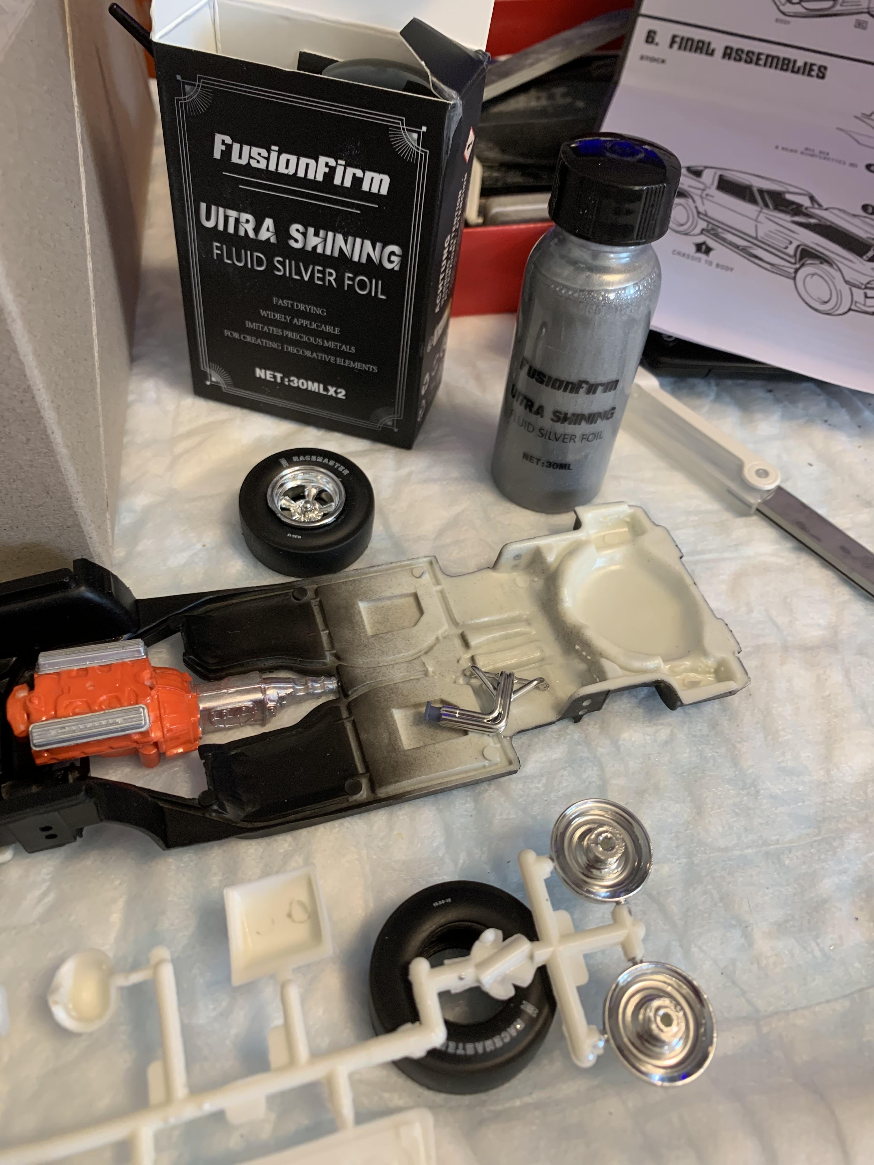

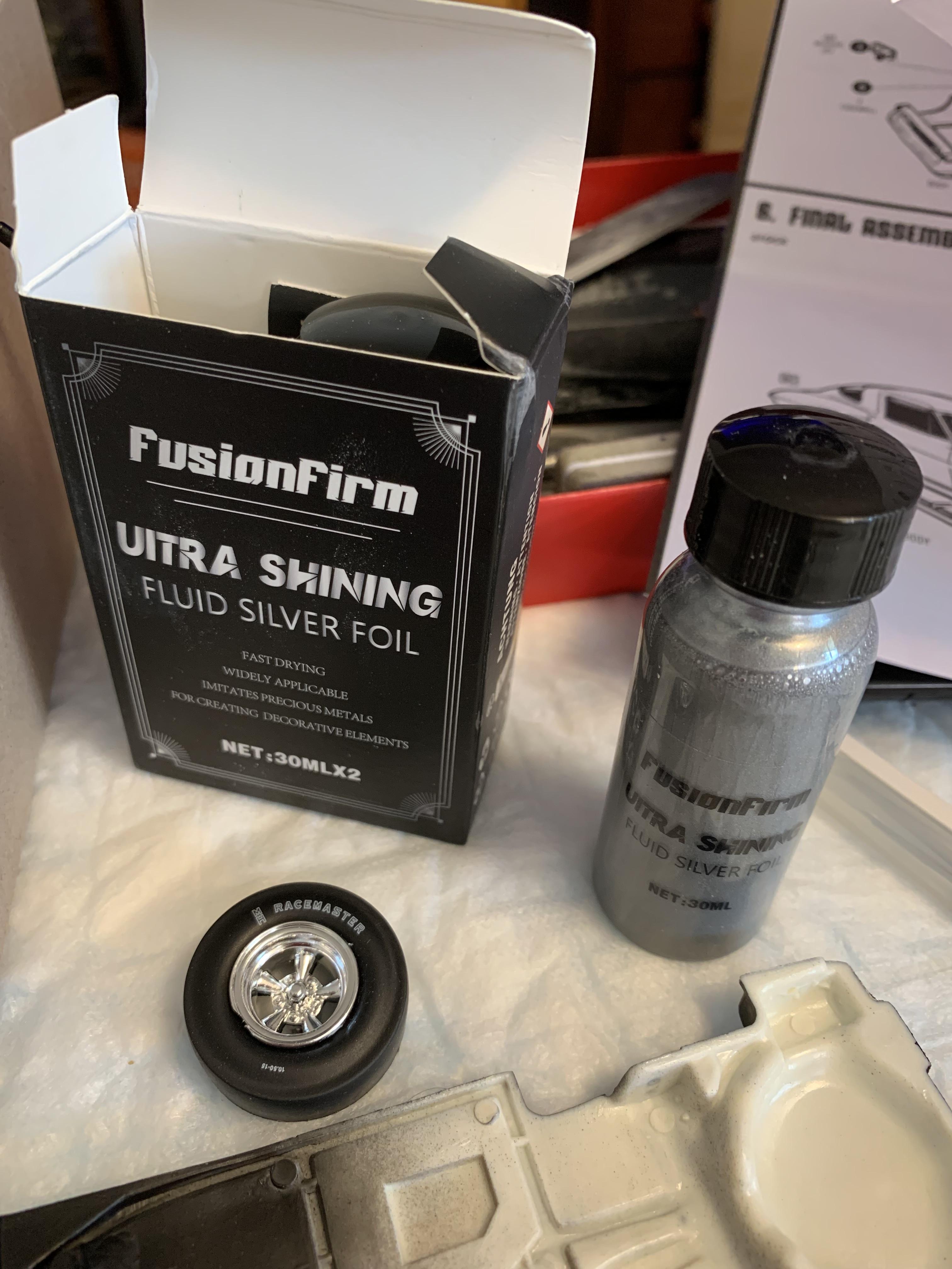

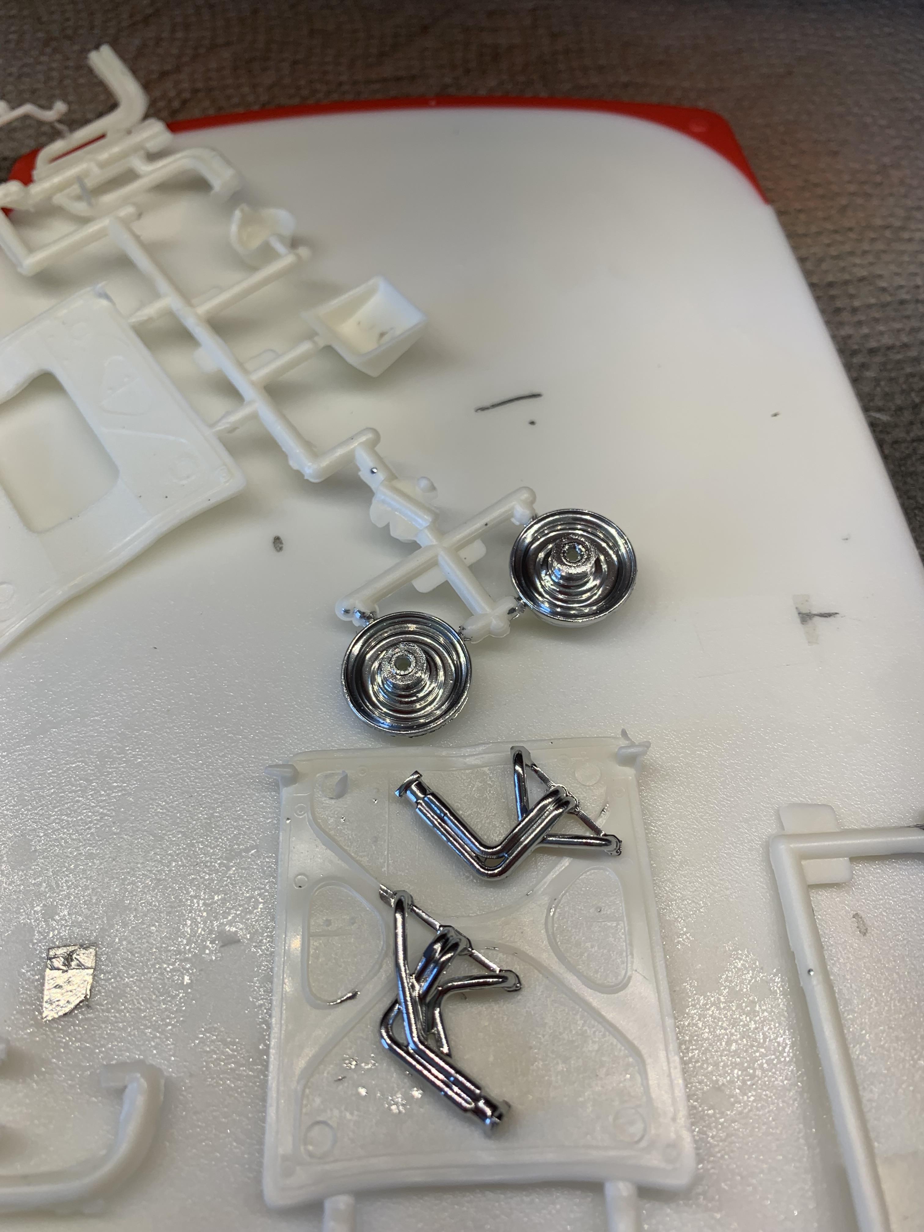

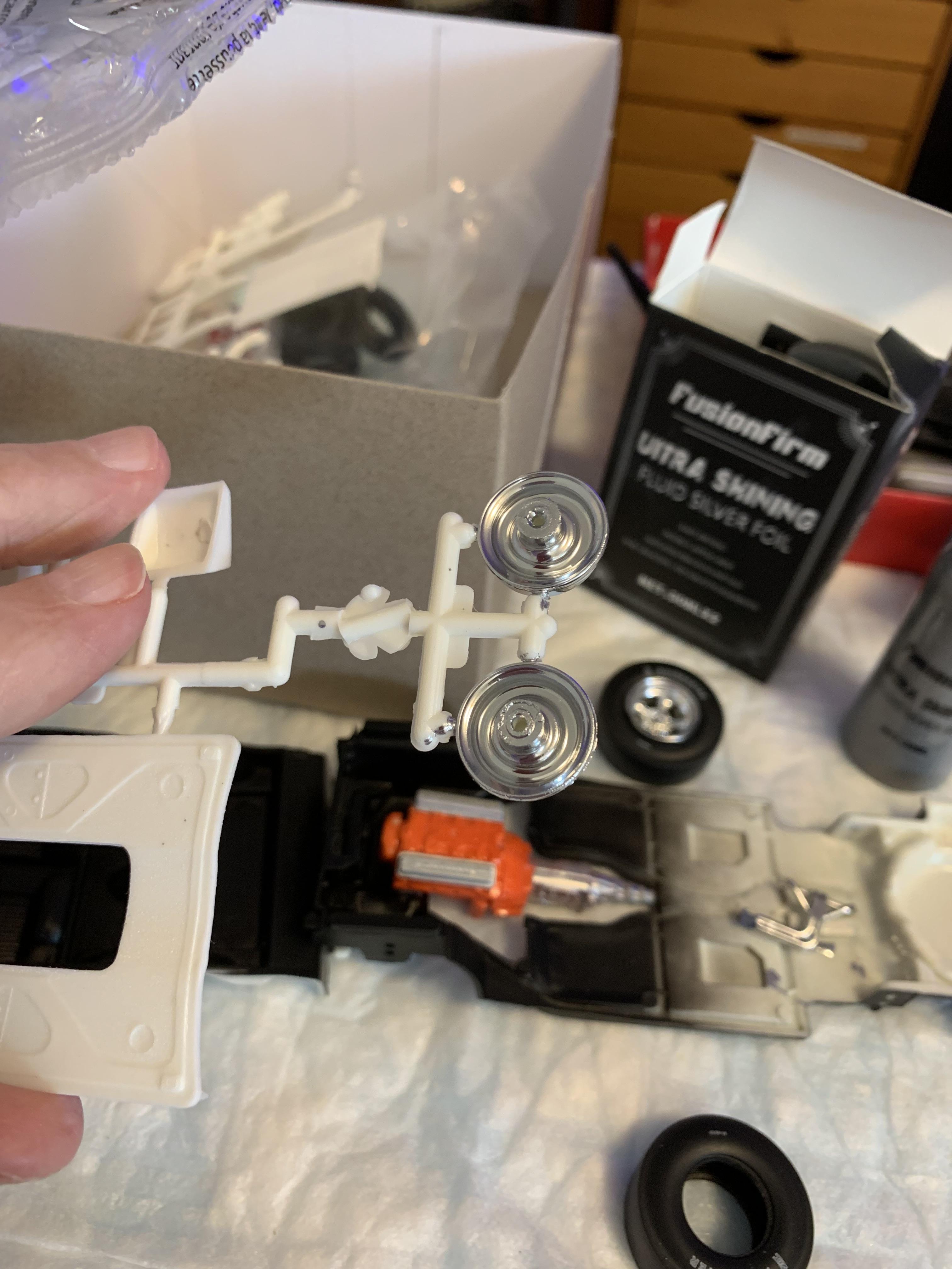

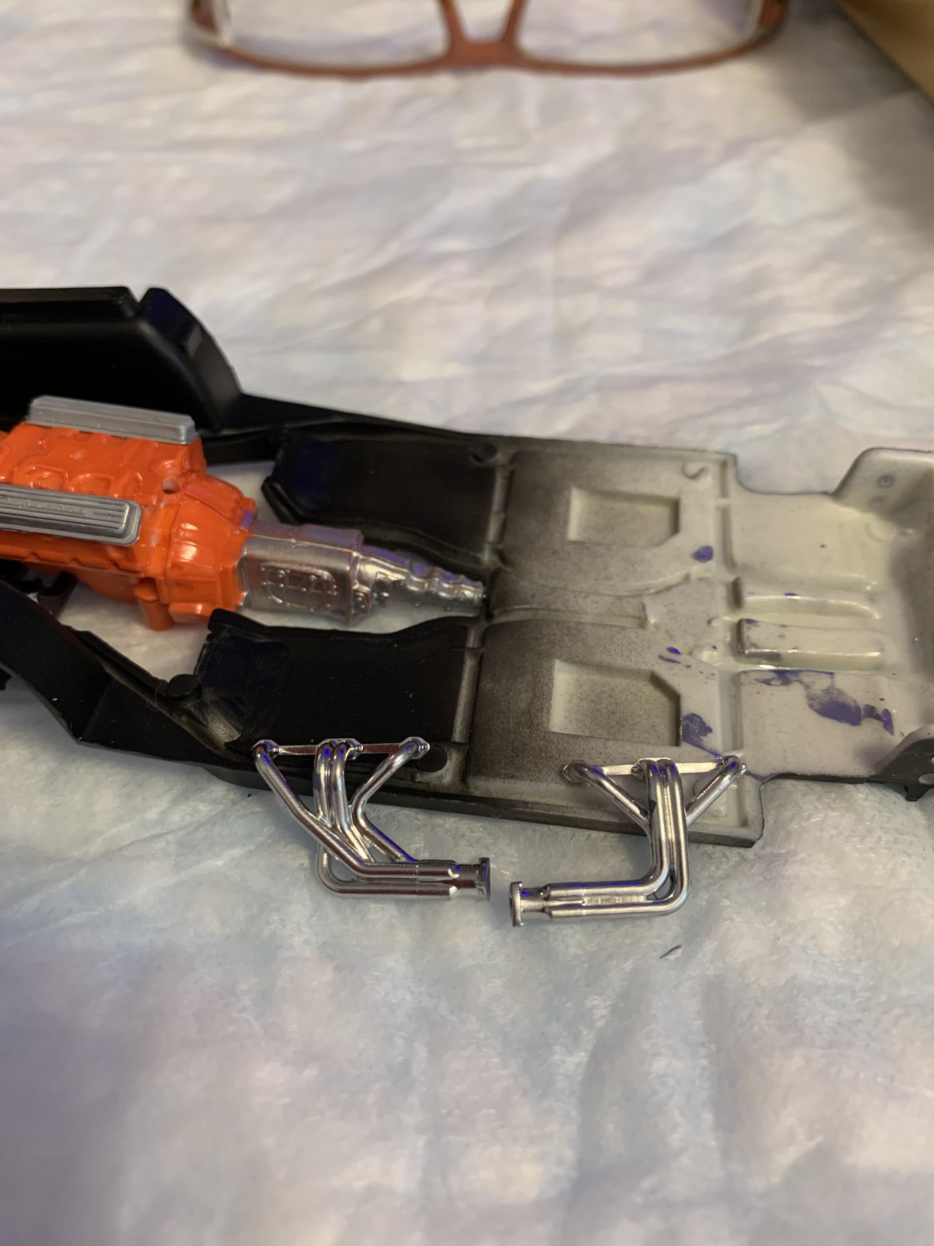

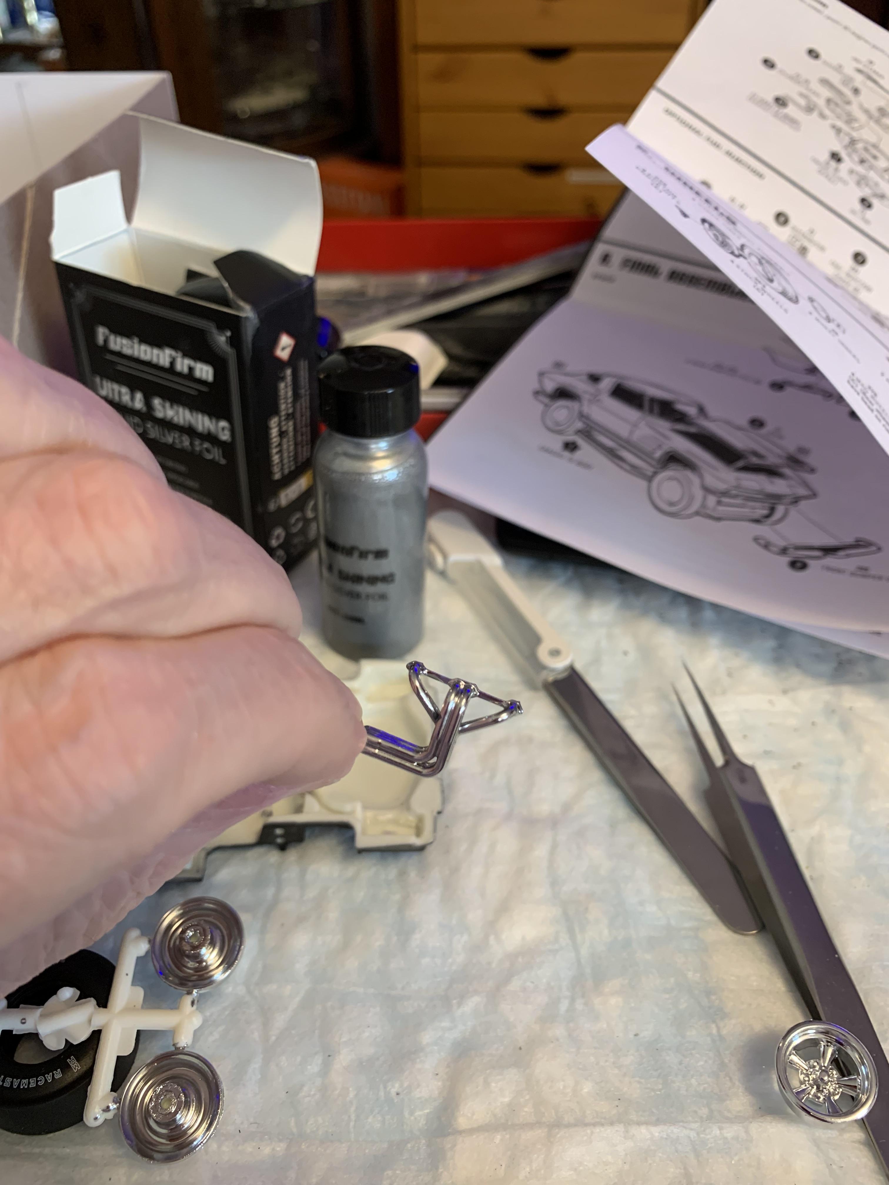

Thanks, Mike.  Back after a lull.  Some engine work and trimmed the frame for some vcgresins Hooker Headers after experimenting (there’s that word again) with some Fusionfirm chrome.  The brush came with it as did some clear (didn’t try that).  Very impressive stuff.

Mike, I got it on July 2 from Amazon, but it is not currently available.  Wait a few days, but be careful, as they will try to sell you the gold instead of the liquid silver leaf.

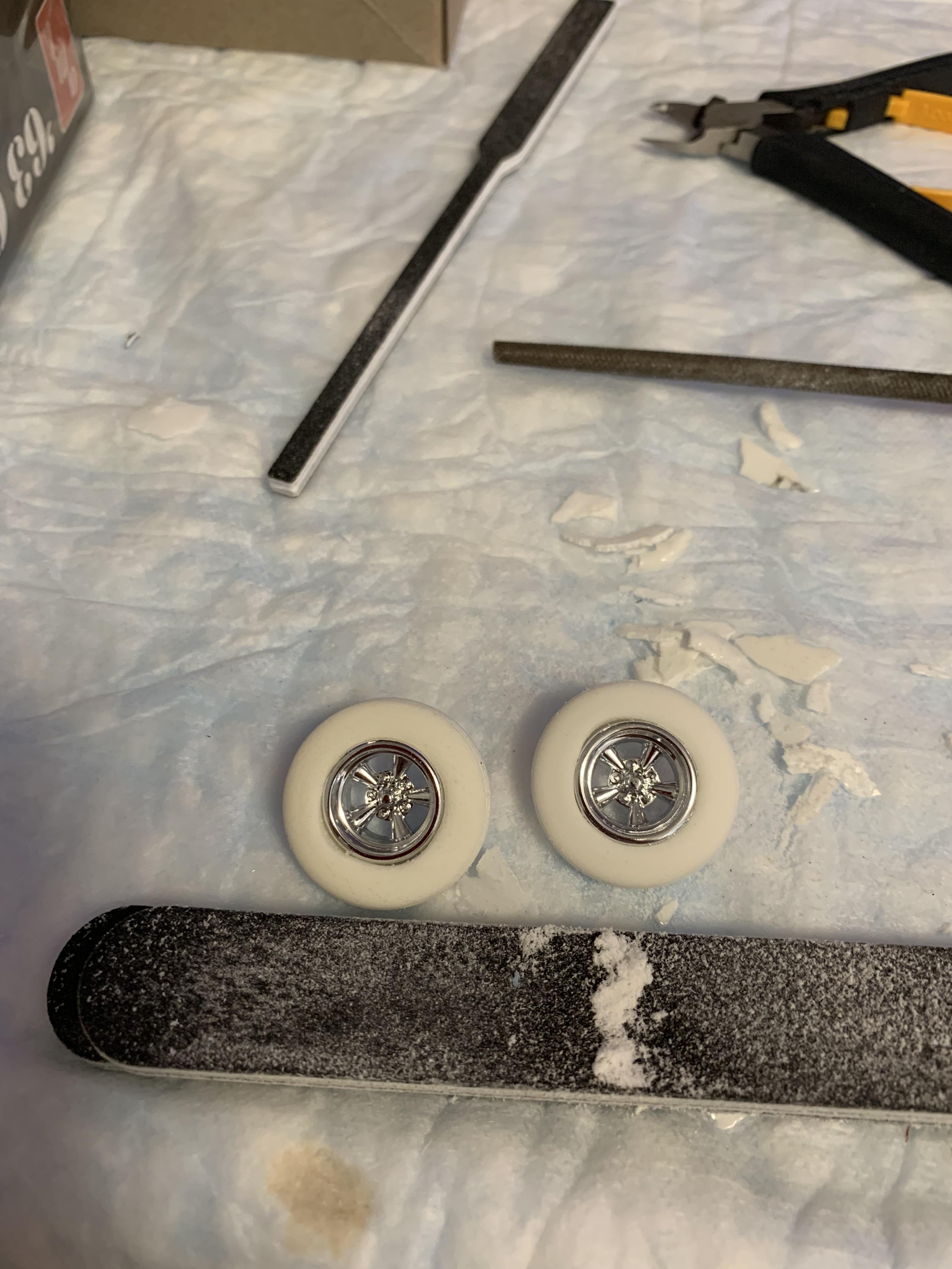

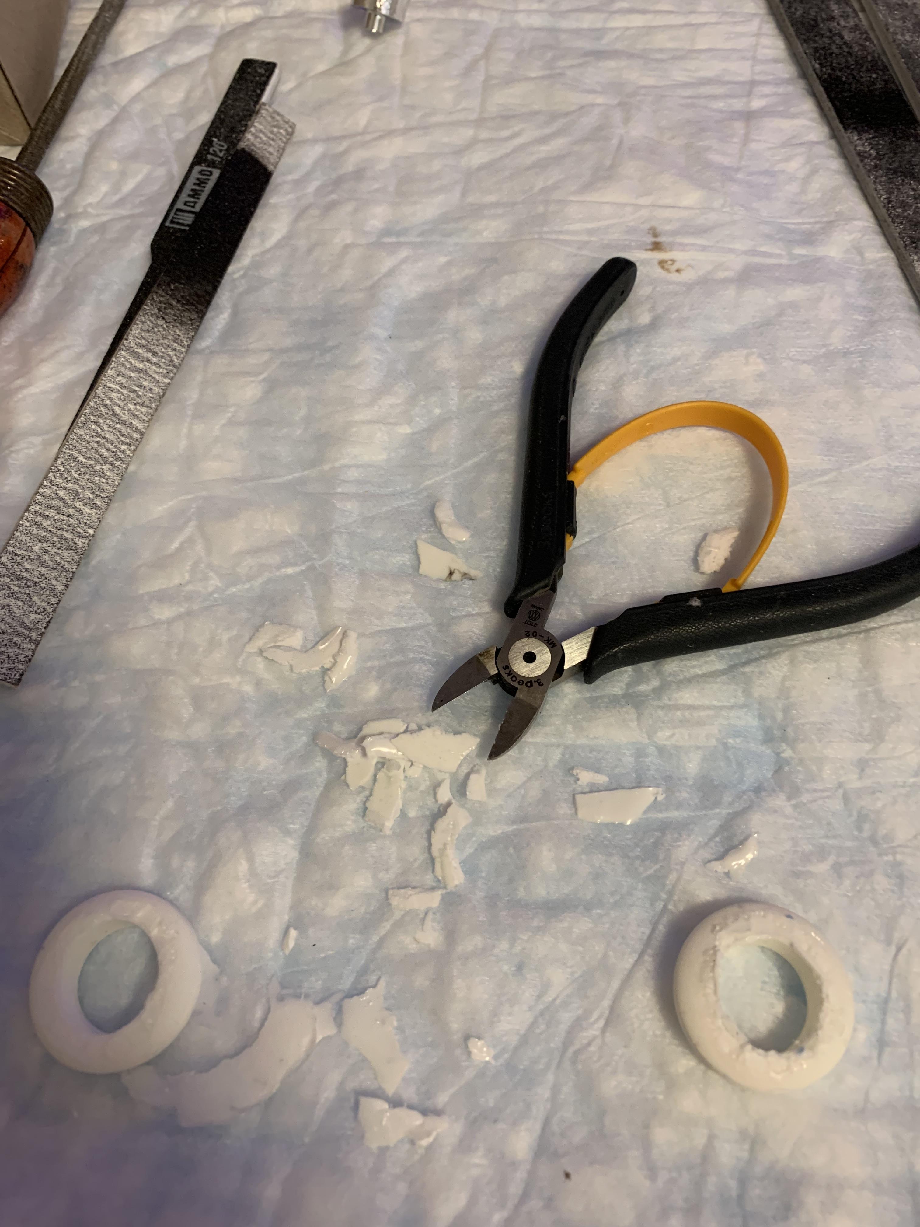

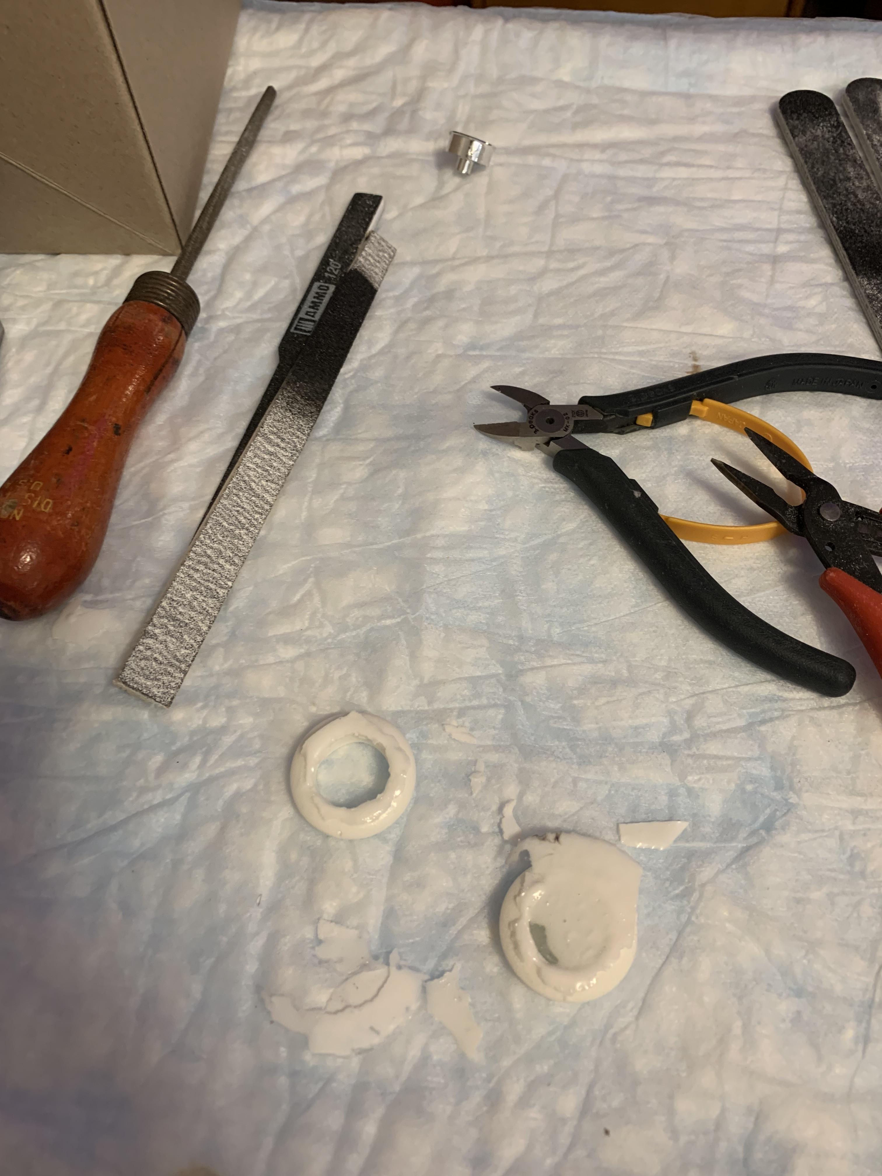

Clipped and sanded some front tires I made and cast with no sidewall markings.  Decided to use the wheels and rear tires that come in the kit.  Next is rubber black paint.  Will post pics tomorrow.

Thanks for the heads-up on the liquid chrome. That really is impressive.

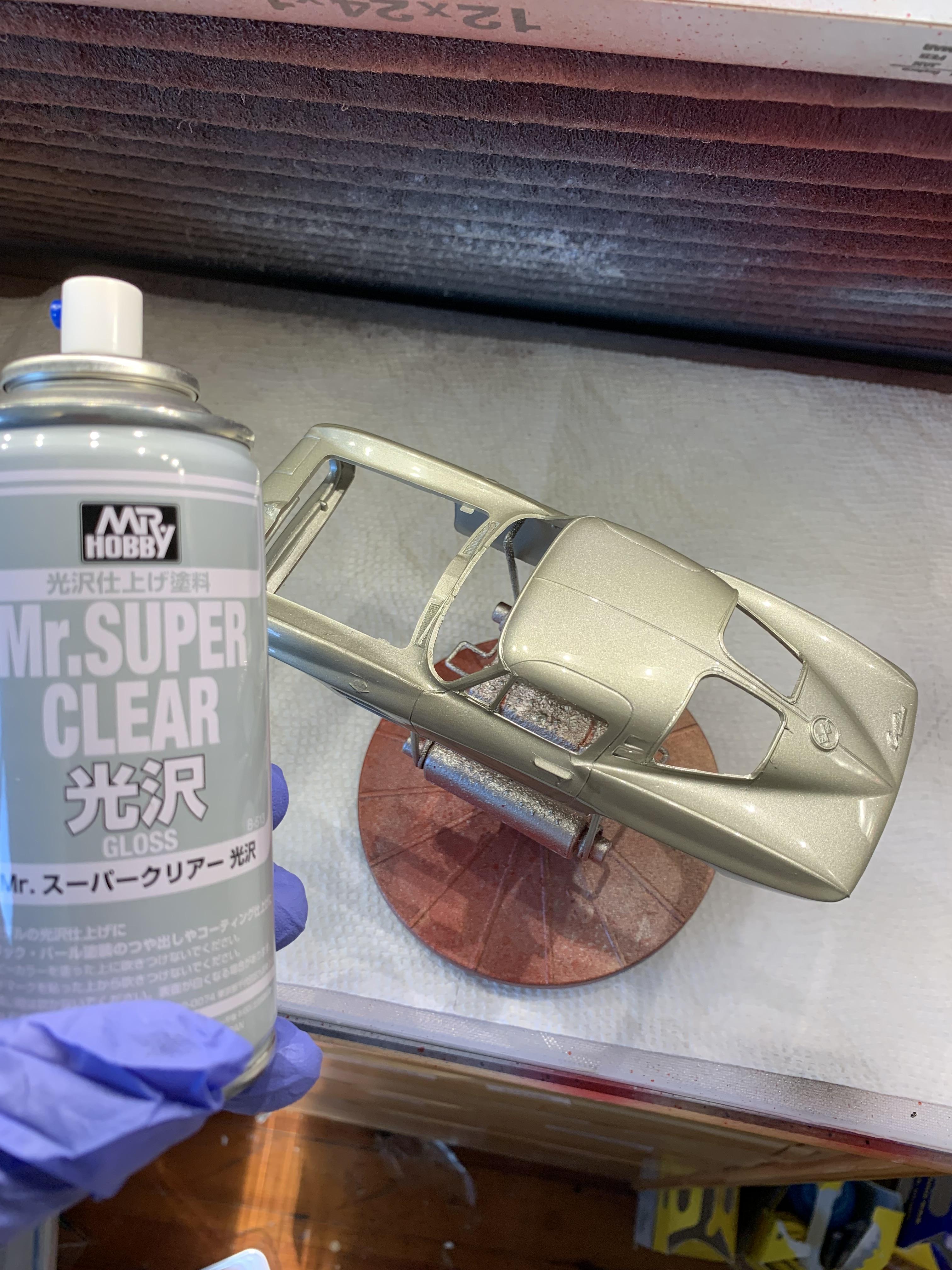

Well, after painting the cast tires, didn’t like the looks of them.  So, dug some out of the parts box.  Then, shortened the metal axles and trial fit the tires and wheels.  Also, was going to use the slicks that came in the box, but, not enough clearance, so went with my normal Stocker (9”) Goodyear tires.  Blackened the blue streak.  There wasn’t enough gloss on the paint, so put a couple medium coats of Mr. Super Clear on.

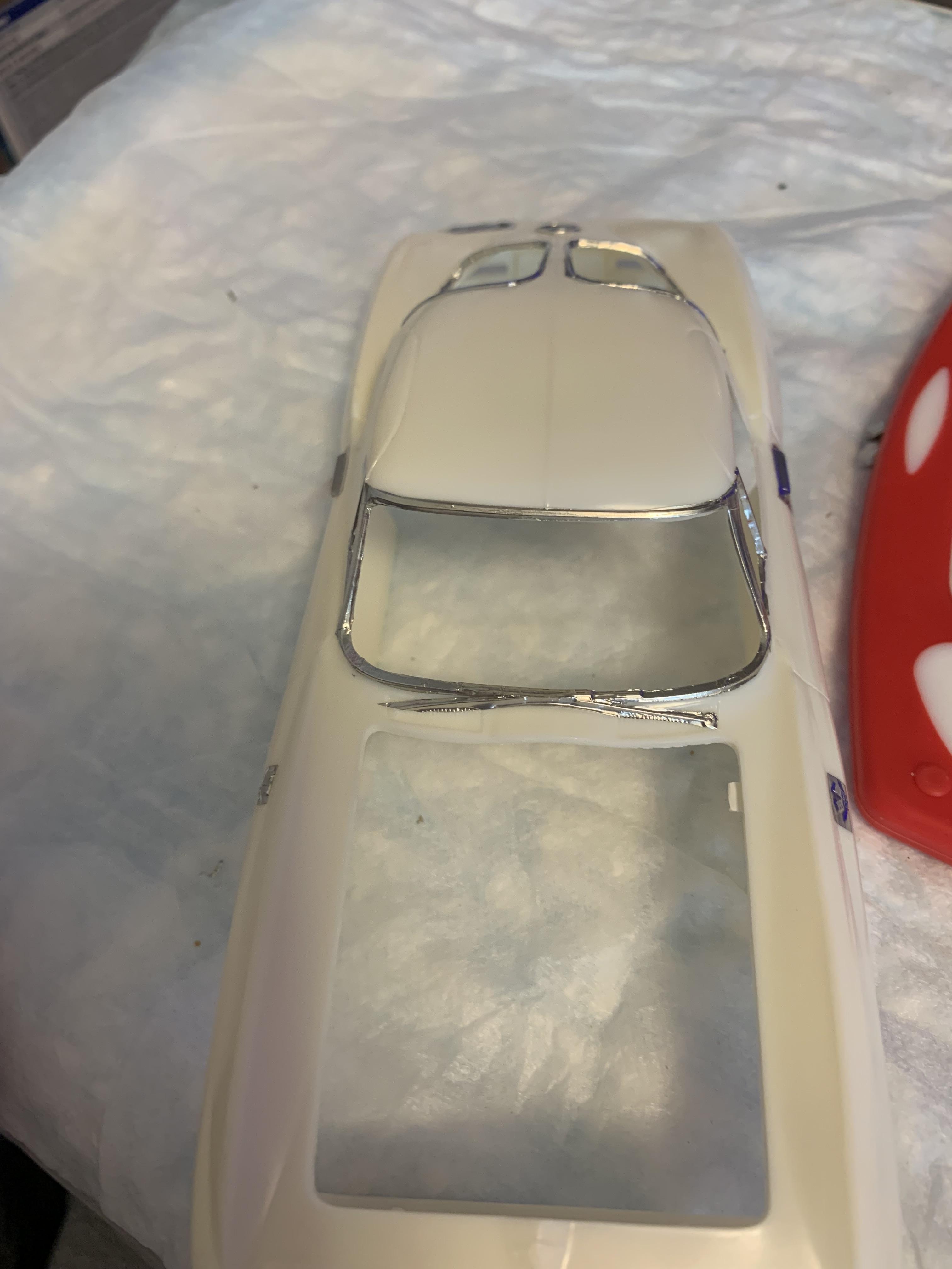

Then spent some time (too much) removing the paint off the bmf on the windshield, back glass and emblems with lacquer thinner and various types of q-tips.  The soft tapered ones worked the best as I believe they retained the most thinner for gentle scrubbing.  Overall, applying foil before painting turned out ok, I guess.  Tried sanding it off with less than stellar results.  Probably hard to see the chrome with this color, anyway.

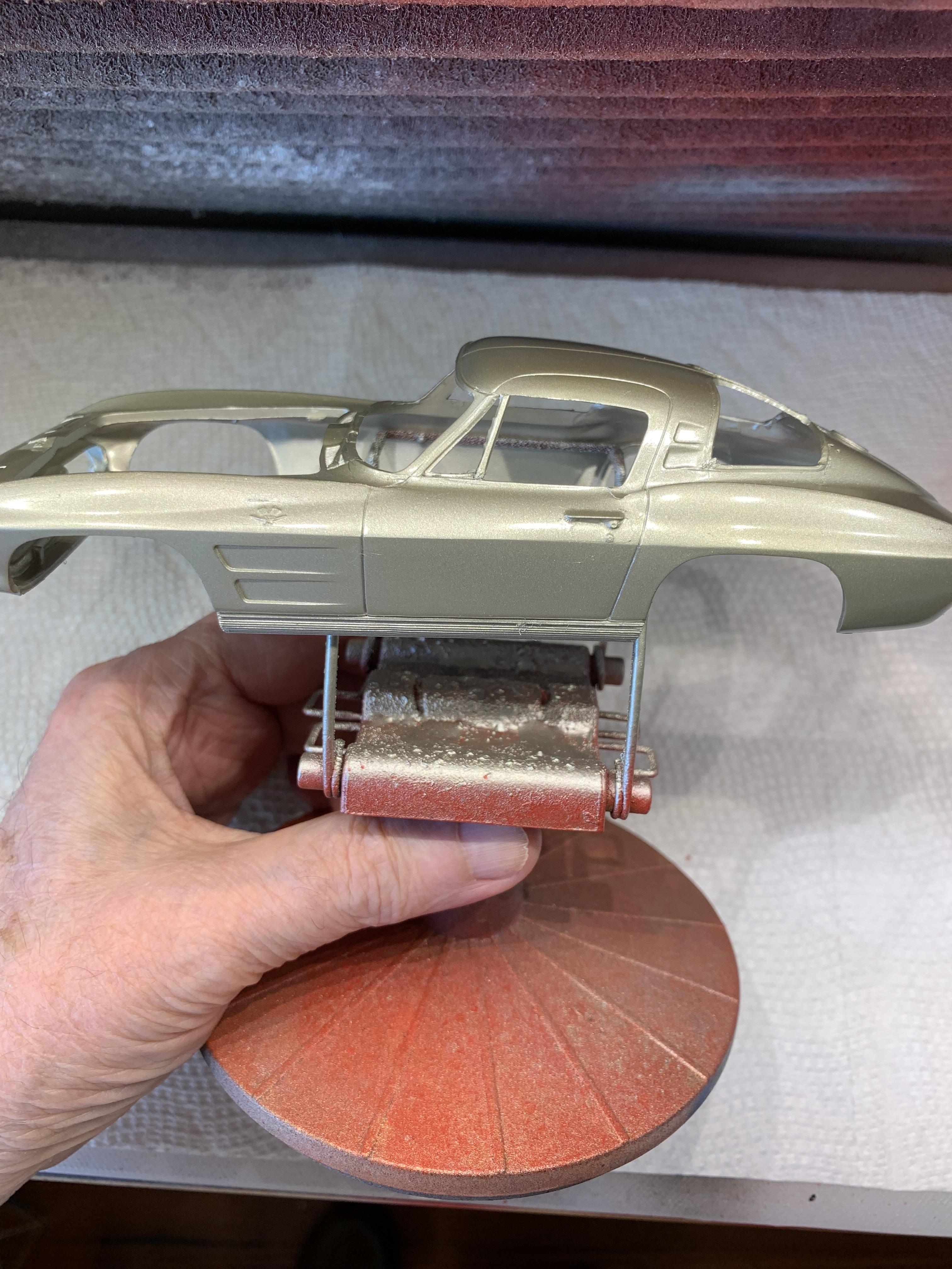

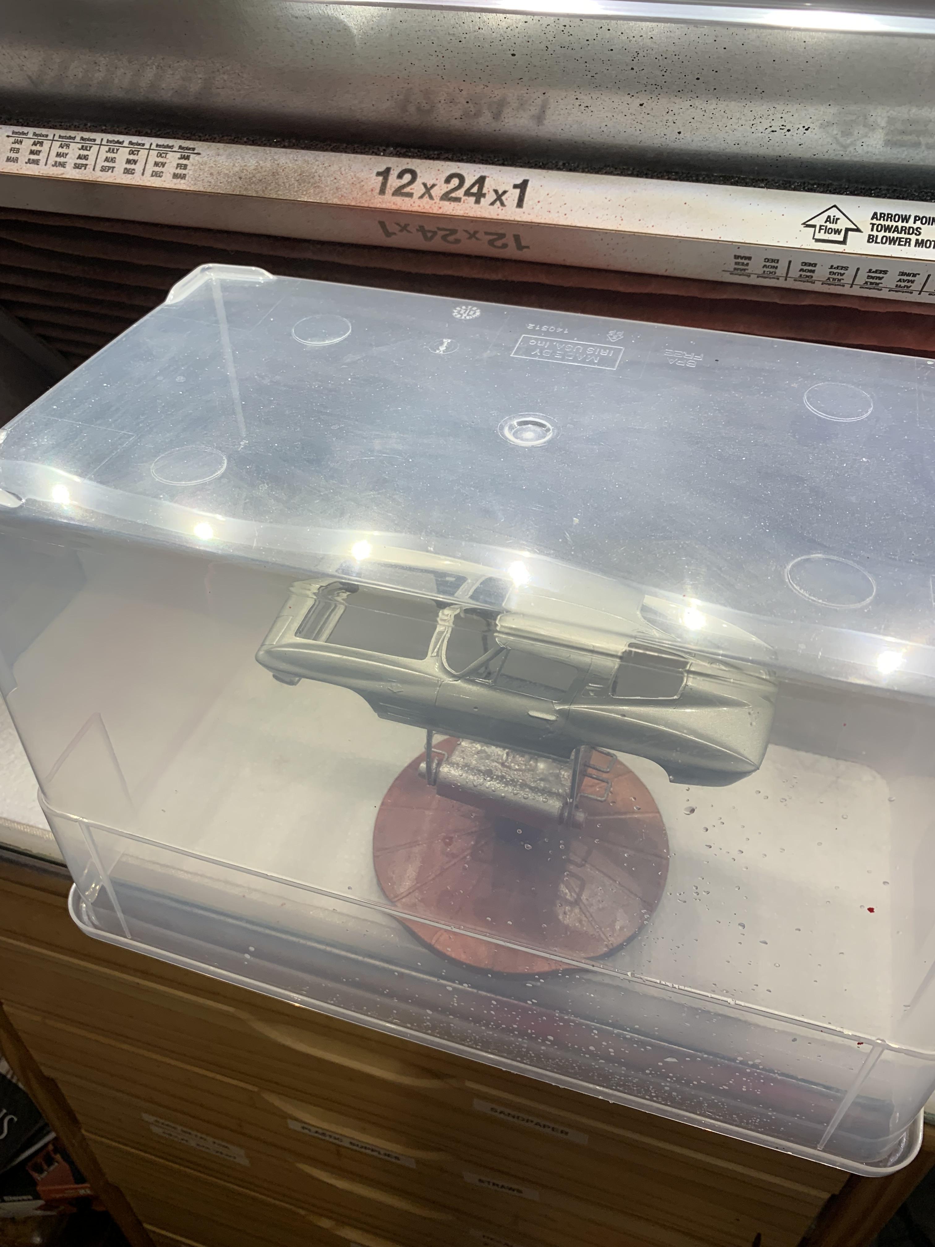

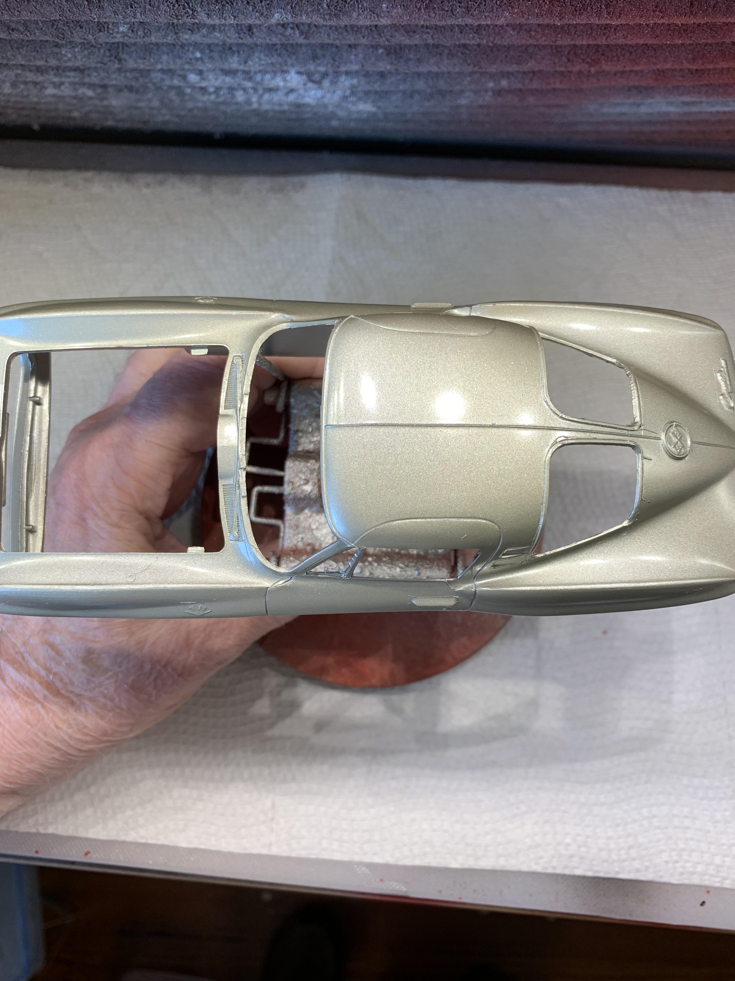

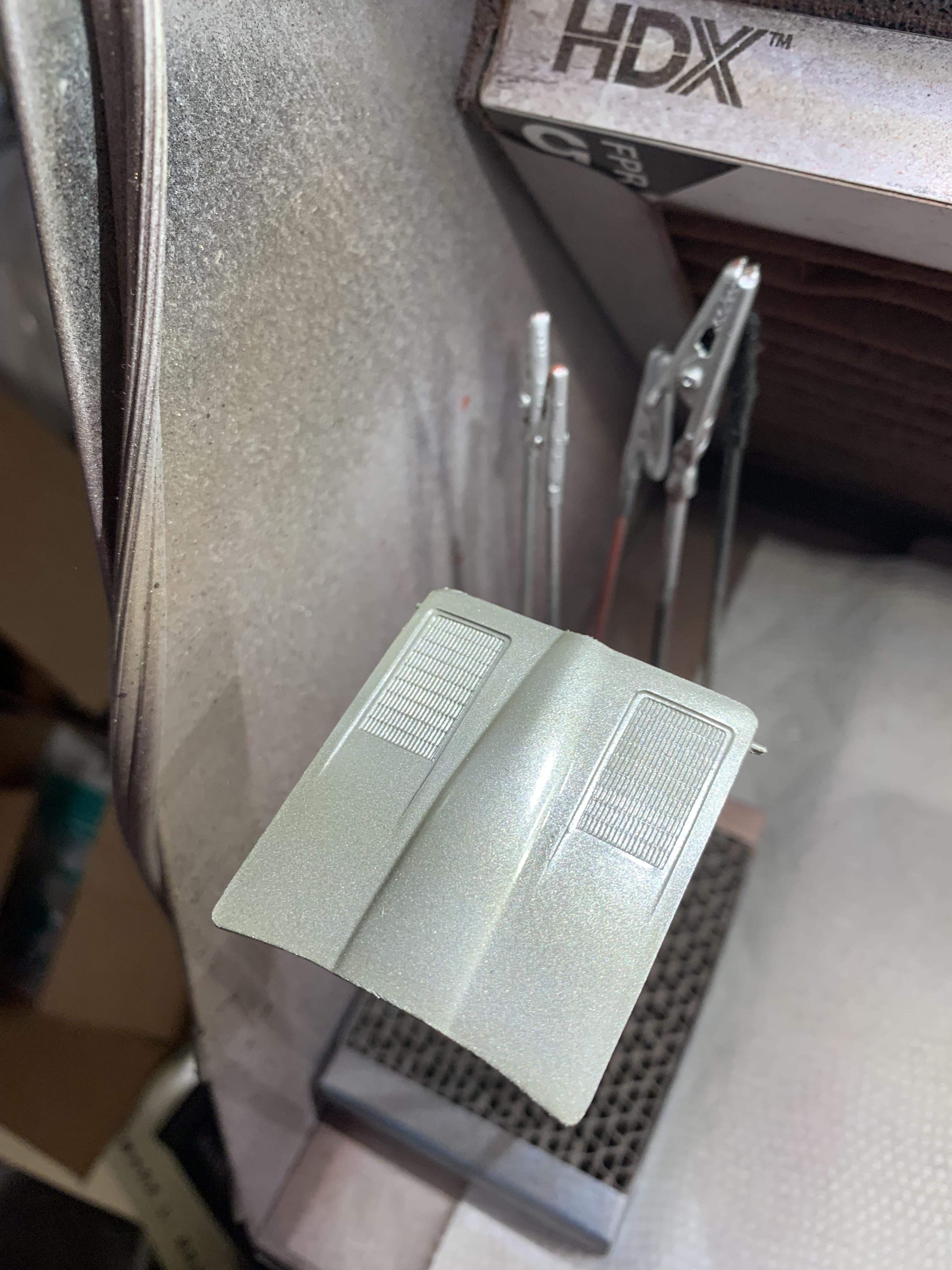

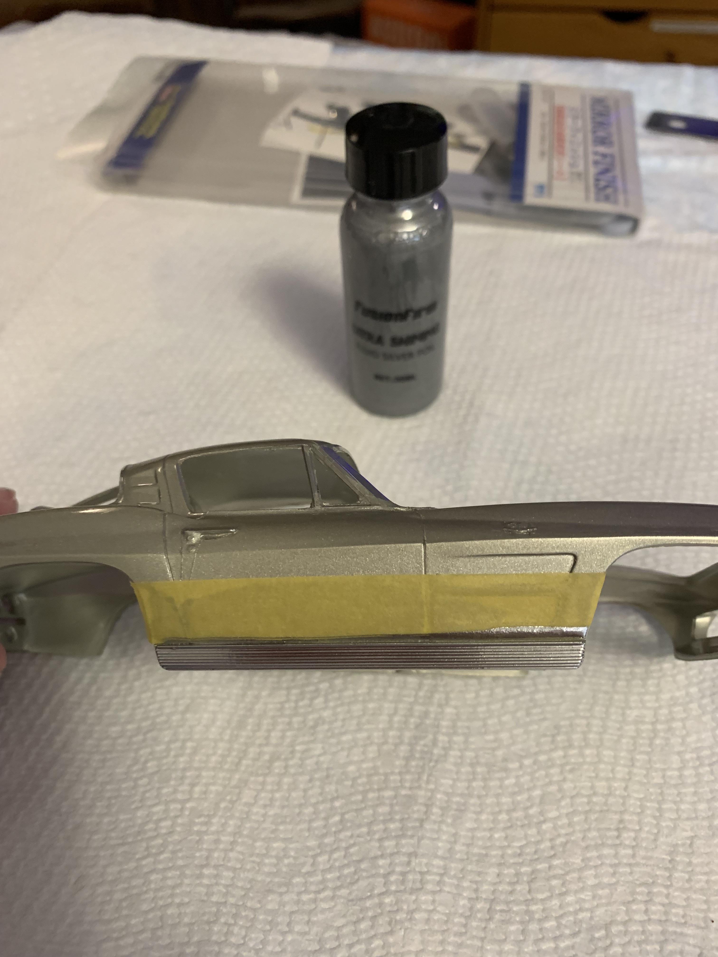

Masked off lower trim and put some Fusionfirm on it.  Took masking tape of after about 5 minutes.  Had one bleed thru at the door scribe.  Cleaned up with alcohol wipe.  Set body aside to dry.
  • Like 1
Have you test fit the body on the chassis? I dont know if its just a weird angle but that body looks pretty warped.  Might want to check that before you go any further.
First, I am always appreciative of suggestions, critiques, etc.  Yes, I have tested the fit a couple of times, but I will take a closer look tomorrow, as I don’t want to mess with the body much while the Fusionfirm is drying.  Thank you, Kevin.
  • Like 1
No problem, maybe its not warped but looks like the roof got a little smashed while in the box? I've seen alot of newer molded AMT/round 2 models that have been deformed from the way they were packed in the box.
Edited by keviiin86

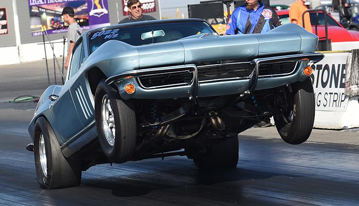

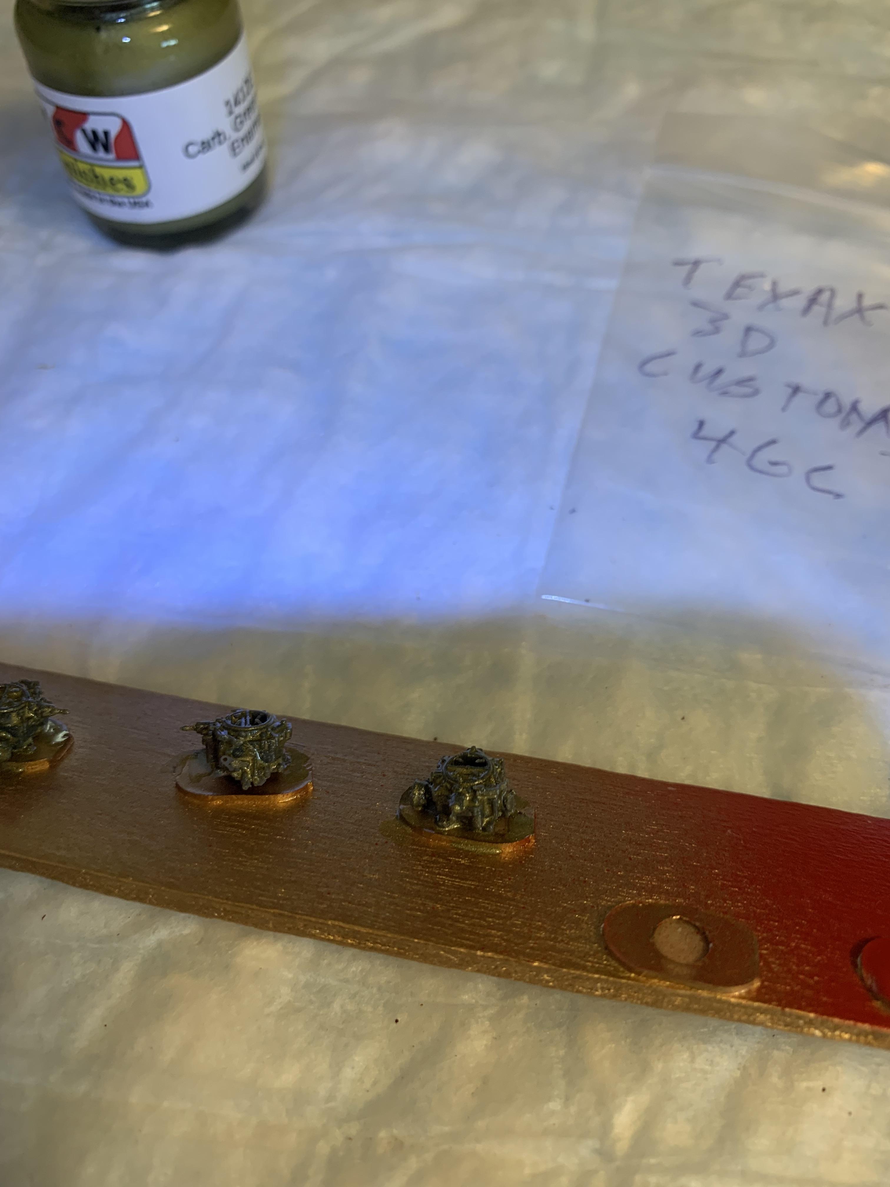

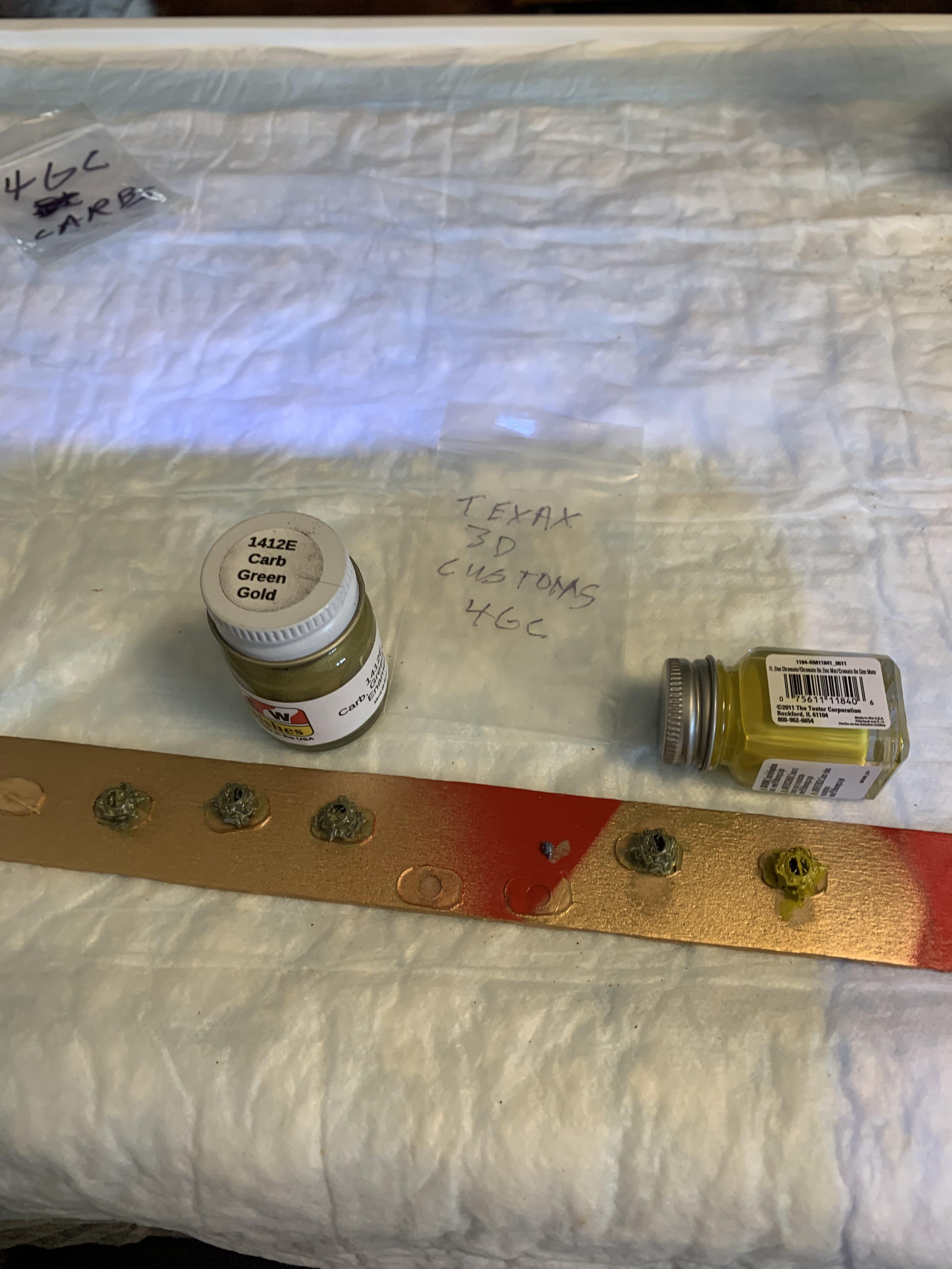

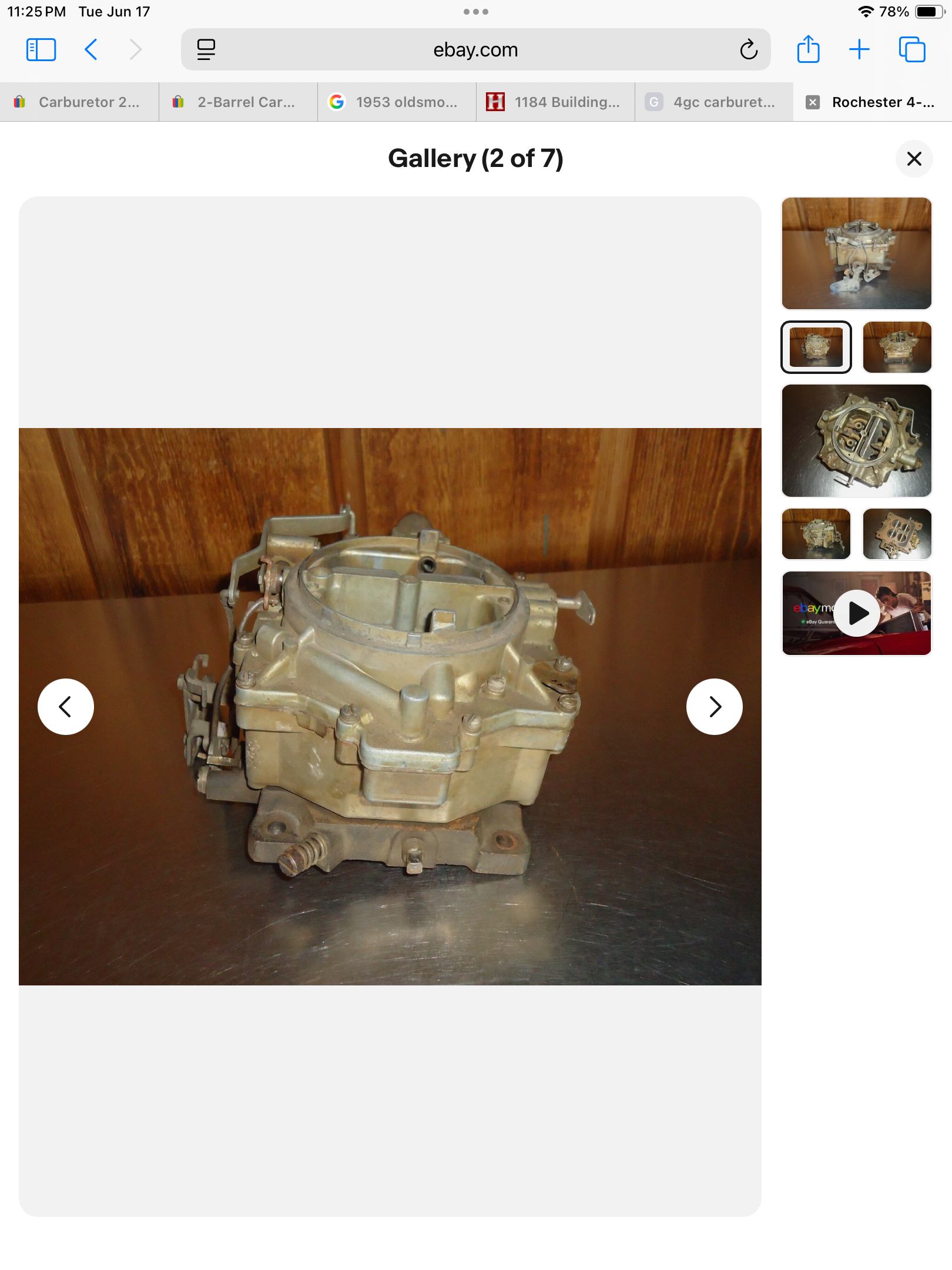

I had noticed that previously, but thanks.  Hopefully, the glass will fit ok.  Decided to go with the 4gc carb (250 h. P. ) , and painted a few extras.  Those Texas3dcustoms are spot on.  The testors zinc paint is a little to yellow, but the MCW is spot on.  A pic of the real thing.

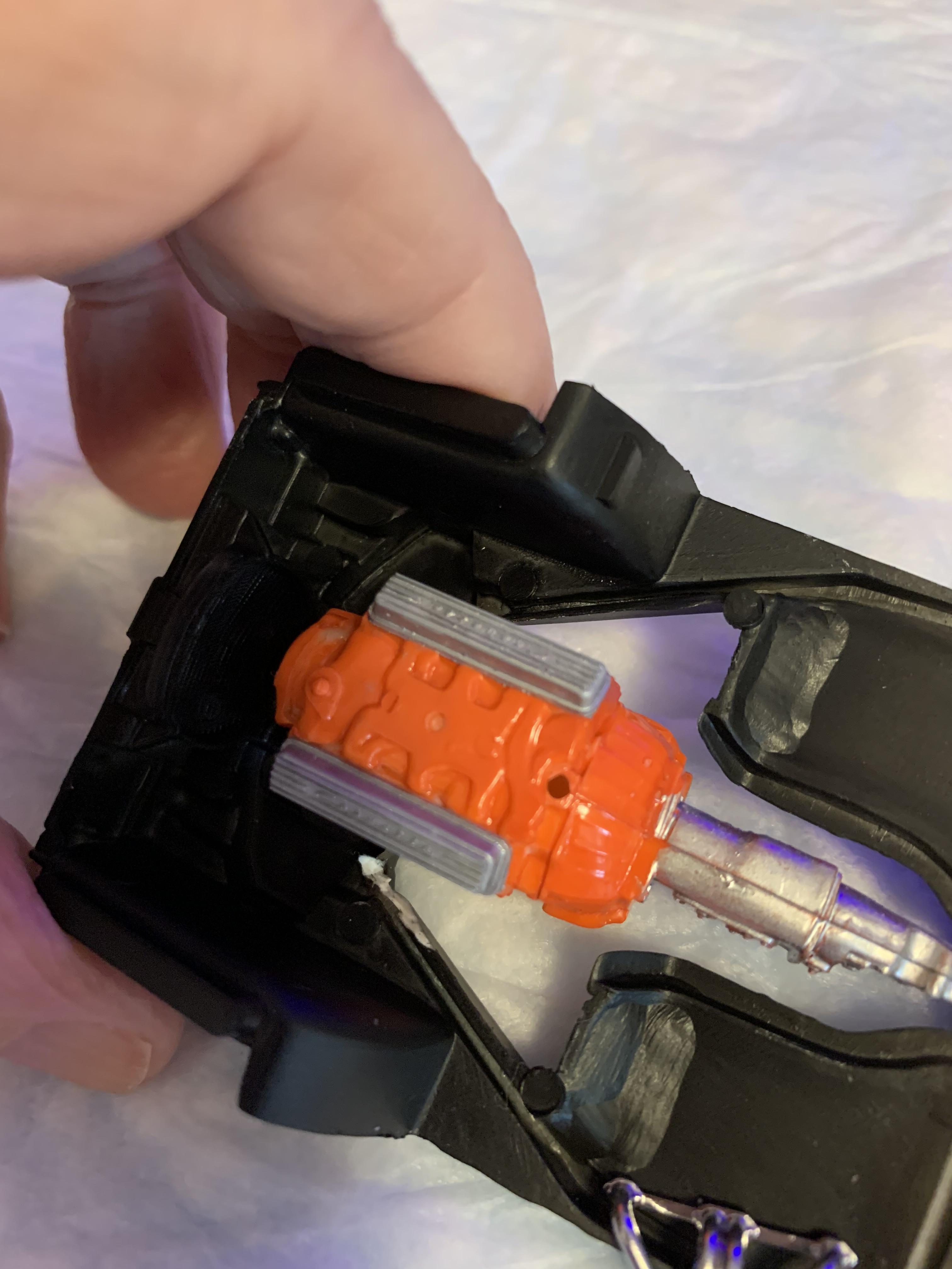

Am I indecisive or what?  Got some Afb carbs from mcvproducts, painted with ts30 Tamiya, and made a spacer to install it instead of the Rochester 4gc.  This will make the engine a 340 hp instead of the 250 hp 4gc version.  Anyway, used markers to paint the distributor and tach.   Obviously, this is not one of my more detailed builds, as there are no roll bar, harness, plug wires, more correct wheels, electric water pump, etc.  Oh yeah, the chassis is less than average, too.  Although, by nature, I am allergic to inauthenticity, sometimes you just have to coast along.
