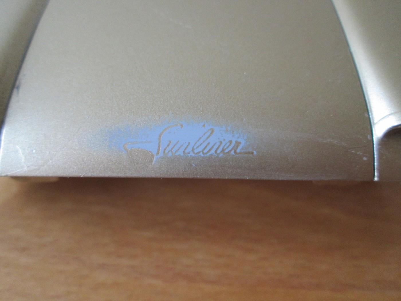

"Ghosting" is a common phenomenon caused by differences in the density of the plastic from the injection molding process:
As the molten plastic cools from the outside, microscopic pores form towards the centre of the part. By trimming/sanding off bodywork details, you expose material that was originally further from the outer surface and thus more porous/vulnerable to solvents in the paint than the immediate surrounding area.
By giving the area a gentle wash of liquid cement you essentially saturate the porous plastic with solvent and binders, causing a controlled "collapse" of the area prior to paint. This allows you to fill in any cavities left as the cement evaporates and sets. Always allow the plastic ample time to thoroughly dry and set before proceeding with the surface preparation and paint.
The severity of the ghosting varies a great deal depending on the type of plastic and the paint you use. Some automotive type lacquers contain highly volatile solvents, and in some cases ghosting can even happen on surfaces which have been thoroughly prepared:
Edit: These images illustrate one of the most extreme cases of ghosting I've ever experienced. The surface had been meticulously prepared, using the liquid cement method described above, and then left to cure for several months. However in this case the unusually "hot" solvents in the lacquer (Zero Paints automotive lacquer basecoat) were able to penetrate the primer and react with the brittle old sixties' plastic underneath.
