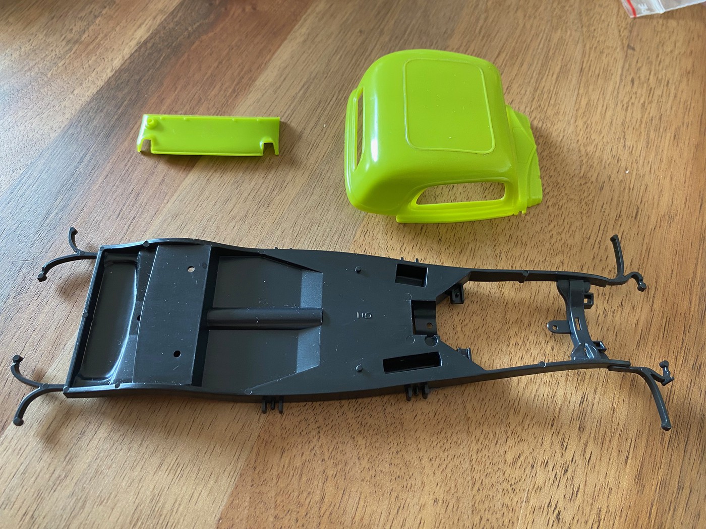

As some of you may know, all early issues of Monogram's 1934 Fords suffer from a mold-misalignment making the lower part of the body flush with the beltline molding. The issue wasn't corrected until the early eighties, when the tooling was altered into the ZZ Top "Eliminator". Thus I'm using one of the subsequent Thom Taylor '34 Cabriolet issues as donor for the main body, while the roof, rear filler panel and stock chassis with bumper brackets are from a seventies "Early Iron" Series '34 Ford Coupé:

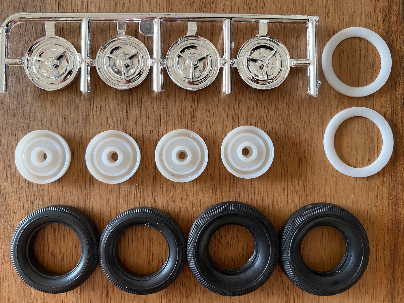

The rolling stock is mainly sourced from the Revell "Skip's Fiesta" Series issue of the 1959 Ford Fairline Skyliner, which features 1:24 scale Oldsmobile Fiesta hubcaps with Monogram's large whitewall tires originally found in the 1958 Ford Thunderbird and 1953/57 Corvettes:

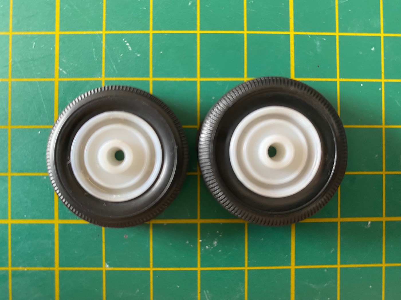

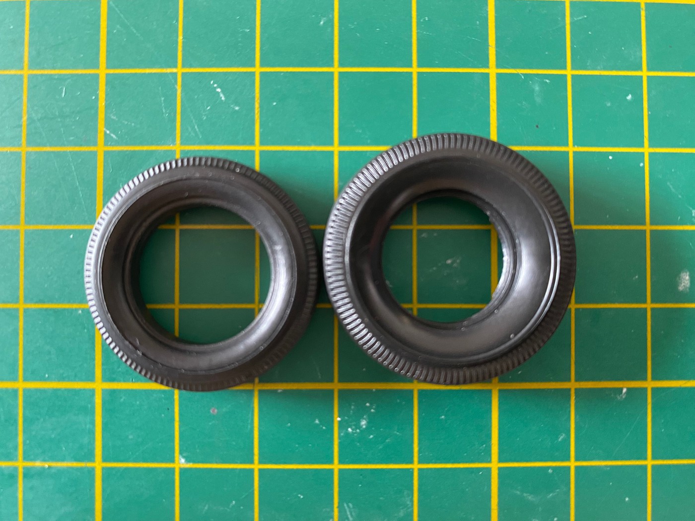

To add a bit of "Rubber Rake" I chose to use the smaller tires from the Lindberg reissues of Pyro's old Cord Convertible and Auburn Speedster kits up front, as the tread and sidewall detail closely matches that of the Monogram tires, only smaller:
As you can see, their inside diameter makes the smaller Lindberg tires an excellent fit for the large Revell/Monogram wheels, which can also be found in the more recent Revell-reissues of Monogram's 1958 Ford Thunderbird:

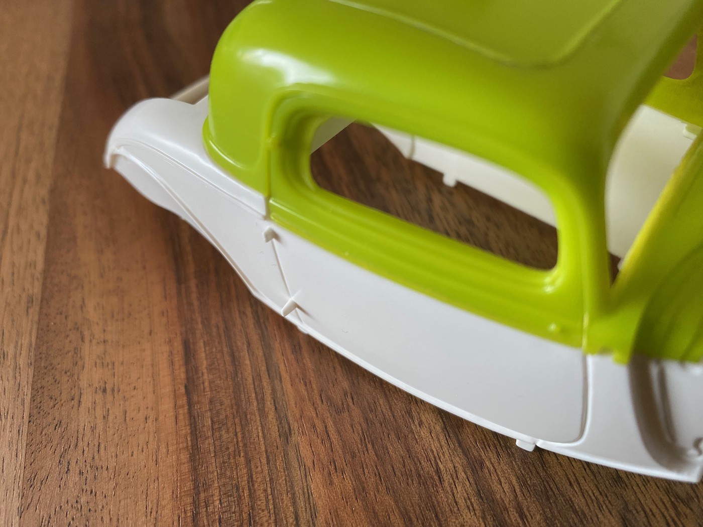

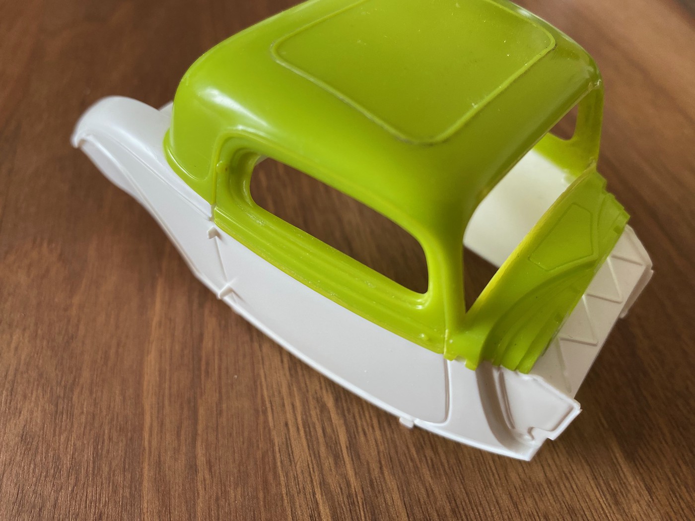

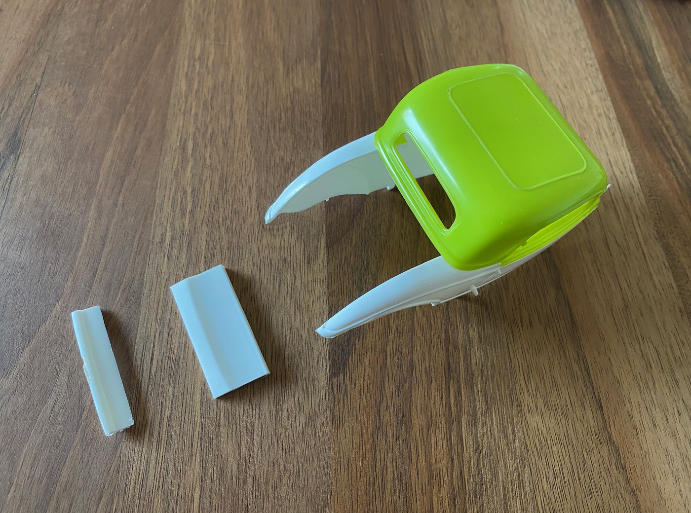

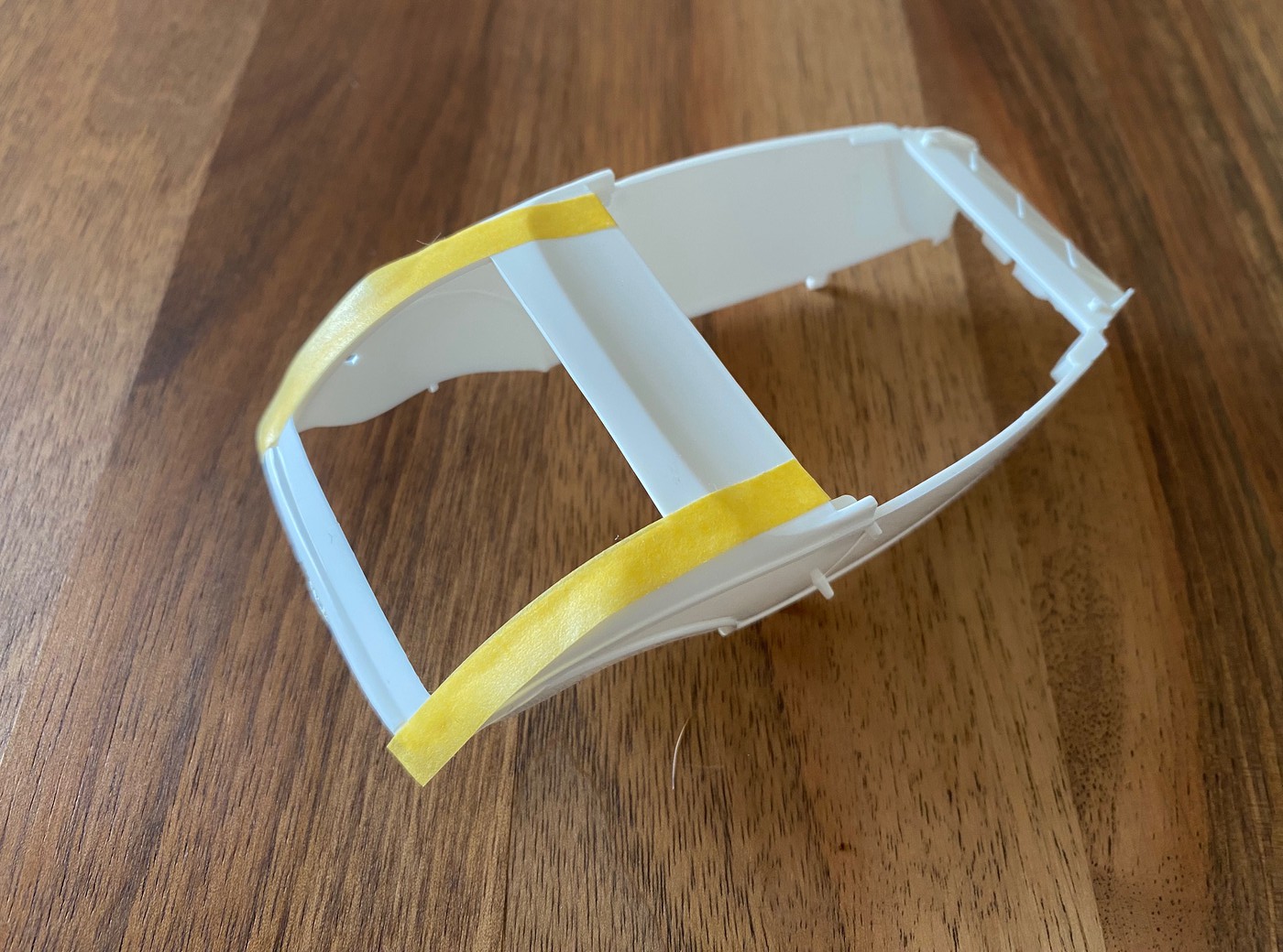

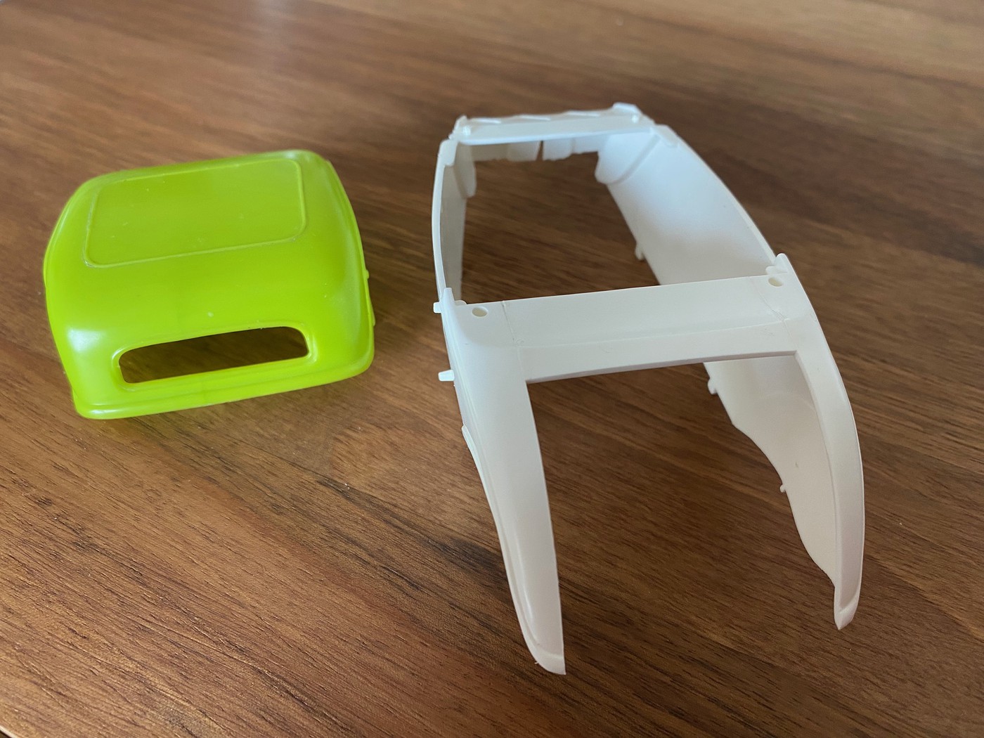

Another issue common to all versions of the '34 tooling is the difference between the main body and the door top/roof-assembly: The two pieces differ by more than a scale inch in width by the rear edge of the doors:
Luckily the solution is pretty straightforward: Cut out the center sections of the main body with a razor saw, making sure the cuts are perfectly parallel. Carefully sand the edges of the upper piece smooth, making sure to remove an even amount from each side and test fit along the way. Reinstall the upper piece. When the glue has set you repeat the procedure for the lower piece making sure to keep the corners in a right angle:
MUCH better:
  • Like 4

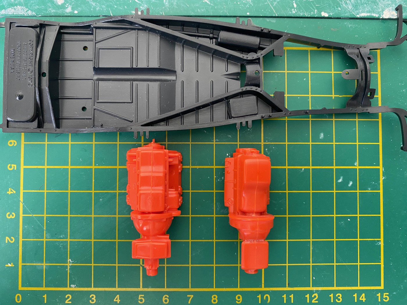

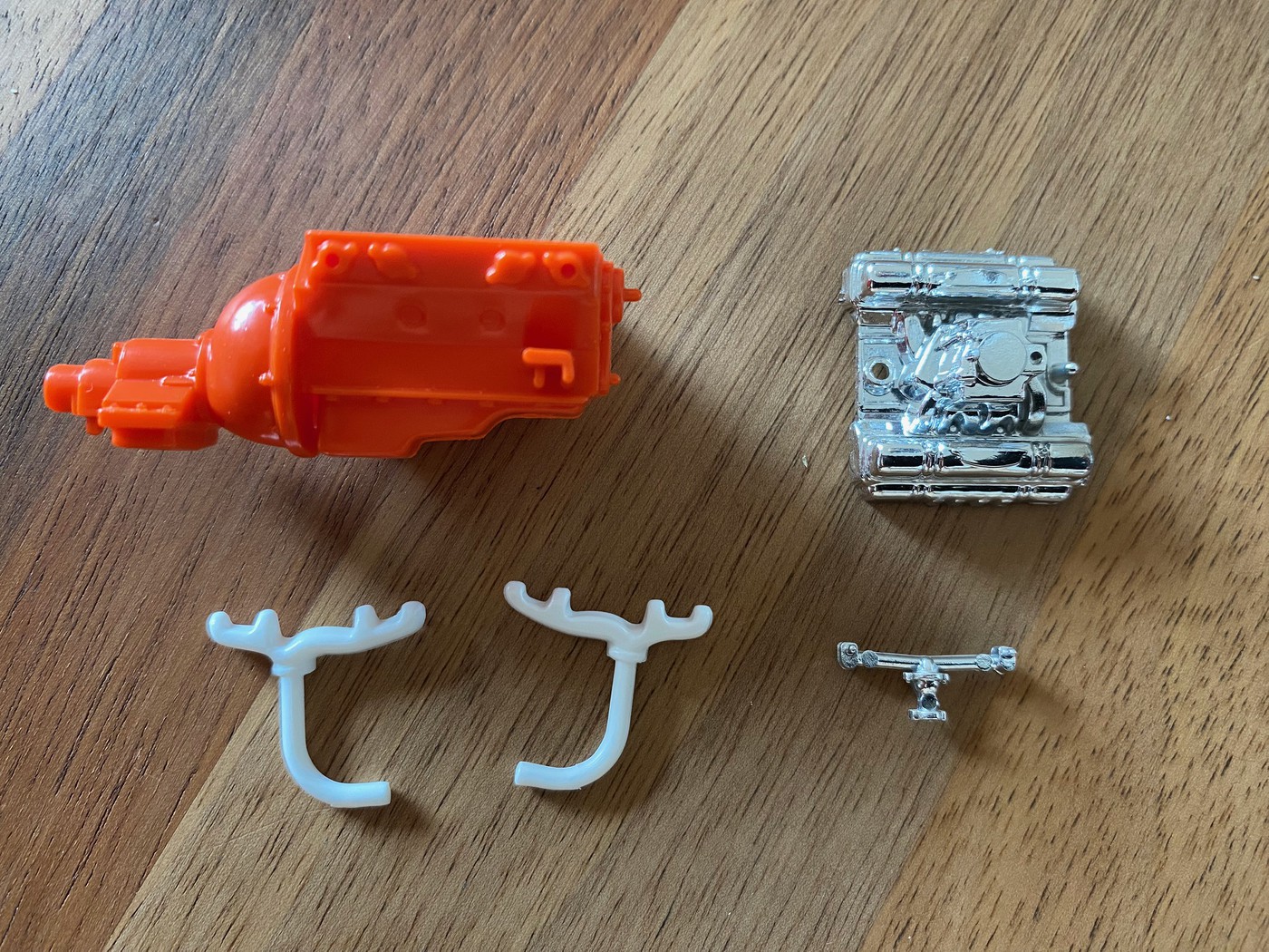

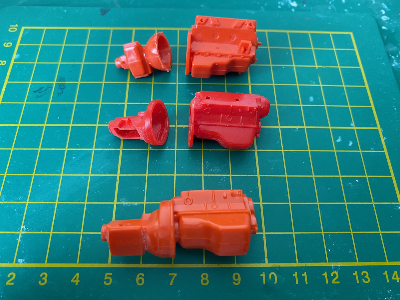

While waiting for the modified main bodywork to set, I started working on the engine. Now the Nailhead from Monogram's "Orange Hauler" kit is equipped with a bulky Buick Dynaflow transmission, which for one isn't very suitable for a proper Hot Rod and would require extensive modification of the frame crossmember to fit. Having eyeballed the engine from "Boot Hill Express" and "Predicta" kits (these engines are clearly based on the same master), I figured it could easily be re-worked to resemble a late thirties' Cadillac/LaSalle transmission, which would be perfect for the type of car I'm building.
"Orange Hauler" engine to the left, "Boot Hill Express" to the right:spacer.png
Off came the transmissions... As you can see, I carefully sanded the square transmission oil pan off of the red (Predicta) engine, before cutting off the bellhousing:spacer.png
The "Orange Hauler" Nailhead mated to the "Predicta" Transmission:spacer.png
I'm currently building a new transmission oil pan from various Evergreen strips.
