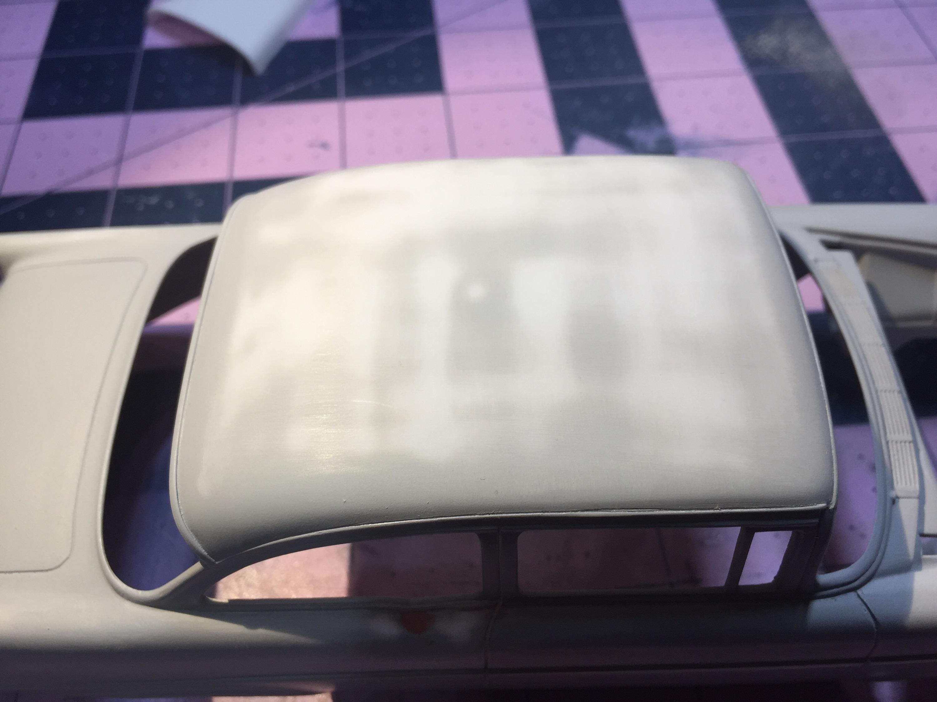

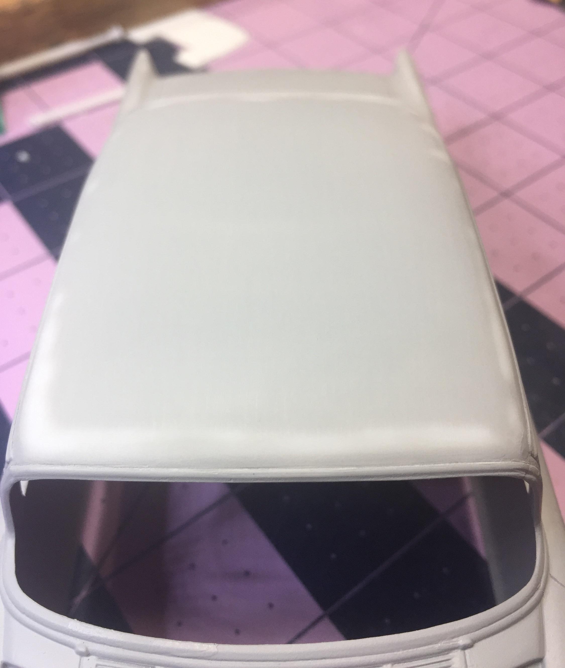

How is the roof on your kit ? I didn't notice that my kits roof was wavy until I applied the clear gloss varnish….
The waves on the outside followed the folds of the inside.
I checked my roof, Ulf, and yes, it is wavy. I still have a few more prime and sand operations to go so I think I can smooth it out. I don't think the depth of the low spots are any more than the thickness of two layers of paint.  Some block sanding should straighten it out.

A sanding job that really takes some effort. I actually bought a new kit and put in quite a bit of work, but played it safe with a matte gold flake on the roof.
I suppose that tactic can help to hide the distortion; gray primer hid it from me until you "opened my eyes" about the issue (and I'm grateful that you did.)  I will make the effort to block sand. If it was easy, it wouldn't worth it.
I had a lot of that ghosting on my roof too…plus a sink mark directly above the interior light if I recall. The project is still in primer so I don’t know if the issue is 100% solved.

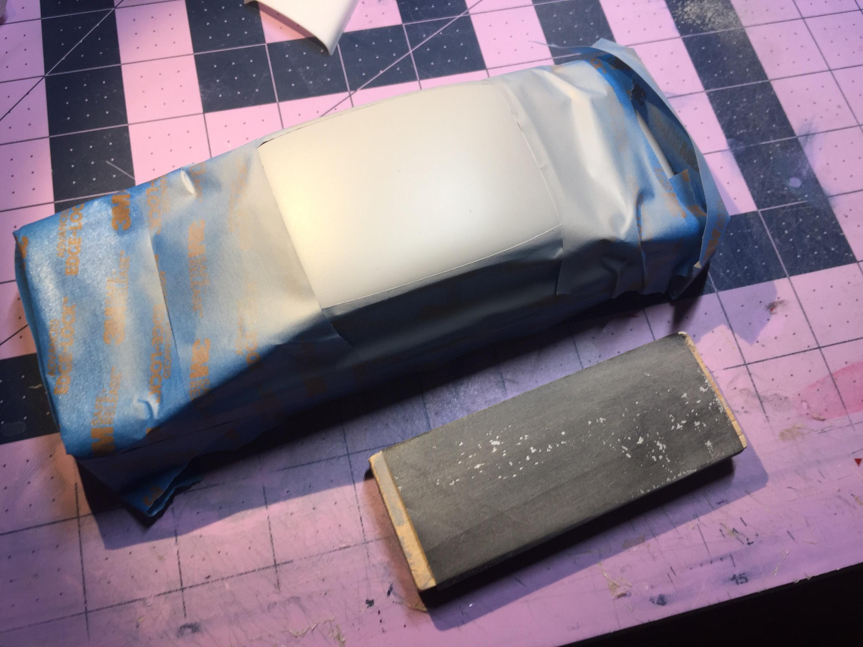

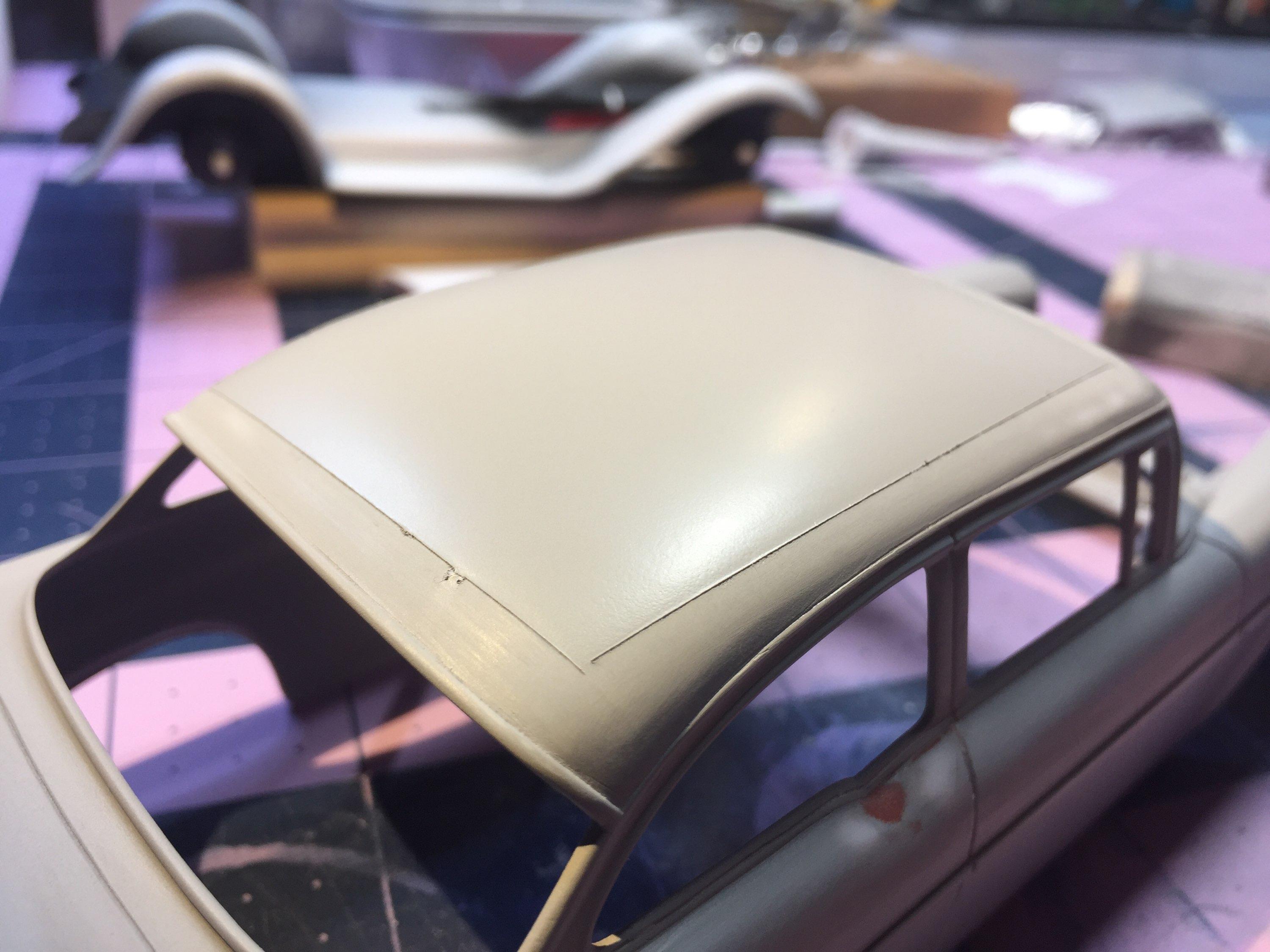

I used some 800 on a block to expose the extent of the issue. It doesn't look too bad on my roof after a few minutes of very deliberate dry sanding. So I taped it up to save all my line chasing and gave the roof two coats of Mr. Surfacer 1500. I'll let it cure out a day and repeat the sanding. I'm sure I will need to repeat all of it again.
I don't want this issue popping up during the rub-out operation so from this day forward I will look for this on cars with headliner detail molded in.

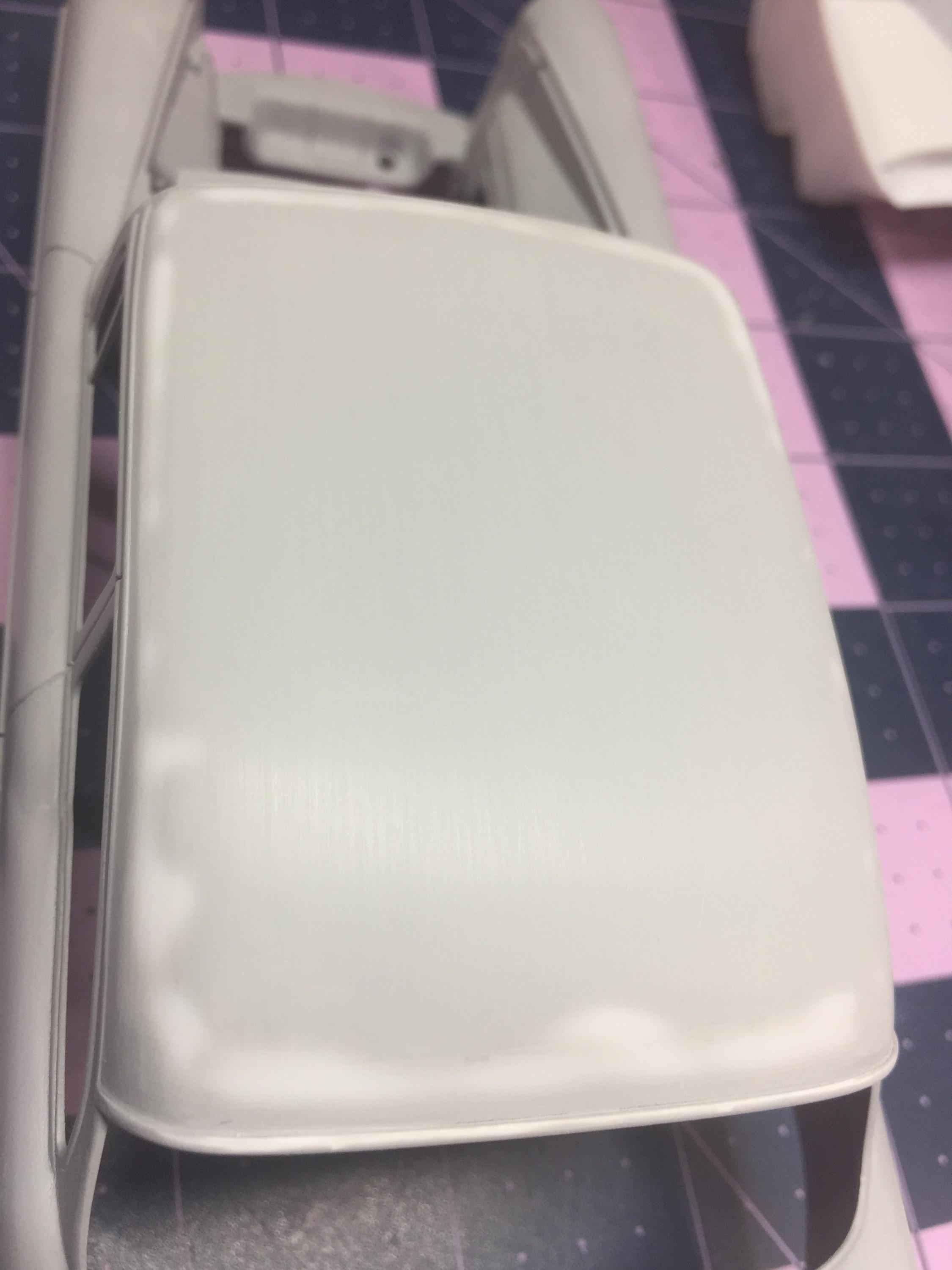

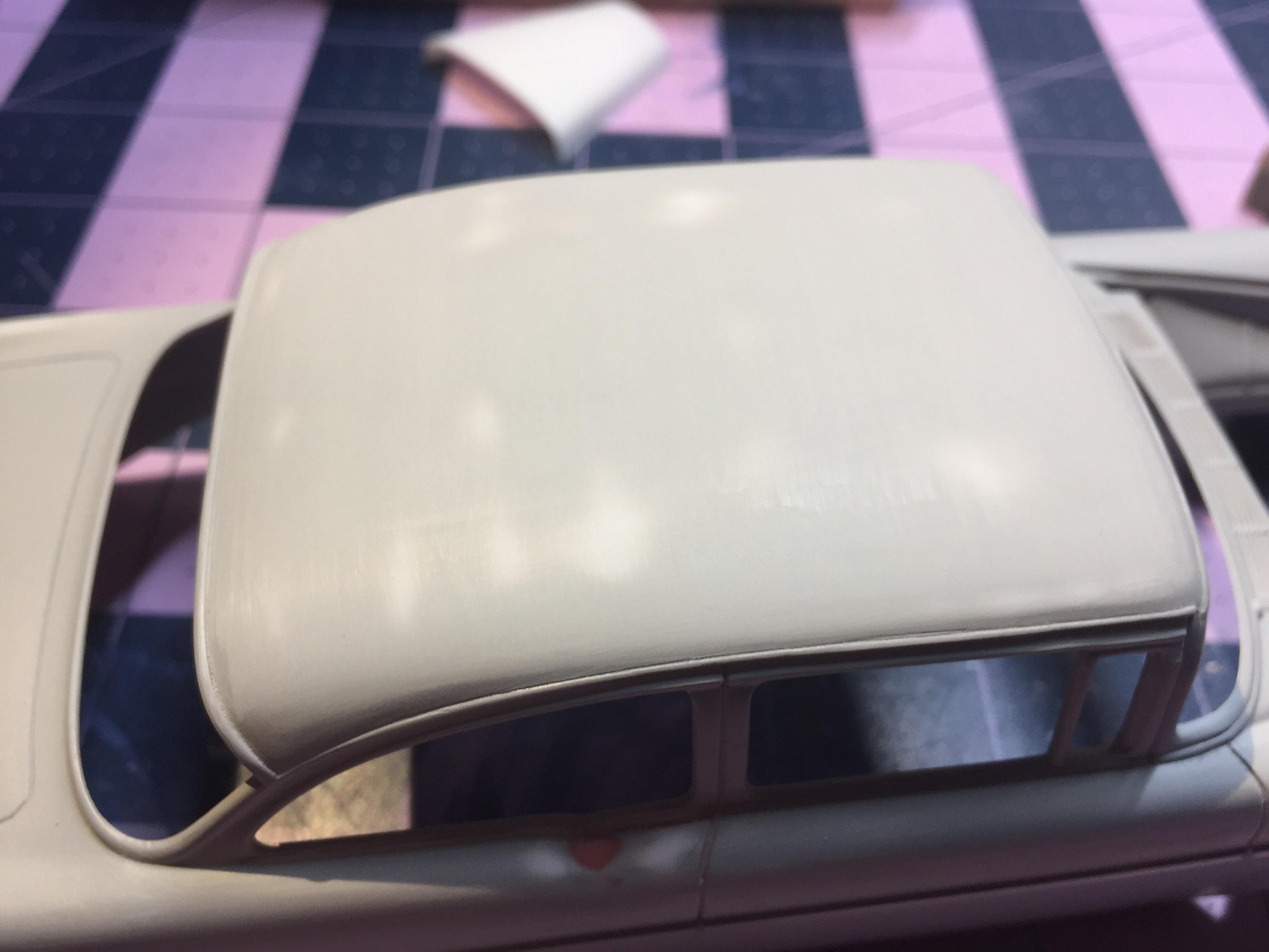

Second block sand. High spots exposed. Back to the garage for more surfacer. Two more coats.
Maybe this will do it. No more block on the next sanding. Tri-folded 1000. This is where I need to use my sense of touch and my flashlight. Gotta try to maintain the curve now.

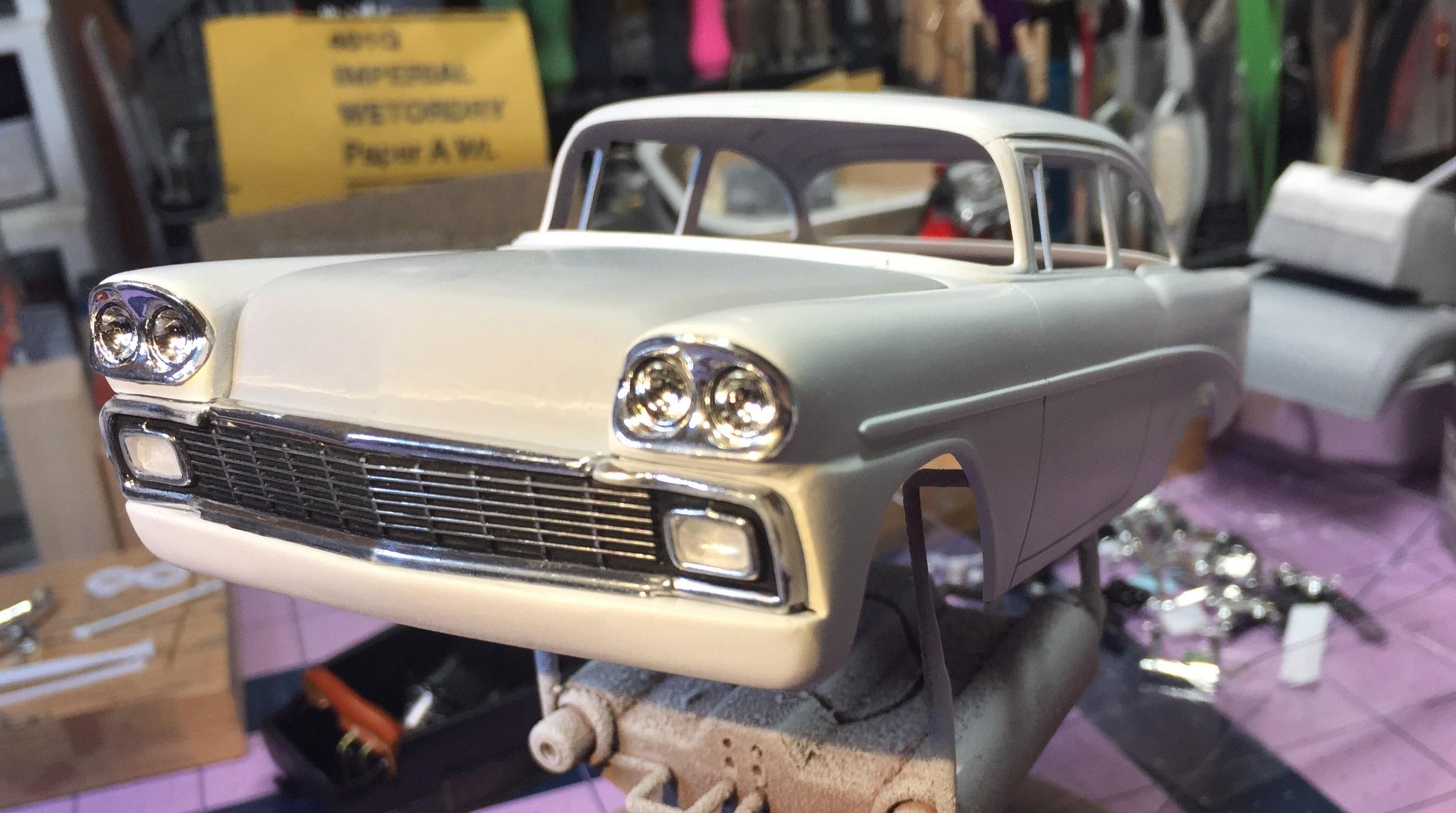

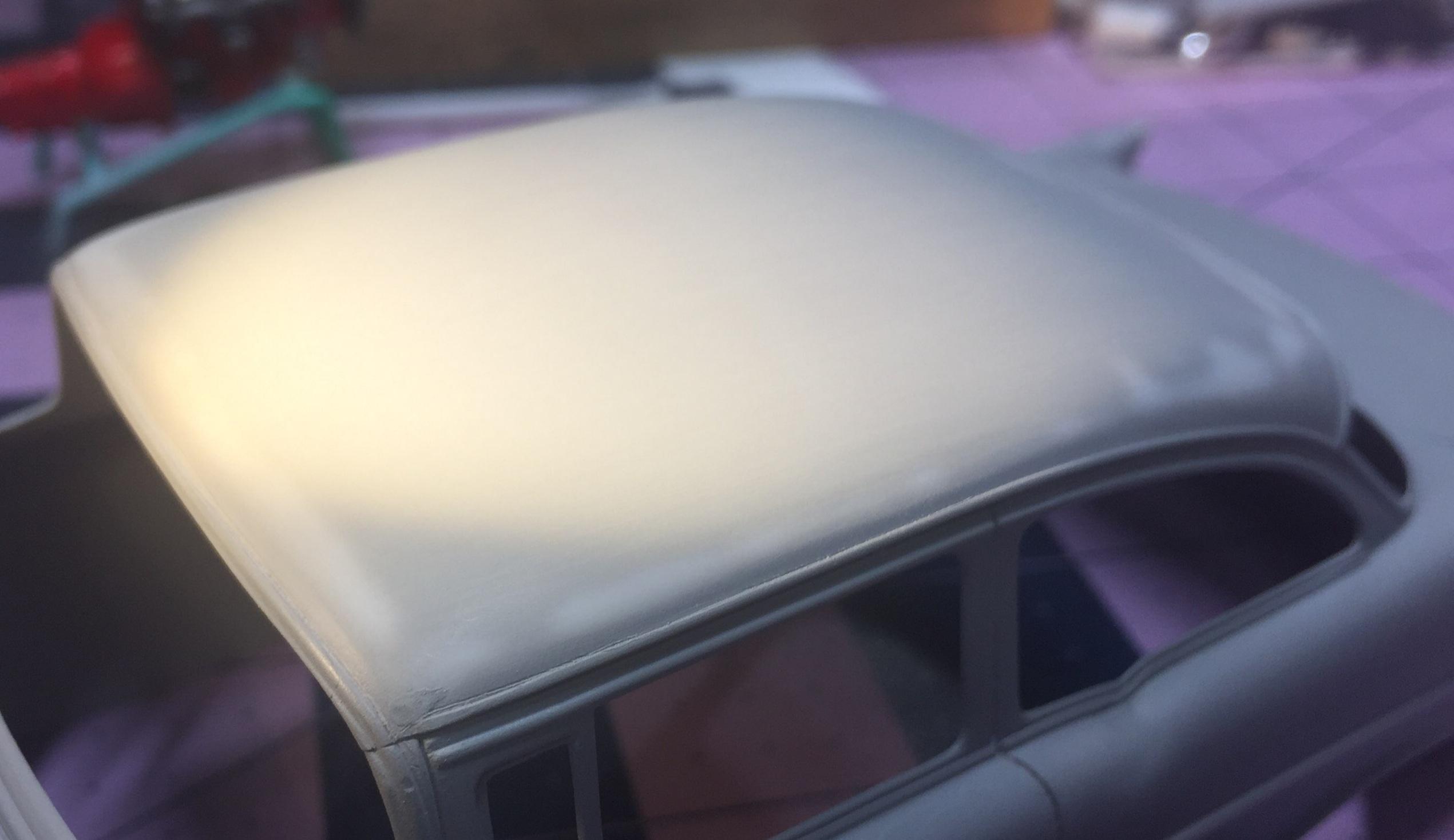

I sanded the second application of surfacer with 1000 grit dry using a large piece folded in thirds for stiffness.  The white plastic is showing around the edges because I needed to remove the ridge left by the tape. The field was sanded with light pressure and only enough to get the surface even. I played light across at various angles to look for shadows. I think I've got it but I will keep my fingers crossed (and the second toe on my right foot 😕).  The pix aren't much help but here they are anyway.

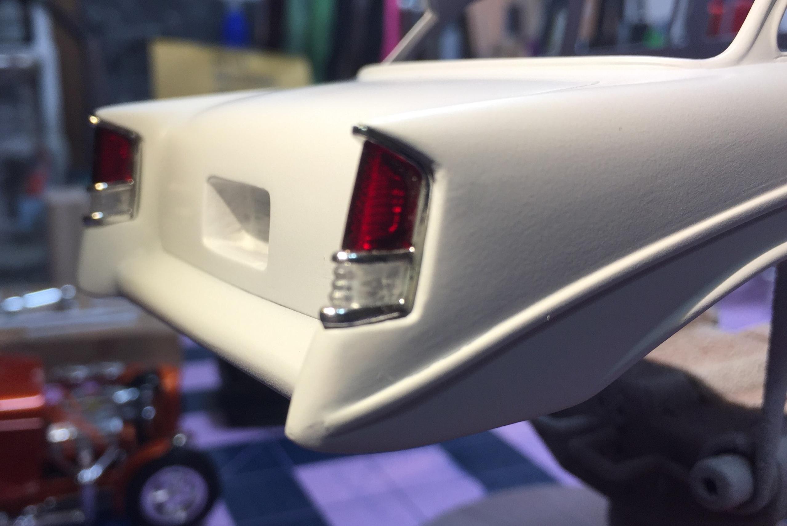

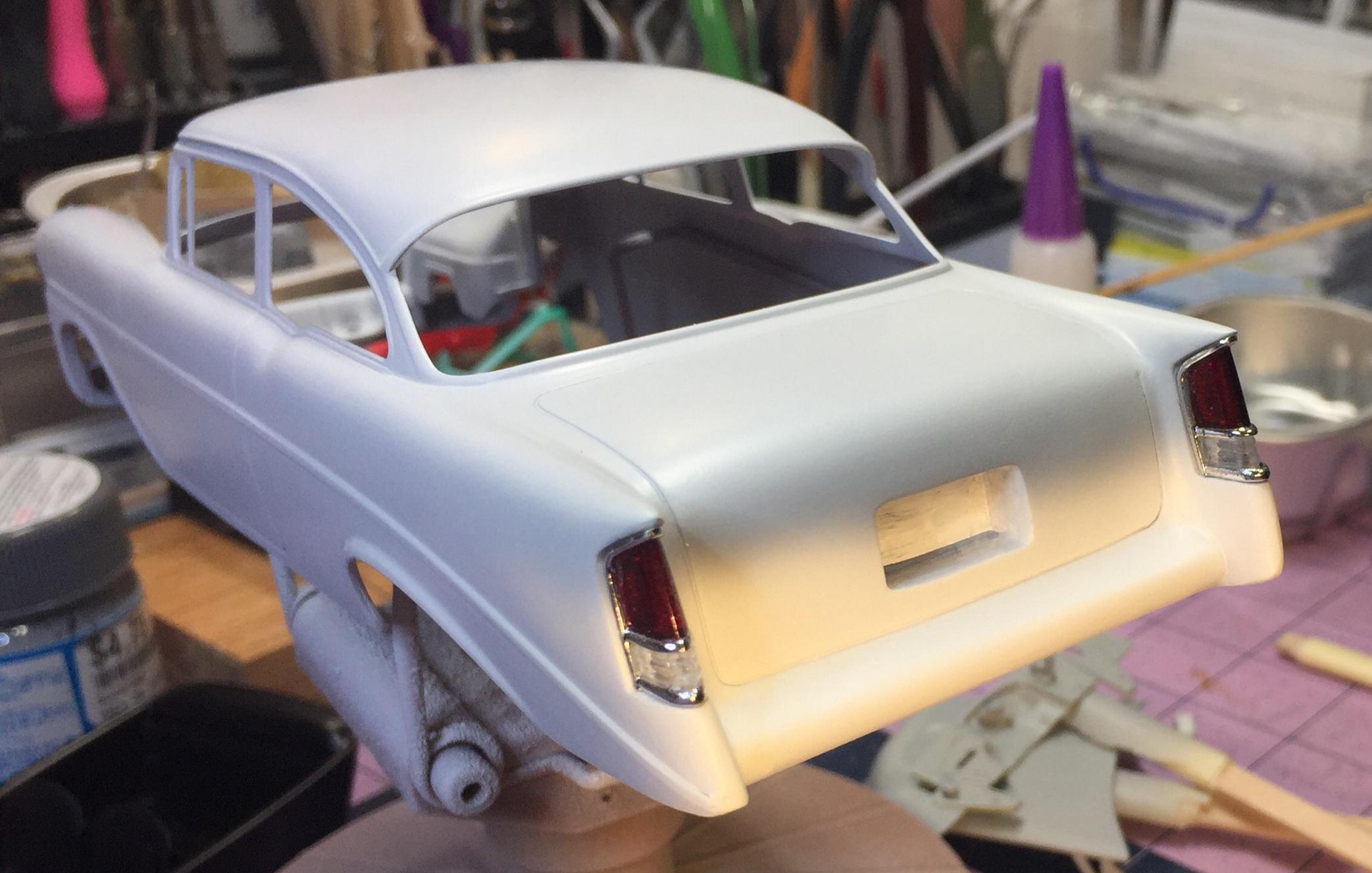

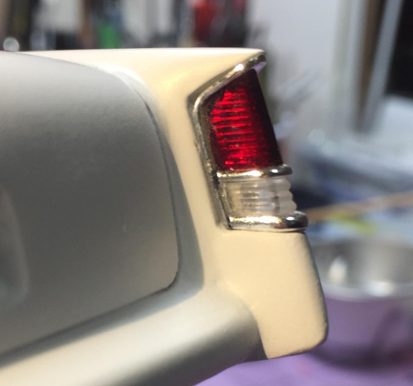

Not much new here.  I've been working on getting the rear smoothed out around the lights and the light-to-body fit. It's close and I'm tempted to call it.... but I'm not completely happy with it yet. The RH today is 32% so I'm tempted to just go ahead and paint it.

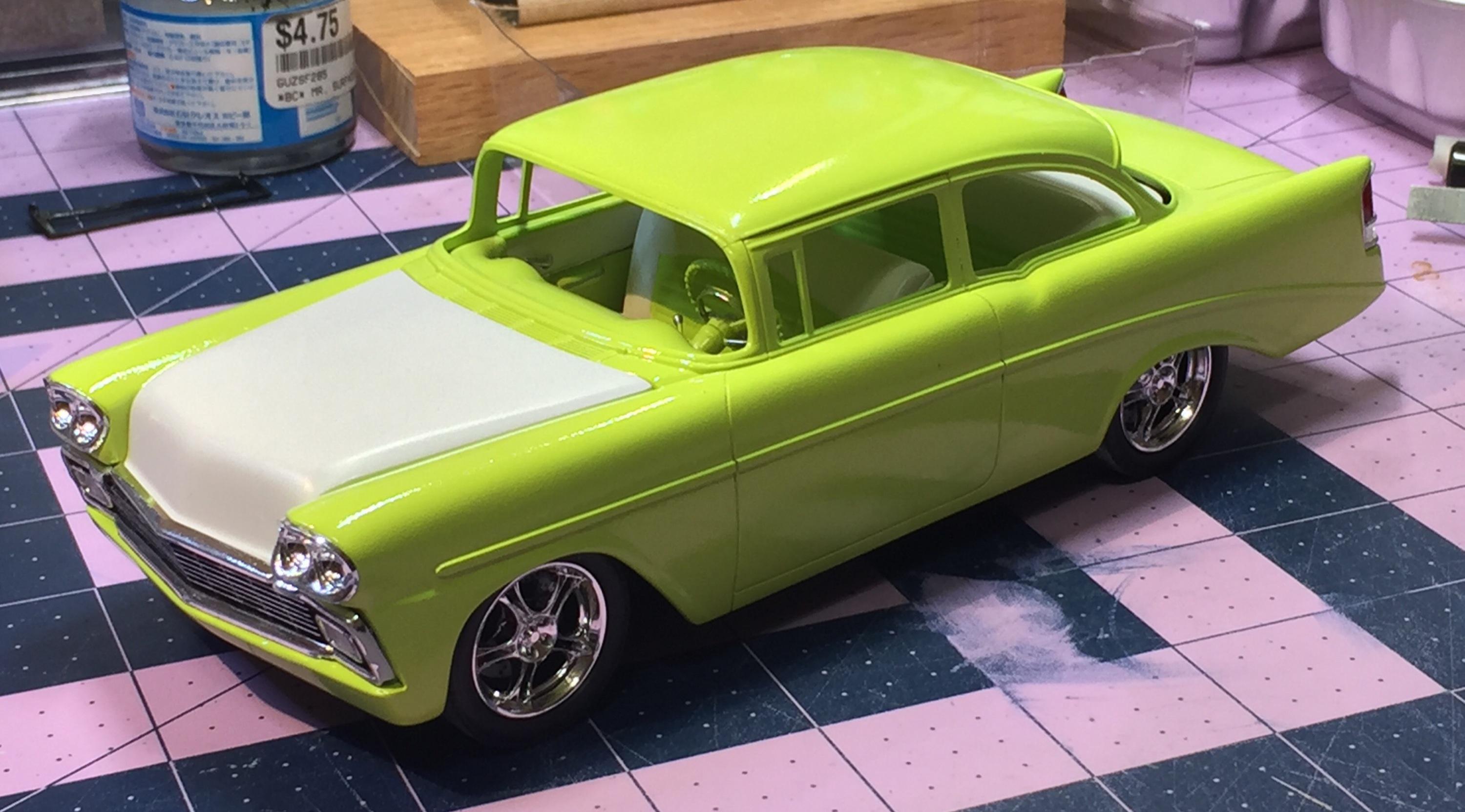

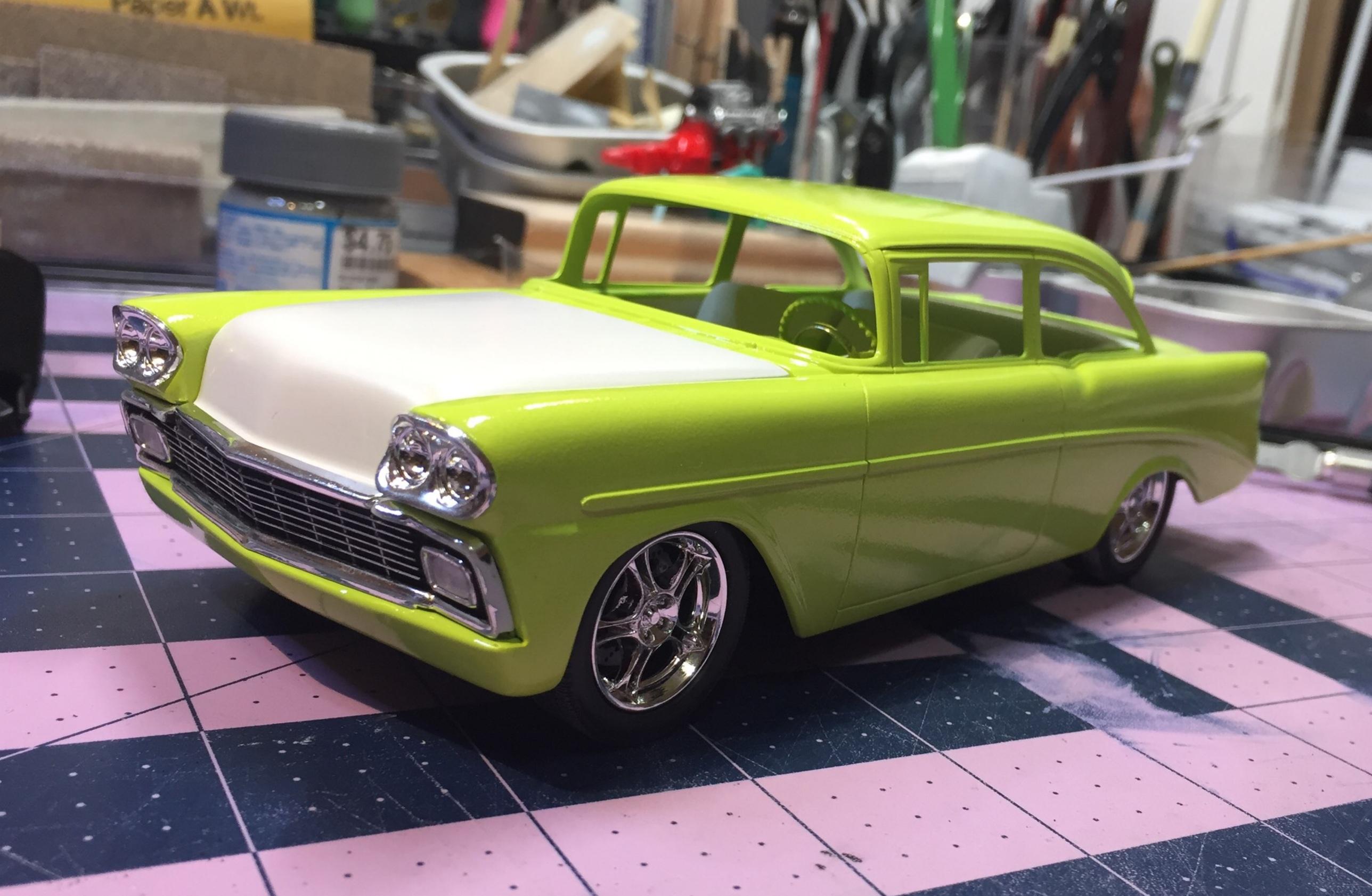

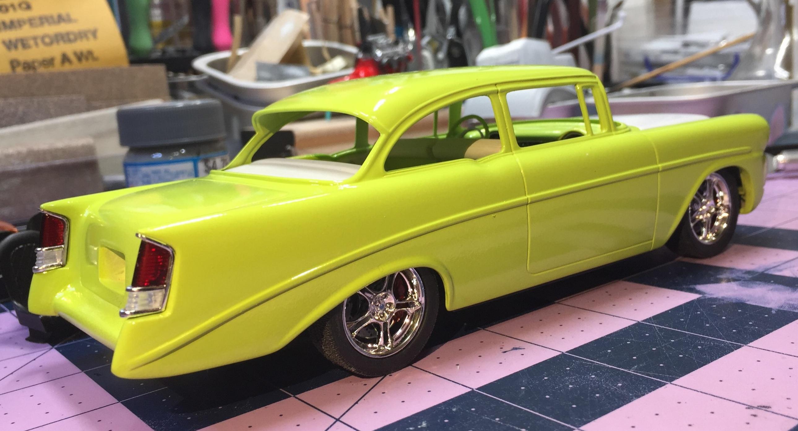

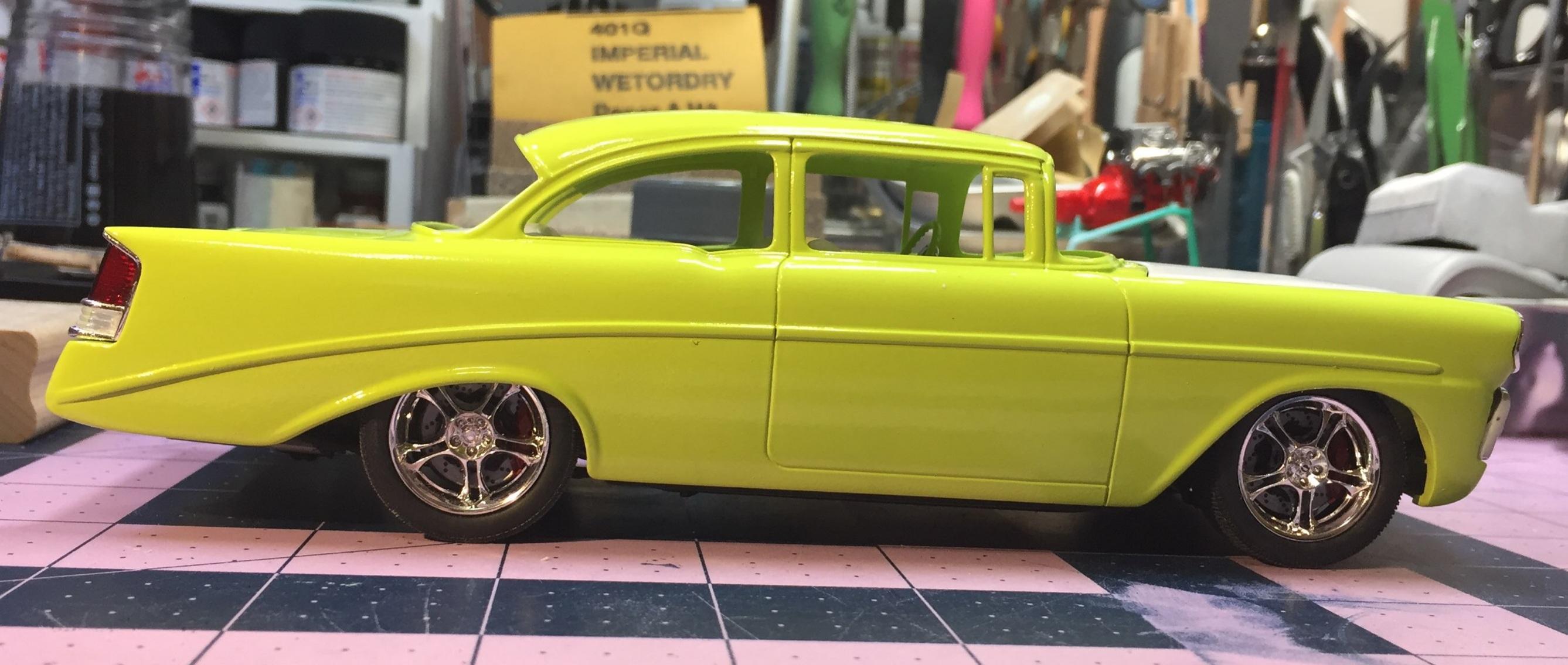

wanted to use the Boyd's but the dash ....never mind.  I shook it really well and I warmed it up. It was spraying just fine and....then......blood clot.  An almost-full can of Rustoleum 2X Key Lime. Of course it's been on the shelf for years. I guess using my sawz-all to shake it was not enough. So now this coat will need some wet-sanding when it finally dries. Naturally, the hood didn't get lucky.  The Deviant Del Rey goes up on the rack of respite. 😔

🤮......yeah, it's too much.  Hopefully, I can find another can of this paint. Shouldn't be difficult. Please don't throw up on your keyboard or drop your new iPhone. Maybe the foil will help.

Looks good and yeah, foil will help, or even blacking out the trim.

The paint finish looks good in the photo anyway. The color also compliments the body work.
Some of it looks good but there's not enough paint in some areas and the OP is really bad.  Gotta wet sand and get another can if I can find it.
