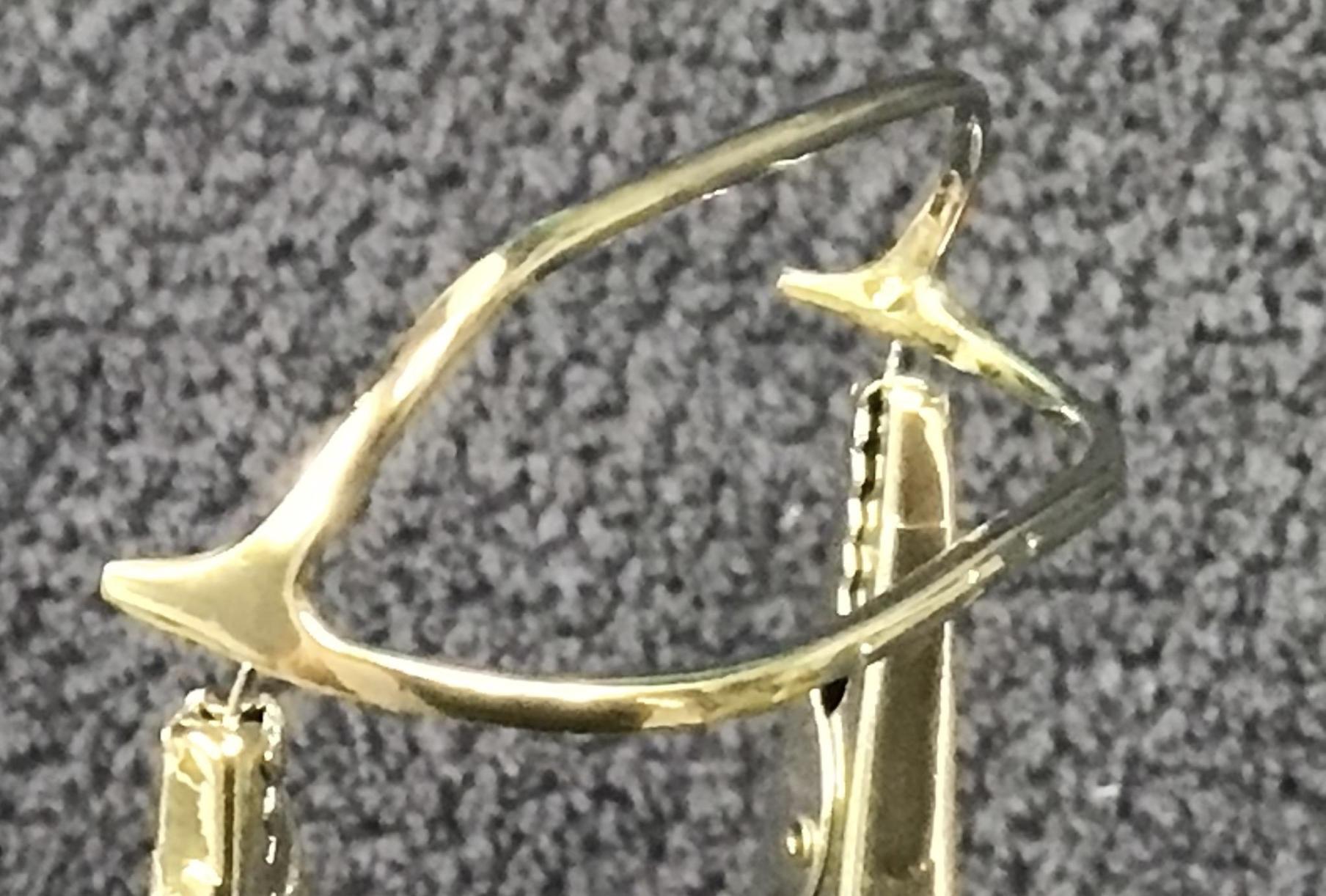

Ace-Garageguy Posted 12 hours ago Posted 12 hours ago (edited) I would have created a means to pin the windshield to the body before painting, then attached it with the pins and a little white glue afterwards. I've used that method several times. It just takes very careful measuring and drilling. EDIT: I pinned this windshield frame early in the mockup process, as it was integral to the look I was after, and it also had to be removable, but go back in exactly the same place every time. I didn't show the process though, as this was the first one I did that way, and I wasn't 100% sure it would work as intended...so I didn't photograph the process. The pins are literally that, short point sections of straight pins glued into the frame, fitting into corresponding holes in the body. Windshield still fits dead-on after all the bodywork and paint on the main body was finished: Edited 12 hours ago by Ace-Garageguy

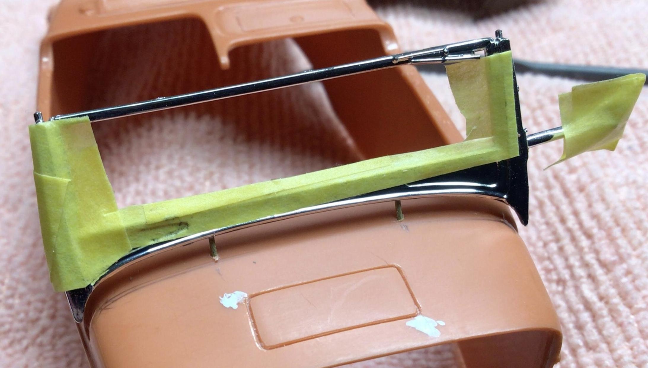

NOBLNG Posted 9 hours ago Posted 9 hours ago (edited) That is what I try to do also if there are no definite mounting points. These are 0.020” brass pins if I recall. Edited 9 hours ago by NOBLNG
