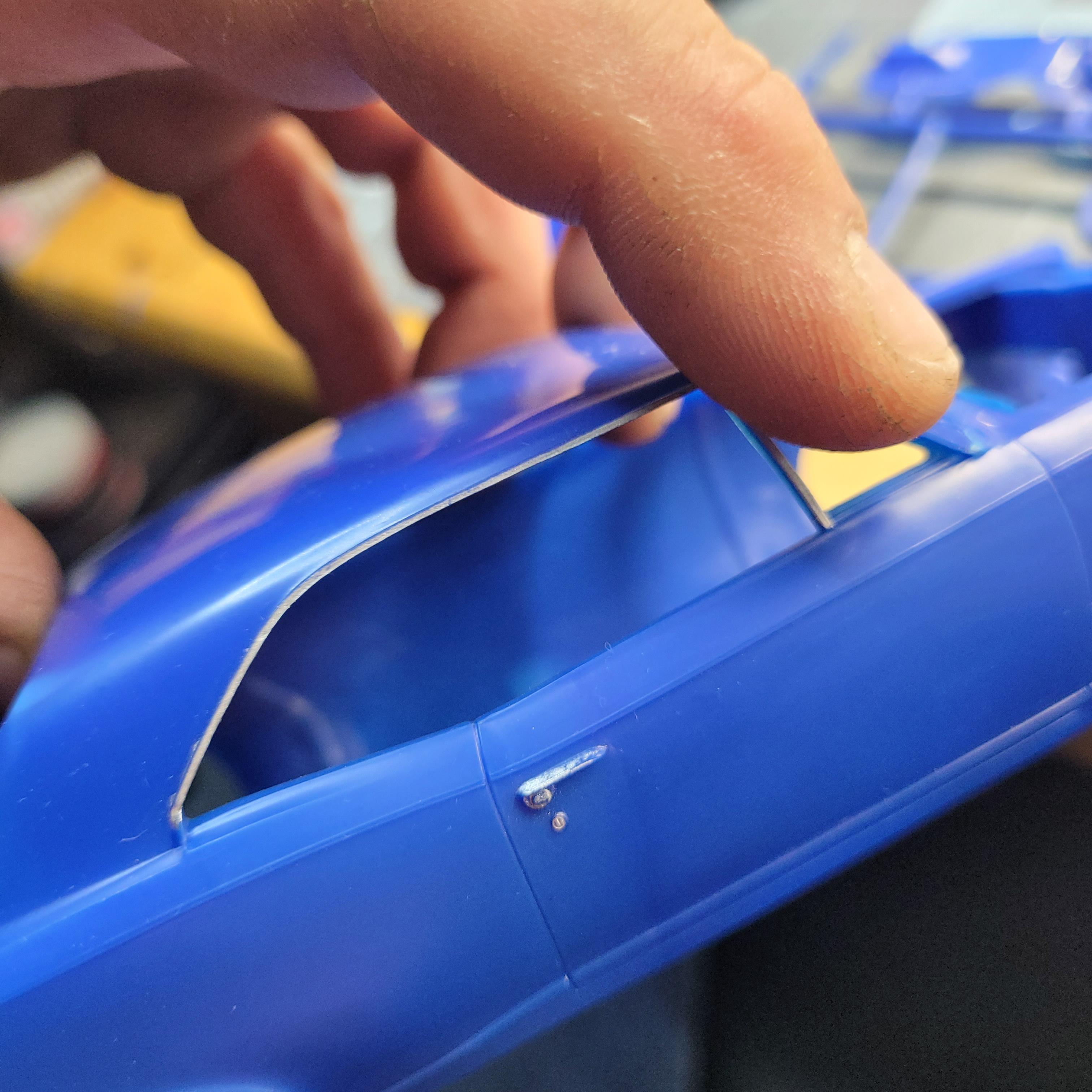

johnyrotten Posted 14 hours ago Author Posted 14 hours ago So here's what I've found after an hour. It's sensitive to the paint thickness, big time. And touchy to adjust. This ornament was after an hour of playing around, straight testors enamel silver. It's good for pronounced details, anything shallow, a brush would be better IMHO. The pen is barely open in order to control the paint flow, and I'm "reloading" the nib, not holding the valve open all the time. I'll continue to mess with this, but im starting to think there's better tools/techniques than this tool. 1
