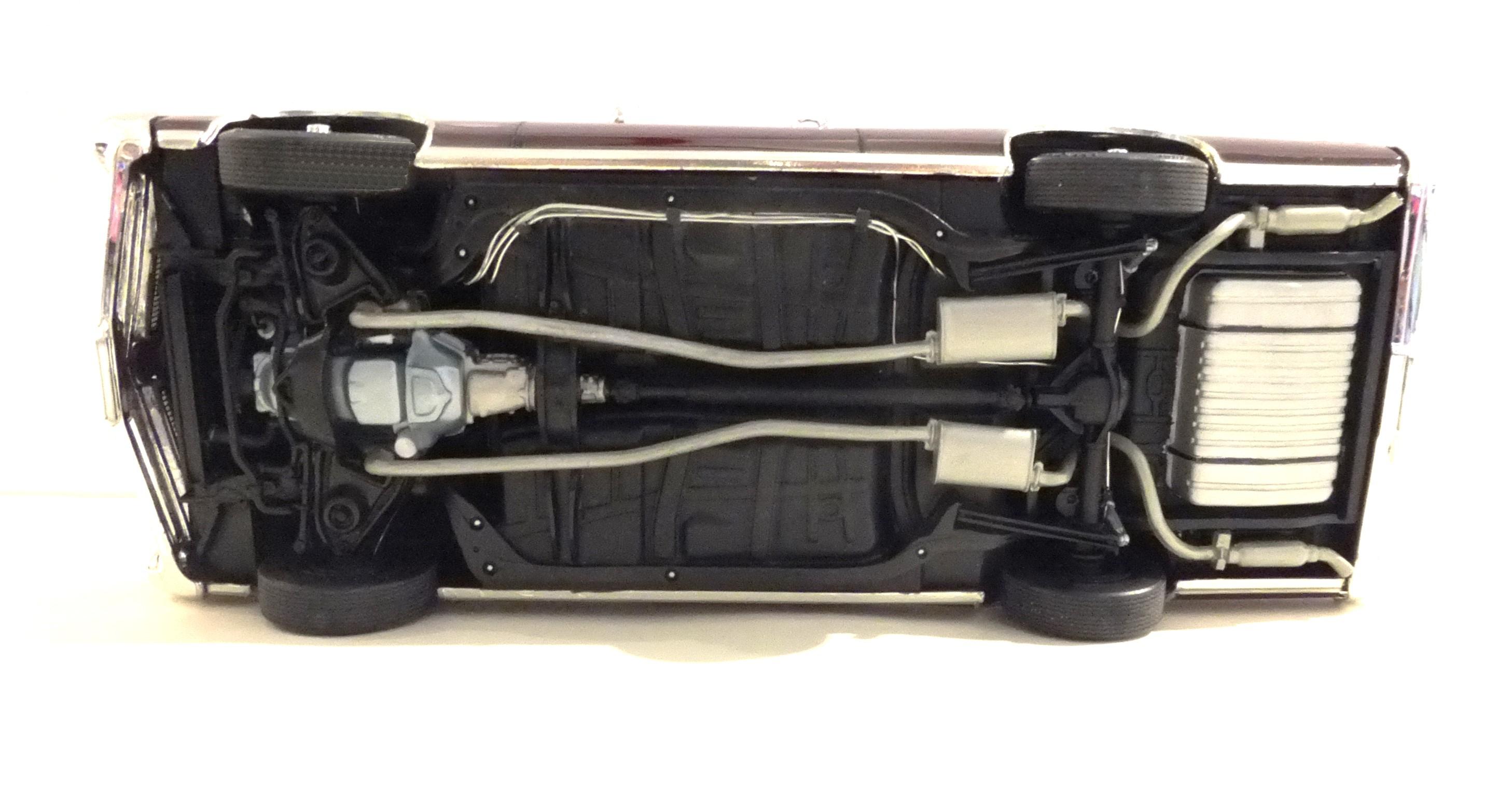

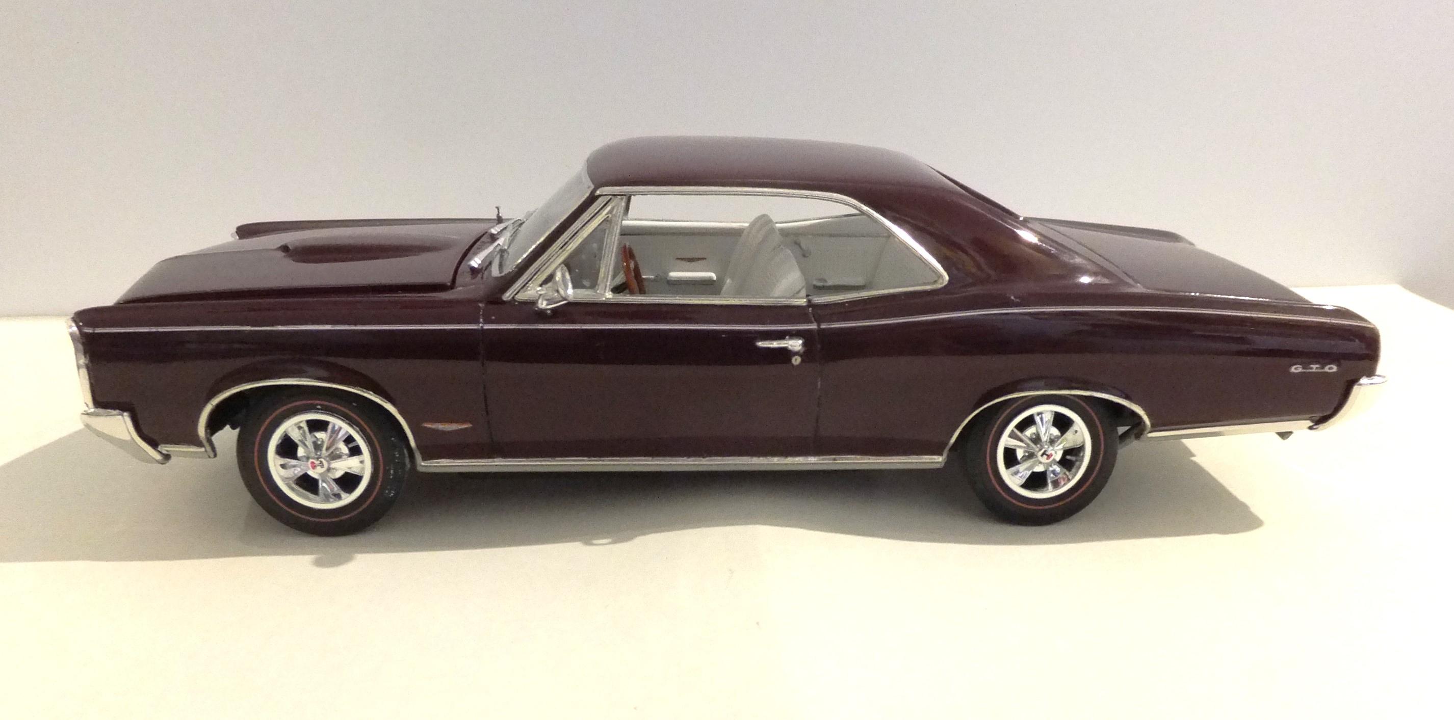

Exotics_Builder Posted October 11 Posted October 11 (edited) Revell/Monogram 64 is not bad, but is 1/24. Polar Lights does a 64 that is simple but has more detail than their 65. The AMT 65 is an old kit repopped several times and chassis is way old school. If choosing one, I'f first opt for the 66 by Revell. Here's the one I did, with some upgrades. The Hurst wheels are from the Royal 66 kit variation. Edited October 11 by Exotics_Builder 1
