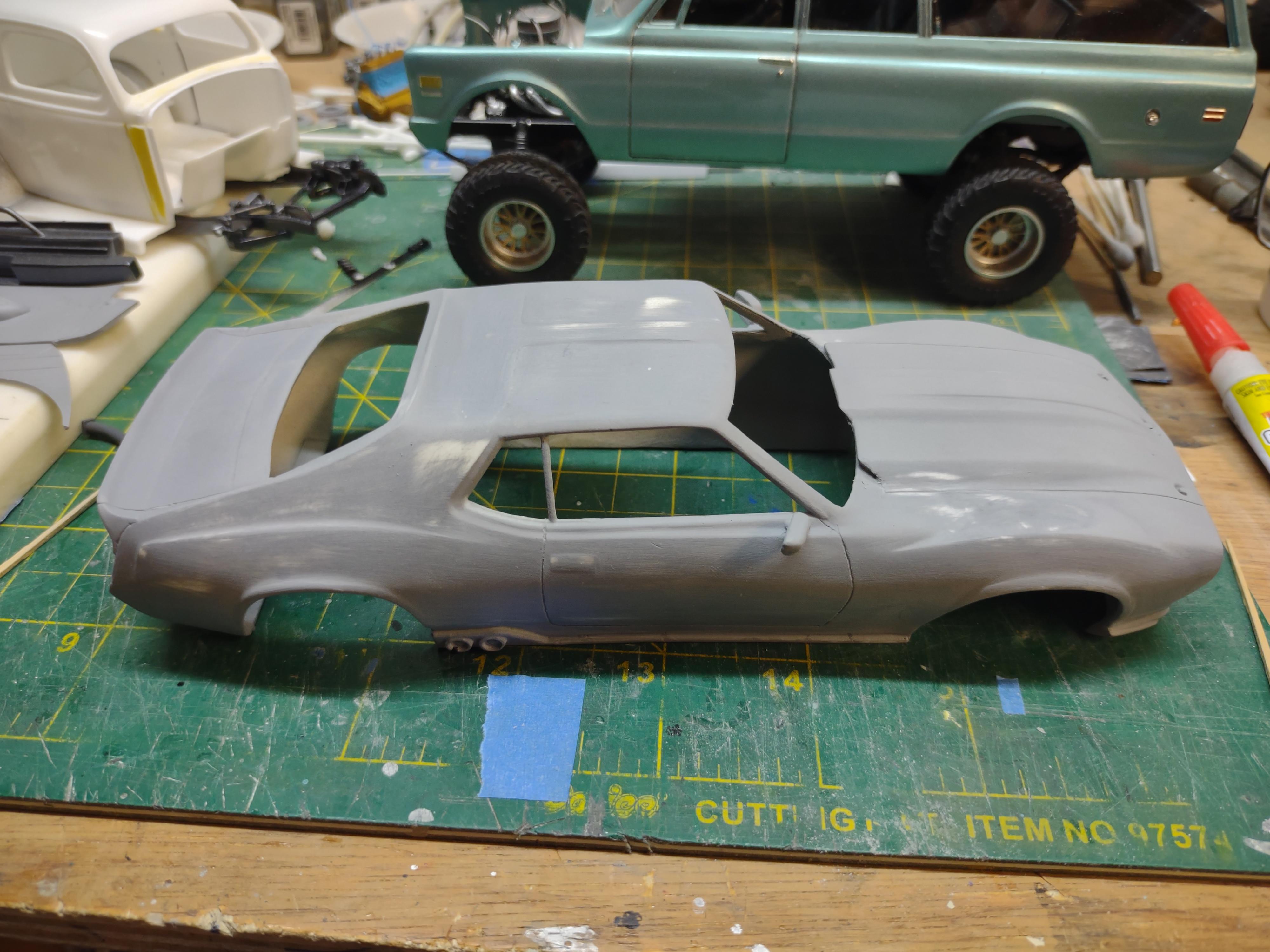

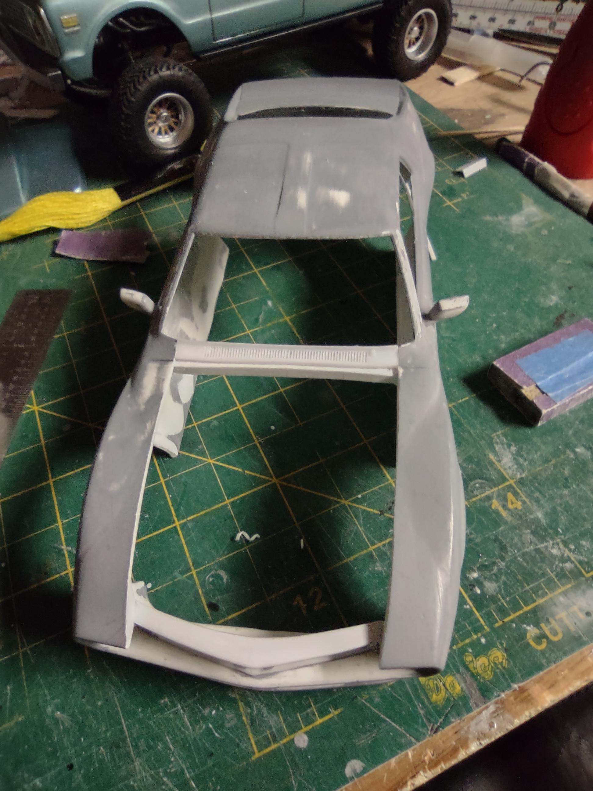

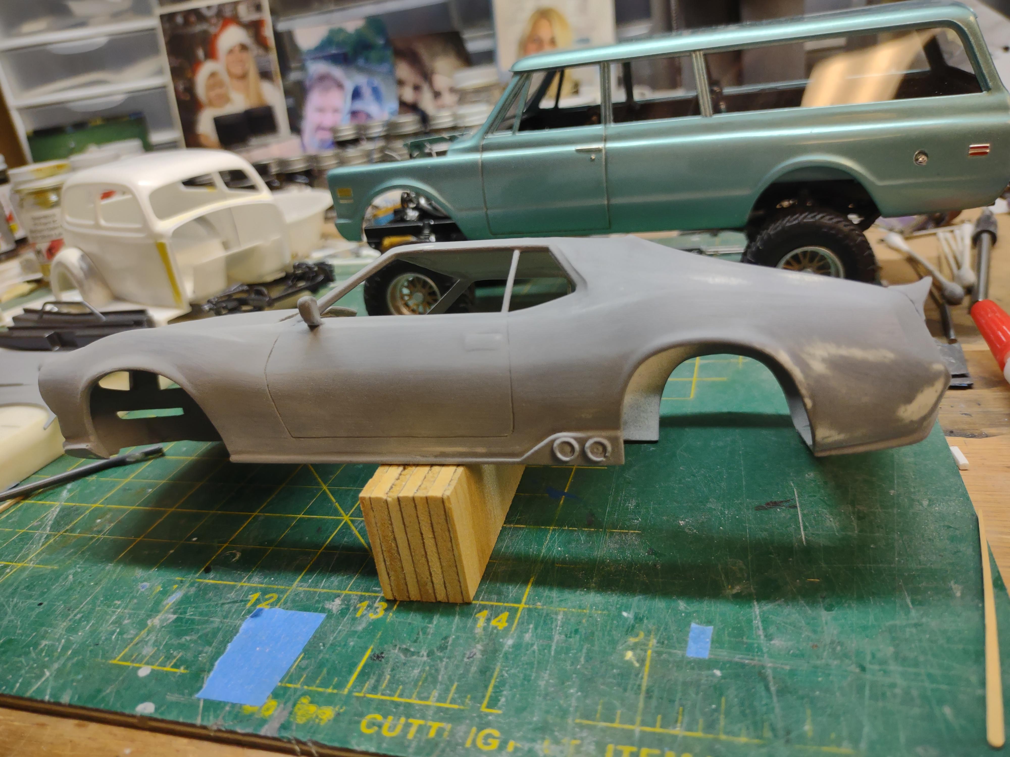

64SS350 Posted November 12 Posted November 12 I know many of us have multiple projects going or sitting in queue, and I am no different. While trying to figure custom ideas and such, I shift to others to help move them along and hopefully....clear some space on the bench or as I call it ..'the staging shelf'. I have had this body since mid 2021, and after purchasing realized it was a slush molded body. The outside is nice, but had a ton of pinholes and some details needed enhanced. I recently decided it was time to move forward with it and after showing it to a friend, we have plans for it when it is closer to being done. Here is my current progress starting of course with the raw body. 9

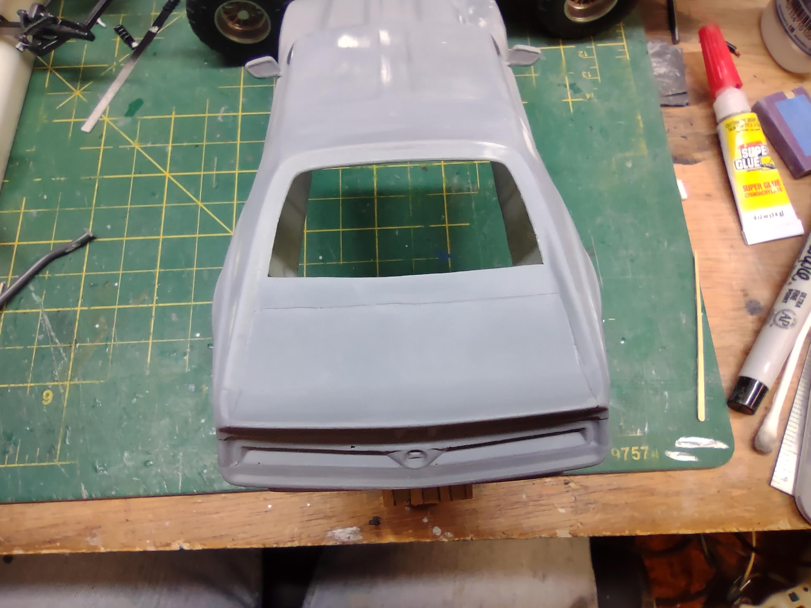

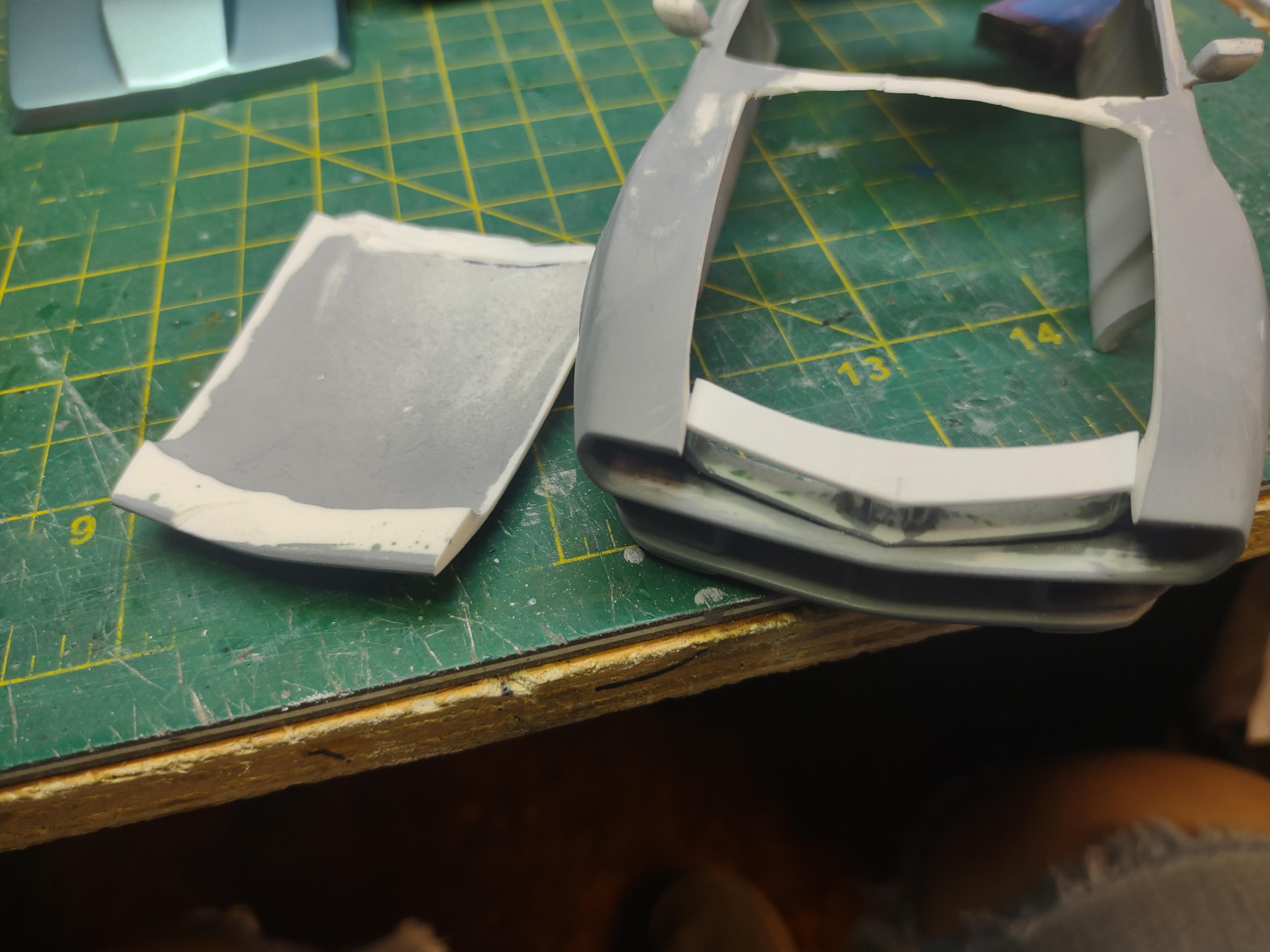

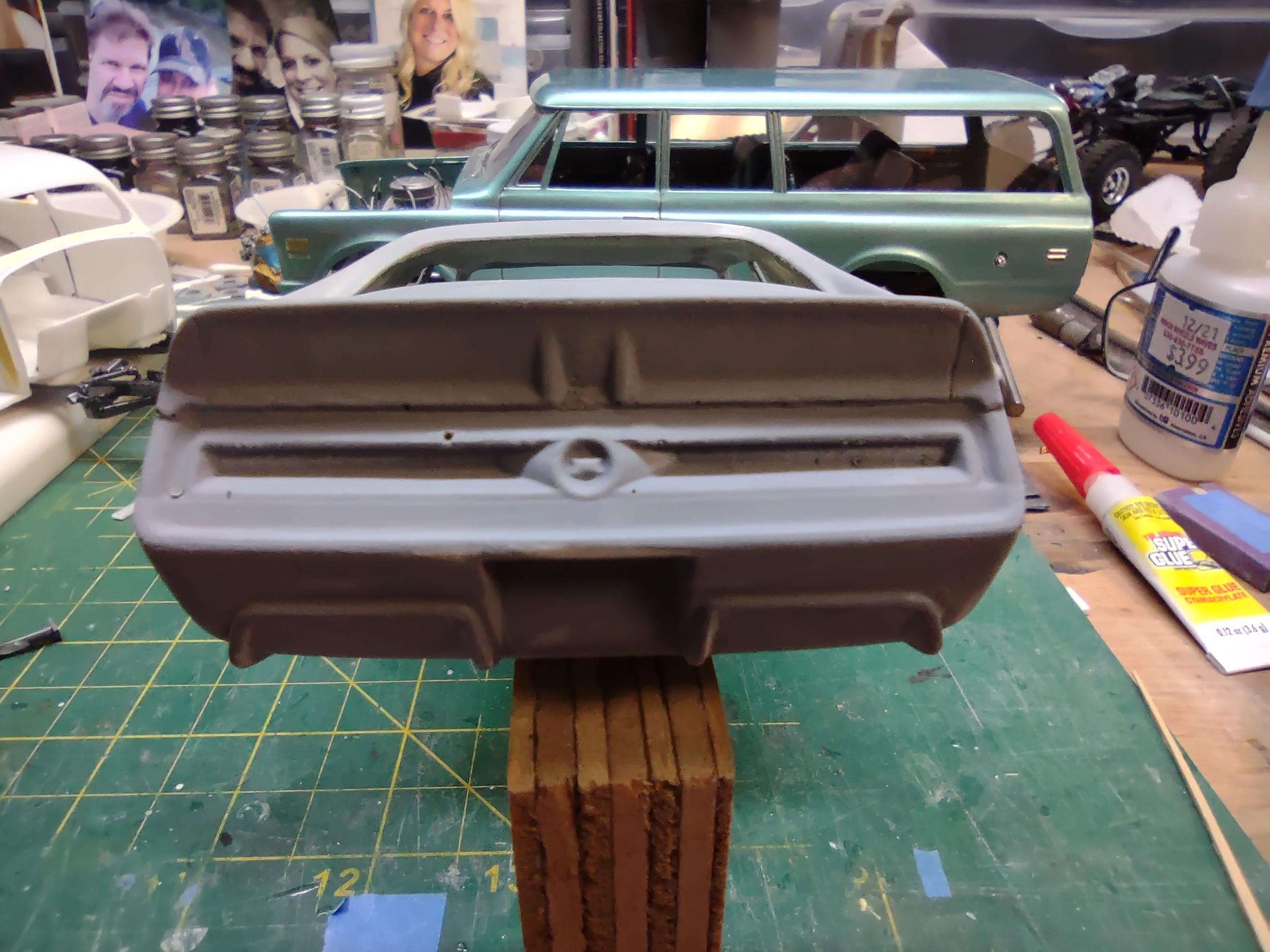

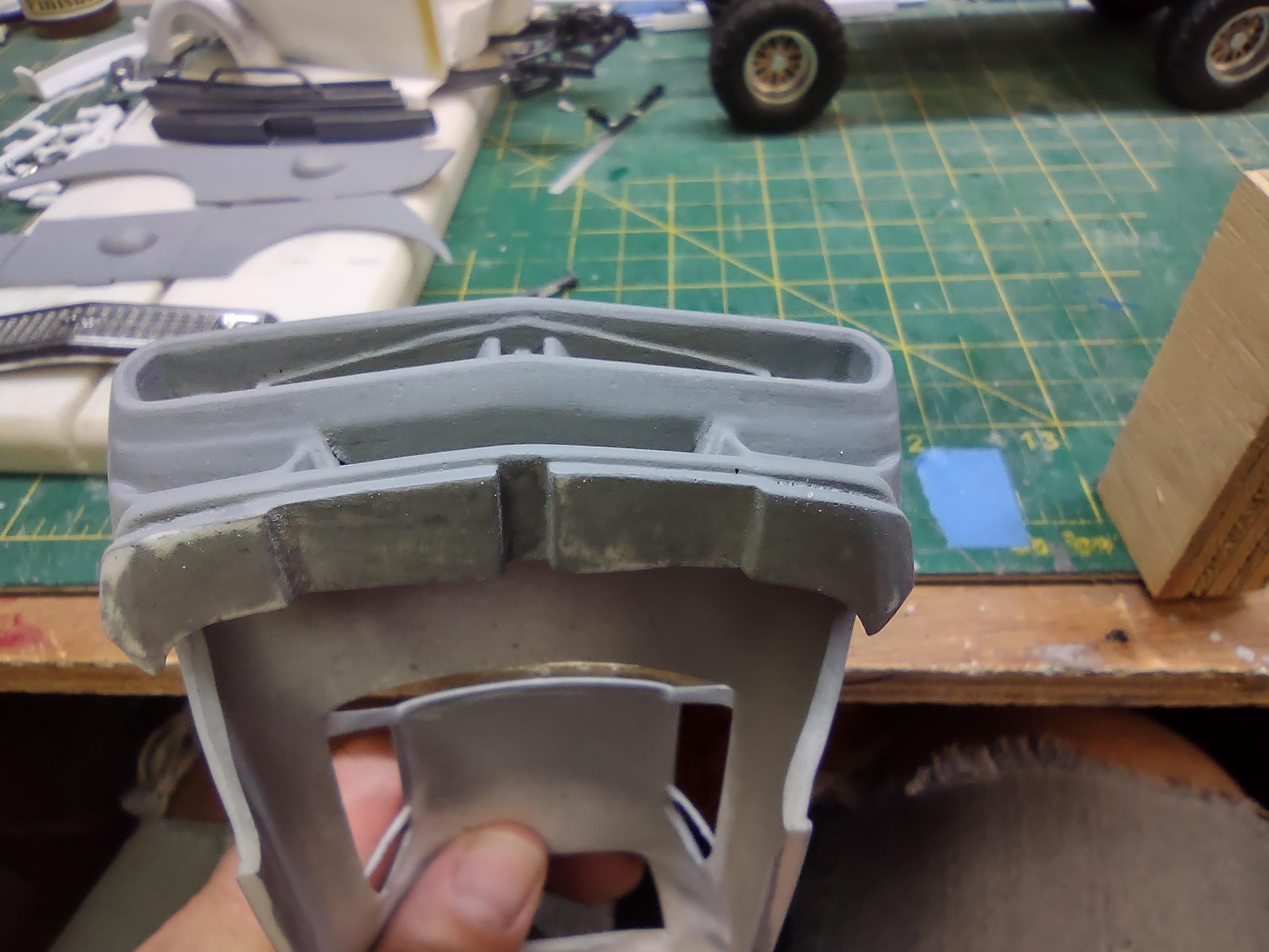

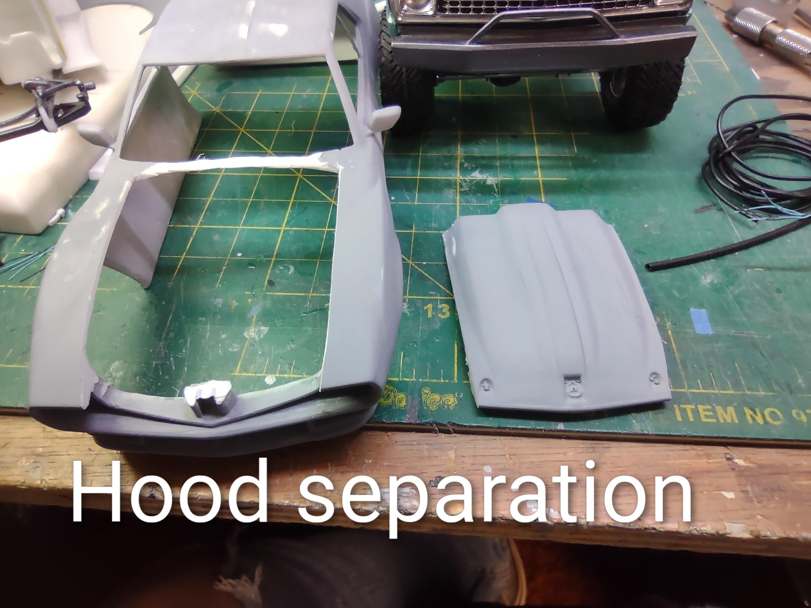

64SS350 Posted November 12 Author Posted November 12 Recent progress. I have opened the hood ( because this has to show it's motor ) and the panel lines weren't great. The trunk will also be opened for similar reasons. The chassis is from the '76 or '79 Nova, lengthened so far, the suspension will be changed also. Inner fender wells won't stay from the Nova kit. 8

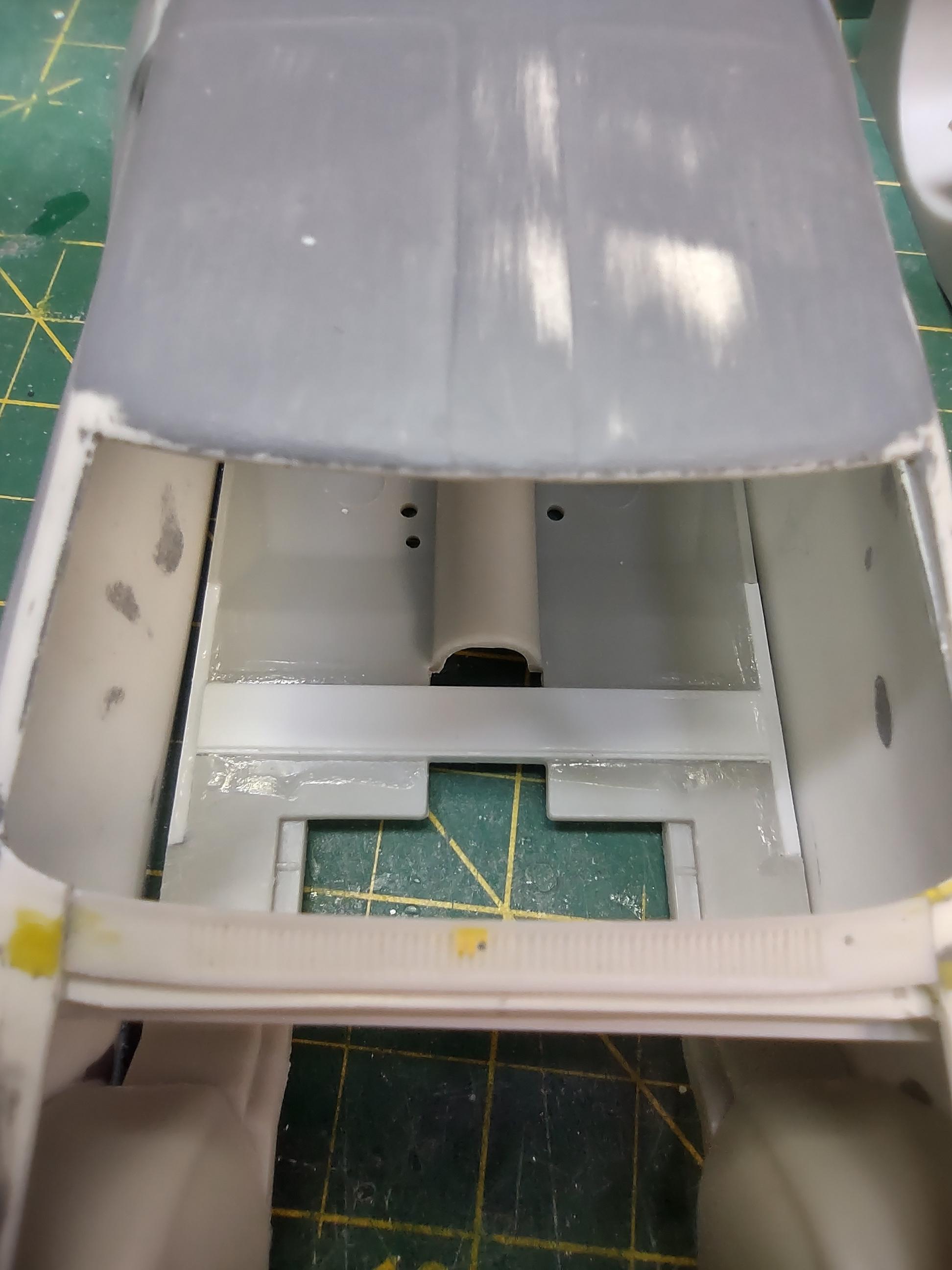

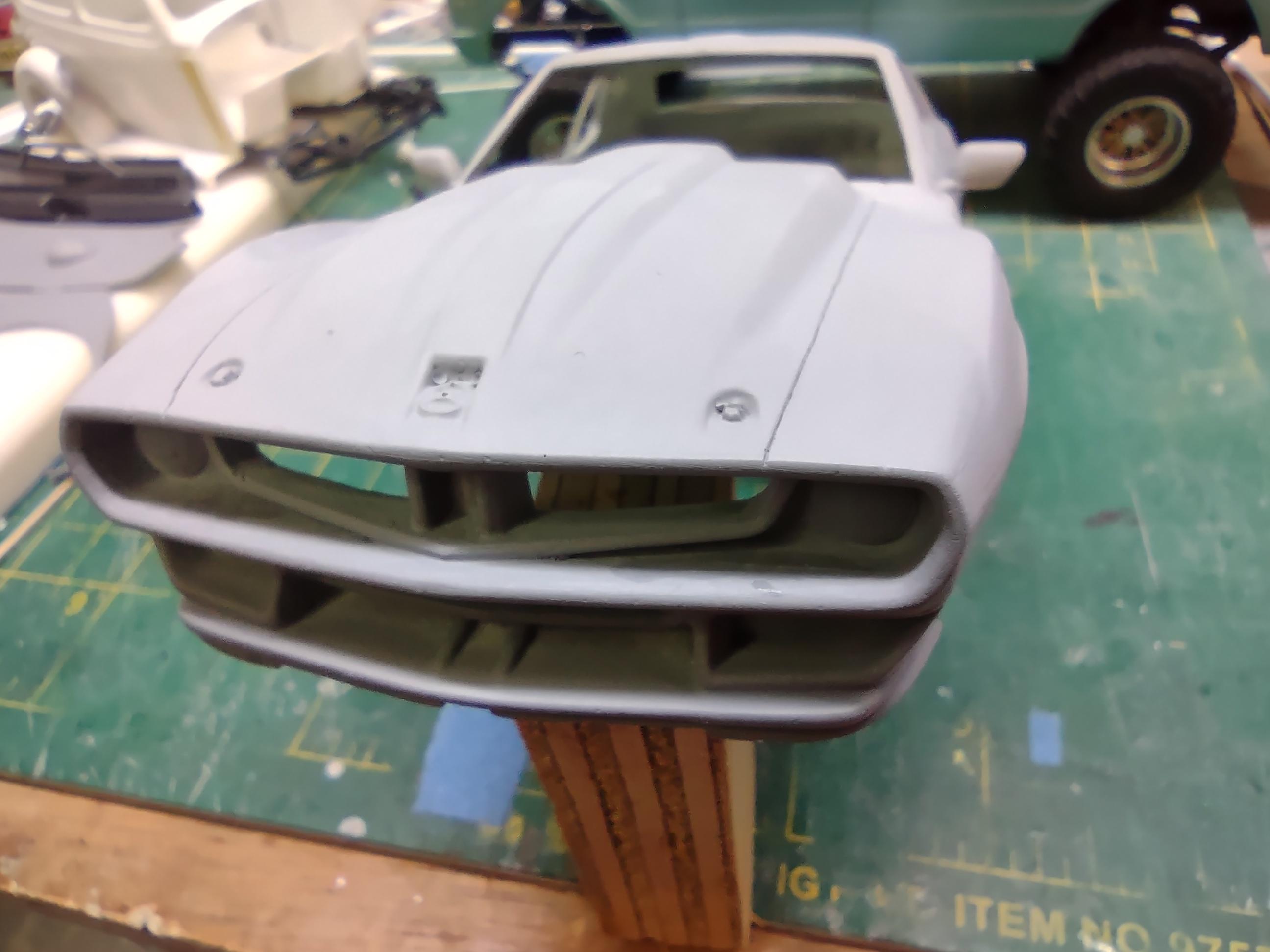

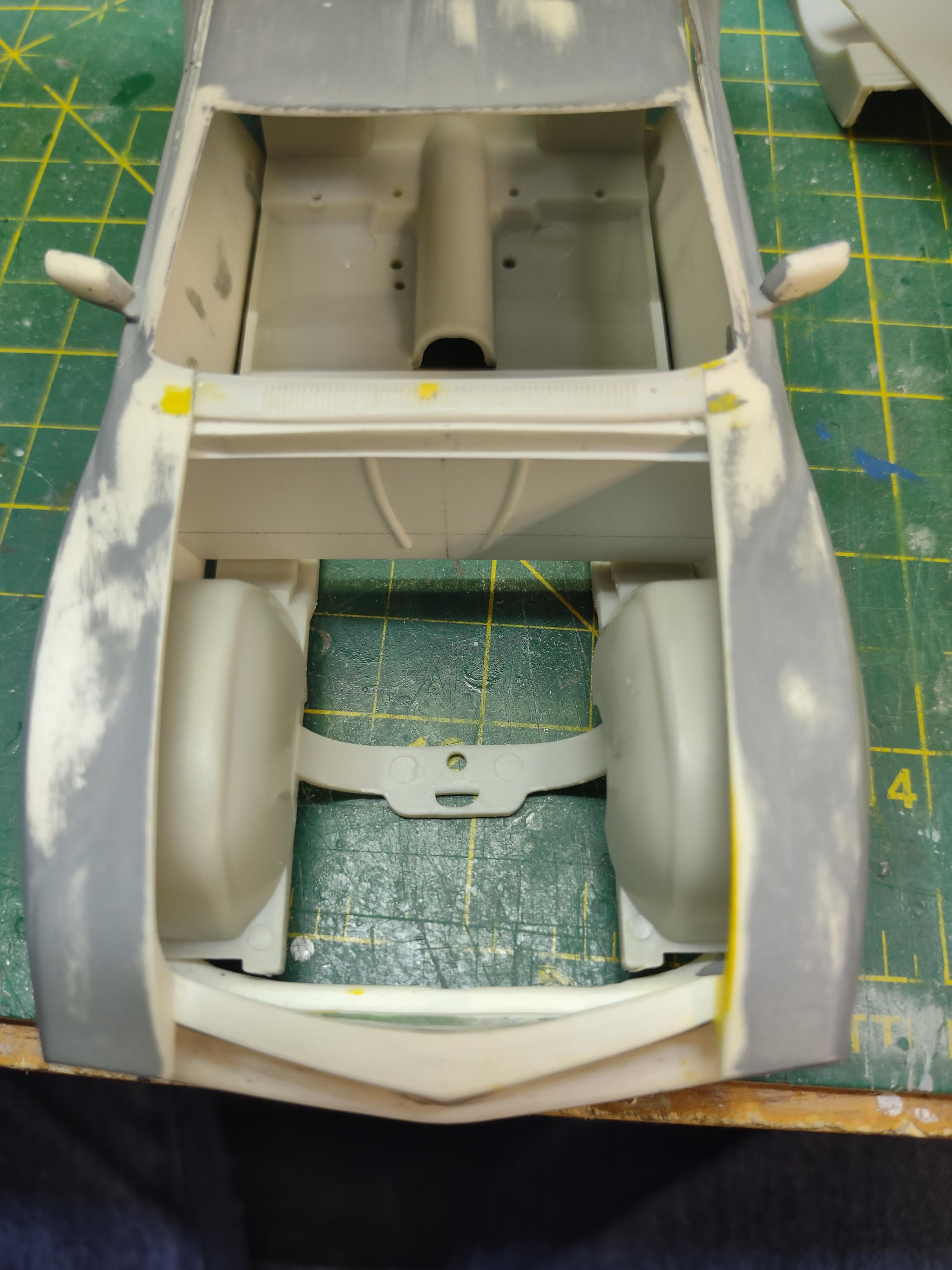

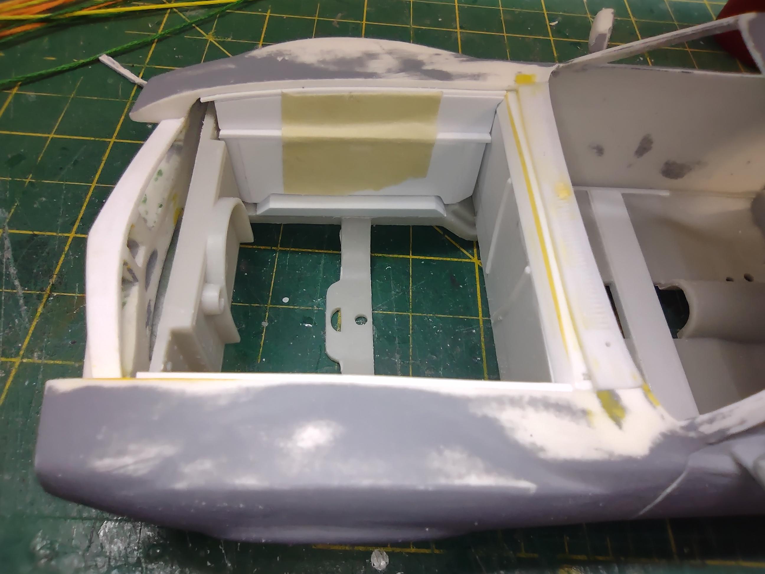

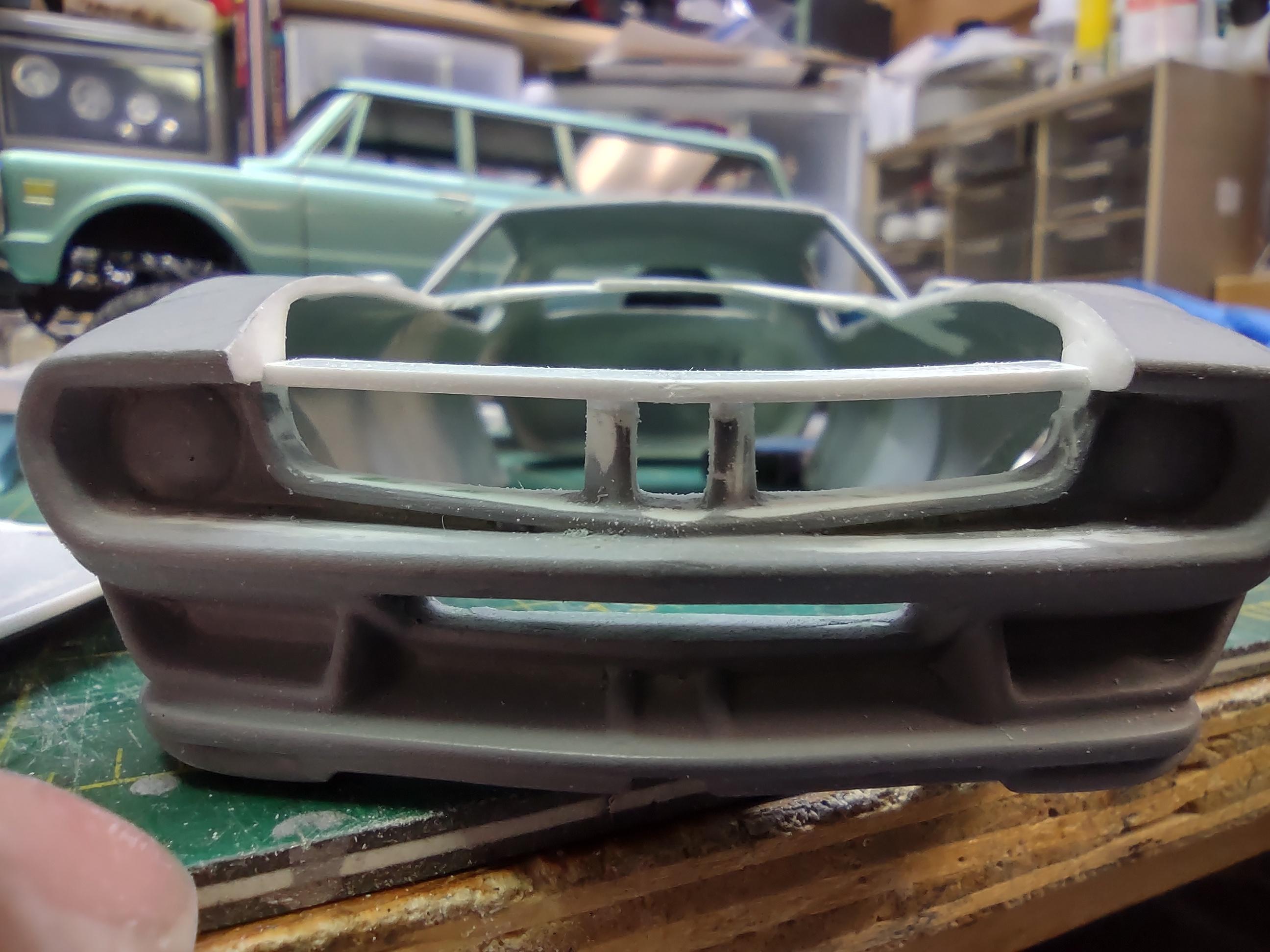

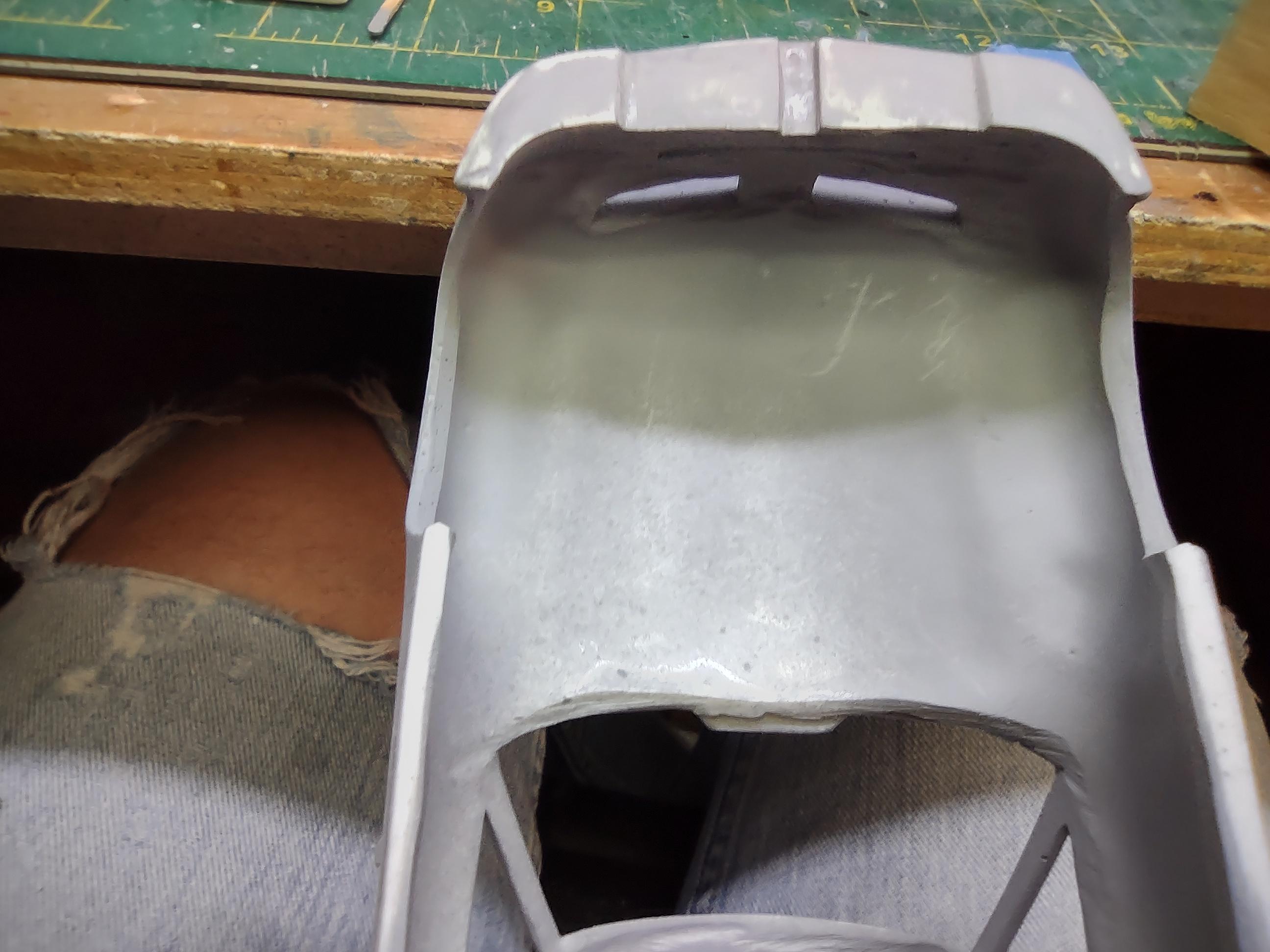

64SS350 Posted November 21 Author Posted November 21 Some fabrication of the engine bay so far. Currently smoothing and blending things together. Also going to upgrade the rad support....the Nova one leaves something to be desired. Front suspension is next. Β 3

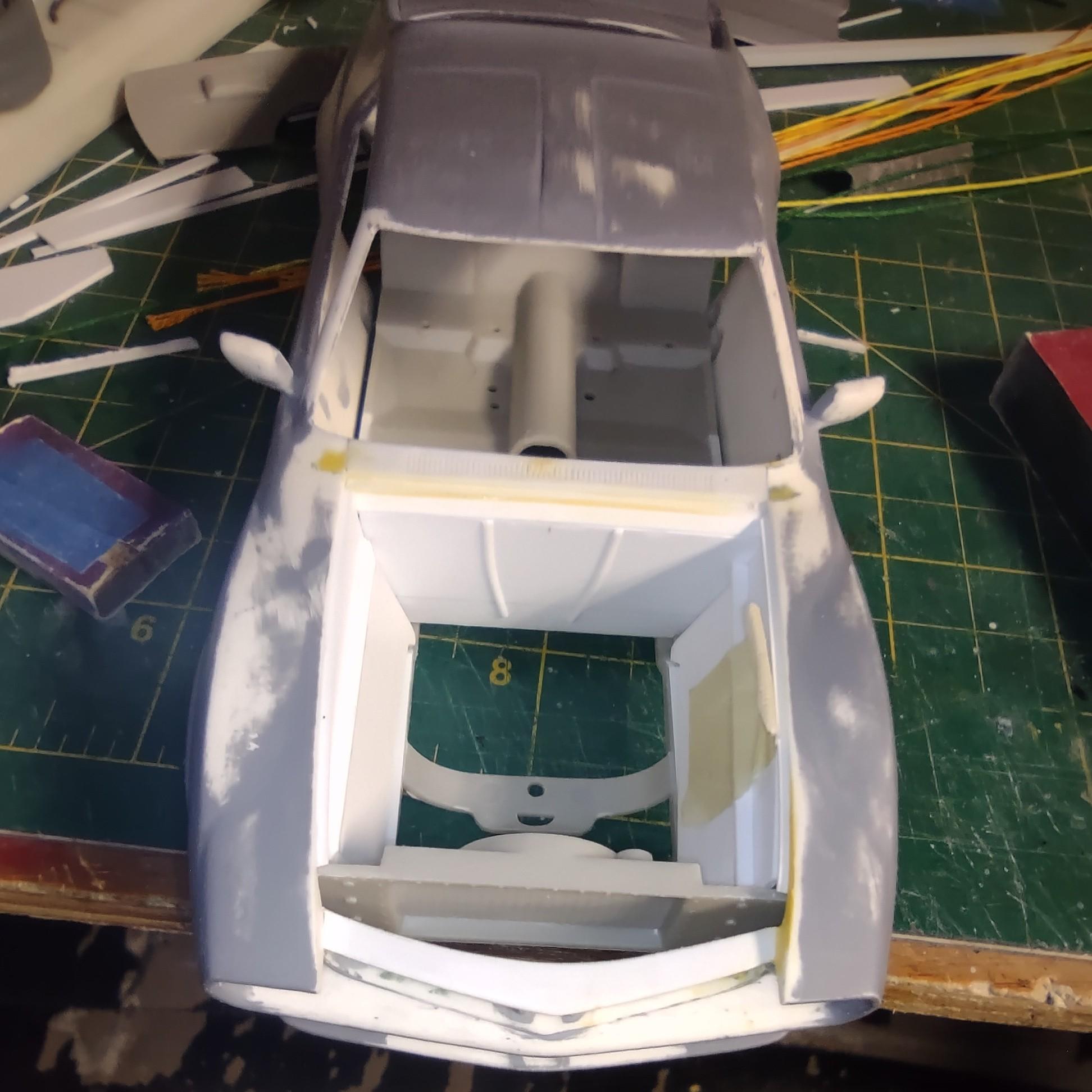

64SS350 Posted November 26 Author Posted November 26 (edited) Pre-lim engine bay unit.... Edited November 26 by 64SS350 4
