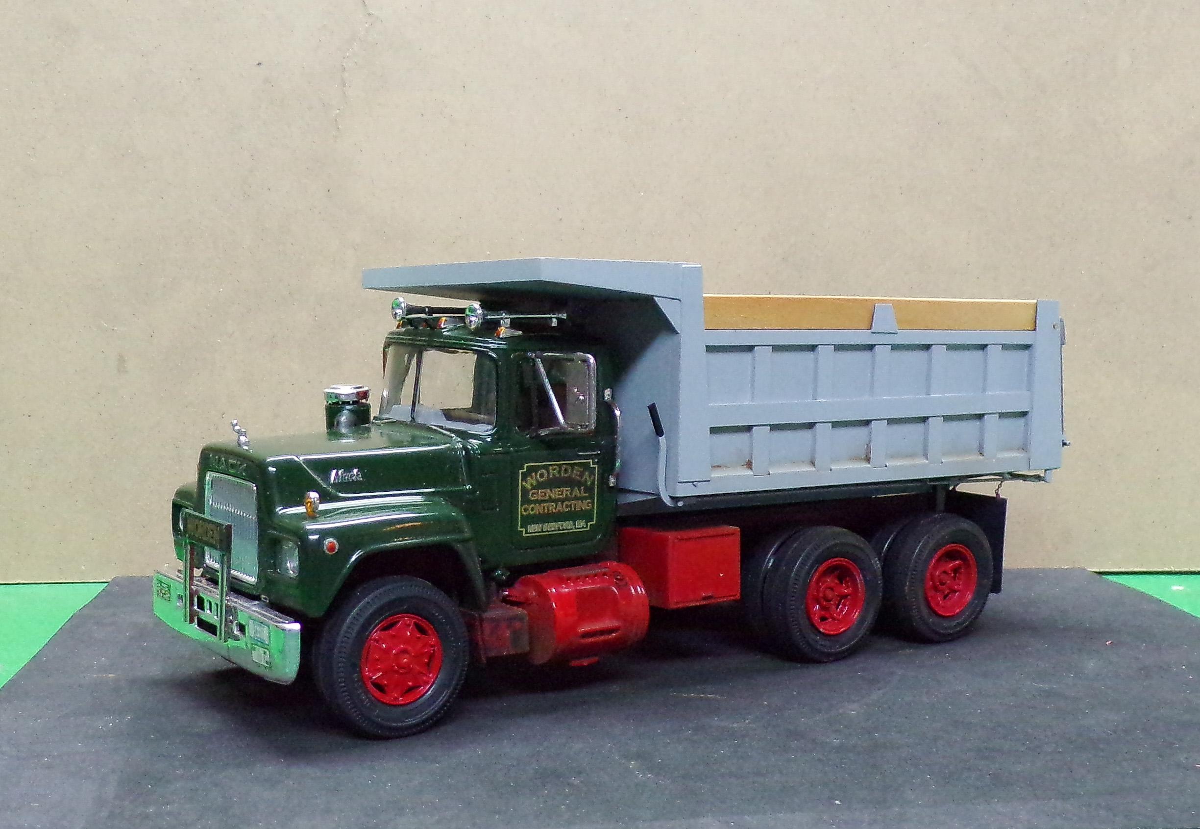

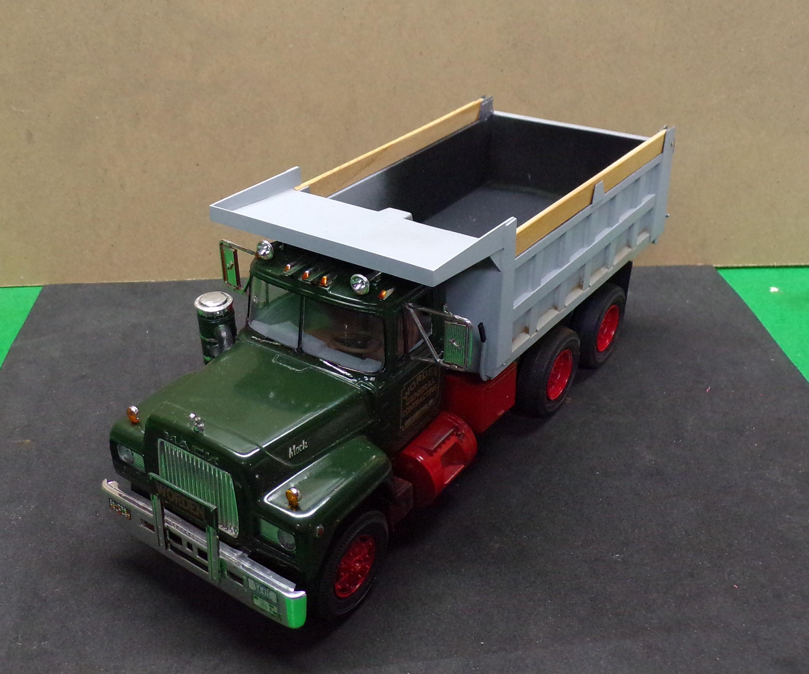

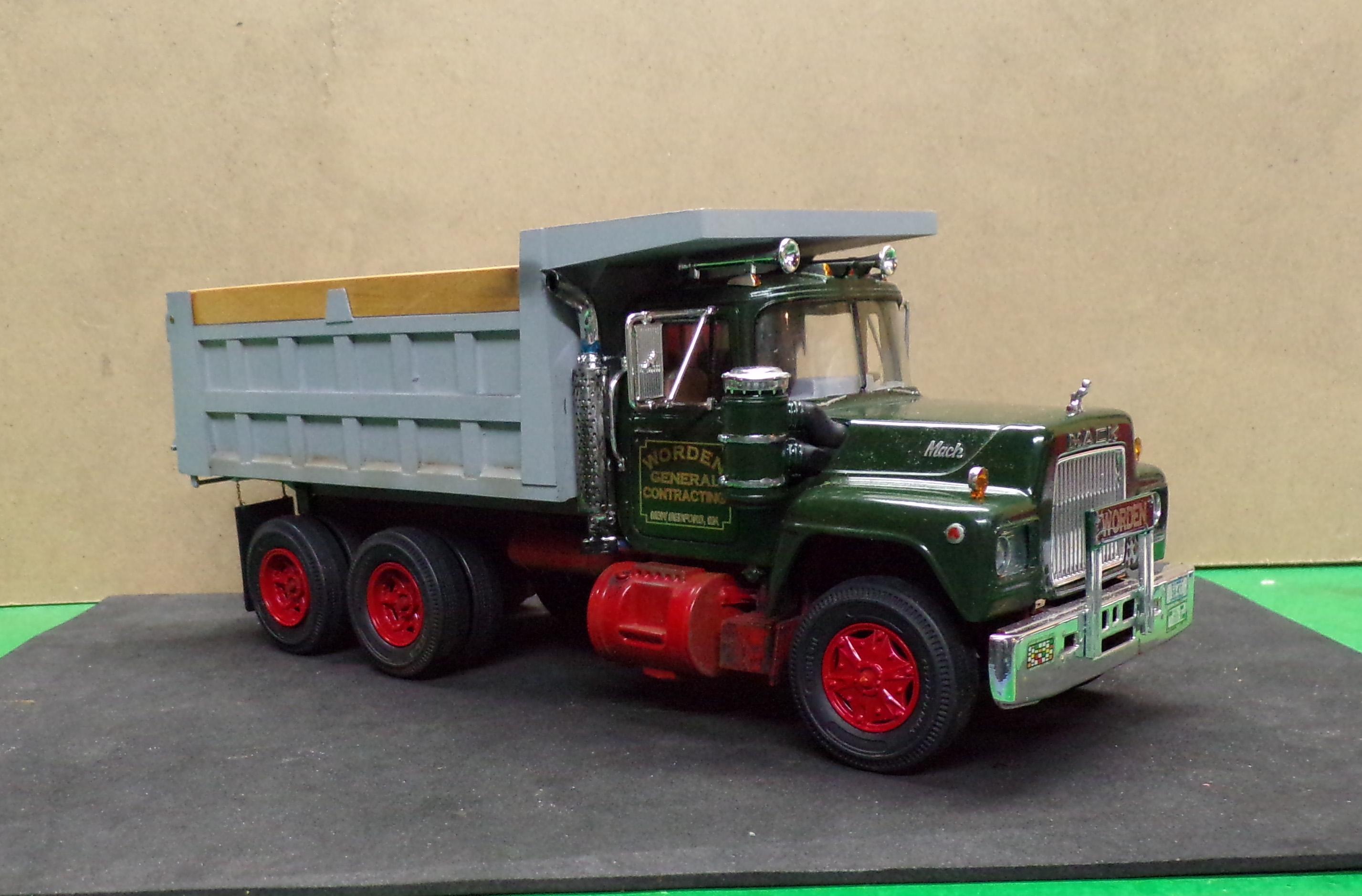

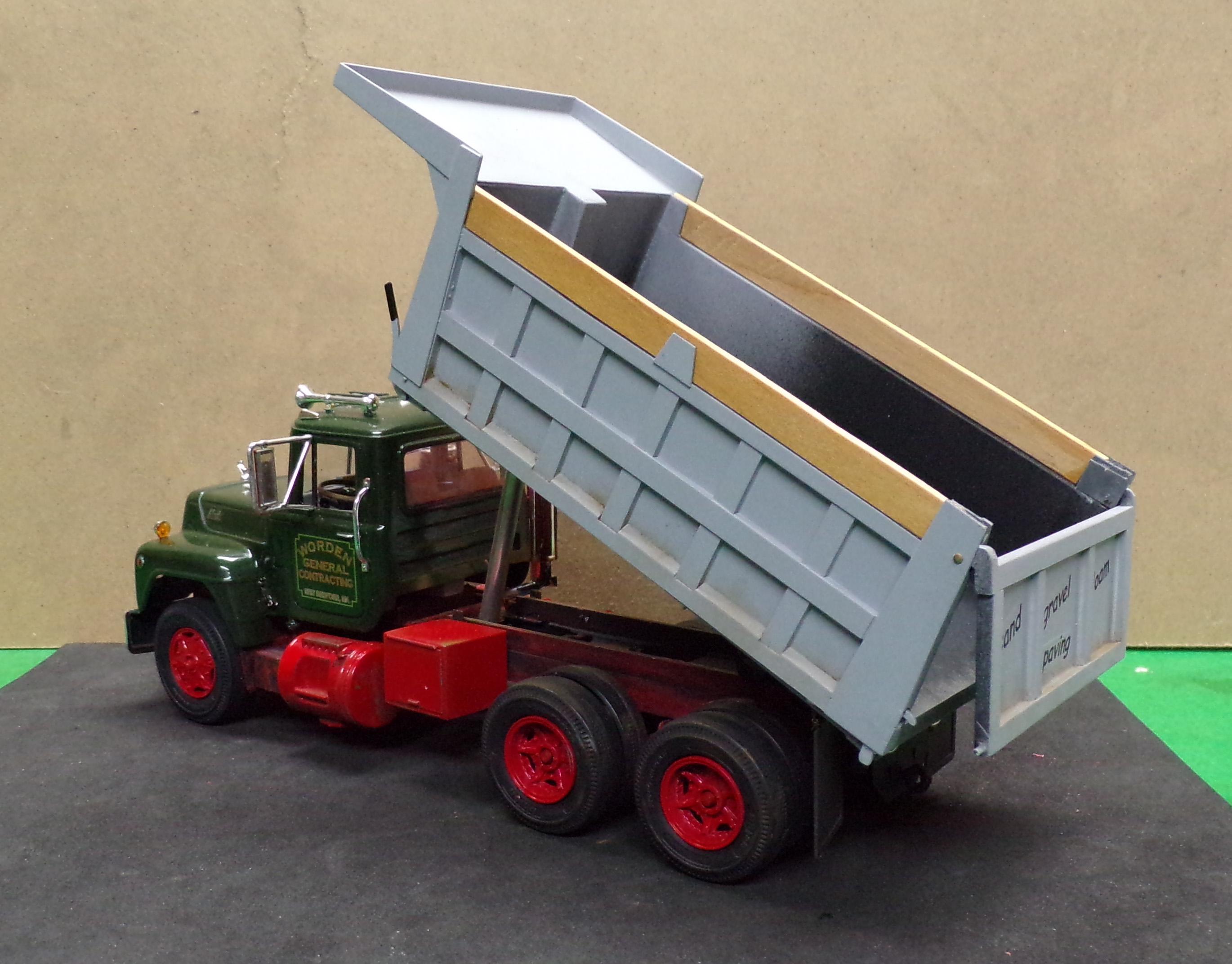

Chariots of Fire Posted November 23 Posted November 23 I should have taken photos of what I started with but the box art will have to do. This tractor was built up but not in good condition so I took all the pieces down, cleaned them except for the frame, which was left dirty and built a dump version. The sleeper was removed, a new back wall for the cab built, fuel tanks cut down, tool box and air tank added, new mud flaps and a new body made of Evergreen sheet and strip stock was installed. The paint on the cab is Tamiya British green. Red is Duplicolor and the body is Duplicolor primer gray. The decals were printed on ALPS. Zoet Chrome pens cleaned up some of the smaller pieces and Fusion Film was used on the modified exhaust stack. The hoist is made of aluminum tubing and the tail gate opens with the handle next to the cab. A fun restoration for a change.☺️ 13

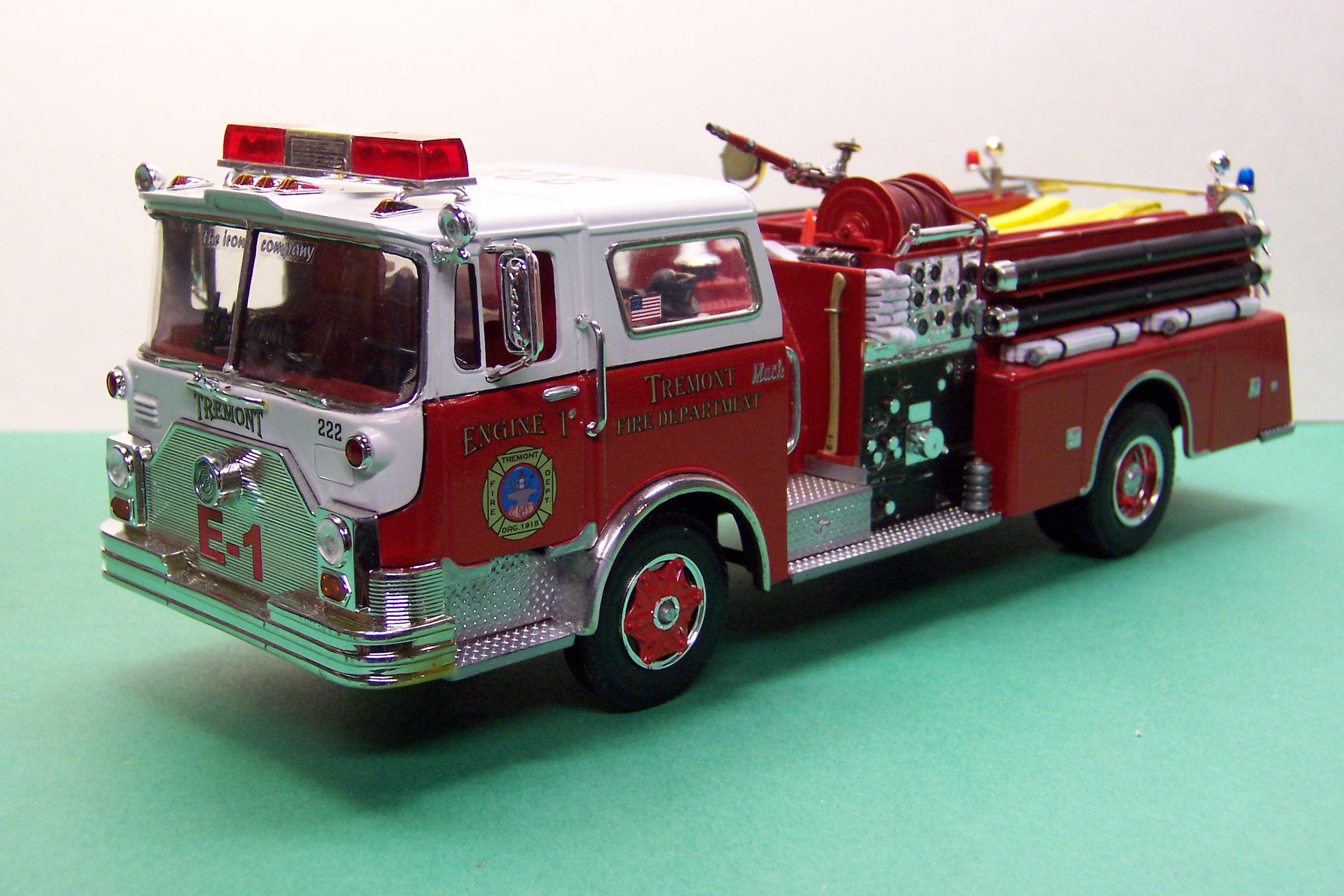

Chariots of Fire Posted November 24 Author Posted November 24 7 hours ago, Jim B said: Great looking Mack. Really well done. Where did the spokes come from? The Monogram Snap kit of the CF pumper has them. It takes two kits to get the 4 needed for the tandem rear axles. 2 1

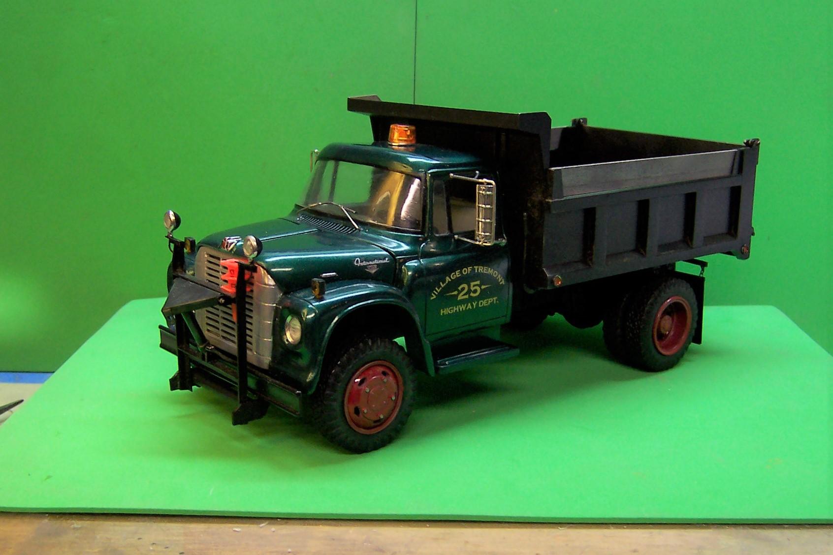

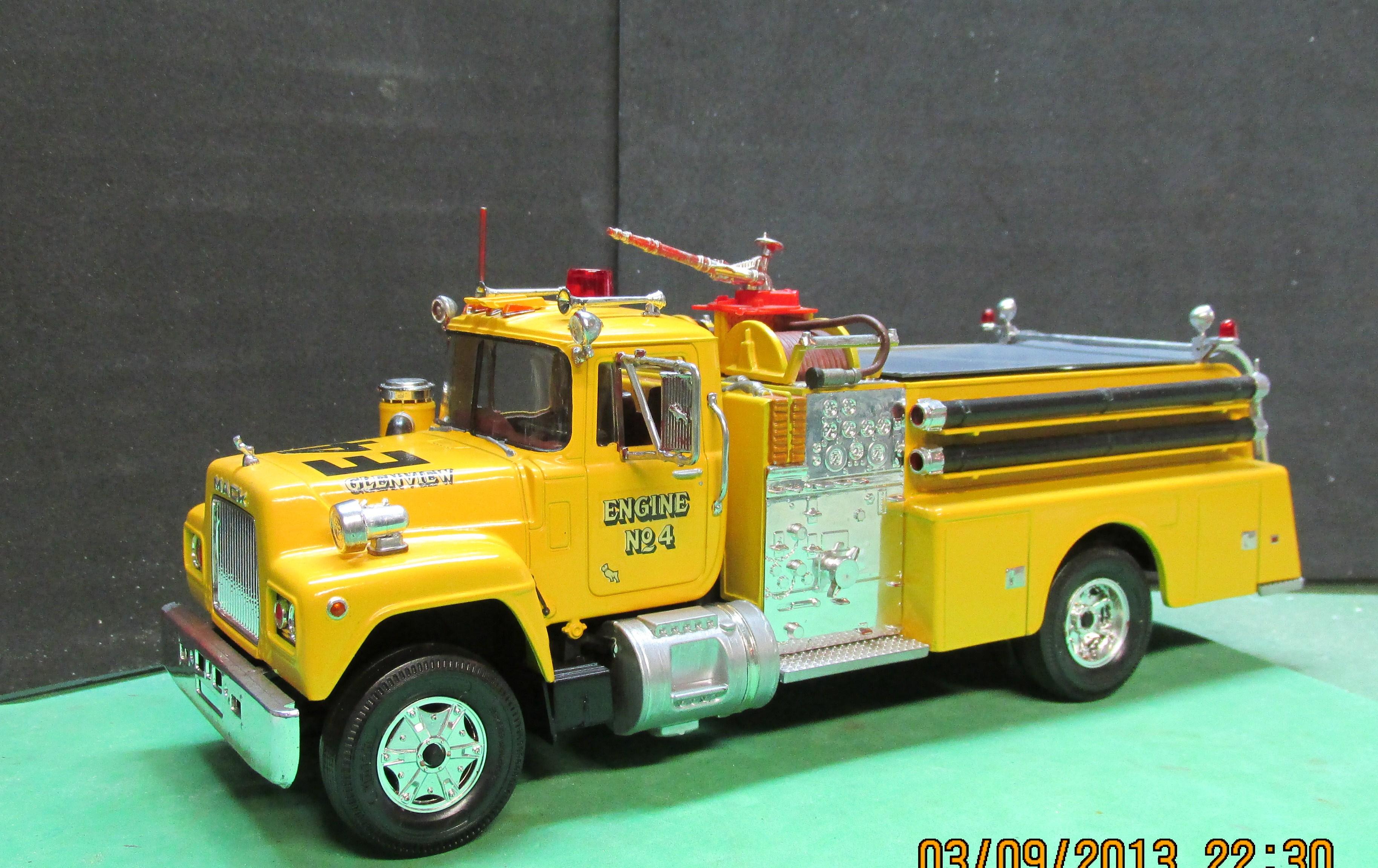

Chariots of Fire Posted November 27 Author Posted November 27 5 hours ago, Pete68 said: Beautiful build Charles. I like that dump bed. The Mack R pumper looks good as well. I have some 1/32 Don Mills Fire apparatus components I need to start using on some of the builds I’ve started. IH fan I see. Here's another dump for you. 1 1

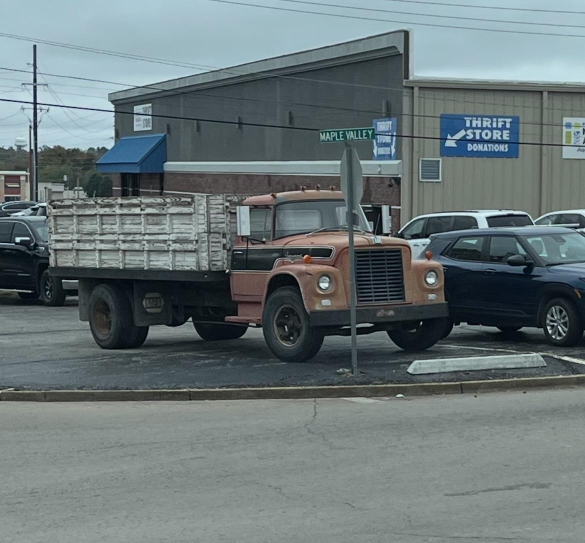

Pete68 Posted November 28 Posted November 28 3 hours ago, Chariots of Fire said: IH fan I see. You bet Charles big time and that is a beautiful truck I don’t remember this one but thanks for sharing. Is this the cab you created? I’ve been thinking of buying one from Dave’s Models and building a grain truck. There’s still quite a few still running around here where I live. I caught this one the other day in town. I thought it had a cool paint scheme

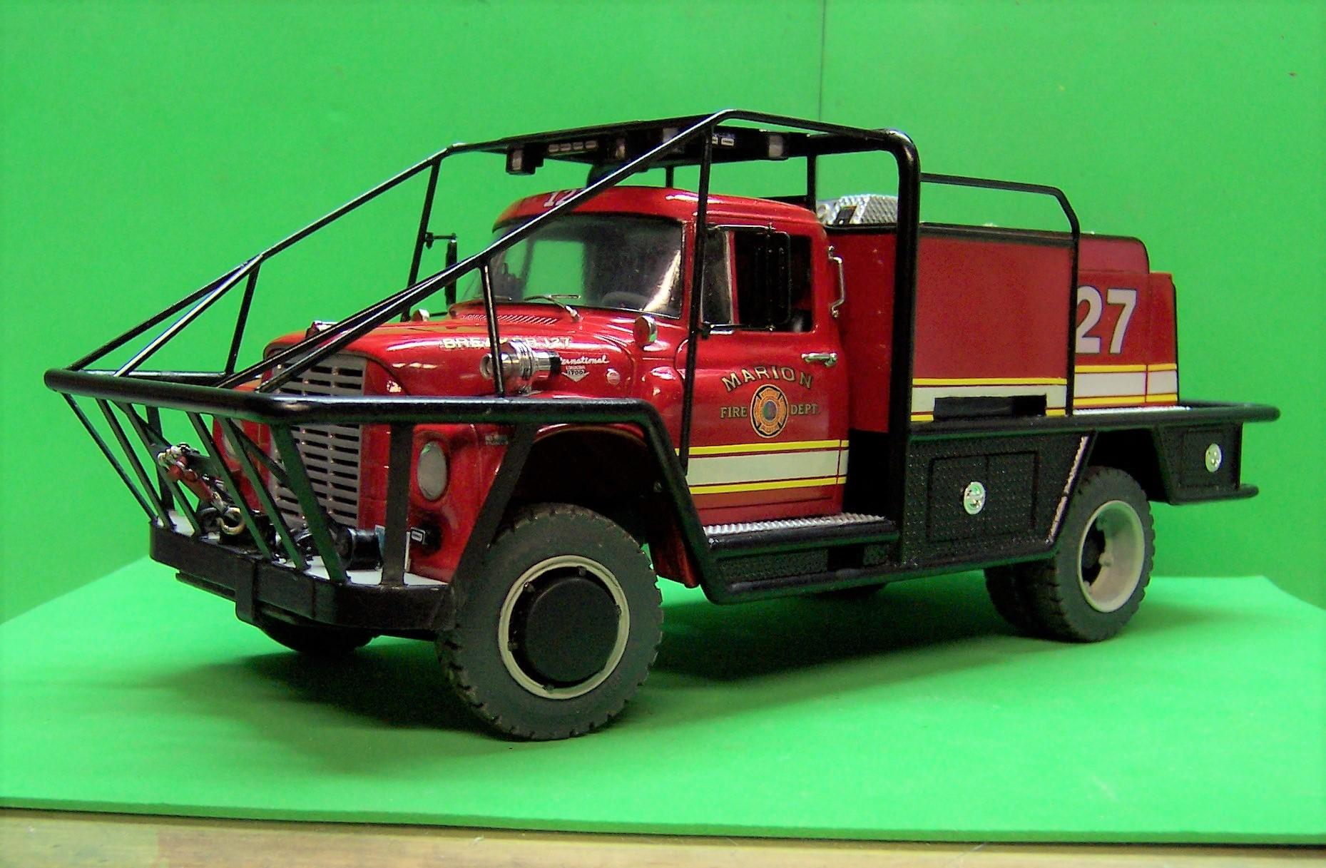

Chariots of Fire Posted November 28 Author Posted November 28 Yes, it is, Lee. Dave should be able to supply you with the cab and all that goes with it. Here's another one I did using the same cab. 1
Pete68 Posted December 5 Posted December 5 On 11/28/2025 at 9:17 AM, Chariots of Fire said: Dave should be able to supply you with the cab and all that goes with it. Thanks Charles I looked at it again the other day and I might get on after the Holidays I’m sure Dave is swamped right now. You did beautiful job on the Brush truck. I will probably make mine a Grain truck.
rekcirb13 Posted December 5 Posted December 5 Hi Charlie, You did a great job with this re-build! Is the dump body your own design or did you use factory drawings?
Chariots of Fire Posted December 7 Author Posted December 7 On 12/5/2025 at 10:43 AM, rekcirb13 said: Hi Charlie, You did a great job with this re-build! Is the dump body your own design or did you use factory drawings? Hey, Bob! Well, a little of both. I found a Mack dump image on line that was a great side view. I saved it, brought it over into the graphics program and resized it to fit the model. Then used the image to make up the sides. Everything else went from there.
