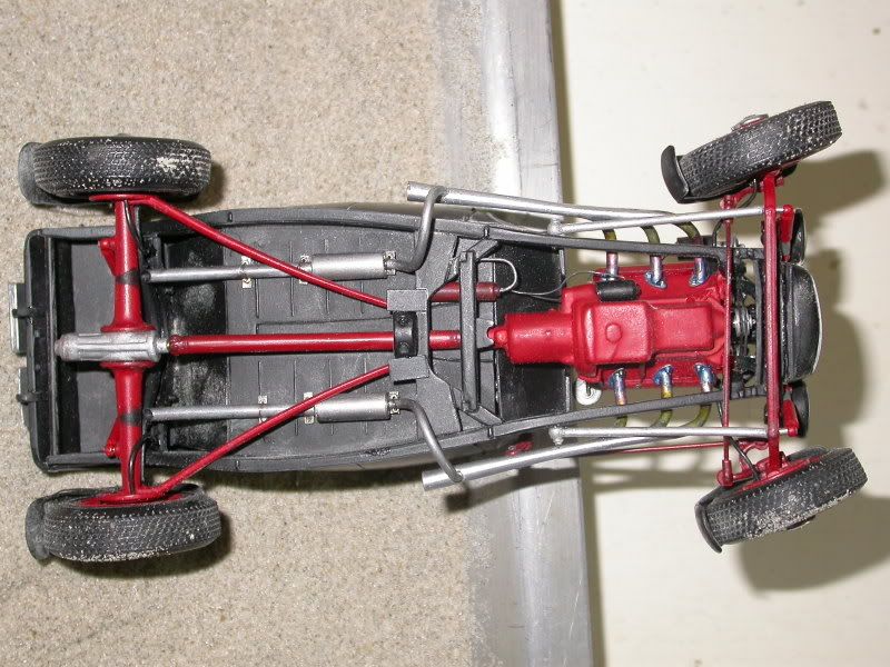

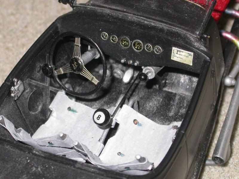

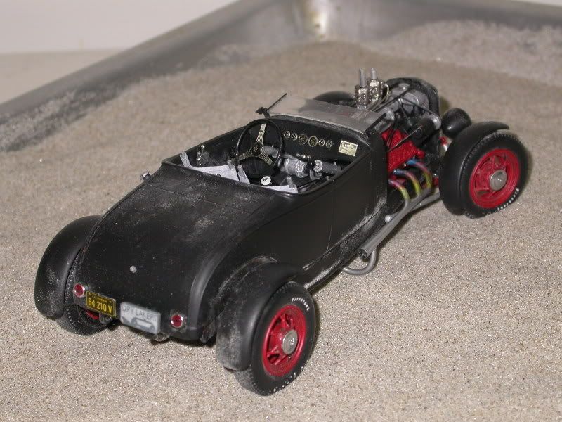

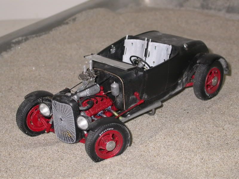

Paul Payne Posted September 9, 2010 Posted September 9, 2010 Great build, especially as a replica of an original 40's rod. I built a 29 a-v8 a few years back using a junker 29 Ford body and new 32 frame with a flathead v8. Here are a couple of pix: I tried scratch building a Gordon Schroder steering box like Doane Spenser used in his deuce, but it came out a little large. I used it anyways, too good to junk!
Alyn Posted September 10, 2010 Author Posted September 10, 2010 Your right, Paul, the steering box is a bit large, but that pressure pump next to it is a great touch. That's a great looking rod with tons of neat features. It's the kind of build that the more you look, the more details keep popping up. Nice heat staining on the headers, and I noticed the exhaust stains on the axle too. The seats are great and the door latches are an especially nice detail. I also like the way you folded down the windshield. I may have to rip off the eight ball shifter. Now that I see yours, I think that would have been a better choice for mine. The cycle fenders are a great choice too. Thanks for posting the pics. I really like it. Our 29's seem to have quite a few things in common.
Paul Payne Posted September 11, 2010 Posted September 11, 2010 They are both 1940's hot rods from the dry lakes era, and it doesn't get any better than that! Race?
