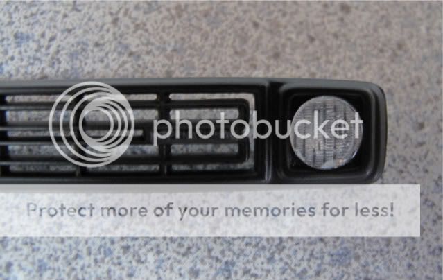

You can always drill out the offending unrealistic headlight & glue a chromed bucket behind, use a new lense & transform it completely. I modded a Scout grill this way...
