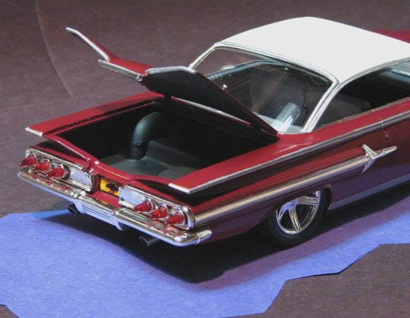

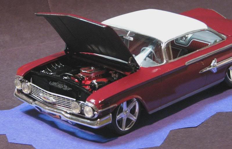

Okay, I'm done mine!!

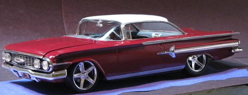

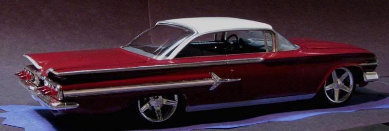

Original Artwork that I was given at the start:

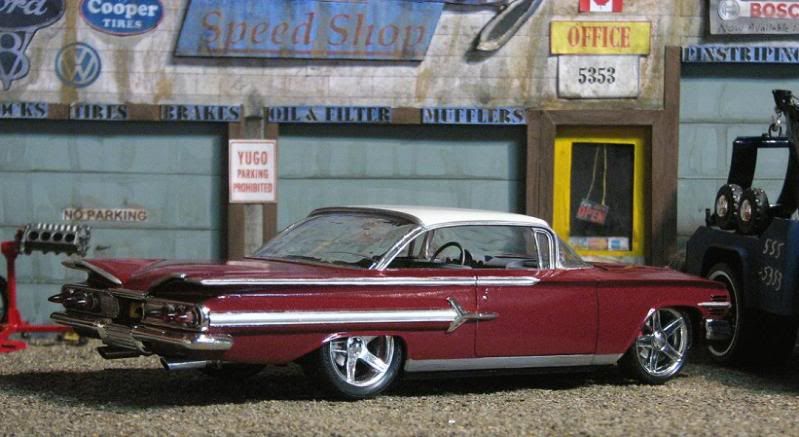

Picture of my build (with craft paper black & blue to look like the photo):

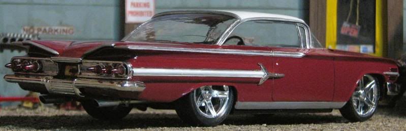

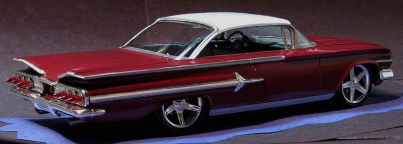

Slightly different angles:

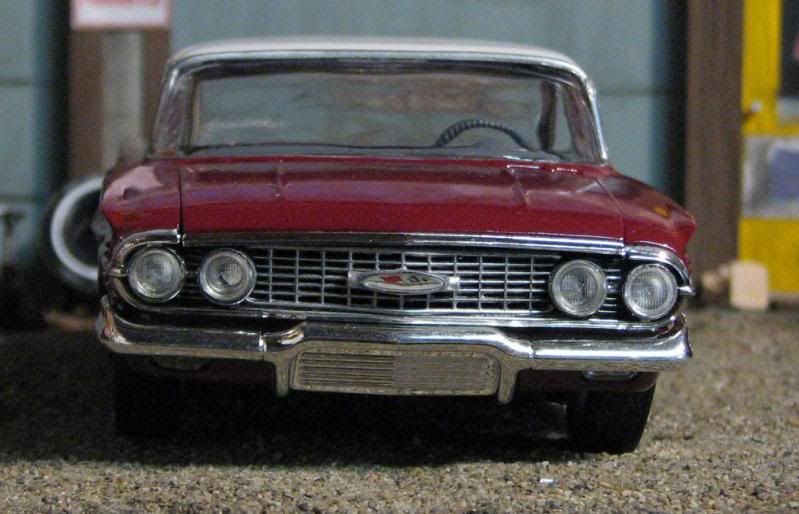

Used Sidewinder kit wheels and tires as the original caption indicated. Also used Revell Viper kit brakes, and the brakes and wheels popped onto the kit suspension with no issues-the wheels do roll!
Used the Revell B-M '69 Camaro grille in place of the Impala kit grille, and cut the Impala emblem out and used the decal.
At the rear, on the decklid I shaved and filled the rear trunk lock. I should have slightly shortened the Caddy taillights. These were in the kit, and just used Tamiya clear red for the middle pair as they were molded in clear for the reverse lights.
This was the kit:

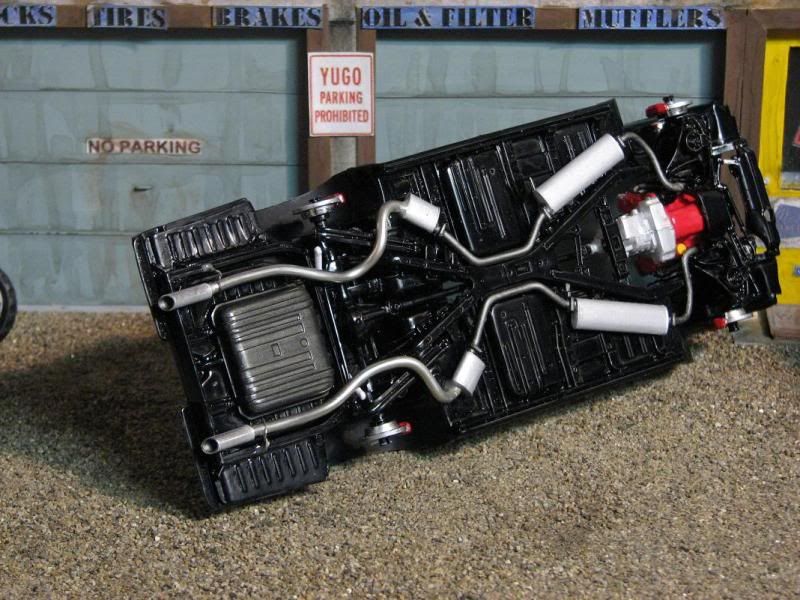

The chassis-Rear wheel tubs cut and material added to make room for the lowered suspension and big rear wheels. Cut the 59 spare hump out and added ribs. Rear of the exhaust is solder, and aluminum tubing:

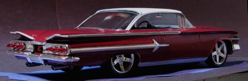

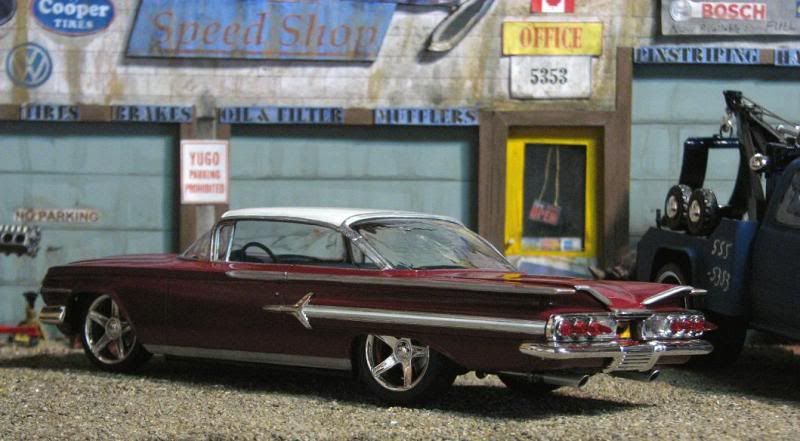

A few more pictures:
Enjoy!! Here's a link to my build album if you'd care to take a look.
This was a fun build, and am looking forward to seeing how others built theirs!!

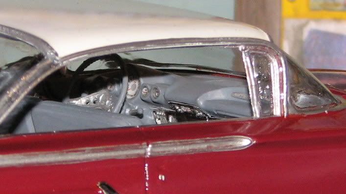

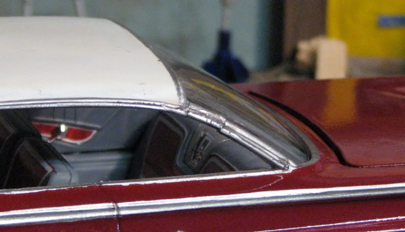

Just after taking these pictures...the model accidentally fell on the floor-I could kick myself! I caught my sweater sleeve on the craft paper base, pulling it off the table, and it fell square on the roof on the floor from the table...I got it back together but the rear roof pillars are a mess-the left one broke, the right one crimped, and the rear glass popped out, and has a crack at the lower right...No other damage, but a few scratches, which another coat of Future will cover, and a couple of parts came off...the rear pillars look terrible, especially the left one. This will still look great on my shelf!
EDIT: So after looking at the remaining damage, I was able to use a clothes peg to clamp the c pillar to the rear glass, and run a bead of clear. We'll see in the morning if it holds. The left c pillar may be able to be touched up, and may hide the repair not too badly.

Thanks, Tom...yeah, I was kind of stunned for a second there! It seems to be not too bad on inspection this morning - the left c pillar breaks are visible, but not too bad, considering. The crack in the back window is visible, but like I said-it will be fine on the shelf. It sure could have been a whole lot worse than it was!

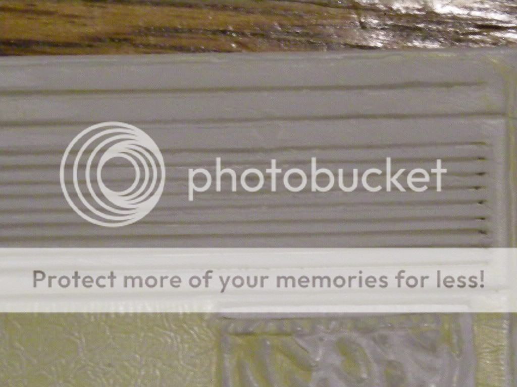

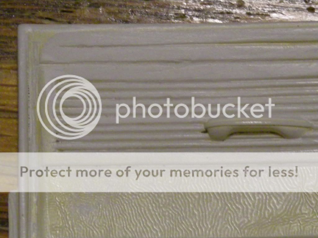

First of all I shaved the handles off of the interior panels. I'm going to put some P.E. power window switches on. I've had them for years and keep forgetting to use them. here are the shaved panels.

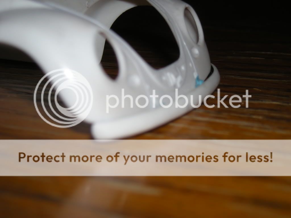

Got a bit more progress made these last couple of days. I sanded the welting(??) off between the body and fenders to clean up the front and back ends a bit.
I also filled and sanded the original mounting holes for the bumpers and started adding the height to the bumpers. What I did for this was judged where i wanted the extra height. I determined that from the way the bumpers sat in relation to the body the rear bumper needed the height added on the top and the front needed it added to the bottom. I started by gluing the half round strip to the respective edge then filled in the gap with some hex rod that was all I had on hand that was small enough to work.
Here is the front bumper before putty and sanding.
