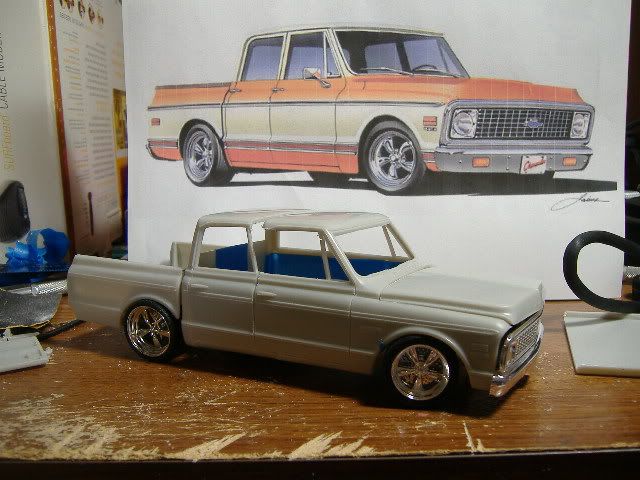

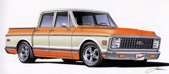

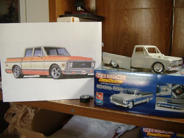

Tumbler75 Posted April 9, 2010 Posted April 9, 2010 (edited) Ok, Let's get this shindig rollin' shall we? I am honoured to do this truck. It's been a project I've wanted to tackle for many years but too scared to do it, UNTIL now! I feel my skills are strong enough to pull this off now. So, with that said, let the fun begin! Modellers, Start Your DREMELS!!!! The Illustration of Inspiration: The Beginnings of the Model: The other 72 Cheyenne kit is behind the illustration I printed off for reference. I'm using Pegasus 19" and 23" Torq's (rear having lower profile rubber than the front) and 19" Discs. I've started figuring up where the cuts need to be made. With that said, it's back to the desk and start cutting up some plastic!! Enjoy! Edited April 9, 2010 by Tumbler75

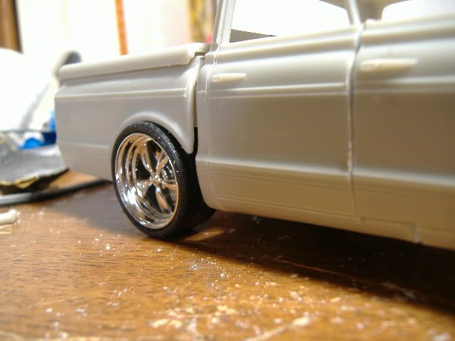

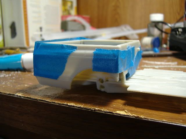

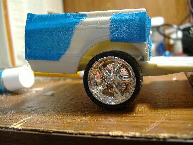

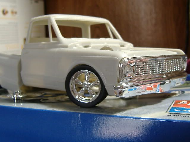

Tumbler75 Posted April 9, 2010 Author Posted April 9, 2010 Thanx for the encouragement! Jairus I'm going with Two Cabs jus' in case I mess somethin' up I got a li'l bit of back up. LoL Well wait no more for a li'l bit of an update! I sat here till 3:15pm after starting around 10am working on the bed. I can't find my dremel!! SO! I eyeball engineered everything and I'm actually quite happy with it! Once the bed dries completely I'll get better pics of it. Here's pics! More to come hopefully soon! Enjoy!!

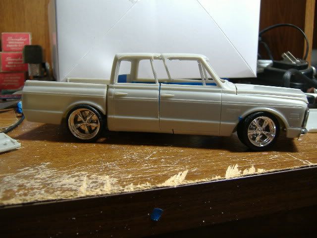

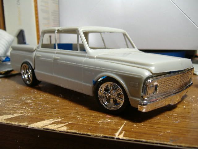

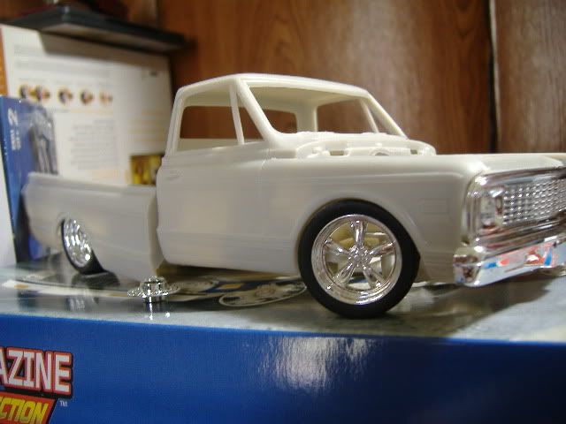

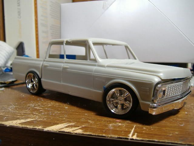

Tumbler75 Posted April 10, 2010 Author Posted April 10, 2010 Well, I got the basics done of the conversion. Now it's time to start all the bodywork and move along to the frame, motor, and such. Nothin's been glued as of yet but will be soon. I cut it as li'l as possible so I didn't make any mistakes (as I've only got two of these kits and nothing as a backup), but enough chatter. Here's the pics. Enjoy!
