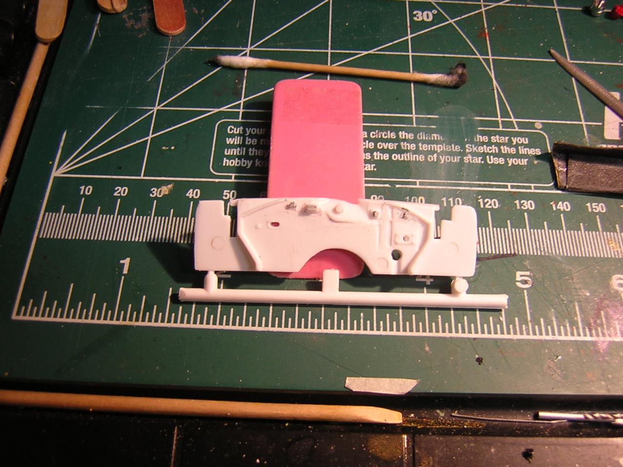

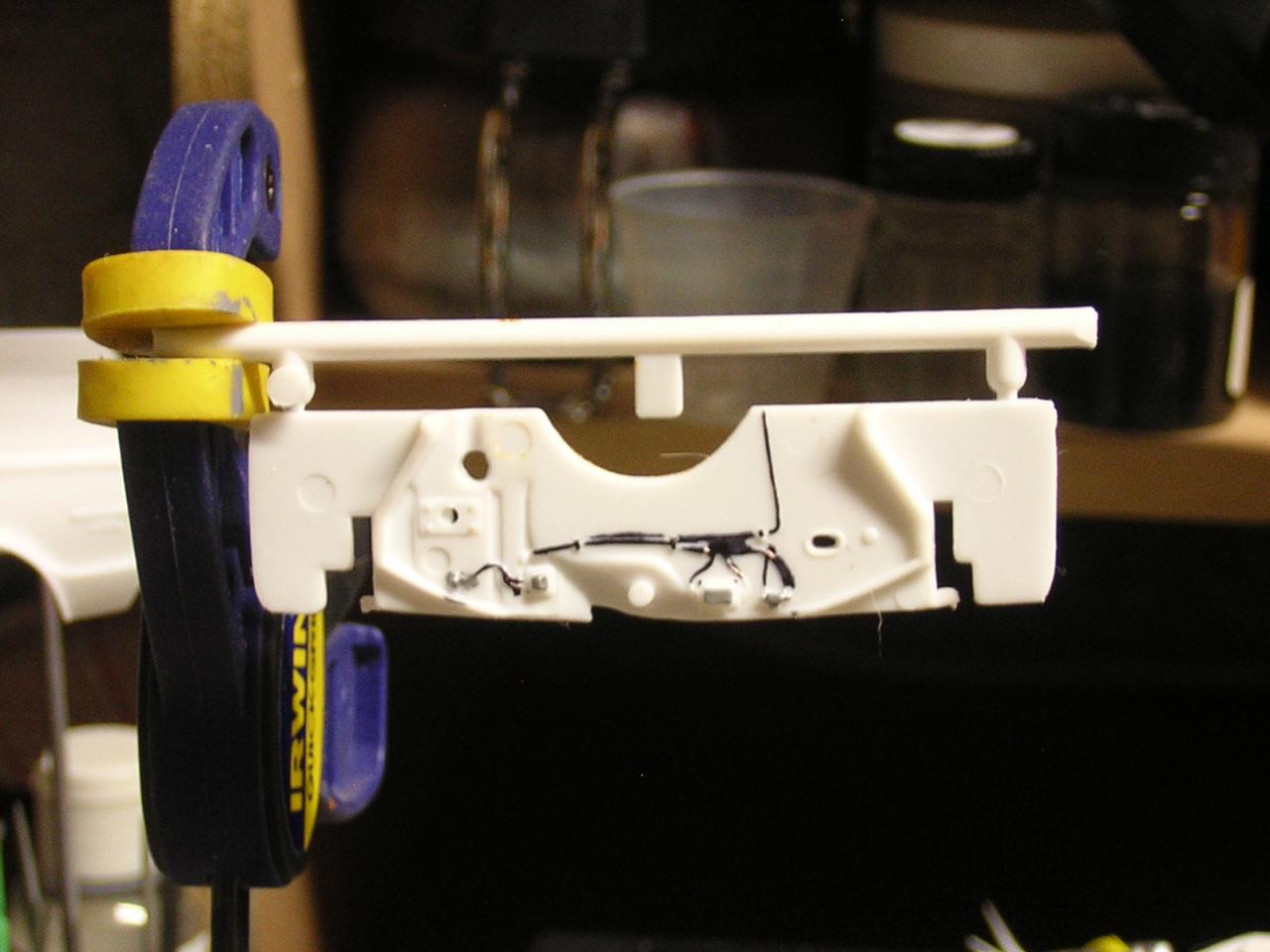

cchapman195 Posted June 1, 2012 Posted June 1, 2012 Okay here are some pics using string. First I have marked all wires with a sharpie so you can see the pattern. I then sand it down with 600 grit and file. Now drill a hole where you want wires to come from. Paint, polish firewall. Cut 4-5 black pieces of string and run through the hole you cut. Glue the string onto the backside of firewall. Then just cut and run string to the proper firewall electrical units. Glue each piece to firewall. Thats about it. You can use any color thread you want. Photo's of actual car you are building can help add other wire and actual color of wires to replicate original. Not hard to do, just have fun with it. It does make you feel a little gitty about your mad skills when you are done lol.
