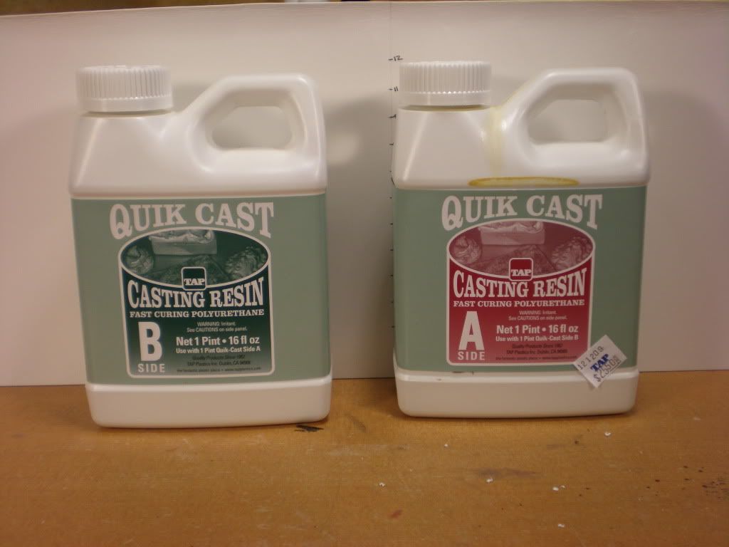

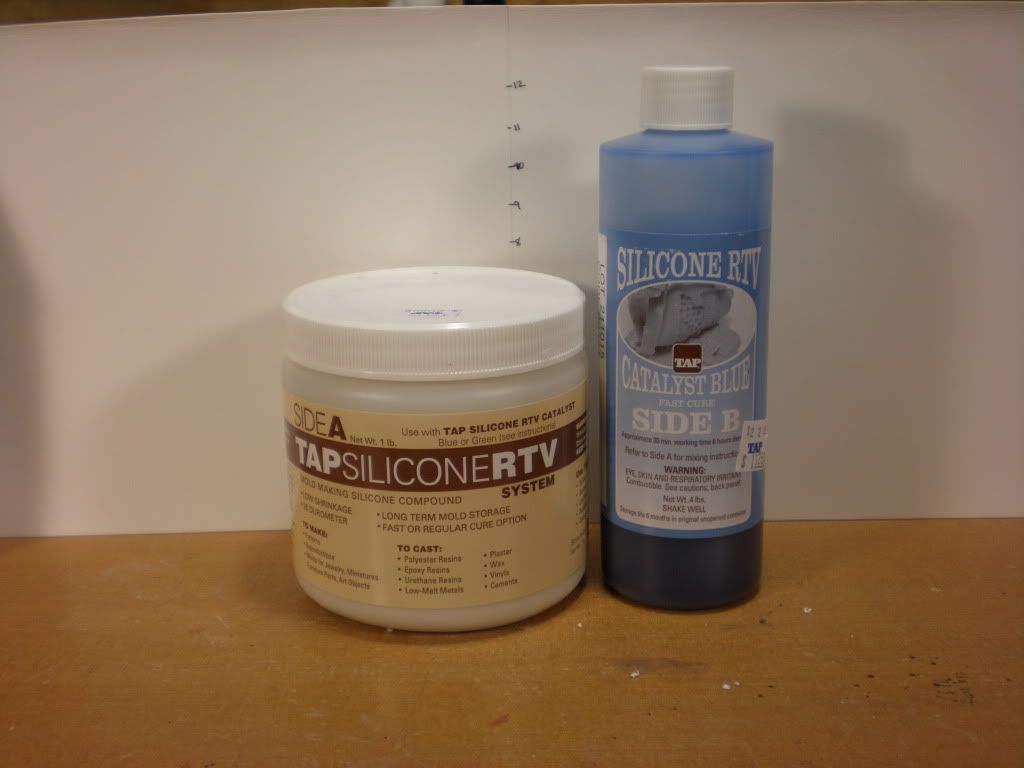

Here is what little I know.
Tap Plastics has some really good stuff for casting parts.
http://www.tapplastics.com/shop/product.php?pid=61&
This is what I have used and it works well.
Molding making stuff (9:1 ratio)($32 for the pair)
To cast the part (1:1 or 50/50 (half & half)($25.50 for the pair)
Actually a touch more part B than Part A works good.
Casting bodys? I don't know about because it would take a lot of the RTV Silicone RTV
to do it and ya really gotta be good at it.
Edited by Zukiholic
Link to comment

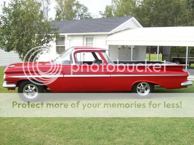

Impcon, is your side molding on a flat section of the body?

Hey Shucky! The side moldings are from a '59 El Camino and yes, they run along the side of the car from front to back. They are reasonably flat, yes.. but delicate becayse they are very shallow and actually, to be done properly, they aill actually be two very slim seperate pieces of trim that join each other at front and back of the car. 59ElCamino.jpgIf they are cast too thick, they will protrude from the side of the car and look ridiculous... I have considered making the piece of trim from two seperate strips of styrene but getting the stuff formed right is a bit beyong my current capabilities. I'm going to add some side moldings to another project using strip styrene but the El Camino moldings are too complicated - I think. My life is pretty complicated and full these days so I can go for a few days at a time and not touch any of my projects. I am still working on my '63 Mercury Meteor and '61 Chevy pickup annual and what I am doing is trying to get a bit of a jump start on these other upcoming projects by trying to figure out and learn how to do what I really want to do.
