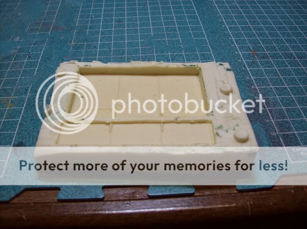

highway Posted August 19, 2010 Posted August 19, 2010 Alumilite has an excellent DVD also. Kinda like "old man" said ... it may not exactly be the products fault that your results aren't what you expected. There is a learning curve with all these products to achieve the best possible results. Reading the directions carefully would help also, thats no joke by the way. I also agree, and I found the Alumilite resin quite pleasing to work with, I started with what I believe is the same mini set you are referring to and liked it so much I bought the larger bottles. As some have said, though, the mini set will not go far, and when I made the trip back to the Hobbytown I bought mine from (over 100 miles away!), they were out of the mold rubber, that's why I only have big bottles of resin. I personally have not had any issues with their mold rubber, but all I was able to make from the starter set is this one for a tractor trailer headache rack and a couple very small part ones, but I have gotten about 10 casts out of it with no problems. This is one of the boxes I made with their resin, and follow this link to see one I traded here actually on a truck: http://www.modelcarsmag.com/forums/index.php?showtopic=31022 Of course, like others have said, too, it does set very quickly. I forgot that one time after not using it for a while, and this is what happen, a headache rack that turned into some sort of modern art!!
