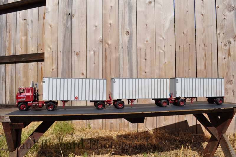

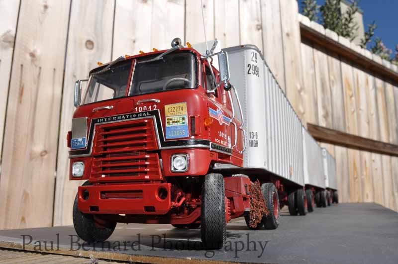

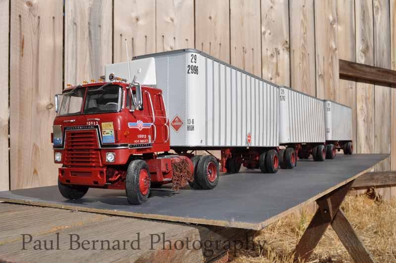

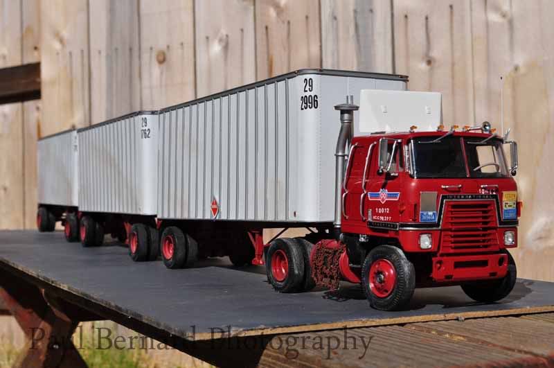

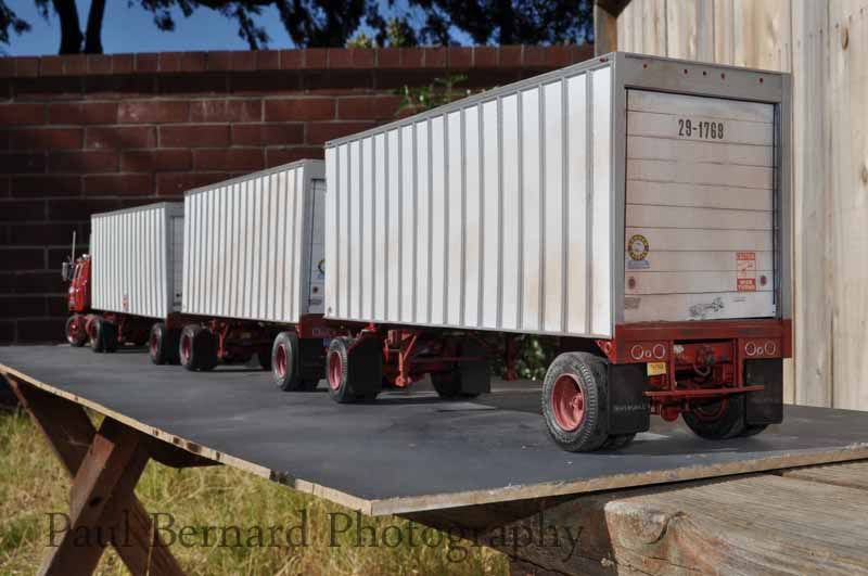

Finally finished this afternoon. The tractor was finished last December. Trailers are from an AMT Double Header kit and a third trailer from a US Mail kit. Wheels are Wicker two hole Budds. Pintle hitches, gladhands, electrical connections are from Platkit. The rear of the trailers were generally lacking in detail and looked like a flat piece of plastic. I therefore detailed the door frames with styrene and built new bumpers. The rear door panels were all individually separated then glued in place. The door cables are small diameter styrene rods, thread just wouldn't provide the correct tensioned look. To my knowledge System 99 never used exterior post vans and these trailers were built to be generic so that they can be used with other tractors as I complete them.
