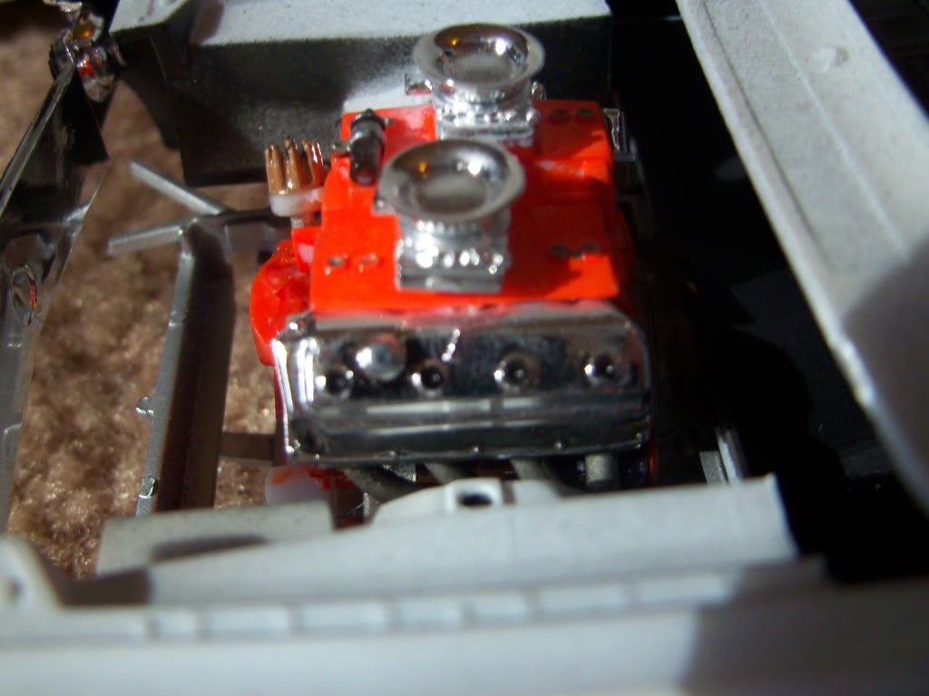

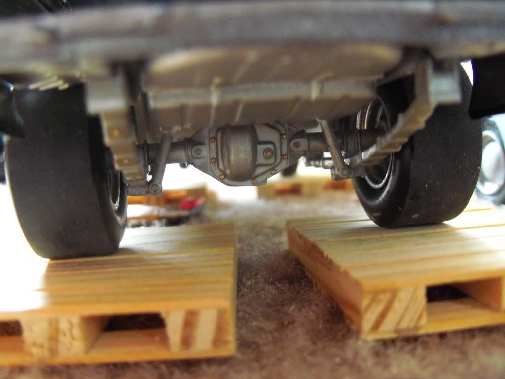

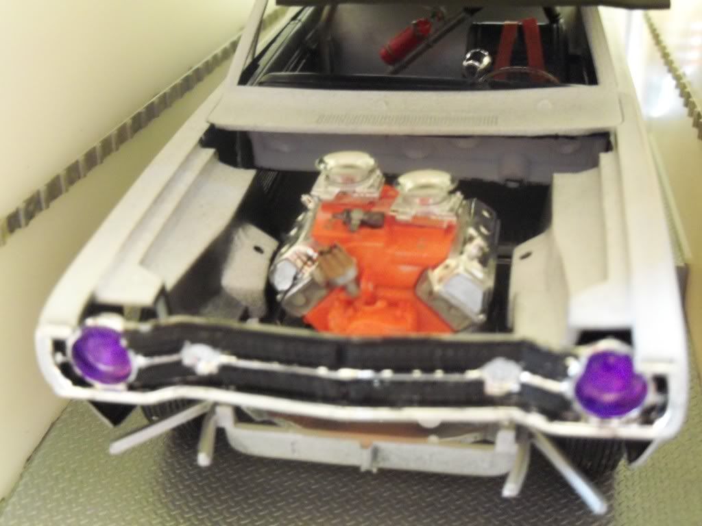

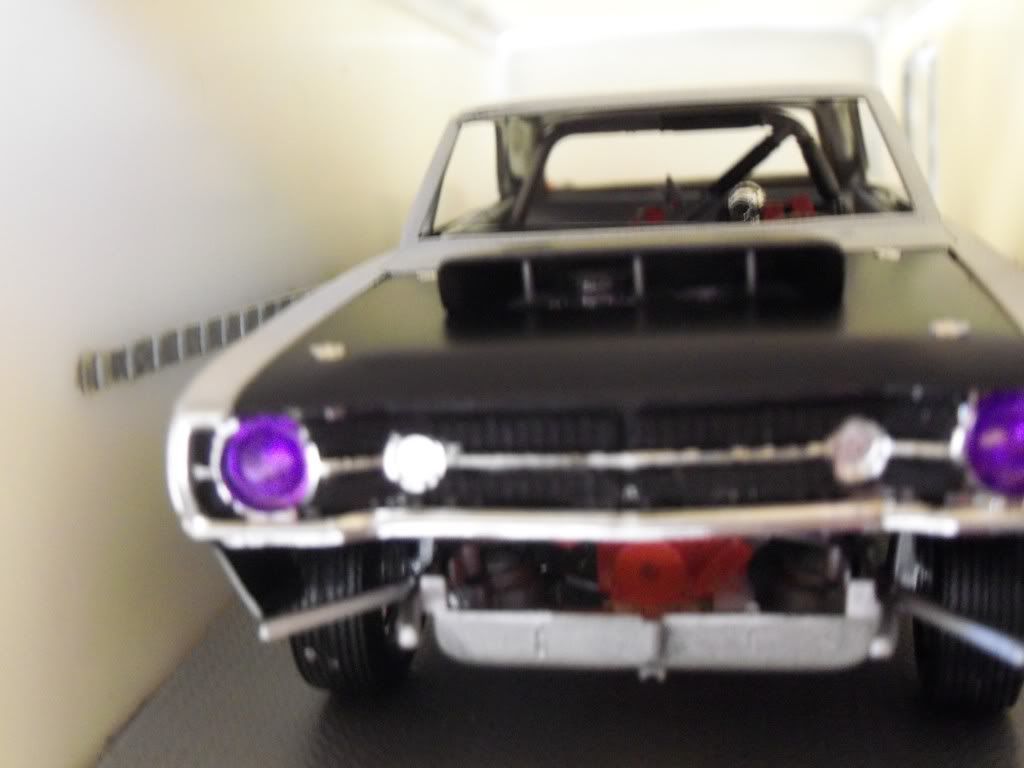

SuperStockAndy Posted February 17, 2011 Posted February 17, 2011 I picked up a '68 Dodge Dart from a guy I know. He was forced to sell it due to the economy, and he only wanted $8200 for such a rare car! I HAD to have it. I drove the El Camino out of the garage, hooked up the trailer, and headed off to his house. He had partially started to build it for drag racing, but had to put it in the shed because he had no time to work on it. The engine was a 426 Hemi Max Wedge. It wasn't completely built, but 90% of it was there. We pushed the Dart into the trailer, I paid him, and I headed back home to fully check it out. Everything was in great shape! It looked like the engine only needed a few parts, and the chassis and interior were complete. The were a few body parts, like the front and rear bumpers. It also needed glass. One of my favorite things about the car was that the headlights were tinted purple. He said he orginally wanted to paint the car Plum Crazy. I was going to paint it black, but then I got to thinking. Then I realized that Plum Crazy does look good! It was already in primer, too. Here are some pics when I got back home: When I do more to this Dart, I'll keep updating this topic. Thanks for looking! Hope you enjoyed my story!

whale392 Posted February 17, 2011 Posted February 17, 2011 Cool story and great start to this build. I just have one thing for you Andy....it is a 426 Maxi Hemi, NOT a Max Wedge. The Max Wedges were the RB series block with the wedge heads (not the Hemi heads). The 426 Hemi came from the wedge platform, but has relocated and an extra row of cylinder head bolts, plus is 4 bolt-mained on #2,#3, and #4 mains. They both have the short 4x2 crossram intake, but again the wedge intake will not bolt to the Hemi due to the extra width of the Hemi heads, and the intake port spacing/intake bolt locations. The 426 Max Wedge was availible late 63 and early 64 (taking the place of the 413 Sonoramic Commando) and the Maxi Hemi was availibly late 64 and 65.........then again in 1968.

SuperStockAndy Posted February 17, 2011 Author Posted February 17, 2011 Thank you all for the comments! 426 Maxi Hemi, NOT a Max Wedge Oops... I knew it had "Max" in it somewhere... Max Wedge was the first one to come to mind!
dwc43 Posted February 17, 2011 Posted February 17, 2011 Actually, you both got it wrong. There is no such thing as a Max Hemi. There's the 426 RACE Hemi in race Hemi orange that sported a factory 12.5:1 compression and solid lifter cam. Then to meet NASCAR's demands for a certain amount of street cars to have the engine available a second Hemi was produced for the assembly lines. IT's called the Street Hemi and it's painted Street Hemi or just Hemi orange. There are two colors and one is much lighter orange than the other. The street version has 10.5:1 compression and a hydraulic camshaft slightly smaller than the race version. 284* .484" for the street version. And most street versions got the inline dual four intake, but, there are cross ram versions of the street Hemi as well.
whale392 Posted February 17, 2011 Posted February 17, 2011 (edited) Thank you Dave. If you want to be technical, yes it was called a Race Hemi. HOWEVER, it is refered to (in factory literature AND press) as the Maxi(mum Effort) Hemi (following in the lines of the Max Wedge naming scheme). Depending on whether the 'Hemi' was destined for NASCAR or NHRA dictated intake and compression ratios. The 'Max' Hemi was 12:1 compression, with the aluminum (some were magnesium) short-ram intake. NASCAR banned the Hemi in 1965, stating that it was NOT a production engine, yet the Maxi Hemi soldered on in NHRA classes. 1966 saw the introduction of the 10.5:1 'Street Hemi' to homologate the engine for NASCAR. It also saw the death of the 'Maxi' Hemi under NHRA for the reasons of the Street Hemi intro (yet I know of and have seen documented ONE 1966 Maxi Hemi). The Street Hemi was actually solid-lifter with adjustable rockers in 1966 and 67, 68-71 was hydraulic lifters and non-adjustable rockers. Also, the 1966-67 inline2x4 intake was different than the 1968-71 intakes in casting stampings and heat riser tube inlet geometry. 1968 RO23 and BO29 cars had a Hemi very similar to the 1964-65 Maxi units, with very little revision (mostly valvetrain and head revisions). From the factory, NO Street Hemi got anything but the inline2x4 intake. Now, quite a few aftermarket manufacturers offered different intakes for the Street Hemi (one had interchangable upper plates that even allowed the 440+6 3x2 carb set-up to be run). As to color, the 'Maxi' color is Much darker red-tinted orange than the Street Hemi lighter orange. Edited February 19, 2011 by whale392

Carmikeman Posted February 19, 2011 Posted February 19, 2011 need to get some wires and coil on that thing so we can hear it run. nothin worse than a silent Hemi!!! lol

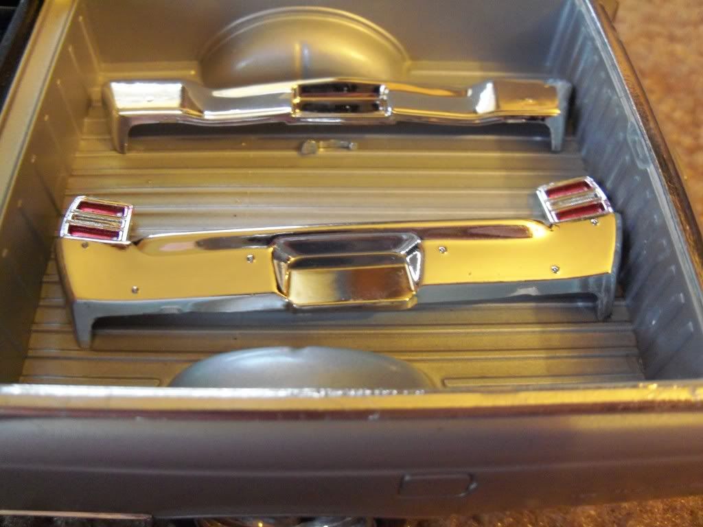

SuperStockAndy Posted February 20, 2011 Author Posted February 20, 2011 Thanks! @Whale392- I have ordered body parts, they should arrive today. @Carmikeman- I have completed the engine, just gotta fire her up.
stewart Posted February 20, 2011 Posted February 20, 2011 Did you paint those in Alclad Chrome? I just recently started using alclad and the stuff is amazing. Nice bumper!!! STewart
SuperStockAndy Posted February 21, 2011 Author Posted February 21, 2011 Thanks, and no that is the Revell chrome. I can't afford an airbrush
