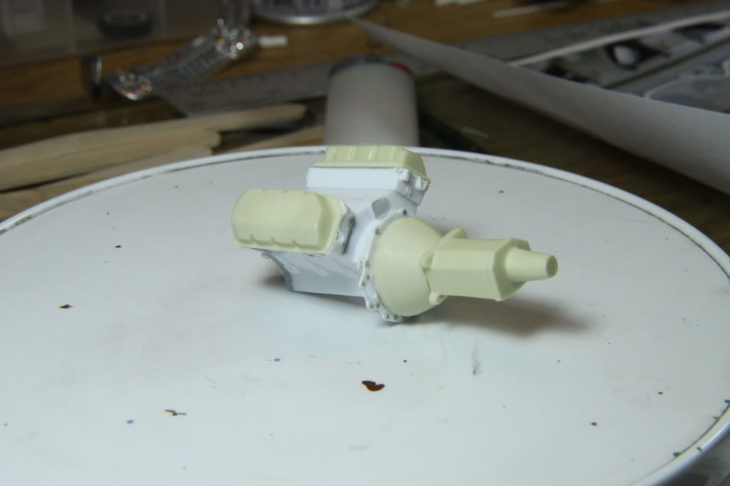

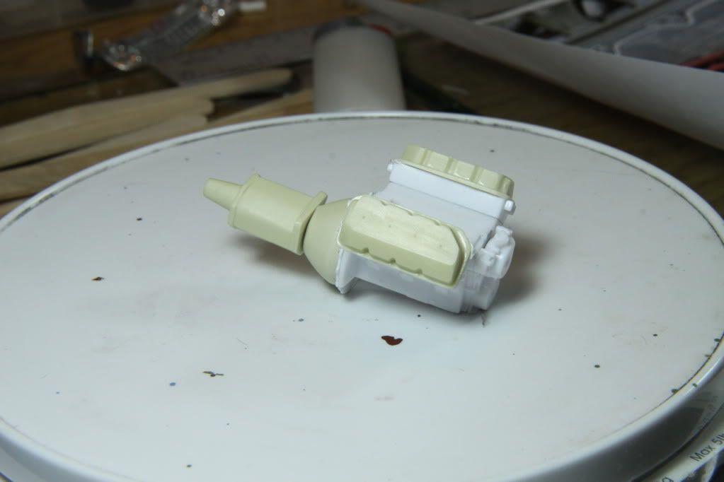

Erik Smith Posted March 7, 2011 Posted March 7, 2011 Another WIP on my bench. Kit is Lindberg's 1964 Dodge 330 - the classic sleeper car. I am attempting to build a fuel injected, aluminium, 588-inch Indy Max Legend Hemi mated to a 5 speed Jerico transmission. The engine idea came from an article in Mopar Action April 2011 issue - it sits in a 205 mph+ 71 Hemi Daytona. Mine will be more of a scary to drive street car/sleeper look. I will be making it a light weight version, as best I can, with aluminim fenders, front bumper, and doors. This is the reason I like making models - if you were lucky enough to own a real 64 super stock, I don't think you'd want to change much! Slightly tubbed out the rear to fit some wide tires - will run steelies and dog dish caps: Here is a mock up of the engine - valve covers are modified from one of Revell's recent hemi funny cars, block is from 68 Dart Hemi, transmission and bellhousing are scratch built:

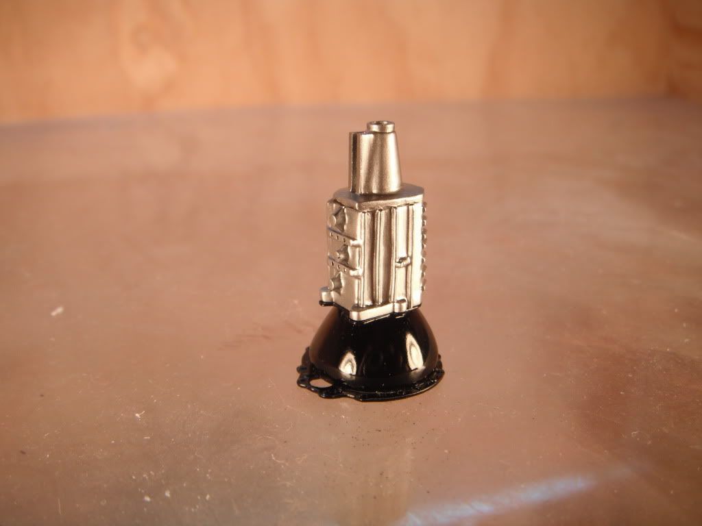

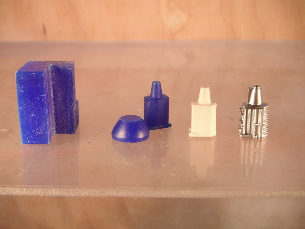

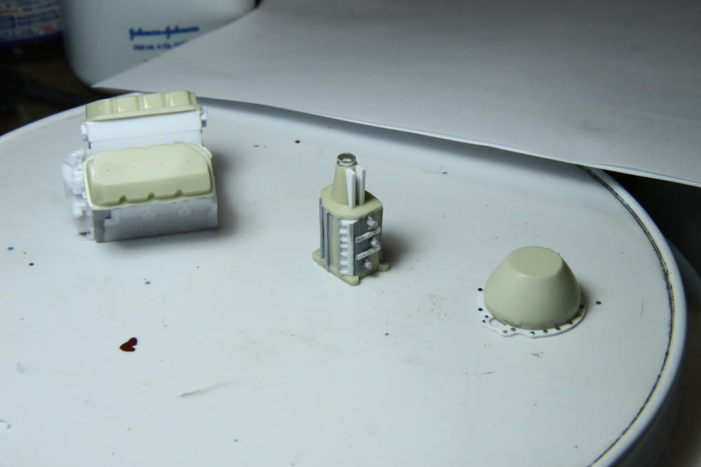

Erik Smith Posted March 10, 2011 Author Posted March 10, 2011 Love your work! Makes me think I can scratch build the transfer case I need. What wax did you use for the transmission master? Seems like candle wax would be too brittle. Steve - here is the wax I have been using: I purchased it from Ottofrie (sp?) online - they are a jewelry making supply company. I purchased the sampler kit with one of each hardness of wax. If you would like a little block PM me and I will send a piece - a transfer case won't take much. Here is the progression - cut out block close to size (I then use a compass to layout lines for proportions), carve the wax to a general shape, cast that in resin, and add final details: For the smaller details I super glue thin styrene, styrene rods, and wire then cover with Mr Surfacer 500 to blend in. Primer, sand, primer, paint and here is the final result: Still need to add a few bolts, the linkages and shifter. Thanks for following and commenting!

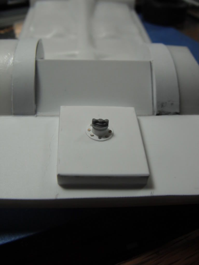

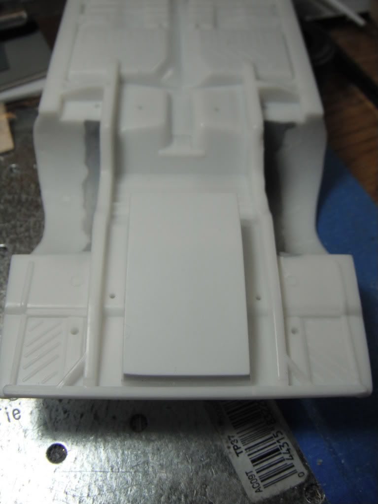

Erik Smith Posted March 10, 2011 Author Posted March 10, 2011 ...and started on the fuel tank. Styrene strips, circle made with a hole punch, tube, photo etch bolts, and some piece I found rolling around in one of my parts bins: Underneath, I just covered the kit tank with styrene: I will add some straps and other details, but not tonight.
