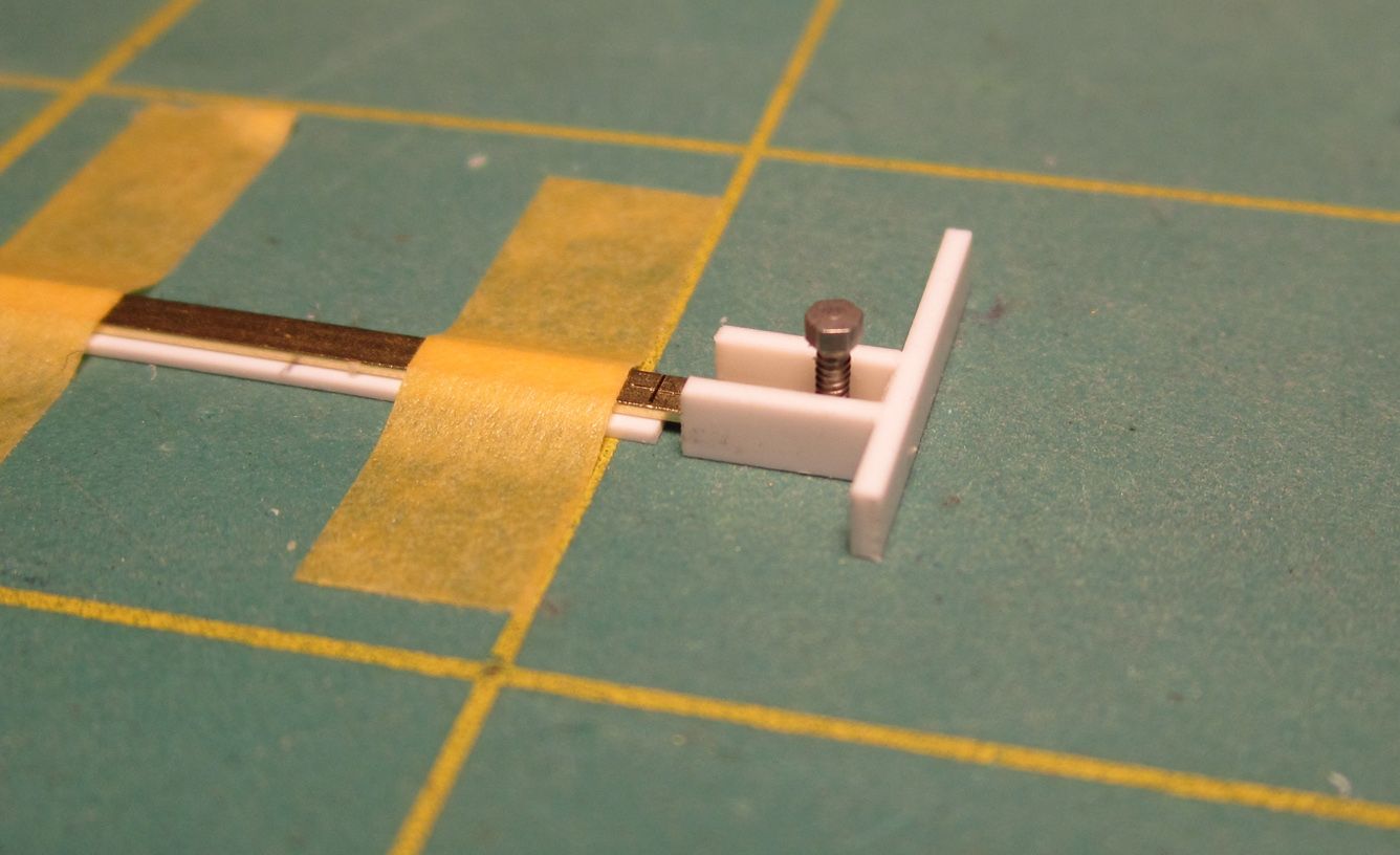

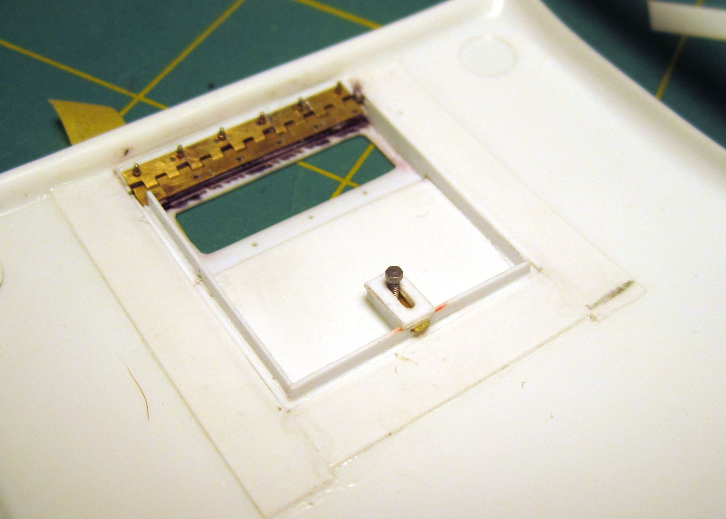

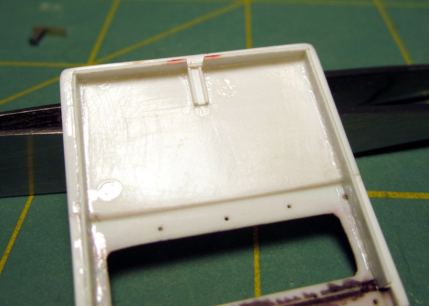

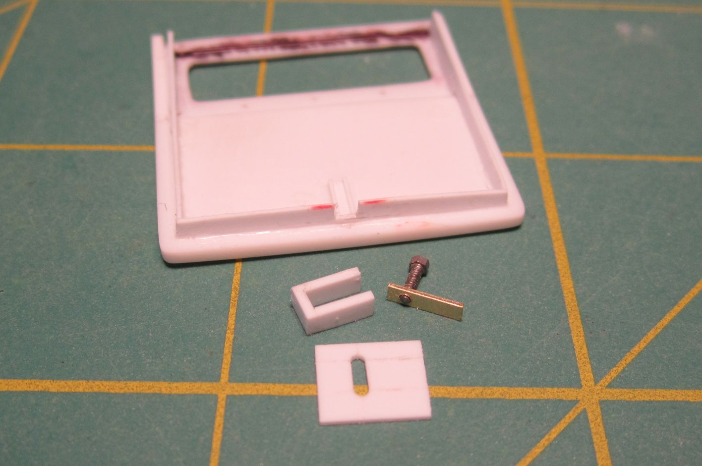

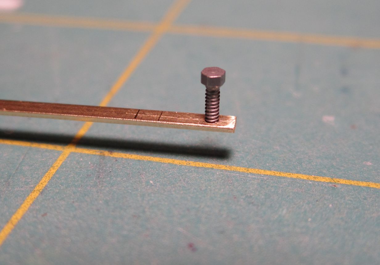

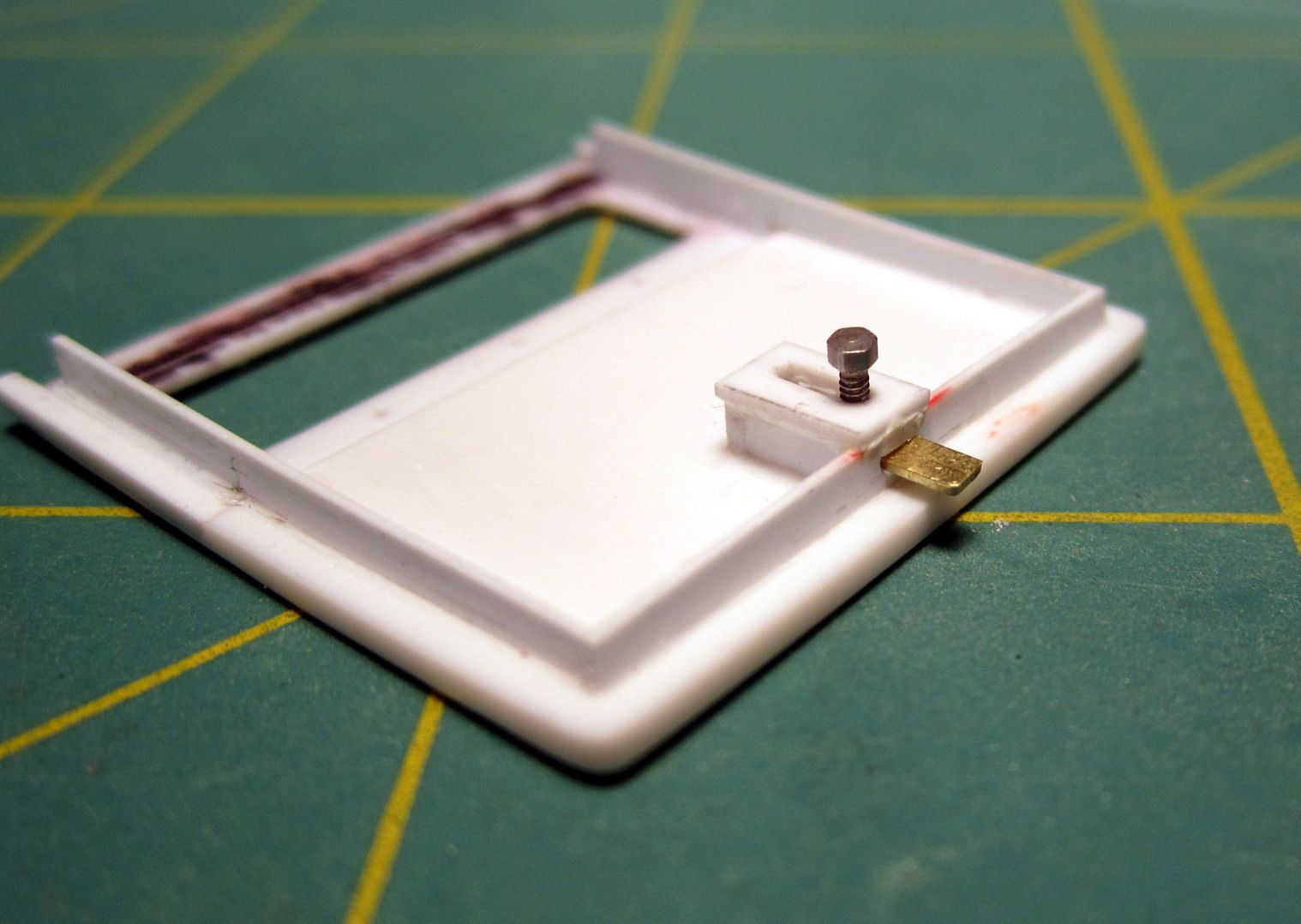

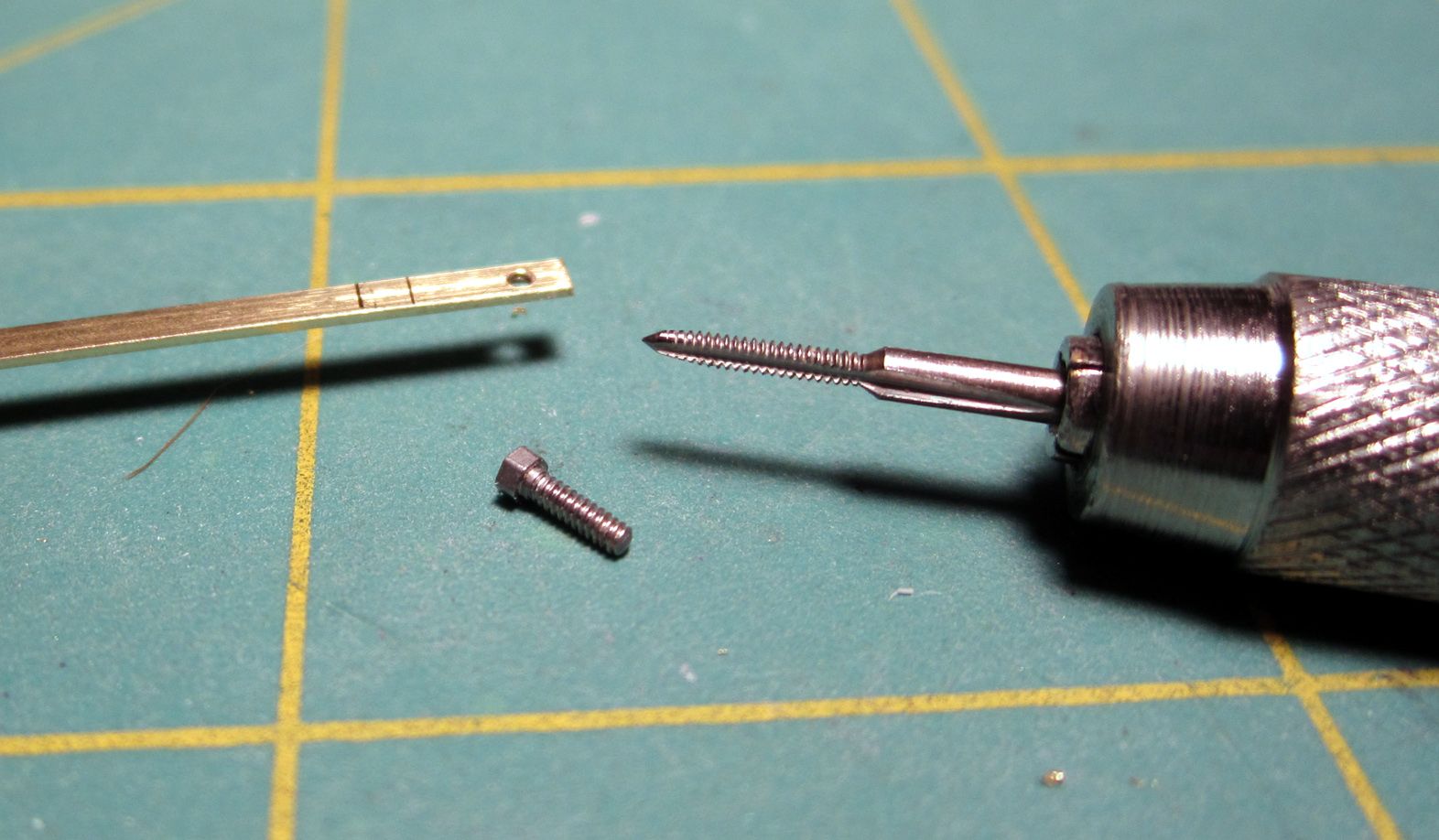

Mooneyzs Posted January 26, 2014 Author Posted January 26, 2014 (edited) Here I have cut down the main box to size, As well as fabricated the top with a slot that will allow the distance that the latch can move: I next set the slide into place and needed to fill part of it in so there wasn't a big gap and I created a small opening that the latch would move thru: I then added some .010" thick pieces to create a track that the latch would slide in. I wish now I would of at this point made the slot a little tighter but was afraid of not giving my self any clearance so that it would bind up and not work: Here it is with the top added. I need to sand the top piece flush to the main body of the latch, Here it is in the retracted position: Another post with pics coming.... Edited January 26, 2014 by Mooneyzs

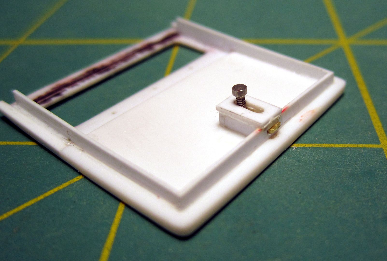

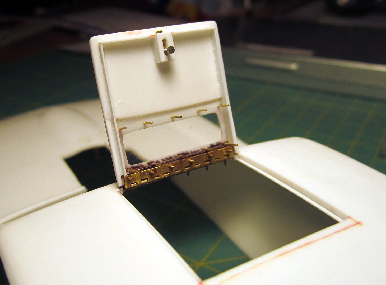

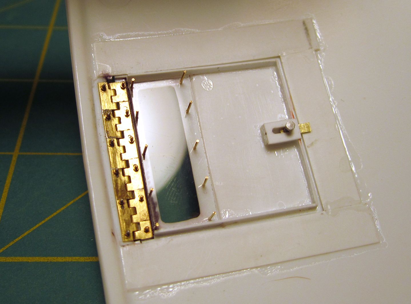

Mooneyzs Posted January 26, 2014 Author Posted January 26, 2014 Now it is in the extended position: Here it is installed in the body, Extended: And Retracted: Picture of it right side up: Well time to give my dog his meds and heat up some left overs, then I will be back at the bench working on the next part of this. Hopefully I will have another update later today for everyone. Thanks for following along.

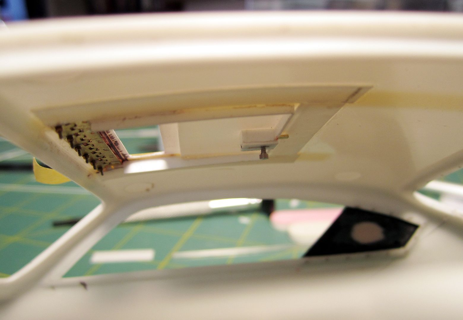

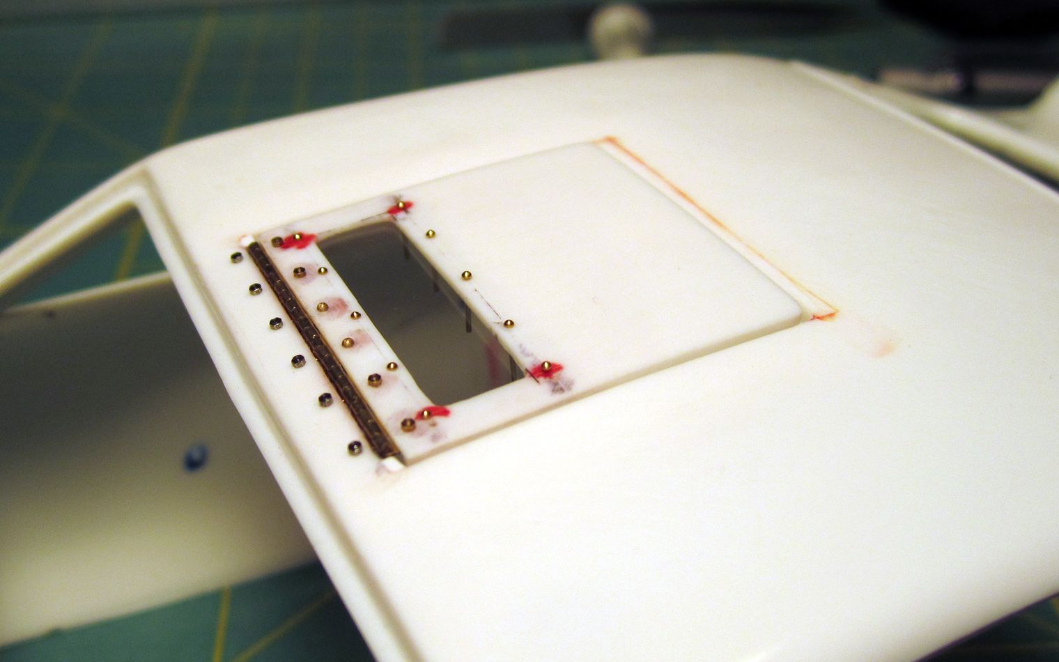

Mooneyzs Posted January 26, 2014 Author Posted January 26, 2014 Well I was able to do a little more tonight. I got the glass installed and holes drilled for it in the Acetate that I am using. Actually not final mounted but more so mocked up, fabricated with the mounting holes. I have to give a big Thanks again to my good friend John Teresi for hooking me with the couple of Acetate pieces he sent me. That stuff is crystal clear and works great. I ended up using the .010 thick material and here are a few pics of it installed. I am thinking also about shooting some primer on the hatch tomorrow, I know I will have some minor body work to do but at least if I get a quick light coat or two It will give me an idea where I need add a little bondo to the hatch. I was also trying to think if I could shoot a little video with my phone to show how the hatch works to everyone. I will try an mess with that tomorrow. Here is the hatch installed again with the Acetate in place: Underside with all of the bolts and nuts to make sure everything works good and lines up: Here the hatch is in the open position. I will need to take the rivets and cut them down to length: For Comparison:
gasser59 Posted January 26, 2014 Posted January 26, 2014 (edited) Exquisite!!! A couple of questions: are you going to put a spring in there to keep the latch under tension and are you planning on trimming down the length of the bolt? Edited January 26, 2014 by gasser59

Mooneyzs Posted January 26, 2014 Author Posted January 26, 2014 Brad... Thank you sir. You know I had originally though of putting a spring in it so it would be spring loaded but the size I was trying to make it I wasn't sure if i could l find a spring that small. I could always see if I could fit one in there. I am glad you brought up the point of shorting the length of the bolt I didn't really think about it. I think I will cut one of the brass ones down because i have to be honest I didn't like how it stuck so far down...lol. I had thoughts of sanding the head down so it was some what smooth but if I leave it with the hex I will be able to use my wrench to put it on and off during installation of it. Larry... Thank you. I appreciate all of the kind words. I am enjoying sharing this with everyone and hoping to have more updates soon. I appreciate the kind comments on my dog, He is recovering well. John... Thanks Brother. I took a look at my time on the hatch and I have a total of 49 hours into the hatch where it is right now. For the total build I am currently at 990 hours for the whole build. Dave... Thank you. I am planning once I get this build done I will be building a Power point together with the pictures and will print out a build book of this build. I think I will try and turn it into a PDF and will be able to email it to who ever would like it. Dave... Thank you so much for the kind words. I can't thank you enough the help behind the scenes on the multiple questions I have messaged you about. Danno... Thank you sir. I am really trying to have this done by Desert Scale Mike... thank you my friend... Coop is doing great. Joe... Thank you so much for the kind words. It really means a lot with the nice things you have said about this. I have Challenged myself with this build to see if I could do some thing i have never done before, so far I am happy with the outcome, I know its not perfect by any means and I have made a lot of assumptions since I had a limited amount of reference pics for this car.
