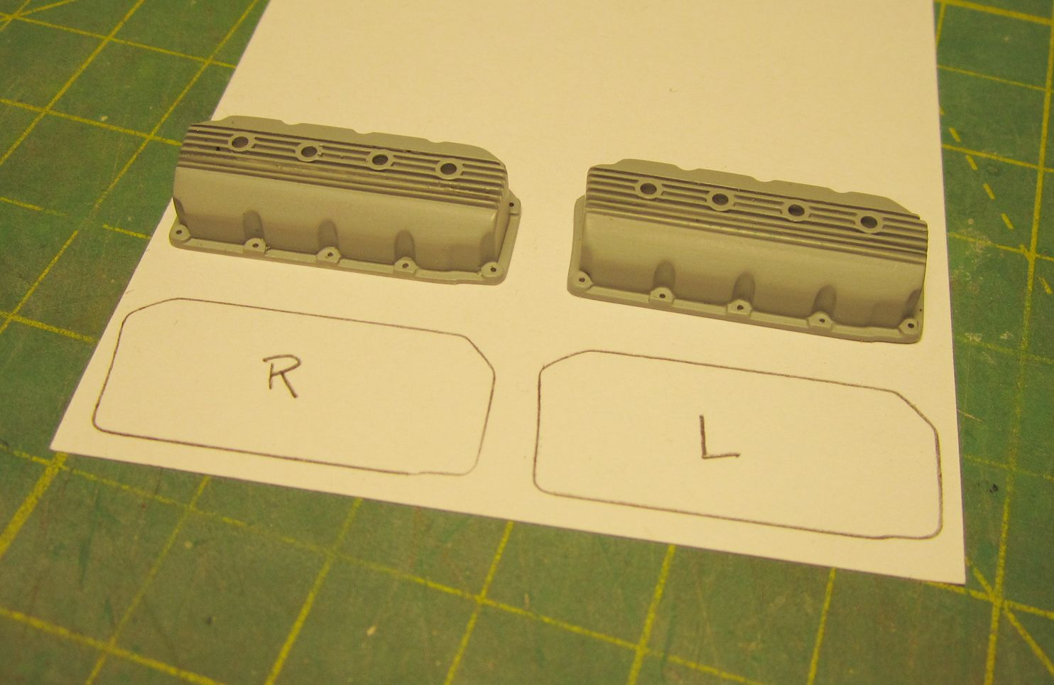

Here is the start of the Valve cover gaskets. 1 - 3x5 card, 1 xacto knife, 1 steel ruler, & the valve covers:
I first started by tracing the edge of the valve cover with a pencil onto the 3x5 card:
Next I cut them out with my xacto knife. as you see here I did 2 sets, I wasn't happy with the first ones so I cut a 2nd:

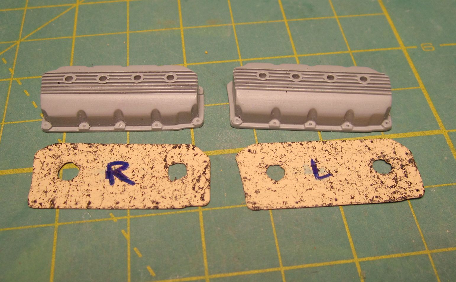

I next took my pin vise and .020" drill bit and transfer drilled the holes from the valve cover to the gaskets. You can see in this pic that I only had one drilled out:
I am a little upset at myself, I guess I forgot to take pics of the next few steps before I painted the gaskets. I finished drilling the 2nd gasket out. I then colored them with a black sharpie. After the black sharpie I brushed on multiple coasts of tan paint. and then the black was added by taking a dish sponge and wetting with flat black and dabbing it out until there wasn't a whole lot of paint on it and I basically dry brushed the gasket creating the black spots to make the gasket look like cork:

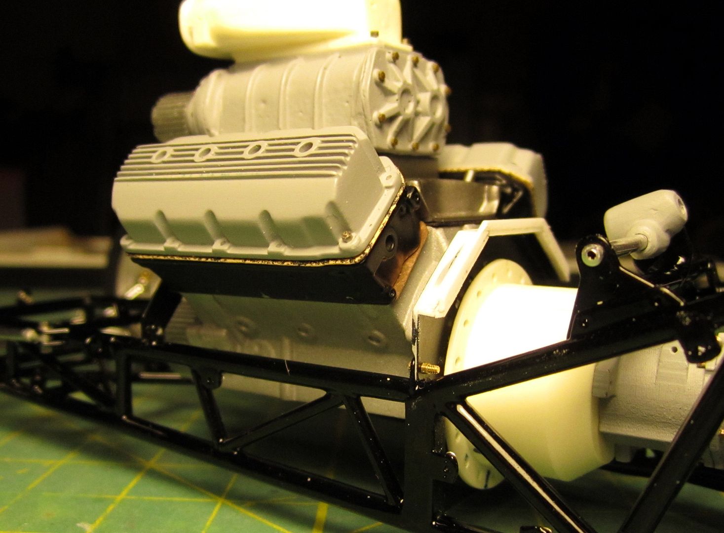

As usual I had to mock up the gaskets to see how they looked:
angle from behind:
Right side from behind:
From the front:
Edited by Mooneyzs
