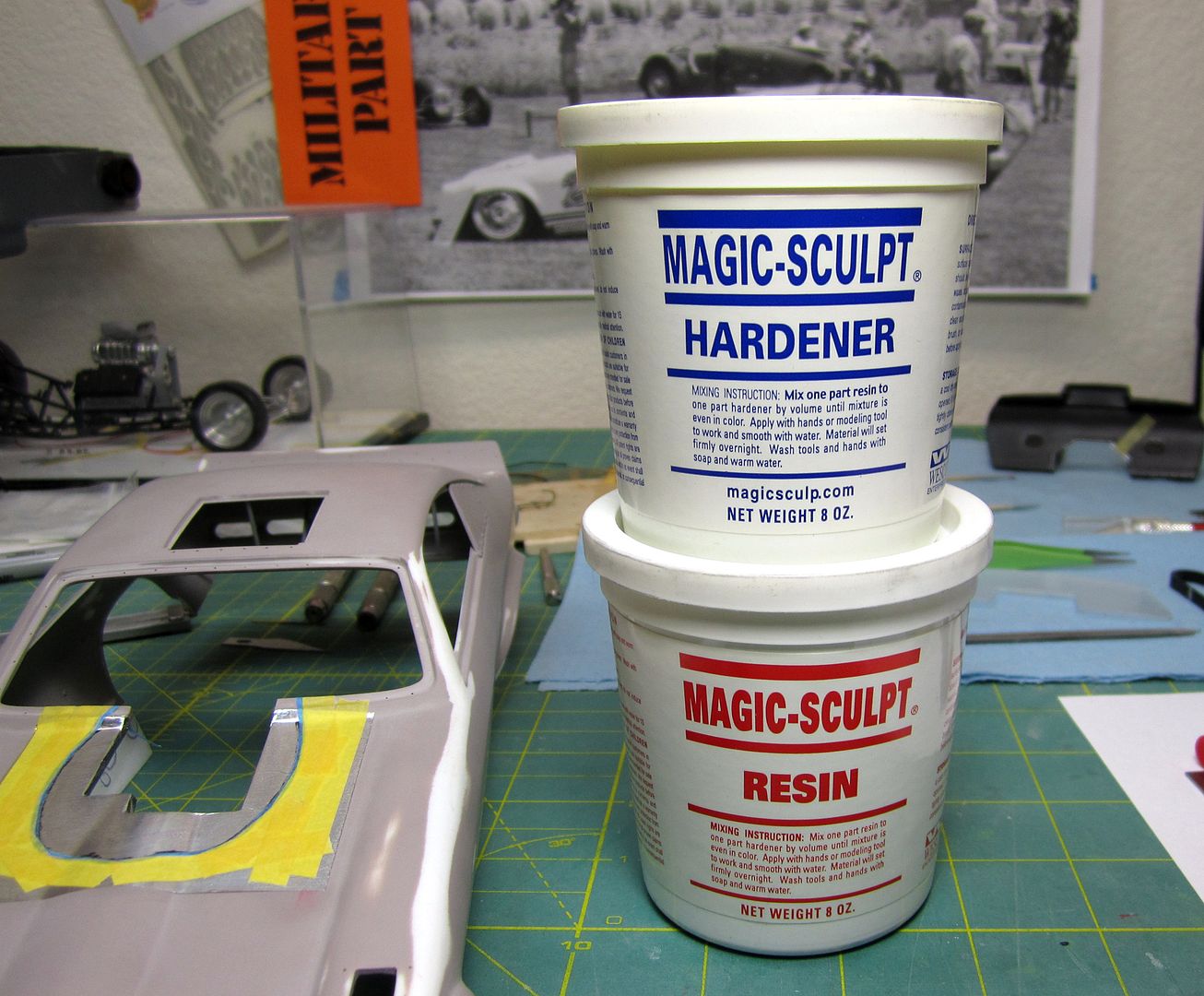

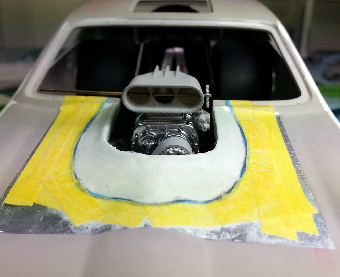

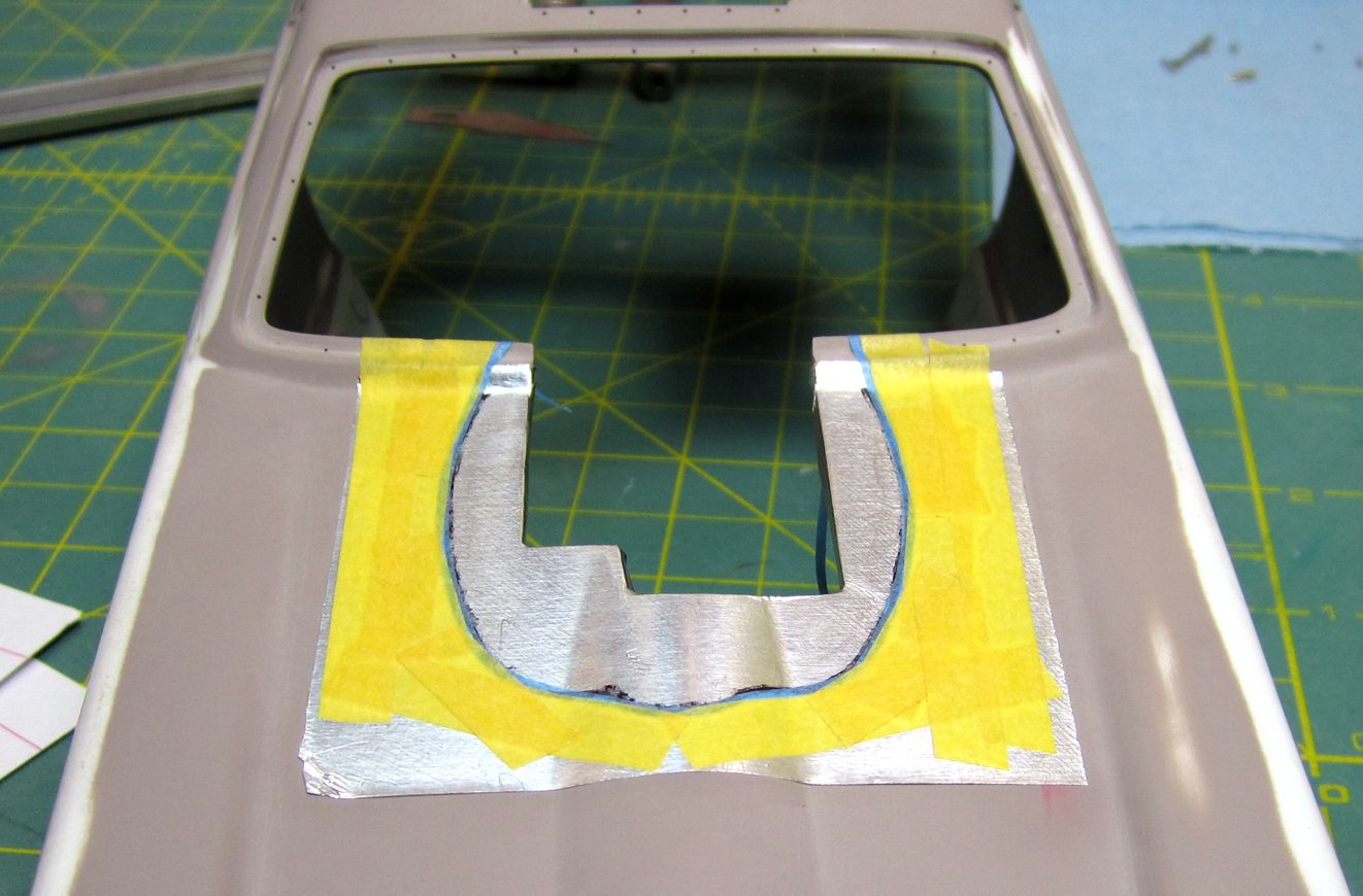

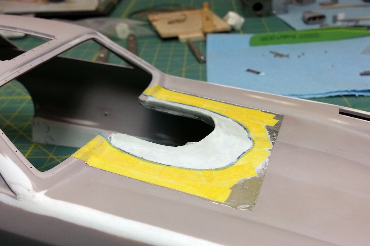

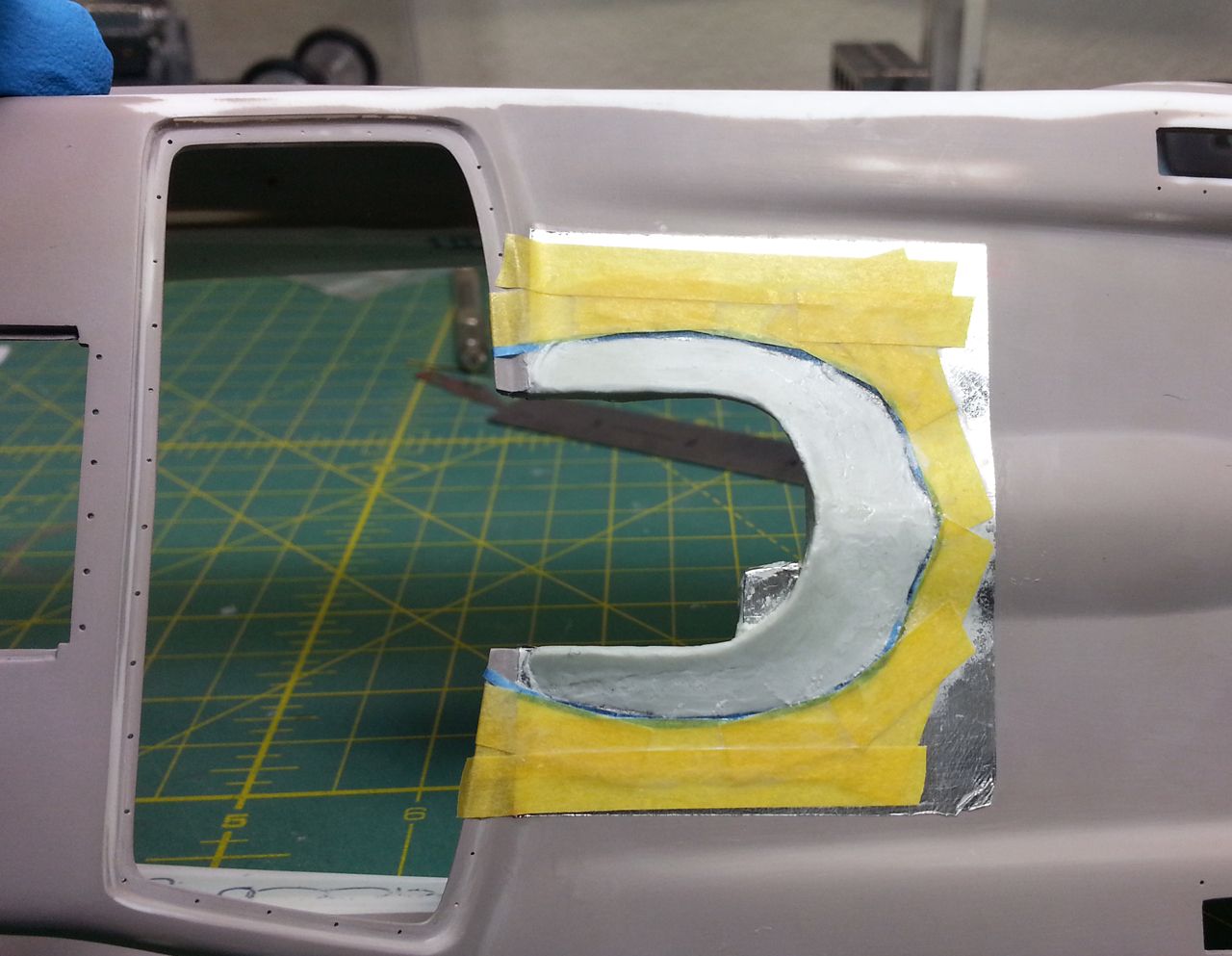

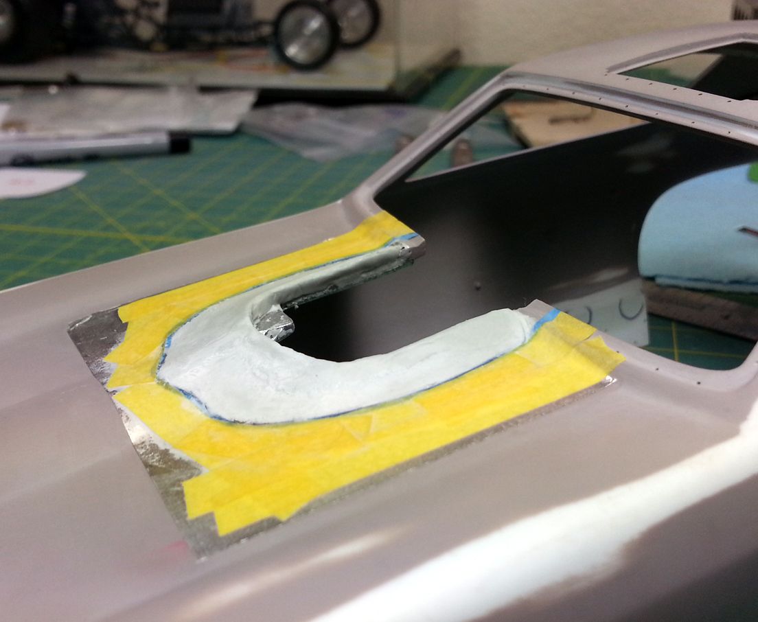

Mooneyzs Posted March 3, 2016 Author Posted March 3, 2016 I will try to respond to everyone when I get home from work. since I don't have time on my lunch break right now. So I have a quick Lunch Teaser with some pics of the Snorkel I have been working on for the hood of the body. Anyway I started by creating a pattern in Solidworks so I could get the curves the way I wanted them. I then printed it out 1:1 and cut it out for a template. I then took a fine tip sharpie traced around the template on the body and then I used some fine line tape and followed the line so That I knew where I wanted the end of the snorkel to be. I then used Magic Sculpt which is a 2 part clay stuff that you mix equal amounts and then you can shape and form it. I worked it for about 2 hours sculpting and shaping the snorkel. and what you see her is what I got done last night. Hoping that I won't have any issues or trouble pulling it off the body. Here are a few pics to share.... This is the start of the process after I had laid the pattern onto the body and got it all taped off. I ended up using Bare Metal Foil as a barrier so that the Magic sculpt would not adhere to the body: Here is the Handy Dandy Material I am using to create the Snorkel: Here is the snorkel after I going to a point where I was happy with the basic shape. I will have to go back and sand and body work it some more:

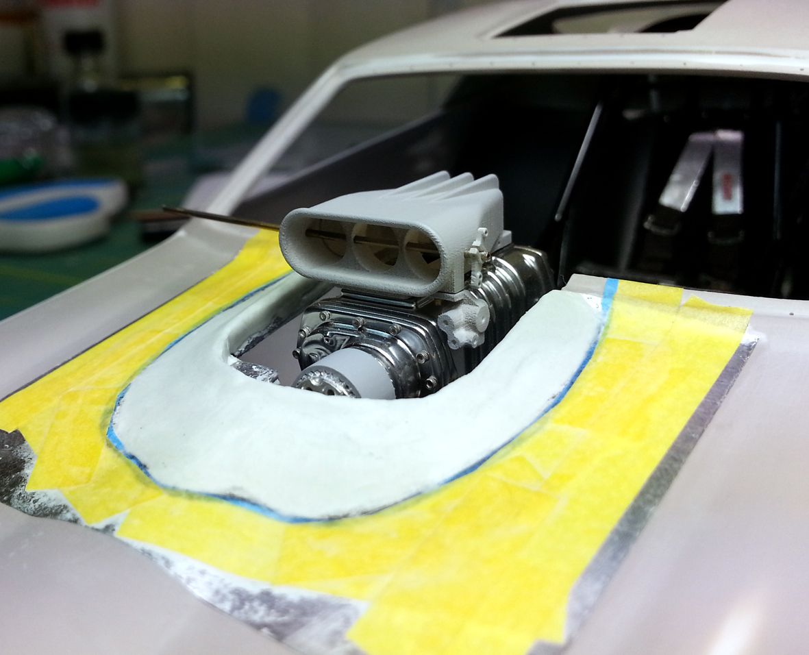

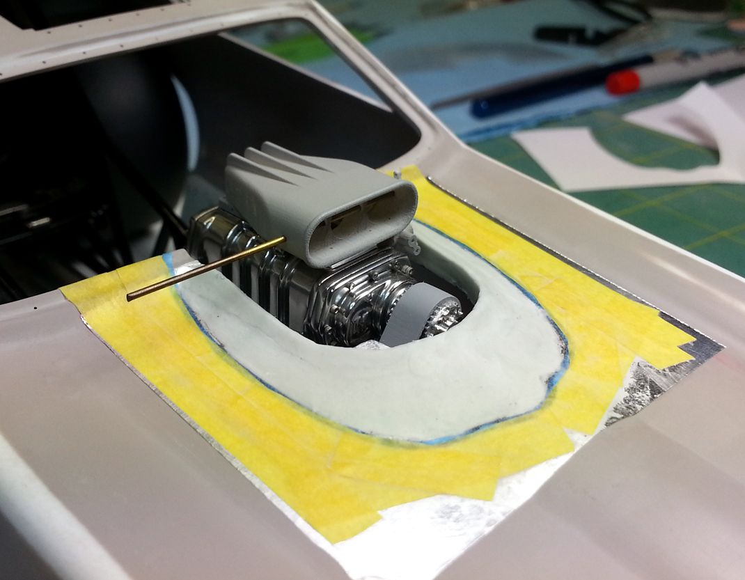

Mooneyzs Posted March 3, 2016 Author Posted March 3, 2016 (edited) See Previous page for the start of the snorkle Knowing me I had to do a test fix to see how things looked. SO I placed the body on the chassis to see how things looked: Other Side: Here is the front view and was making sure that it would clear the Barrel Valve and linkages. I will still probably sand some away from the inside to give even more clearance: Edited March 3, 2016 by Mooneyzs
gasser59 Posted March 3, 2016 Posted March 3, 2016 looks pretty good Chris. X2 LOLThat is really shaping up nicely Chris. Will be be thinning from the inside of the body where eh snorkel is to mimic the thickness of the body?I hope that made sense.
Mooneyzs Posted March 3, 2016 Author Posted March 3, 2016 Dave.... thanks!! Brad.... yean I will be doing that. made total sense . Svsle wise the kits thickness is probavly like an inch... lol

John Teresi Posted March 4, 2016 Posted March 4, 2016 Chris.......great up-date......that snorkle looks great......your getting some great progress Brother
Armornv Posted March 4, 2016 Posted March 4, 2016 Looks great Chris. I love Magic Sculpt. It's wonderful for all kinds of model related things!
Mooneyzs Posted March 5, 2016 Author Posted March 5, 2016 Bob... thank you. I have to say that it is not too bad to work with.Randy D... Thank you buddy. I am getting closer one step at a time. Looking forward to see you in little over a month....John... Thanks Brother!!! I always appreciate you checking in.Clint... Thank you. I have got to admit that this is the first time that I have ever used it. It wasn't too bad either. My part is not perfect but good enough at this point, I will be able to use it and do some body work to it by adding some body filler to it.Bruce... Thank you.
