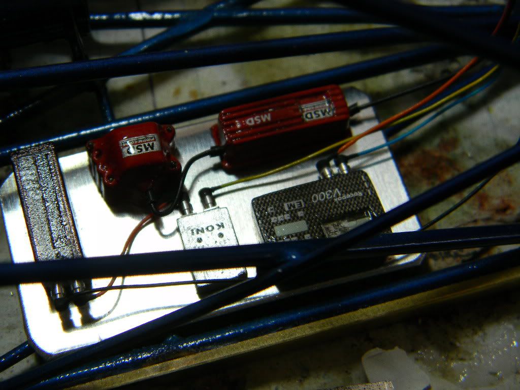

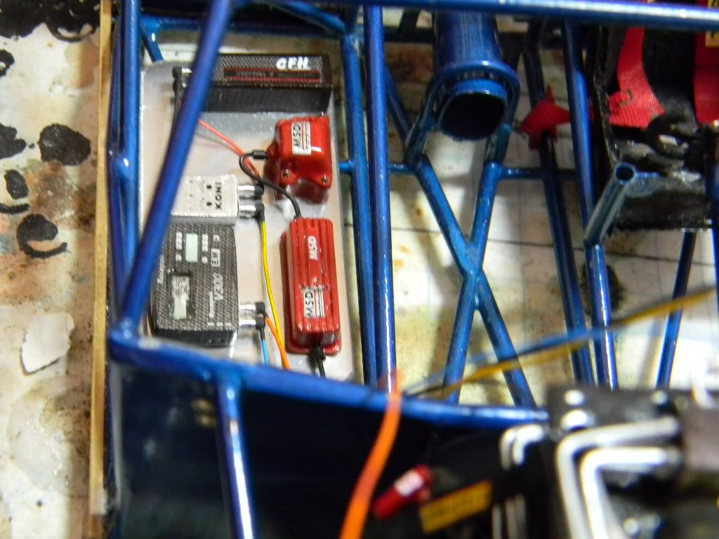

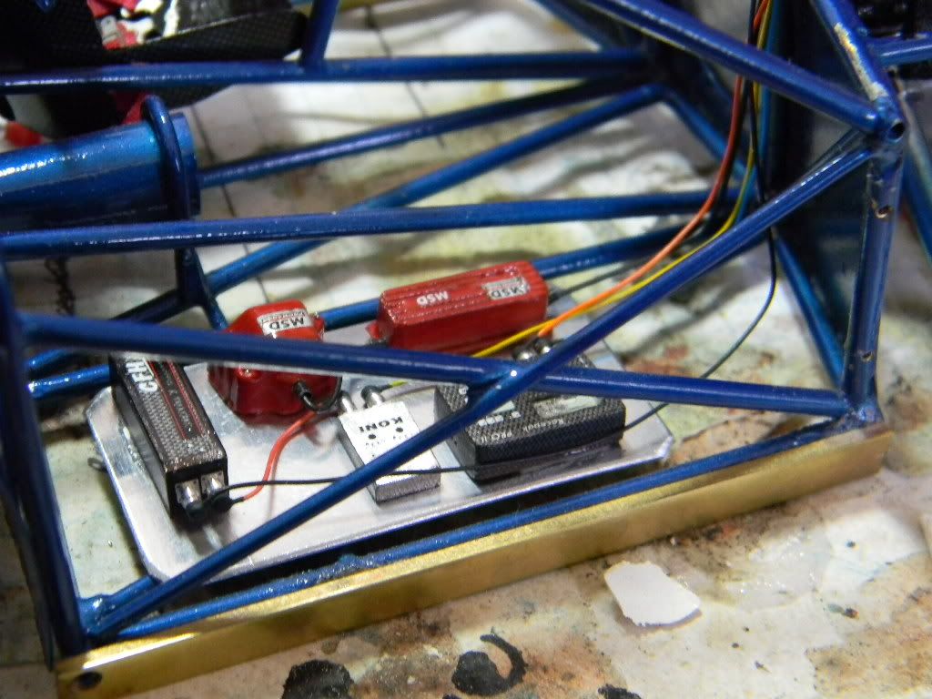

Here's a few more progress photos for ya, installed the electronics well the first part anyway. enjoy!!

Gotta question too. I know a little about electronic active shocks, does this build have those type of shocks? Specifically, what does the silver Koni box do?

It adjust ride stiffness for front and rear Dampening of the shocks this helps eliminate wheel hop along with violent chassis separation and wheel stands, the point of the system is to keep the wheels down and the car straight, it can also be adjusted on the fly per track conditions, I hope that answered your question for ya Mark.

The electronics are looking sweet Rom, I have a question, I noticed that there are no floor boards, are you going to be running a belly-pan set-up or are you just gonna leave it open for better veiwing?, & I can't wait to see this car done & painted!, it's beautiful!

ROM in looking at your Pic, where you have your electronics I don't see your two 10 lb fire suppression bottles up against the passengers side. Are you planning on putting these some where else?

Hey Richard I already have the floor pan made I cant put it on unitl certain interior details are completed.
Bart I get my decals from Slixx these 1/25th believe it or not, I wish I had an ALPS printer. and yes I'll be installing the fire suppression bottles in another location.

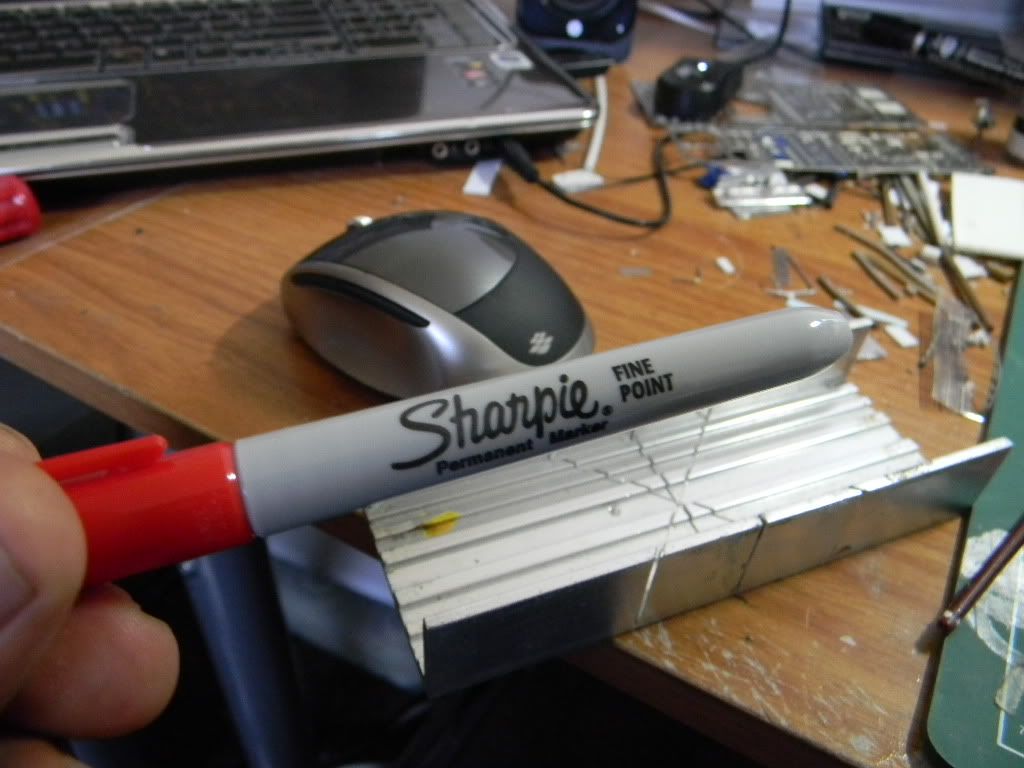

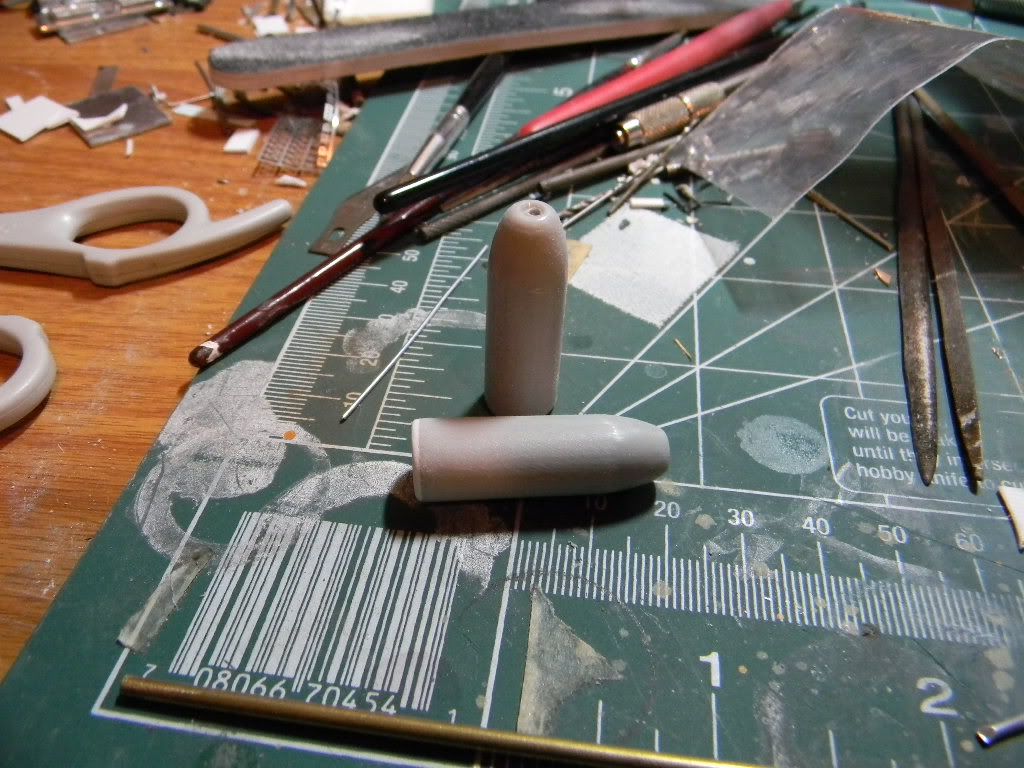

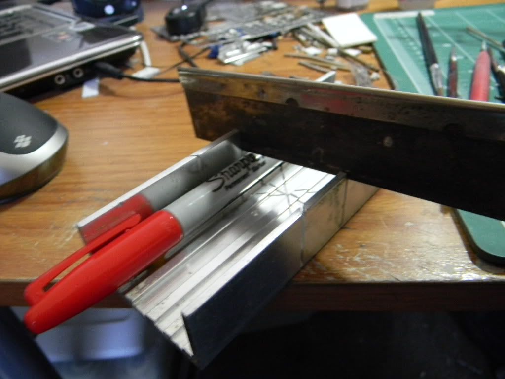

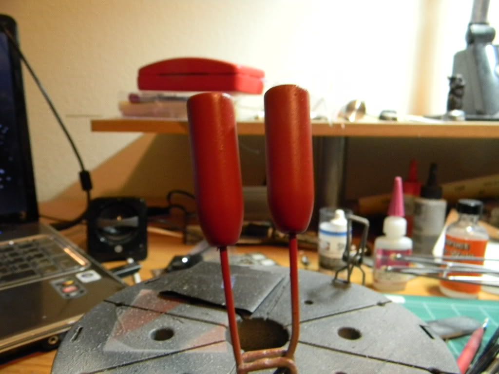

Hey guys I been pulling my hair out trying to figure out how I was gonna make the fire suppression bottles, And just as I went to bed a couple nights ago it hit me....... so heres what I came up with I'll let the pics do the talking
Styrene sheet glued to the bottom
Romell the straps you made for the tanks look top notch. I sell aluminum tanks close to yours but have never been able to come up with a good mounting strap. If you do not mind me asking how were those straps made. Thanks for your time posting all the picture of this build it is a lot of fun to watch.
Hey Jim the straps were made from .062"/1.6mm rosen core solder flattened out by rolling my exacto blade on it like a rolling pin then I gave it a slight polish with a fine sanding board. Thx for the compliments buddy and for the fine craftsmanship you put into my rims.
