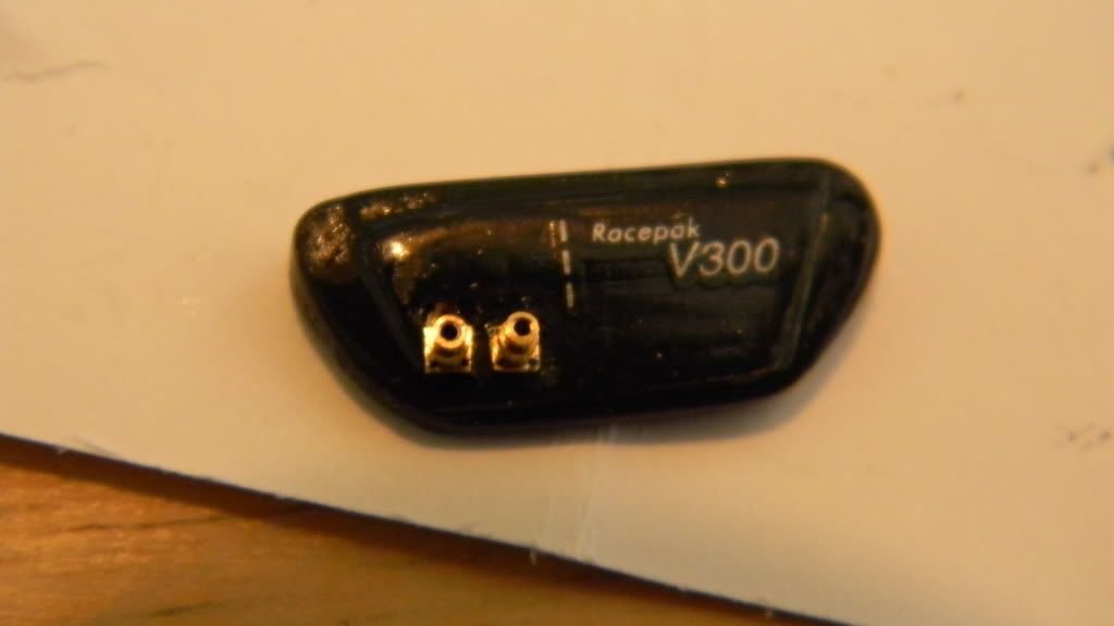

Here the finished Dash I hope you enjoy.............
Didnt make the changes I thought I would Just made a new lense and put it all together

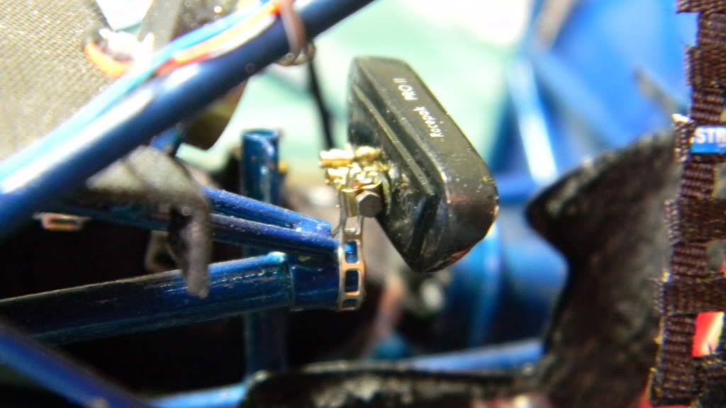

Here I added control buttons and installed the new lense
and the back with the wire connectors added
And finally installed in its new resting place..
See ya on the next update....

Rom, the racepak looks great, nice touch with the buttons, enoying seeing this come together.....
Thanks Tyrone It's easy to do when youre inspired by great builders such as yourself and Bill.

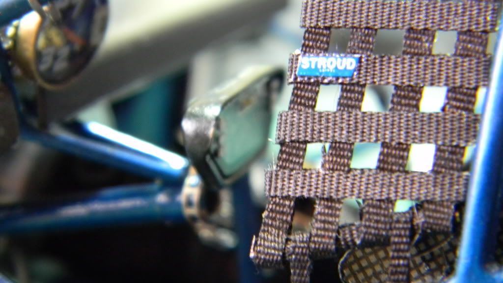

I also made the wheelie bar net, actually it was made a couple days ago just never took pics of it
Cya on the next one .................... B)
Off the chain Rom... the net.. is so the chutes dont get tangled up and not open, and then Rom wont able to stop after 200 mph blast down the track.....lol....
