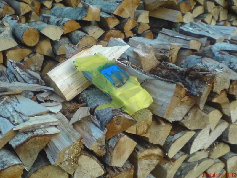

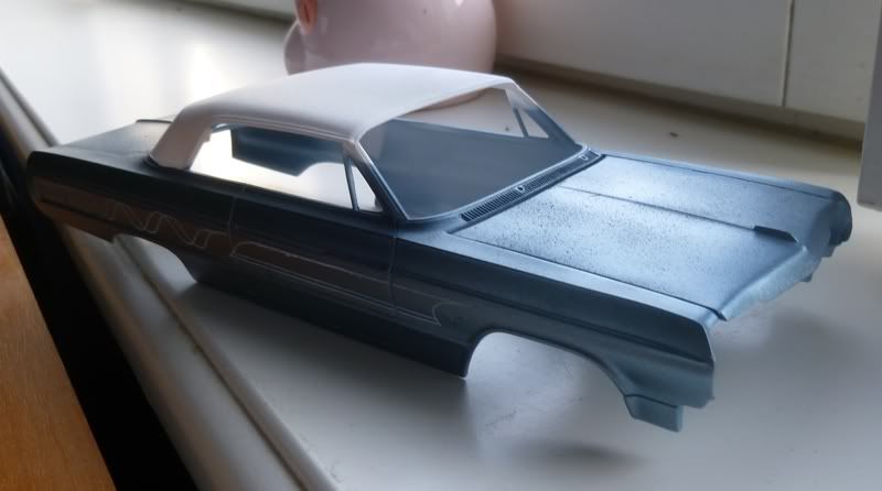

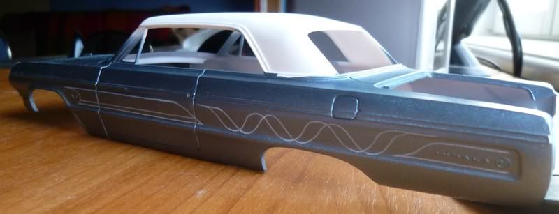

I've been laying down some pinstripe tape tonight, hopefully I can shoot few coats of paint tomorrow.
I've been working on the body this week but all my hard work didn't give me results. I had no idea the primer was so faulty until today when I shot few coats of base paint on the body. Zero Paints are really sensitive for the surface so any flaw on the primer will show up.
Plus I pulled off the pinstripe tape too late when the paint was already too dry, that's why the sidestripes are so rough.
Oh well, need to repaint the body now.

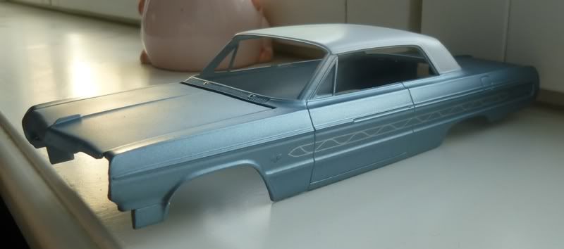

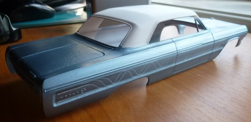

Got it repainted :lol: . And I love how the side design came out this time. Now time to open a beer and design the roof patterns :lol:
Nice paint and color choice. I'm not a huge lowrider fan, but I enjoy the paint jobs and graphics done on them in this forum, and the cars used as subjects are often some of my favorites. Looking forward to seeing the progress on this. I just raised my beer as a salute!

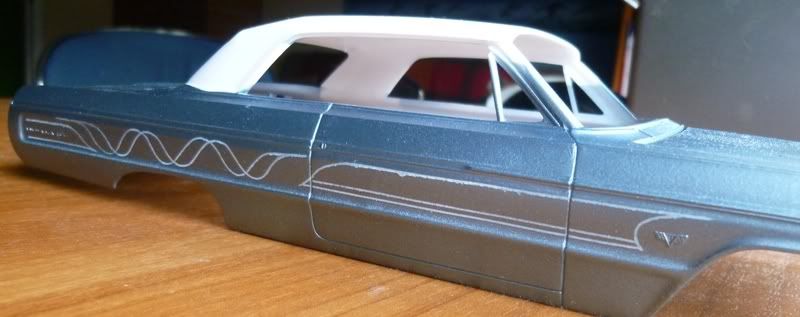

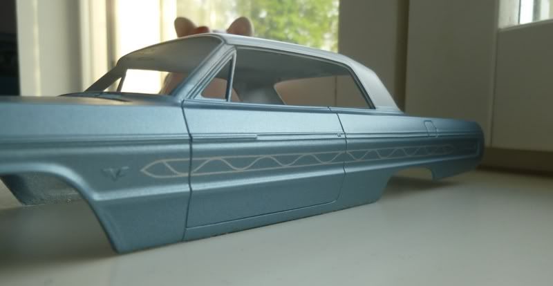

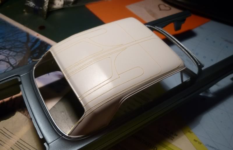

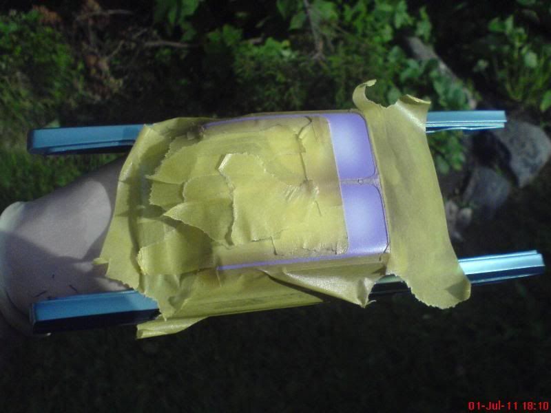

Got some painting done today, still a lot of work to do tho. Pictures after the first one are done with old phone so sorry about blurry stuff.
Wow! thas some impressive paintwork! where do you get that skinny masking tape?
tape 2 razor blades together the more you pitch them inwards the thinner you can make it
how's that?, what blades?.....please B)
how's that?, what blades?.....please :lol:
siim is using the last one
its 2 #11 blades pitched inwards with a piece of styrene works great for a lot of stuff ive only used mine once
Thats right, I usually put the tape between the blades instead of styrene to bend the sharp edge of blade more closer so I can make more thinner line.

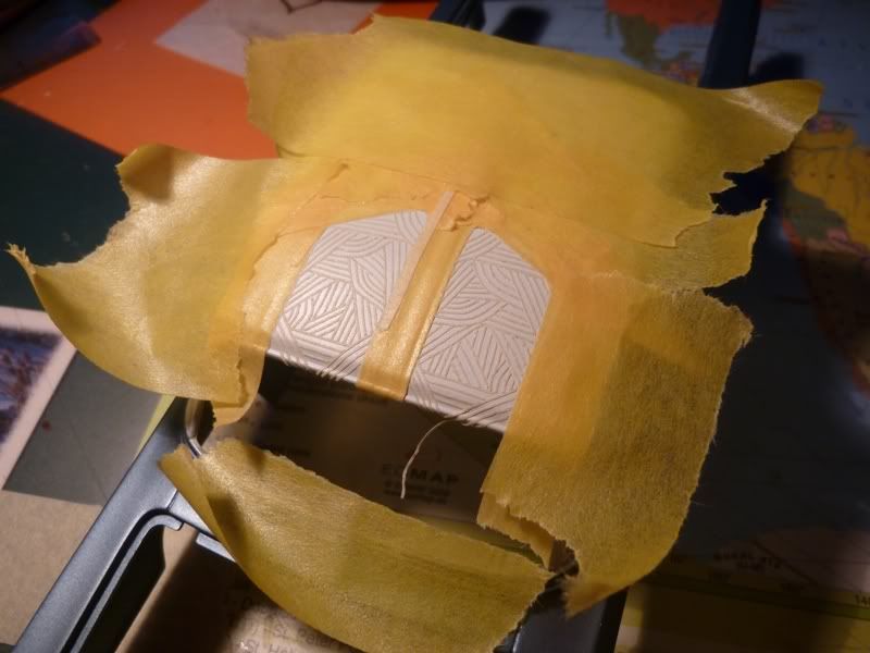

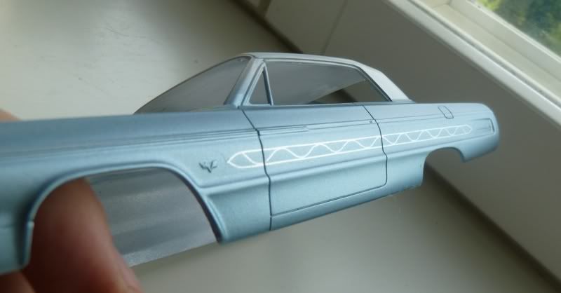

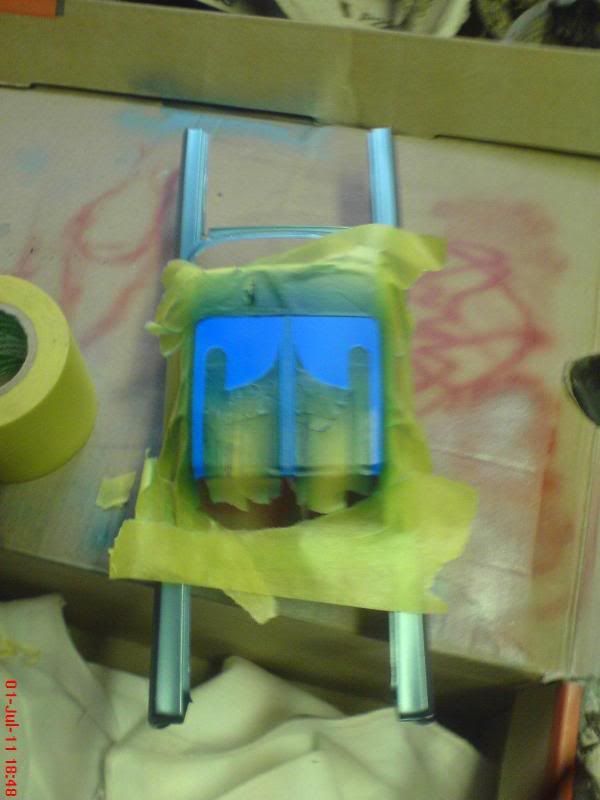

Got some more work done

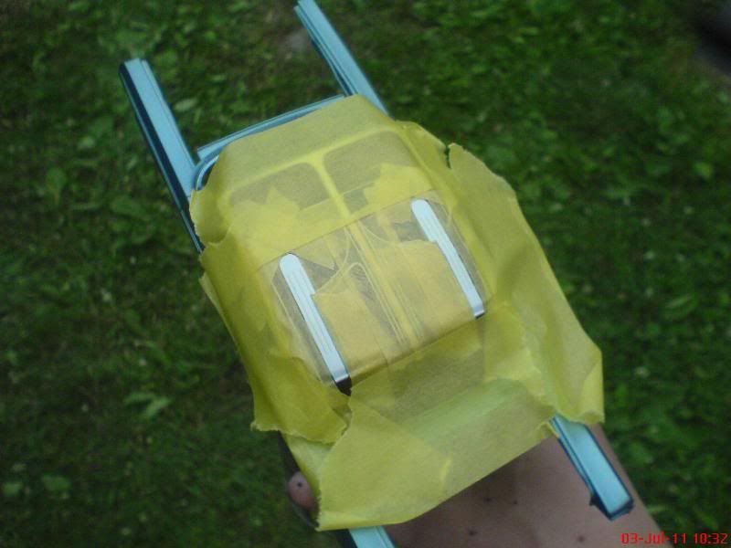

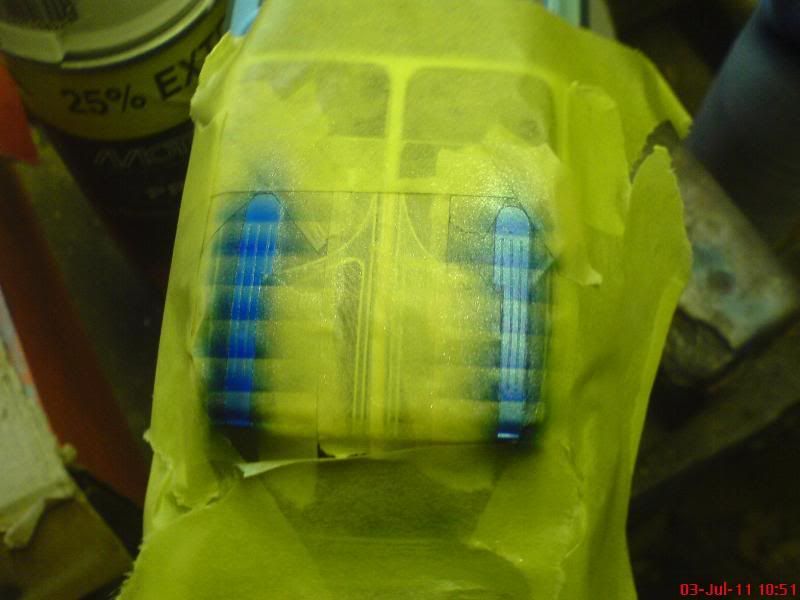

First pattern for today, something simple:

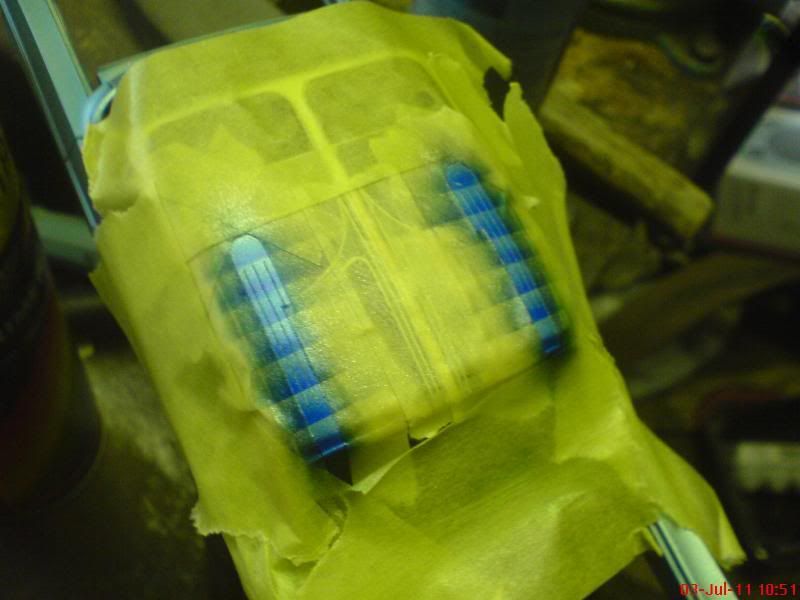

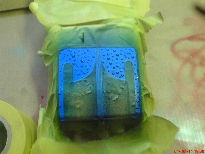

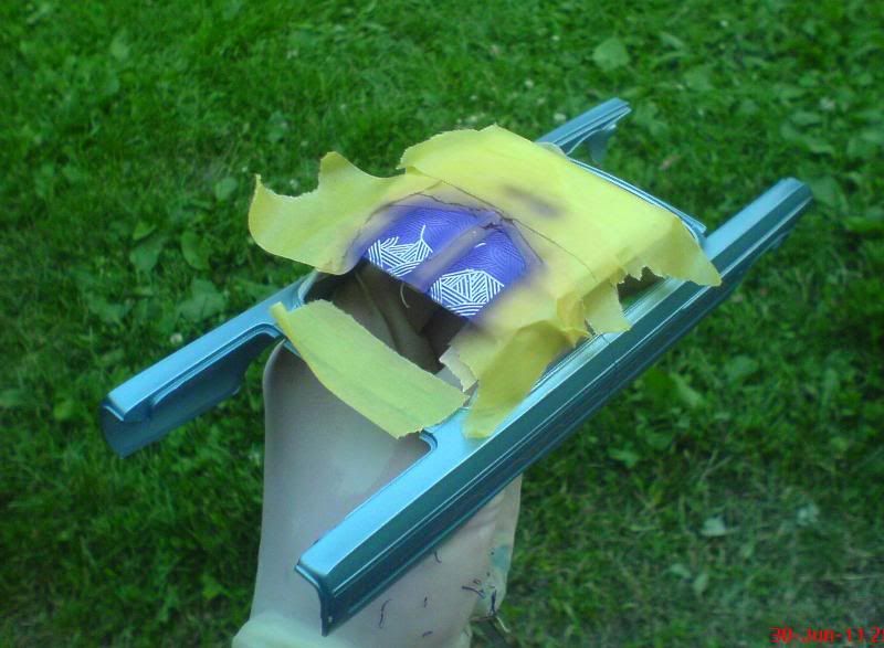

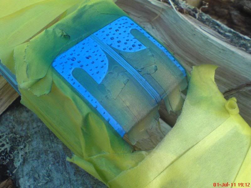

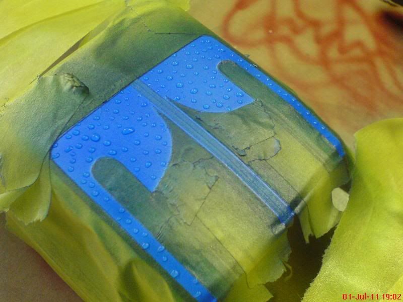

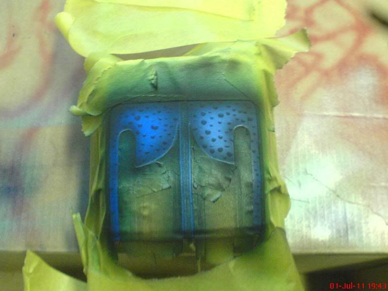

Second pattern, with waterdrop effect
Put some waterdrops on the paint
And paint it some enamel black on them in very sharp angle. Didnt turn out very good but I tried this first time in my life so not too bad.

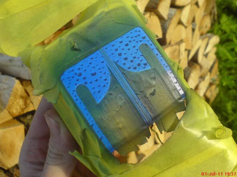

Let the water dry up(in my case in sunshine)
After water dried up, it looked like this
And added some shades
Incredible masking job. I like the water droplets also. But, you might consider smaller droplets on your next job so they are a little more in scale. There is a good water droplet video on youtube. Nice work Six-Fo.
Yeah I was wondering the same thing how big I should do the droplets, but I decided to make big ones because if they were smaller, you could only see some black dots and you wouldnt understand if they were droplets or not.

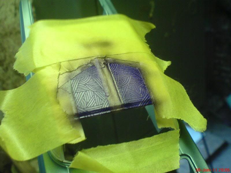

Nope, just rip off the tape and start another one. Sometimes it pulls off the previous paint but it doesnt happen very often if you have good tape and good paint.

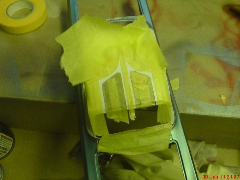

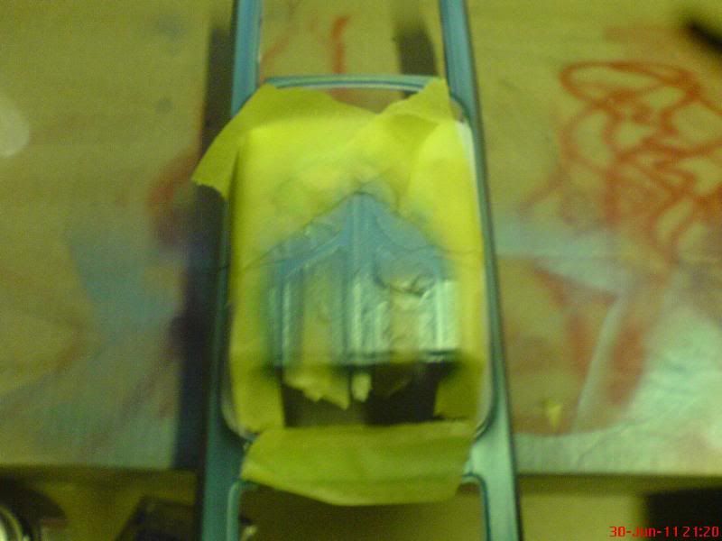

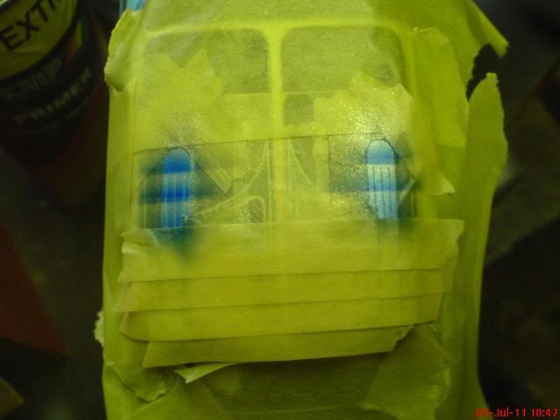

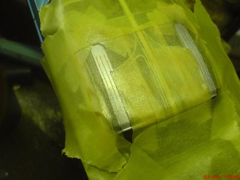

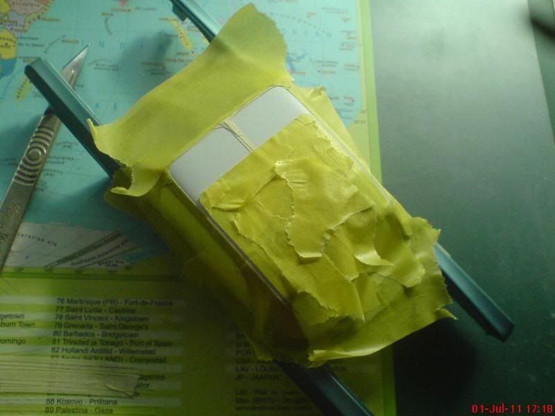

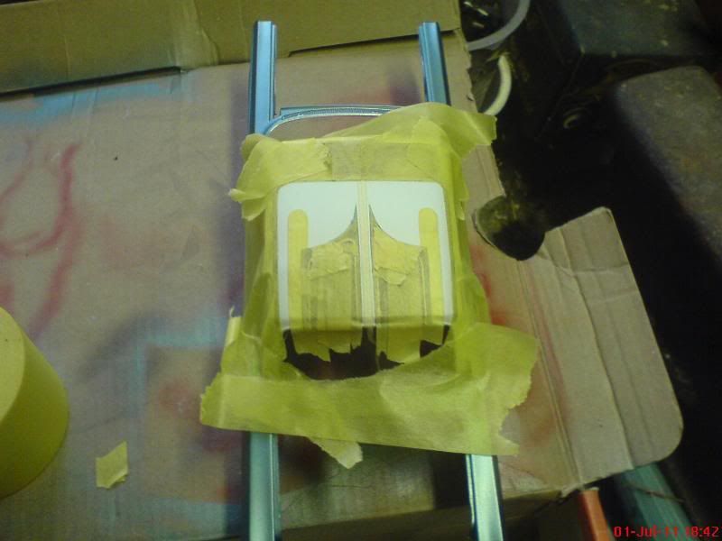

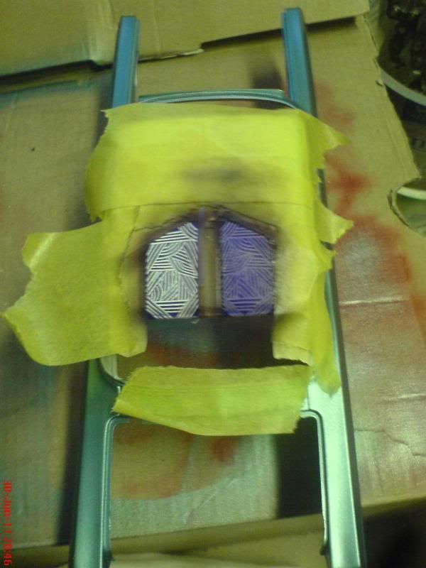

A little step by step for another pattern

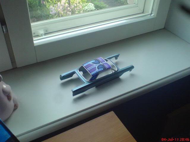

My paintjob is completed :D But I wont show it bigger before I get the clear coat on.
