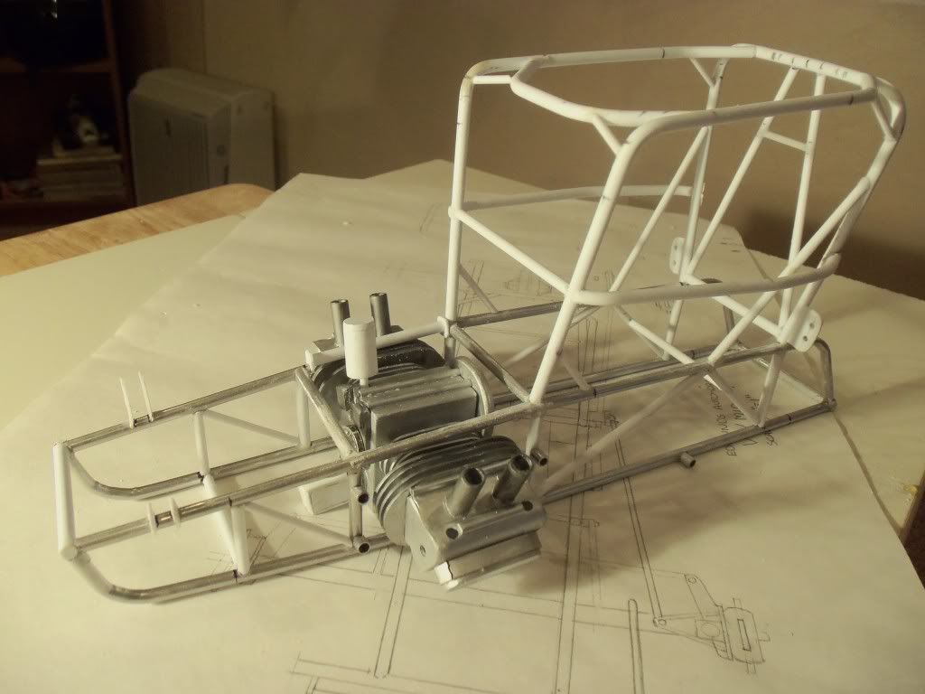

So far good work. I see a lot of flush cut tubing trying to butt up to the sides of other tubes. If you file an arc into the end of the intersecting piece with a round needle file, you can make those joints look much smoother.
Ken - are you using CA or epoxy to attach styrene ears to the metal frame? I am using CA and knock the ears off on a regular basis.
The term you are referring to is "fishmouth"
Nice build by the way. Is the autocraft motor scratchbuilt?
Sorry I just noticed part of his chassis is aluminum.. so I am sure epoxy is the right thing to use here. If it was all styrene something like Plastruct Weld or Ambroid Pro Weld liquid cement. This stuff actually welds the styrene together as if it was one piece. I use the latter on all of my styrene projects.

I use epoxy for styrene to metal. Here's what I am trying to build. The VW were hot back in the 80s.101_0941.jpg

Question, is there any special reason you went with half aluminum and half styrene on the main section?
Shane, the motor is scratch built. Bart, the only reason I used aluminum tube for the main rails is it does not distort. I have learned through experience that using styrene for main rails is easier but will warp up slightly and change as the other pieces are added. Then the frame will not lay flat. By using metal main rails and styrene tube for the cage and braces, the chassis remains unchanged during the whole construction. This is my seventh car this year so I have some scar tissue to base my building materals on.
