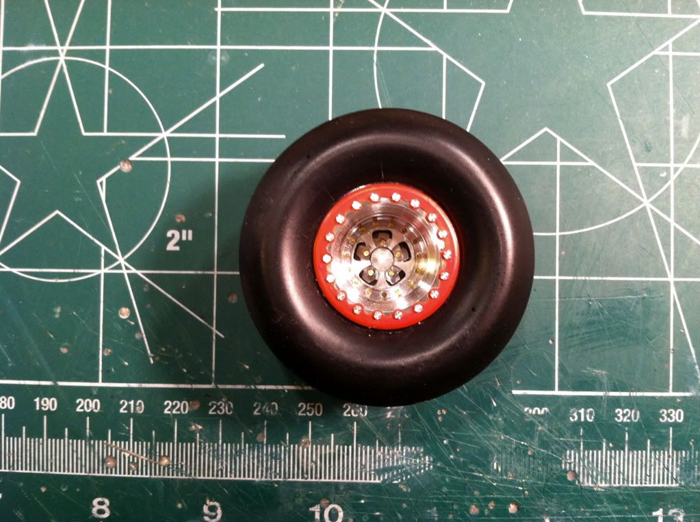

Prostreet Posted April 12, 2012 Author Posted April 12, 2012 Messed around with the rear wheels a little tonight, I decided to do anodized red bead rings to be a little different as black and gold seem to be the norm. I used model masters Acryl clear red on the ring then hit with some model masters dull coat to give it that flat ano look and finished it of with RB motion bolt heads. All that's left to do is put on the valve stems and once the tire decals show up i can finish the tires and i will finally have one completed piece. The picture was taken with my Iphone, they look much better in person.
tyrone Posted April 12, 2012 Posted April 12, 2012 Wheels look badazz Joe I like the red beadlock ring...
Mooneyzs Posted April 13, 2012 Posted April 13, 2012 Nice work on the bead lock. Looks Killer Joe!!! very nice work.
stump Posted April 13, 2012 Posted April 13, 2012 Joe, LOVE that wheelie bar set up mate. And I must agree, the red beadlock makes a pleasant change from the blue and black you see all the time. Nice touch.

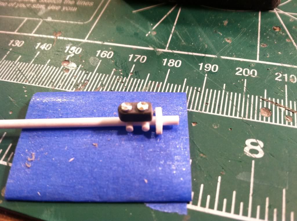

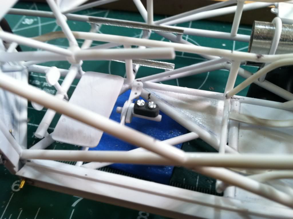

Prostreet Posted April 15, 2012 Author Posted April 15, 2012 Thx. Guys, Built the master cylinder last night and turned some caps for it, They will be anodized red to match the beadlocks. Will make the mount tonight and get it finished up.
Mooneyzs Posted April 15, 2012 Posted April 15, 2012 Joe.... Killer work on the master cylinder. It's little details like this that makes our build pop. I really need to get myself a miniature lathe. I wanted to ask you again which I could probably dig thru the post here on where you go the springs that you changed out on your struts and coilovers?? I know the springs you switched too looked perfect for these. Thanks man!
Prostreet Posted April 15, 2012 Author Posted April 15, 2012 Joe.... Killer work on the master cylinder. It's little details like this that makes our build pop. I really need to get myself a miniature lathe. I wanted to ask you again which I could probably dig thru the post here on where you go the springs that you changed out on your struts and coilovers?? I know the springs you switched too looked perfect for these. Thanks man! Thx. Chris, One of the first caps i did i lost when it flew out of the tweezers lol, Then i had to make another one. They are so darn small, Hope to have a picture of it mounted in the frame later. The springs came from this Harbor Freight kit. http://www.harborfreight.com/200-piece-assorted-spring-set-67562.html Alot of little useful springs in there, If you can't find any let me know and i can hook you up.

Prostreet Posted April 16, 2012 Author Posted April 16, 2012 Thx. so much guys, As far as paint goes i hope to have it in primer in another 2 weeks i hope. Still have to add couple more bars and tabs, As far as color goes , Really leaning towards a pearl white or maybe german silver i really have no idea yet. Not sure if i will do graphics or not, Tonight i finished the foot pad and it will probably get a grip tape type material to finish it off. Also got the master cylinder mount done, The lines will go into the chassis then exit in front of the firewall like they are going through the frame. My end mill bits will be here this week so i hop to start on the top part of my manifold.

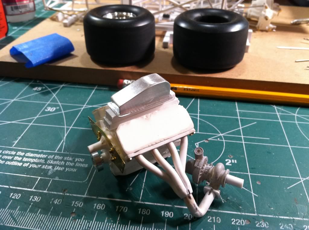

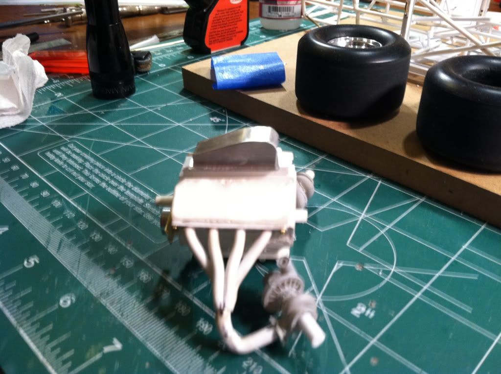

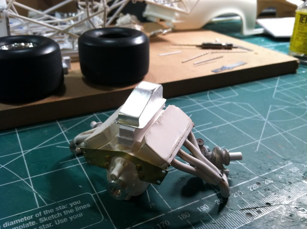

Prostreet Posted April 18, 2012 Author Posted April 18, 2012 Thx.Rom. Little update, I got the top half of the intake done. Still needs some clean up and fine sanding, I used the mill attachment for my lathe to make it. Doing it this way really limited me doing a couple little things to the intake that i wanted to do, A rotary table would have helped. I can't wait to get a mill it's alot of fun making these little parts, Not sure what i'm doing with the lower half or the throttle body yet. Might do it out of brass or just do styrene.
