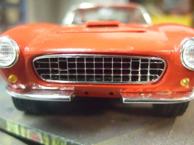

philo426 Posted May 17, 2012 Posted May 17, 2012 Nice work!Apart from the missing prancing horse,what is wrong with the kit's grille?
Matt Bacon Posted May 17, 2012 Author Posted May 17, 2012 I didn't say there was anything wrong with the kit's grille, except that it's rather hard to put together! The prancing horse will go on later, just before I put the whole thing into the frame. Forgive me, Phil, but that looks like the Esci/AMT kit, rather than the Gunze one, unless you've cut open the bonnet and used different wheels... bestest, M.
