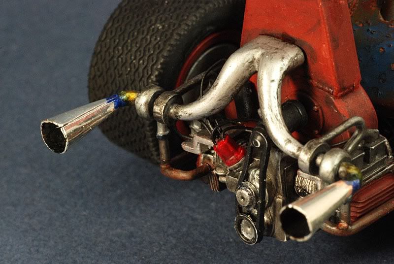

VW Dave Posted July 23, 2012 Posted July 23, 2012 Dan Van posted pics of a VW Bug he built using a polished megaphone style stinger exhaust tip he found at Michael's, and I just saw them there Saturday. I will try to find a pic... Nope, that was me. The packaging or brand name might be different, but search the beading section for 'bead cones,' and you should find these:

Casey Posted July 23, 2012 Posted July 23, 2012 Nope, that was me. The packaging or brand name might be different, but search the beading section for 'bead cones,' and you should find these Gah, sorry, Dave. I picked the wrong Dave. I think the packaging has changed slightly, but they looked very nice, and in scale, too.
Foxer Posted July 23, 2012 Posted July 23, 2012 I used the same bead cones as VW dave shows from Michaels thou a different brand I believe. They are thin metal with a seam down one side. These were attached to a pipe elbow at the ends, Plastistrut I believe.
Casey Posted July 23, 2012 Posted July 23, 2012 I used the same bead cones as VW dave shows from Michaels thou a different brand I believe. They are thin metal with a seam down one side. That's what's nice about the cones Dave used- they have no seam that I could see, and they are nicely polished, too. To seam or not to seam, that is the question for Rob.
VW Dave Posted July 23, 2012 Posted July 23, 2012 Rob's got a PM from me; I checked my stash, and I seem to have a spare pack of those bead cones.
VW Dave Posted July 24, 2012 Posted July 24, 2012 That's what's nice about the cones Dave used- they have no seam that I could see, and they are nicely polished, too. To seam or not to seam, that is the question for Rob. Pssst...don't tell anybody, but they do have a seam. I just position them carefully to downplay it.
