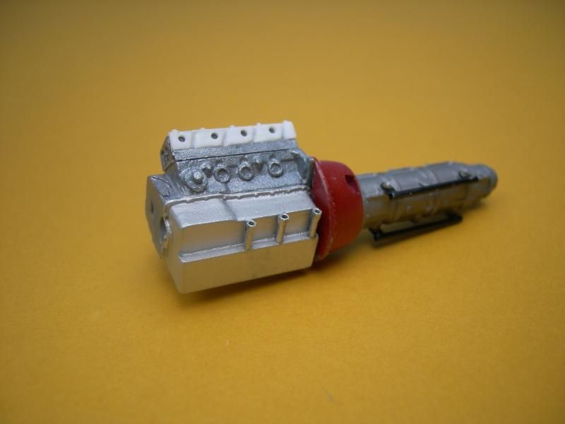

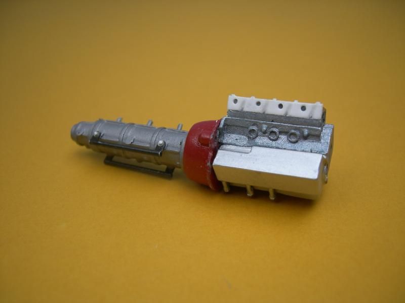

Remind me never to jump the gun and glue things together that shouldn't be... LOL It was a real pain to modify the dry sump on my engine with the pan attached. I finally accomplished it, but it would have gone faster and looked a bit better if I'd exercised a bit more wisdom. Anyway, here are the progress pics with the extended sump and pickup tubs attached.

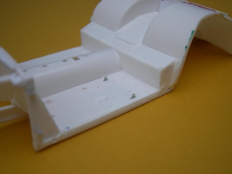

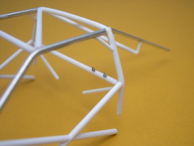

I also made a bit of progress on getting racing harness mounting tabs and set braces added to the chassis.

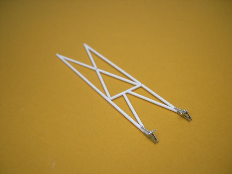

I also got started on the wheelie bars. I'm using one of my sets of PE wheel housings. I'm using RBMotion #1504 rod ends for the upper links and some way or other drilled out the eye on two of them and added stainless steel sleeves to size the hole down to .020". There isn't enough material around the housing hole to go any larger than that. The rod is .050" Plastruct. The #1504 rod ends have a .033" shank, so I made a fixture out of stainless steel tubing so I could drill centered holes in the rod. Holes are approximately .050" deep so the rod ends will have decent engagement inside the rods. The upper bars must be bent slightly so they'll clear the underside of the chassis. I haven't gotten that far yet.
